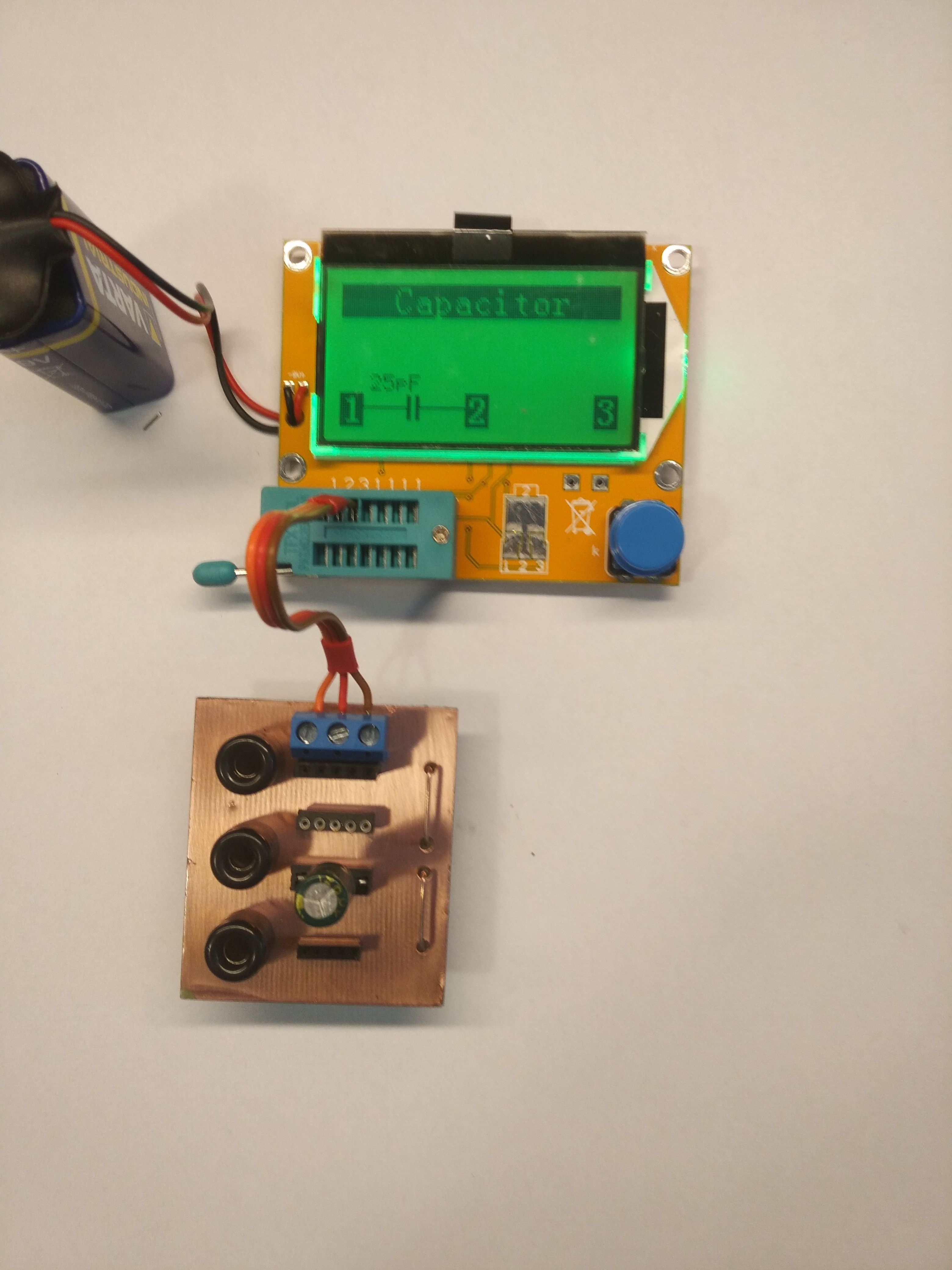

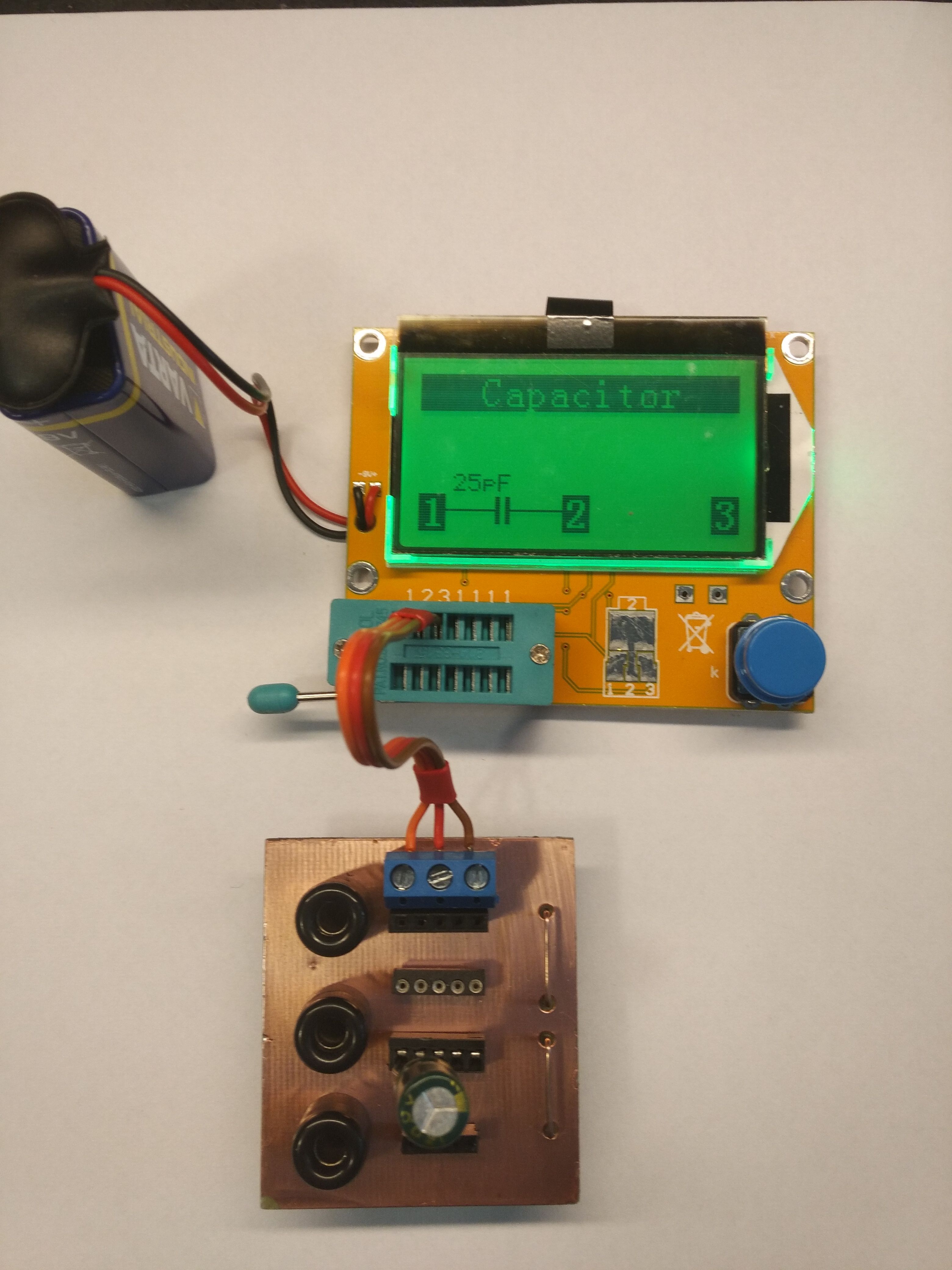

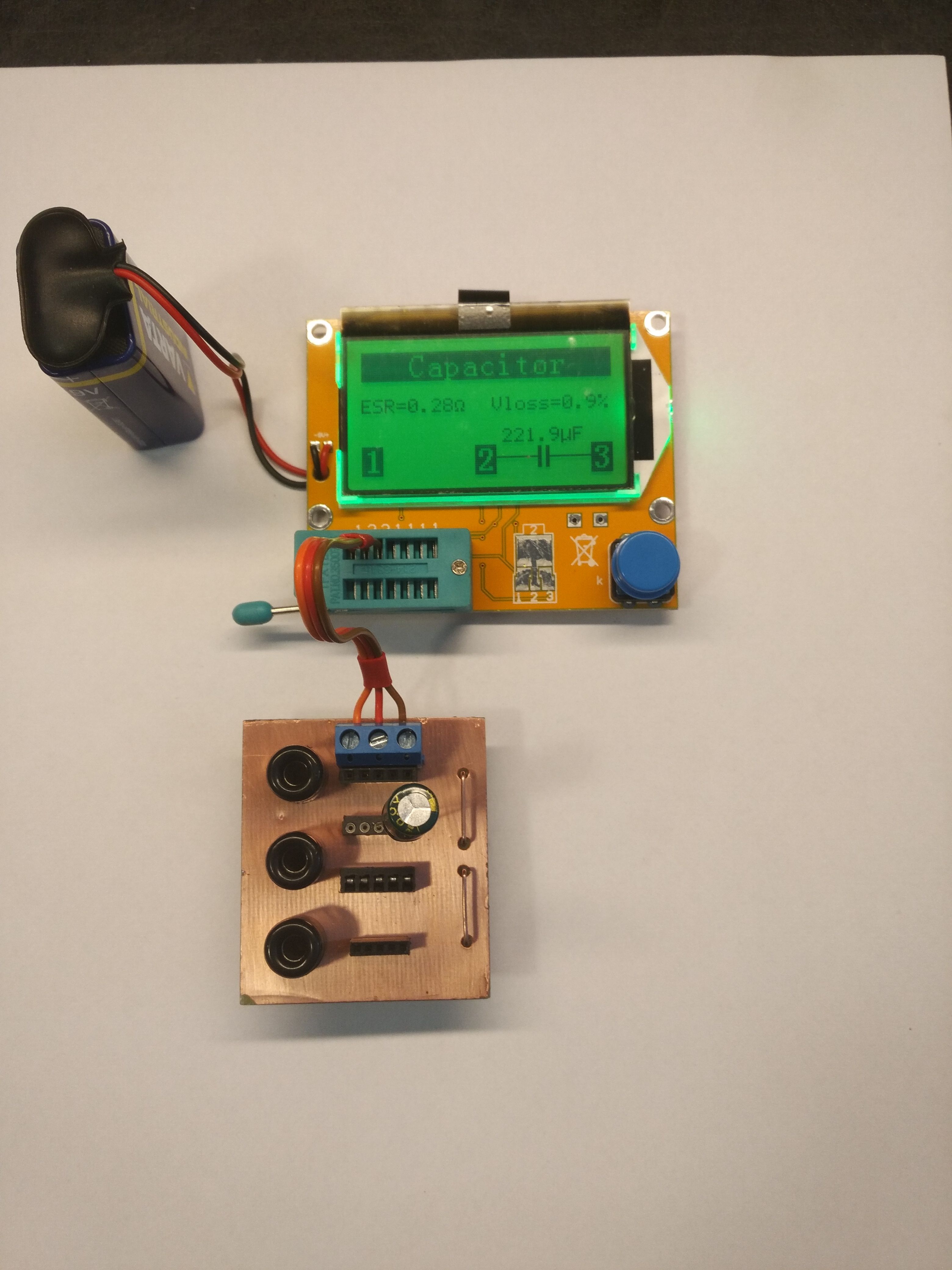

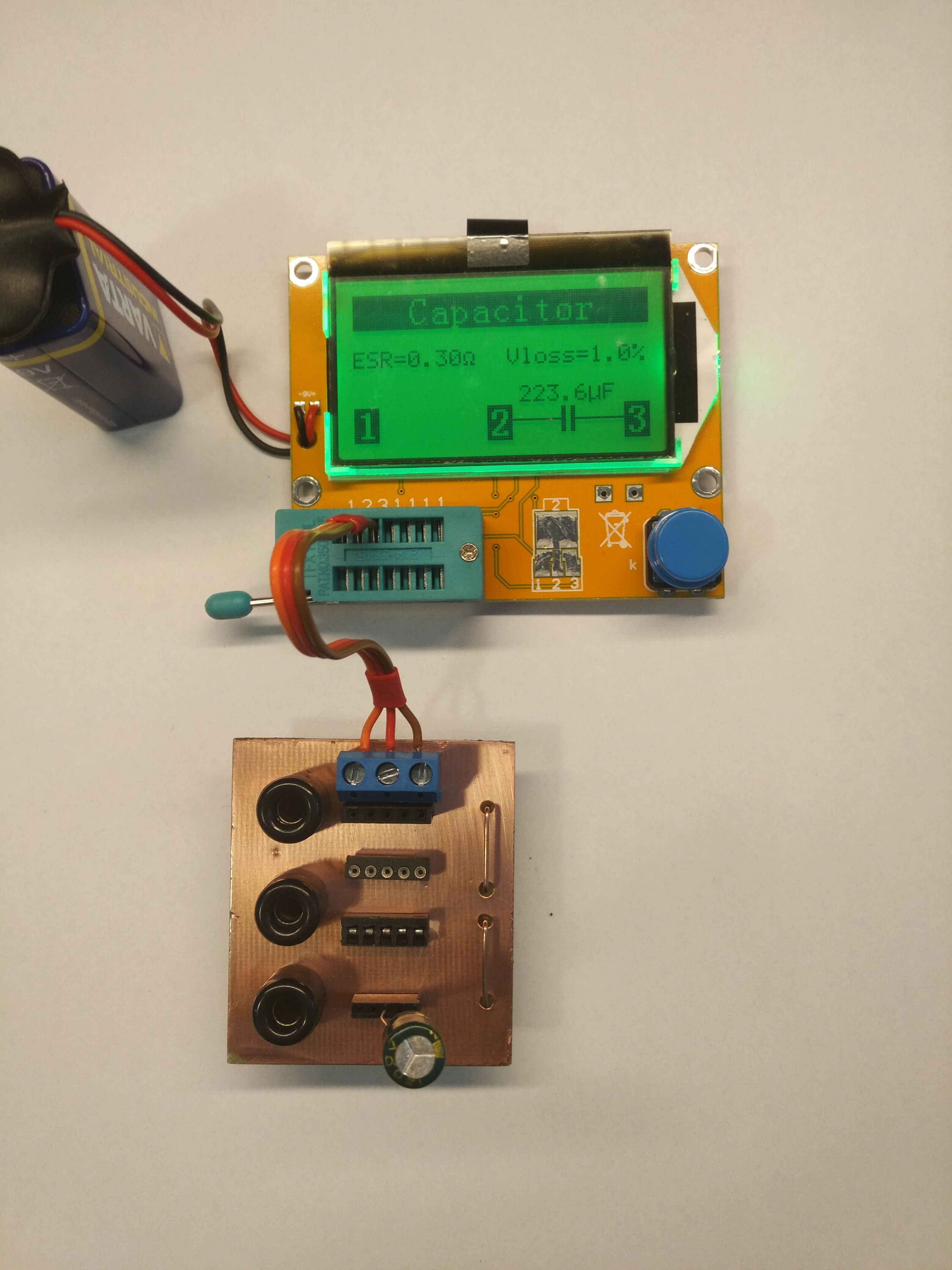

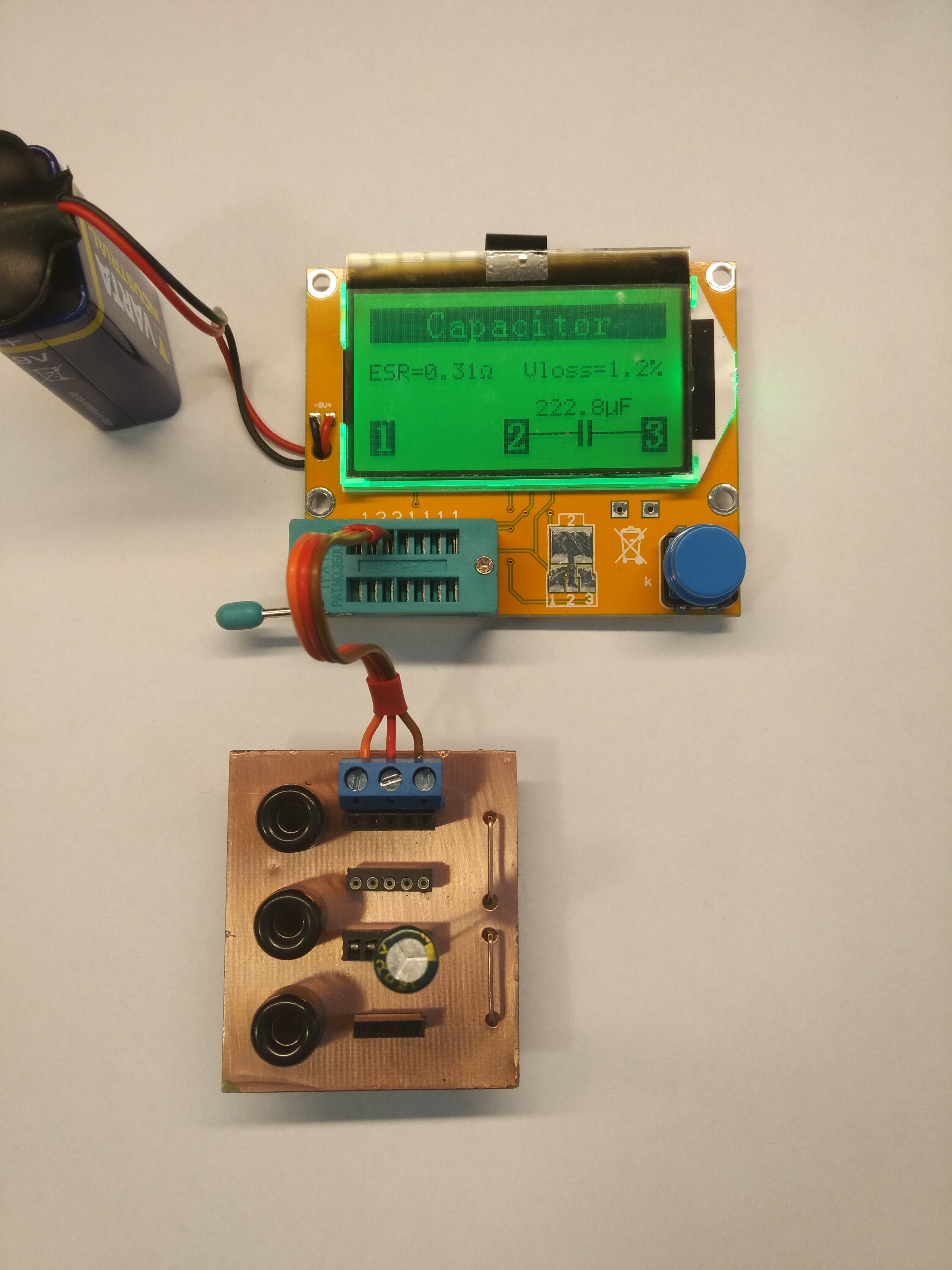

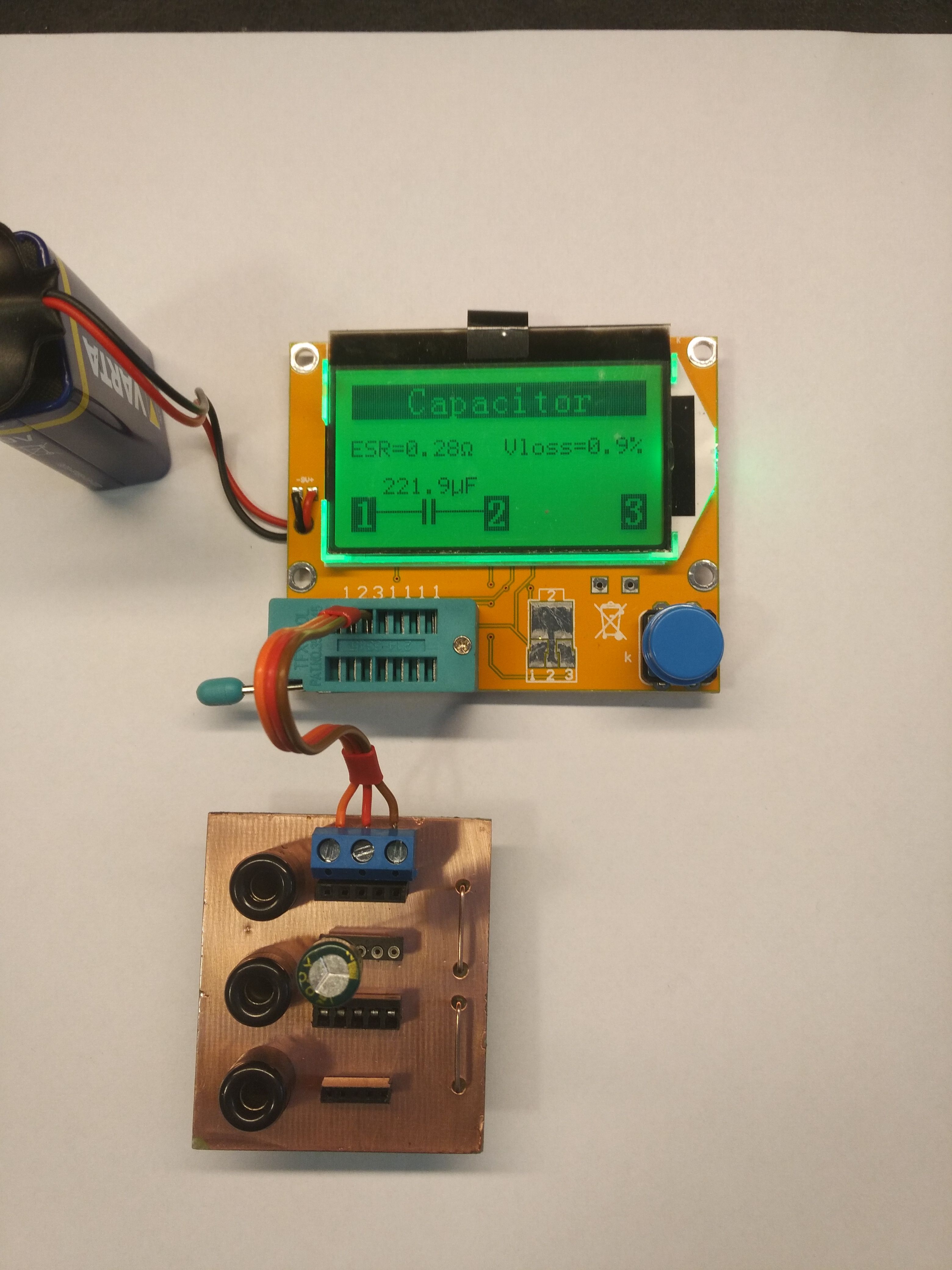

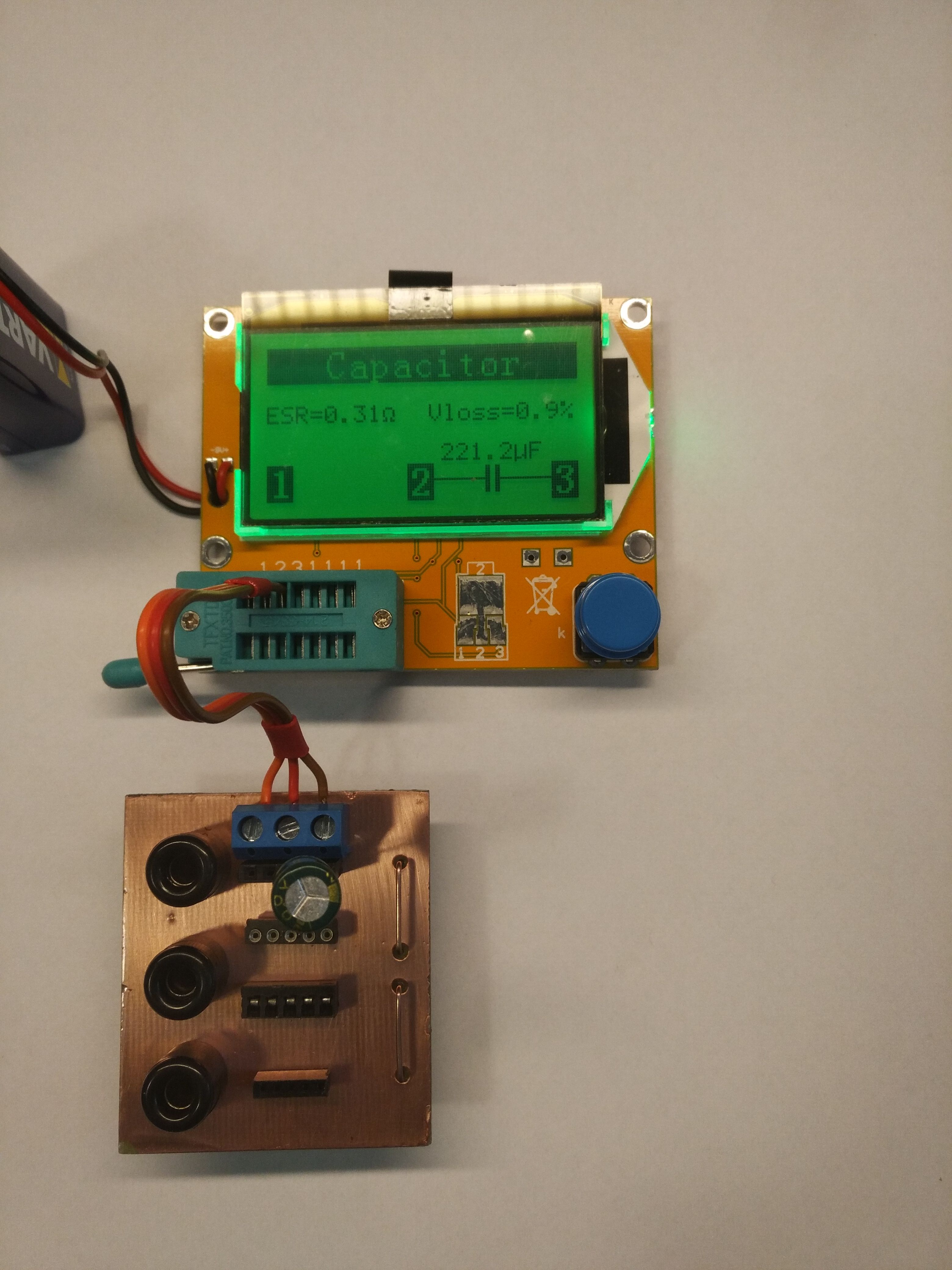

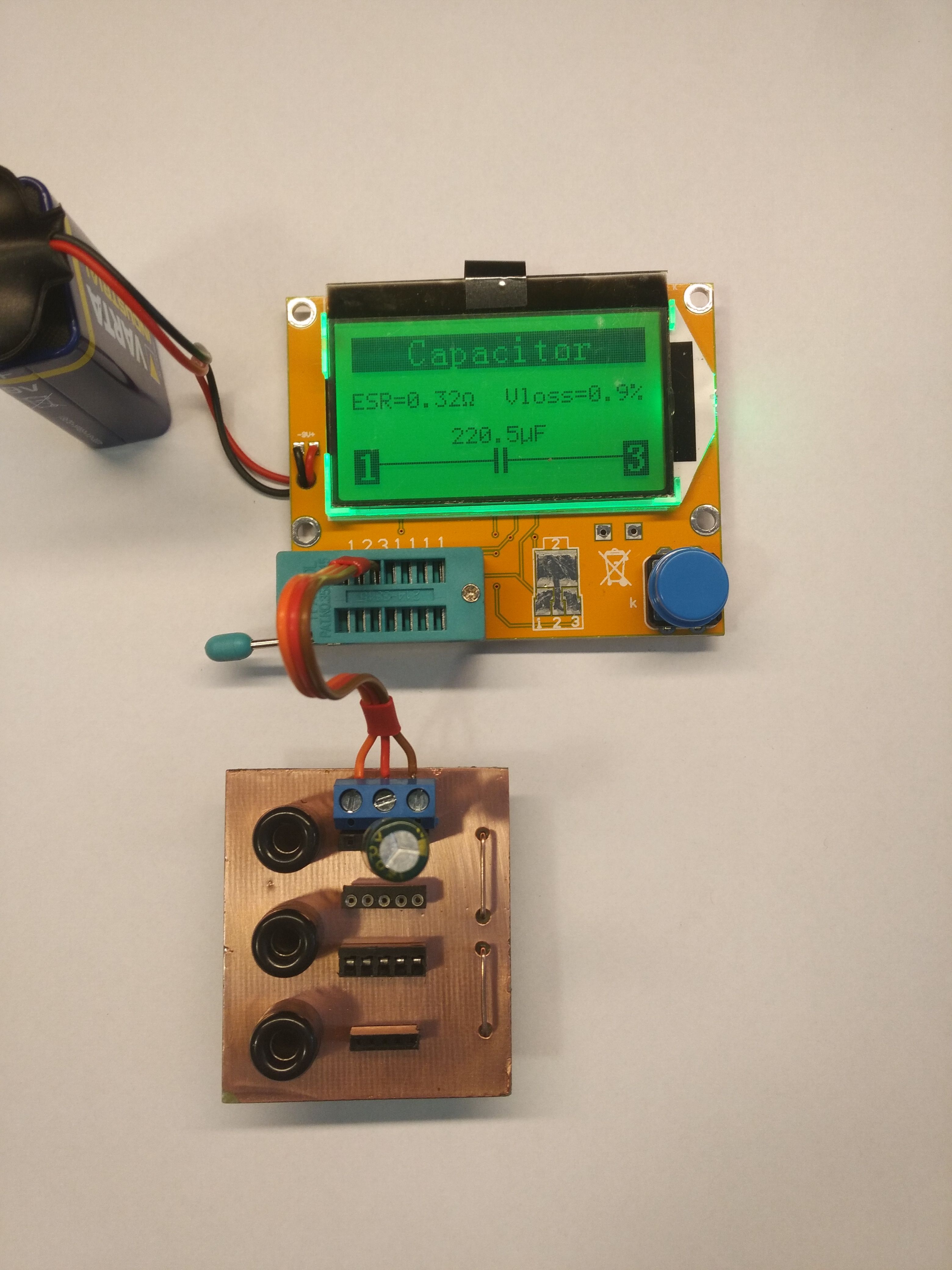

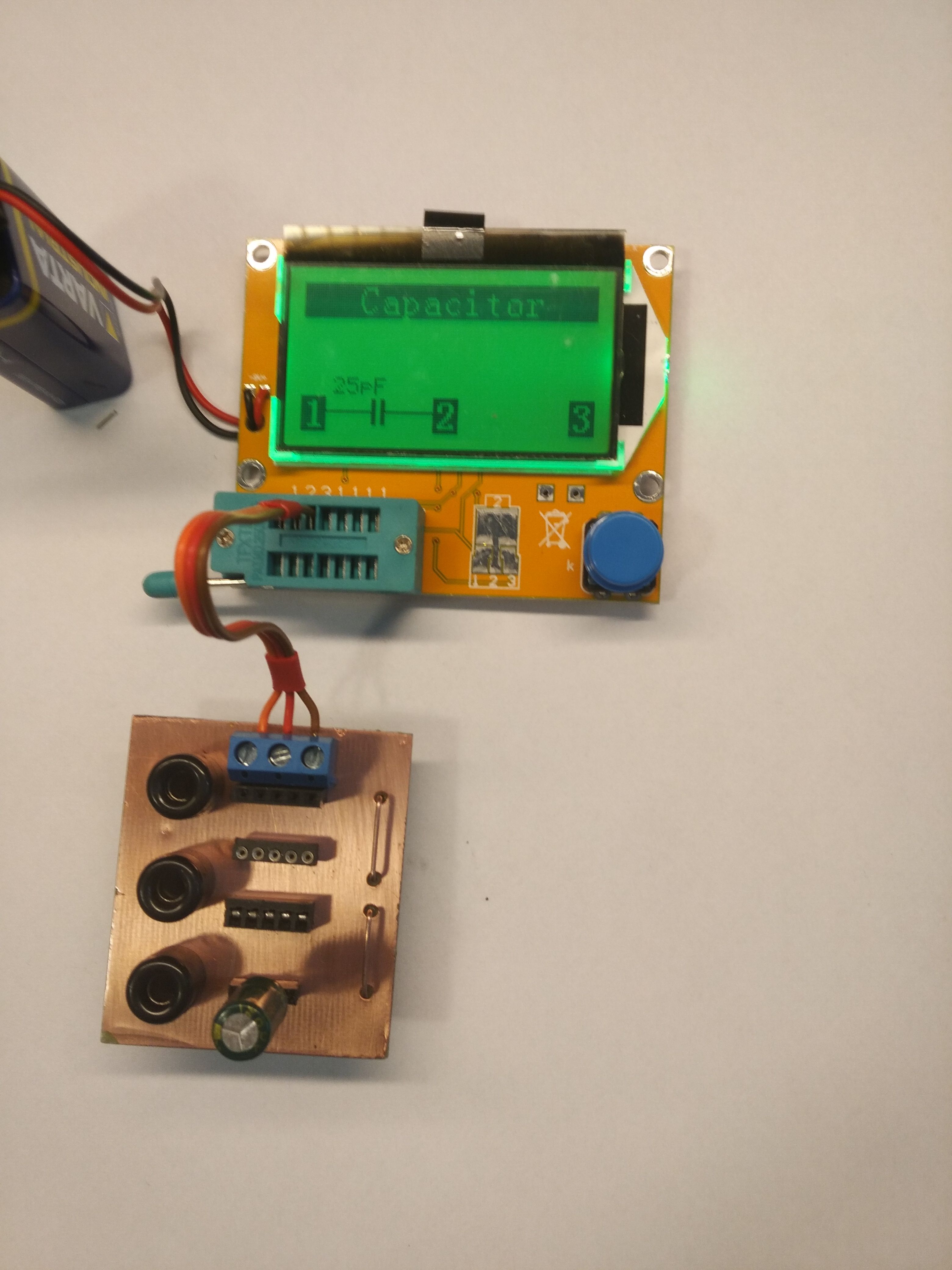

    I made a small extension to the tester and now I have quite a puzzle to solve. Look yourself. Pins 1 and 2 are connected and "doing" as pad 1 test, pin 3 is pad 2 test, pins 4 and 5 are connected and "do" for pad 3 test. And in all joints, except ARK and bananas, because these they are triple. These wires on the right side are copper wire coated with a 10? 3W resistor soldered on them to unload the capacitors before the measurement. And now the time for pictures, pay attention to which outputs the capacitor is connected to, where the measurement result is incorrect. LCR-T4 electronics components tester ATMega328 - Test and Review LCR-T4 electronics components tester ATMega328 - Test and Review LCR-T4 electronics components tester ATMega328 - Test and Review LCR-T4 electronics components tester ATMega328 - Test and Review LCR-T4 electronics components tester ATMega328 - Test and Review LCR-T4 electronics components tester ATMega328 - Test and Review LCR-T4 electronics components tester ATMega328 - Test and Review LCR-T4 electronics components tester ATMega328 - Test and Review LCR-T4 electronics components tester ATMega328 - Test and Review LCR-T4 electronics components tester ATMega328 - Test and Review LCR-T4 electronics components tester ATMega328 - Test and Review Normally, I would think that I have a faulty stand, but two different damaged ones are no longer an exaggeration. Please note that in the last two photos the capacitor is connected to other pins than the tester detects. a 220uF capacitor on pins 1-3, and the tester sees 25pF at 1-2. Who will be so clever and say what this beast is about? Maybe it measures the capacity of paths. But if so, why it does not go out equally, after all, all connectors are connected in parallel and the paths have the same length for each slot. Apart from the bananas, because each one has a different length, but I did not check on these joints.

    Because where do you write that an element does not enter the handles ?? Forgive but sorry, this is your defense line.
    Are you making a fool of yourself or are you trying to make me? Since, as you rightly wrote, I did not indicate that the element does not fit into the handles on what basis europtis he wrote:
    eurotips wrote:
    As the item does not enter the stand on pcb it is not connected to the feet by connecting cables
    instead of asking me how this capacitor connected :) . Did he see from a distance of over 300km as I was making a measurement or "in the dark" suggested that "I kept the cable in the paws" :?: Where does the infantile naming "cable" instead of "cord" come from? You emotionally defend your friend instead of reading comprehensively from posts 175 to 177.

    eurotips wrote:
    Most of the "strange" indications are the issue of the pins contact of the tested element. When testing an unknown element, it is worth inserting it into the stand twice, turning it 180 degrees second time.
    If it's a matter of contacts, just insert it twice or three times in the same position. If the reversal by 180 degrees significantly changes the test result, for example from the transistor, the thyristor is made, and really it is a triac, the error lies in the way of testing. Returning to the German capacitor, which "appeared" at the first measurement as a duodode. Earlier (just after receiving the tester) I measured a dozen capacitors with a capacity of 10 nF to 4700 F, there were no surprises, then (repeated measurement of German and several others, not previously measured). That is why I consider the contact error unlikely.

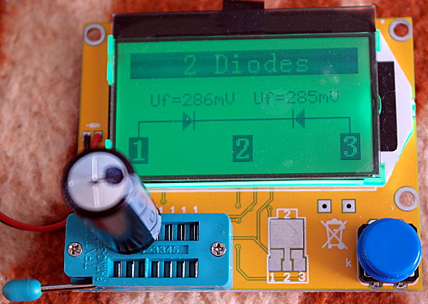

    A curiosity about what a tester can do. At the first measurement of the old GDR capacitor from 1987. o. nom. 2200uF / 63V detected a double diode. The next capacitor with capacitance is correctly 2120uF. Is it possible that a long unused capacitor "pretends" two diodes connected in series cathode to the cathode?
    I probably discovered the reason for this strange behavior of the tester. Yesterday I measured the capacitor again and again pretended to be a double diode, also after the pins reversed. I looked carefully at the capacitor and noticed something that had previously escaped my attention. The capacitor has only been output + and - it is on an aluminum housing. The minus outlet is soldered to a brass washer pressed with an aluminum nut. Probably due to the influence of these metals (micro-cell), the result is false. When I moved this washer, the tester correctly identified the capacitor and measured its capacitance. Added after 6 [minutes]: Still a request. Maybe one of my colleagues would like to test the linear potentiometer. The tester visualizes its image as two resistors connected in series with the tap at the connection point. The visualization changes (guess how?) When the potentiometer is turned to the maximum left or right. At the end of the test results of the Mf-102 phono cartridge. As far as I remember correctly, the nominal resistance of the coils of one channel is 660? and the inductance is 550mH. I measured: L - 668? and 541mH; R- 638? and 595mH

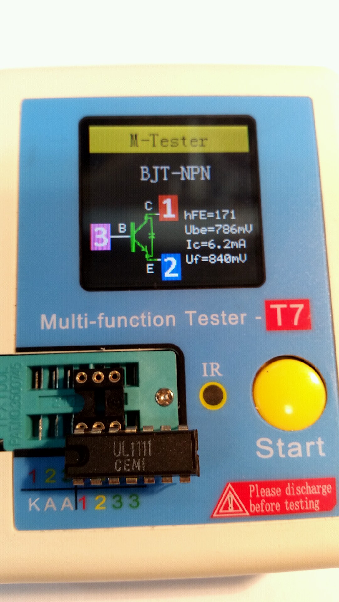

    And what interests me the most is what this tester showed on one of the "components" of UL1111 integrated transistors ... I just do not have to check because I do not have the meter: /

    Adamcyn wrote:
    MiernikZKauflanda wrote:
    And what interests me the most is what this tester showed on one of the "components" of the UL1111 integrated transistors
    Why do you ask? There are quite normal bipolar transistors.
    robiit1 wrote:
    .. Workshop "WN-T 1987r. gives the transistor data from this system: Uce = 15V, Ucb = 20V, Ueb = 5V, Icmax50mA, Ptot = 300mW, f = 500MHz.
    UL1111 - tester T7 yes, it is presumably detected as normal bipolar transistors. But t5 on terminals 12 (B), 13 (E), 14 (C) has a diode between E and C. And she is there, which can be checked with a diode tester in an ordinary multimeter :) It seems that by combining 13 (E) with the ground, so you can judge from the application note, LCR-T4 electronics components tester ATMega328 - Test and Review
    and gates, as I understand from the series, e.g., 7400, require power so this meter will not work.
    This type of testers are intended only for measurements of discrete elements, it was probably in this thread. It can not sensibly detect / measure even TL431 type circuits. Similarly in terms of operational amplifiers.

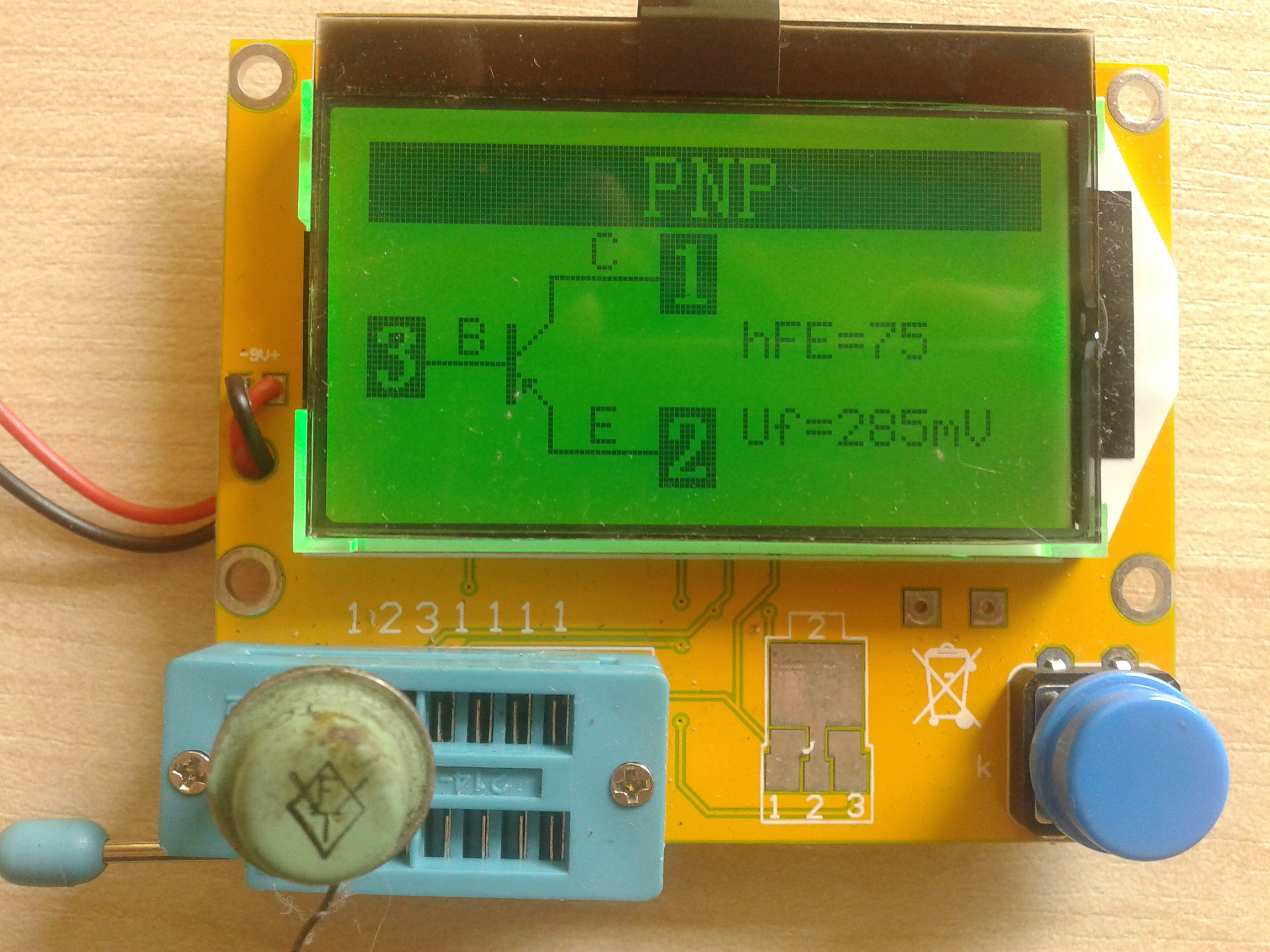

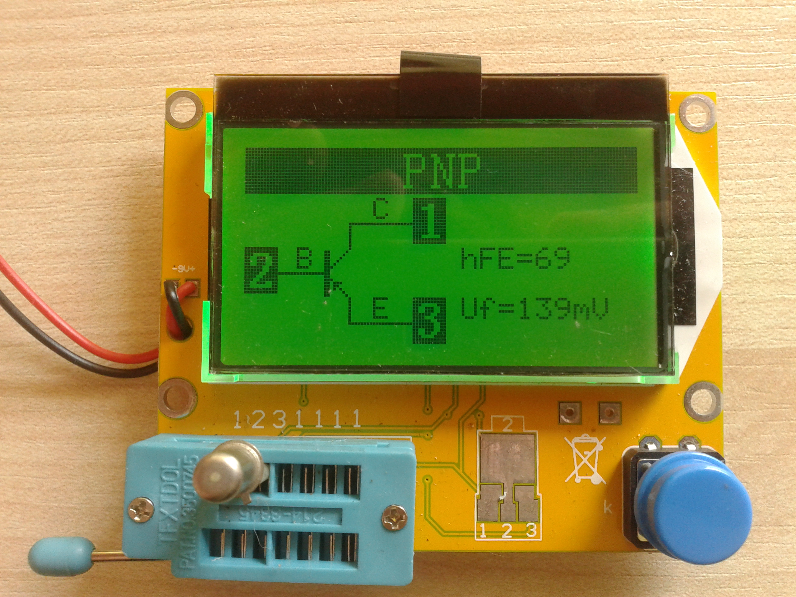

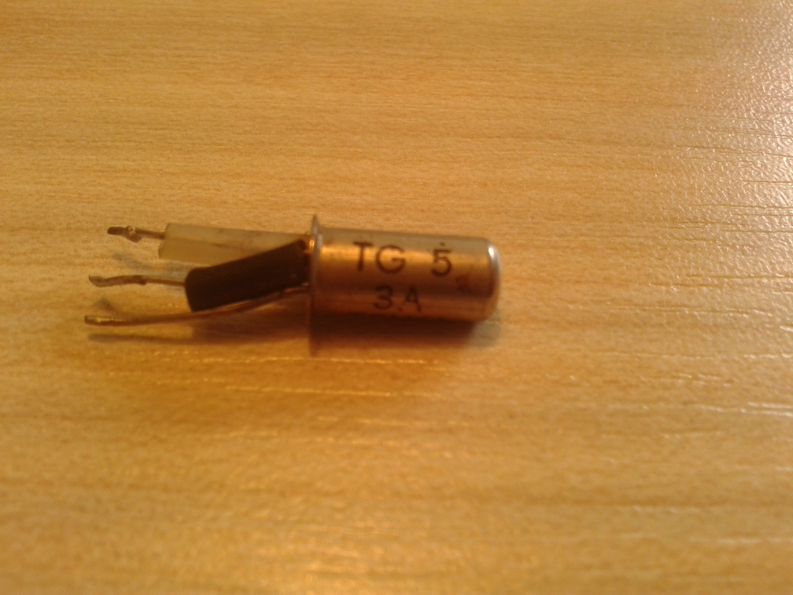

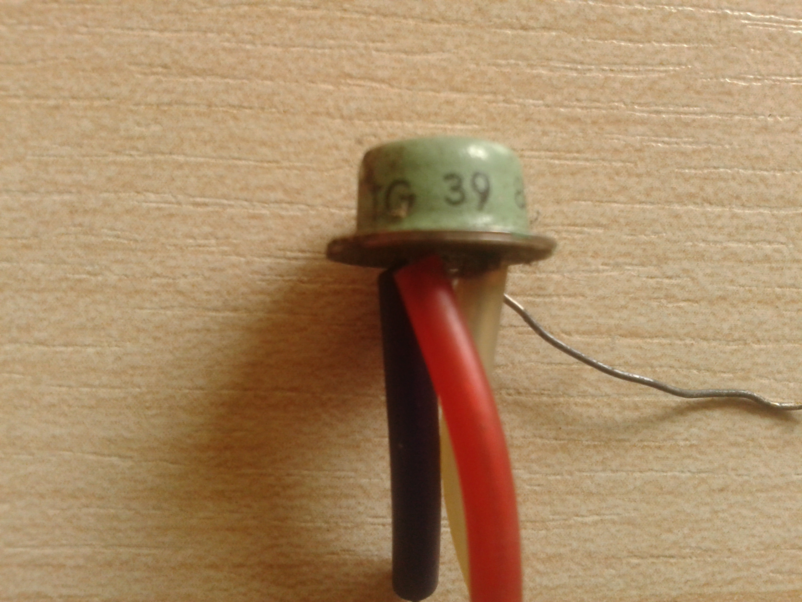

    E8600 wrote:
    I wonder how he would deal with germanium diodes or other elements rarely used today.
    I found a germanium transistor in my museum. Photos what the tester showed: LCR-T4 electronics components tester ATMega328 - Test and Review LCR-T4 electronics components tester ATMega328 - Test and Review The transistor is working :) Added after 12 [minutes]: Another transistor: LCR-T4 electronics components tester ATMega328 - Test and Review LCR-T4 electronics components tester ATMega328 - Test and Review Also working.

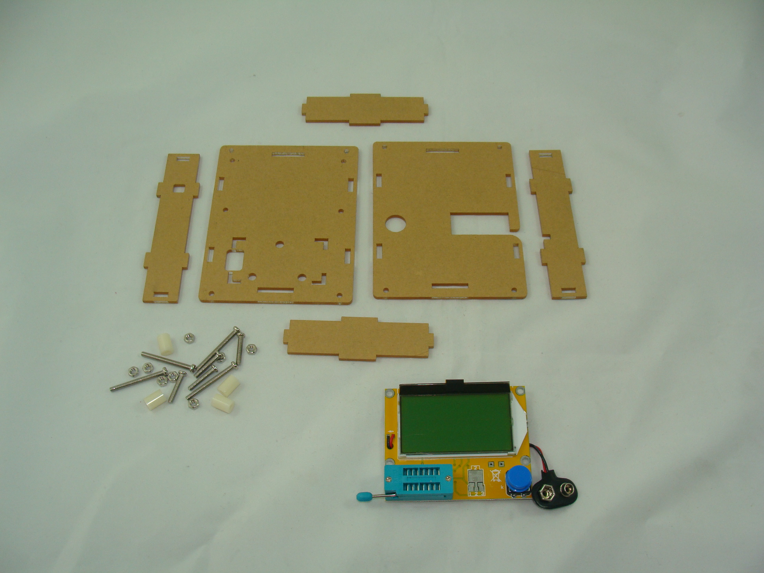

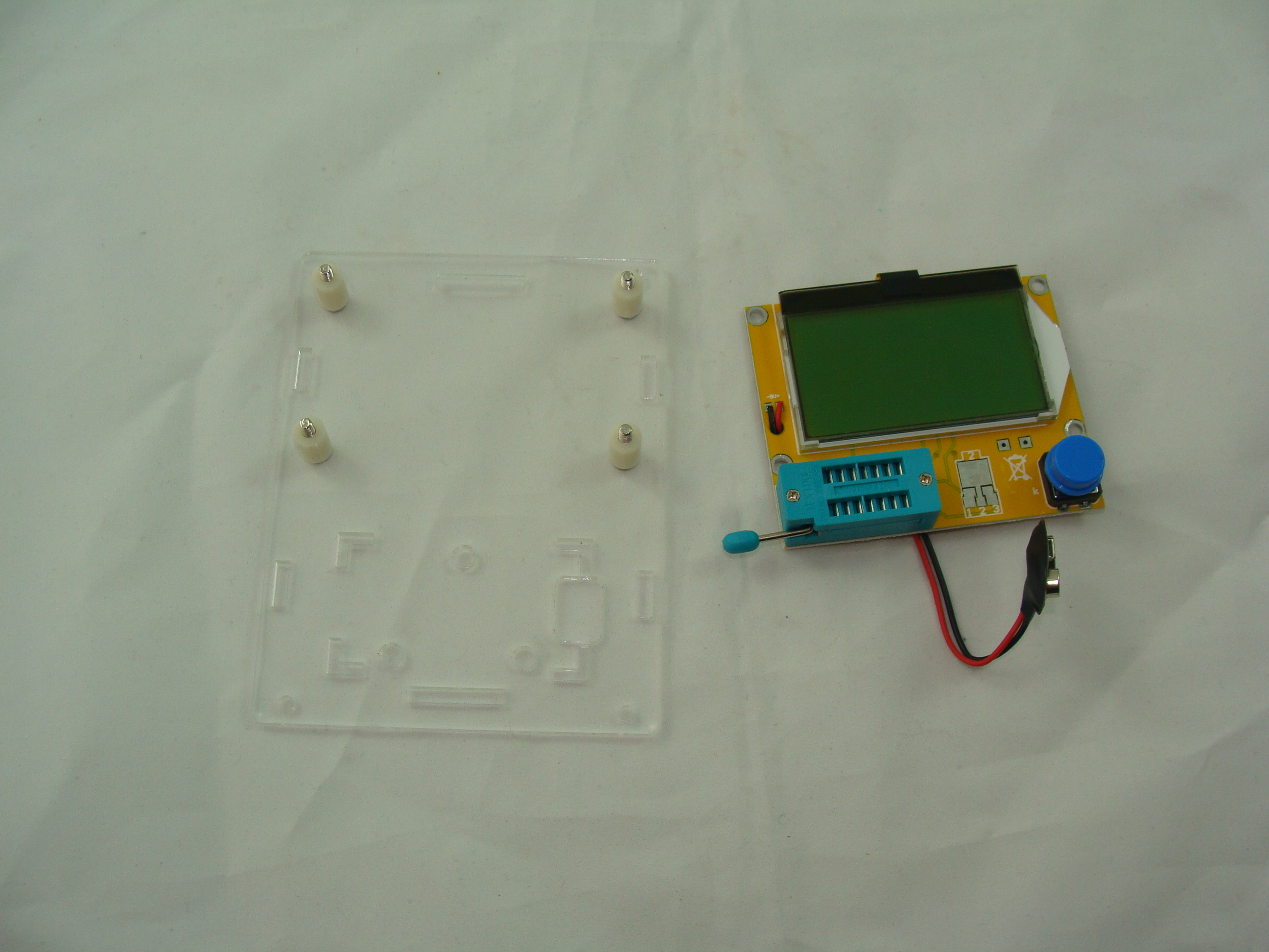

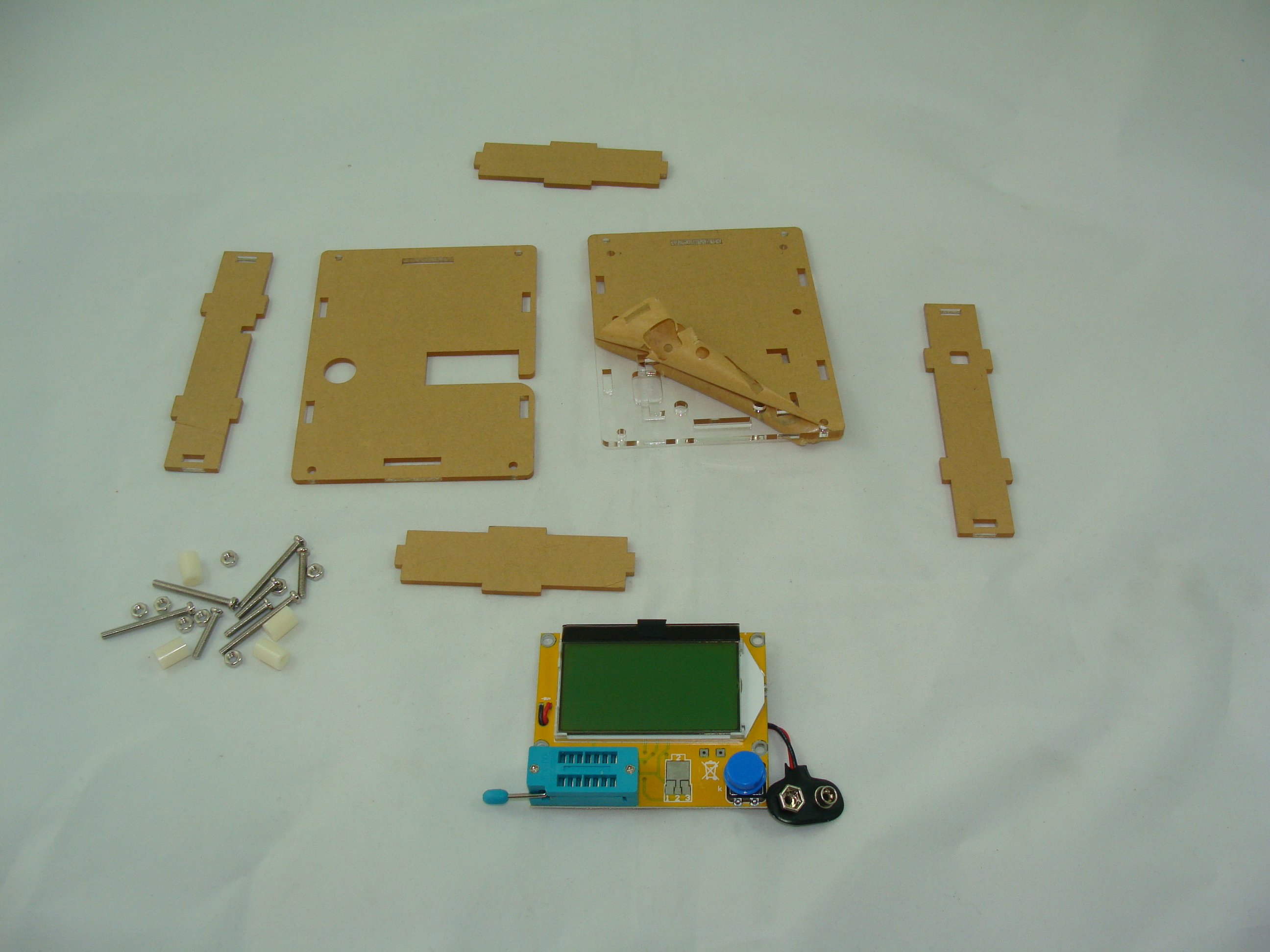

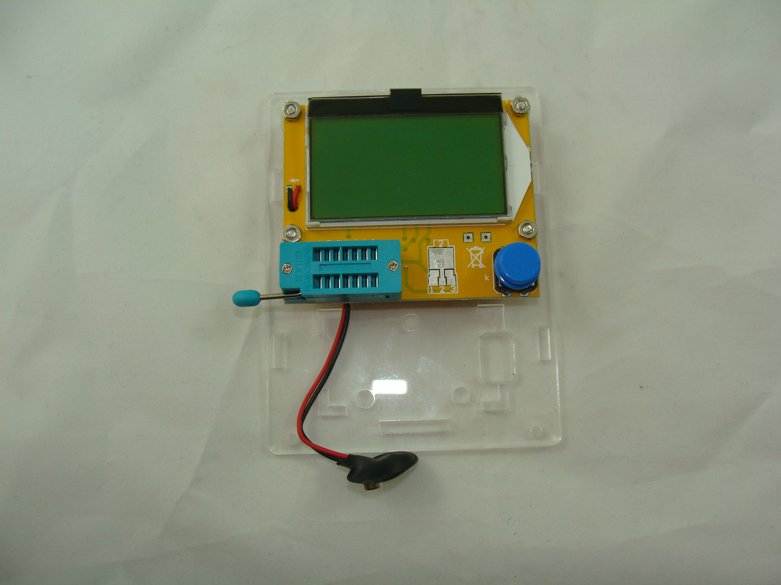

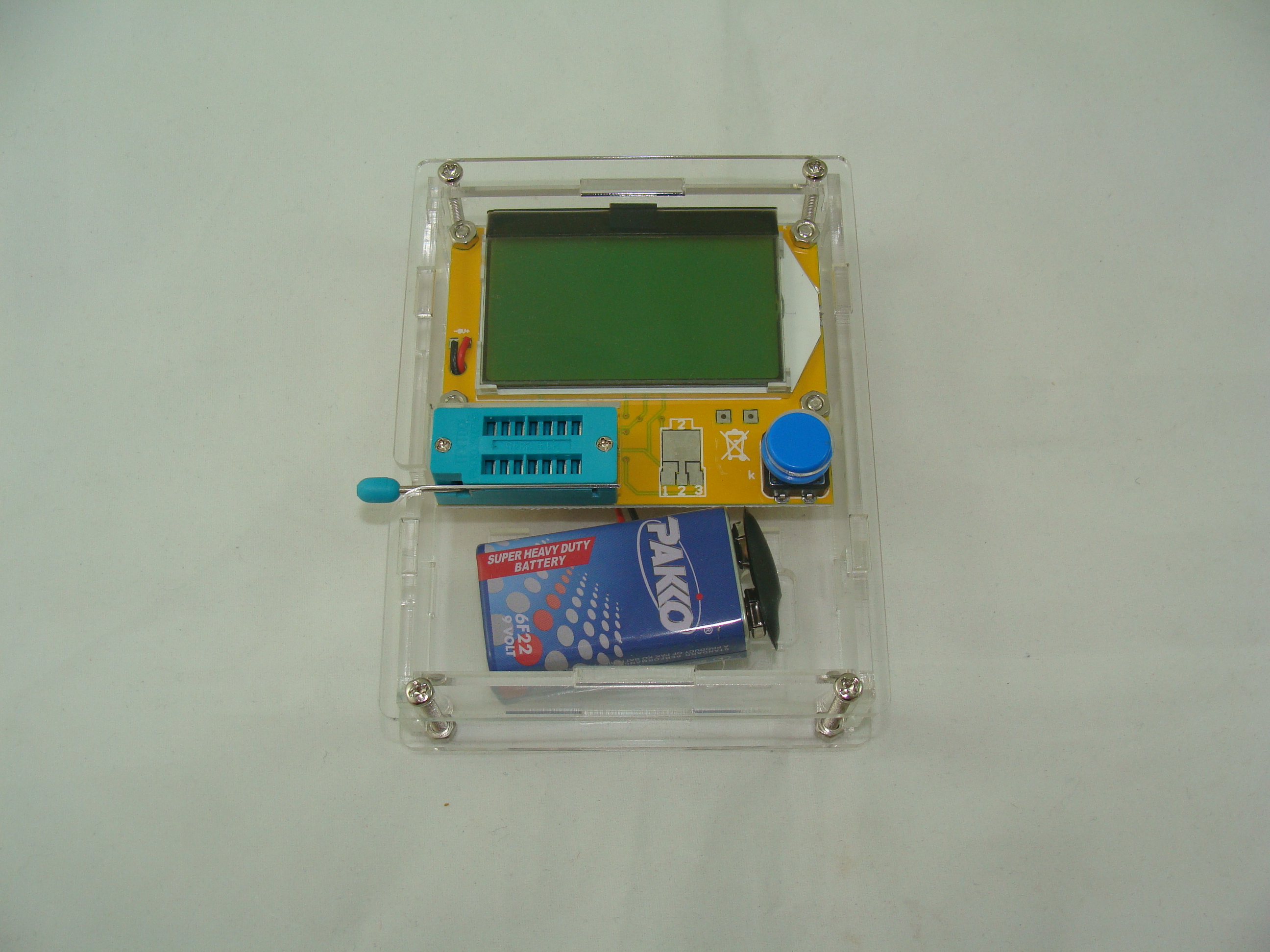

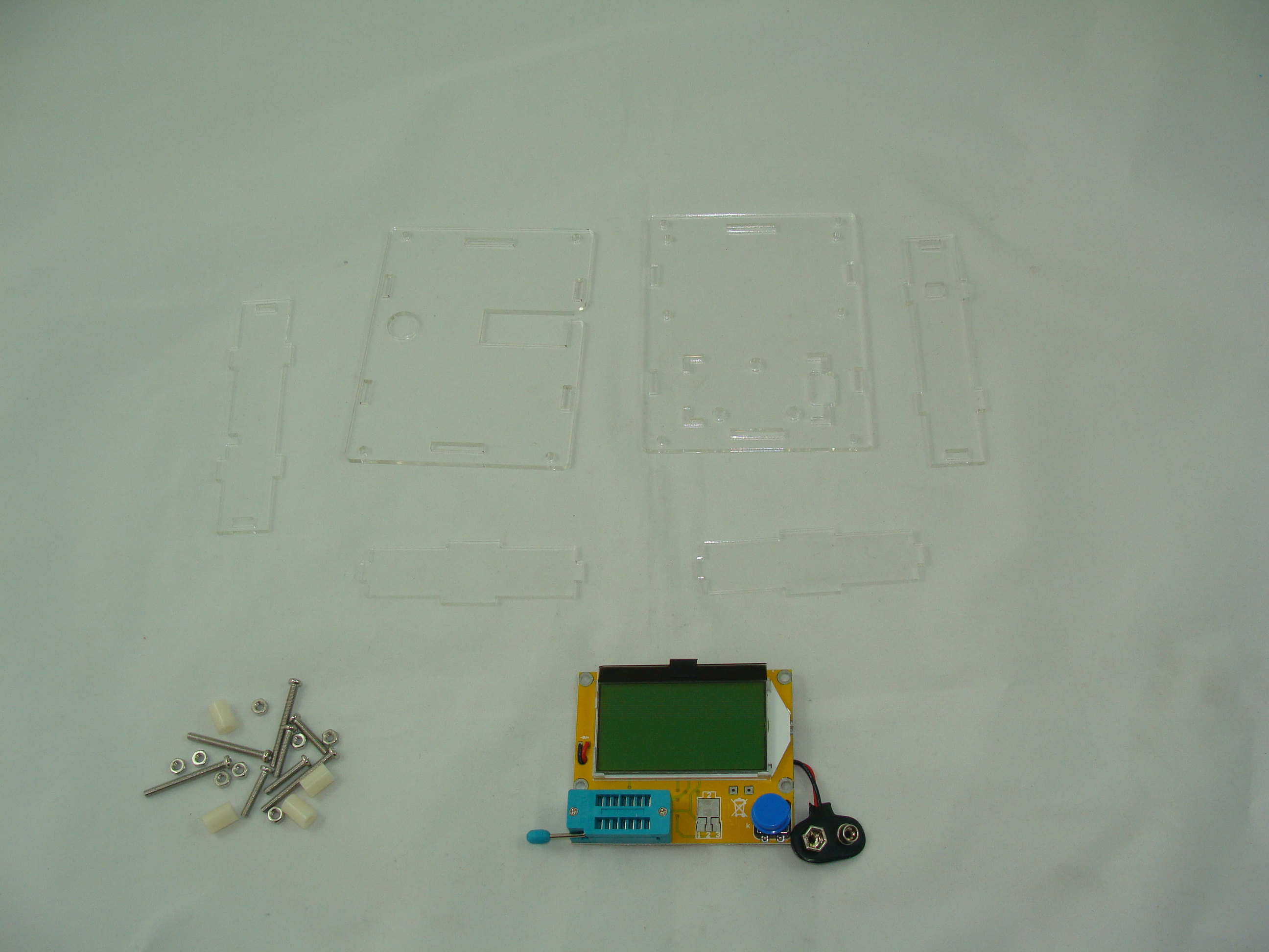

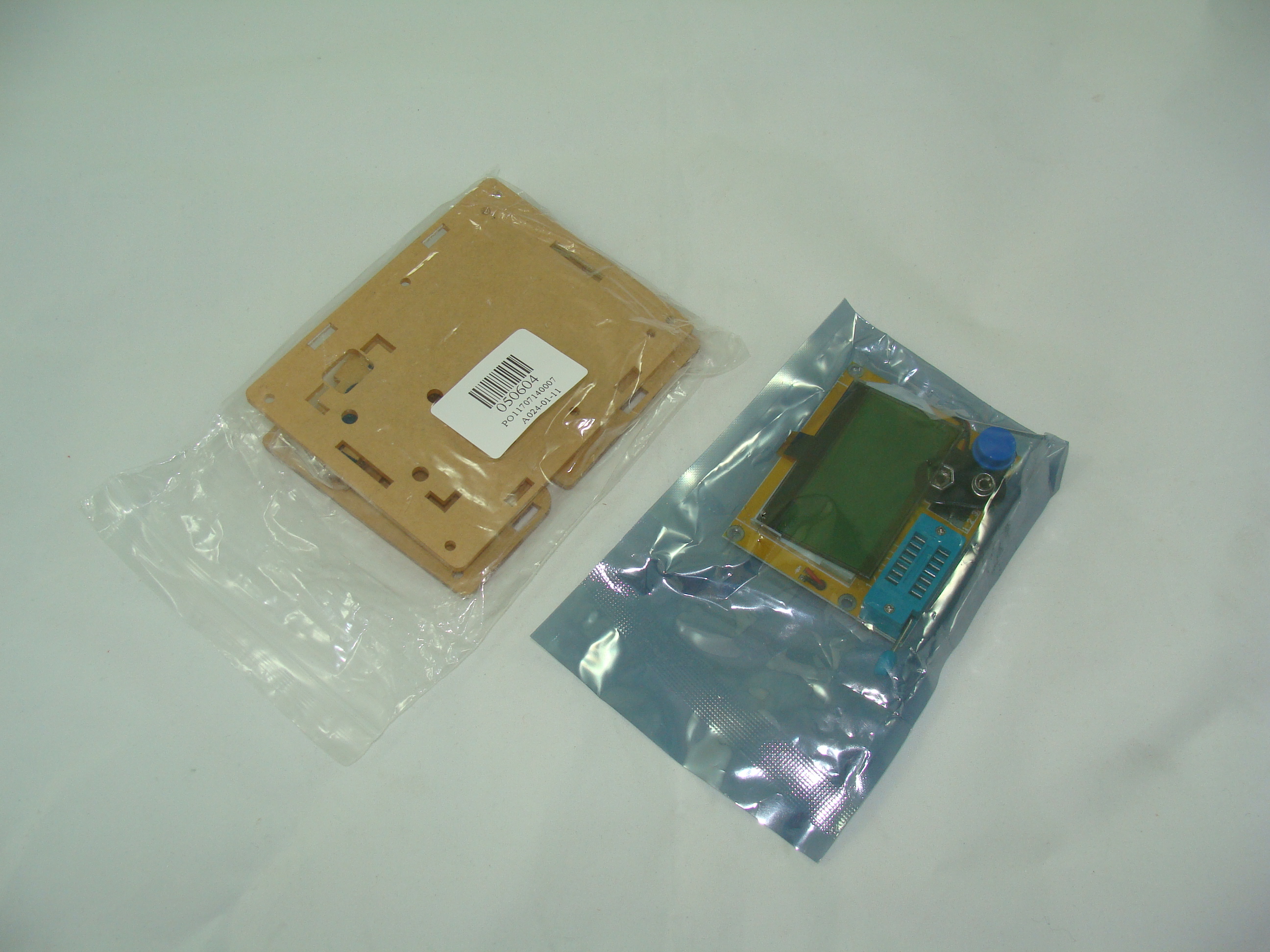

    Folding the tester housing: LCR-T4 electronics components tester ATMega328 - Test and Review LCR-T4 electronics components tester ATMega328 - Test and Review LCR-T4 electronics components tester ATMega328 - Test and Review LCR-T4 electronics components tester ATMega328 - Test and Review LCR-T4 electronics components tester ATMega328 - Test and Review LCR-T4 electronics components tester ATMega328 - Test and Review LCR-T4 electronics components tester ATMega328 - Test and Review

    The housing prevents using the tester to check SMD components.

    I bought such a housing and, unfortunately, the attached white sleeves are probably 11.5mm long and are too long and the attempt to twist the enclosure ends with the permanent depression of the tester button. It needs to be replaced with 10mm bushings.

    The person who played with this did not report anything like that. The sleeve in the test copy was 10mm. I do not know how in others.
    Replace?. We created hammers for the first six months at school (Kasprzak) with a file from a piece, a roller with a diameter of 5cm. With full respect for precision mechanics, but a real electronics enthusiast for this hobbyist with this 1.5mm would not write something like that. After all, this is a gadget that has the right to be useful at the bivouac with grandchildren. Greetings.
