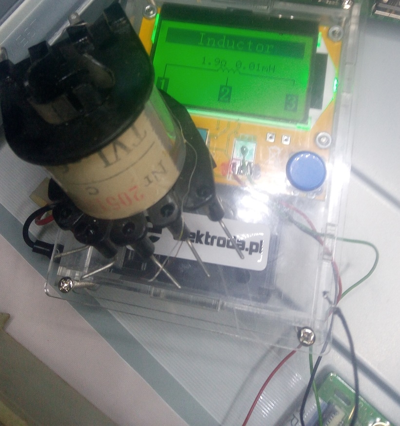

    vodiczka wrote:
    ... I also noticed that it does not recognize inductance in coreless coils ...
    This is not the reason. For proof, the measurement of the coreless coil measurement: LCR-T4 electronics components tester ATMega328 - Test and Review

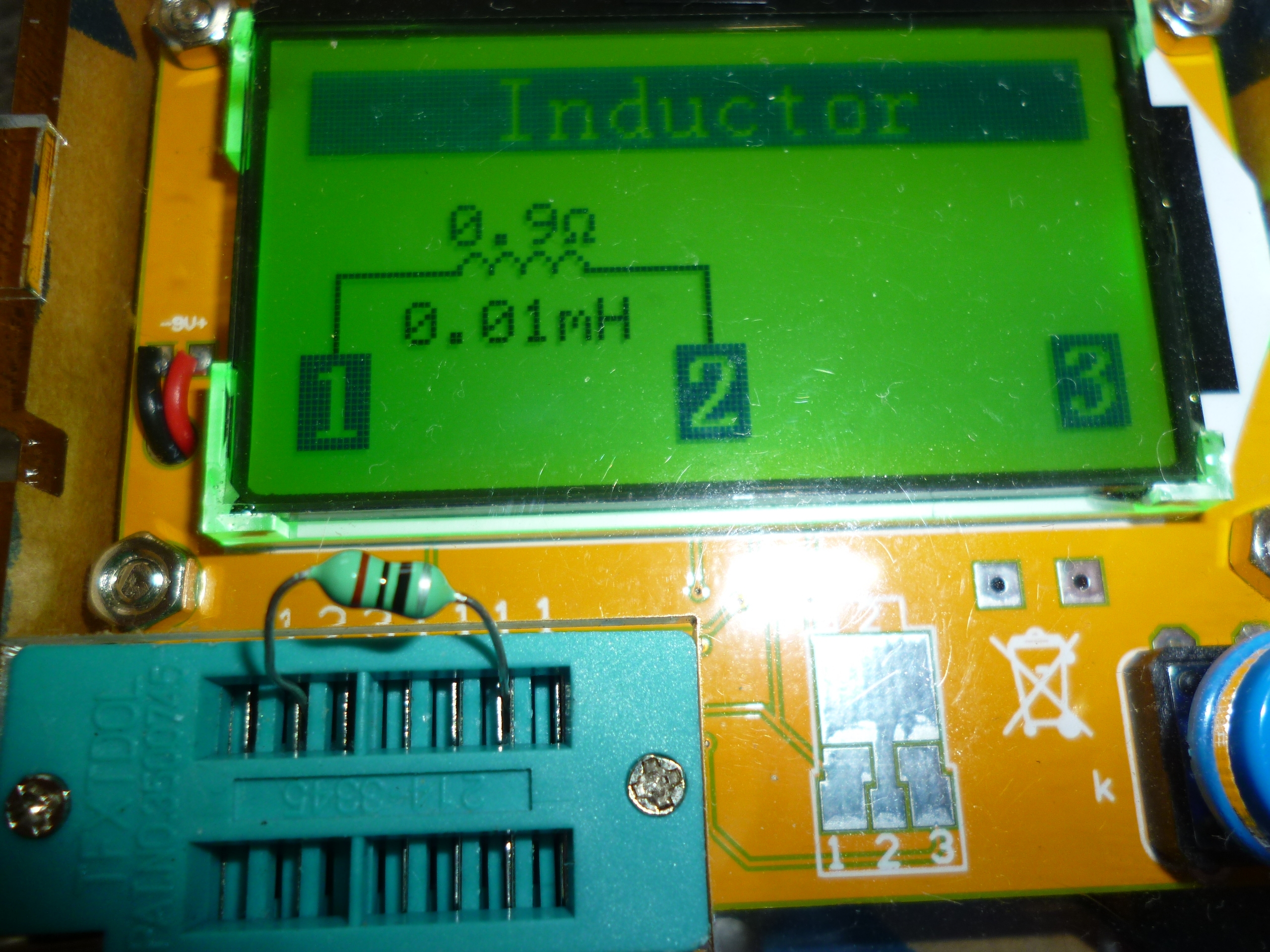

    vodiczka wrote:
    How not how. I did not add that she did not recognize small inductance. I wrapped the coils for several dozen turns and a resistance of 0.2-0.5?, the tester recognized the resistors.
    According to its (tester) technical data, it measures the inductance from 0.01mH. A few or even tens of coils without a core are probably less than 0.01mH. My coil with 0.01mH inductance (lower measurement limit) has been detected. If it was half as long as it had a coil it would probably be only a resistor of about 1?
    You probably are right, I will not check the inductance meter.
    Adamcyn wrote:
    Maybe we'll be back to measuring the different inductances? In the lower and upper range of this tester.
    Hm, I can wind coils about 0.01 mH based on the calculator below and give what the tester pointed out. http://ekalk.eu/l_pl.html

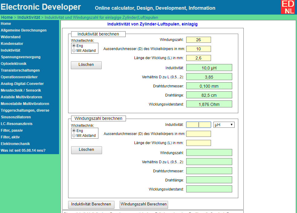

    Adamcyn wrote:
    vodiczka wrote:
    Hm, I can wind coils about 0.01 mH based on the calculator below and give what the tester pointed out. http://ekalk.eu/l.html
    I just read in the description that this calculator is not suitable: This calculator will help you calculate the air coil. The formula used in the calculations gives correct results for the inductance not exceeding several dozen microhenries. If you need a coil with a higher inductance, you should use other methods.
    0.01mH = 10?H. The coil can be wound using this inductance with the inductance ? 0.01mH (10?H), ie the one that the tester should detect as inductance and give the size.
    Why? I undertook to:
    Both 0.01mH and 0.05mH are in the range of several dozen microhrens.
    Adamcyn wrote:
    Below is another calculator and considerable discrepancy for 10 ?H.
    "Spore" is the percentage of the lower value?

    Adamcyn wrote:
    ... L = 10 ?H, D = 10 mm, d = 0.1 mm http://www.pronine.ca/coilcal.htm 106 scrolls http://ekalk.eu/l_en.html 27 scrolls
    This is a 4-fold difference, that is, passing the yen as if not both patterns with reality. It is worth doing both coils and measuring both cases with the tester.

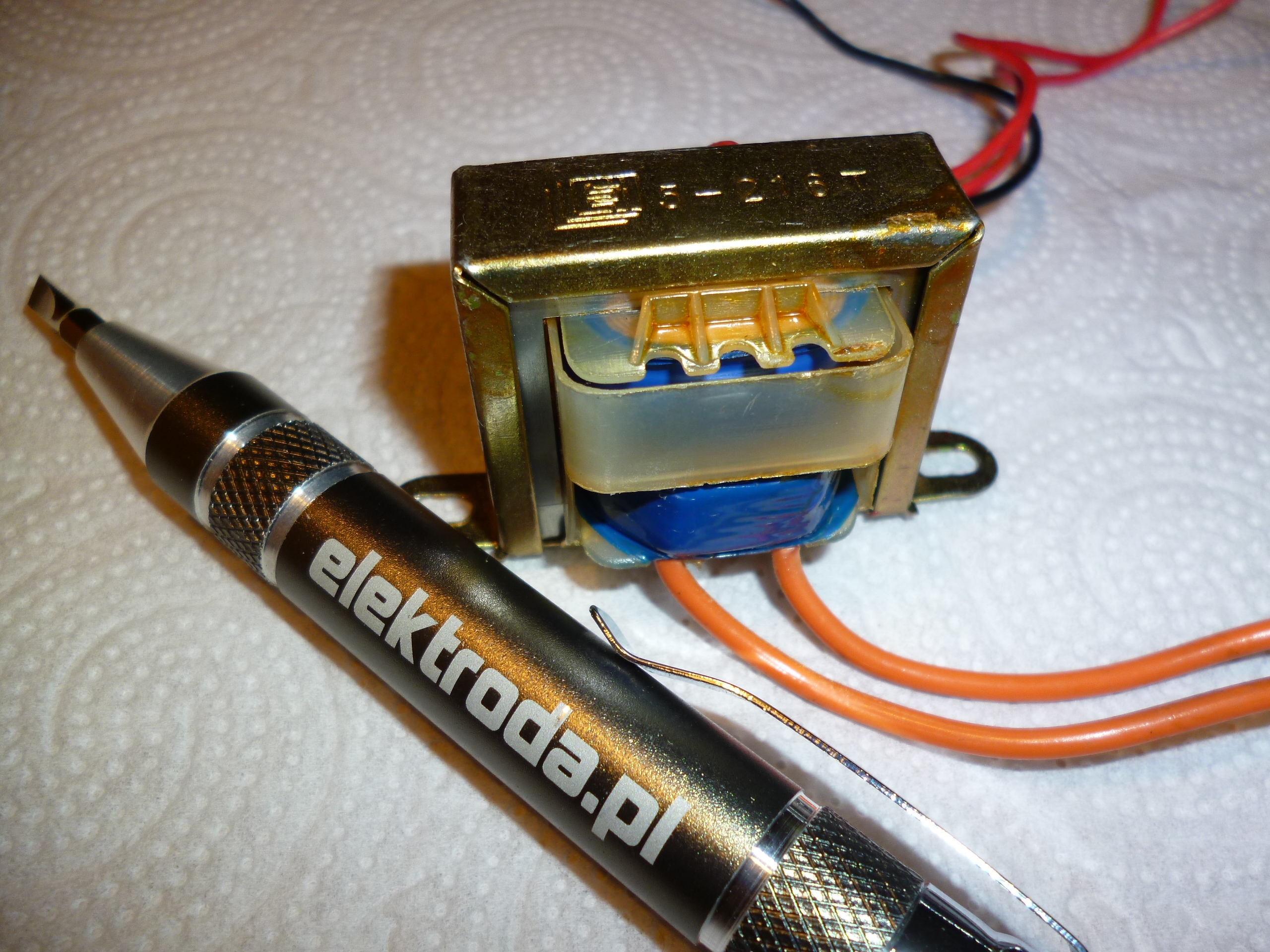

    Adamcyn wrote:
    I have measured such a transformer: ... that is around 32 H. Check. The tester showed different values and had the right - 32 H is a value outside its range of 20 H. He defeated again. :D
    Well, he did not fully defend himself. If it is outside the range, it should "say" and do not indicate what "saliva into language will bring". And without the use of a metaphor, it should display a message that the result is out of range as normal meters or other "simple" devices measuring even weights. It should not be misleading.
