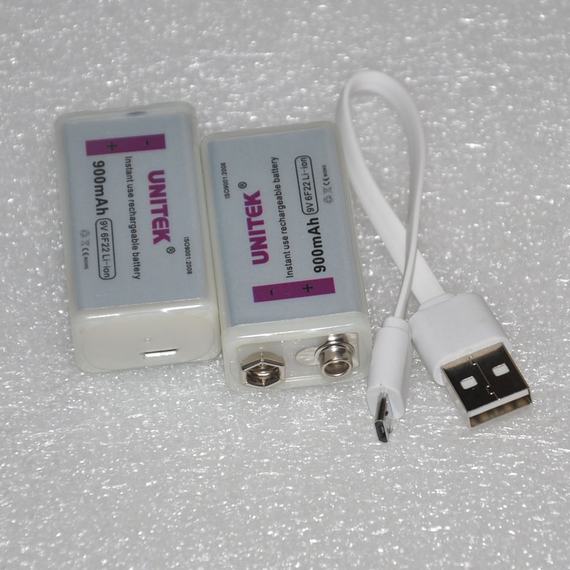

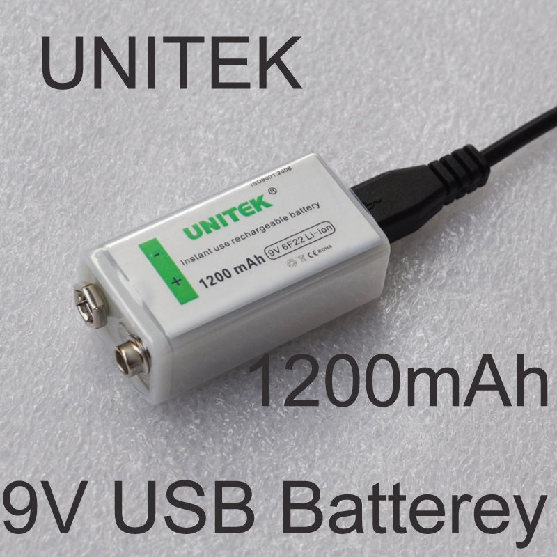

    Hello, I was always pissed off with a small capacity of 6F22 and a relatively large price, I ordered Ali 9V Lion batteries, probably with a converter, declared capacity greater than the battery. Soon there will be batteries with a cartridge, then I will share my impressions. I have to make a similar pull with LR2032 batteries, I have a lot of devices with such a power supply and I always lack a free cell when stores do not work :) . greetings
  • #218 16671353
    vodiczka
    Posts: 30227
    Help: 1185
    Rate: 4301
    PiotrPitucha wrote:
    And I was always pissed off with a small capacity of 6F22 and a relatively large price
    Price at the level of 25-30% of a cheap universal meter also annoys me. :cry: I make measurements on an occasional basis, so a good Alkali 6F22 withstands the meter for over 4 years. I wonder how long it will last in the tester.

    PiotrPitucha wrote:
    And I was always pissed off with a small capacity of 6F22 and a relatively large price, I ordered Ali 9V Lion batteries, probably with a converter, declared capacity greater than the battery. Soon there will be batteries with a cartridge, then I will share my impressions. A similar pull I have to do with LR2032 batteries, I have a lot of devices with such a power supply and I always lack a free cell when stores do not work.
    Please, report after purchase because I am interested in buying.

    Rather not enough. Capacities start at 280. These 600-700 will go away, but I have more concerns.

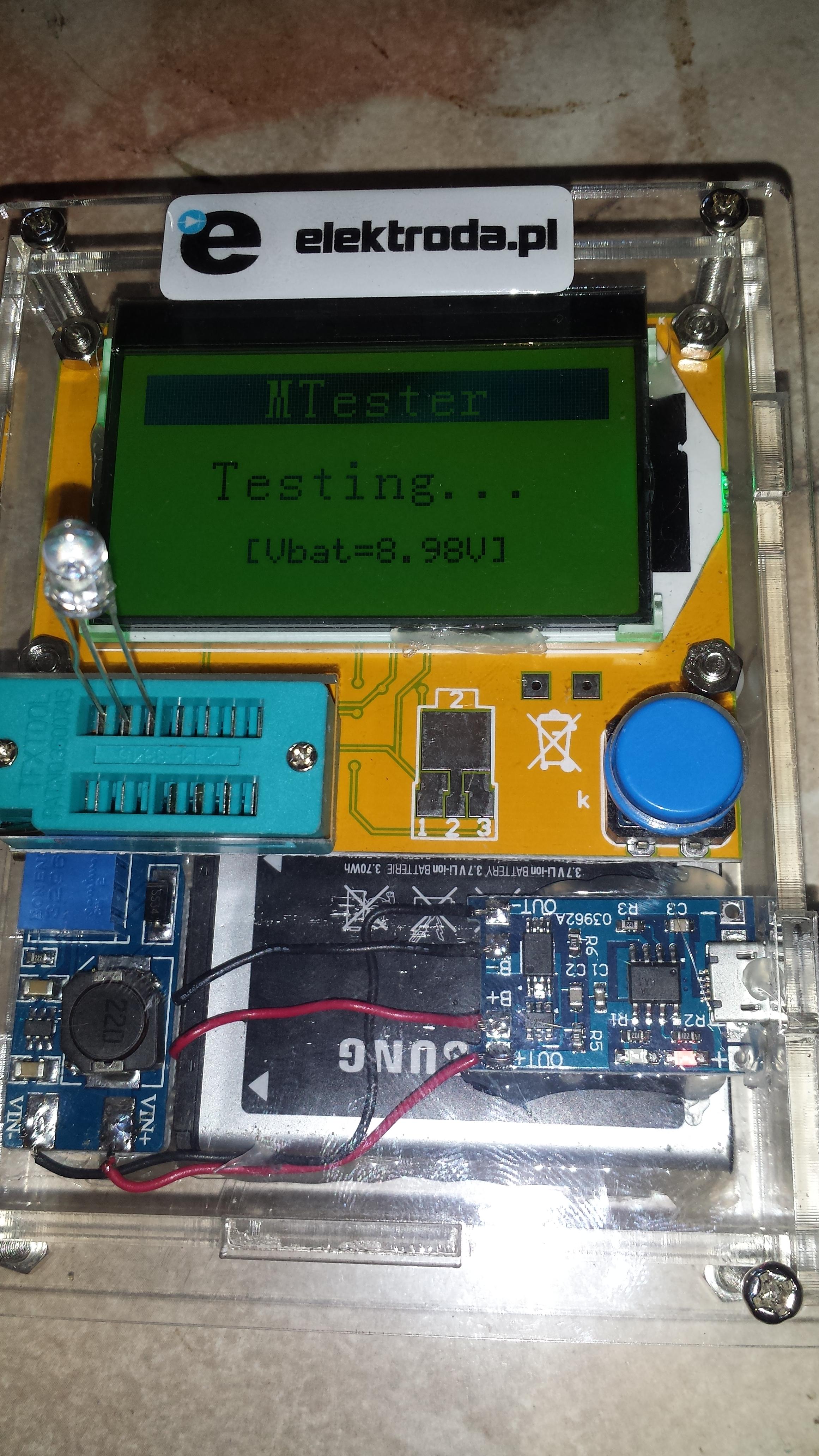

    Or maybe I just put and test such power.
    You can also do it on a cheaper 1 board: stabilizer 7809, 2 capacitors 100nF and DC Jack connector and connect it to the power supply, eg from the router.

    You can also but it is not such a big cost about 3.5 PLN with ali .. plus some battery from an old phone and in such a configuration you do not need a network battery system is portable and the network only charges the battery if necessary.

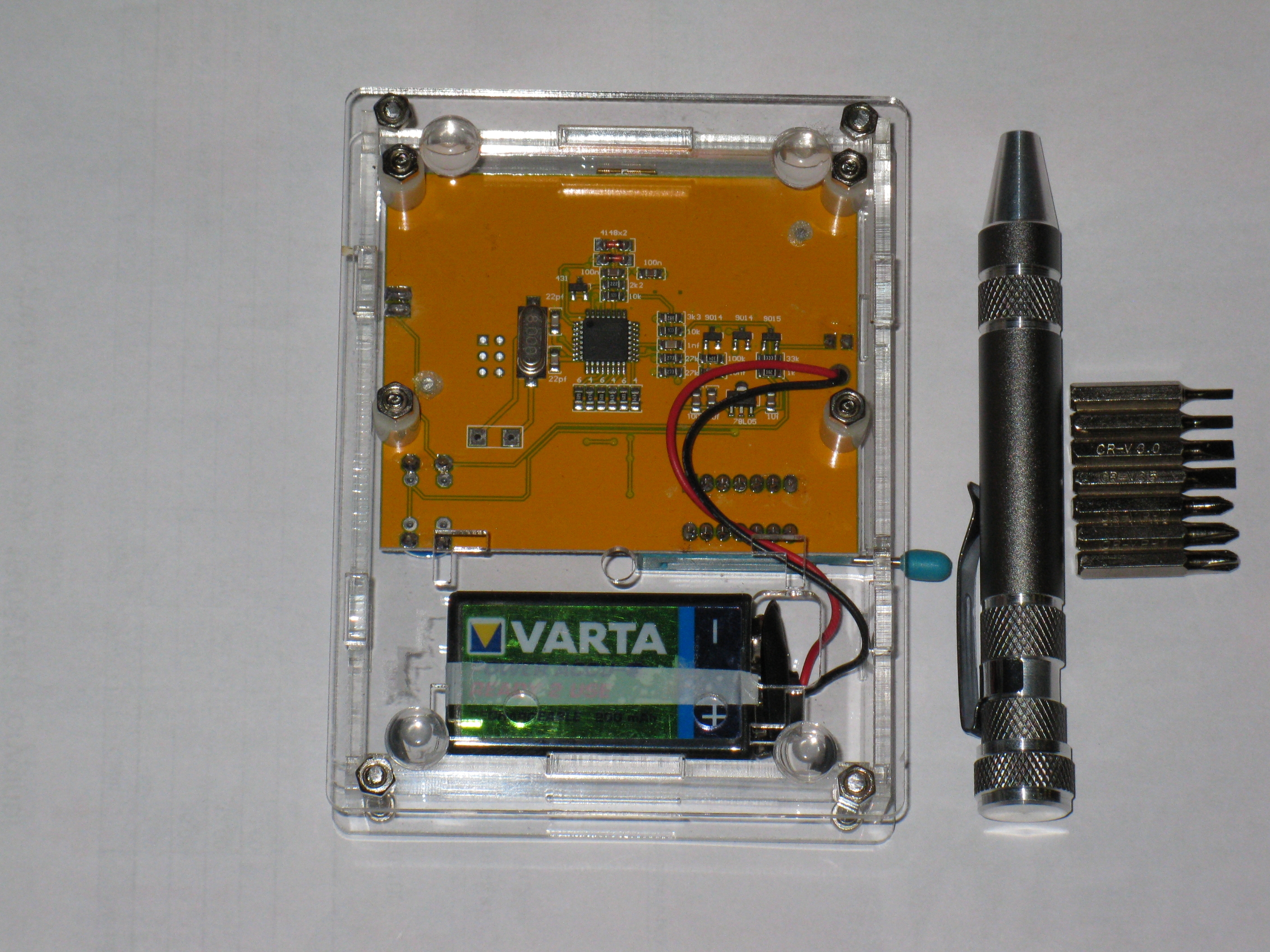

    Hello. I received information from home that the parcel had arrived (tester, sticker and screwdriver). I'll be back from work after testing and let me know what and how. Greetings. elektrodo, thank you.

    The tester reached me yesterday, along with one sticker with the electrode logo, and a screwdriver, although I was counting on a caliper, because the screwdrivers gave me a lot of :-) . Today I made the whole and (which is obvious to me :wink: ) slightly improved the "factory", i.e.: first of all, the display was immobilized with double-sided adhesive tape, I shortened the housing screws (ATTENTION! - do not tighten them too much, because the front and rear panels bend!), immobilized aku so that it does not fly inside, to the rear I stuck my feet on the panel. LCR-T4 electronics components tester ATMega328 - Test and Review LCR-T4 electronics components tester ATMega328 - Test and Review Thank you! :spoko: Greetings.

    DjMapet wrote:
    I have slightly improved the "factory", i.e. I have shortened the housing bolts
    I put on (screwed) rubber feet on these protruding screws. Currently, I have a 9V power supply connected to further tests but then, afterwards. Greetings. PS Grandfather, this is "GADGET" but "trusty" grandson told me so. End of summer. I think I will stop the tester at home to not part with :cry: .
  • #234 16674662
    I did so at first, but I only have legs with a diameter of about 24mm, so they stick out a bit and are otherwise quite high (about 15mm), which seemed to me a little aesthetic. :-) I have a lot of them, so I used them and it looks better to me. Temporarily, I power the device, visible on the photos aku 200mAh and who knows if it will not be this way? I have a little bit of them and despite their age (it's about 7 years old), they stay well. After about 30 minutes of testing, the voltage from 8.9V, dropped to 8.75V, so it's not bad.
