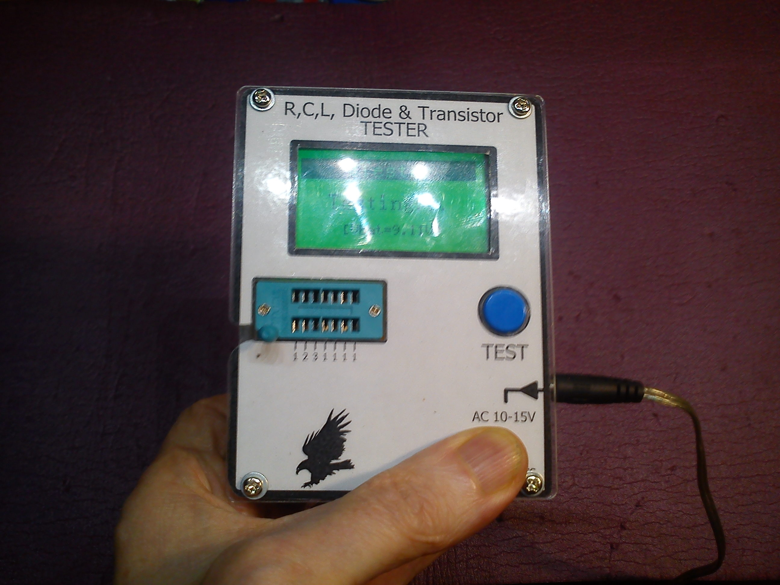

    Gentlemen, I bought a housing and I do not know if it is scrapped, or whether it should be. Are there any "corner cutouts" under the battery, and there are no "walls" and no battery in bulk?

    Are these cutouts made for cholera? I think it's better to get inside. It begs you to somehow stabilize this battery, because it will scratch everything from the inside.

    I did not use any 9V battery only I put the box on two-sided tape with a 6V / 1.3Ah gel battery (recycled, new is not worth investing) which gives the supply voltage 6-6,8V which is enough for this tester, because it works properly even with a power supply below 6V. I obtained additional stability of the whole which in the performance only with the box at a slight deduction drops what is healthy is not. If it discharges below 6V which will occur earlier due to the storage time than due to the use of the tester (current consumed by the tester during the test is none for this battery), then connect under the 7V power supply for a few hours and again peace for many months.

    The price of the cast mold in China depends only on the weight of the final element and not its shape. These few grams are a lighter element, although a more complicated form makes the form to it cheaper and there is still material saving on each piece. All the secret.

    Only that it is laser cut :) . Consequently, additional holes = additional costs.

    It is very possible that this housing has and other uses. For some other tester model, for example. It does not bother me - the power supply from the external power supply inside only the 9V stabilizer. LCR-T4 electronics components tester ATMega328 - Test and Review LCR-T4 electronics components tester ATMega328 - Test and Review LCR-T4 electronics components tester ATMega328 - Test and Review

    These holes are under the so-called tricks, or bands to attach the battery ;) pozdr

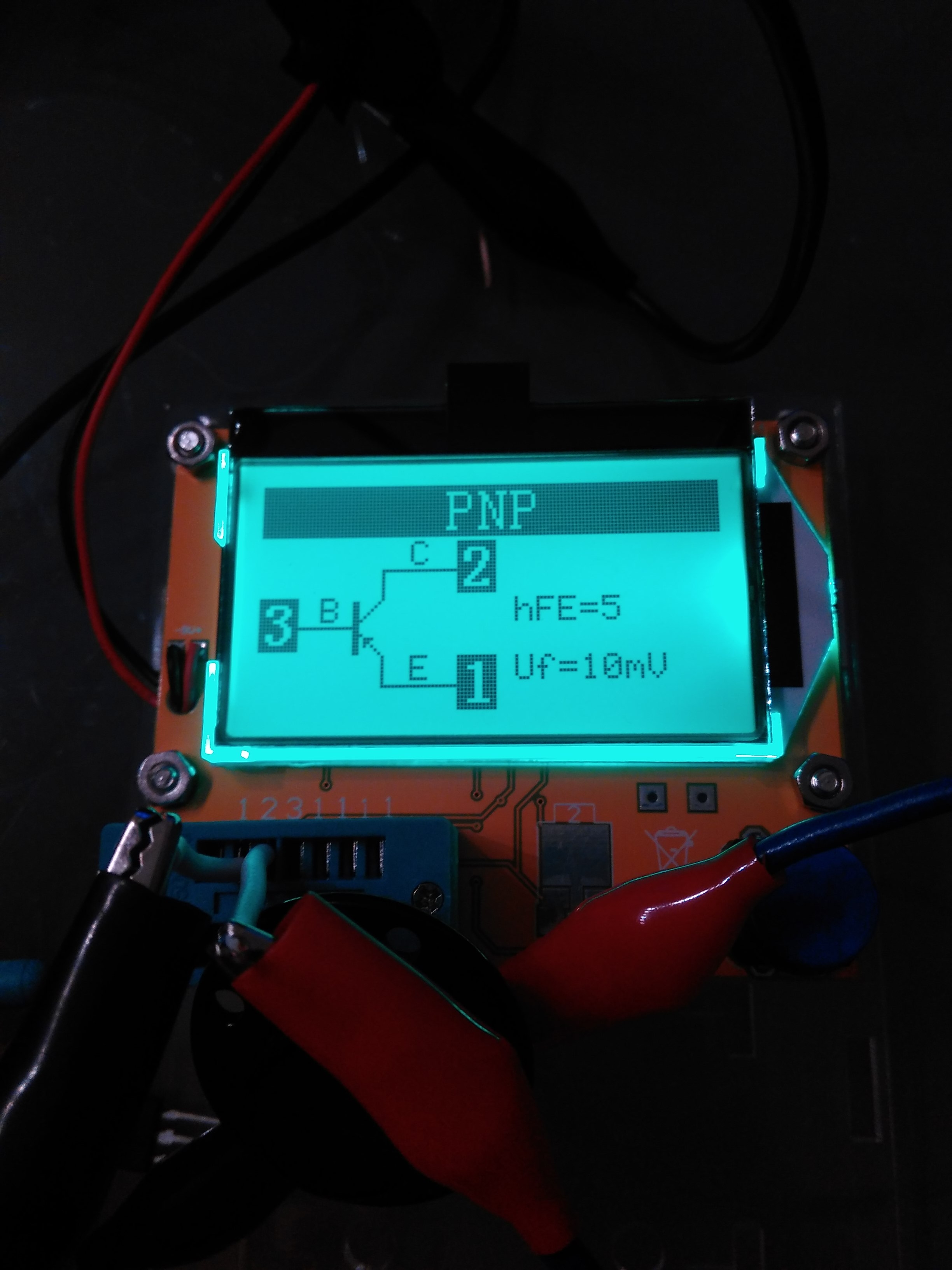

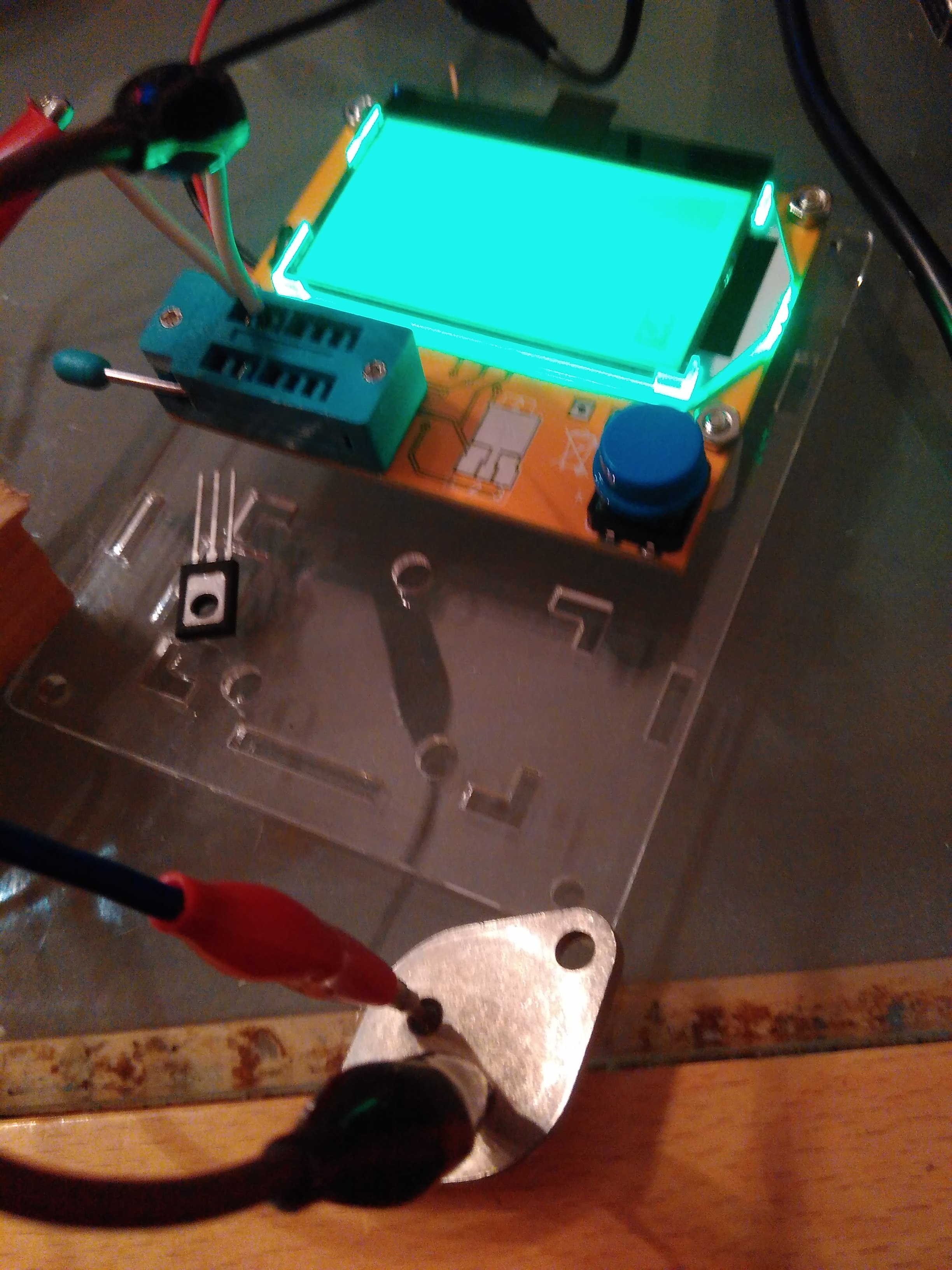

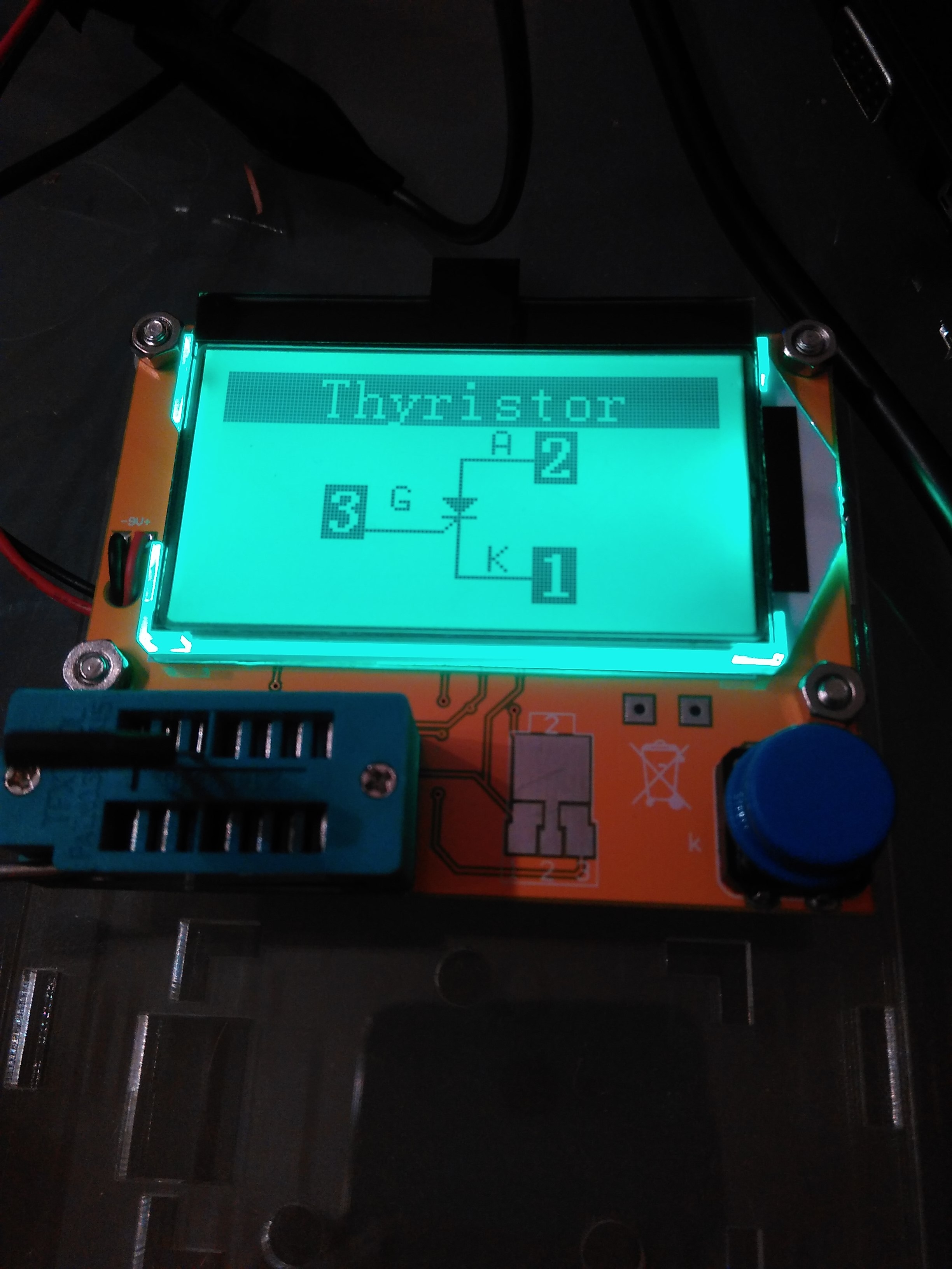

    C106 thyristor LCR-T4 electronics components tester ATMega328 - Test and Review TESLA KD502 LCR-T4 electronics components tester ATMega328 - Test and Review Base-Emiter connector LCR-T4 electronics components tester ATMega328 - Test and Review LCR-T4 electronics components tester ATMega328 - Test and Review And now the rarity or ?4?? P4BE. German power PNP transistor produced by the Soviet Union. It is a new transistor from 1965. LCR-T4 electronics components tester ATMega328 - Test and Review LCR-T4 electronics components tester ATMega328 - Test and Review

    Adamcyn wrote:
    It's just that they have definitely higher Hfe.
    These "hats" were characterized by a very low Hfe.

    New in that it is unused. Zero currents are also probably quite big. I did not measure exactly but I remember that they were probably bigger than 1mA. I would have to measure. For this reason, the tester probably reports a low conduction voltage. I was powering my tester's board straight from my power supply to the multimeters. The board reports a voltage of 11.6V. The ribbon from the display actually looks delicate. I secured it with a piece of insulating tape. Along with the tester I got a screwdriver and the elektroda.pl sticker. It is a pity that the screwdriver does not have a smaller cross. The tips are smaller which would allow for a precise job. The fitting of the casing is also a bit average because it happens that the button does not reflect. I'm going to cut that buttonhole a bit and it'll be fine. I solder DC jack, I will make an alligator to connect large components and I will try to "produce" an SMD adapter. I have a piece of laminate somewhere, I do not have the chemistry to digest but I can still cut three separate pieces that will serve as contact areas.
  • #355 16733659

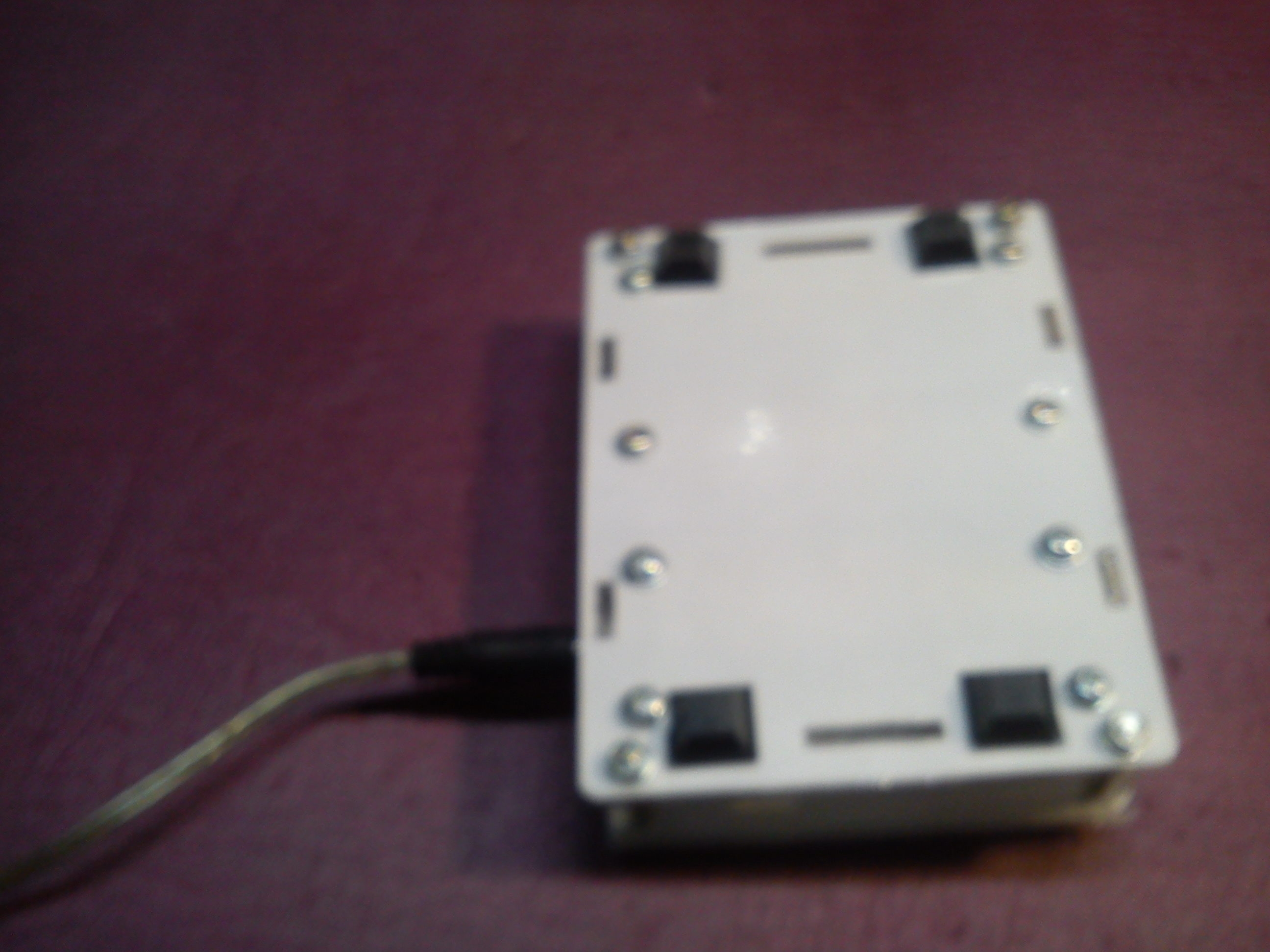

    I invested a little penny in basket and now it looks much better. I have a 3min walk from work there ... Because if I was to order a basket myself, I would rather let it go. :) The question is, are your sleeves too long and just press on the housing to run the tester? I have filed them by 0.5mm and are still a little too long, but this does not bother me anymore so that I would like to start all this again and saw for another 0.2mm. There is still the question of a mysterious square hole, on the long side opposite to ZIF's lever. Maybe, quite by accident, a connector for an external power supply fits there, with the option of disconnecting battery power after connecting it?
    Hello. You "combine" well. On the second day after receiving the tester, I inserted such a joint into this hole. Greetings.

    I mean, this hole has factory destiny. I do not want to paste anything. If I'm right, I want to insert a dedicated connector.

    Probably anyway, but in this case, it would be better to ask such a question to the producer "factory".
