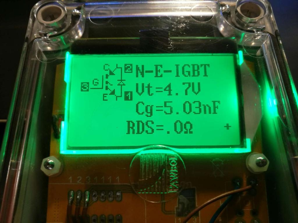

    My tester has been damaged after more than 2 years of use. The screen with information about testing the element takes much longer than usually even several seconds and then there is information about the detection of the cell - a function that nobody has discovered here ;) Each time the same, regardless of the inserted element. Actually on pins 1 and 2 all the time there is such a voltage. LCR-T4 electronics components tester ATMega328 - Test and Review LCR-T4 electronics components tester ATMega328 - Test and Review As I used it almost every day, I immediately felt the lack of it and now I have to buy something else quickly. I saw that newer versions scroll with the Zener measurement and color lcd in the thread? Could someone recommend something tested? The best option is to buy alllegro. Thank you. Possibly someone may have bought it with the possibility of reselling it very willingly.
    From the series "Pole is able" ... yesterday, when I bought other Atmega 328P for other purchases. Before the exchange I unsuccessfully tried to rip the software. After replacing the prock it turned out that the soft one does not fit in one of the themes - the effect was a blank screen. I read and it turned out that I have some older version with quartz 8Mhz. The forum came with help: https://www.eevblog.com/forum/testgear/lcr-t4-mtester-v2-07-lcr-meter-black-block-issue/, where friends shared a soft match for my tester. I tried to upload softy from https://yadi.sk/d/yW8xa5NJgUo5z, but the Cyrillic alphabet itself ... Changing prock banal -1 min. LCR-T4 electronics components tester ATMega328 - Test and Review LCR-T4 electronics components tester ATMega328 - Test and Review And so after uploading the new software: LCR-T4 electronics components tester ATMega328 - Test and Review LCR-T4 electronics components tester ATMega328 - Test and Review LCR-T4 electronics components tester ATMega328 - Test and Review LCR-T4 electronics components tester ATMega328 - Test and Review LCR-T4 electronics components tester ATMega328 - Test and Review And even IGBT detects ... that the previous version did not have. I'm still reading about the impulser mounting, it can also work, because navigating the menu with this one button is a bit weak.
