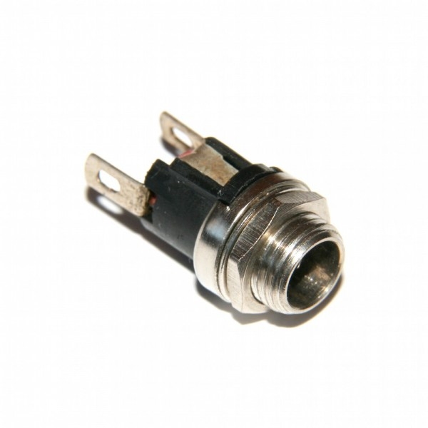

    In that case, I suggest such a socket. LCR-T4 electronics components tester ATMega328 - Test and Review
    Great, but there are two problems with this socket. 1. How to mount such a socket in a rectangular hole ?. 2. It does not meet the requirements of col. CMS . "connector for an external power supply, with the option of disconnecting battery power after connecting?". PS To avoid pasting, you can use the Col. Removed advice.
    • LCR-T4 electronics components tester ATMega328 - Test and Review Usunięty.jpg (1.45 MB) You must be logged in to download this attachment.

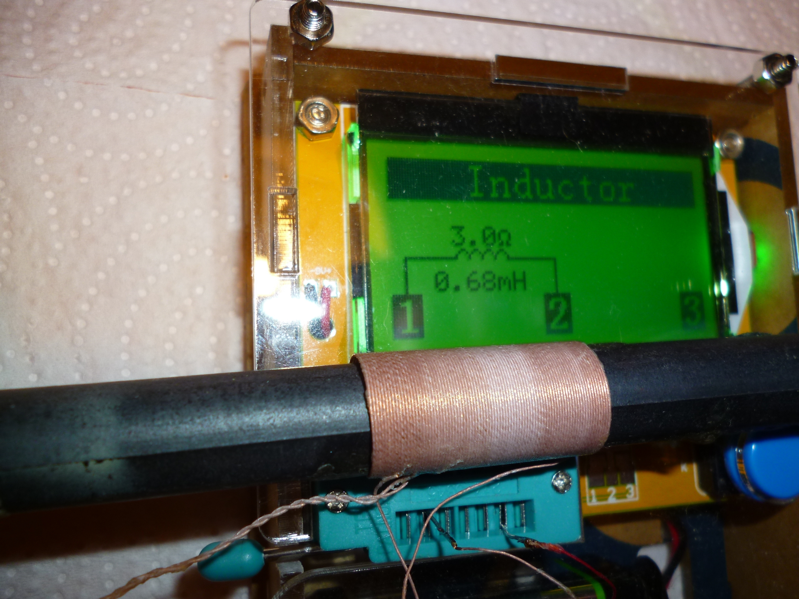

    Hello, I also ordered this tester, I already have it. It seems to be all right, although what I care most about is detected as ... an ordinary resistor :( it's about inductance. No matter what type, whether axial chokes, or coils wound by me or a clutch, everything is as a resistor. Once it only detected as a coil. What is wrong?

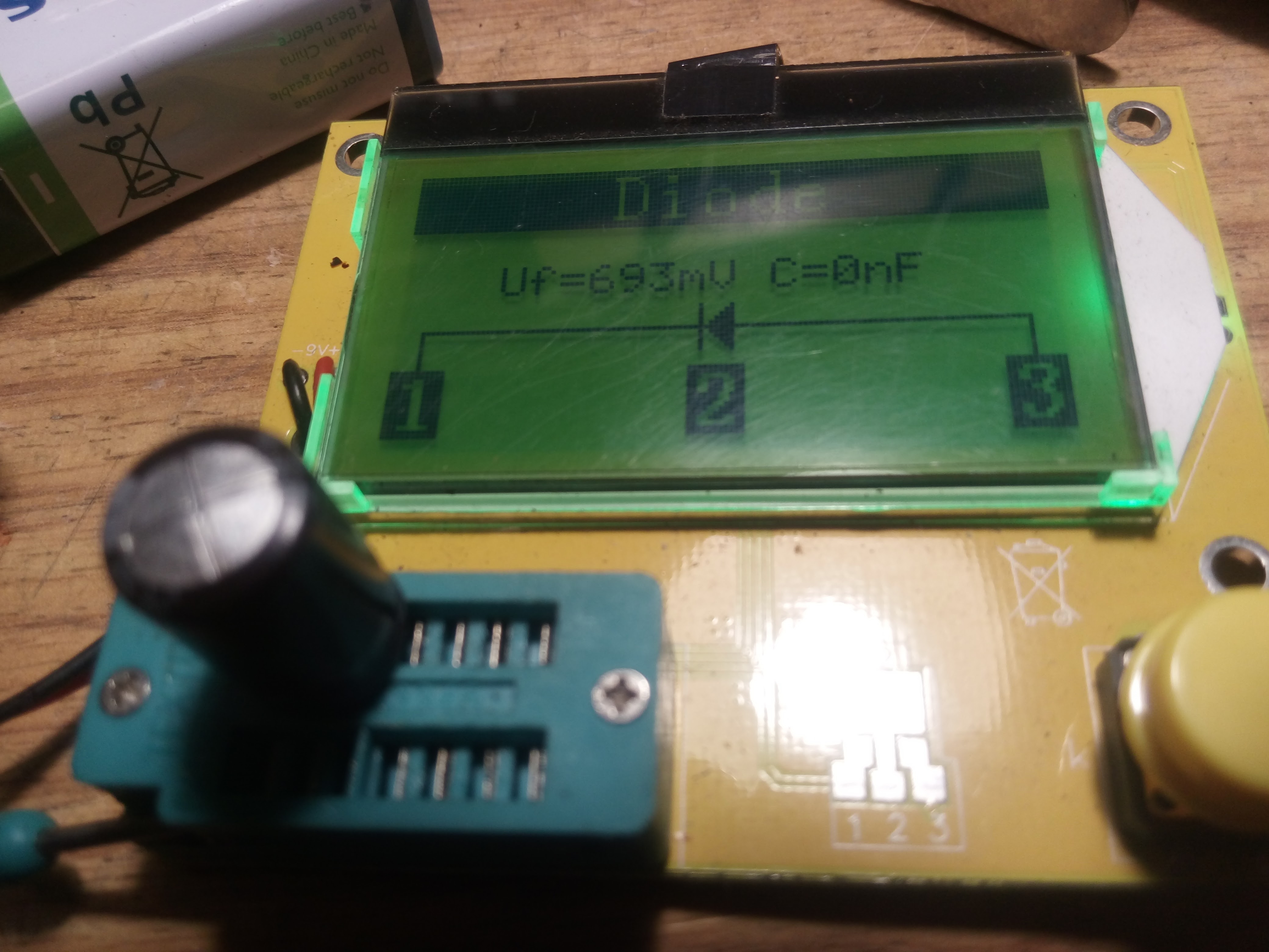

    I use T4 to measure inductance and smiglessly. Sometimes it sees transistors (npn / pnp) as 2 diodes but it's enough to change the system into other measuring holes and it's ok. Maybe try something like that.
    Surely the coil you want to measure has a different value, like:
    Adamcyn wrote:
    Probably out of range - inductance 0.01mH-20H.
    . 0.01mH = 10?H and the value lower than this will not be measured, this also applies to values higher than those that are provided for this tester. Greetings.

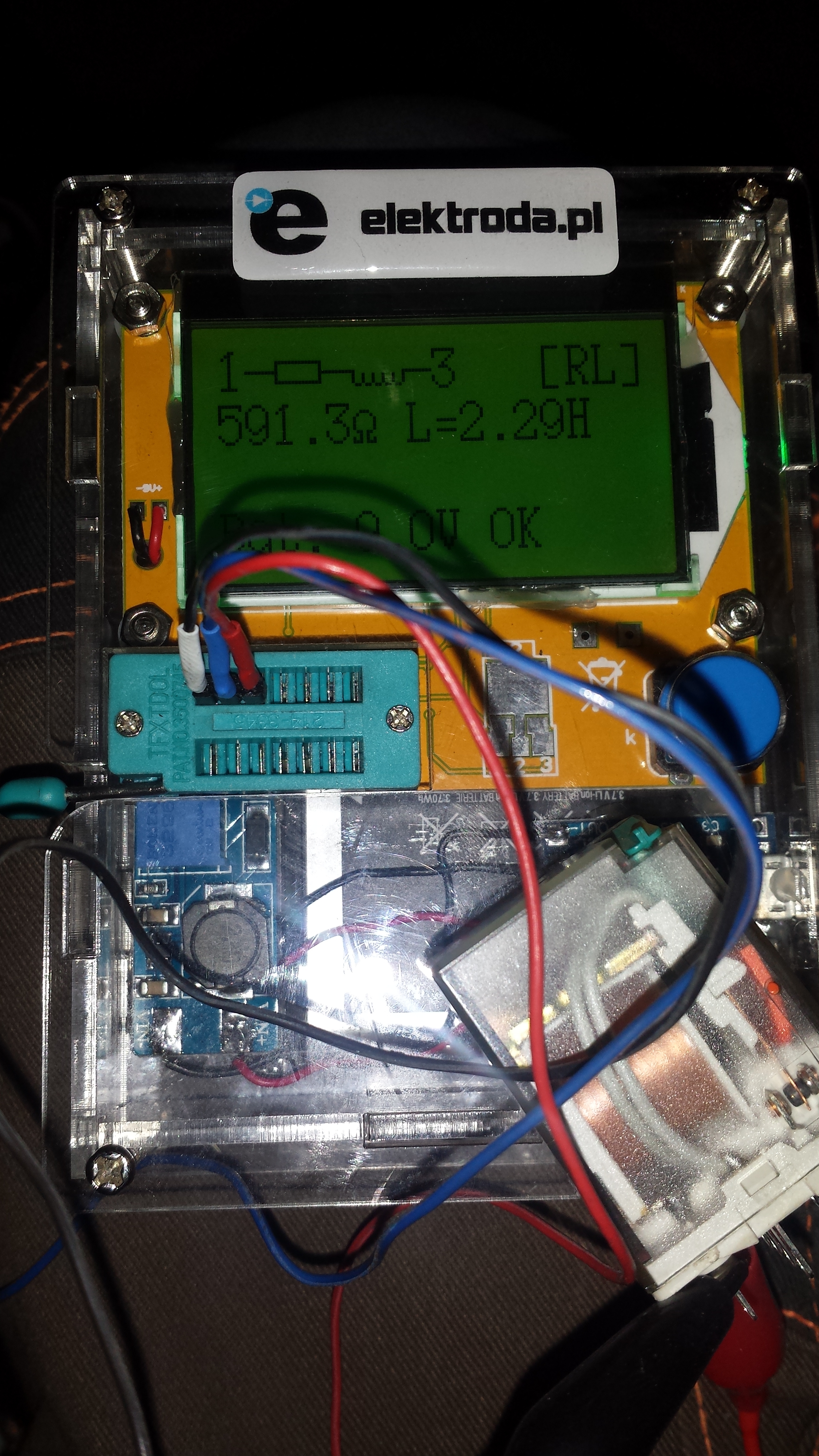

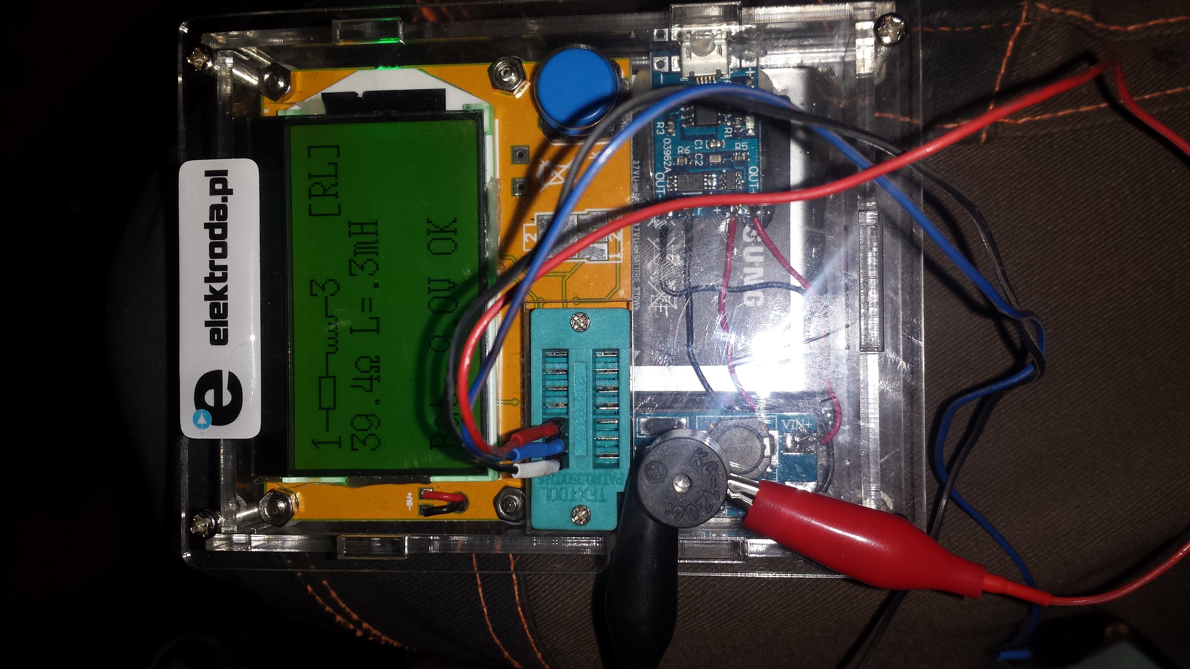

  • #375 16738275
    rafcio_21
    Posts: 1110
    Help: 137
    Rate: 293
    Measuring the relay coil and measuring the buzzer LCR-T4 electronics components tester ATMega328 - Test and Review LCR-T4 electronics components tester ATMega328 - Test and Review
  • #376 16738333
    It is a pity that you do not have a second tester under the hand with the original soft for comparison. Because maybe soft is the culprit. It would be useful for such a test in this section. Did someone pull the original soft from the processor so that you could come back as if what? I have poor detection of small inductances. Tested a colleague how is it with elements from outside the declared ranges on this changed software?

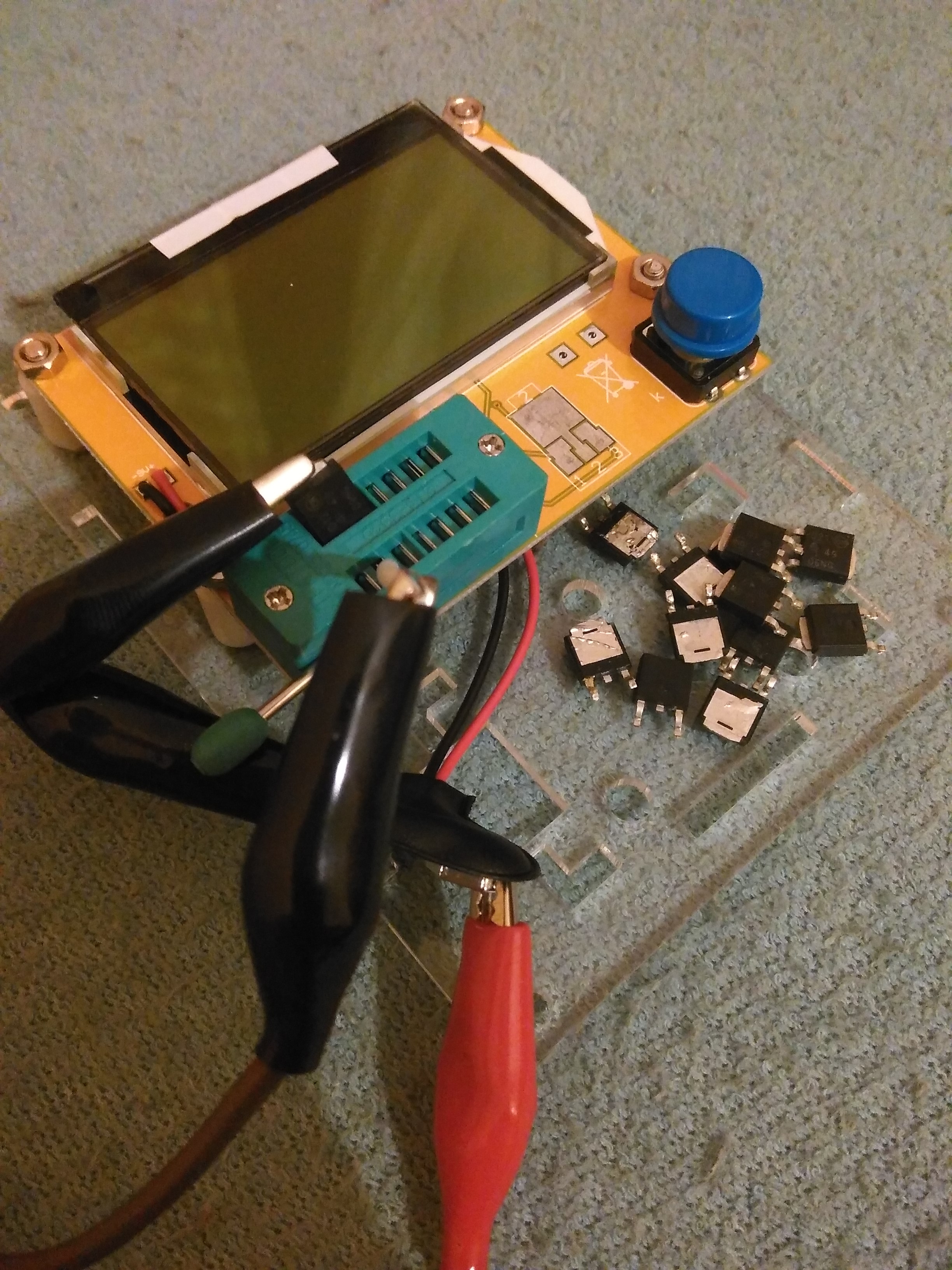

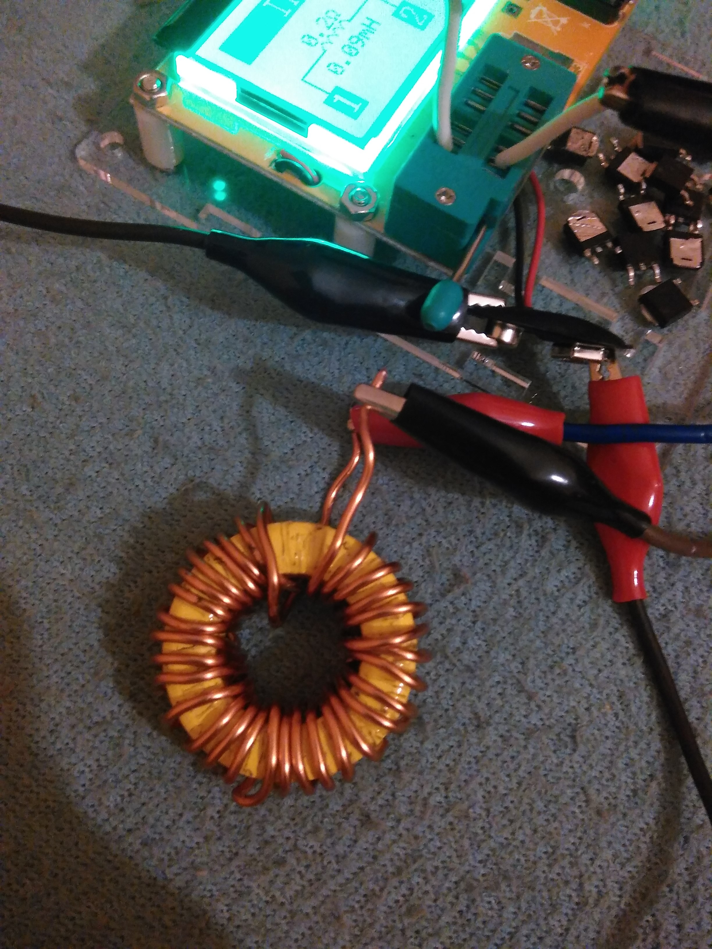

    Adamcyn wrote:
    At last I understood what is moving the coil along the ferrite rod. :)
    Probably a change in the inductance value and the second result on resistance, or the wave resistance of this circuit.
  • #379 16738422
    rafcio_21
    Posts: 1110
    Help: 137
    Rate: 293
    E8600 wrote:
    In some time I will have a friend tester with original soft (in order to modify it), I can compare some results but I've already tested my before and after uploading and I would definitely not return to the original. Now the possibilities are much bigger, I am waiting for the inverters from China and I will still be able to measure zener diodes and LMxxx stabilizers.

    Adamcyn wrote:
    If you mean the nH government, there is nothing at a reasonable price.
    You can do it on your own, the cost is the price: display + microprocessor, I made my own on PIC16F628 + 16x2 LCD. Greetings.
