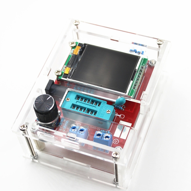

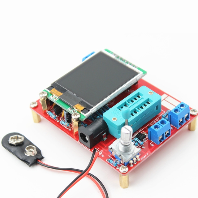

    I happened by chance for a much nicer tester - GM328 . LCR-T4 electronics components tester ATMega328 - Test and Review LCR-T4 electronics components tester ATMega328 - Test and Review A version without a case for today available for $ 10.33, and with a housing for $ 14.71. Remember that it is a kit for its own assembly. It has several interesting functions, such as rectangle generator, PWM generator, fast capacitance measurement and ESR and others. LCR-T4 electronics components tester ATMega328 - Test and Review

    The Chinese put the case poorly in the picture ... :)

    I was wondering if anyone would pay attention to it. Well done, buddy.

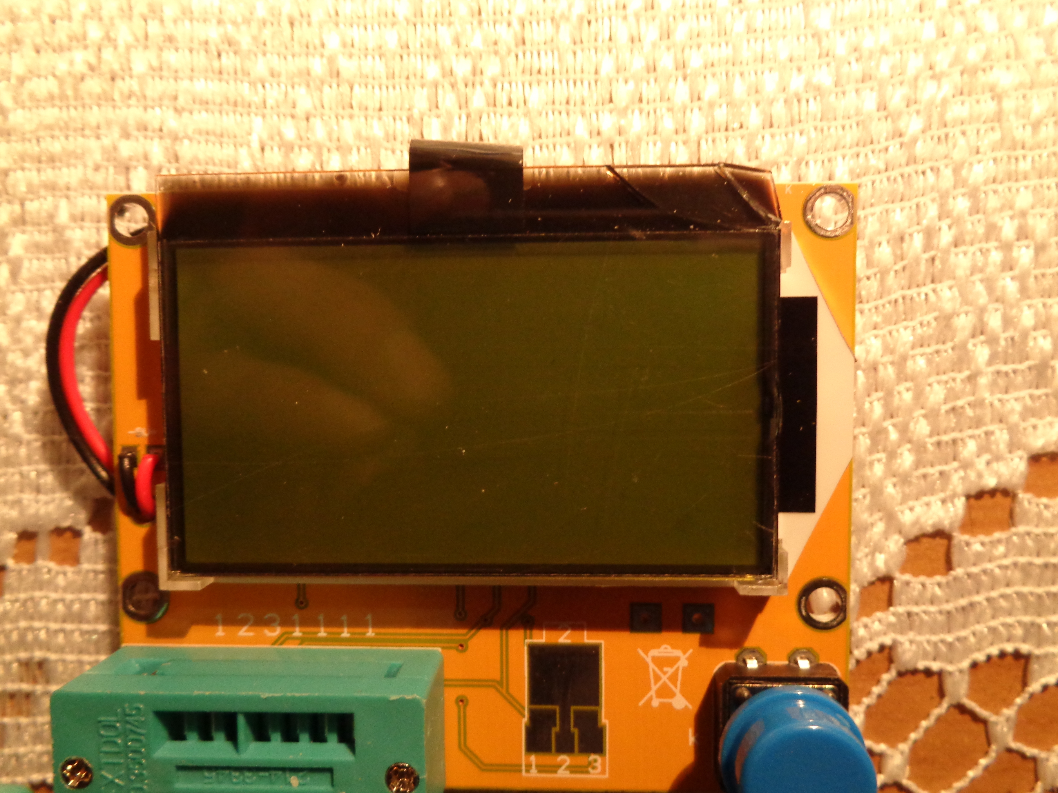

    I received the Electrode Tester today, but the joy only lasted until the unpacking, the display of the parcel or the packaging did not survive. LCR-T4 electronics components tester ATMega328 - Test and Review

    For me in the box only tester, housing and pen, no protection, foam or anything. As at the post office they started to flip it out, it's unbelievable that it burst. PW I just sent to Gulson. Added after 14 [minutes]:
    Christophorus wrote:
    It presses on the corner of the display causing it to crumble.
    On this film, in the place of the crack, you can see marks of dents from this display. Probably filling with foam in a box would give a positive effect.

    Gentlemen, maybe it's the fault of the person who "unwraps" the package. I waited for about two weeks for the postman and suddenly "din_dong", your postman with the package. Before I signed the receipt, my legs were itching to open the packet as soon as possible. Kicha, I can not do it. Because this "nasty" sender has secured the package so that it will not be damaged. A moment of patience, it has succeeded, there is a broken tester and something :?: (screwdriver) :!: :D

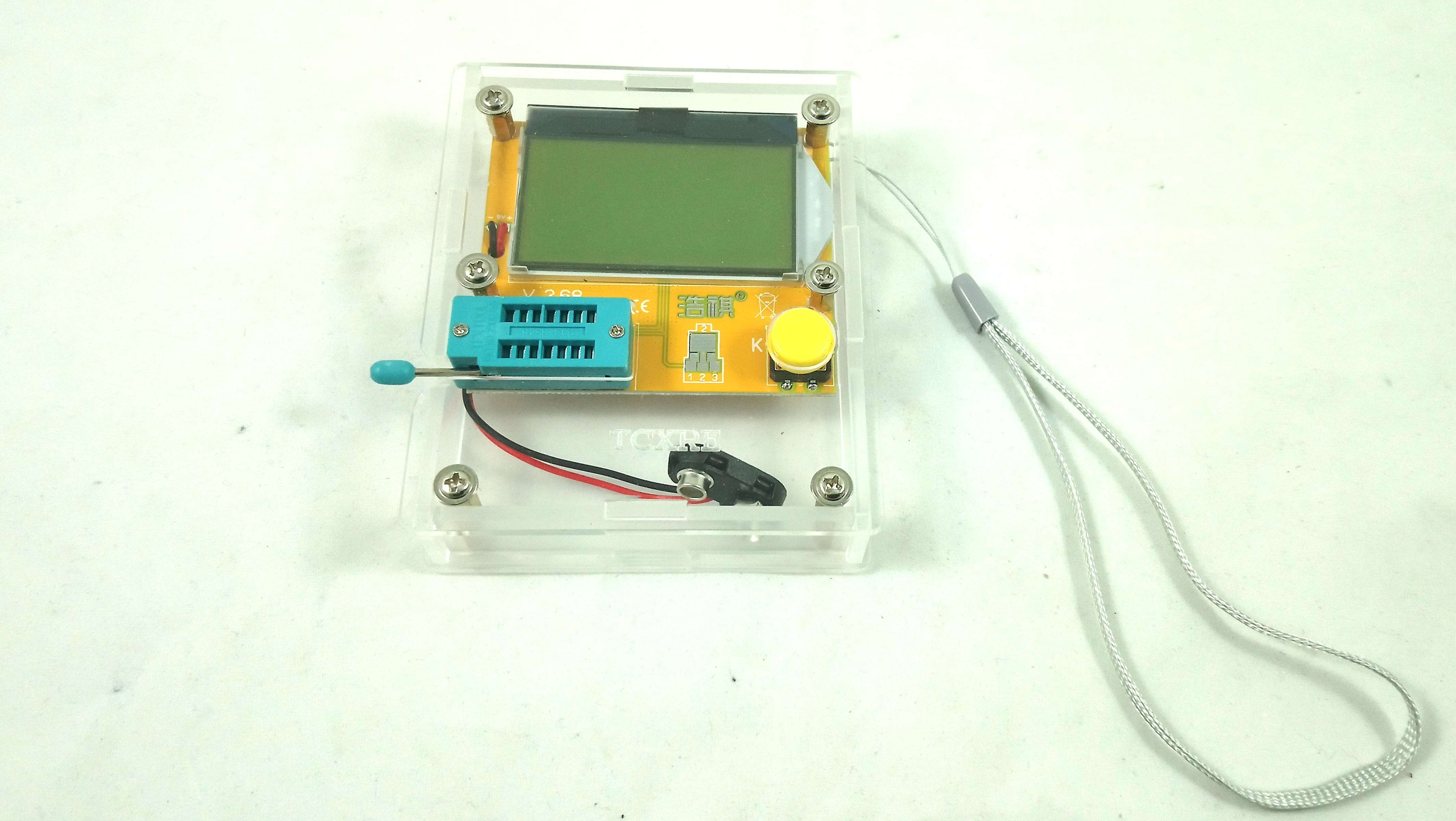

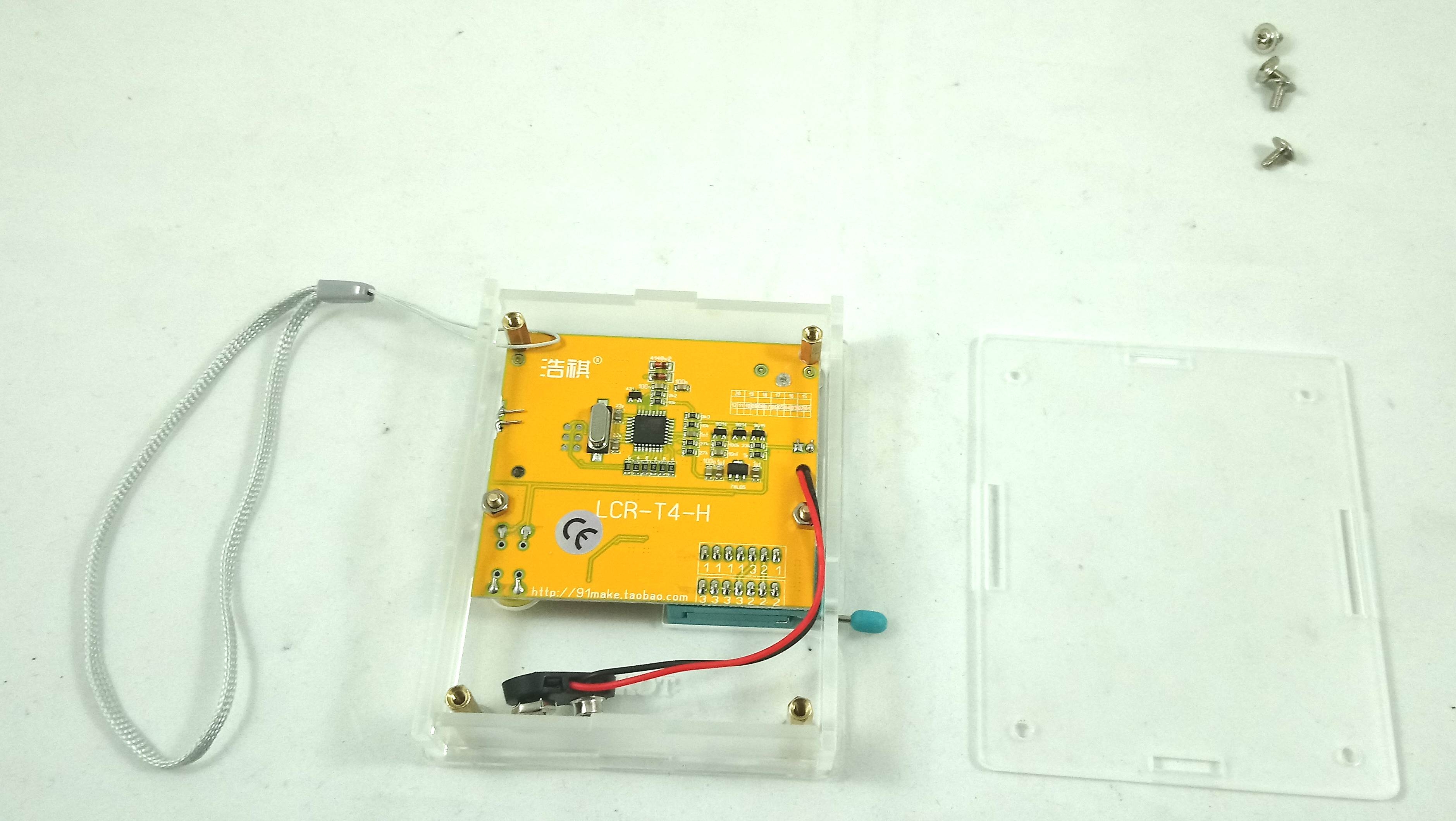

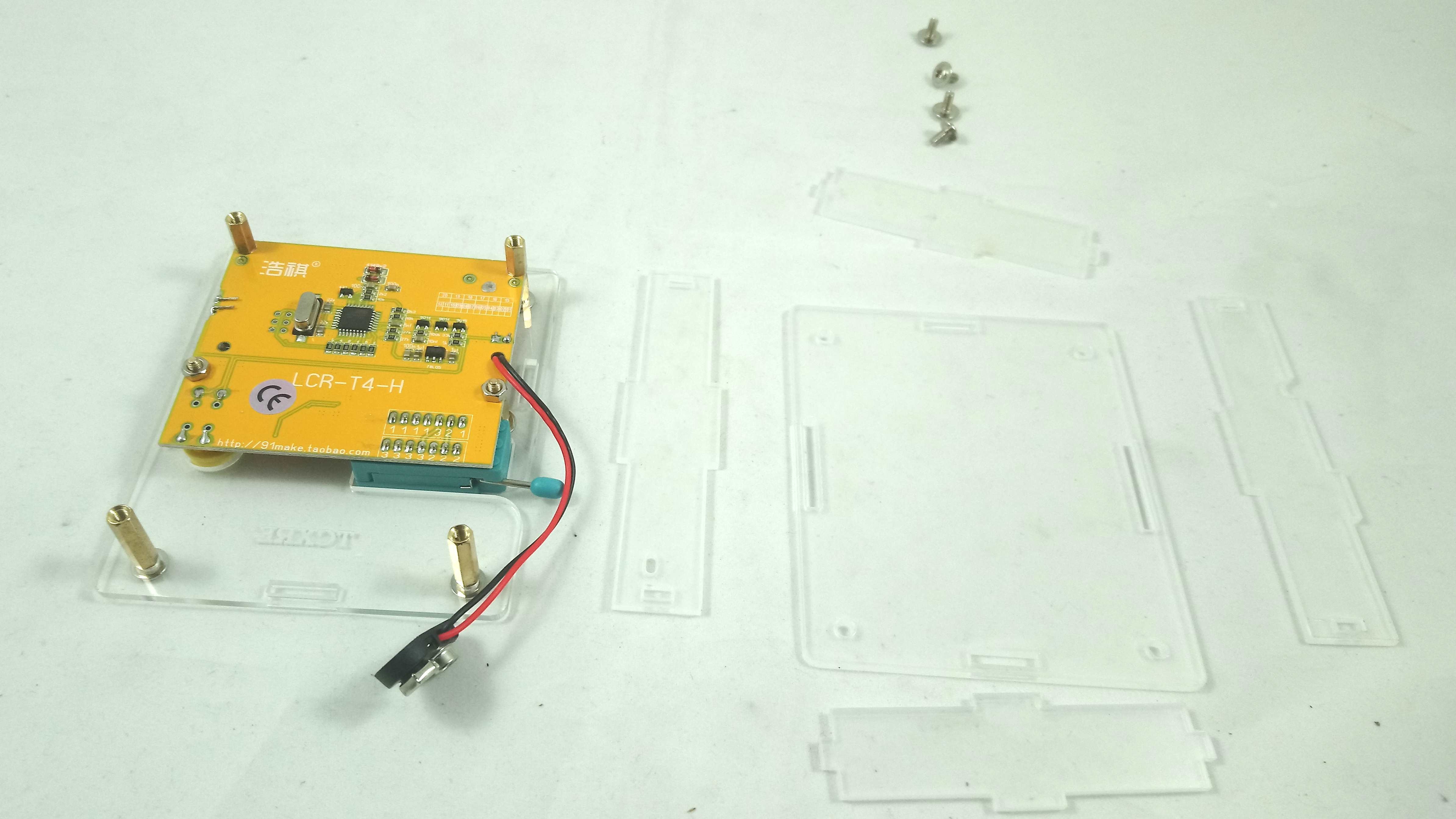

    In the New Year's shop there will be new testers with updated software and a different casing. The display is protected and glued this time. New housing, a new way of folding: LCR-T4 electronics components tester ATMega328 - Test and Review Remove the protective film (it is transparent): LCR-T4 electronics components tester ATMega328 - Test and Review Do not tighten: LCR-T4 electronics components tester ATMega328 - Test and Review Position so that the button does not rub and tighten: LCR-T4 electronics components tester ATMega328 - Test and Review And now ATTENTION! The housing is profiled (with the display higher): LCR-T4 electronics components tester ATMega328 - Test and Review LCR-T4 electronics components tester ATMega328 - Test and Review LCR-T4 electronics components tester ATMega328 - Test and Review LCR-T4 electronics components tester ATMega328 - Test and Review

    What new features are available in the newer version of the firmware? Does the new housing have a notch around the contact fields for SMD?

    She can not be seen :(

    Even if there was a hole, I can not imagine placing an SMD element in these fields ... It is about a centimeter below the plane of the upper housing ...

    The layout of paths on the PCB and the yellow button suggest that it is a "strip grid" version and the soft version from the previous version will not be compatible and vice versa. The difference is that the LCD is connected to other CPU ports. The issue of changing one entry in the "makefile" file before compilation.

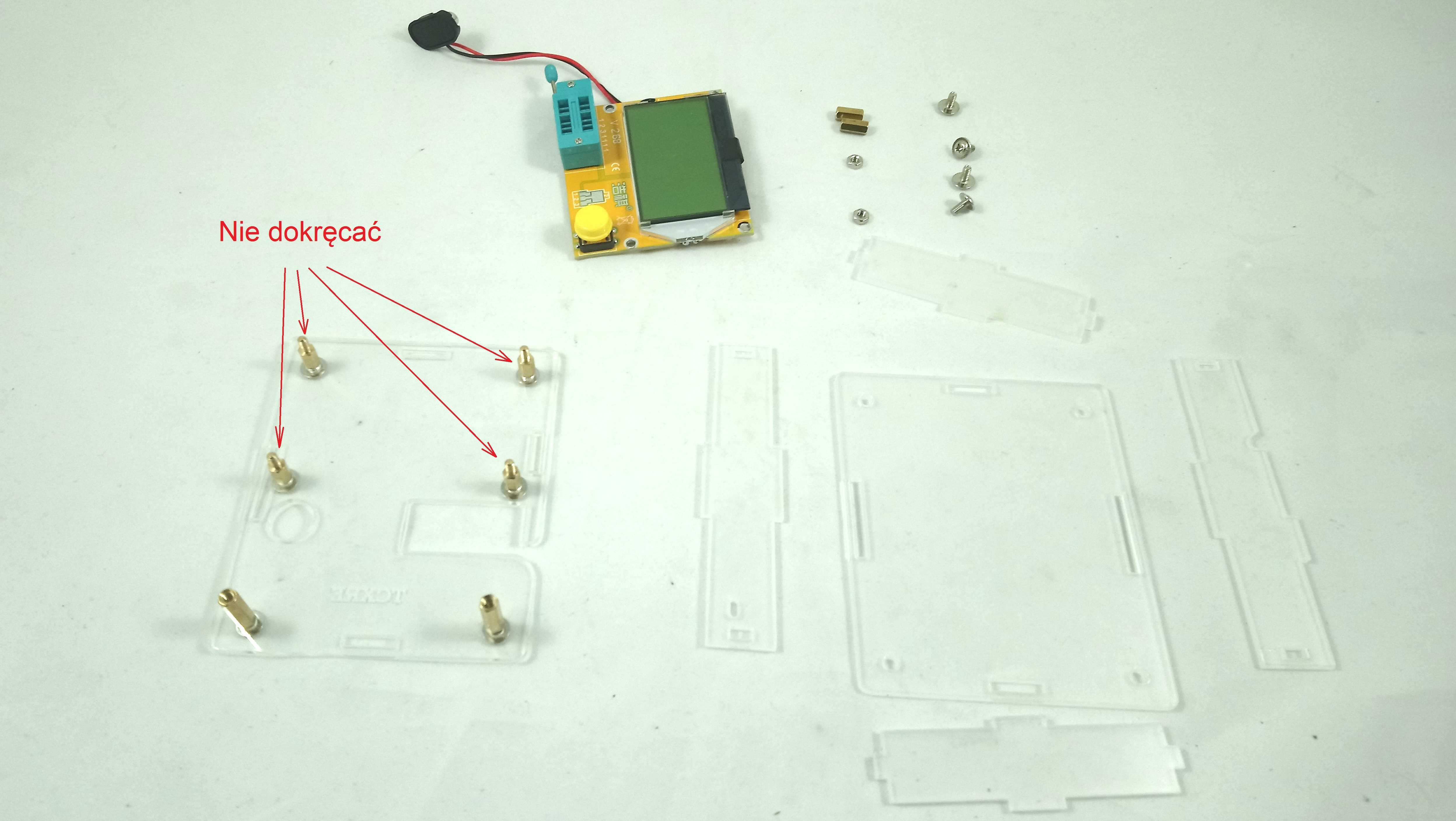

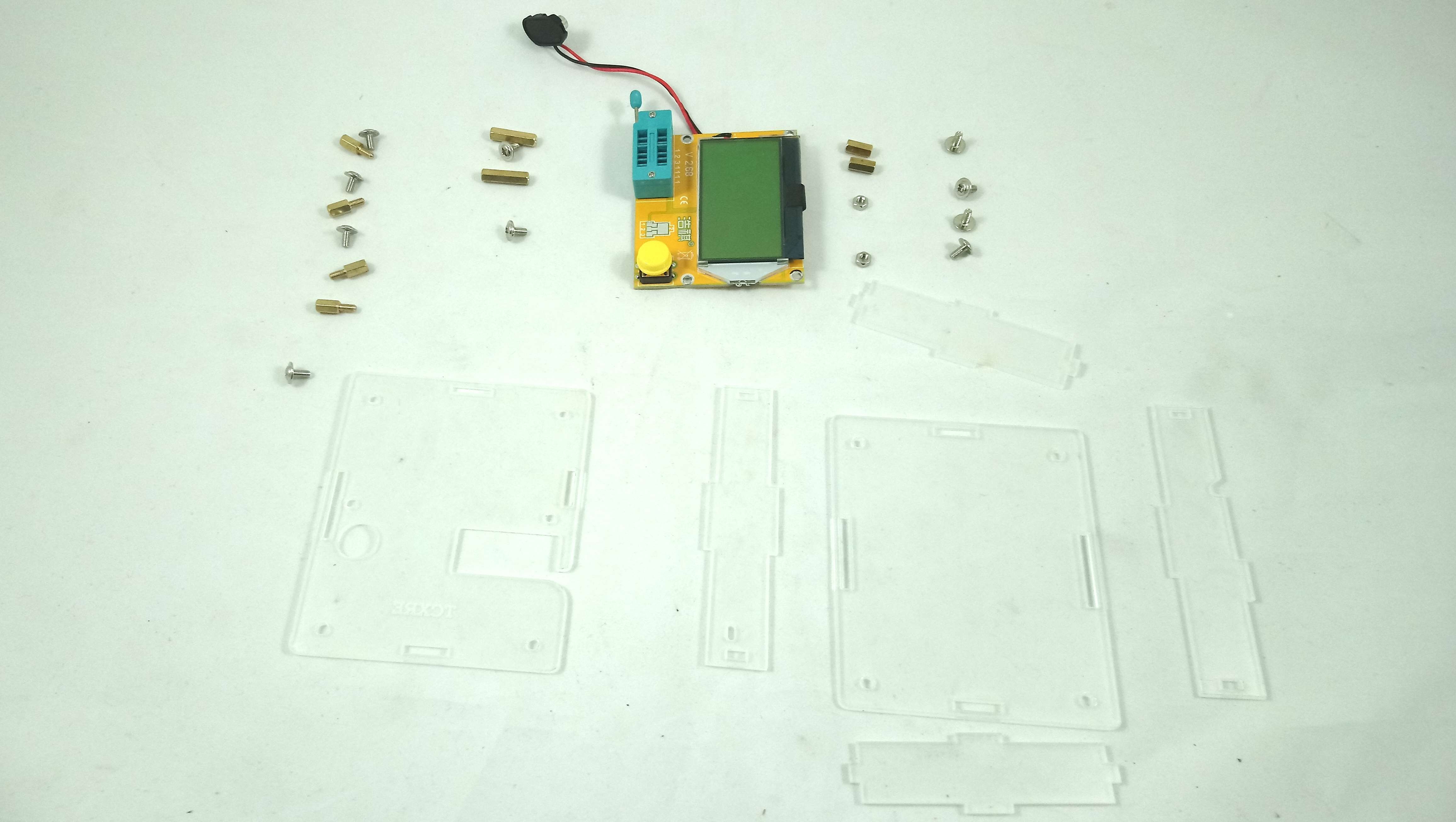

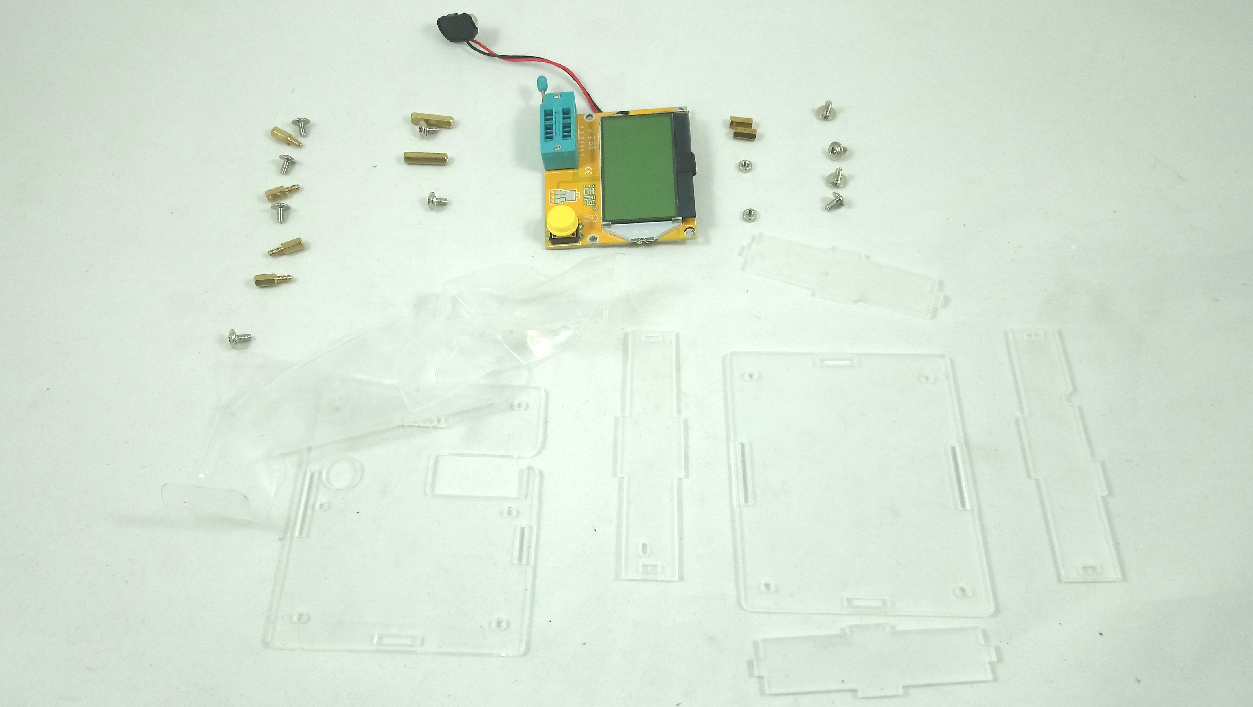

Stick 1 mm foam tape under the LCD and avoid flexing the gold ribbon. A clear acrylic case with 10 mm standoffs prevents pressure on the button [Elektroda, 16674114]
12. How do I assemble the acrylic enclosure?
Follow this 3-step: 1. Sandwich PCB between 10 mm spacers; 2. Insert LCD through front panel, secure with nuts; 3. Add rear plate and eight M3 screws [Elektroda, 16658664]
