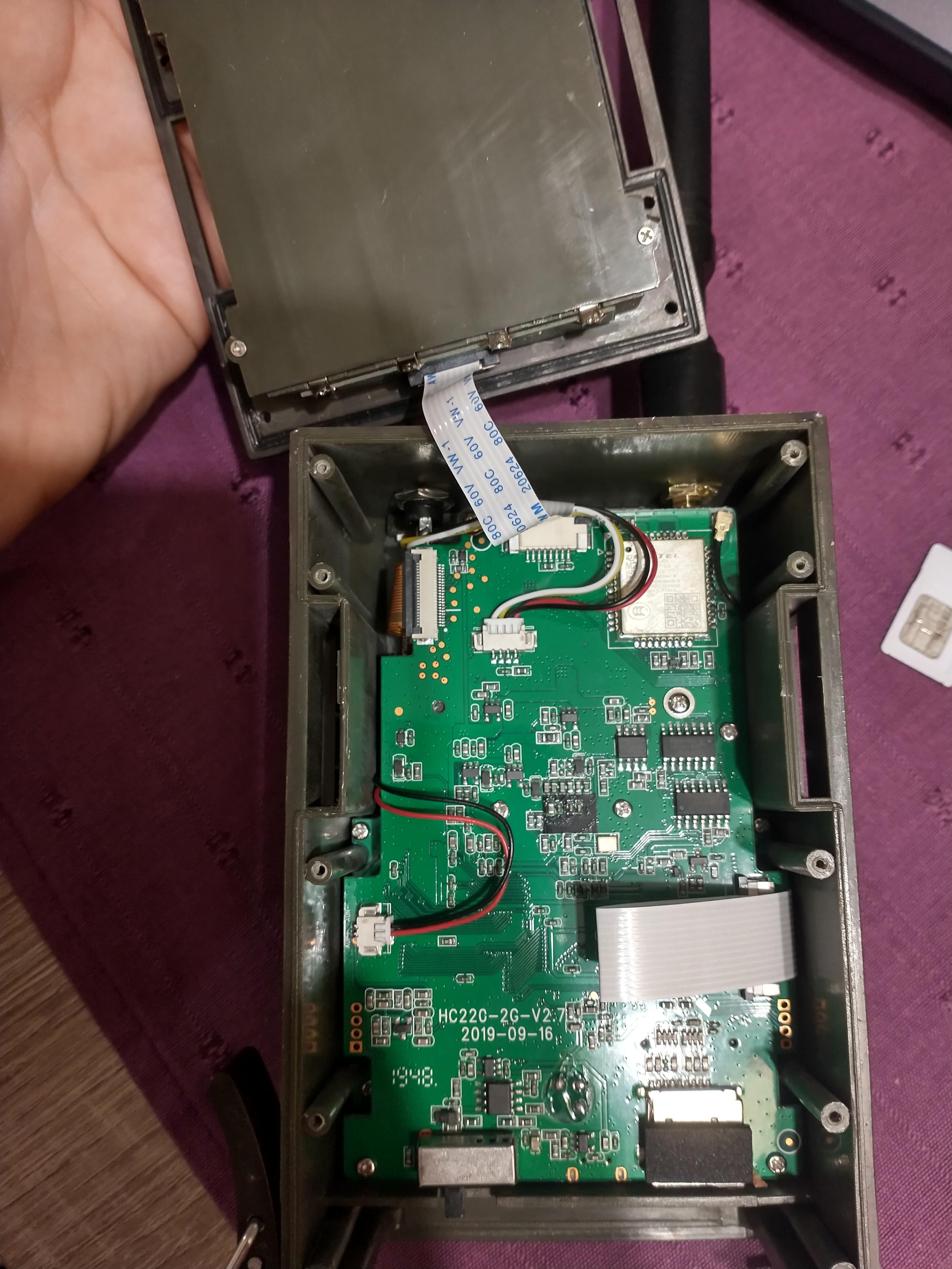

  • #257 19192707
    Razdwatrzy123k
    I have such a problem with the forest webcam, after setting all the parameters, the operator is not displayed next to the lines with the range
  • #258 19192936
    gradek83
    Posts: 9104
    Help: 929
    Rate: 2093
    Razdwatrzy123k wrote:
    after setting all parameters, the operator is not displayed next to the dashes with the range
    Remove the SIM card, insert it into the phone and disable the PIN code for the card in the SIM CARD settings.
    What operator and how did you set the MMS options.
  • #259 19192999
    Razdwatrzy123k

  • #261 19193119
    Razdwatrzy123k
    A memory card
    SIM
    Only in the current one, not and I don't know where the problem is.
    gradek83 wrote:
    how you set the MMS options.
    Was it working OK before?
    Is this the new FP?
    How powered externally or by batteries?
    Before everything worked, it just suddenly disappeared. Battery powered.
    • Denver WCM-8010 Camera Trap: Troubleshooting MMS & Email Issues, Activation Codes & Setup IMG_20210118_175633928_HDR.jpg (3.84 MB) You must be logged in to download this attachment.
  • #262 19193254
    gradek83
    Posts: 9104
    Help: 929
    Rate: 2093
    Unscrew the FP and check the condition of the small 3V battery from the inside.
  • #263 19193300
    Razdwatrzy123k
    Where is this battery located?
    • Denver WCM-8010 Camera Trap: Troubleshooting MMS & Email Issues, Activation Codes & Setup IMG_20210118_190712486_HDR.jpg (1.15 MB) You must be logged in to download this attachment.

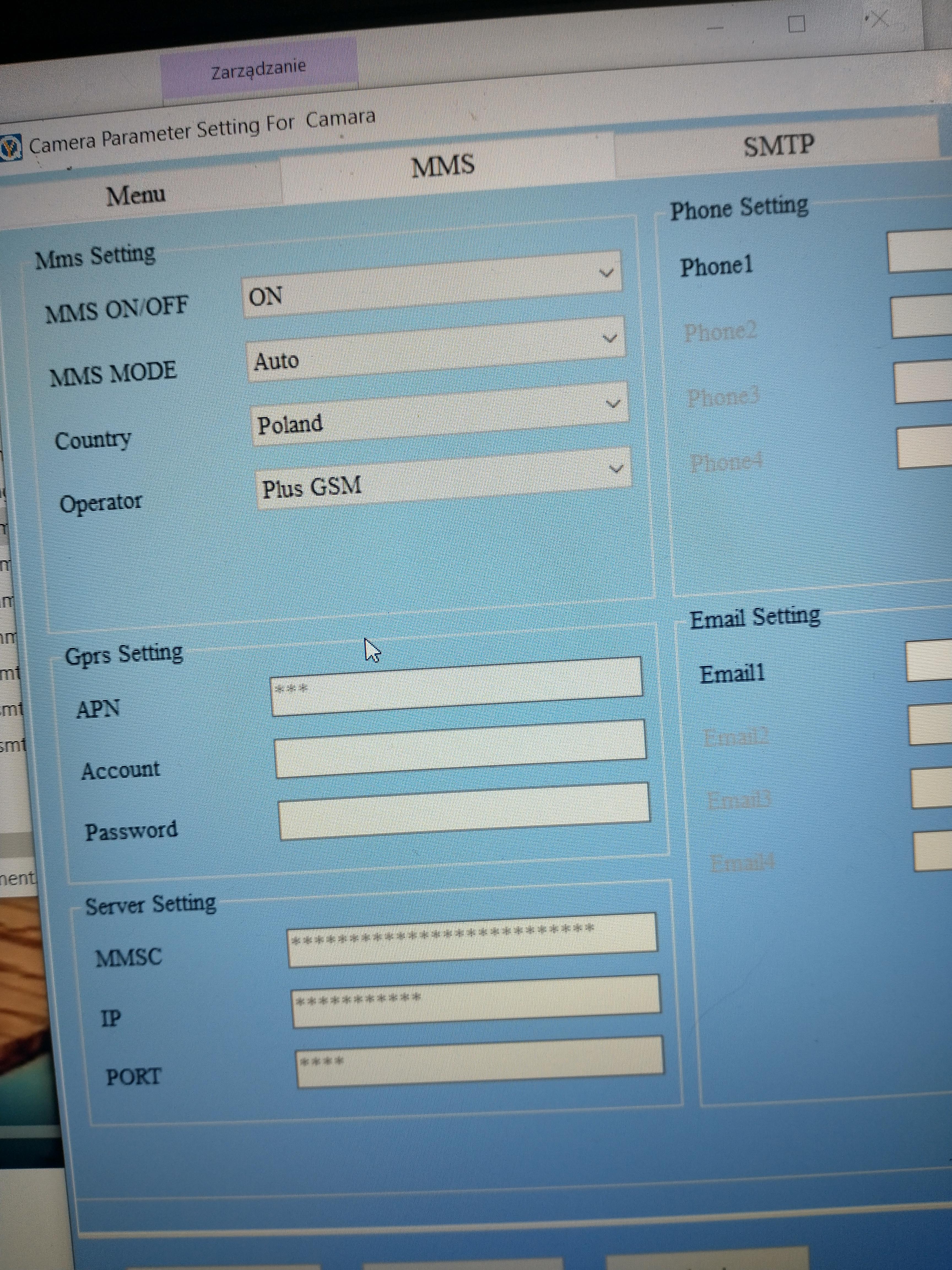

  • #267 19494584
    robertk111
    Hello, I bought a camera trap today and I can't configure it for anything in the world. He's not sending me anything. I have the card activated in play. Please help with setting. Greetings.
  • #268 19494588
    sosarek
    Posts: 83875
    Help: 9318
    Rate: 15495
    robertk111 wrote:
    I bought a wildlife camera today
    What?
    Include the configuration file.
    Z
    Pka, Poznań, 60-850

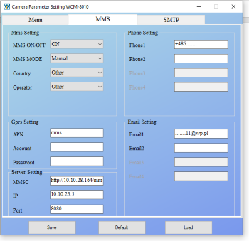

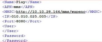

  • #269 19494606
    robertk111
    Denver WCM-8010 Camera Trap: Troubleshooting MMS & Email Issues, Activation Codes & Setup Denver WCM-8010MK2 with soft 20200803
  • #270 19494690
    gradek83
    Posts: 9104
    Help: 929
    Rate: 2093
    Put the card in the phone and disable the PIN on the SIM card.
    And give your telephone number without +48
    You can enter the IP in this form.
    Additionally, check if the photos are saved on the micro SD card.
    To manage the SIM card, install the Play24 phone application.
    And remember, depending on your tariff and activated packages, the cost of MMS is 0.45 PLN.
    So, set the interval to a sufficiently long time.
