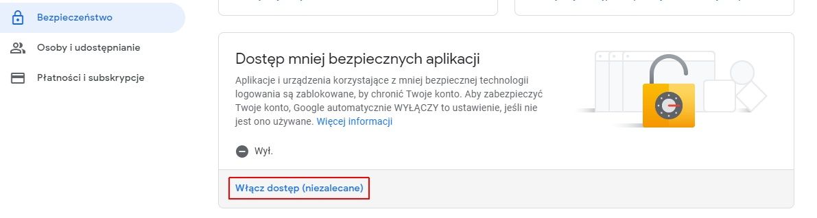

    Has anyone ever set up SMTP?
    Thanks in advance :D
  • #182 18810296
    gradek83
    Posts: 9104
    Help: 929
    Rate: 2093
    MMS and SMTP cannot be active together, OR OR.
    When configuring SMTP, as far as gmail is concerned, remember to enable the access to less secure applications in the Google account management options in the security tab.

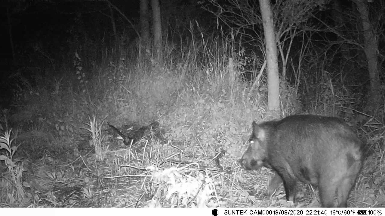

    The first WCM -8010 was returned, the cash was returned, from our representative of the Denver company from Chorzów, I bought the same model again because we hoped that the previous copy was faulty [the only service that tried to do something to solve the problem was the service from Germany sent a few soft to the test, but without improvement and they said they had better return] but it was the same.
    I bought HC801M 2G and I am satisfied with the photos for me of sufficient quality SMS commands are accepted and sent back is just OK and you have to forget about Denver. To configure the same program. Regards.
    Photo for comparison.

Can the camera e-mail pictures via SMTP instead of MMS?
Yes. In MMSCONFIG switch MMS to OFF, SMTP to ON, use a Gmail account with “less secure apps” enabled and port 465 SSL. Expect ~500 kB per mail. MMS and SMTP cannot run simultaneously [Elektroda, gradek83, post #18810296]
