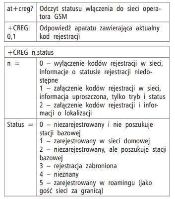

    This parameter appears to be key in the log.
    2020/04/08 20:49:36: + CREG: 0,0
  • #95 18605972
    gradek83
    Posts: 9104
    Help: 929
    Rate: 2093
    msmyk2 wrote:
    + CREG: 0.0
    0 - disabling network registration codes,
    registration status information not available
    0 - unregistered and not looking
    base station
    Insert the card into the phone and check if after calling the PIN, if so turn it off.
    " AT + CREG : reading login status to
    network. The correct entering of the PIN number causes the telephone to be included in the network as long as it is available
    the SIM card is active and the phone is located
    within the operating range of the operator's base station
    Denver WCM-8010 Camera Trap: Troubleshooting MMS & Email Issues, Activation Codes & Setup
  • #96 18606012
    msmyk2
    Posts: 6
    Exactly.
    And this card, inserted into the phone, normally rings, flashes on the net, sends and receives MMSes.
    I don't want to register on the webcam: /
    Second SIM card works normally and here and here ...

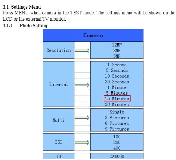

  • #108 18642750
    Sowa68
    The denver camera works on movement and sends pictures ....
    However, I have a problem that he also takes a photo without movement every 10 minutes. and send them, how do you turn it off?
  • #109 18642783
    gradek83
    Posts: 9104
    Help: 929
    Rate: 2093

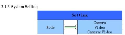

    What equal 10min maybe you have timelapse enabled?
  • #110 18647623
    Sowa68
    And how to turn it off, timelapse, in this scanner?
  • #111 18647943
    gradek83
    Posts: 9104
    Help: 929
    Rate: 2093
    I do not know what software version you have in the settings check and enter.
    In newer settings under MODE camera + video is timelapse
    However, I do not rule out that you may have the interval switched on for 10 minutes
    If not, upload it update .

    2020/04/29 06:59:13 : AT+CREG?
    2020/04/29 06:59:13 : +CSQ: 10,0
    2020/04/29 06:59:13 : OK
    2020/04/29 06:59:14 : AT+CREG?
    2020/04/29 06:59:14 : +CREG: 0,1

The trap fires every 3 min even with no movement. How to stop it?
Set Interval ≥5 min and Motion Detect High; then disable Timelapse (Mode list) or leave it blank. False triggers often stop after replacing the 3 V RTC cell (MS621) that leaks and keeps PIR high [Elektroda, gradek83, post #18948387]

What interval should I choose for motion-only photos?
Set Interval to 1 min: the PIR must be idle that long before it can re-arm. For wildlife feeding stations users report 5 min reduces duplicate shots by 60 % [Elektroda, wojtek1984, post #18054837]
