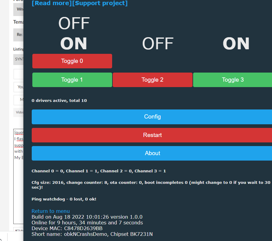

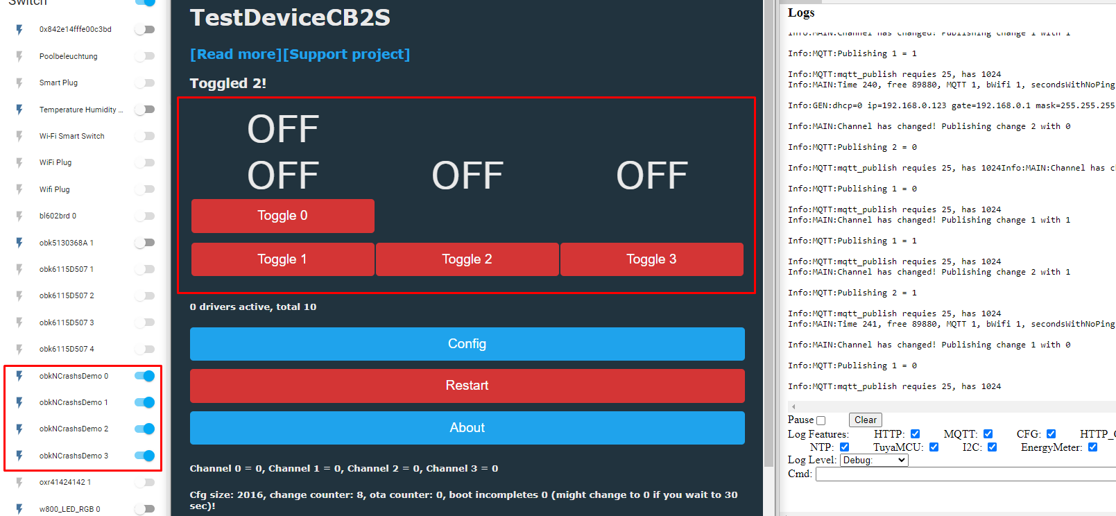

    SFMax wrote:
    start to work intensively (saving pins, name, mqtt settings more than one time, toggling relay state, watching WebApp log) device was rebooted (or just disconnected from WiFi connection as AP) one moment and than it began to be rebooted (or just disconnected from WiFi connection as AP) on some random actions (some time on attempt to open pin config page, some time on toggling relay state and so on)
    Can't reproduce it so far, do you do that with MQTT connected?
    The one issue I have in mind is the HTTP handler buffer malloc/free fragmentation. I can change the code to use thread-safe buffer cache with mutex and see if it helps you.
    EDIT: Mqtt is not connected, Web app is open and I am clicking 10 times on each option and device is still up.
    Maybe I need to have more relays or MQTT for it to crash.

    It seemed like MAC flash sector was broken, but I don't know if it was wrong in the first place or did it break during the 0xFF overwrite made by @00svd00 if I remember correctly.
    After last flashing MAC address was not broken (I could see my original MAC in page with MAC settings) but on first load I've tried to change it to new random one using OpenBeken MAC config page and it looks like that it caused problems with AP disappearing.
    Can you try this QIO firmware update?
    See please my previous message I've already reflashed device one more time without changing MAC and now everything is OK with AP. But I have other problems (discribed in previous message). Can you check my new dump with debug log and if you find anything else then I try to flash your new QIO firmware update.
    Many thanks to you for help!!!
    Added after 13 [minutes]:
    MQTT broker is not set up. In my case MQTT is not connected too. I've just left settings in default.
    I have only one relay. But as I wrote it is hot enough after 5-10 minutes of intensive working with reading log and changing some settings and state of relay.
    It would be good if you can do it. I want to understand what is problem - memory usage or heating due to such scheme of device.
  • No crashes after 32 minutes with MQTT and dummy relays

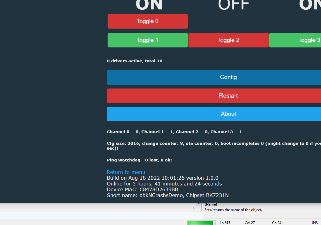

    The exact flash version should not matter for that, futhermore I am using still your old one, just with a MAC change..

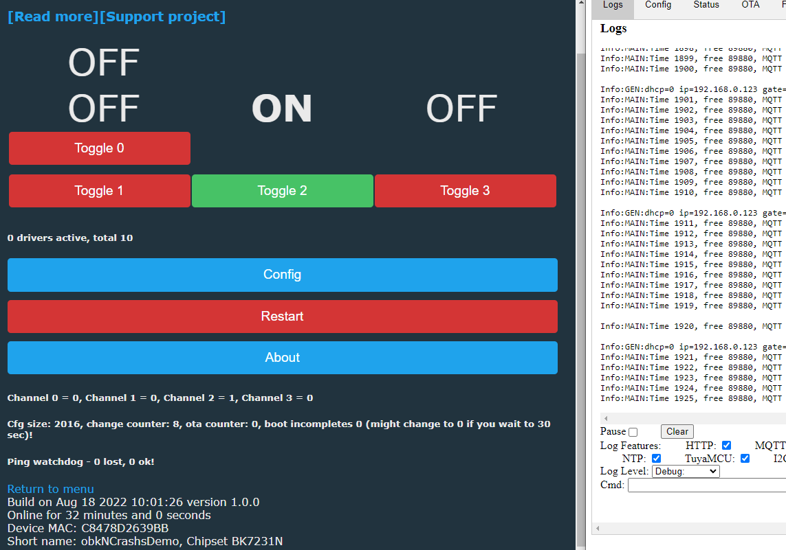

    I've set up 4 dummy relays (with inverted values but it doesn't matter), a MQTT and a log window:
    Qiachip Smart Switch - BK7231N / CB2S - interior, programming

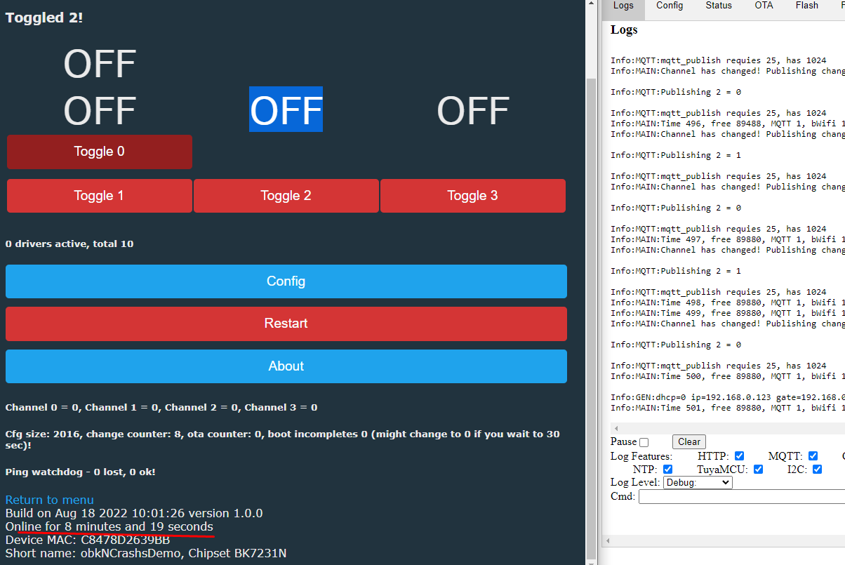

    I am clicking and clicking and no crashes so far.
    The only crash I remember having is some months ago, when I tried BL0937 socket with MQTT reporting many values every loop. It was doing publish for voltage, energy, power, etc all the time and it was crashing, but I don't think it's related.
    My device is slightly warm. I can feel that, but that's not much warm, I would say.
    8 minutes up
    but still, it could be that memory fragmentation issue, if you are really doing lots of HTTP request, but that's not even the expected usage by me
    edit: 32 minutes

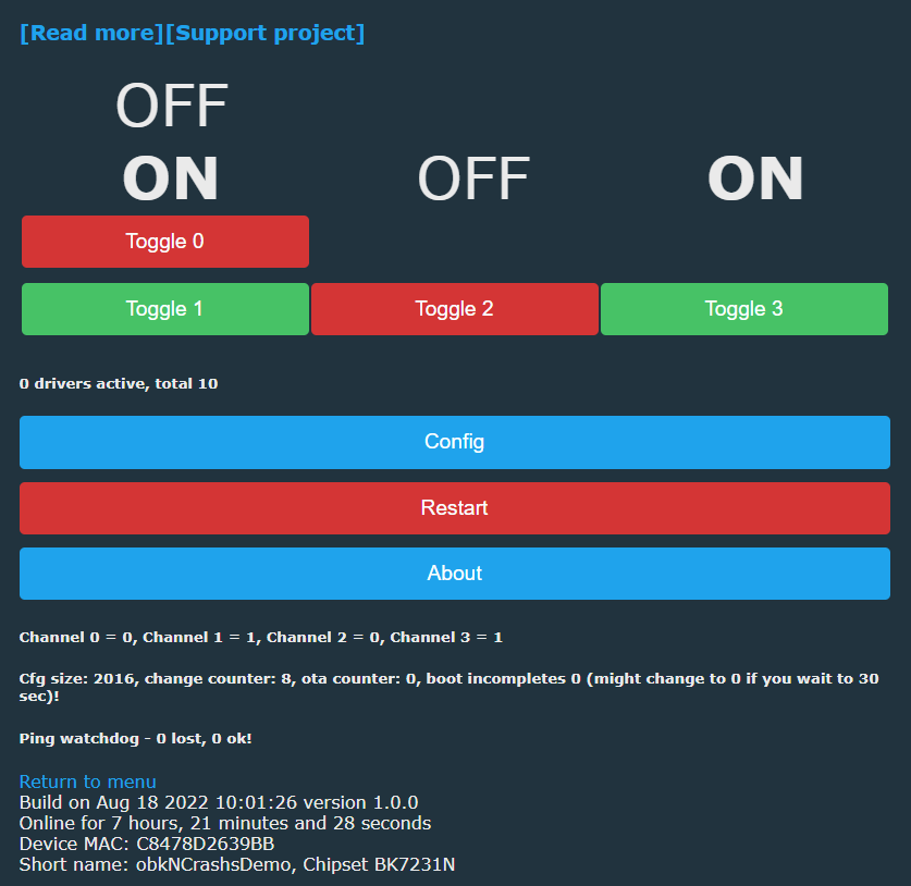

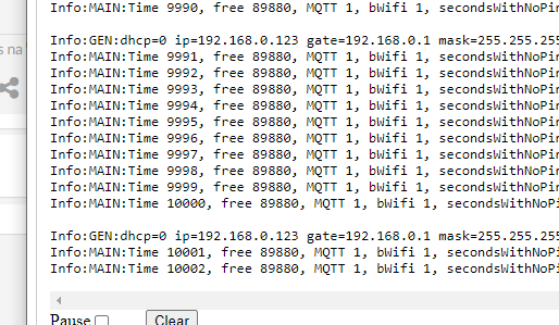

    Still up:
    I am not sure how to trigger that at will, I will most likely have to connect it to other machine than my notebook and leave it overnight with USB to UART dongle connect to collect logs...
  • #128 20149626

    I don't think it is. I think something might be wrong with N SDK in certain cases.
    I suspect that you might have the same issue that the two BL0937 users from Github. At first I tought it was related to MQTT and was an other thing, but maybe it's the same... they also reported using CB2S (not: CB3S and not any other device).
    edit: 6h almost

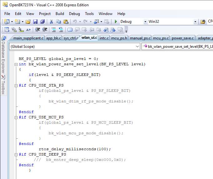

    I looked at the other CB2S user errors and supposedly it hangs with UART log:
    Info:MAIN:Time 23435, free 78688, MQTT 1, bWifi 1, secondsWithNoPing 1, socks 2/38
    sm_disassoc_handler
    sm_disassoc_handler reason=2,vif=0
    sm_disconnect_process
    me_set_ps_disable:840 0 0 1 0 11
    SM_DISCONNECT_IND
    bad_channel vif_idx=0
    the sm_disassoc_handler seems to come from librwnx.a
    .text.sm_disassoc_handler
    0x0007fc78 0x8c ./beken378/lib/\librwnx.a(sm.o)
    0x0007fc78 sm_disassoc_handler
    then I looked into the config:
    GIT\OpenBK7231N\platforms\bk7231n\bk7231n_os\beken378\app\config\sys_config.h
    GIT\OpenBK7231T\platforms\bk7231t\bk7231t_os\beken378\app\config\sys_config.h
    The N SDK has CFG_LESS_MEMERY_IN_RWNX enabled but T don't
    in the end, I found some other changes in the sys_config.h files and ported T variables to N
    I am not sure if I should test it myself because it would mean losing 7h rest results from CB3S, so can you check out this binary and see how it behaves?

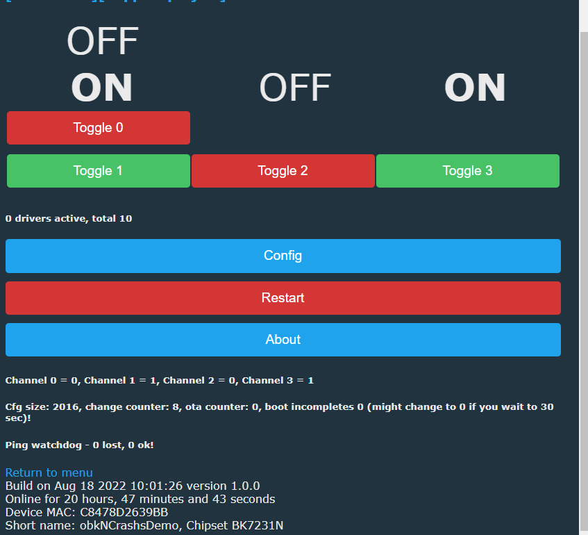

    SFMax wrote:
    I flashed your binary. At first boot (with uart connected) it was ok. I set name, made pin configuration. But when I connect to 220V power supply and open logs page after 2-3 minutes it began rebooting repeatedly 2-3 times until I powered off my device. So I have same results but with less time.
    My BK7231N is almost at 10h uptime mark:
    So maybe let's try another way....

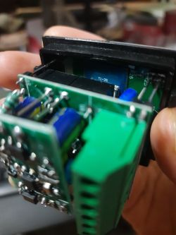

    1. does your device works if you power it from external reliable 3.3V or 5V (but of course through LDO 3.3V) supply?
    2. by any chance, don't you have a faulty capacitor like me in this topic (use google translate):
    https://www.elektroda.pl/rtvforum/topic3898805.html
    basically, the device described in the topic above, was only several weeks old and had a faulty capacitor that made it randomly reset and emit strange sounds from the coil
  • Suspect faulty 16V 1000 µF capacitor causing overheating

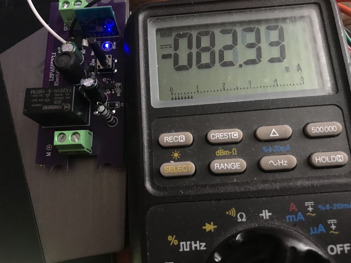

    I need some more time for testing. Till this moment device (powered by uart 3.3 V) worked for 25 minutes with log showing and some my actions by http without any problem.
    Hyncdz capacitor 16V 1000 uF is the hottest of all components (big enough to touch with my fingers) but it looks normal. It is used to power both relay (12 V) and CB2S module (3.3V).
    If it is bad one it means that I have 5 smart switch devices with bad capacitors. May be it must be changed by other one with higher parameters.

    I soldered 35v 1000uF capacitor on wires instead 16V 1000 uF and behavior is much better. After about half an hour of testing there is no reboots.

  • OpenBeken power draw causes overheating and reboots
    #139 20156690
    SFMax
    Posts: 26
    I made some tests with power measurements. With original firmware device consumes 0,4 to 1,0 W with relay switched off state depending on strength of wifi signal from router and 1,4 W with relay switched on state. With OpenBeken firmware consumption is 1,1 - 1,4 W with relay switched off state and 2,1 W with relay switched on state. It causes strong heat of components under shell and rebooting of device (device has linear voltage regulator with overheating protection). In my case I changed low voltage capacitor (16 V, 1000 uF) by other one new capacitor with the same characteristics but bigger size and longer connection contacts, don't use cover of shell. Temperature of device is not so hot now and there is no rebooting. But it is necessary to do more tests with different scenarios. Unfortunately firmware is too resource intensive for my device (in photo below).
    Added after 9 [minutes]:
    I will investigate it later when I get some more free time, but the current solution is to flash bin file posted by @00svd00 , then reset device power 6 times, connect to AP, change MAC and just configure it like always.
    In my case device behavior is the same with these steps. But power consumption of device with OBK firmware makes me think that it is OBK firmware problem. Does this firmware have such optimization like
    new CB2S devices which seem to have new format of WiFi calibration/something

    I think that the power consumption can be easily improved. I will look into that.
    The only problem is that there is no documentation at all for BK chips so I will have to look through the SDK...
    Can you do some tests, for example, check power consumption in AP mode?
    If I were to send you some test cases, would you measure power consumption for them?
    Regarding new CB2S devices - my CB2S from this topic worked flawlessly, it's @00svd00 who discovered that new device flash contents breaks OBK... idk why it happens yet.

    EDIT: I have made futher tests with my CB2S board. CB2S is powered from AMS1117 3.3V. The current meter is before 1117
    At 5V, it consumes 60mA up to 80mA, so it's (0.08*5)W = 0.4W

    I'm on it right now.
    Current consumption is between 60mA and 80mA at 5V, most of the time 80mA.
    I am testing:
    /*section 23 ----- support reduce nomal power*/
    #define CFG_SYS_REDUCE_NORMAL_POWER                0
    but it makes seemingly no difference right now, despite me recompiling whole SDK
    I wonder how did you get to 1.4W. I am measuring at 5V, so the power supply loses are not included....
    ah, and I am testing without MQTT right now.
    I will try to lower this 80mA active current
