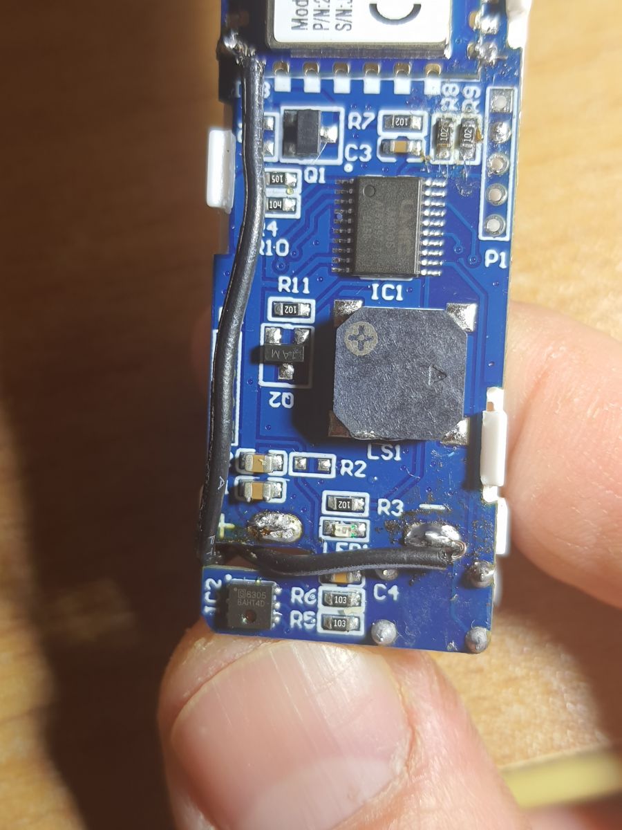

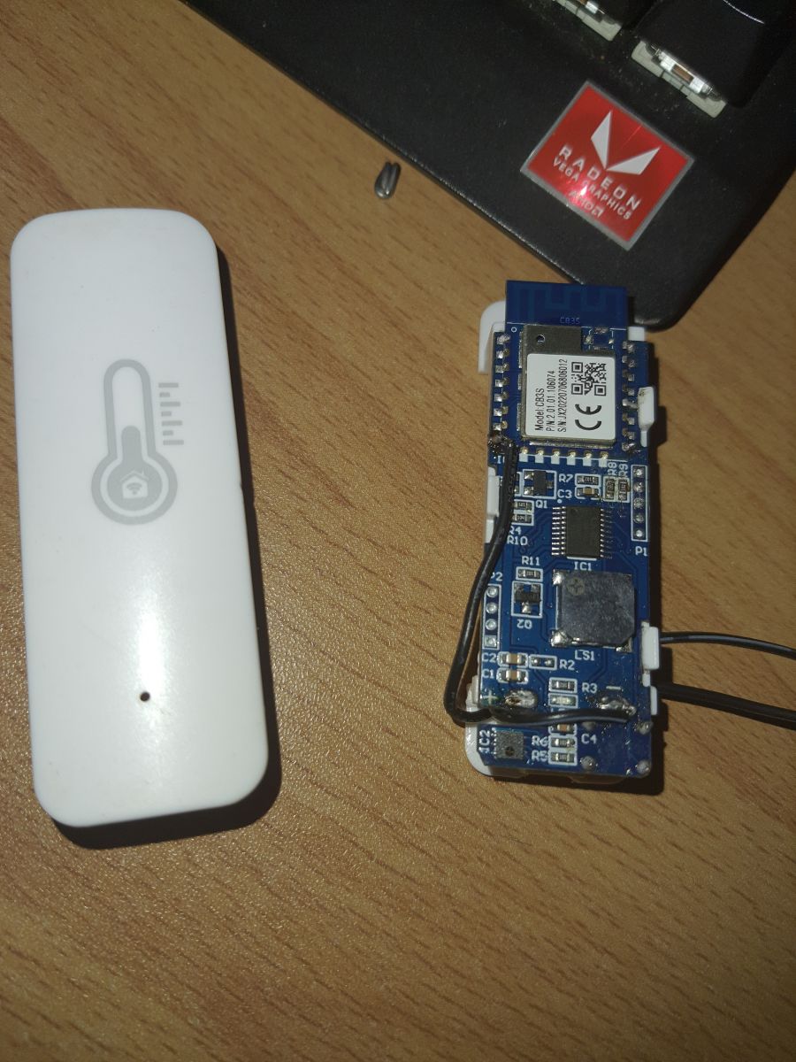

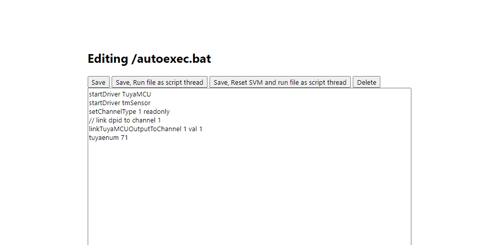

  • Need method to read temperature from CB3S sensor
    #220 20334235
    nemec23041990
    Level 4  
    Qiachip Smart Switch - BK7231N / CB2S - interior, programming Qiachip Smart Switch - BK7231N / CB2S - interior, programming приветствую. удалось прошить температурный датчик на CB3S, подскажите как извлечь информацию о температуре? Qiachip Smart Switch - BK7231N / CB2S - interior, programming Qiachip Smart Switch - BK7231N / CB2S - interior, programming Qiachip Smart Switch - BK7231N / CB2S - interior, programming Qiachip Smart Switch - BK7231N / CB2S - interior, programming
  • Find temperature dpid and disconnect 3.3V power wire
    #221 20334252
    Posts: 14754
    Rate: 12875
    Hello @nemec23041990 , can you provide more information about your device? What kind of sensor? Is it a TuyaMCU one?
    This might be slightly related - TuyaMCU Motion Sensor configuration: https://www.elektroda.com/rtvforum/topic3937723.html
    EDIT: You need to find dpID for temperature now.
    dpID may be 1, or 2, or 3, idk. You need to check logs.
    Then:
    startDriver TuyaMCU
    startDriver tmSensor
    setChannelType 1 readonly
    // link dpid to channel 1
    Note that you should disconnect power wire from 3.3V pad of CB3S. Your device is a low-power battery powered device. TuyaMCU takes control of CB3S power is will turn it off most of the time.

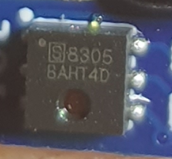

  • UM8005 chip and sensor interface questions
    #222 20334263
    nemec23041990
    Level 4  
    chip UNICMICRO UM8005
    http://www.gztrchip.com/uploadfile/file/20210811/1628649277678726.pdf
    его можно прошить?
    датчик
    http://sensylink.com/a/products/lm2/CHT8305.html
    dpID может быть 1, 2 или 3, idk. Вам нужно проверить журналы.
    можно подробнее?
    как указать rx tx?
    возможно подключить сторонний датчик dht11?

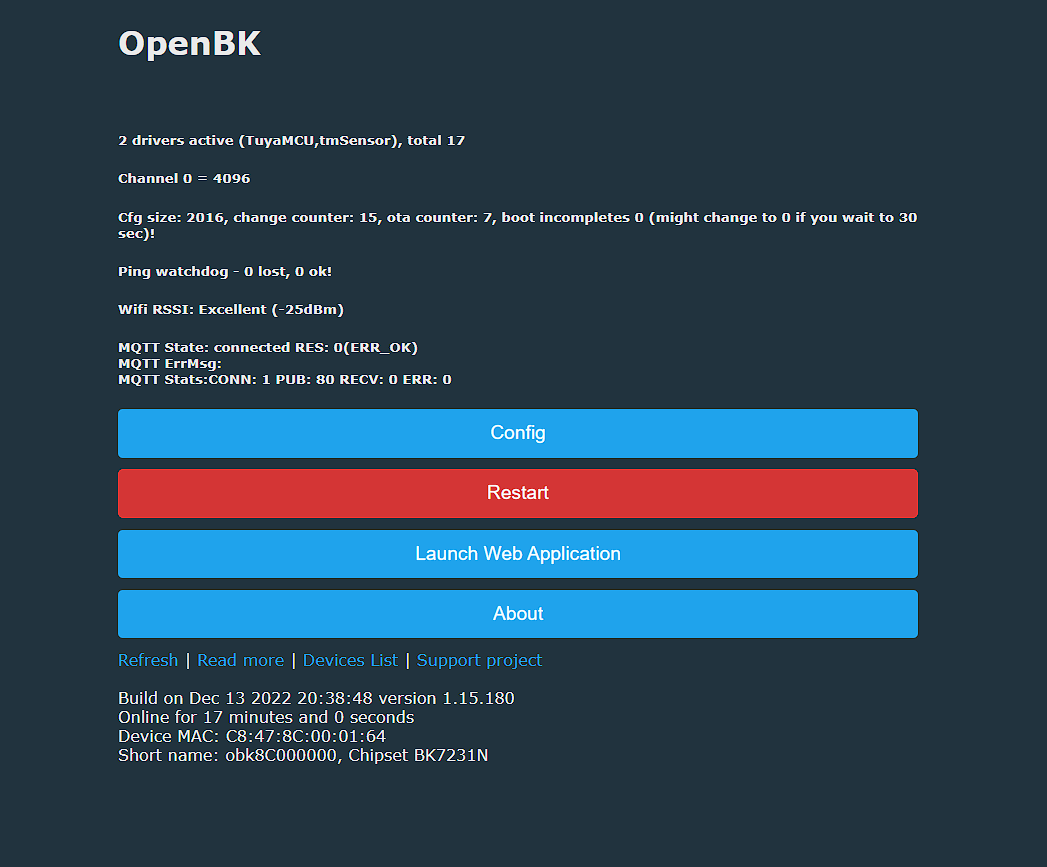

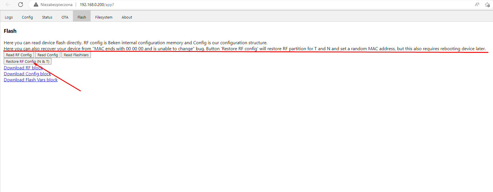

  • MAC reset to C8:47:8C:00:00:00 breaks Wi-Fi connection
    #223 20334483
    dzidziaka1
    Posts: 29
    I have a similar experience with two Aubees 20A.
    Six flashed with version 1.12.44 and then via OTA to 1.15.176.
    The MAC of the two problematic ones has changed to C8:47:8C:00:00:00 and they do not connect to the router. Its logs show attempts to connect but are disconnected. Over and over again. Router reset.
    What I did on one:
    Uploading 1.0.0, 1.10.4, 1.12.44, 1.15.176 without changes.
    I padded 1.10.4 with zeros up to 2Mb with no changes.
    What else can I try?
    What could be the reason that I achieved different results with the same flashing procedure? (maybe I did something wrong?)
    Regards

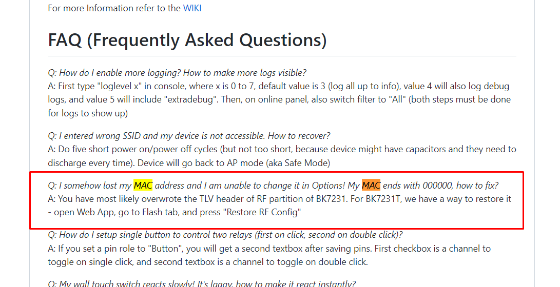

  • Restore RF config to generate a new MAC address
    #224 20334533
    Posts: 14754
    Rate: 12875
    You padded with zeros, so you deleted the MAC partition - that`s logical.
    The router will always disconnect devices if you have two with the same MAC.
    According to the FAQ:
    Use the "Restore RF Config" tool in the OpenBeken application panel and you will get a new MAC address.
  • #225 20334543
    dzidziaka1
    Posts: 29
    I`m only testing one enabled device.
    I can`t access the panel because it doesn`t connect to the router. And that`s the problem :) .
    I`ll give him another router soon, maybe something will change.
    What is the most correct way to wipe the device and upload the firmware?
  • Duplicate MAC address blocking router connection

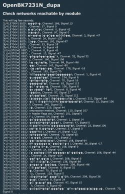

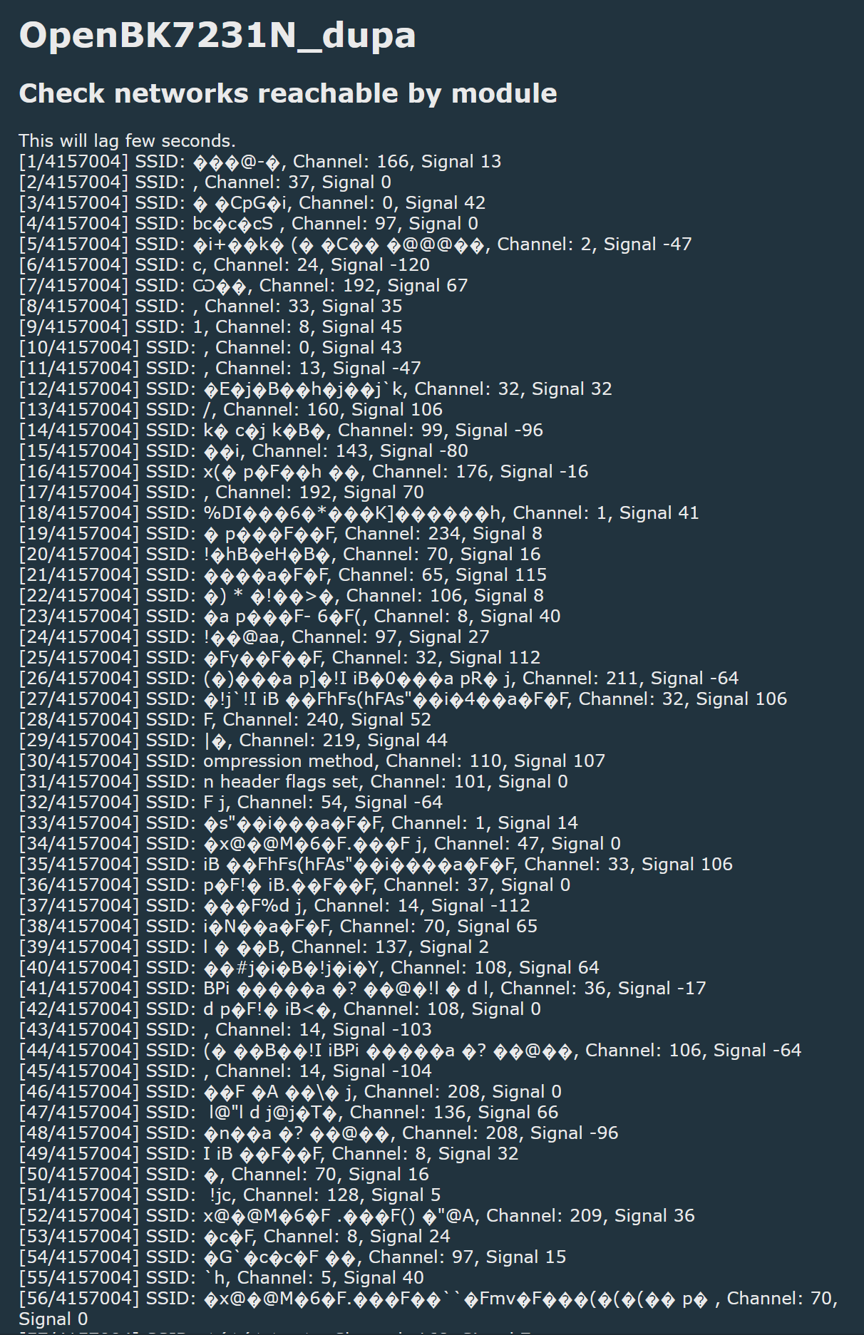

  • AP mode shows white web page and garbled SSID names
    #227 20334646
    dzidziaka1
    Posts: 29
    I only do this with this one on all the time.
    I flashed 1.15.176, connected in AP mode, pressed Exit Safe Mode, waited, pressed again, Exit Safe Mode disappeared. When I press Launch Web Application, a white page appears 192.168.4.1/app? and stands alone.
    Interestingly, in AP mode, when I search for the network, bushes appear as in the attached picture.
    BK7231N downed? Maybe it has an impact that I test with a direct power supply connected? (Well, the actors had no problem with it :) )
  • Web app and scanning work with Ethernet connected
    #228 20334753
    Posts: 14754
    Rate: 12875
    Web The application is downloaded from the Internet on an ongoing basis. Maybe in AP mode you don`t have a second internet connection (e.g. via cable) like me and it doesn`t load for you?
    Both the Web Application (WiFi connected to the OpenBeken AP, Ethernet cable to the router) and network scanning work for me.
    Does WiFi scanning not work on all your devices? Or maybe, for example, I don`t know, you click "Search" three times and that`s why there are bushes? This is the first time I see this, try to diagnose more and we will fix it.
  • Relay load on 3.3 V may be causing resets
    #229 20334822
    dzidziaka1
    Posts: 29
    I`m not thinking about something today.
    You are right, how should the application be loaded when I am connected to the AP socket and I do not have any other Internet connection :)
    I only press once.
    There is some light. When I turn off Rel on P26, the socket connects to the router.
    Maybe when the 3.3 power supply is taken by the USB programmer, the relay wants to turn on and the voltage drops.
    I turned off the P26, plugged the socket into the 220, it connected, turned on the P26, restarted. Disconnection in the router logs :) .
    Maybe when the relay was turned on with power from 3.3, one of the elements on the board was damaged?
    It`s not a problem, I can try to check.
    I keep going.

  • Full memory dump restored to revive sockets
    #235 20336000
    dzidziaka1
    Posts: 29
    Two broken sockets brought back to life.
    What I did:
    Dump all memory from a working socket.
    Uploading this dump to a non-working one.
    After that, the socket starts in AP mode in which I changed the MAC.
    Using the Restore RF Config option causes the socket to be re-bricked, which the application warns about.
    In this case, entering AP mode does not help. The socket is unstable, it is difficult to connect to it, I only connected via mobile phone (win 10 and linux on VM with three different wifi cards)

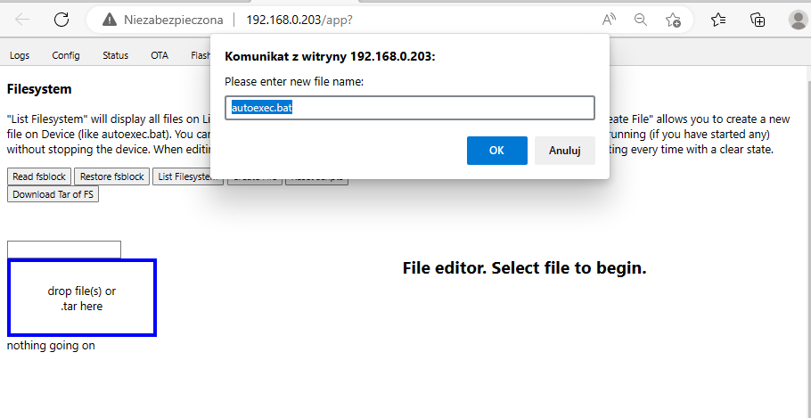

  • PowerSave must run after each reboot
    #239 20357216
    Posts: 14754
    Rate: 12875

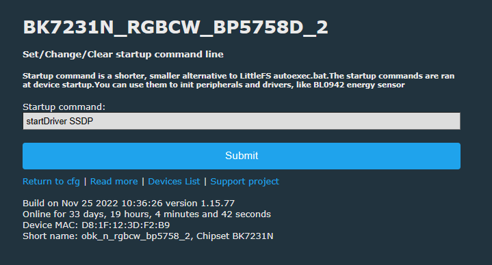

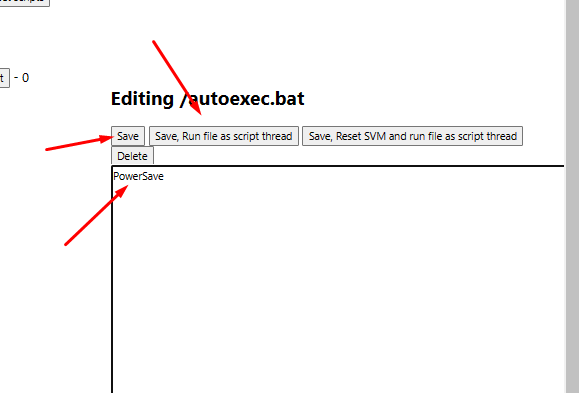

    PowerSave command needs to be executed after device reboot. The PowerSave is not remembered, so there are two options for you.
    Option 1. Enter in Options->Short Startup Command (then reboot):
    BTW - look at the uptime! My device runs for 33 days and still stable!
    Option 2: On Web Application, create autoexec.bat:
    Enter command, save, and reboot (or just run should also work):
    NOTE: Currently, PowerSave doesn't like keeping the HTTP page open in your browser! If you leave our HTTP page - that features autorefreshing - open in your web browser, then device will not sleep much
    We are still improving it. Things are relatively hard here because there are no docs for Beken chips. It's not like ESP, where you get thousands of examples in Google.
