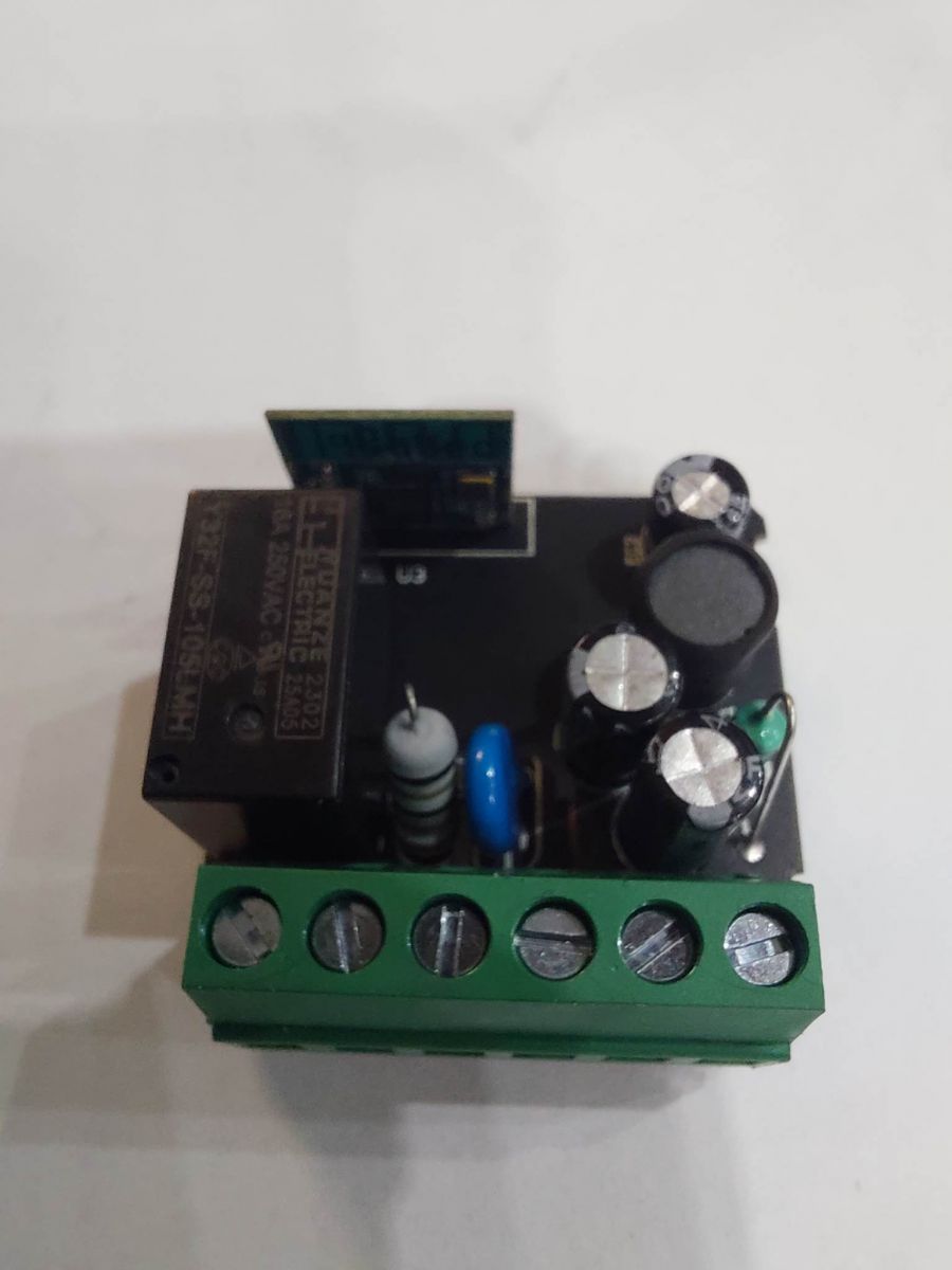

    Thanks. I will add this to our templates list, but can you at least post a photo of MK601 switch and information where it was bought? And which module?

    Thanks for the tip. pins RX, TX are P6, P7? on my board only these pins are connected. At the time of laying I usually wire) Qiachip Smart Switch - BK7231N / CB2S - interior, programming

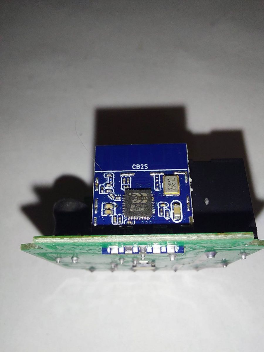

    Mine has a CB2S board, although I replaced it with the equivalent TYWE2S because the operation was not stable.
    regards
    Qiachip Smart Switch - BK7231N / CB2S - interior, programming Qiachip Smart Switch - BK7231N / CB2S - interior, programming Qiachip Smart Switch - BK7231N / CB2S - interior, programming
    Added after 2 [hours] 9 [minutes]:
    Pin 10 is RX1 and I use it to switch S2.
    regards
    Added after 11 [minutes]:
    You have to short-circuit the P10 to ground for it to work. Or with S1 which is internally connected to ground. Be careful because in the double relay controllers for blinds these contacts usually go to the 230V phase. Careful with this.

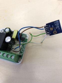

    DHT11, DHT22, DHT12, DHT21 support has been added on latest update and was tested in BK7231T and BL602.
    Qiachip Smart Switch - BK7231N / CB2S - interior, programming Qiachip Smart Switch - BK7231N / CB2S - interior, programming Qiachip Smart Switch - BK7231N / CB2S - interior, programming Qiachip Smart Switch - BK7231N / CB2S - interior, programming
    Configuration: connect DHT11 to any pin. For that pin role, select DHT11. First linked channel is temperature, second is humidity. You can receive publishes with Home Assistant. You can scale values in HA because temperature is stored as times 10 value like in TuyaMCU. You could also just do on change handler with publishFloat and $CH2*0.1 expression, this will also work and that way you can set any topic
    Here is a screenshot from out automatic tests for this feature:
    Here is the command (to be put in autoexec.bat):
    addEventHandler OnChannelChange 20 publishFloat myAliasedVal $CH20*0.1

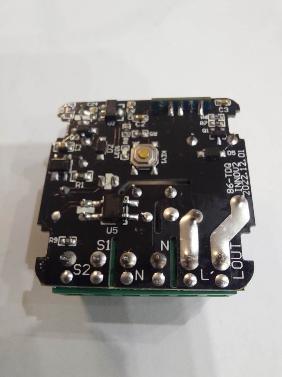

    I am trying to read the az BK7231N firmware and I get the message:
    (on the chip is the inscription NU2)
    Starting read!
    Now is: niedziela, 16 kwietnia 2023 20:39:18.
    Flasher mode: BK7231N
    Going to open port: COM1.
    Serial port open!
    Getting bus... (now, please do reboot by CEN or by power off/on)
    Getting bus success!
    Going to set baud rate setting (921600)!
    Will try to read device flash MID (for unprotect N):
    failed with serial.BytesToRead 0 (expected 15)
    The beginning of buffer in UART contains data.
    Failed to read device MID!
    Going to start reading at offset 0x00...
    Reading 0x00... failed with serial.BytesToRead 0 (expected 4111)
    Failed! There was no result to save. Qiachip Smart Switch - BK7231N / CB2S - interior, programming Qiachip Smart Switch - BK7231N / CB2S - interior, programming Qiachip Smart Switch - BK7231N / CB2S - interior, programming Qiachip Smart Switch - BK7231N / CB2S - interior, programming

    Please try desoldering the module first, just to be sure.
    Please try hid_download_py:
    https://github.com/OpenBekenIOT/hid_download_py
    https://www.youtube.com/watch?v=PKkiqDNFIx8&t=295s&ab_channel=Elektrodacom
    That fail at MID is worrying, I hope they didn't change the flashing method or the way chip identifies itself

    Today I read the second switch after desoldering.
    P8 - WiFiLED
    P10 - Btn
    P23-TglChanOnTgl
    P26 - Rel
    Regards
