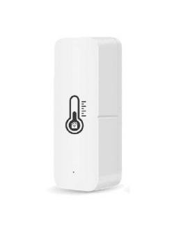

    Hello All,
    I have a temperature and humidity sensor with a CB3S module, which I'm trying to free from tuya cloud with your very promising BK7231N firmware. It works with 2 AA batteries. The article number is TW-TH002 I think.
    Qiachip Smart Switch - BK7231N / CB2S - interior, programming
    I have a CH340G USB to TTL deivce for the task.
    I connected pins to the CB3S (8) VCC, (9) GND, (15) RX, (16) TX, and for resetting (3) CEN, and could download the firmware, but with CRC errors. TTL device is set to 3.3V.
    When I try to write the BK7231N (OpenBK7231N_QIO_1.12.48.bin) with -s 0x0, -u options, then I get an error right after start: "WriteSector 1 Failed"
    Do you have any idea how to continue?

    What is the marking on the chip in SOIC?
    I'd guess that's a TuyaMCU device. Most likely TuyaMCU has to be temporarily removed because it shared TX and RX lines with the lines that are used for programming.
    Second option would be to send 2MB flash dump to tuya-cloudcutter guys and wait for them to prepare OTA support for this device.
    Can you check with multimeter where the RX and TX of CB3S goes to? Is it connected to the MCU? Just to confirm...

    Could you clarify, I don't understand this:
    Okay, I'll check next week as soon as I can, and get back to you.
    I could see a very similar device that you successfully flashed in post #100, did you cut the RX/TX connection to the MCU there?

    I am asking what is the chip name from the photo, because It's a bit blurry and it's hard for me to read.
    I had to cut RX/TX in order to flash, but it might be not necessary if you identify the chip and find if it has a reset pin in its datasheet.
    Here is more information about that device, sadly only in polish so far (use google translate):
    https://www.elektroda.pl/rtvforum/topic3914412.html

    I couldn't make a better picture, but I think this is an Unicmicro UM8005-ACTE (TSSOP20) microcontroller.

    I didn't have time to read whole datasheet, but you can find one on the web, and it seems there is a RST pin. Maybe connecting this pin to ground or something will put chip in RESET mode and allow you to read and write flash from UART with no interference.
    Otherwise you will have to cut the tracks... the UART used to talk with this chip is the same as programming UART

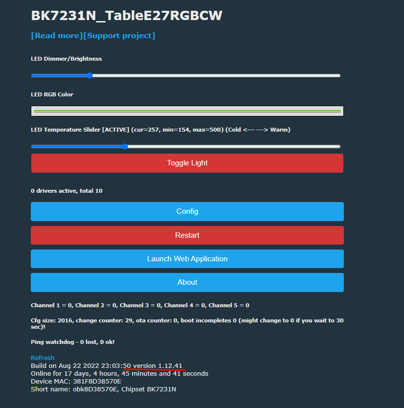

    Are you saying that it reboots even after @00svd00 fix?
    Ok, can you check the very same version that I have running for 18 days already?
    This version: Build on Aug 22 2022 23:03:50 version 1.12.41 pick that one from releases and check.
  • 2 MB firmware still reboots on MQTT subscribe
