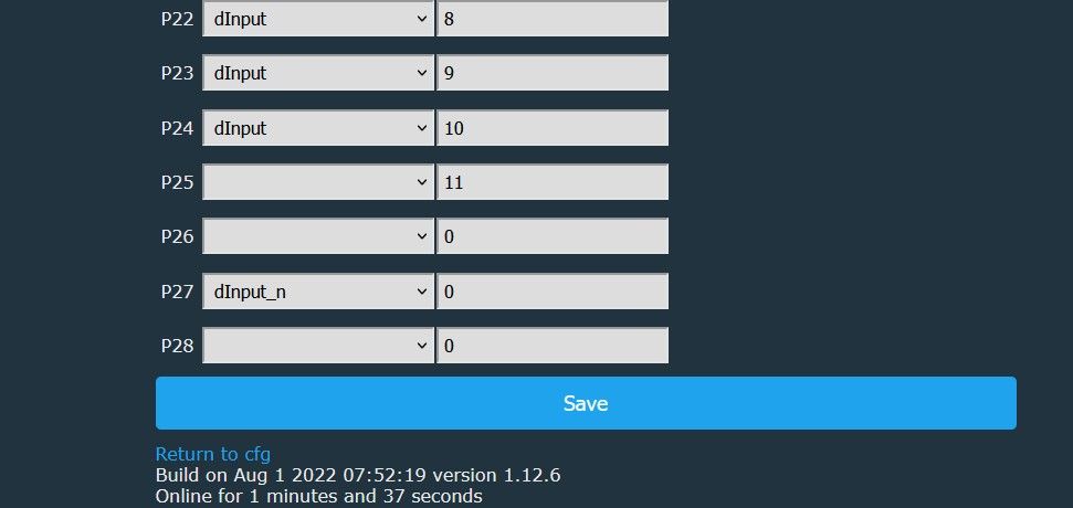

    00svd00
    Posts: 26

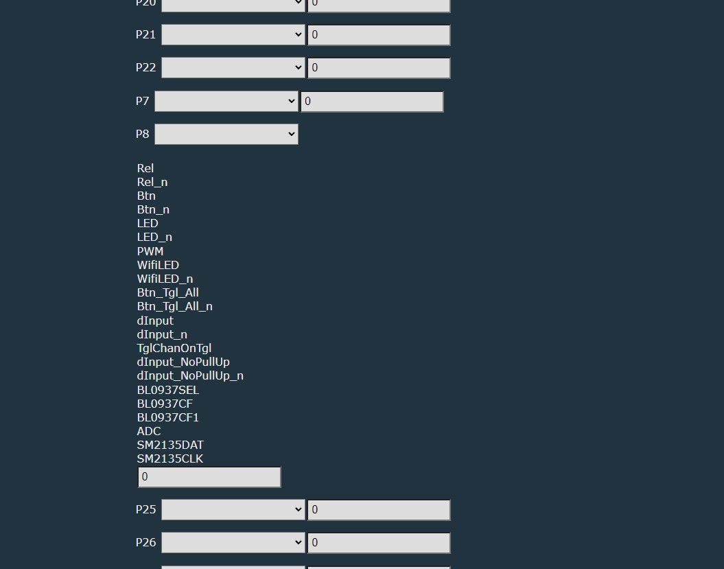

    So it's not even possible to reach the configuration page?
    We have never experienced such an issue before. Safe mode is designed to work even with invalid settings.
    Can you try reading the debug log output on UART 2 pin (TX pin)?
    Done(in attach)

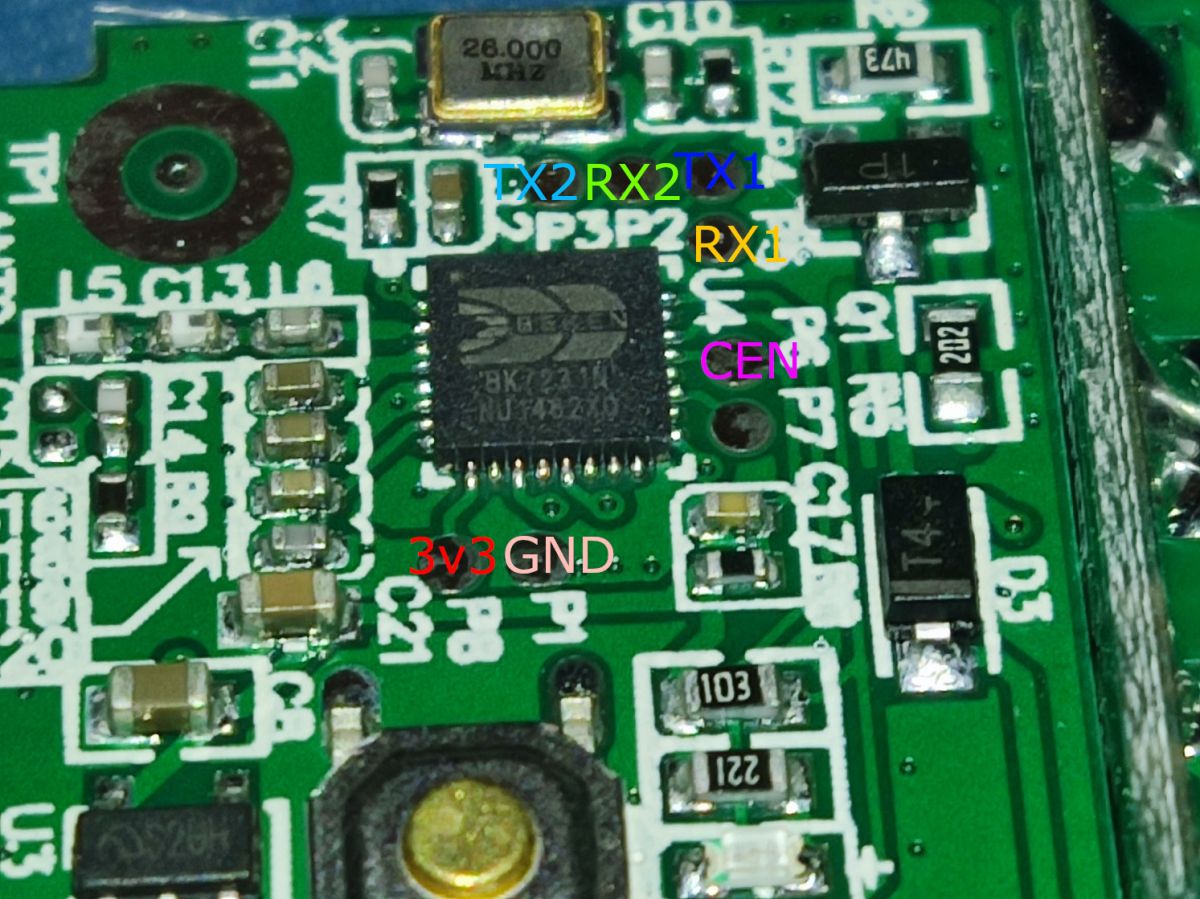

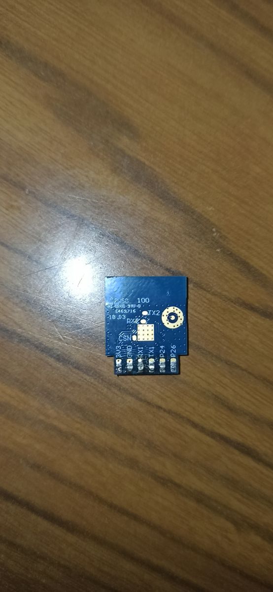

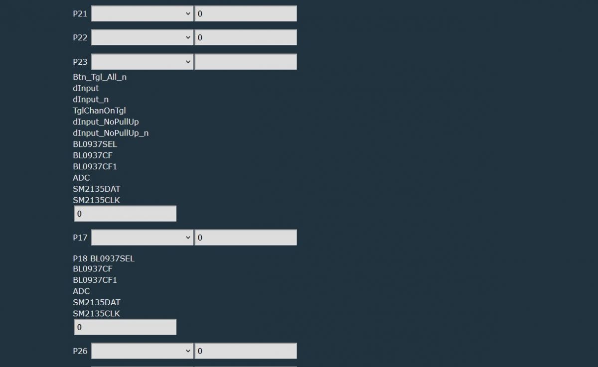

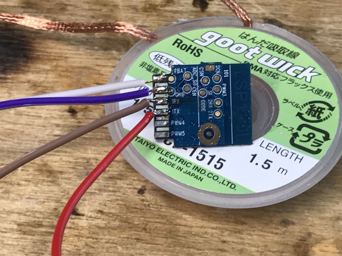

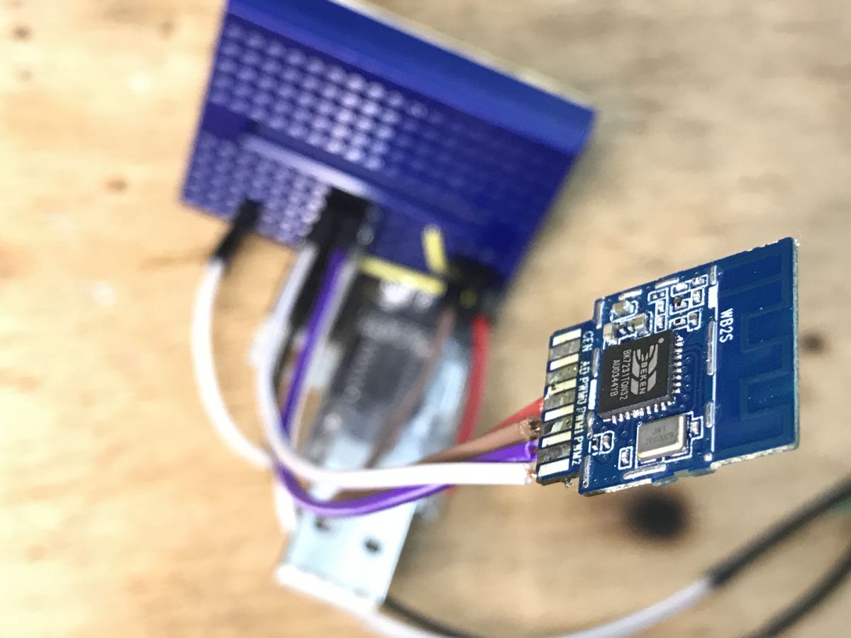

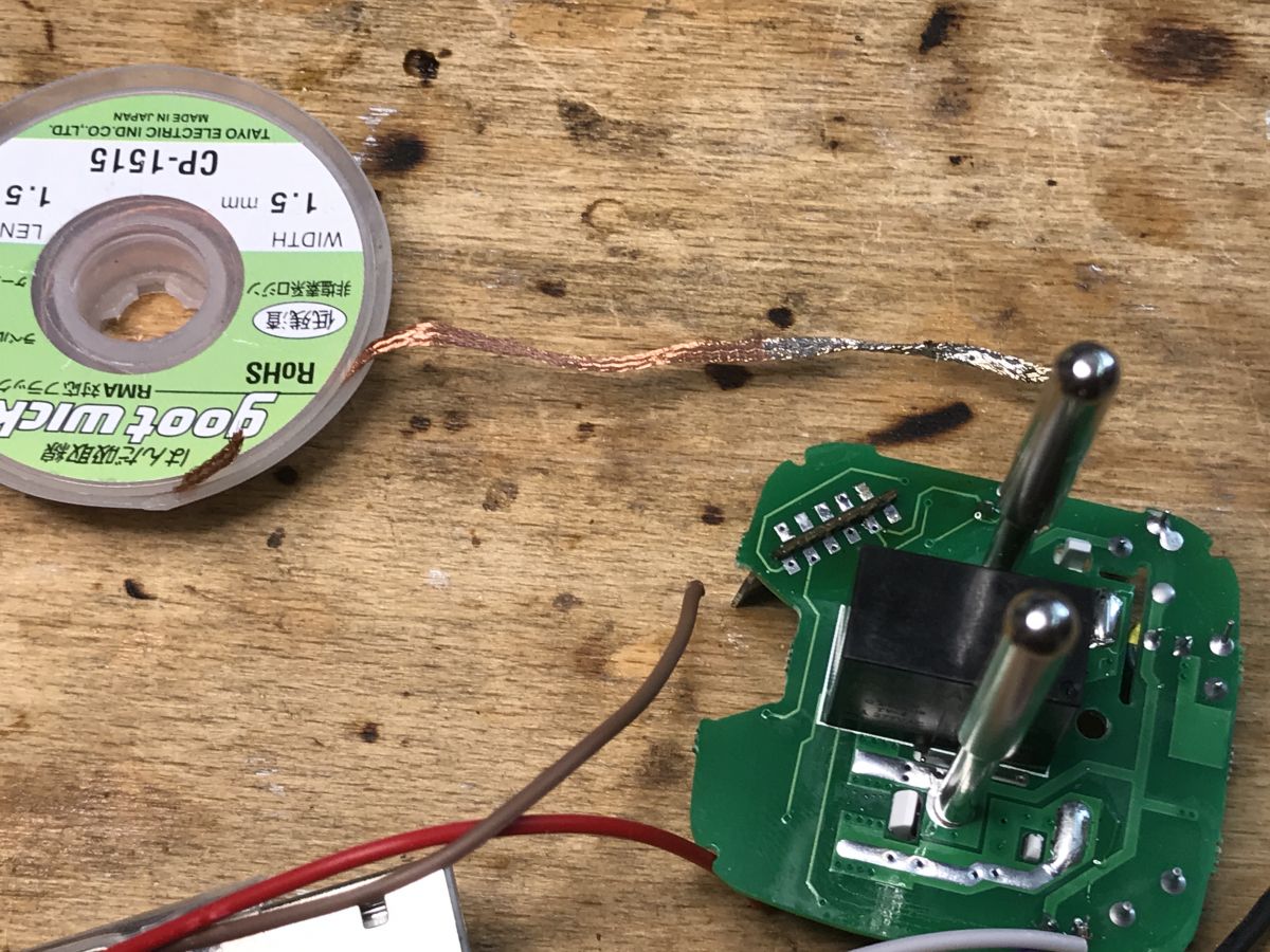

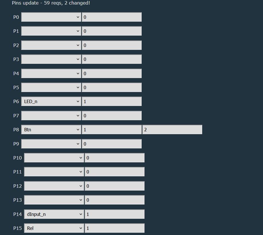

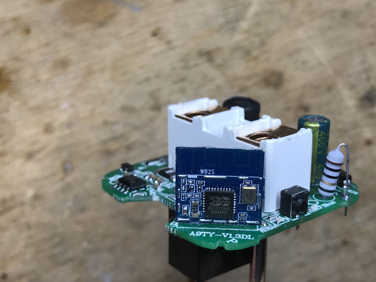

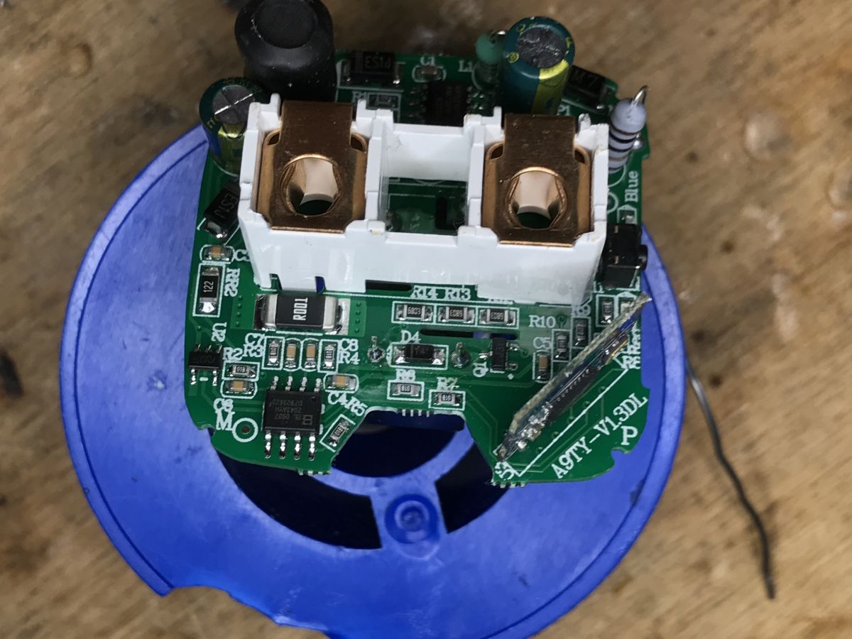

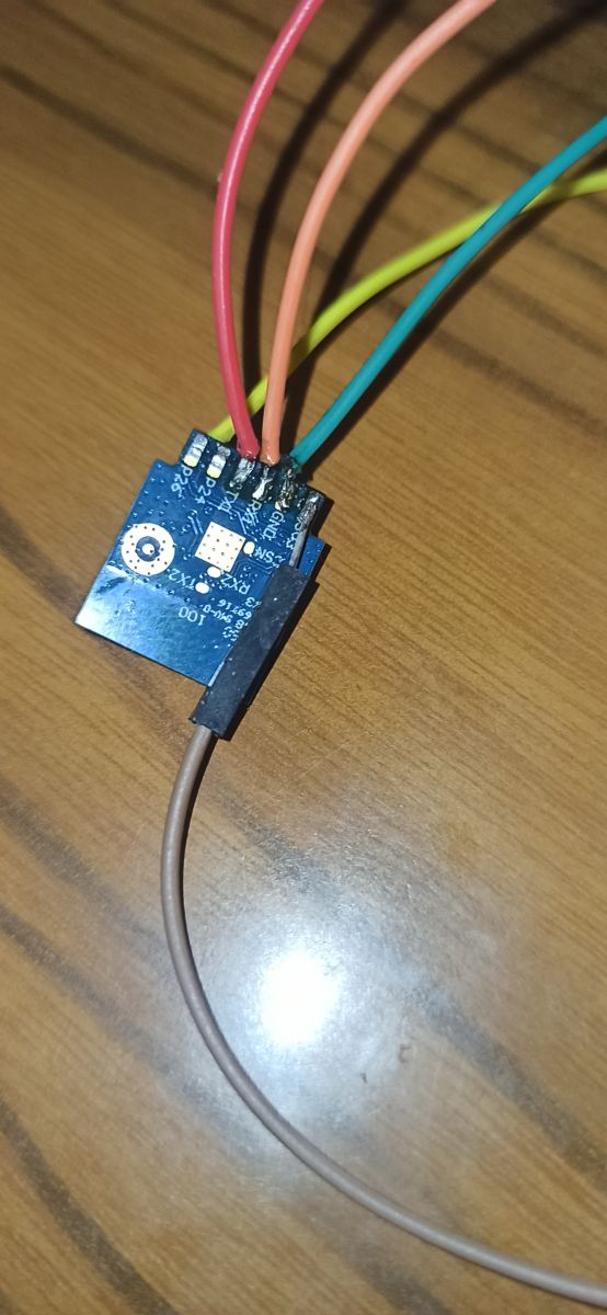

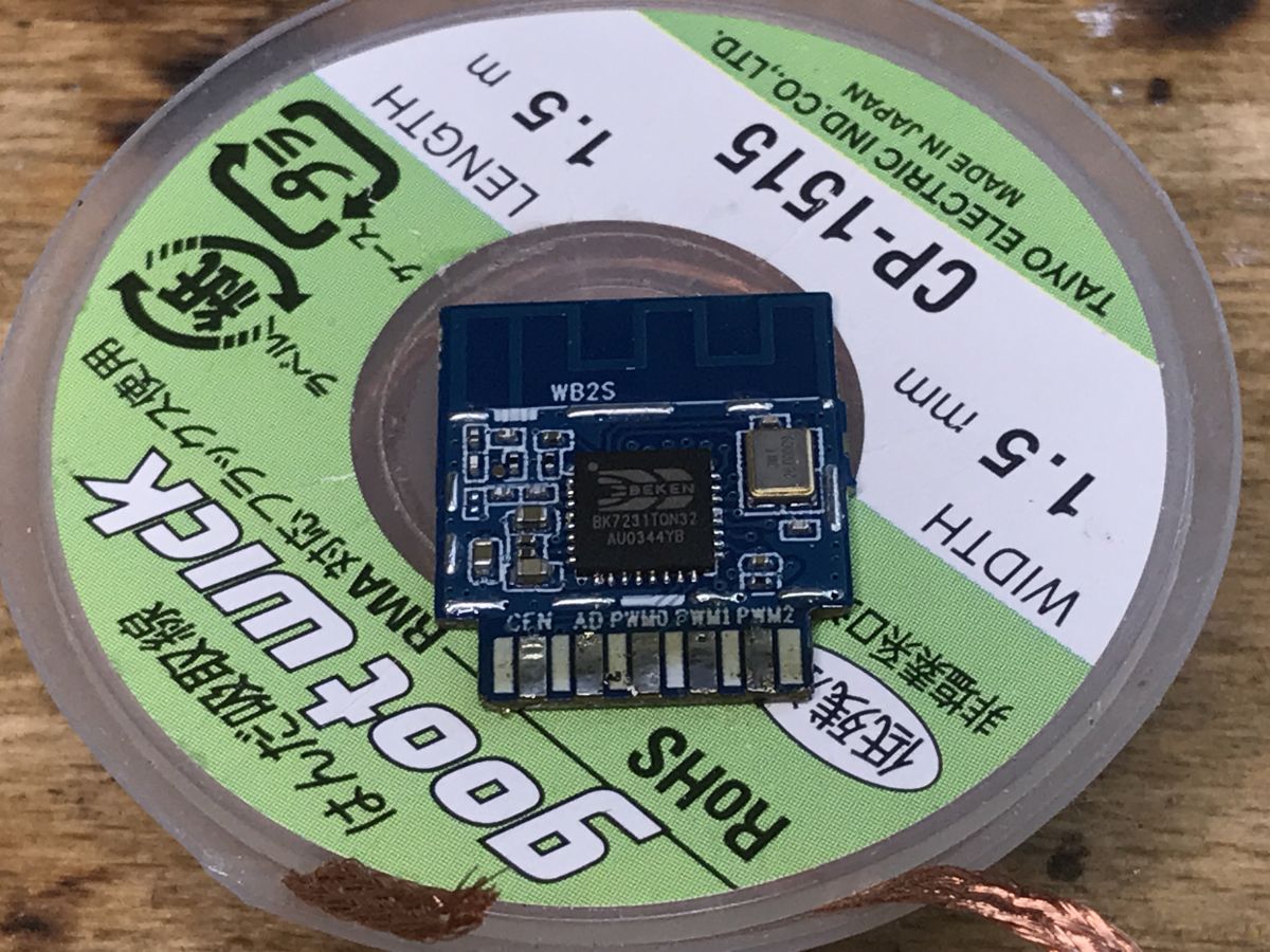

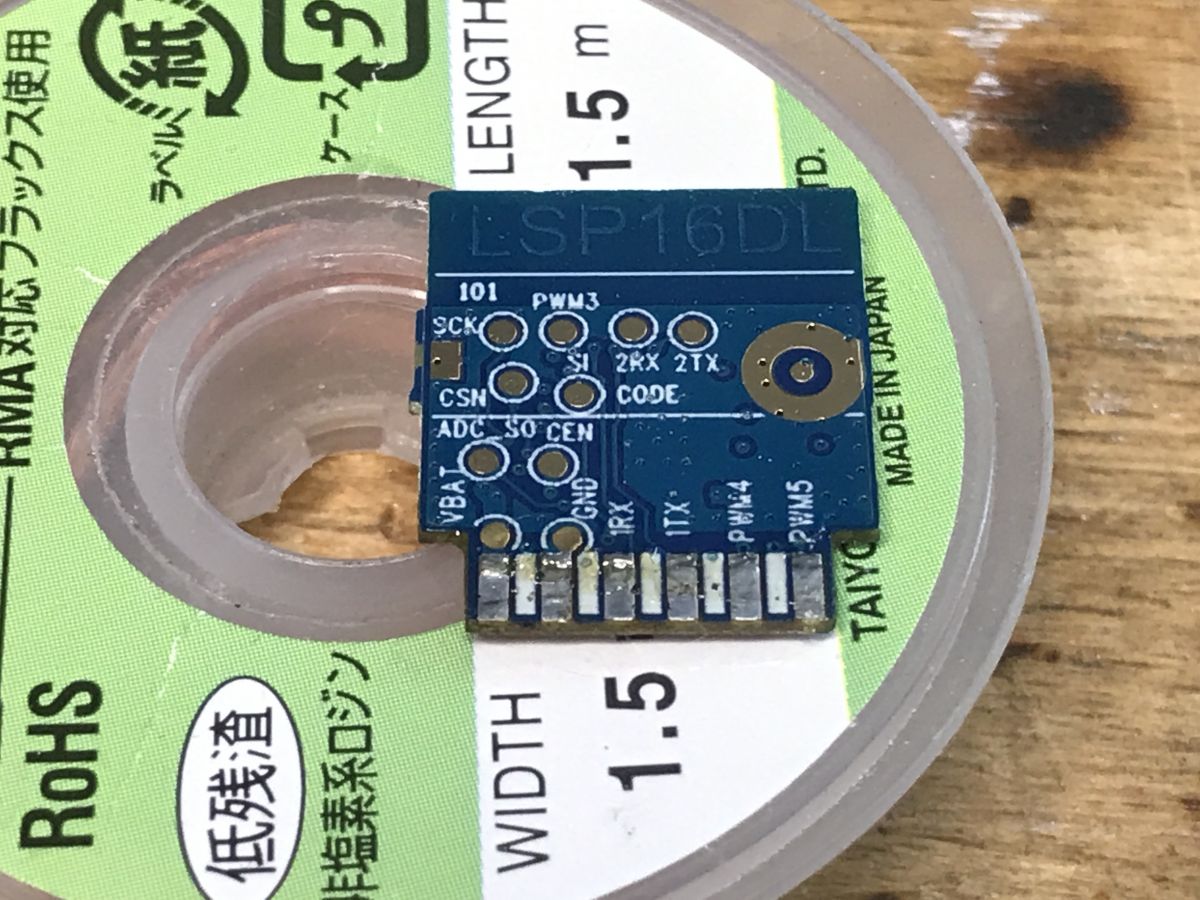

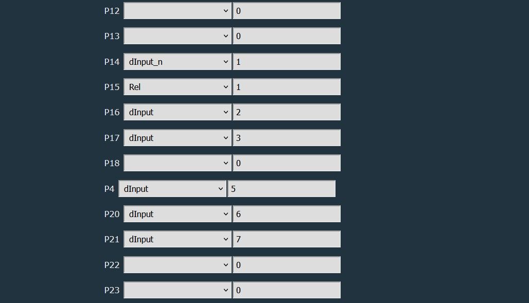

    Maybe this happened because my device have this controller soldered to it's pcb (not as module)
    First boot everything was fully OK. Then i tried to figure out what pins do what and configured some of them(button, led and relay, button was controlling led and relay, looked very promising).
    After that i've rebooted controller and it refused to boot normally. I've rebooted it several times and it booted in safe mod(with AP enabled), I was able to connect, but when I tried to update any pin config - it was rebooting immediatelly. Problems were somehow fixed when I've pressed 'Convert to AP' button in Wifi setiings, after that I was able to update pin settings and Wifi settings - I've even managed to connect it to my home wifi again. But pin settings seemed to be not working anymore, relay and led were not changing their state. And after next reboot it was fully inoperable.
    Also attached PCB photo(with my contact markings) Qiachip Smart Switch - BK7231N / CB2S - interior, programming

    This is an interesting crash, I have never seen it before. I would love to debug it, but it's hard to do that remotely.
    The strange thing is it crashes ever before reading the config.
    Have you used the correct file for the flashing? For N version it's QIO.
    Can you do the following steps?
    1. Do a full 2MB read from 0 offset on your device with hid_download_py and send it to me for analysis
    2. Do you have original flash (full 2MB) saved from Tuya? Can you try reflashing device again with original flash 2MB and then flash OBK again?
    3. If you don't have original 2mb dump, then I could send you some of the stock ones for N so you can do step 2 here

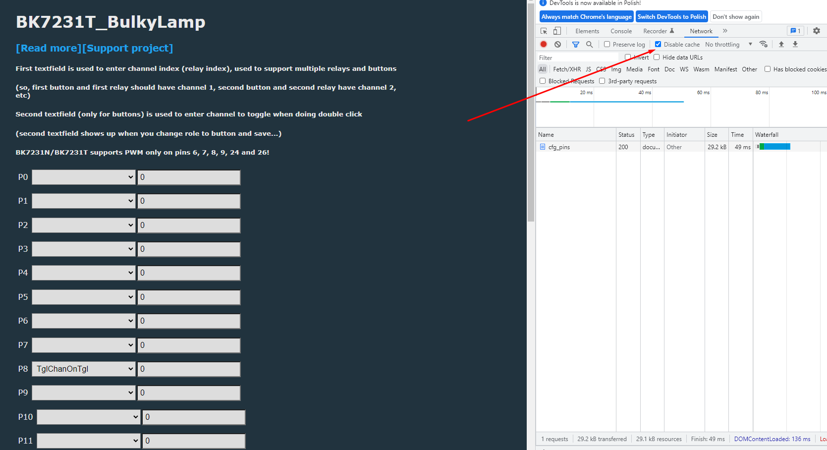

    Have you tried configuring PWM pins before the crash?

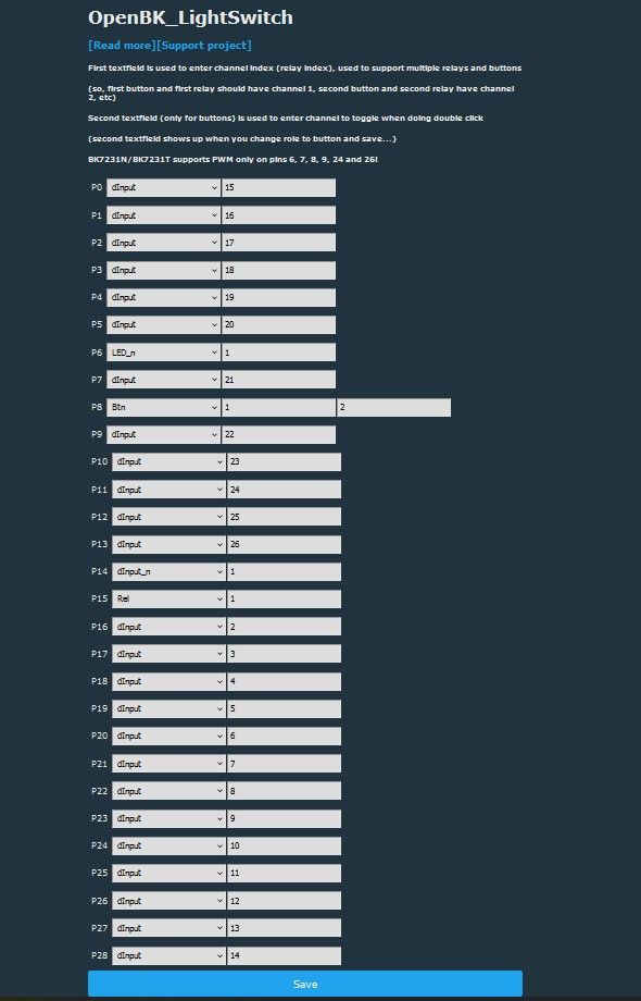

    Yes, problems started after I've configured pins
    Flshed your dump and controller booted fully OK in Wifi AP mod
    Configured my pins and still OK after reboot
  • #38 20125113
    Posts: 14754
    Rate: 12875
    Any news? Can you redo configuration and tell me what breaks stuff?
    I'd like to add some kind of failsafe, but I need to know what breaks.
    But it's very, very strange, because after reboot pins are not started if more than 5 reboots fails (safe mode)
    EDIT: maybe a string buffer overflow error? Have you set any lenghty names? I will double-check if all string sizes are kept at bay
  • Safe mode triggered after MAC restore and pin config

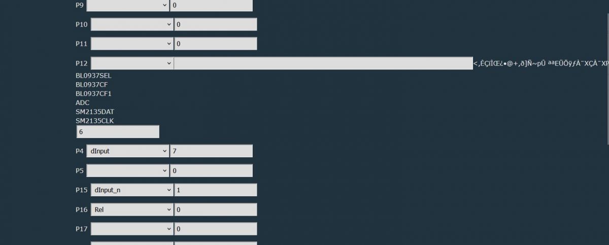

    #39 20125170
    00svd00
    Posts: 26

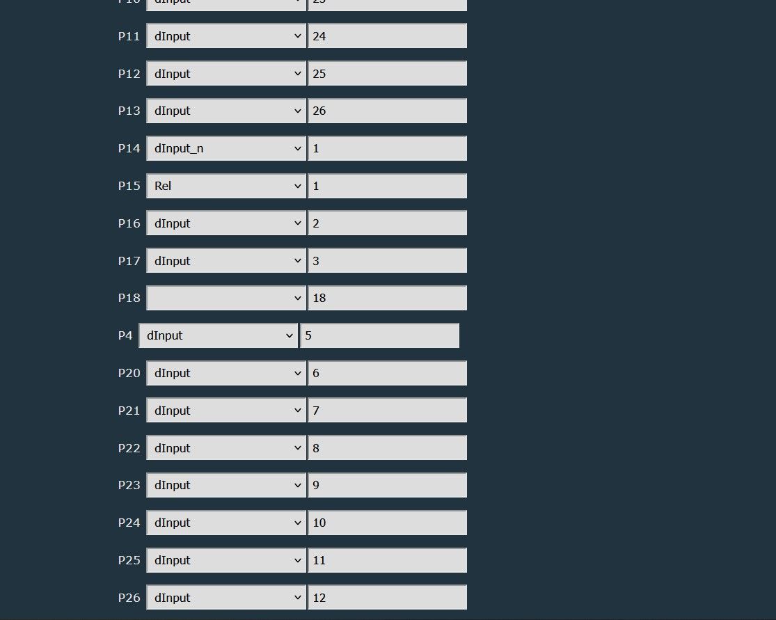

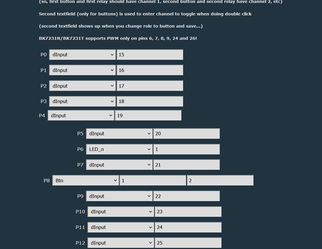

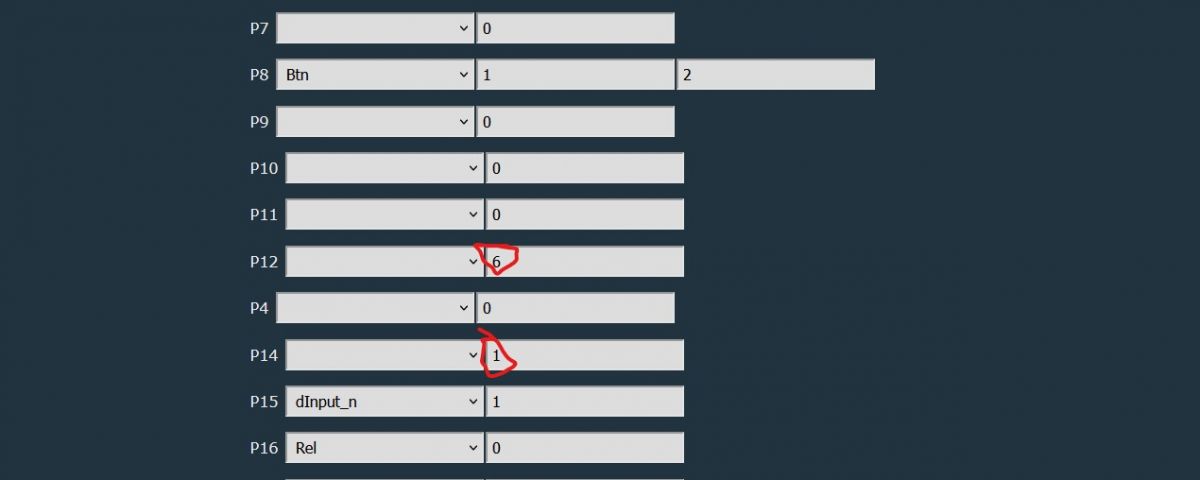

    Everything was great untill I tried to find which pin corespond to external switch input and tried to restore my original mac address. Marked all channels as dInput, found right config, everything was OK.
    Now I see this in serial
    V:BK7231N_1.0.1
    REG:cpsr spsr r13 r14
    SVC:000000D3 00401C1C 000033AC
    IRQ:000000d2 00000010 00401e0c 85fefcfc
    FIR:000000d1 00000010 00401ffc 75d79dae

    Device don't connect to wifi and buttons are not working anymore
    After three reboots it' now on safe mod, will try further
    UPD

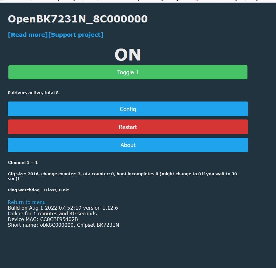

    After connecting in safe mod I've pressed button "Convert to AP" In wifi settings and this happened in serial
    sta: 0, softap: 1, b/g/n
    softap:ssid=OpenBK7231N_8C000000,channel=1,dhcp=1,cipher_type:OPEN

    So I've reflashed everything from scratch
    1.full dump
    2. Your FW
    3. Connected to AP
    4. Restored Mac
    5. Rebooted
    6. Set Wifi settings
    7. Rebooted
    8. Configured pins which I know I can use
    9. Rebooted
    And now everything is OK, at least all buttons work properly

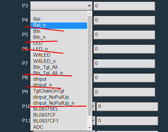

    I think some pins should not be touched EVER in my device, because while configuring pins with RX1 and TX1 connected I saw some activity from TX pin. God knows which registers I've touched

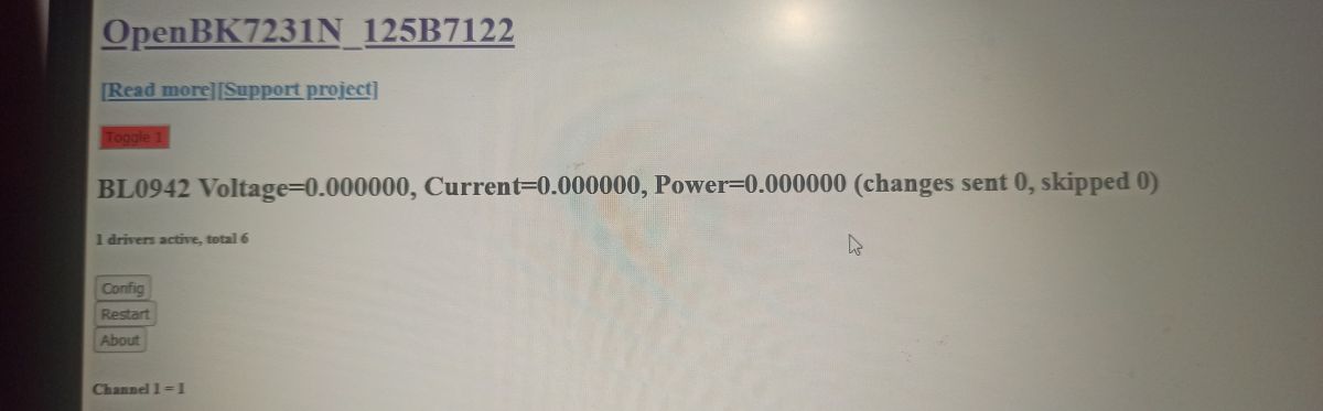

    UPD Is there any possibility to invert condition of this toggle
    It shows thai it's ON but It's OFF
    And also can we disable MQTT fuction? I see it's trying to connect to some host, but I'm not planning to use MQTT(I have another realisation for metrics from my sensors - simple webpage in Prometheus format where Prometheus collects It's data)

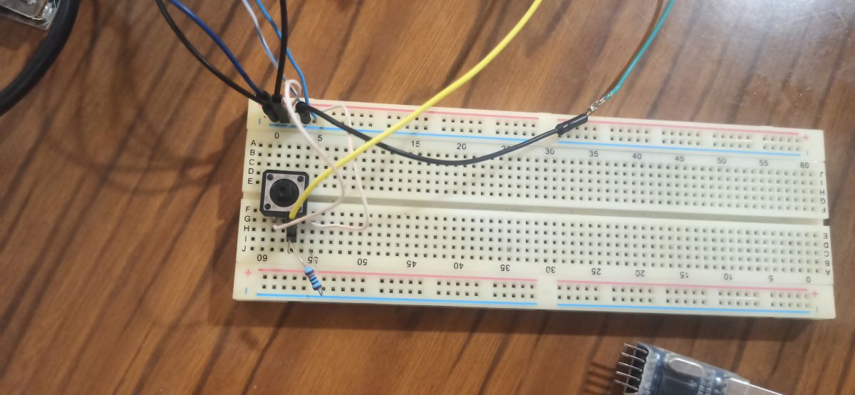

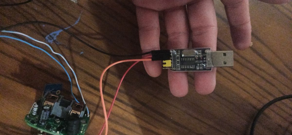

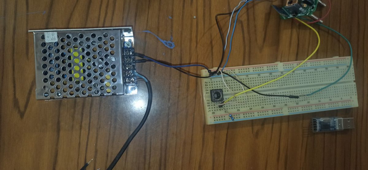

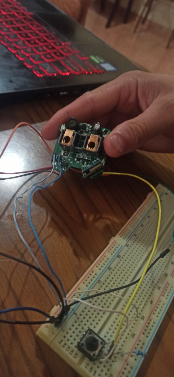

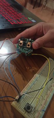

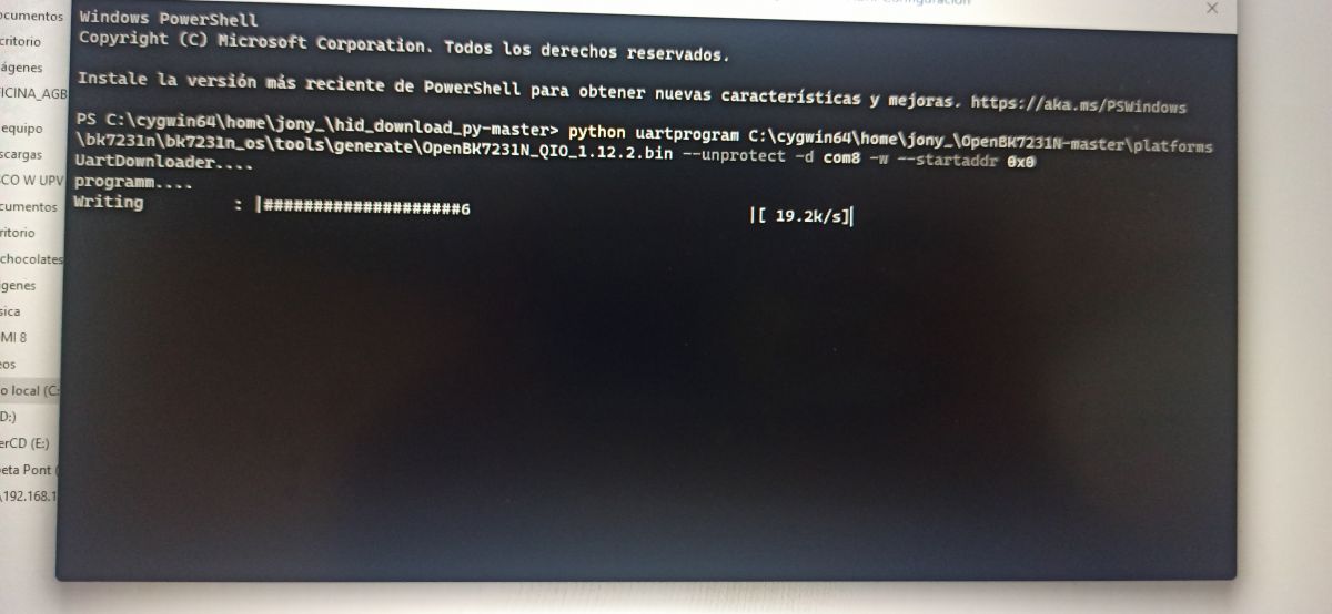

    jony4t
    Posts: 21

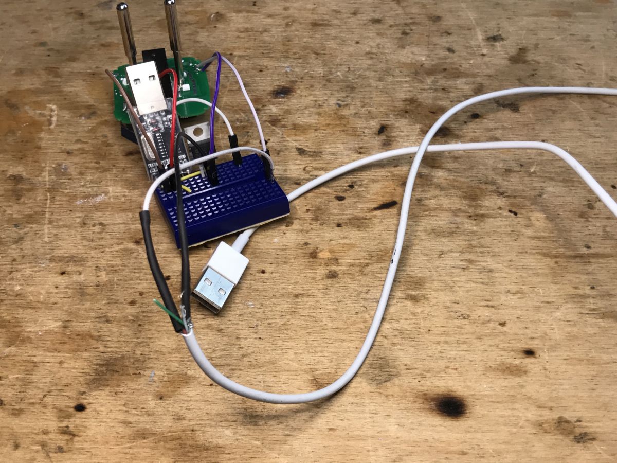

    Hello, I will try my best to help you, but you need to provide more information. There can be multiple reasons for your flashing issues.
    1. Are you doing a proper reboot while the programmer tool is waiting to get bus? You can do this by:
    a) power off and power on the device (NOTE: too large capacitors will overload usb port so it's better to power from external 5V source or remove temporarily said capacitor from board)
    *yes, I use an external power supply*
    b) use CEN pin to RESET (NOTE: this is tricky because it works only if you ground CEN for a certain amount of time, you have to do this for a short while, it always takes me several tries to get right)
    *I have tried in different ways*
    2. Are you connecting to correct RX and TX? Are you connecting RX of USB converter to TX of Beken, and TX of USB to RX of Beken?
    *I have checked*
    3. Are you sure that RX and TX lines used for programming are not "busy"? By "busy" I mean, they could:
    a) be used for TuyaMCU communication. They could have be connected to MCU. In this case you might need to temporary disconnect them, but not always
    b) be used for something like a button with external pull up resistor, and it's the same in this case, you might need to disconnect them temporarily (cut the trace)
    *I don't understand*
    4. Have you tried the second flashing tool? We have bkWriter 1.60 for Windows and the python uartprogram for hid_download_py repository.
    *i am using python uartprogram*
    Please post some photos of your setup. Show how your device look like, how is connected, how you do a reset.
    Qiachip Smart Switch - BK7231N / CB2S - interior, programming Qiachip Smart Switch - BK7231N / CB2S - interior, programming Qiachip Smart Switch - BK7231N / CB2S - interior, programming Qiachip Smart Switch - BK7231N / CB2S - interior, programming Qiachip Smart Switch - BK7231N / CB2S - interior, programming

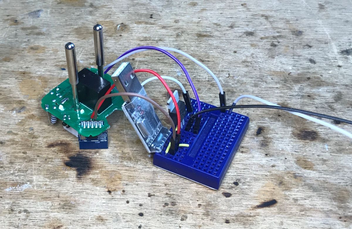

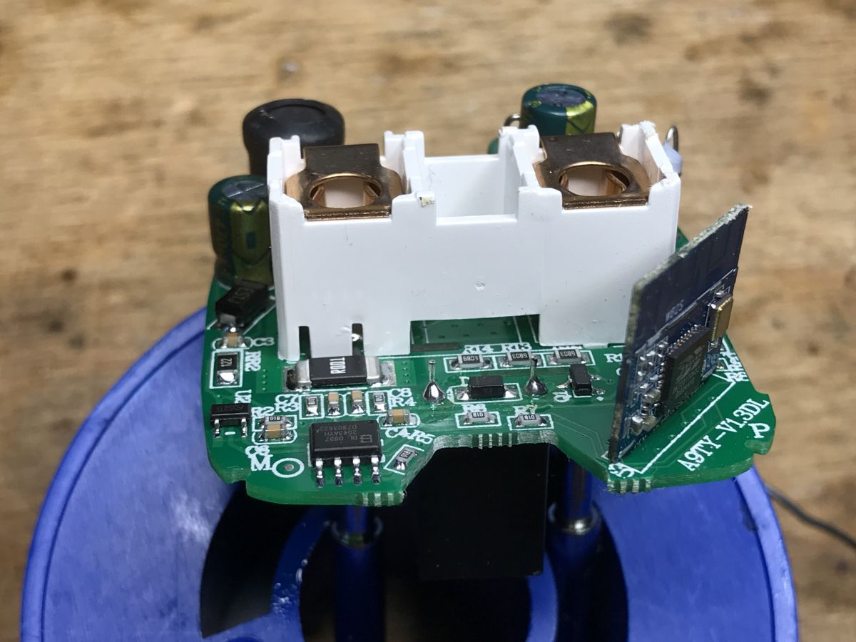

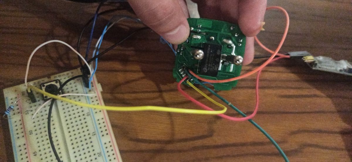

    @00svd00 if you could provide information which pin exactly breaks then I would add a failsafe mechanism.
    Regarding other questions....
    - clearConfig is only in latest build, not in earlier ones
    - you can switch On and Off by using the _N version of pin
    - mqtt tries to connect but it does not hurt, albeit you might try settting mqtt host and names to empty string and tell me if it silences that
    second photo shows a CB2S (or WB2S, not sure) module connected to SOIC8 chip, most likely BL0937 or BL0942:
    I am not sure now, but it might be on RX or TX pin and might be interfering with flashing.
    How good are you soldering skills?
    If you're good at soldering, it wouldn't hurt to check programming module separately.

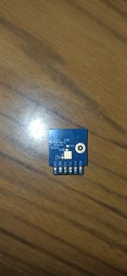

    See, I had this device:
    And that didnt work for me:
    So I did:
  • BL0937 identified and flashing pin interference suspected
    #43 20125341
    jony4t
    Posts: 21
    Yes. it is a BL0937.
    I'm not very good at welding. But I have come to learn. thanks. I will try tonight. Let me tell you.

  • Corrupted config page and commit may be causing hangs

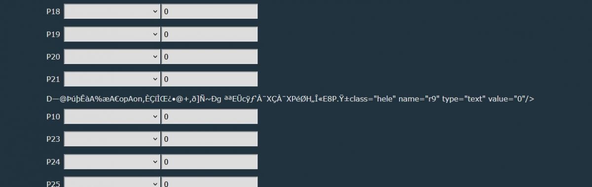

    #44 20125354
    00svd00
    Posts: 26
    Maybe it's not pin-related problem but problem of config commit mechanism.
    Crazy things were hapening when I was trying to find death-trigger for now.
    Ater reloading config page I was sometimes seen things like this
    And this
    And this
    Sometimes config page looked normaly, but was containing numers I've never entered
    Sometimes fields looked normally but their indexes were totally wrong( First P4 after P3 and Second P4 after P13)
    Sometimes controller rebooted while I was truing to access /cfg_pins?, and once it fully hanged until hard reset
    I think if I'll try to save config in this condition - it will lead to unpredictible results
    For now I've tested all pins from P0 to P16 and had no problems, but every time I was refreshing page untill it was fully OK. After saving config I was opening cfg_pins? again to be sure that saved config is fully OK. And I've rebooted after every config change.
    Maybe you'll better add some security mechanism - like counting hash sum of normally loaded config page and adding some JS which will hide all fields if hash mismatch? Or change config mechanism to reading json with precalculated hash? For now my best theory is that my promlebs were bounded with corrupted configuration saved to memory.
    UPD Tried to revert back all changes and on config commit it hanged again. After hard reset everything still OK
    UPD2 I've configured P25 as dInput with channell 11. Double checked it, but after reboot it was configured like this
  • #45 20125447
    Posts: 14754
    Rate: 12875
    I just managed to get the same error, by refreshing the page several times.
    After a small change, I am not able to reproduce the problem any more.
    Can you get latest release from github and check if it still happens for you?
    I am asking because I can't verify myself whether it's just a fluke or my change really helped.

    So for now I can confirm that problem is not bound with pin functions IF config is correct.
    I've managed to configure all pins to do somethong and my device is still able to boot.
    It was not really easy - it was corrupted so many times.
    I also reproduced case when controller hangs on reading pin config - you should refresh page /cfg_pins? while it's still loading.

  • Ctrl+F5 and no-cache meta tags improve refresh reliability
    #50 20125490
    00svd00
    Posts: 26
    Really? Then I might need to look myself at that on N device, because for me, on T, this page is perfect 100% times and I tried refreshing about 50 times
    Still buggy sometimes.
    Maybe you should try to add something like this to head
    <meta http-equiv="Cache-Control" content="no-cache, no-store, must-revalidate" >
    <meta http-equiv="Cache-Control" content="post-check=0, pre-check=0" >
    <meta http-equiv="Cache-Control" content="max-age=0" >
    <meta http-equiv="Cache-Control" content="private0" >
    <meta http-equiv="Pragma" content="no-cache" >
    <meta http-equiv="Expires" content="0" >
    I've noticed that when I refresh page with ctrl+F5 - It works much better
    Also I use this tags in every my ESP32 project with HTTP webserver. It prevents from SO many bugs

    Booted to safe mode - disabled TCP console (It was working earlier, I SWEAR, I was testing it)
    Booted OK
    6. Configure module - got my beloved bug(This time in chromium)
    Reloaded page wtih ctrl+F5 - now it looks normal
    Set my pin config - tested it(Working) - reboot - OK
    7. Set startup value to 0 - reboot - OK (OMG, Why it's working now?)
    8. Rebooted several times with different state - confirmed, it' not a fluke
    9. Set startup value to 1 - reboot - OK (confirmed working now)
    10. Configure watchdog - reboot - OK
    So, seems that for now only really broken thing - is TCP console. Don't know why it was working - maybe some flukes
    And I can cocnlude that garbage from previous FW matters ALOT. Even when I got pin config page bug - the was no symbols from outer space, only broken fields
    • FullFW.bin (2 MB) You must be logged in to download this attachment.
  • Desoldering CB2S enabled successful flashing
    #55 20125906
    jony4t
    Posts: 21
    I have desoldered the cb2s component. me
    i managed to flash
    It works now . thank you
    So I did:

    Found a pretty lifehack. Seems that we can easilly control this with POST and GET requests(at least when we have only one switch configured. If more than one - things become much more complicated)
    For example, if we want to get current switch state - we can do
    curl -s -m 2 -l -r GET 'http://your.device.ip.address/api/channels'
    And if we want for example set this switch to "1" state, we can
    curl -s -m 2 -l -r POST 'http://your.device.ip.address/api/channels' --header 'Content-Type: text/plain' --data-raw '[0,1]'
    For "0" it will be
    curl -s -m 2 -l -r POST 'http://your.device.ip.address/api/channels' --header 'Content-Type: text/plain' --data-raw '[0,0]'
    So I've created example task for Tasker app
    After importing and configuring device ip it could be added as Android home automation widget(Tasker supports this integration)
    • SmartSwitch.tsk.zip (817 Bytes) You must be logged in to download this attachment.

    Can someone write in a few steps how to upload this software to bk7231n? I don`t know anything about programming and I don`t know where to type what and how. These commands are black magic to me
    I have rpi 4. Should I do it in the terminal like I uploaded tape to the sockets from the tutorial?
  • #59 20131892
    Posts: 14754
    Rate: 12875
    Is the problem with connecting the pins or with the console commands?
    Try downloading https://github.com/OpenBekenIOT/hid_download_py , it requires python, and see if it works on your platform. You have a setup file there.
    For Linux it looks like this:
    $ apt install python3-hid python3-serial python3-tqdm
    $ python3 setup.py install --user
  • #60 20132118
    djlukas
    Posts: 1606
    Help: 94
    Rate: 266
    I have no problem in terms of hardware, the pins are soldered and connected to the programmer
    3.3-3.3
    Gnd-gnd
    Tx-rx
    Tx-rx
    Worse with the program. I don`t know if I should do it on a laptop with Windows or on RPI with Linux. I don`t know anything about Linux and unfortunately I don`t know the commands to use in the terminal to download and install this program.
