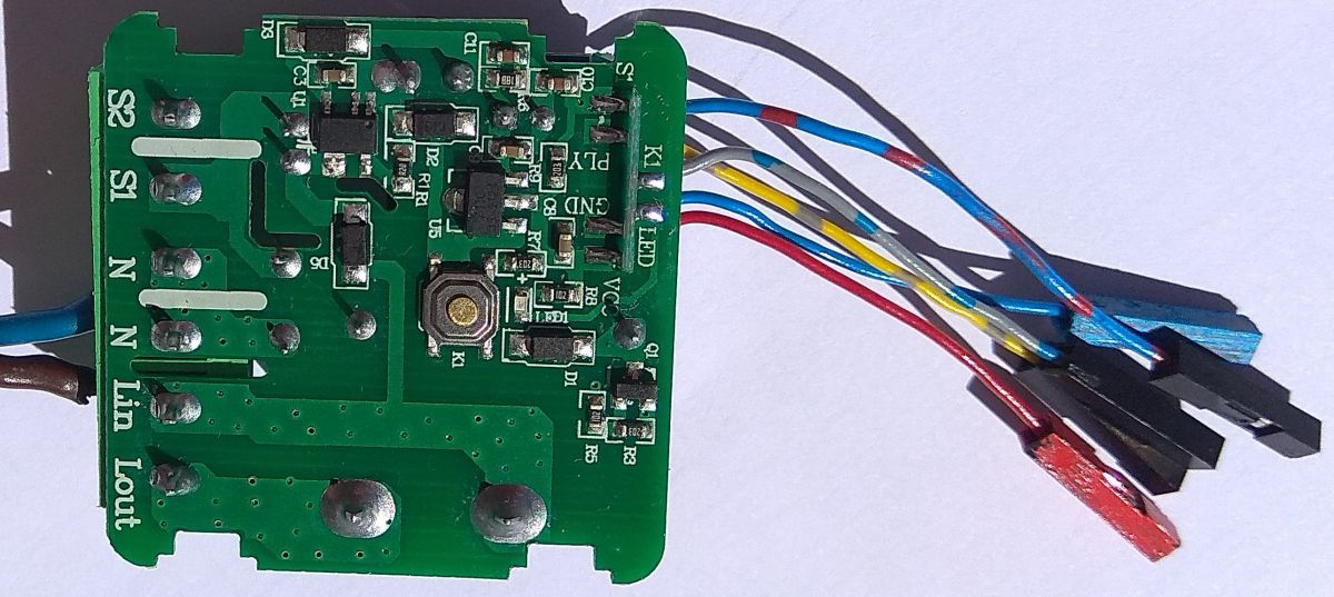

Qiachip Smart Switch - BK7231N / CB2S - interior, programming
p.kaczmarek2 77310 310
  • Qiachip Smart Switch contains a CB2S Wi‑Fi/Bluetooth module based on the BK7231N, not the BK7231T, inside a simple relay board with BP2525 supply and AMS1117 regulator.
  • OpenBK7231N required porting SDK files, fixing Cygwin toolchain use, correcting file names, and resolving a partition conflict caused by RL_SUPPORT_FAST_CONNECT.
  • BKwriter 1.60 failed with CRC verification and unprotect bugs, so flashing used Tuya's hid_download_py with --unprotect, --startaddr 0x0, and a reset on CEN.
  • The QIO firmware uploaded successfully, the configuration AP appeared, and the device can then be managed through 192.168.4.1, MQTT, and Home Assistant.

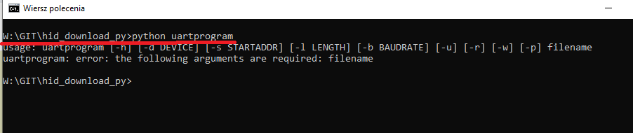

    I downloaded what you told me, ran the install file and something was installed there.
    I managed to install Python on Windows.
    I ran cmd and entered python, now I have this window and I don`t know what to do next

    This way you don`t have to enter the Python console.
    Simply go to the folder where you have the uartprogram in a regular console and execute:
    python uartprogram backup_2mb_default.bin -d com9 -r -l 0x200000
    as a rule, do the same thing but with offset 0:
    python uartprogram backup2_mb_ofs0x0.bin -d com9 -r -s 0x0 -l 0x200000
    And that`s all from the software side for now.

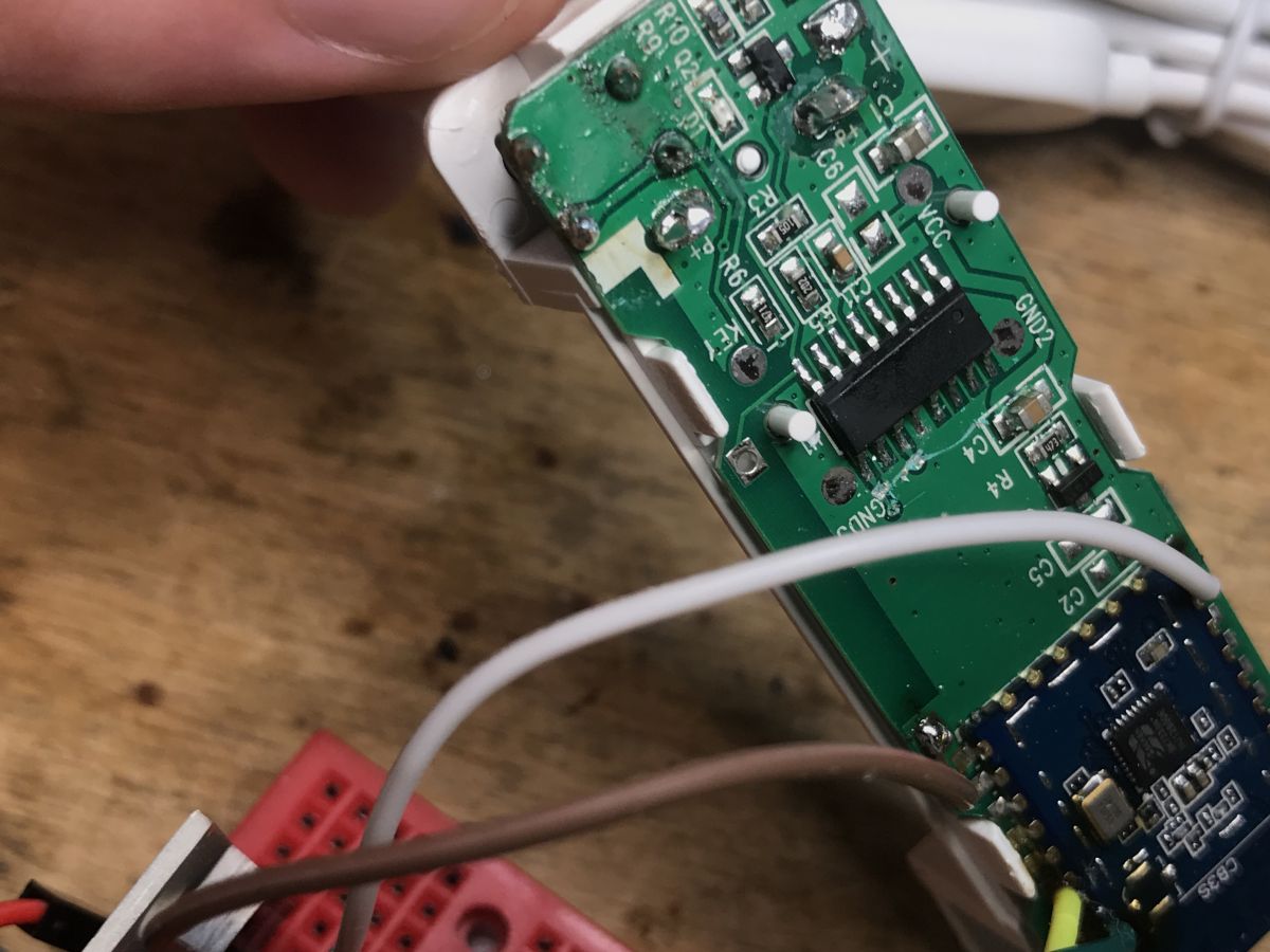

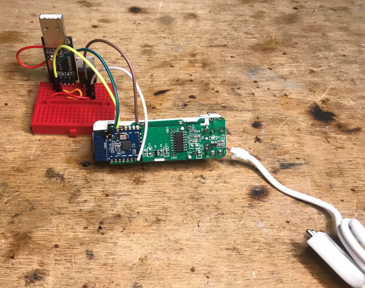

    Well, I see two problems.
    First of all, what is USB to UART? Users reported that the CP2102 did not work, but the CH340 did. Is this CP2102?
    And secondly... it`s probably a door sensor? The one on TuyaMCU?
    Although no, it`s a humidity sensor, but it`s probably also on TuyaMCU...
    The same PCB as in the door opening sensor. I analyzed it, but did not post it on the forum:
    This is a device that consists of a WiFi module (CB3S) and TuyaMCU (microcontroller). The microcontroller runs all the time and only turns on the Wifi module (its power supply) via the transistor when data needs to be sent. TuyaMCU communicates with CB3S via UART (the same one used for programming).
    Look at the photo with my signatures. See two things.
    1. RX and TX lines go to TuyaMCU (microcontroller in SOIC), so it interferes with programming
    2. VDD line (3.3V) to the CB3S module goes through a transistor controlled by TuyaMCU, so TuyaMCU controls the CB3S power supply (so your CB3S is not even powered)
    At the moment, to program it, you would have to unsolder the TuyaMCU (SOIC chip) or interrupt their paths, but this does not fully solve the problem because the protocol of this device is not supported at the moment anyway.
    So anyway, you won`t fully release it for now, you`d have to wait until I add support for it, unless....
    If you are willing to shorten the battery life, you can remove the TuyaMCU completely (then the UART and RX/TX lines will be free) and connect the water sensor directly to CB3S, and modify the CB3S power supply so that it is constantly present. Maybe it would work. But overall, I haven`t had this device yet.

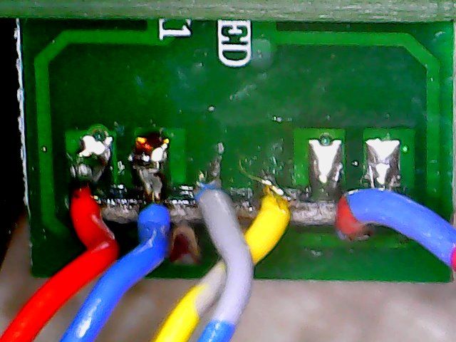

  • #80 20135318
    eazevedo88
    Hello!

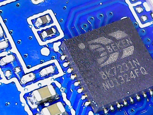

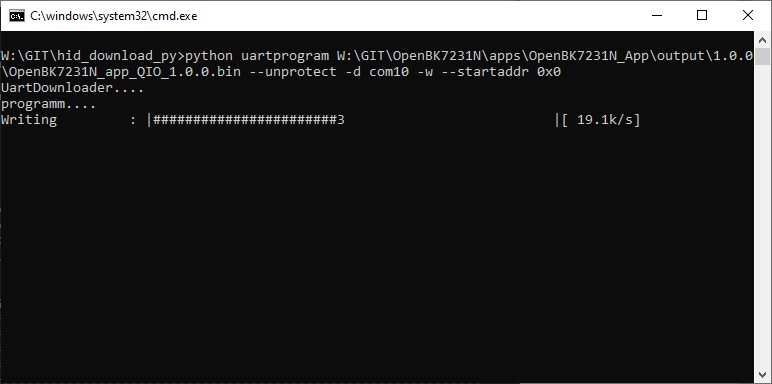

    I have a smart plug using this the "BK7321N" chip model.
    When I was trying to upload firmware, through python, I got stuck on the message : Unprotect Failed
    In Beken Writer it said i successfully uploaded the BIN file. I could also backup and erase flash content but, even saying that there was no error, the hotspot for configuration does not appear on the wifi.
    [edit] *** The Beken Writer just erased the flash, did not uploaded the new firmware*** [edit]
    Is there any procedure I can try to break this chip protection?
    Thanks in advance!
    Added after 1 [hours] 12 [minutes]:
    Made some evolution!
    I changed de baud rate to 115200 and now I can iniciate the writing!
    Now I tried like 50 x and it is the max that it goes.
    [EDIT 2] =========
    WRITE SUCCESSFUL!!
    I changed the UART adapter to the CH341A, and tried different baud rate.
    I got it to work at the rate of 15000. It took about 10 minutes but I got it.
    Thanks!
  • #81 20135718
    Posts: 14388
    Help: 650
    Rate: 12308
    @eazevedo88 good job, but I am wondering, is it a power-metering plug with BL0942 or BL0937 chip?
    EDIT: now looking at your pictures, I am not too much suprised that lower speed helped. In general, the rule is to keep connections as short as possible, especially at higher frequencies it's crucial to avoid the noise that causes communication errors

    I recently bought 2 switches Tuya Mini Smart Switch .
    They work on CB2S. Small [40x40mm], neat, fits into the socket.
    It is relatively easy to solder the pins necessary for re-flashing.
    Flashing itself using hid_download_py/uartprogram is trouble-free with a little practice.
    I have downloaded the original firmware [2M from 0x0] and I can post/send it if it would be useful to someone.
    Many thanks to Mr. Kaczmarek2 great job on the coding and tutorials.

    Hello @ksichu, I think I recognize this switch, isn`t it some version of this?
    https://www.elektroda.pl/rtvforum/topic3895572.html
    The input will definitely be useful, post it here or send it as an issue on github tuya-cloudcutter with a description of what it is exactly (specific product details) so that they can create an OTA hack for this product
    Fixed IP address? I didn`t deal with it from the firmware side because all you need is a MAC reservation on the router , does your router support something like this? This should probably be in the DHCP settings. Check. If not, I`ll think about the static IP...

    ksichu
    Really similar.
    I have different pin functions.
    P7 - LED,
    P8 - Btn,
    P24 - Rel,
    P26 - Btn_Tgl_All
    I took firmware dumps many times and each time they differ by about 20 bytes [apparently in the same place].
    IMO it`s some variable or configuration field...
    I`m including a few just in case.
    As for IP. My router has long since run out of reservation tables ;)
    so if it worked with static_IP, it would be great.
    Regards

    djlukas wrote:
    Ps. The shipment has been sent.
    Thanks to you, I started working on the lower power tuya mcu protocol (version 0x00, not 0x03 as in dimmers):
    Qiachip Smart Switch - BK7231N / CB2S - interior, programming Qiachip Smart Switch - BK7231N / CB2S - interior, programming
    (I also have a copy of the batch)
    We`ll see how it goes. Thanks again for your donation.
    @ksichu thanks for the input, I passed it on.

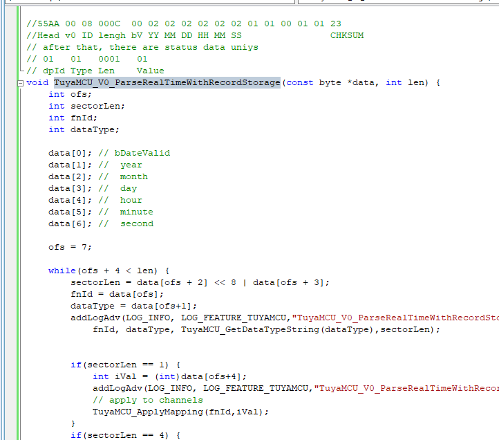

  • #90 20143007
    Posts: 14388
    Help: 650
    Rate: 12308
    @djlukas
    the base works and the sensor now reports variables to HA (more precisely, TuyaMCU reports via UART to CB3S, and CB3S reports to HA via MQTT).
    I found two variables:
    - dpId 1 is 1 or 0 flood status
    - dpId 3 is the battery status (2 full, 1 half??, I don`t know, 0 requires replacement?)
    backlog startDriver tuyaMCU; startDriver tmSensor; linkTuyaMCUOutputToChannel 1 val 1; setChannelType 1 ReadOnly; linkTuyaMCUOutputToChannel 3 val 3; setChannelType 3 ReadOnly;

    By the way, I measured power consumption with and without CB3S running:
    At the moment, there is one problem that needs to be solved, namely, I have the irresistible impression that after I place the sensor in water, TuyaMCU first reports that it is actually wet, and then it seems to "change its mind" and report that it is dry. Maybe I`m interpreting the data incorrectly and/or I`ve got something mixed up, but initially I expected that TuyaMCU wouldn`t "change its mind" until I took the sensor out of the water.
    It`s up to you whether you want to test this unfinished version or wait until I fix all possible problems.
