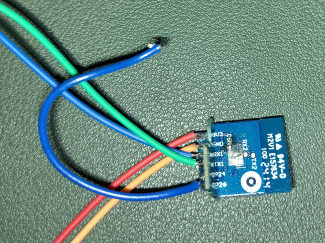

    Hi all.
    I have a problem with flashing.
    I have a BK7231N/CB2S switch trying to read the firmware ends up with me getting a file with 2kB of just 0x00
    Any upload ends up failing.
    I tried to read from the beginning I powered the BK7231N on the board itself:
    ie Rx, Tx, to USB-TTL common GND, +5USB to IN AMS1117 - did not read,
    I decided not to play around - solder the CB2S module itself so 100% nothing would interfere and that didn't help :( .
    Trials were done: converter PL2303, CH340C - no difference,
    software: bk7231flasher_1.0.4 , hid_download_py-master , bk_writer1.60
    hid: tried in different ways, at different speeds.... nothing... simply hands are falling down.
    python uartprogram firmware3.bin -d com11 -b 57600 -r
    pause
    python uartprogram firmware33.bin -d com11 -b 9600 -r
    pause

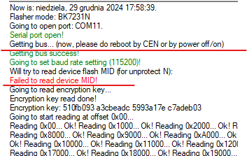

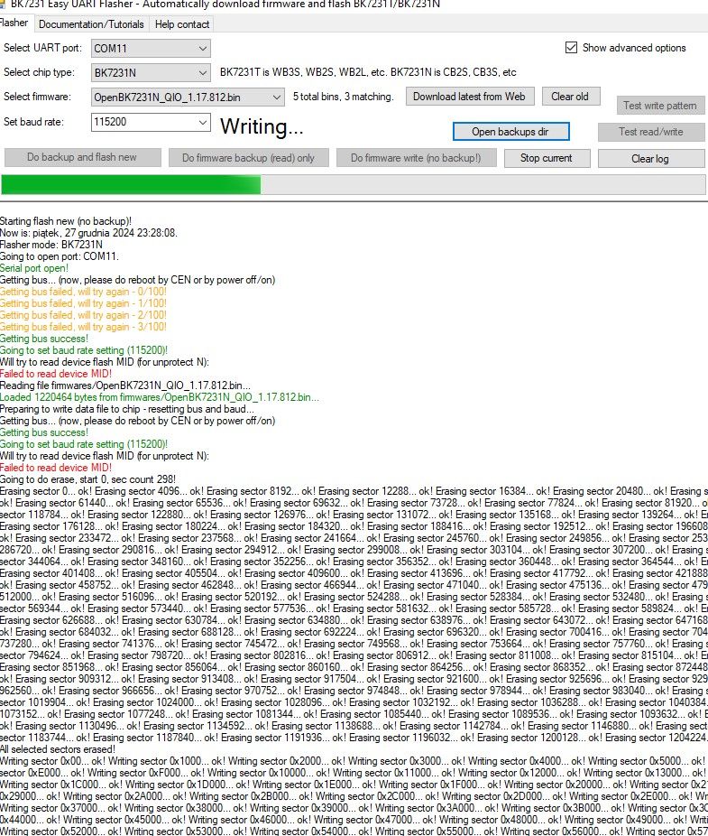

    log for bk7231flasher_1.0.4
    Screenshot of UART flasher program for BK7231N. Screenshot of the BK7231 Easy UART Flasher program showing errors during flashing of the BK7231N module. .
    Screenshot of logs from BK7231N flasher .
    in general, the beginning of Failed to read device MID is bizarre - such a text appears every time.
    Next steps:
    power supply from foreign 3.3V, common GND - same thing,
    OK, I'm thinking - maybe something's hit with this module.... I soldered another one from the same switch - same.
    I soldered the first one back on, start up, SmartLife - found it, works....
    Please help.

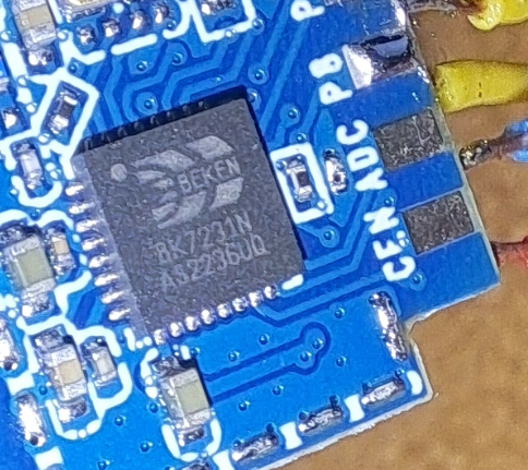

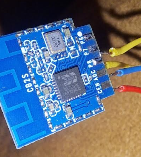

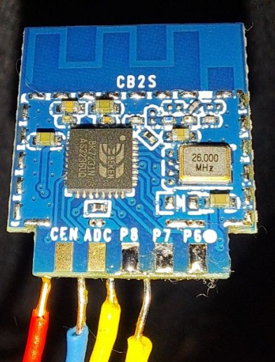

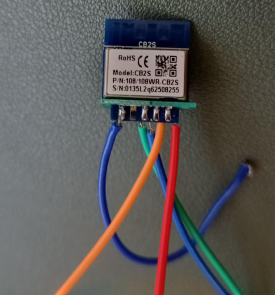

    Just pictures of the module:
    CB2S module with BK7231N chip and connected wires. .
    Close-up of an electronic module featuring a Beken BK7231N chip. .

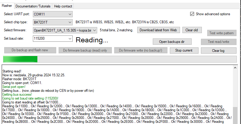

    Or is it a BK7231T in a CB2S housing? Try setting the BK7231T mode and then take a reading. I think I've seen a case like this before.
  • #277 21367525
    m0v0m

    ok. i'm already trying:
    Screenshot of Flasher program reading data from a microcontroller. .
    Screenshot of a flashing program showing a CRC mismatch error message during the BK7231T chip flashing process. .
    But here, if I mark the chyp type as BK7231N - it reads:
    Screenshot of BK7231 Easy UART Flasher program with error message. .
    Screenshot of BK7231 Easy UART Flasher program with Reading success! message. .
    But I read as apparently Null Null Null Null Null....

    Well, it might still be worth trying BK7231M mode....
    What does this CB2S look like? Does it have a metal screen, or without a screen? There is definitely a BK7231N inside?
    I ask because we have already had such cases where there was a CB2S module with, for example, a BK7231M inside.

    Here: above I already added a picture of the module itself: post #275 21367346 29 Dec 2024 15:09
    https://obrazki.elektroda.pl/1060023800_1735482435.png
    https://obrazki.elektroda.pl/2472121000_1735482401.png
    as you can see - no screen, on the chip itself it says BK7231N

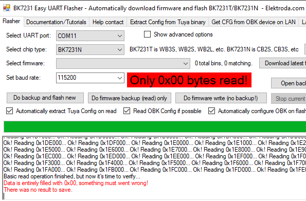

    I downloaded the latest version here: BK7231GUIFlashTool v5 https://github.com/openshwprojects/BK7231GUIFlashTool/releases
    Similar situation:
    Screen of the BK7231 Easy UART Flasher program displaying the message Only 0x00 bytes read. .
    Screenshot of BK7231N flasher application showing a device MID read error.
    I can still come back to note that when the program asks to reset CEN - it often continues reading without grounding CEN. Maybe this is the problem? But the situation doesn't change whether I use power from an external power supply or from USB. It works the same way.

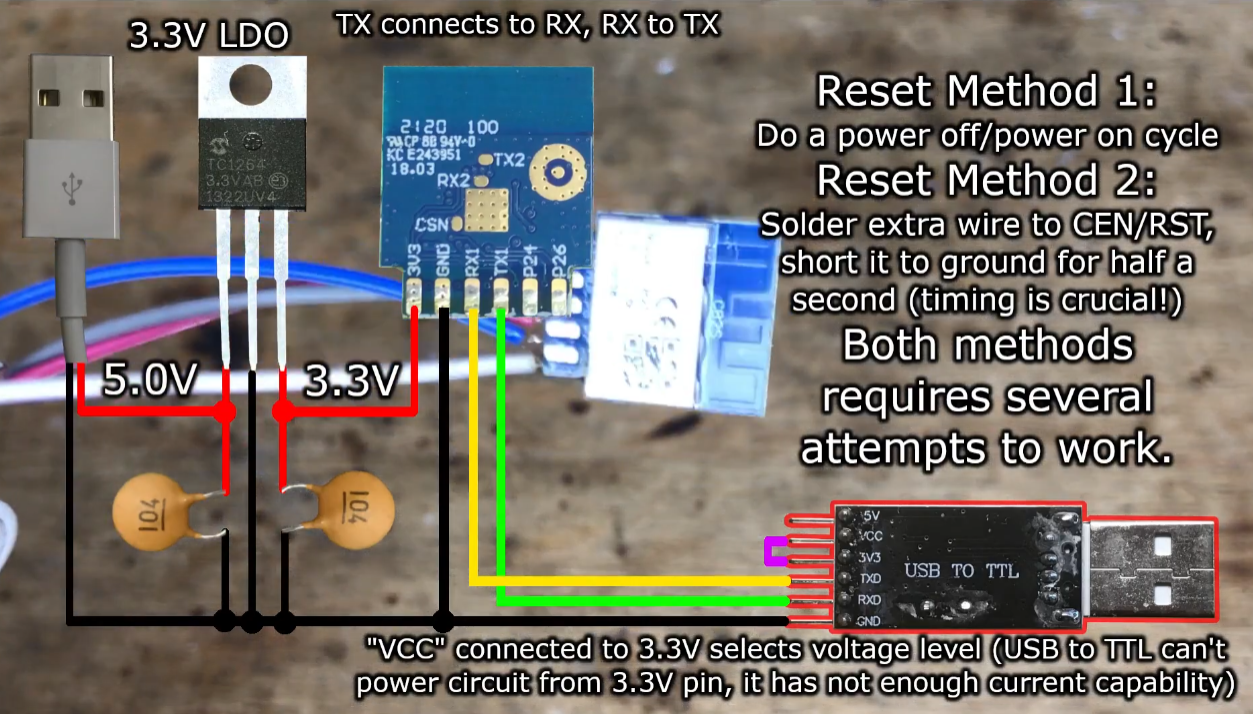

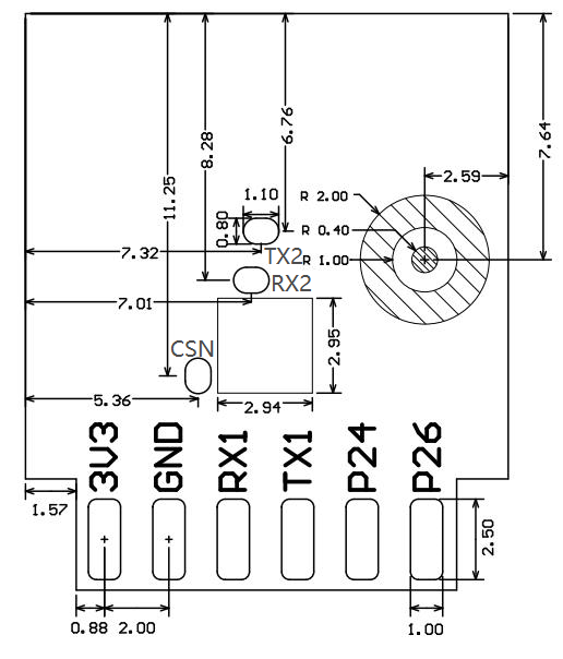

    @m0v0m maybe too long wires or bad USB to UART converter? There have already been reports of such problems on the forum.
    It works for me using this method: https://www.youtube.com/watch?v=YQdR7r6lXRY
    If you are from Poland, and I assume you are, you can also send me the modules to upload the OBK.

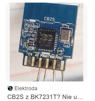

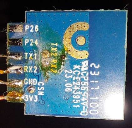

    And I have another idea - did you connect according to:
    Diagram showing the pin layout on a board with labels: 3V3, GND, RX1, TX1, P24, P26, TX2, RX2, CSN. .
    There is a CB2S series on the market with incorrect markings! This can be misleading! Always connect according to the documentation! .
    Yes looking at the photo from the forum:
    CB2S module with BK7231T chip and connectors. .
    ... I guess that's what you have?

    Also check what I wrote about the location of the RX1/TX1 pads. Show a photo from the side of those pads.
  • #287 21372605
    m0v0m
    Posts: 8
    Welcome everyone to the New Year :) .
    This is what the module looks like (sorry for the uncleared top):
    Close-up of an electronic module with visible pins and labels. .
    Uncleaned electronic module with visible connectors and labeled CB2S. .

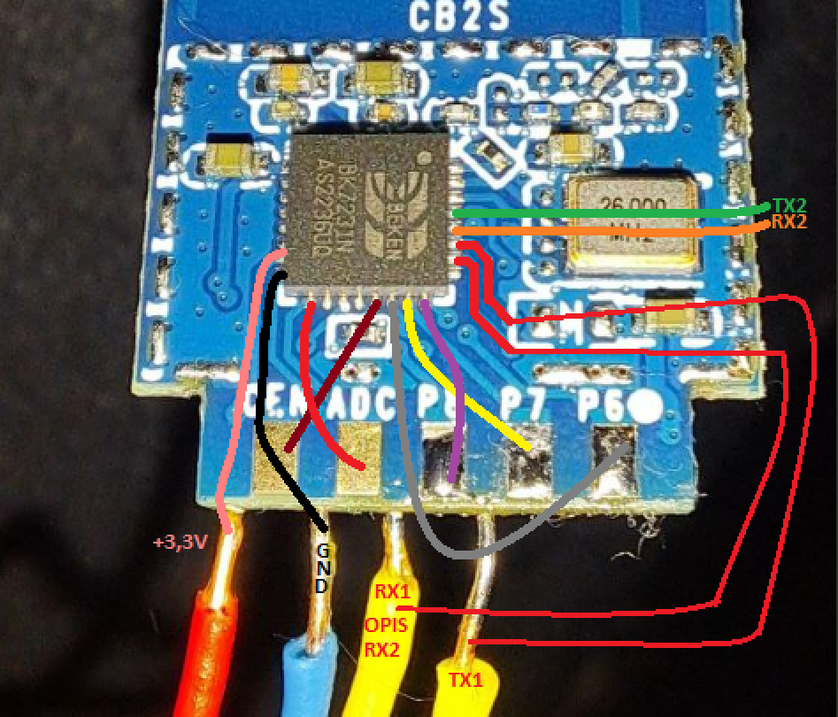

    Exactly:
    DESCRIPTION +3.3V in truth is P24
    DESCRIPTION of GND in truth is P26
    Image of an electronic module with wires labeled in different colors, indicating connections such as +3.3V, GND, RX, and TX. .
    Rx Tx as seen in the pictures

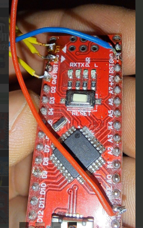

    And the next iteration - trying to use the programmer from the Arduino Nano:
    Close-up of an electronic module in hand. .
    Close-up of an Arduino Nano module with attached wires. .
    I trimmed the sticks for the Atmega.
    But that didn't work either. :(
  • #288 21372640
    Posts: 14622
    Help: 655
    Rate: 12637
    So it's not as I wrote? Plus those RX2s twice...
    Compare for yourself:
    Close-up of a CB2S board with TX2 and RX2 labels and a pinout diagram. .
    See this topic, identical situation:
    Flashing OpenBK on CB2S using BK7231Flasher - connection problems .
    Read the linked material and connect the programmer according to the correct leads.
  • #289 21373187
    m0v0m
    Posts: 8
    Thank you.
    You were 100% right I made a mistake - I didn't check the pins.
    Close-up of a circuit board with pins labeled 3.3V, GND, RX1, TX1, P24, P26. .
    After proper connection frimware uploaded flawlessly.

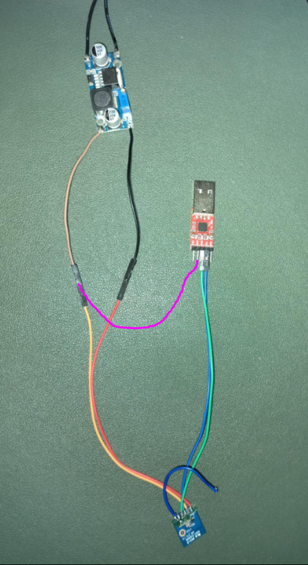

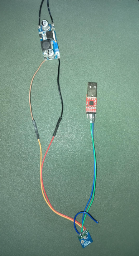

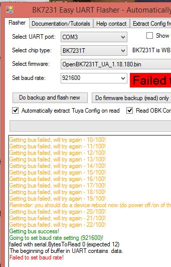

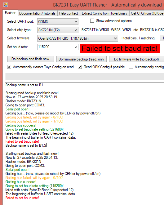

    Hey,

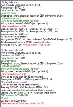

    CB2S connected to UART CH9102 on RX and TX ports
    External power supply 3.3V after LM2596 (12V input)
    I checked RX and TX ports on CB2S - OK 3V3|GND|RX|TX|P24|P26

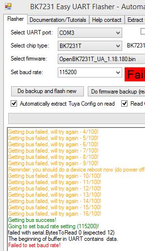

    I am trying to upload OpenBeken to the CB2S but I encounter some problems every now and then.
    I had this problem earlier on the same settings:
    Now is: 27 września 2025 09:55:49.
    Flasher mode: BK7231N
    Going to open port: COM3.
    Serial port open!
    Getting bus failed, will try again - 0/100!
    Getting bus failed, will try again - 1/100!
    Getting bus failed, will try again - 2/100!
    Getting bus success!
    Going to set baud rate setting (115200)!
    failed with serial.BytesToRead 0 (expected 15)
    The beginning of buffer in UART contains  data.
    Failed to read device MID!
    Going to read encryption key...
    CheckRespond_WriteReg: ERROR
    CheckRespond_FlashReadSR: bad value returned?

    I also tested with the "M" option but that didn't go either. Currently it is a baud rate problem but none works:
    Screenshot of BK7231 Easy UART Flasher showing “Failed to set baud rate” error .
    Screenshot of BK7231 Easy UART Flasher showing error setting baud rate during flashing. .
    Screenshot of BK7231 Easy UART Flasher showing “Failed to set baud rate!” error .
    Screenshot of BK7231 Easy UART Flasher showing UART communication errors .
    I don't know what's wrong ...

    Show a photo of the whole.
    Or is there something on the RX/TX pins from CB2S, such as a capacitor?
  • #292 21702678
    Cutin
    Posts: 92
    Rate: 11
    >>21702620 .
    RX/TX cables 13 cm long
    CB2S module with 13 cm RX/TX wires soldered to pins Wire from RX/TX length 13 cm.
    RX/TX wires 13 cm long connected to USB-UART and voltage converter modules .
    Electronic module with soldered RX/TX wires on a green textured background .
  • #293 21702689
    Posts: 14622
    Help: 655
    Rate: 12637
    And did you flash the other CB2S correctly? A bit long for those wires.

    >>21702689 .
    I understand, no, the ground is separate. I have to make a bridge like in the picture ?
    Wiring setup showing ground bridge marked with a pink wire .
  • #296 21702720
    Posts: 14622
    Help: 655
    Rate: 12637
    I can't clearly see what's in the picture and I'm not familiar with this USB to UART converter. I don't know which pin of it in the picture you have drawn a line to. Simply GND (colloquially minus) is supposed to be common.
    Connection diagram with USB to TTL converter, module, and 3.3V voltage regulator
  • #297 21702888
    Tilator
    Posts: 133
    Rate: 13
    The purple wire looks odd.
    It should connect your TTL adapter 3,3V pin to the same adapter pin between 3,3V and 5V pins.
    Adapter itself does not need external power. It only needs to know if 3,3V or 5V voltage is used for the signaling.

    A bit long these wires.
    Although... Are you connecting the common ground? Because if not, that's a basic mistake. The ground must be common. Otherwise the signals have no reference point.
    You have helped to solve this problem, as it was the lack of common ground that was the cause. It worked out fine on the same cables.
    The interesting thing is that I initially chose the "N" option , which did not work ...
