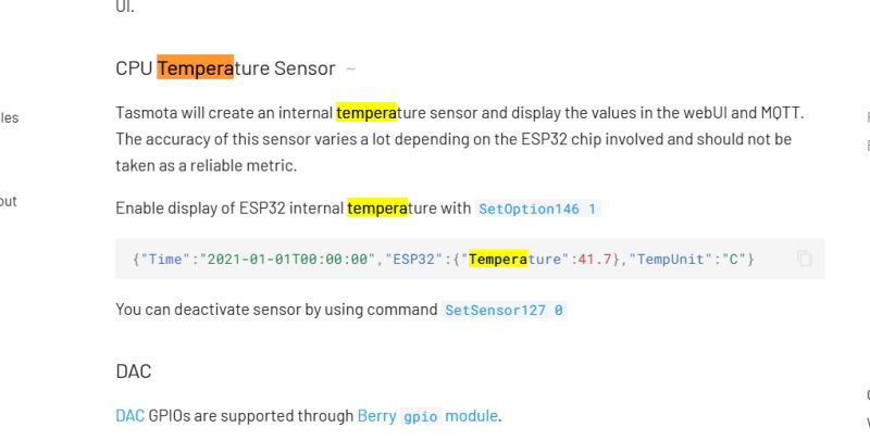

    We've been considering enabling powersave by default but there were some reports (in the early years) saying that it causes problems....
    We can add temperature in tasmota json, isn't it currently included there? @max4elektroda
  • #305 21707775
    max4elektroda
    Posts: 754
    Help: 48
    Rate: 187

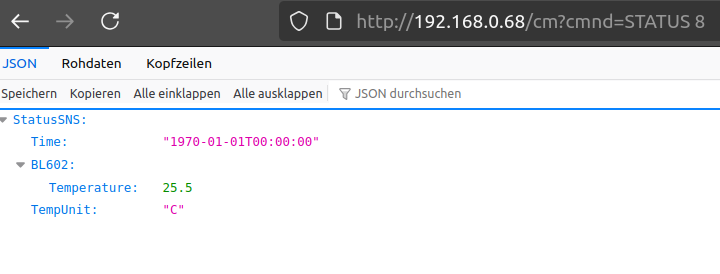

    The Chip temperature is in fact only shown in MQTT and not as a "sensor" in JSON "SSN" status.
    We might add it there, but it would not be following Tasmota then ;-).
    Just kidding - what would you propose as sensor name? "Chip" - "MCU" - "internal" ... ???

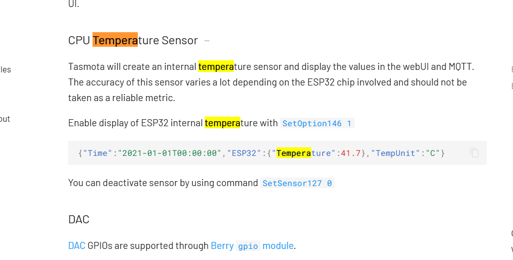

    This is good question. Should we... fake it and use ESP32 so Tasmota apps can read it?
  • #309 21707993
    max4elektroda
    Posts: 754
    Help: 48
    Rate: 187
    I would not. In the end it's just the "sensors" name. But you decide :-)
    And: shall it be present in any case, or make it configurable?
  • #310 21707997
    Posts: 14611
    Help: 654
    Rate: 12623
    Always show it, we don't have flash space to add configuration option, and I don't think it can hurt to show it. So probably use ESP32 name, so apps working with Tasmota can work

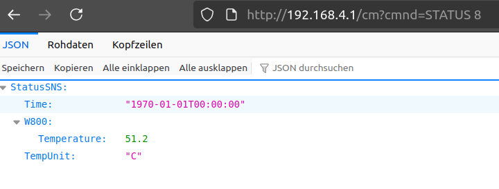

  • #311 21709766
    max4elektroda
    Posts: 754
    Help: 48
    Rate: 187
    PR changed, will always use "ESP32" as "sensor":
    E.G. on an BL602:
    max@max-PC:~$ curl  -w '\n' "http://192.168.0.68/cm?cmnd=STATUS%208"
    {"StatusSNS":{"Time":"1970-01-01T00:00:00","ESP32":{"Temperature": 27.3},"TempUnit":"C"}}
