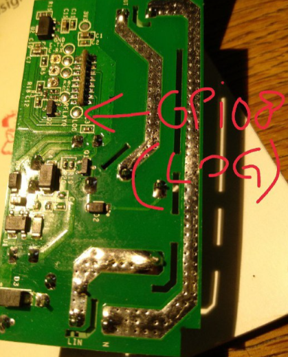

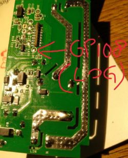

  • GPIO8 traced to the LOG solder pad
    #182 20261071
    francwalter
    Posts: 17

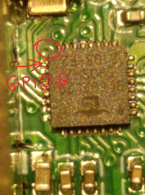

    Hello @Maniac2002 . I will try to help you here. You need to find BOOT pin, which is, unless I'm much mistaken, the GPIO8.
    Please refer to this schematic: (this is another board)
    Tasmota replacement for BL602, programming, pairing with Home Assistant, now with OTA working!
    I have composed an image for you. The dot marks the first pin. See where GPIO8 is:
    Now, my question is, where does the via goes with GPIO8? Can you look at the other side of the board? Where is this PCB track connected? I can't clearly see it on your photos...
    Maybe you can check with multimeter where does GPIO8 goes?
    Hallo @p.kaczmarek2 I think I could take it from here, as @Maniac2002 didnt post anymore about the Boot-Pin - hopefully he was not electrocuted by opening this Switch-WF ;-)
    I had bought the same switches (4x ebay nr. e.g.: 314044964133), I had bought them in the thought they were sonoff (Tasmota flashable). In Discord the very helpful "sfromis" pointed me to your work.
    Now I found your great entry how to flash them BL602 chips :) Thank you already for the big and thorough work!!!
    I will look (and measure) where the GPIO8 goes to on the board. I have to open it again, my photos are not good enough.

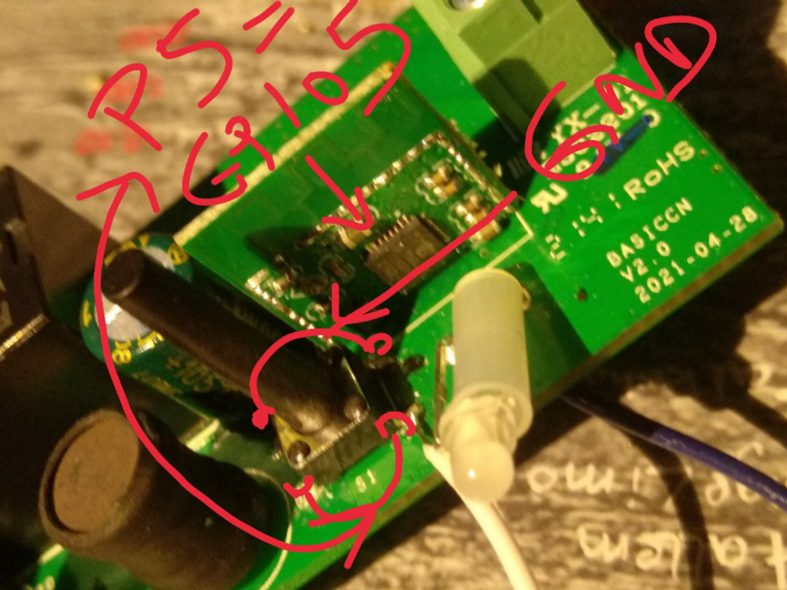

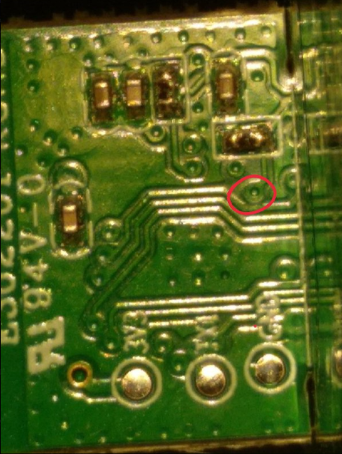

    Hier some pics (after I soldered the LED out to get sight on to the chip daughter-board):
    As you say, the GPIO8 is near the Quartz at the border. I made a red circle around a point, just to show its position on the other side:
    Here the position from the other side (its is not the GPIO8, I think, it is just a spot, which is on both sides, which helps me to find the position, but anyway, it didnt help, I used my multimeter and try and error):
    and I measured it (with difficulties, because so small contact) to the soldering spot where I read "LOG":

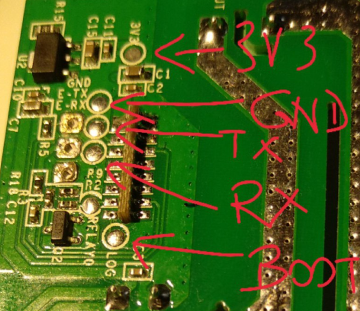

    So the GPIO8 (Boot) Pin is, as I think, just the LOG soldering-spot on the backside, so these should be the 5 interesting spots:
    Is this realistic or could I be totally wrong?
    The GND, RX, TX marks on the backside of the board are not directly beside the spots, but on a space where it could be printed, so I guess they are in order of the soldering-spots and right, right?
    Thank in advance.
    Please give me green light to flashem :)
    Edit: without an answer I will try to flash anyway ;)

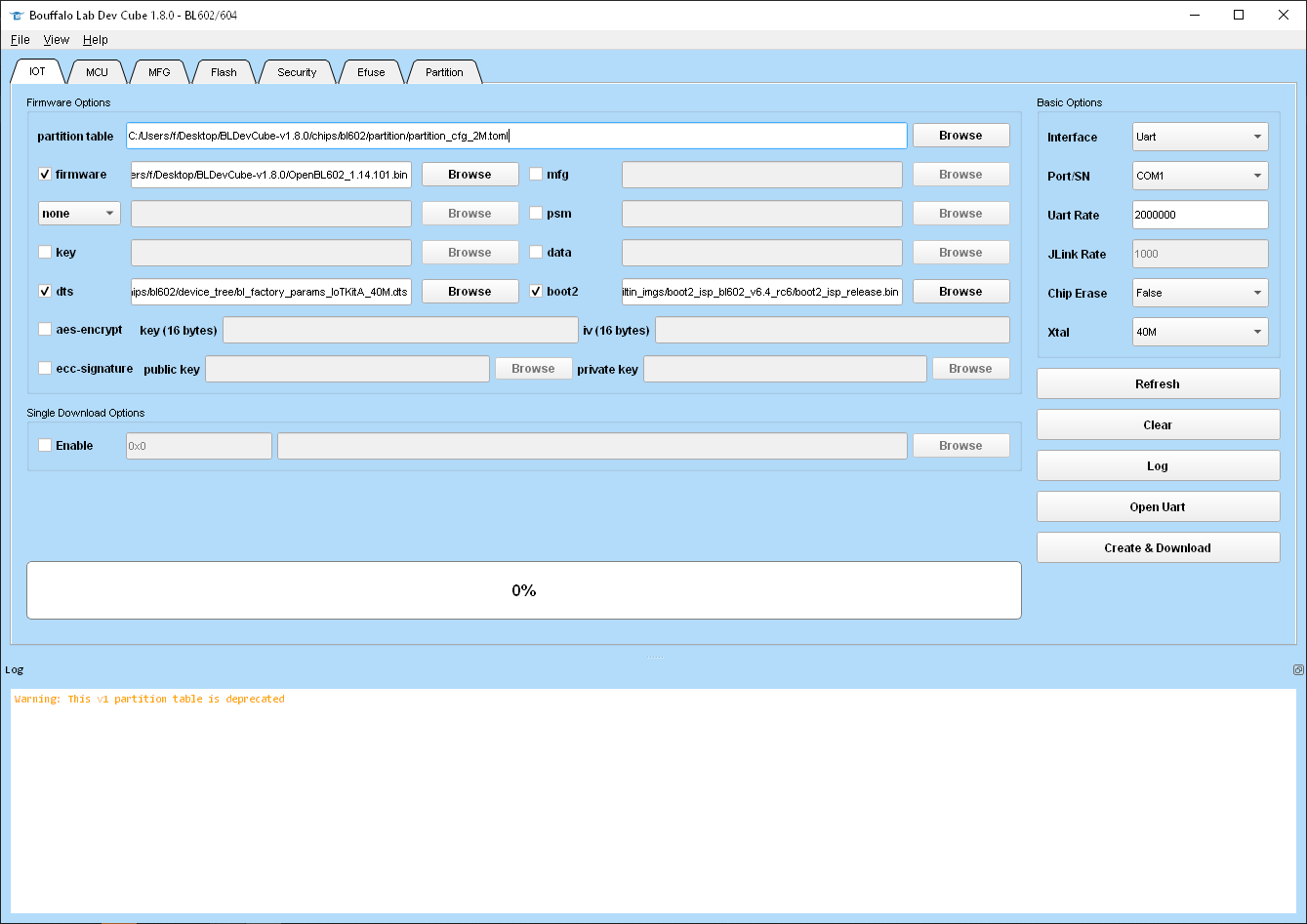

    Added after 8 [hours] 32 [minutes]:

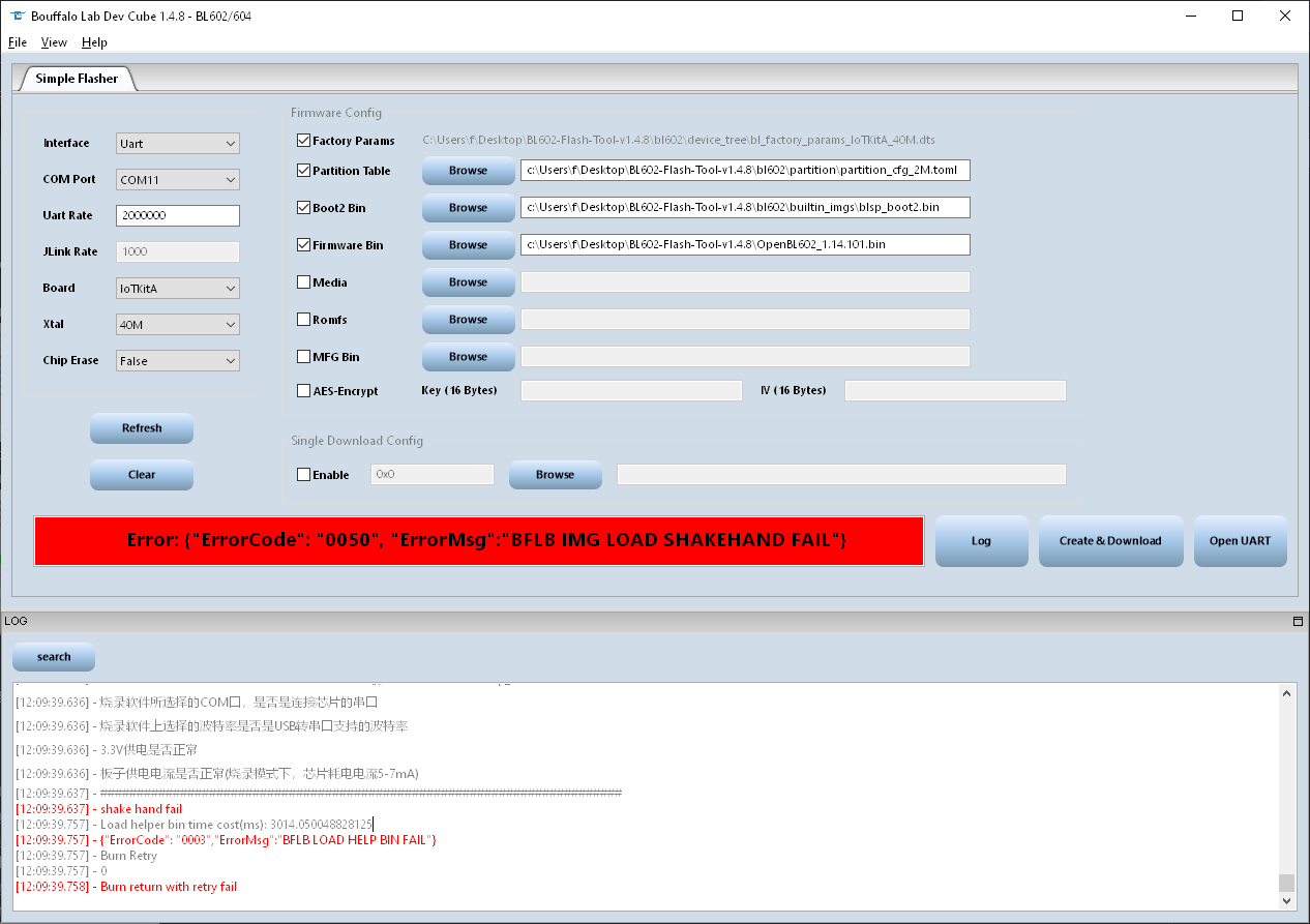

    But when I would try to flash, the next huge problem arises:

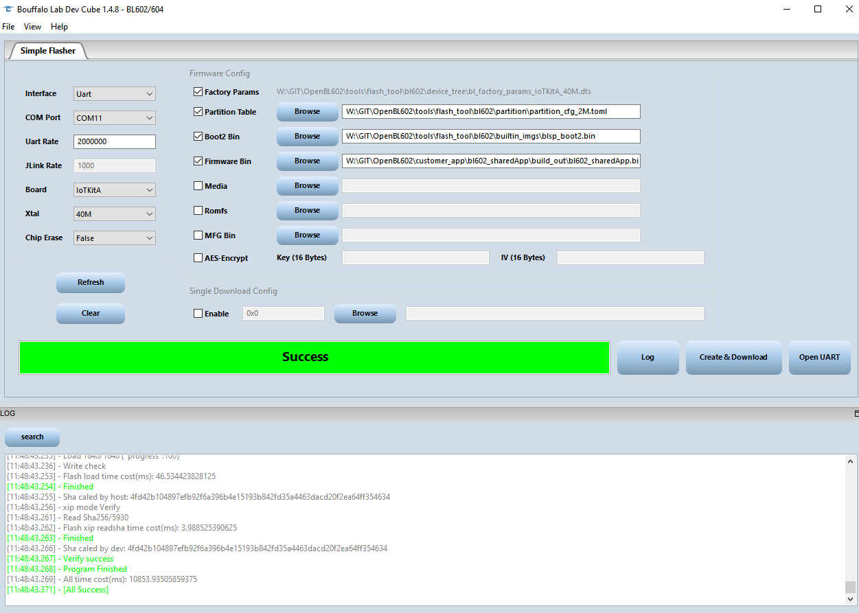

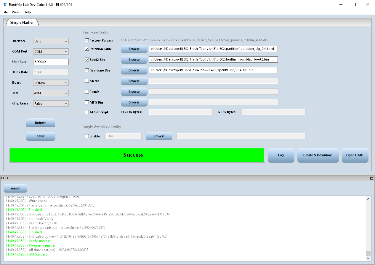

    On your step " For the user - loading the firmware ... 3. In BLDevCube.exe select files in turn: " you have a screenshot of an older version of the Bouffalo Lab Dev Cube, version 1.4.8 but I found only the download for v1.8 and this tool looks totally different.
    Here I can enter in "partition table" the file "partition_cfg_2M.toml" from the downloaded zip (in bl602\partition\), which I think is the same as you had.
    Furhter I put the new firmware "OpenBL602_1.14.101.bin" in the "firmware" input.
    "Factory params" in your screenshot is in mine "dts" I guess and here I put "bl_factory_params_IoTKitA_40M.dts" from folder "device_tree".
    And "Boot2 Bin" could be "boot2" here I put "BLDevCube-v1.8.0/chips/bl602/builtin_imgs/boot2_isp_bl602_v6.4_rc6/boot2_isp_release.bin"
    It looks like this now:
    Are these files right?
    I have a warning in the log: Warning: This v1 partition table is deprecated
    I wonder why you did not mention this at all in your howto, it is not clear to me.
    All the other settings in the tool I didnt change, I hope they fit.
    Could you help?
    Thank!

    francwalter wrote:
    On your step " For the user - loading the firmware ... 3. In BLDevCube.exe select files in turn: " you have a screenshot of an older version of the Bouffalo Lab Dev Cube, version 1.4.8 but I found only the download for v1.8 and this tool looks totally different. Here I can enter in "partition table" the file "partition_cfg_2M.toml" from the downloaded zip (in bl602\partition\), which I think is the same as you had.
    https://www.elektroda.com/rtvforum/topic3889041-90.html#20117857
    attachments to the post, It should be moved to the first post...
  • #184 20262610
    francwalter
    Posts: 17
    Thank, used 1.4.8 then, and the actual firmware OpenBL602_1.14.101.bin.
    But it failed:
    BFLB LOAD HELP BIN FAIL
    So I dont know what that means, either my Boot Pin is wrong or anything other is not working.
    Cannot continue like this, I even dont know how to check which part is not working.
    It was an experiment.
  • #185 20262640
    omelchuk890
    Posts: 70
    Rate: 10
    @francwalter reduce the speed from 2000000 to 500000, the speed of the uart, experiment, my recording also does not work at such a high speed as 2M

    BL602 platform-specific SDK has been updated. Multiple new fixes introduced. The MQTT problem (crash) reported by @droege has been fixed. The platform should be more stable now
    Futhermore, I have enabled most of the OBK drivers on BL602, including the LED ones (SM2135 and friends).
  • Use the first-post flashing tool version and check UART setup
    #187 20268666
    Posts: 14797
    Rate: 12954
    @francwalter thank you for switch analysis. As said earlier in this topic, you should use the same version of flashing tool that is in the FIRST post of this topic, not a different one.
    You can find it as attachment somewhere in this topic, you can also find it here (but you need to download whole dir):
    https://github.com/openshwprojects/OpenBL602/tree/master/tools/flash_tool
    BLDevCube.exe
    EDIT: If it still fails in the correct version, can you check:
    - are you correctly entering the bootloader mode? How your connection looks like?
    - Maybe you have swapped RX and TX? Try swapping them
    - do you have any other software that may use the UART COM port, like Cura, or RealTerm open? Please close it, COM port should be free
    - do you have each setting set as in my first post, check the screenshots

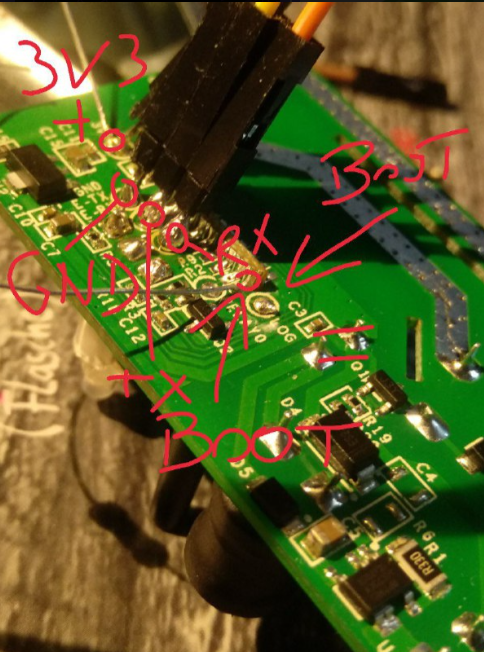

    #189 20269065
    Posts: 14797
    Rate: 12954
    The tool from first post is correct. I have edited my post for clarity.
    You are supposed to connect BOOT (GPIO8) to ground then either do a power off/on cycle or press RESET button. This is because BOOT has to be set to low while device reboots/restarts.
    I just flashed BL602 and it works:
    Are you 100% sure that you have found the BOOT pin correctly, GPIO?
    Or maybe you are doing something like this: first connecting power, then connecting BOOT to ground? It won't work. It's either connect boot to ground and then RESET, or connect boot to ground and then power off/on cycle.
  • BOOT pin must be pulled high during reboot
    #190 20269704
    francwalter
    Posts: 17
    You are supposed to connect BOOT (GPIO8) to ground then either do a power off/on cycle or press RESET button. This is because BOOT has to be set to low while device reboots/restarts...
    That maybe the reason! I did put the (which I think) BOOT Pin over a 10k resistance to plus (positive, +), not LOW. EDIT: plus is right, not GND!
    In the first post I read:
    To upload the firmware , youneed to:
    1. Connect the BOOT signal to the power supply through a 10k resistor
    2. Disconnect and reconnect power (reboot with BOOT signal raised to power)...
    "Boot signal to the power supply" - this I thought meant plus not ground.
    ...Are you 100% sure that you have found the BOOT pin correctly, GPIO?...
    No, but it is very difficult to check the pins with my Multimeter. Reminds me of the "Heisenbergsche Unschärferelation" ;)
    ...Or maybe you are doing something like this: first connecting power, then connecting BOOT to ground? It won't work. It's either connect boot to ground and then RESET, or connect boot to ground and then power off/on cycle.
    OK, I will try this again. Power on, Boot to ground (EDIT: PLUS, not GND), power off and on. Then try to flash...
    Thank!
  • Baud rate and boot pin settings for BL602 flashing
    #191 20270676
    francwalter
    Posts: 17
    OK, I DID IT!!!
    Thank you very much!
    I think the trick was, to set the Baud from 2M to 500k
    And the Boot PIN (GPIO08) seems to be the right one, it is the LOG spot on the mainboard, which is identical with the connection coming from the daughterboard just beside (the last contact):
    And I had to set the BOOT Pin (over a 10k resistance) to PLUS (not GND) and switch off-on, then keep it on PLUS (3V3) and then flash. After flashing only I disconnected the Boot-Pin from Plus.
    I first used to flash a cheap FT232RL which has insufficient 3V3 supply (as I read in Tasmota support) but it is enough to flash.
    To run it and to set up an accesspoint it seems really to weak on its chest, so I switched to a NodeMCU as described in Tasmota. On the NodeMCU I shortcut the EN-Pin to GND and I dont cross RX-TX but put RX from NodeMCU directly to RX (and TX...) from my BL602 Chip. A NodeMCU is much more reliable.

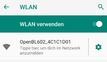

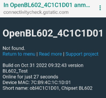

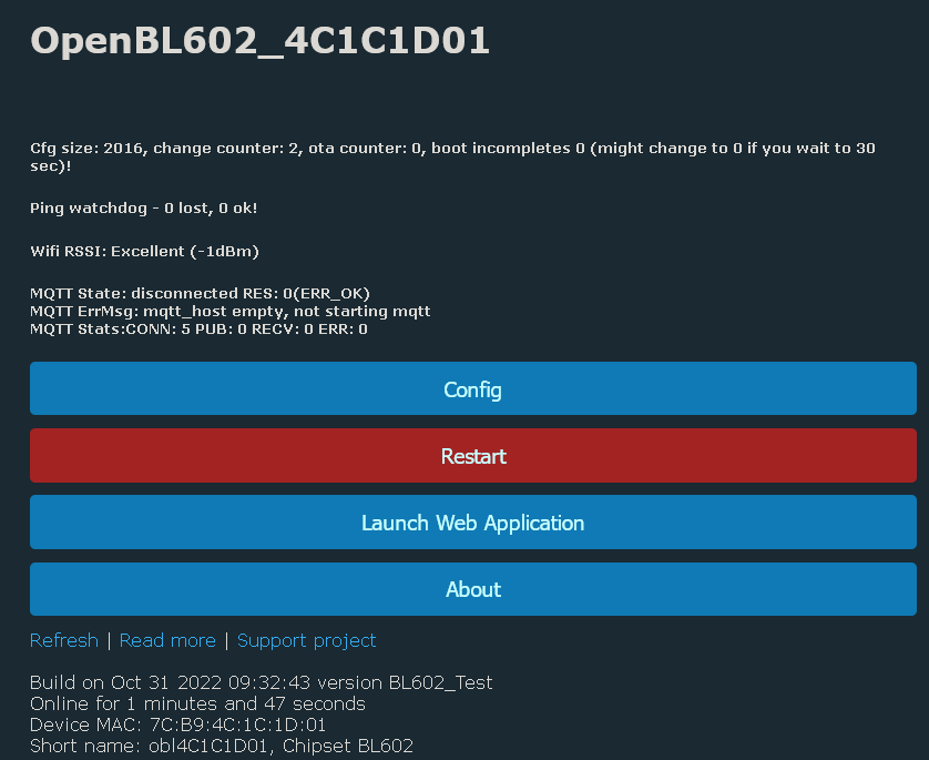

    Only then I found the OpenBL602 AP.

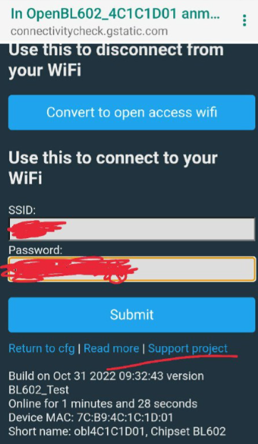

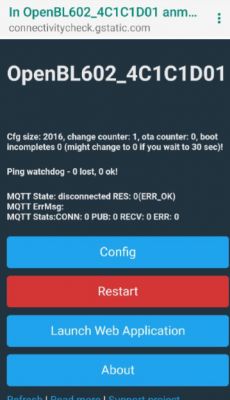

    In my phone I connected now to the OpenBL602_... network, tapped to login (switch to the welcome page) and then I could enter my home WiFi:
    Then I restart the BL602 and it logged successfully into my WiFi. Here I searched it in my router's network (FritzBox) and found it under 192.168.0.115 and on this site I could config it:
    Heureka! I didnt believe that I would get it done finally :)

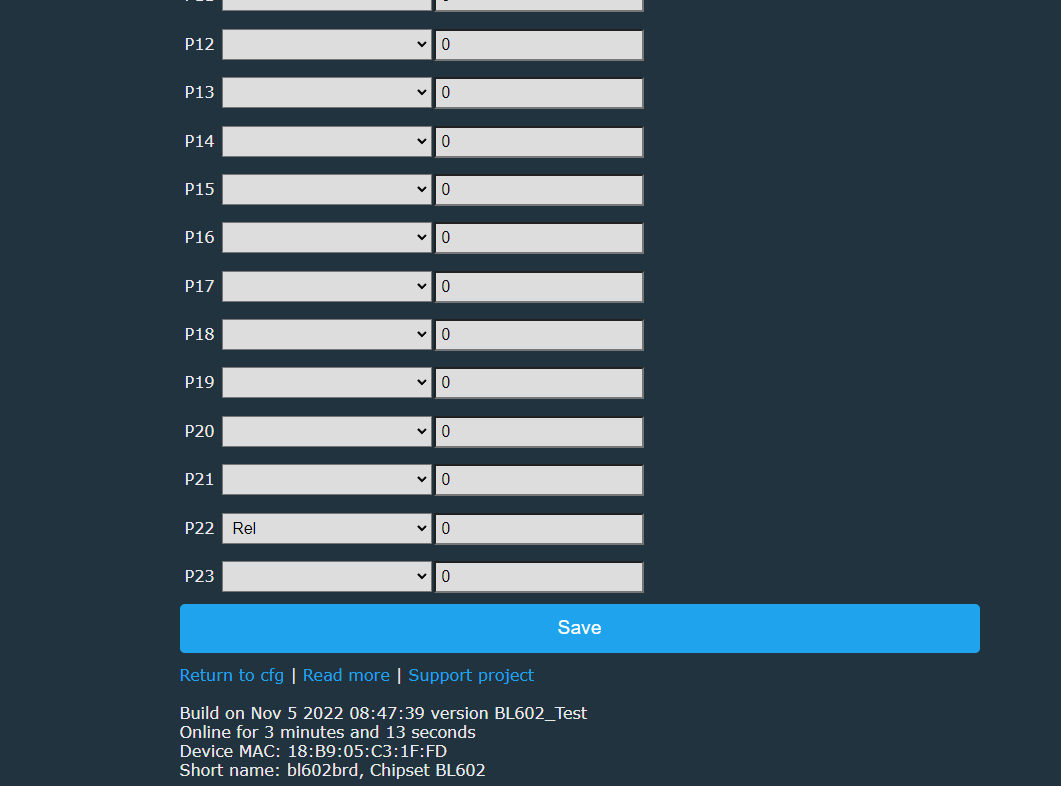

    Now I have one central question, I think I overread it in the 200 first posts :( - how can I just and simple switch on and off with an URL command (without MQTT) the only relay which this switch has on board, so just to use it as it is but with my (your) own firmware?
    I didnt find it in the millions of settings.

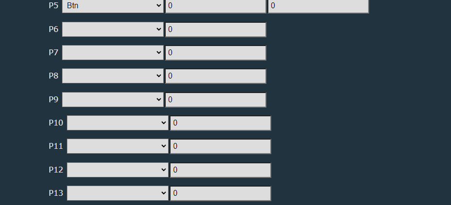

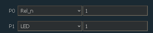

    OK, I try and errored some in Config > Config Module and found 24 Pins to configure, P0 to P23. I could set them to:
    Spoiler:
    Rel
    Rel_n
    Btn
    Btn_n
    LED
    LED_n
    PWM
    WifiLED
    WifiLED_n
    Btn_Tgl_All
    Btn_Tgl_All_n
    dInput
    dInput_n
    TglChanOnTgl
    dInput_NoPullUp
    dInput_NoPullUp_n
    BL0937SEL
    BL0937CF
    BL0937CF1
    ADC
    SM2135DAT
    SM2135CLK
    BP5758D_DAT
    BP5758D_CLK
    BP1658CJ_DAT
    BP1658CJ_CLK
    PWM_n
    IRRecv
    IRSend
    Btn_NextColor
    Btn_NextColor_n
    Btn_NextDimmer
    Btn_NextDimmer_n
    AlwaysHigh
    AlwaysLow
    But none of them did switch on my relay, only the LED I could toggle with Rel_n but not the relay. Or I dont understand this system at all :(
  • #192 20270838
    Posts: 14797
    Rate: 12954
    Good job with figuring it out. Now when it comes to configuration...
    You need to know which pin is used for relay. Then just set this pin role for Relay, and you will get a button on GUI that switches this relay.
    It works the same for LED - if you can toggle LED that way, it means the relay might be just on the other pin. Check the PCB or try each pin one by one.

    ... - if you can toggle LED that way, it means the relay might be just on the other pin. ...
    Unfortunately the Rel pin doesnt work. This was my first attempt, but only the LED on Rel_n works :(
    EDIT: I followed with the multimeter the spot where I read "RELAY0" and I think it is GPIO22, the PIN Number 31 in your picture above.
    But this does not help a lot :(

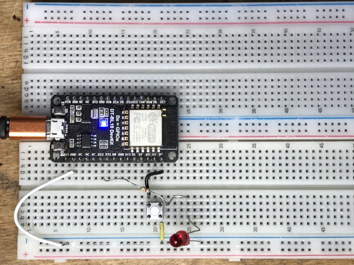

  • Check relay supply and GPIO22 state with multimeter
    #194 20270997
    Posts: 14797
    Rate: 12954

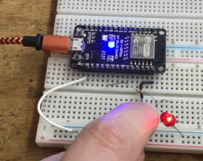

    Are you 100% sure about that? Can you please check for any potential wiring errors?
    BL602 dev board with connections:
    BL602 microcontroller connected to a breadboard with a flashing LED.
    NOTE: here I also configured a button pin, but a clickable button on WWW page also works.
    It just works...
    well. One of the possibilities is that you are currently powering board with 5V or with 3.3V and relay is using 12V or something like that, so it can't "click". You might need to disconnect programmer and power the board how it is supposed to done to get relay working.
    The other thing you can do, is to disconnect the mains power (important, for safety) and then probe with multimeter pin 22 and check if it has a low or high state (0V or 3.3V) and does it change when you click button on GUI...
  • P22 is just pin 22; relay wiring fixed
    #195 20271047
    francwalter
    Posts: 17
    Tasmota replacement for BL602, programming, pairing with Home Assistant, now with OTA working! ...
    YEAHH!!!
    Your picture made it immediately clear :)
    PIN 22 is just P22! I didnt check this until I saw your picture and after going to find the right pin for the relay on the pcb.
    Before I just combined anything (try&error) on any P0-P23 because I didnt realize that these are the pins, shame on me :(
    Now I put P1 to the LED (Rel_n) and P22 to the relay (Rel) and it works :)
    Furthermore I put P0 to Rel_n and P1 to LED
    now I have blue when off and red when on, great, exactly what I need :)
    Thank again.

    Still one thing unclear: the button on the device, when I press it, it should manually toggle the relay (and LED color).
    Is this possible?
    At the moment nothing happens if I press it. But this is quite important, without manual switch it is nearly not useable.
  • #198 20271195
    Posts: 14797
    Rate: 12954
    So which pin is the button pin?
  • GPIO5 identified as the button pin
    #199 20271294
    francwalter
    Posts: 17
    My multimeter says GPIO5, the switch ("S1") has 4 pins, two each seem to be connected, so not a bipolar switch, just on-off (first I had a broken jumper cable (with interruption), never had that before, took me a while to check).
    The contacts on the border are GND and the other side is 0 Ohm to Pin 6 of the BL602 so that is GPIO5:
    But what can I do if I know this? YESS! I can connect P5 to Btn_Tgl_All:
    AND IT DOES :) :) :)
    Tadaaa!
    All set. Thank again and again :)

  • Need verbose STATUS response for Tasmota Remota compatibility
    #202 20272121
    francwalter
    Posts: 17
    Is it possible to make the status answer so verbose as the Tasmota status?
    When I ask status 0 with:
    http://192.168.0.221/cm?cmnd=STATUS%200
    this gives me only:
    {"Status":{"Module":0,"DeviceName":"obl4C1C1D01","FriendlyName":["OpenBL602_4C1C1D01"],"Topic":"obl4C1C1D01","ButtonTopic":"0","Power":1,"PowerOnState":3,"LedState":1,"LedMask":"FFFF","SaveData":1,"SaveState":1,"SwitchTopic":"0","SwitchMode":[0,0,0,0,0,0,0,0],"ButtonRetain":0,"SwitchRetain":0,"SensorRetain":0,"PowerRetain":0,"InfoRetain":0,"StateRetain":0}}
    But not also StatusPRM, StatusSNS, StatusTIM, StatusSTS, StatusPTH, StatusFWR, StatusLOG, StatusMEM, StatusNET, StatusMQT
    I wouldn't care but an app I use, Tasmota Remota, crashes because of that.
    Thanks.

  • How to reset BL602 Wi-Fi configuration
    #205 20273839
    Maniac2002
    Posts: 9
    today i flashed also my Switch WF.
    Unfortunally i have made a mistake in cofiguring the wifi.
    Now it can not connect to the Network.
    ===start sm_get_bss_params===
    bssid[0] = 0xffff
    bssid[1] = 0xffff
    bssid[2] = 0xffff
    search ssid = DONTCARE
    result ssid index = -1
    ===end sm_get_bss_params===
    [WF][SM] Entering connecting state
    [APP] [EVT] Reconnect 211879
    [APP] [EVT] Connecting 211879
    Info:MAIN:Main_OnWiFiStatusChange - WIFI_STA_CONNECTING
    [23:35:23.168] - Info:MAIN:Time 211, idle 0/s, free 10825, MQTT 0(0), bWifi 0, secondsWithNoPing -1, socks 2/21
    [23:35:24.159] - Info:MAIN:Time 212, idle 0/s, free 108256, MQTT 0(0), bWifi 0, secondsWithNoPing -1, socks 2/21
    [23:35:25.164] - Info:MAIN:Time 213, idle 0/s, free 108256, MQTT 0(0), bWifi 0, secondsWithNoPing -1, socks 2/21
    [23:35:25.616] - ===start sm_get_bss_params===
    bssid[0] = 0xffff
    bssid[1] = 0xffff
    bsid[2] = 0xffff
    ind ix 0x42028cbc, chan_ctxt is 0x00000000
    connect fail
    ure, ssid = DONTCARE , index = -1
    [RX] Connection Status
    [RX] status_code 12
    [RX] connect result: SSID error
    , scan no bssid and channel
    [RX] MAC 00:00:00:00:00:00
    [RX] vif_idx 0
    [RX] ap_idx 255
    [RX] ch_idx 0
    [RX] qos 0
    [RX] acm 0
    [RX] assoc_req_ie_len 0
    [RX] assoc_rsp_ie_len 0
    [RX] aid 0
    [RX] band 0
    [RX] center_freq 0
    [RX] width 0
    [RX] center_freq1 0
    [RX] center_freq2 0
    [WF][SM] Exiting connecting state
    [WF][SM] State Action ###connecting### --->>> ###disconnect###
    [WF][SM] Entering disconnect state
    [WF][SM] Will retry in 2000 ticks
    [APP] [EVT] disconnect 215143, Reason: SSID error
    Does anybody know how to reset the WIFI configuration?.
    best regards an Thanks in advance
    Maniac2002
  • Safe AP mode recovery after five power cycles
    #206 20274096
    Posts: 14797
    Rate: 12954
    @francwalter I will try to look into it very soon, but it's not good that his app crashes when a single block is missing. He should be checking for null pointers. Also, what about Tasmota Control? Is it crashing as well?
    @Maniac2002 first thing to try is to do quick 5 power on and off cycles in order for device to go back to safe AP mode.
    WARNING: in safe AP mode the pinout of device is disabled! Relay will not work! it's for recovering device from bad config
