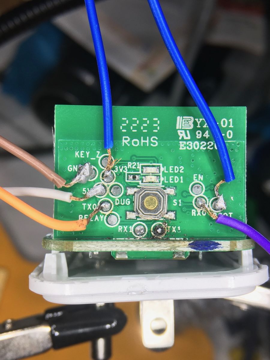

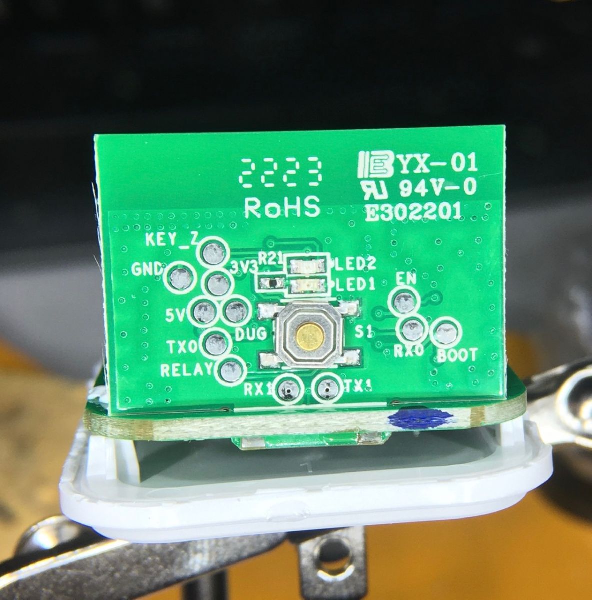

    davidcpurdy
    Posts: 22
    bxwen19 wrote:
    I finally got some time to figure out most of the pins of sonoff S40 . The LEDs and relay are verified to be working as expected. I am not sure how to set the power monitoring device though. GPIO pin 14 is connected to cse7759b tx pin. It is supposed to receive readout from the chip. Which one should I choose?
    After some messing around, I've gotten as far as @bxwen19 has gotten I think...
    Confirmed on Sonoff S40 :
    -Used the 1.4.8 BLDevCube.exe, properly located in the flash_tools folder, on a Windows 10 laptop
    -Had to dig through the thread to find the specific post where the author's correct/anointed version 1.4.8 resided
    -Flashed OpenBL602_1.15.149.bin from Link - OpenBL602_1.15.149.bin
    -Used TX0 and RX0, worked for flashing (*not* TX1 and RX1, notably)
    -Used an FTDI USB-Serial converter
    -Used the 5V power supply from the FTDI to power the 5V pad on the daughter board
    -Confirmed that the on-daughterboard power converted stepped 5V down to 3.3V correctly
    -Bridged from 3.3V pad on daughter board to the Boot pad with a 10k resister to enable flashing
    -Once my wiring, software and files were in order, the actual flashing is quite fast... after which I rebooted the device...
    -Required powering off/on many times, and some nervous waiting, until the Access Point "OpenBL602_BLAHBLAH" appeared...
    -WiFi access point connects correctly, has IP 192.168.169.1 , serves address to clients connecting as expected

    After considerable messing around, here is a summary of a working (but incomplete) Sonoff S40 OpenBL flashing and results.
    I could not get the pins/Gpio mentioned by @bxwen19 (or was unable to interpret his meaning correctly?). I ended up with this:
    Configuration data for S40, through the web interface configuration page.
    Pn (per Config page)Role (from dropdown menu)Channel #2nd Channel #GPIO_NAME (per datasheet)
    P0Btn (button)11 PAD_GPIO_0
    P1LED (blue LED2)1 PAD_GPIO_1
    P12Rel (AC mains voltage relay, and red LED1)1 PAD_GPIO_11
    Some notes about behavior of the flashed device:
    - LED1 and LED2 are mutually exclusive in terms of being lit, per programming, I assume.
    - LED2 (blue) signifies that the module is powered on but the relay is OFF.
    - LED1 (red) signifies that the module is powered on and the relay is ON.
    - the logs show that the module, as configured, is correctly registering "button presses", single, long and multiple.
    I would also like to turn on the power monitoring circuitry ans use that in my HomeAssistant setup.

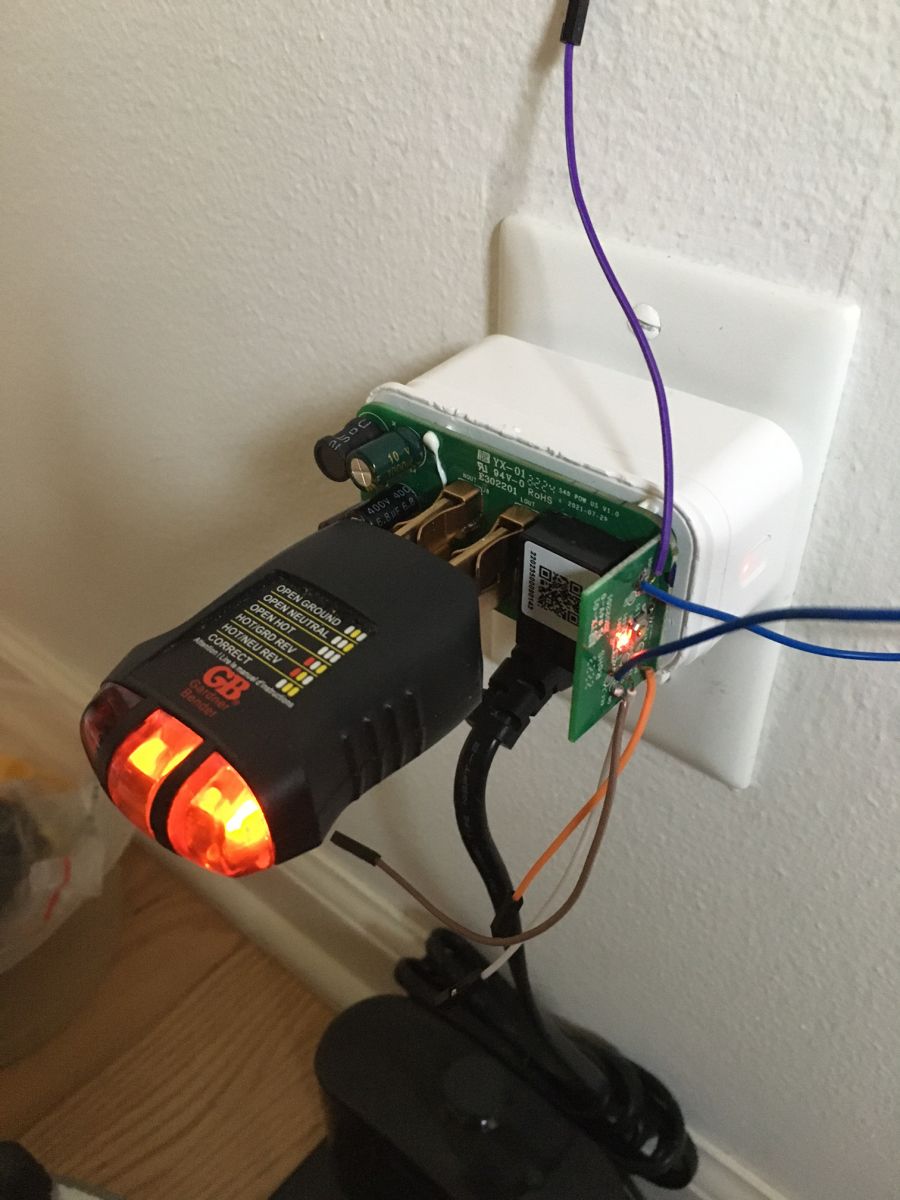

    Attached are some photos also that show:
    - daughterboard
    - daughterboard w/ soldered leads (apologies for nasty solder joints)
    - S40 module w/ relay OFF (blue LED visible)
    - S40 module w/ relay ON (red LED visible)
    - screenshot of configuration page

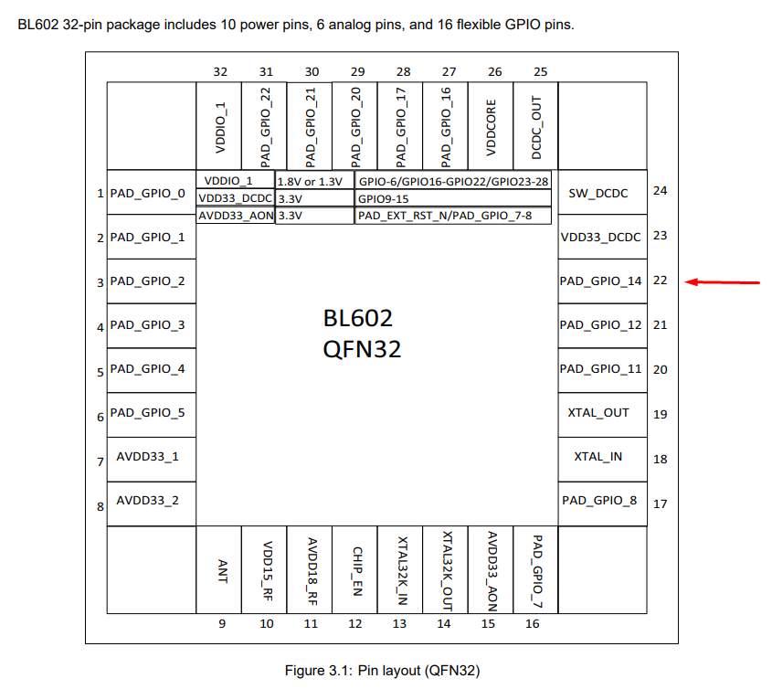

    Tasmota replacement for BL602, programming, pairing with Home Assistant, now with OTA working!
    This pin? I will look into changing UART (there are two UARTs on BL602) to use this pin and we will see.
    We will also need to know if cse7759b protocol is the same as cse7766. Maybe if it's at least similar, then cse7766 driver could be adjusted to support both. I haven't looked at the datasheet yet.

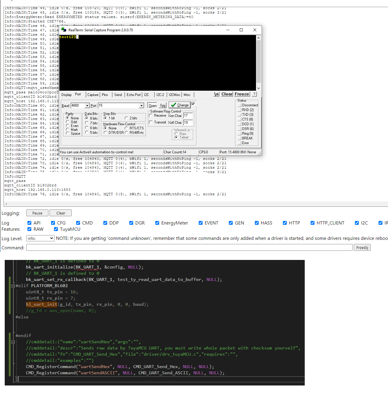

    1.15.165 for me seems to be only able to send data through UART, no receive yet.
  • CSE7766 driver starts but reads zero values

    This is what I'm seeing. (My soldering iron is attached and is hot, so I know it is drawing current.)
    Added after 8 [hours] 28 [minutes]:
    @davidcpurdy from what I can gather, the IO7 and IO16 were used for flashing the board from the first post in this topic and BL602 SDK. The same port is used for log and commandline.
    So far I have tried to get it running in OBK, but while send works, it seems there might be some issue with receive:
    Two thoughts:
    1. Any chance that you could use UART Port 1 instead of Port 0?
    A few docs I looked at mention that UART0 ( tx=16, rx=7) is reserved for CLI and console. They used UART1 (tx=4, rx=3) for data transfer, as in this BL602 + E-Ink Display using UART.
    2. In the CSE7766.c driver, I can find where PREF and IREF are defined. I couldn't find the same sort of define for VREF, though.

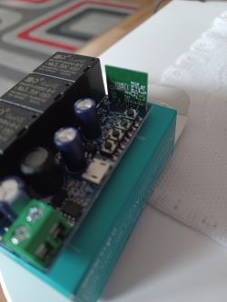

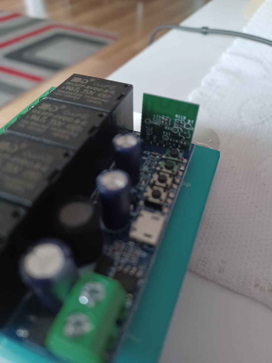

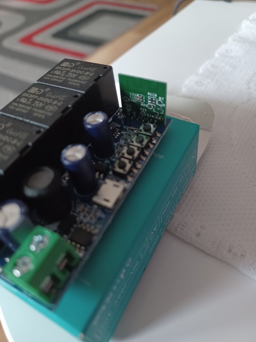

    Hi
    I bought a four-channel relay module, I didn`t actually notice that it wasn`t ESP enabled - and that`s how I found out about BL602 :)
    Has anyone uploaded the firmware from this thread to it?
    If so, can you share the configuration, i.e. which pin is responsible for what?
    link to my board https://pl.aliexpress.com/item/10050049800849...t_main.17.3c441c24DneLdn&gatewayAdapt=glo2pol
  • #233 20347309
    Posts: 14770
    Rate: 12913
    Show clear photos of the WiFi module and we will try to advise you. You need to find RX, TX and boot. Ultimately, you can guess the signals from buttons and relays once you upload the new firmware.
  • #234 20347388
    rkarolek
    Posts: 22
    Rx, txt, etc. are not a problem, they are nicely described on the module
    However, assigning pins to the relay etc. would make it easier and save a lot of time, which is not much time before Christmas.
