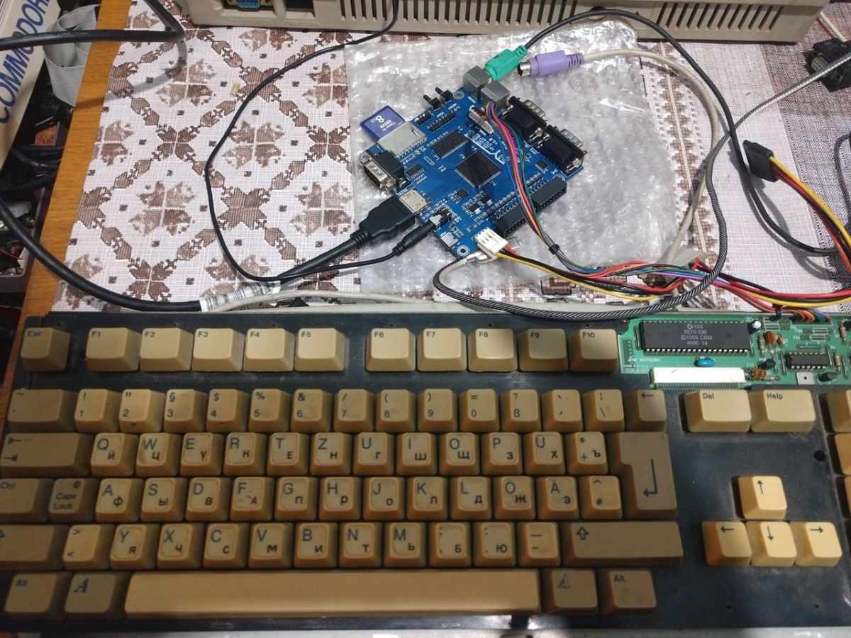

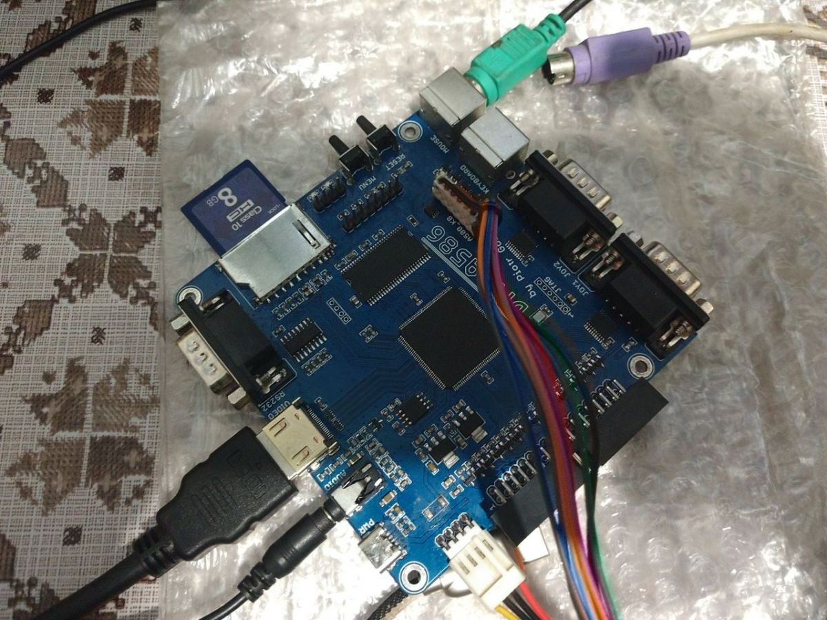

  • #316 21367200
    motohobiman
    So cool, thanks for your, DIYA 586 best Amiga from fpga , Merry Christmas!!!
    Added after 5 [hours] 11 [minutes]:
    Sorry, but not working keyboard:(
    Keyboard with FPGA board and wires on a table. PCB board with various ports and cables on a table with bubble wrap. Software list on a computer screen with options including mikan and ZX Spectrum 128.
    Added after 21 [minutes]:
    It's me again)))
    Working,but not work in Main Menu.
    Plz addon work keyboards with Main Menu,i won't install DIYA586 into Amiga500 case.
    Thanks, sorry me,i addons problems for you .

    Menu.
    I'm wondering how to go about it.
    I was thinking of autodetecting the keyboard, but I think I'll do a separate one under the A500 though.
    For the moment you can use JOY2 to navigate the menu.
    You soldered the floppy drive connector the other way round. :) .
