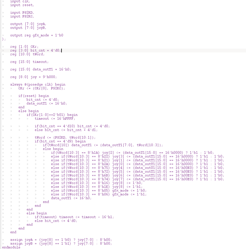

  • #283 21140431
    leonecomdir
    Posts: 35
    I am almost sure that the purpose of the key is described here))) I need to study Veriliog)
    Verilog code describing electronic components.

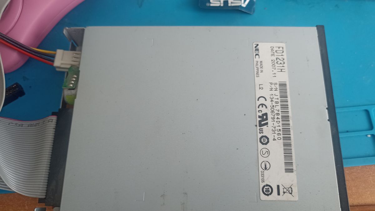

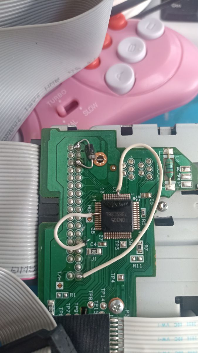

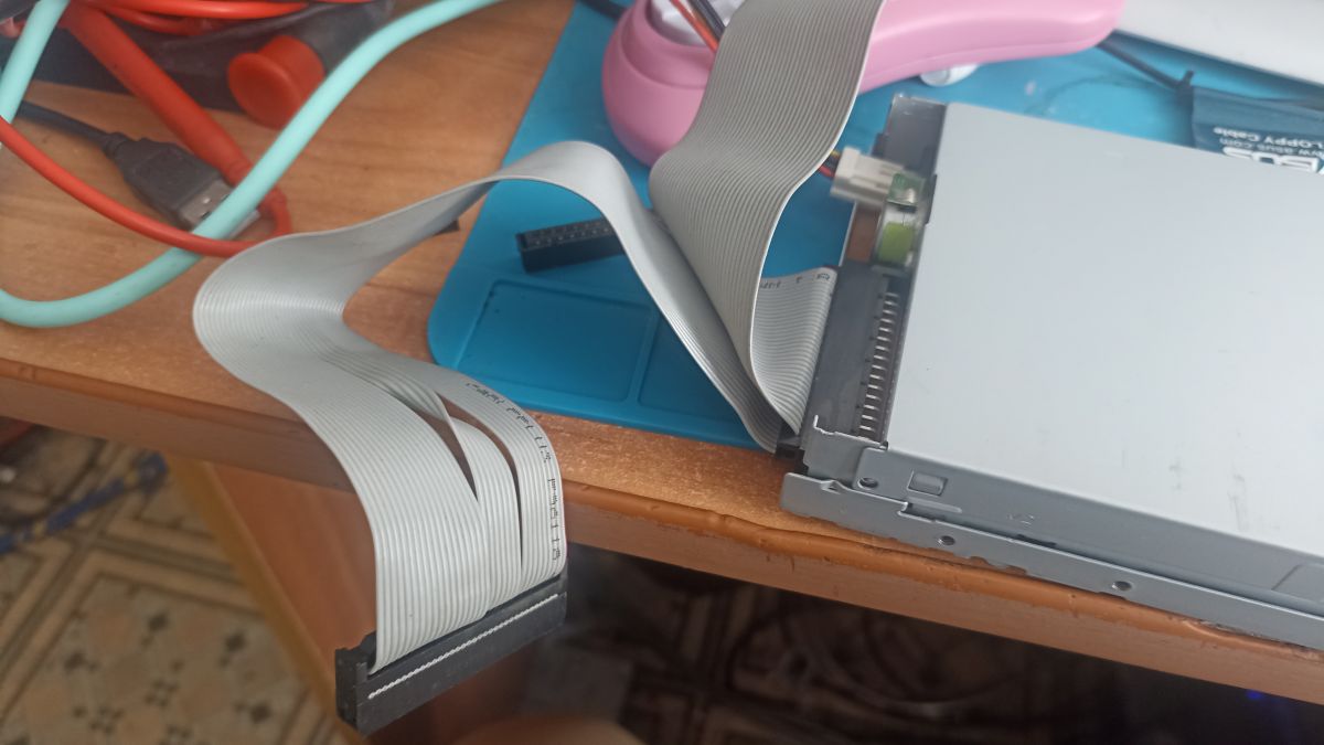

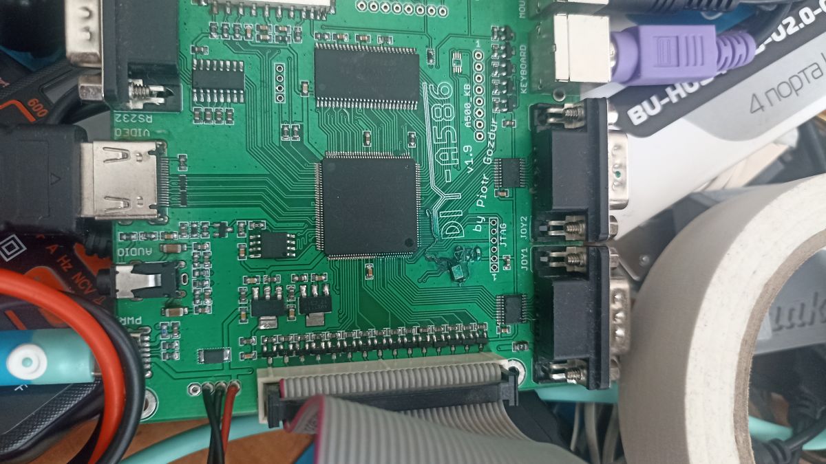

    leonecomdir
    Posts: 35
    I'm not going to investigate the gamepad ports on the NES core yet, I don't have time and I don't know Veriliog)))
    But I rewired and connected the NEC FD1231H floppy - It works))
    NEC FD1231H floppy drive with connected cables. Photo of a green circuit board with various connectors and wires. Connected NEC FD1231H floppy drive to a computer. Modified NEC FD1231H floppy disk connected to a circuit board with visible wires and a chip. A pink controller is in the background. Modified NEC FD1231H floppy disk connected to a circuit board with visible wires and a chip. A pink controller is in the background.
