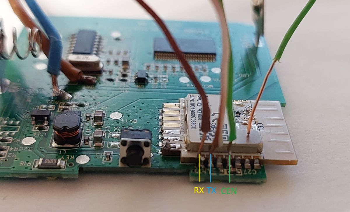

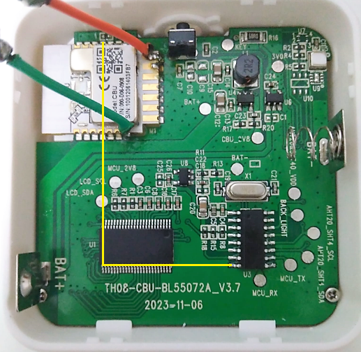

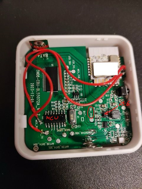

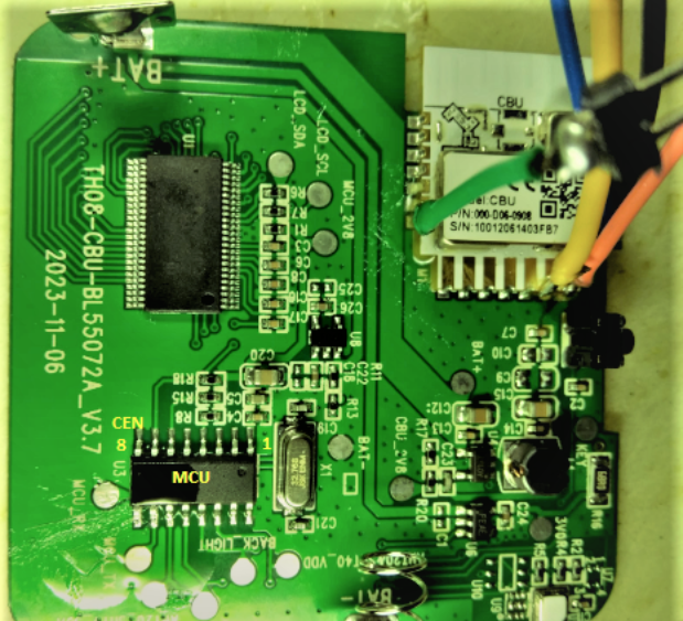

  • TH08-CBU-ATH20-V2 is a LCD calendar/clock/temperature/humidity unit with a BK7231N CBU module, BL55070 LCD driver, and ATH20 sensor.
  • U3 appears to be the Tuya MCU, while U8 with a 32.768 kHz crystal likely handles RTC and LCD/backlight control, and Q1 switches Wi‑Fi power.
  • It runs from 3xAAA cells at 4.5V and was bought for 4.49€ as a Choice offer.
  • The Tuya app shows a 1 hour update interval, and pairing can fail because the device connects only briefly between updates.

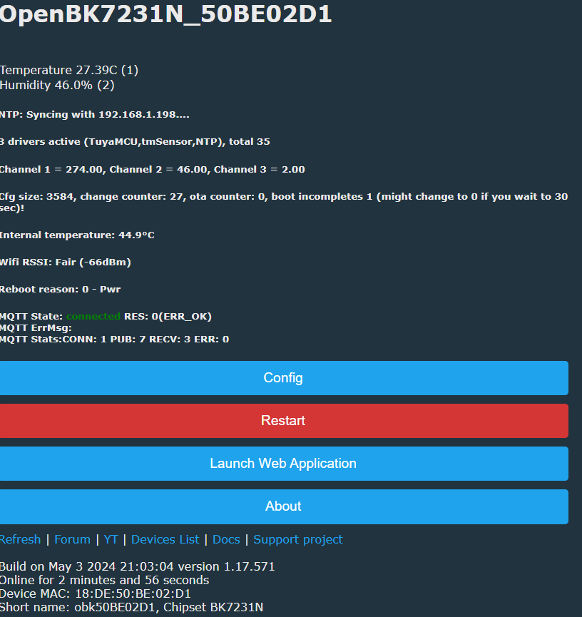

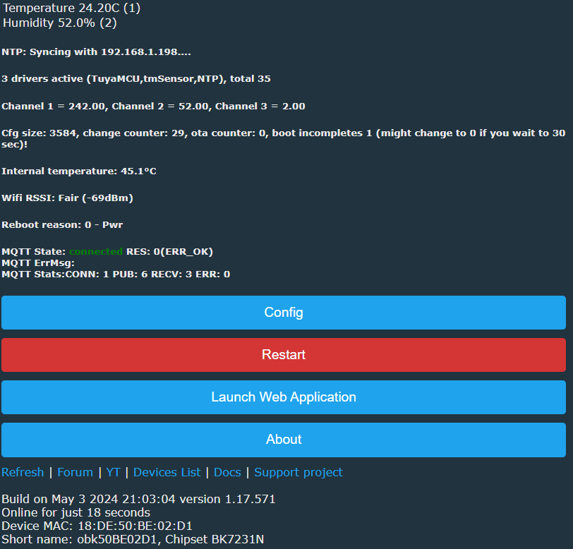

    First thing to check is the Web App Log. This will tell you whether any communication occurs. Keep in mind that you need to check this when TuyaMCU decided to power up WiFi module and not by artificially powering it.
  • #152 21002511
    bogovik
    Posts: 8
    Why is there no record of data exchange with TuyaMCU in my log?
    My LOG:

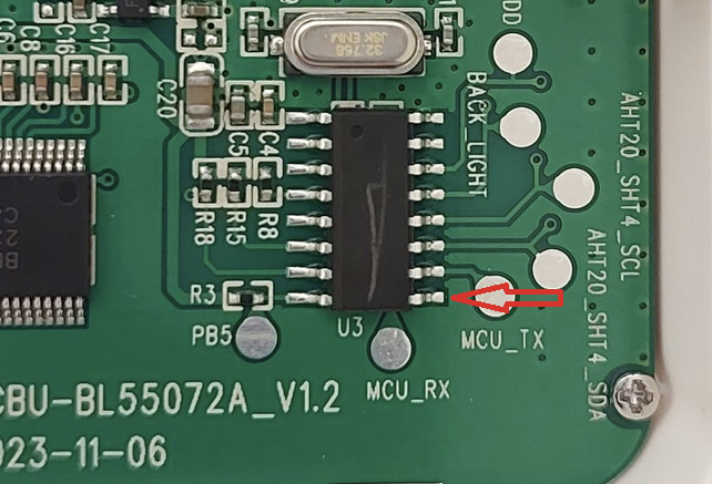

    How to enable data exchange with TuyaMCU? Is there a console command that forces sensor reading?
    Added after 30 [minutes]:
    I'm sorry, I found the reason why there was no entry in the log for receiving data from TuyaMCU. I soldered the RX pin poorly to the TuyaMCU chip, there was no contact. I heated the leg of the RX TuyaMCU with a soldering iron and everything worked.
    Close-up of a circuit board with an arrow pointing to the MCU_RX label.
    Info:TuyaMCU:Received: 55 AA 00 02 00 00 01
    Info:TuyaMCU:ProcessIncoming[v=0]: cmd 2 (MCUconf) len 7
    Info:TuyaMCU:ProcessIncoming: TUYA_CMD_MCU_CONF, TODO!
    Info:TuyaMCU:Received: 55 AA 00 0B 00 00 0A
    Info:TuyaMCU:ProcessIncoming[v=0]: cmd 11 (QuerySignalStrngth) len 7
    Info:TuyaMCU:ProcessIncoming: received TUYA_V0_CMD_QUERYSIGNALSTRENGTH, so sending back signal
    Info:TuyaMCU:Received: 55 AA 00 05 00 15 01 02 00 04 00 00 01 08 02 02 00 04 00 00 00 0B 03 04 00 01 02 46
    Info:TuyaMCU:ProcessIncoming[v=0]: cmd 5 (WiFiSelect) len 28
    Info:TuyaMCU:V0_ParseRealTimeWithRecordStorage: processing id 1, dataType 2-val and 4 data bytes
    Info:TuyaMCU:V0_ParseRealTimeWithRecordStorage: int32 264
    Info:TuyaMCU:V0_ParseRealTimeWithRecordStorage: processing id 2, dataType 2-val and 4 data bytes
    Info:TuyaMCU:V0_ParseRealTimeWithRecordStorage: int32 11
    Info:TuyaMCU:V0_ParseRealTimeWithRecordStorage: processing id 3, dataType 4-enum and 1 data bytes
    Info:TuyaMCU:V0_ParseRealTimeWithRecordStorage: byte 2

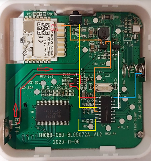

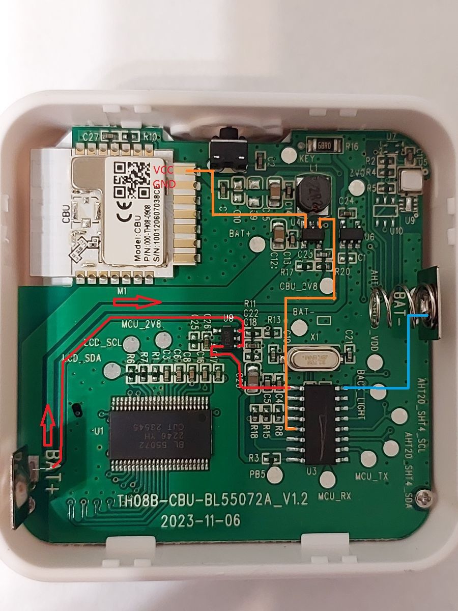

    Clarify that I bought this device taking advantage of an offer and for experimental purposes because, as I already mentioned, I think that Zigbee battery devices are much more efficient than standard Wi-Fi devices.
    It is a TH08 model with a plate similar to that of @spupetic with reference TH08-CBU-BL55072A_V3.7 2023-11-06.
    As soon as I opened it and made the standard CBU module to UART connections, I managed to make a backup copy of the original firmware and then flash it with OpenBK7231N_QIO_1.17.501.bin. I was able to connect to the Access Point and configure the Wifi network. And from here it became impossible to establish communication. I connected a modem to the TX2 port of the CBU module and could see that the module kept rebooting before the router could assign it a dynamic IP.
    I tried to flash it again and it was impossible. It started well and always ended before the end.
    Following @bogovik's comment in post #152, I raised the two pins of U3 corresponding to MCU_RX and MCU_TX (pins 9 and 10 of U3). I tried flashing it and it also crashed before finishing.
    Following @morgan_flint's comment in post #128, I was able to verify with a multimeter that the 2.82V voltage at the CEN terminal of the CBU module dropped to ground every so often and initialized the module. I verified that it is connected to pin 8 of U3, so I lifted the pin (with a soldering iron and a pin) and problem solved.
    I believe that interrupting the CEN connection is enough to successfully flash the CBU module, I don't think it is necessary to interrupt MCU_TX and MCU_RX. In my case I already had them lifted from the previous unsuccessful test.
    Close-up of the TH08 circuit board with visible connections and pin labels. Soldering iron with heated tip next to a metal pin on a white background.

    Posts: 8
    @spin55, Hi!
    In your photo there is a green wire connected to the left side of the CBU. Why is it needed?
    In my CBU, I connected the green wire to the CEN pin and during the firmware I shorted it to the CBU cover (the CBU cover is connected to the ground pin). Marked contact details in the photo
    Close-up of a circuit board with wires connected to a WiFi module.
    When the MCU_RX and MCU_TX contacts are disconnected, the WiFi module (CBU) does not go to sleep, it is convenient to program and configure. In my case, I will use the TH08B sensor to obtain the indoor temperature and transmit the temperature via the SendGet command to the SonOff WiFi relay (Tasmota), which controls the gas boiler. Therefore, I need a lot of time to configure TH08B. If I connect the MCU_RX and MCU_TX contacts, then Tuya will turn off the power to TH08B too quickly and I will not have time to check the settings.
    To flash the CBU module it is not necessary to connect a cable to the TX2 pin, but it is convenient to monitor this pin once flashed to see the boot process and detect the cause of any malfunction. Please note that on battery powered devices with TuyaMCU chip you have no control over the disconnection time and it is so fast that you often do not have access to the OpenBeken web log.
    I also use it to know the IP because, sometimes, it does not appear in the router's DHCP list because the disconnection is so fast. If you do not know the IP you cannot access the website. Without a website you do not have access to the registry. And many times even if you know the IP, there is no time to load the web page. You have all that information and more on that TX2 pin. I connect it to RX of the USB and monitor with the serial monitor of the Arduino IDE, selecting 115200 bps, in this case. Logically you can use any other program for this.
    Normally, battery-powered devices that have a TuyaMCU chip can usually be flashed without having to cut tracks, and that has been the case so far in my case. Even in this case, the first flashing was successful from the original firmware, that's why I wanted to narrate the entire process until I managed to flash it.
    In this specific device, it is the CEN signal that prevents the flashing process from being completed successfully, and the least intrusive way to interrupt the connection has been to lift pin 8 of U3 (TuyaMCU chip) following your example.
    Grettings

    I'm also starting to understand how this thermometer works
    In this model that runs on batteries, the power to the Wi-Fi module is managed by the MCU. without power there is no wifi.
    You can check with a multimeter on the cbu vdd that the power is cut.
    Deep sleep is not used.
    To make the settings at openBeken web Pages you can power directly the CBU module with a external power supply.
    With the heating on, the temperature inside the house does not rise or fall suddenly, when the mcu detects that there is a difference it will turn on the cbu to update the temperature

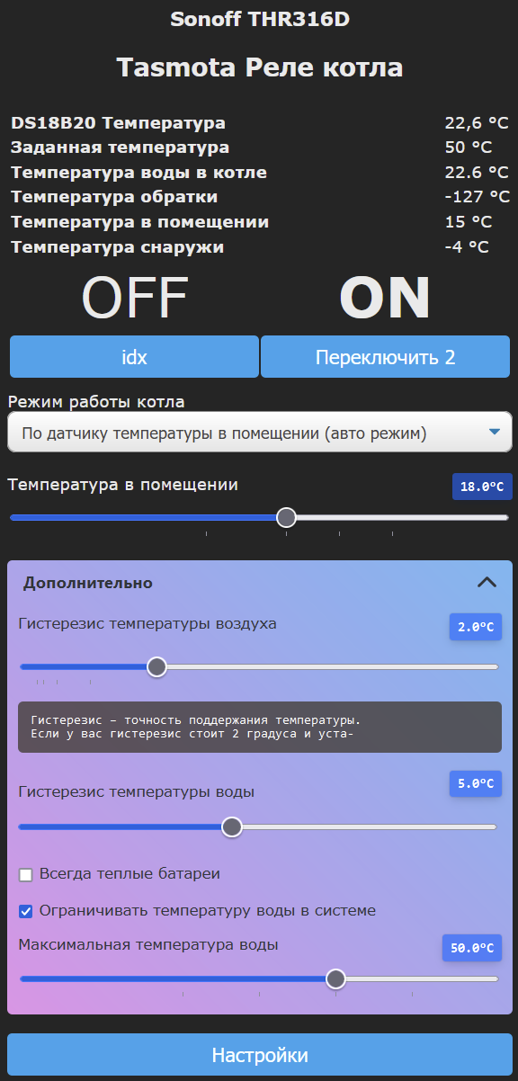

    Initially I also wanted to use HomeAssistant to control the gas burner. But then I bought a Sonoff TH Elite 16A Temperature and Humidity Monitoring Switch Module (THR316D) relay. The THR316D turned out to be very useful for me and I stopped using HomeAsistant. The THR316D relay and the TH08B temperature sensor will exchange data via WiFi, without using the HomeAssistant server.
    Sonoff THR316D with box.Image showing Sonoff THR316D relay with labeled features.
    This THR316D relay has a connector for connecting a DS18B20 thermal sensor. Several DS18B20s can be connected to this connector at the same time (simply by twisting the corresponding wires together). I connected three DS18B20 temperature sensors (one for the temperature of the water that flows out of the boiler; the second for the temperature of the water that enters the boiler; the third for measuring the temperature outside in order to make weather-dependent automation).
    DS18B20 temperature sensor with cable.
    The THR316D also features dry contact relays that are not connected to any voltage. I use this relay to turn the gas burner on and off. In addition, the Berry programming language is built into the Tasmota firmware. I was interested in learning it and using it to fully control the logic of turning on/off the gas burner, manage settings via the web interface and publish data on the Internet.
    This is the web interface for my relay firmware. The water temperature can be adjusted in different modes.
    Sonoff THR316D relay interface with temperature settings

  • #167 21006339
    morgan_flint
    Posts: 251
    Rate: 60
    bogovik wrote:
    Lay a wire route directly from the battery compartment to the power legs of the WiFi module
    Don't do that, you'd be feeding the CBU with 5V while it requires 3.3 or less (in both versions it is fed with 2.8V)
    bogovik wrote:
    How else can I increase the time after which the WiFi module will turn off?
    For the first version of TH08, you can see the way the Tuya MCU controls power to the module in the schematic posted at the first post of this thread: There's a MOSFET that connects CBU's GND to main GND, and its gate is controlled from the Tuya MCU (here I explained the possible advantage of cutting GND instead of Vcc). A possible way to extend the period the CBU is on would be to insert a diode between R3 and R23 and a capacitor in parallel with R23, with enough capacity to keep the gate high during the required time before it discharges through R23.
    In your version of TH08, same as spupetic's, the CBU's GND is connected directly to main GND, and the MCU seems to control power by turning on and off the voltage regulator that feeds it. I guessed that from spupetic's photos; I can't check it as I don't have that device, but you can check if there's a connection between the MCU (U3 in your version) and the regulator (seems to be U4, I'm marking them in red in spupetic's photo)
    View of the interior of an electronic device with a PCB and component labels.
    Test point CBU_2.8V is the output of the regulator and should be connected to CBU's Vcc. If you can trace the connection between the MCU and the regulator (either directly or via a resistor), then you could add a series diode- parallel capacitor-resistor in between to extend a bit the time the regulator is on after the MCU tries to shut it down.
    Obviously, a more elegant way of doing this would be to change MCUs firmware, but I'm afraid this is way beyond our possibilities, as we don't even know which MCU it is (and the effort to do so probably wouldn't be worth it).

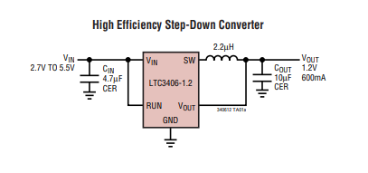

    EDIT: I've been looking at the photos of the new version, but I can't read the markings in U4 so I couldn't identify it. Probably, the pinout is similar to this one, as the connections of Vin, GND, SW coincide, and Vout (feedback) is connected to the output of the coil with a resistor divider instead of directly, but this is OK to adjust output voltage:

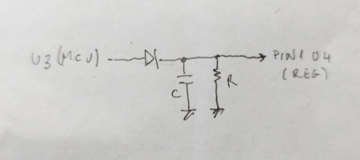

    LTC3406-1.2 step-down converter diagram Top view of a TSOT-23-5 package integrated circuit. If this is true, then pin 1 (RUN) could be the pin that controls the regulator and should be connected to the MCU. Following the traces in the photos is difficult because it goes through several vias, but with a multimeter, it is a matter of seconds to find out. Then, inserting this between MCU and regulator:
    Circuit diagram with diode, capacitor, and resistor between MCU and regulator.
    should give some extra time after the MCU pin goes low (1uF-10Mohm, for example, should give about 5 seconds)
    EDIT 2: Maybe there's a more elegant way to extend the period the CBU is powered on by the MCU. If you read this post, you'll see that, with an older version of OBK, the module was kept on quite longer than with the original firmware (read from "So everything seems to go well, except for one detail" in that post). Read also this post and the end of this one. After those findings, @p.kaczmarek2 implemented a correction form version 302 and, as you can read here, from that version onwards the MCU turned off the CBU just after it received the last packet from the module.
    So, a possibility to have the module on for a longer time would be to undo, at least partially, that correction, introducing a delay before sending the "closing packet", you could compile a modded version of OBK with that as for your specific application as, for general use, it's better that the MCH shuts the CBU down as soon as possible to save battery.

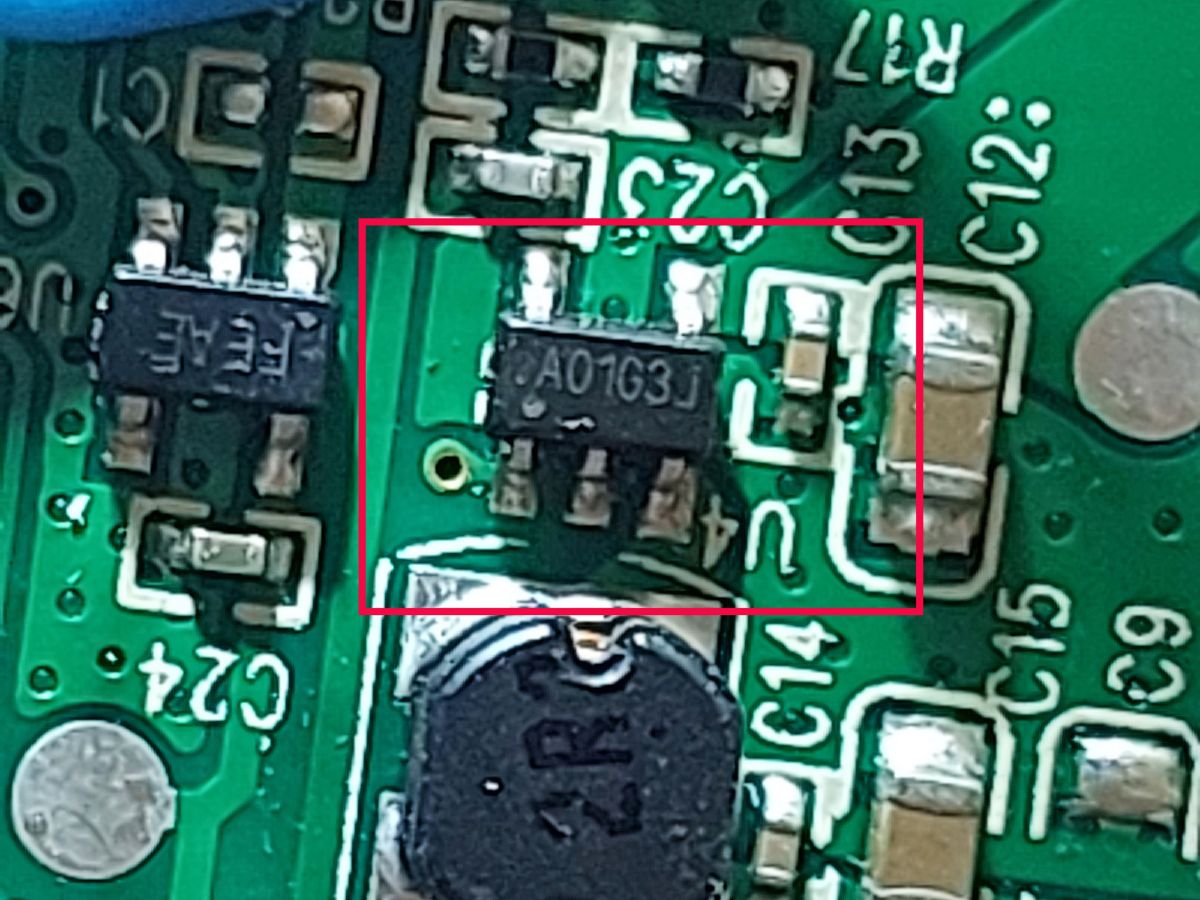

  • #168 21007162
    bogovik
    Posts: 8
    @morganflint, Hi!
    Today I flashed the TH08B sensor again. The firmware was successfully installed.
    I tried to use spin55`s idea for the firmware: disconnect only the CEN pin from the MCU (the RX and TX pins remained connected). Unfortunately this didn't work for me. Erasing the chip was successful, but recording failed. I did a few reps. The process always ended in failure.
    After that, I had to disconnect the RX and TX pins from the MCU and the device was successfully flashed. I always have to disconnect the RX and TX pins from the MCU, otherwise the firmware process fails. I don't know why this happens to me.
    I checked the board layout. I drew the electrical connection routes in the following figure.
    Image of a circuit board with marked electrical connections.
    Bat+ (4.2V) -> U8 (2.8V) -> pin 1 MCU (2.8V)
    U8 - step-down voltage converter
    The MCU turns the WiFi module on and off via pin 5 of the MCU. If there is a voltage of +2.8V on this leg, then power is supplied to the WiFi (VCC pin) via U4. If there is no voltage on pin 5 of the MCU, then WiFi turns off. This electrical circuit is marked in orange in the figure.
    I took a detailed photo of the U4.
    Close-up of a circuit board with electronic components.
    I understood your idea with "closing packet". I need to try to implement this.

    Thanks for the photos and the details. I haven't been able to find anything by searching "A01G3" or "AO1G3", but in this page I followed the link to the SOT-25 devices and found this datasheet that may well correspond to U4. The pinout is also the same as the previous device, so the conclusions are the same.
    bogovik wrote:
    As soon as I deleted the command "tuyaMcu_setBaudRate 115200 " from Autoexec.bat, Tuya MCU began communicating with the WiFi module.
    This is completely normal; the FW in the TuyaMCU is programmed for the default 9600 baud rate, so if you force a different one in CBU there will be no communications

    Hi @bogovik,
    I assumed that the TH08 and TH08B models only differed in the way data was presented on the LCD screen and that the motherboards were the same. Well, they are not the same. And one of the differences between the two affects terminal 8 of the TuyaMCU chip, which in the TH08 is connected to the CEN terminal of the CBU module (which could explain why you could not flash by lifting only that pin).
    Interior of an electronic device showing circuit boards and electrical components.
    However, in the TH08B, that terminal 8 is connected to a resistor R3 that appears to be connected to 2.8V and PB5. The area of ​​the chip that manages the LCD also has differences but I don't think they are relevant.
    I took advantage of your photo to complete the MCU connections with the Backlight button and turning on the LEDs through U6.
    PCB of model TH08B with connection markings.
    I updated the link to the CBU module information because this is the CBU-NL model that can operate in the voltage range 2.3V to 3.6V.
    https://developer.tuya.com/en/docs/iot/CBU-NL-module-datasheet?id=Kbaeq6j53y0yg
    If you can't achieve your goal by trying the recommendations of colleagues, what I would do is look for a generic sensor without a TuyaMCU chip, like the one at the link https://www.elektroda.com/rtvforum/topic3945688.html. That way you have a lot of room to get what you want, and if the batteries run out very quickly you have the option of powering it externally.

    Hello everybody.
    In my case I had to desolder the CBU to be able to solder.
    After that, I entered the WIFI data and rebooted, but now I can't access the web interface. I have to press the physical button for a few seconds and it connects to the wifi but disconnects very quickly. it won't let me change anything... How can I solve it?
    Thanks
  • #172 21071387
    fjcns
    Posts: 9
    If you can directly feed power to cbu you can easily access the web interface.
    It is also possible to access the web interface but it has to be at the correct Timing.
    As you mentioned, when you press the button, the CBU will turn on for a few seconds.
    The idea is to press the module button for the CBU to be activated and only access one page at a time, if you try to access another page the CBU will already be turned off and the browser will lose the information. the next time you press the module button the cbu will turn back on, and with the previously loaded page you can access the next page. You have to give the module some time to go to sleep because if you press it too repeatedly the MCU won't turn on the CBU

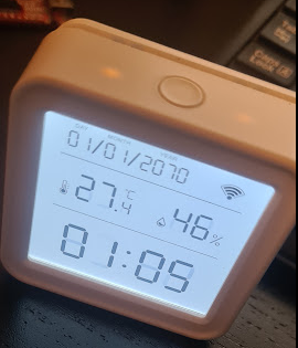

    It was only today that I managed to get my TH08 sensor working (except the time and date are wrong). How do I make the display show the correct time and date?
    I leave my log here, along with some photos.
    Thank you very much for the help already given
    startDriver TuyaMCU
    startDriver tmSensor
    startDriver NTP
    ntp_setServer  192.168.1.198
    ntp_timeZoneOfs 1
    setChannelType 1 temperature_div10
    setChannelType 2 Humidity
    setChannelType 3 ReadOnlyLowMidHigh
    linkTuyaMCUOutputToChannel 3 val 3
    setChannelLabel 3 BatteryLevel

    Info:TuyaMCU:Received: 55 AA 00 10 00 04 03 09 17 18 4E
    Info:TuyaMCU:ProcessIncoming[v=0]: cmd 16 (Unknown) len 11
    Info:TuyaMCU:Received: 55 AA 00 06 00 00 05
    Info:TuyaMCU:ProcessIncoming[v=0]: cmd 6 (SetDP) len 7
    Info:TuyaMCU:ProcessIncoming: received TUYA_V0_CMD_OBTAINLOCALTIME, so sending back time
    Info:TuyaMCU:MCU time to set: 3617
    Info:TuyaMCU:ptime ->gmtime => tm_hour: 1
    Info:TuyaMCU:ptime ->gmtime => tm_min: 0
    Info:TuyaMCU:Received: 55 AA 00 05 00 15 09 04 00 01 00 17 02 00 04 00 00 00 00 18 02 00 04 00 00 00 00 62
    Info:TuyaMCU:V0_ParseRealTimeWithRecordStorage: processing id 9, dataType 4-enum and 1 data bytes
    Info:TuyaMCU:V0_ParseRealTimeWithRecordStorage: byte 0
    Info:TuyaMCU:V0_ParseRealTimeWithRecordStorage: processing id 23, dataType 2-val and 4 data bytes
    Info:TuyaMCU:V0_ParseRealTimeWithRecordStorage: int32 0
    Info:TuyaMCU:V0_ParseRealTimeWithRecordStorage: processing id 24, dataType 2-val and 4 data bytes
    Info:NTP:NTP_CheckForReceive: Error while receiving server's msg
    Info:MAIN:Time 18, idle 152888/s, free 72184, MQTT 1(1), bWifi 1, secondsWithNoPing -1, socks 3/38
    Info:TuyaMCU:Received: 55 AA 00 05 00 15 01 02 00 04 00 00 01 12 02 02 00 04 00 00 00 2E 03 04 00 01 01 72
    Info:TuyaMCU:V0_ParseRealTimeWithRecordStorage: int32 274
    Info:GEN:CHANNEL_Set channel 1 has changed to 274 (flags 0)
    Info:MQTT:Channel has changed! Publishing 274 to channel 1
    Info:MQTT:Publishing val 274 to th08/1/get retain=0
    Info:TuyaMCU:V0_ParseRealTimeWithRecordStorage: int32 46
    Info:GEN:CHANNEL_Set channel 2 has changed to 46 (flags 0)
    Info:MQTT:Channel has changed! Publishing 46 to channel 2
    Info:MQTT:Publishing val 46 to th08/2/get retain=0
    Info:TuyaMCU:V0_ParseRealTimeWithRecordStorage: byte 1
    Info:GEN:CHANNEL_Set channel 3 has changed to 1 (flags 0)
    Info:MQTT:Channel has changed! Publishing 1 to channel 3
    Info:MQTT:Publishing val 1 to th08/3/get retain=0
    Info:MQTT:MQTT client in mqtt_incoming_publish_cb topic th08/1/get
    Info:MQTT:MQTT client in mqtt_incoming_publish_cb topic th08/2/get
    Info:MQTT:MQTT client in mqtt_incoming_publish_cb topic th08/3/get
    Info:CFG:####### Boot Count 1661 #######
    Warn:CFG:CFG_InitAndLoad: Correct config has been loaded with 27 changes count.
    Error:CMD:no file early.bat err -2
    Info:GEN:PIN_SetupPins pins have been set up.
    Info:MAIN:Main_Init_Before_Delay done
    Info:MAIN:Main_Init_Delay
    Info:MAIN:Main_Init_Delay done
    Info:MAIN:Using SSID [network_WIFI_name]
    Info:MAIN:Using Pass [xxxx]
    Info:MQTT:MQTT_RegisterCallback called for bT th08/ subT th08/+/set
    Info:MQTT:MQTT_RegisterCallback called for bT bekens_n/ subT bekens_n/+/set
    Info:MQTT:MQTT_RegisterCallback called for bT cmnd/th08/ subT cmnd/th08/+
    Info:MQTT:MQTT_RegisterCallback called for bT cmnd/bekens_n/ subT cmnd/bekens_n/+
    Info:MQTT:MQTT_RegisterCallback called for bT th08/ subT th08/+/get
    Info:CMD:CMD_StartScript: started autoexec.bat at the beginning
    Info:MAIN:Main_Init_After_Delay done
    Info:MAIN:Started TuyaMCU.
    Info:MAIN:Started tmSensor.
    Info:NTP:NTP driver initialized with server=192.168.1.198, offset=0
    Info:MAIN:Started NTP.
    Info:NTP:NTP server set to 192.168.1.198
    Info:NTP:NTP offset set
    Info:GEN:Channel 1 type changed to temperature_div10
    Info:GEN:Channel 2 type changed to Humidity
    Info:GEN:Channel 3 type changed to ReadOnlyLowMidHigh
    Info:MAIN:Time 1, idle 268643/s, free 78048, MQTT 0(0), bWifi 0, secondsWithNoPing -1, socks 2/38
    Info:TuyaMCU:Received: 55 AA 00 01 00 24 7B 22 70 22 3A 22 69 64 79 70 6B 62 6F 6B 61 72 64 78 74 38 32 33 22 2C 22 76 22 3A 22 31 2E 30 2E 30 22 7D BC
    Info:TuyaMCU:ProcessIncoming[v=0]: cmd 1 (QueryProductInformation) len 43
    Info:TuyaMCU:ParseQueryProductInformation: received {"p":"idypkbokardxt823","v":"1.0.0"}
    Info:MAIN:Time 2, idle 189486/s, free 78048, MQTT 0(0), bWifi 0, secondsWithNoPing -1, socks 2/38
    Info:MAIN:Time 3, idle 191221/s, free 78048, MQTT 0(0), bWifi 0, secondsWithNoPing -1, socks 2/38
    Info:TuyaMCU:Received: 55 AA 00 03 00 00 02
    Info:TuyaMCU:ProcessIncoming[v=0]: cmd 3 (WiFiState) len 7
    Info:MAIN:Time 4, idle 192236/s, free 78048, MQTT 0(0), bWifi 0, secondsWithNoPing -1, socks 2/38
    Info:MAIN:Time 5, idle 191134/s, free 78048, MQTT 0(0), bWifi 0, secondsWithNoPing -1, socks 2/38
    Info:MAIN:ssid:network_WIFI_name key:xxxxxxxx
    Info:MAIN:Time 6, idle 183437/s, free 72664, MQTT 0(0), bWifi 0, secondsWithNoPing -1, socks 2/38
    Info:MAIN:Boot complete time reached (5 seconds)
    Info:CFG:####### Set Boot Complete #######
    Info:MAIN:Time 7, idle 181609/s, free 72192, MQTT 0(0), bWifi 0, secondsWithNoPing -1, socks 2/38
    Info:MAIN:Time 8, idle 85533/s, free 71808, MQTT 0(0), bWifi 0, secondsWithNoPing -1, socks 2/38
    Info:MAIN:Time 9, idle 0/s, free 71808, MQTT 0(0), bWifi 0, secondsWithNoPing -1, socks 2/38
    Info:MAIN:Time 10, idle 0/s, free 71808, MQTT 0(0), bWifi 0, secondsWithNoPing -1, socks 2/38
    Info:GEN:dhcp=0 ip=0.0.0.0 gate=0.0.0.0 mask=0.0.0.0 mac=18:de:50:be:02:d1
    Info:GEN:sta: 0, softap: 0, b/g/n
    Info:MAIN:Main_OnWiFiStatusChange - WIFI_STA_CONNECTING - 1
    Info:MAIN:Main_OnWiFiStatusChange - WIFI_STA_CONNECTED - 4
    Info:MAIN:Time 11, idle 84733/s, free 63680, MQTT 0(0), bWifi 1, secondsWithNoPing -1, socks 4/38
    Info:MAIN:Time 12, idle 179775/s, free 72328, MQTT 0(0), bWifi 1, secondsWithNoPing -1, socks 3/38
    Info:MAIN:Time 16, idle 194188/s, free 72240, MQTT 0(1), bWifi 1, secondsWithNoPing -1, socks 3/38
    Info:MQTT:mqtt_connection_cb: Successfully connected
    Info:MQTT:mqtt_subscribed to th08/+/set
    Info:MQTT:mqtt_subscribed to bekens_n/+/set
    Info:MQTT:mqtt_subscribed to cmnd/th08/+
    Info:MQTT:mqtt_subscribed to cmnd/bekens_n/+
    Info:MQTT:mqtt_subscribed to th08/+/get
    Info:MQTT:Publishing val 18:de:50:be:02:d1 to th08/mac retain=0
    Info:MAIN:Time 19, idle 166290/s, free 60304, MQTT 1(1), bWifi 1, secondsWithNoPing -1, socks 4/38
    Info:CFG:####### Boot Count 1662 #######
    Info:MAIN:Time 1, idle 264996/s, free 78048, MQTT 0(0), bWifi 0, secondsWithNoPing -1, socks 2/38
    Info:MAIN:Time 2, idle 186185/s, free 78048, MQTT 0(0), bWifi 0, secondsWithNoPing -1, socks 2/38
    Info:MAIN:Time 3, idle 188737/s, free 78048, MQTT 0(0), bWifi 0, secondsWithNoPing -1, socks 2/38
    Info:MAIN:Time 4, idle 191239/s, free 78048, MQTT 0(0), bWifi 0, secondsWithNoPing -1, socks 2/38
    Info:MAIN:Time 5, idle 189010/s, free 78048, MQTT 0(0), bWifi 0, secondsWithNoPing -1, socks 2/38
    Info:MAIN:Time 6, idle 181618/s, free 72592, MQTT 0(0), bWifi 0, secondsWithNoPing -1, socks 2/38
    Info:MAIN:Time 7, idle 180547/s, free 72120, MQTT 0(0), bWifi 0, secondsWithNoPing -1, socks 2/38
    Info:MAIN:Time 8, idle 84362/s, free 71680, MQTT 0(0), bWifi 0, secondsWithNoPing -1, socks 2/38
    Info:MAIN:Time 9, idle 0/s, free 71680, MQTT 0(0), bWifi 0, secondsWithNoPing -1, socks 2/38
    Info:MAIN:Time 10, idle 0/s, free 71680, MQTT 0(0), bWifi 0, secondsWithNoPing -1, socks 2/38
    Info:MQTT:MQTT base topic is dirty, will reinit callbacks and reconnect
    Info:MQTT:MQTT has pending reconnect in 4
    Info:MAIN:Time 11, idle 89907/s, free 72248, MQTT 0(0), bWifi 1, secondsWithNoPing -1, socks 3/38
    Info:MQTT:MQTT has pending reconnect in 2
    Info:MQTT:mqtt_userName user_mqtt
    mqtt_pass pass_mqtt
    mqtt_clientID th08
    mqtt_host 192.168.1.80:1883
    Info:MAIN:Time 13, idle 186515/s, free 60304, MQTT 0(1), bWifi 1, secondsWithNoPing -1, socks 4/38
    Info:MAIN:Time 17, idle 181105/s, free 72288, MQTT 0(1), bWifi 1, secondsWithNoPing -1, socks 3/38
    Info:CFG:####### Boot Count 1663 #######
    Info:MAIN:Time 1, idle 270167/s, free 78048, MQTT 0(0), bWifi 0, secondsWithNoPing -1, socks 2/38
    Info:MAIN:Time 2, idle 188268/s, free 78048, MQTT 0(0), bWifi 0, secondsWithNoPing -1, socks 2/38
    Info:MAIN:Time 3, idle 191333/s, free 78048, MQTT 0(0), bWifi 0, secondsWithNoPing -1, socks 2/38
    Info:MAIN:Time 4, idle 192140/s, free 78048, MQTT 0(0), bWifi 0, secondsWithNoPing -1, socks 2/38
    Info:MAIN:Time 5, idle 191142/s, free 78048, MQTT 0(0), bWifi 0, secondsWithNoPing -1, socks 2/38

    Screenshot of the configuration panel for the OpenBK7231N device, displaying parameters like temperature, humidity, and network settings.
    User interface of the OpenBK7231N device showing status and sensor information.
    TH08 sensor display showing incorrect date and time.

    It seems you have a lot of NTP errors in your log. Are you sure that your NTP IP is correct?>
  • #178 21073866
    kkarmah
    Posts: 11
    Yes. It's like assigning a static IP to the device, isn't it? I went to confirm now once again, this IP is his...

    When I remove the batteries and it turns on, the date appears 04/18/2022 00:00 but then returns to 01/01/2070 01:00 Hours.
    And from last night to this morning (Times in Portugal), the display only changed from 01:00 to 01:36 hours...

    Info:MQTT:Publishing val OpenBK7231N 1.17.571 May 3 2024 21:03:10 to th08/build retain=0
    Info:MAIN:Time 15, idle 172346/s, free 72344, MQTT 1(1), bWifi 1, secondsWithNoPing -1, socks 3/38
    Info:TuyaMCU:Received: 55 AA 00 05 00 15 01 02 00 04 00 00 00 FB 02 02 00 04 00 00 00 44 03 04 00 01 02 71
    Info:TuyaMCU:V0_ParseRealTimeWithRecordStorage: int32 251
    Info:GEN:CHANNEL_Set channel 1 has changed to 251 (flags 0)
    Info:MQTT:Channel has changed! Publishing 251 to channel 1
    Info:MQTT:Publishing val 251 to th08/1/get retain=0
    Info:TuyaMCU:V0_ParseRealTimeWithRecordStorage: int32 68
    Info:GEN:CHANNEL_Set channel 2 has changed to 68 (flags 0)
    Info:MQTT:Channel has changed! Publishing 68 to channel 2
    Info:MQTT:Publishing val 68 to th08/2/get retain=0
    Info:GEN:CHANNEL_Set channel 3 has changed to 2 (flags 0)
    Info:MQTT:Channel has changed! Publishing 2 to channel 3
    Info:MQTT:Publishing val 2 to th08/3/get retain=0
