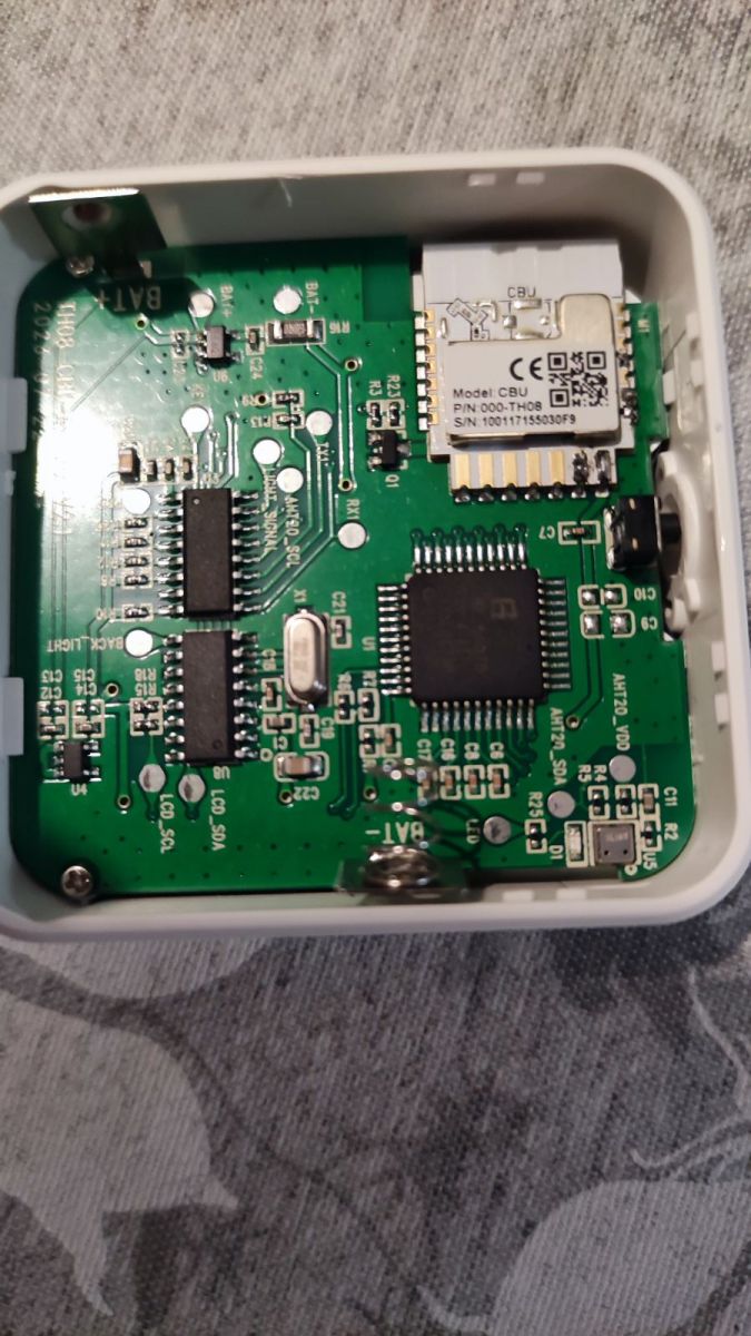

  • TH08-CBU-ATH20-V2 is a LCD calendar/clock/temperature/humidity unit with a BK7231N CBU module, BL55070 LCD driver, and ATH20 sensor.
  • U3 appears to be the Tuya MCU, while U8 with a 32.768 kHz crystal likely handles RTC and LCD/backlight control, and Q1 switches Wi‑Fi power.
  • It runs from 3xAAA cells at 4.5V and was bought for 4.49€ as a Choice offer.
  • The Tuya app shows a 1 hour update interval, and pairing can fail because the device connects only briefly between updates.

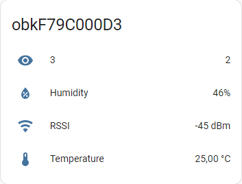

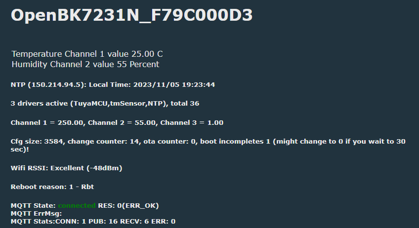

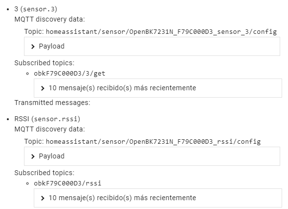

    @morgan_flint nothing was changed in relation to RSSI, but maybe you need to do HASS discovery again?
    Bingo! I didi it again and now it shows RSSI:
    A screenshot from Home Assistant showing MQTT device data with icons for humidity, RSSI, and temperature.
    This is what appears under MQTT info in HomeAssistant:
    Screenshot showing MQTT data in HomeAssistant.

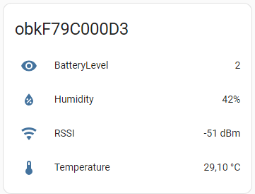

    Done:
    Device status panel with battery level and environmental data.
    Added setChannelLabel 3 Battery level to autoexec.bat and launched Start Home Assistant Discovery afterwards.
    Also updated fw to 305

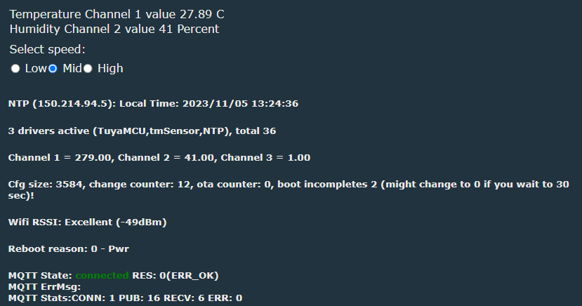

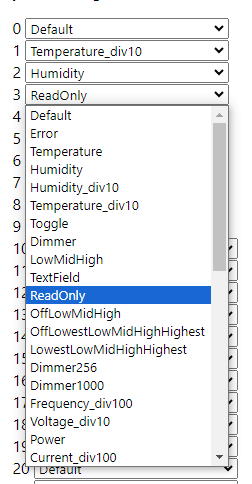

    These are the possibilities in "Channel types": Dropdown list showing available channel types in a user interface.
    I will try with "LowMidHigh"
    EDIT: Changed "setChannelType 3 ReadOnly" to "setChannelType 3 LowMidHig" in autoexec.bat. The main page changed to this:
    Screenshot of the interface with channel information and MQTT settings.
    But, in Home Assistant, "BatteryLevel" disappears, even after executing "Home Assistant Discovery" several times
    Changed autoexec back to "setChannelType 3 ReadOnly" and the battery level reappeared in Home Assistant.
    Looking at the new "control" in the web interface, I understand "lowMidHig" is intended for something you can control, not a (read only) measurement
    For me it's OK to have 1-2 as BatteryLevel instead of a string; I'm not really sure of the range of this measurement, maybe0-1-2 or 1-2-3 0r even 0-1-2-3, I should use a variable power supply and start lowering voltage from 4.5V to see when it changes, and how does it change

    You are correct, but if you check our docs:
    https://github.com/openshwprojects/OpenBK7231T_App/blob/main/docs/channelTypes.md
    You can see that we also have:
    ReadOnlyLowMidHigh	Like LowMidHigh, but just read only
    Maybe that one can work for you.

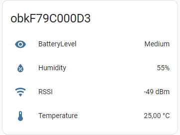

    I've just tried it:
    Screenshot of the OpenBK7231N interface displaying temperature and humidity parameters and connection details. Information panel displaying battery level, humidity, RSSI, and temperature.
    Now we still have to check that 1 is really "Medium". I'm feeding it with a small LiPo which is now 3.9V and the battery low icon isn't showing on the screen, so it could be really "Medium" (the device is designed for 3 * 1.5V batteries)

    EDIT: I'm now feeding it from 5V, the channel 3 value is 2 and showing "High" in Home Assistant. Now, I'll have to find the low voltage threshold...

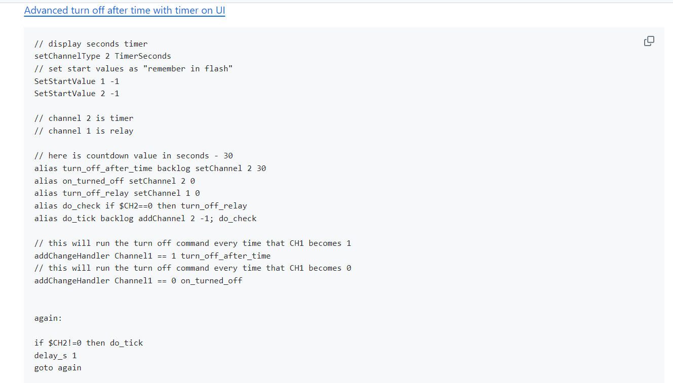

    Timers can be created in many ways and they are fully scriptable.
    For example:
    Screenshot of script code with comments for a timer in the UI.

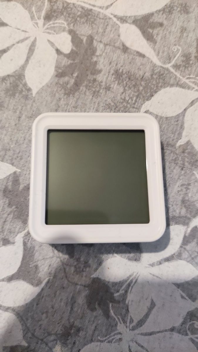

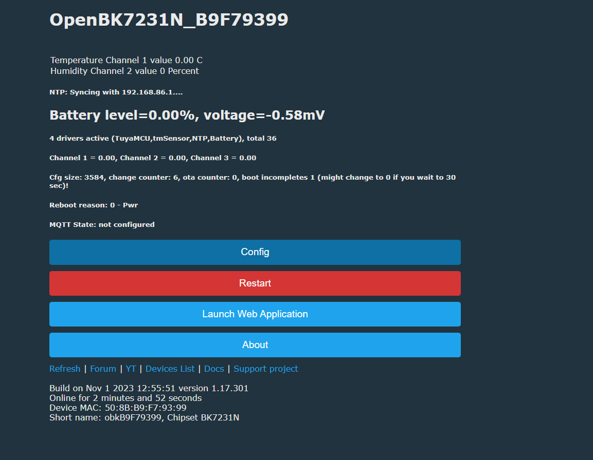

    vikicha

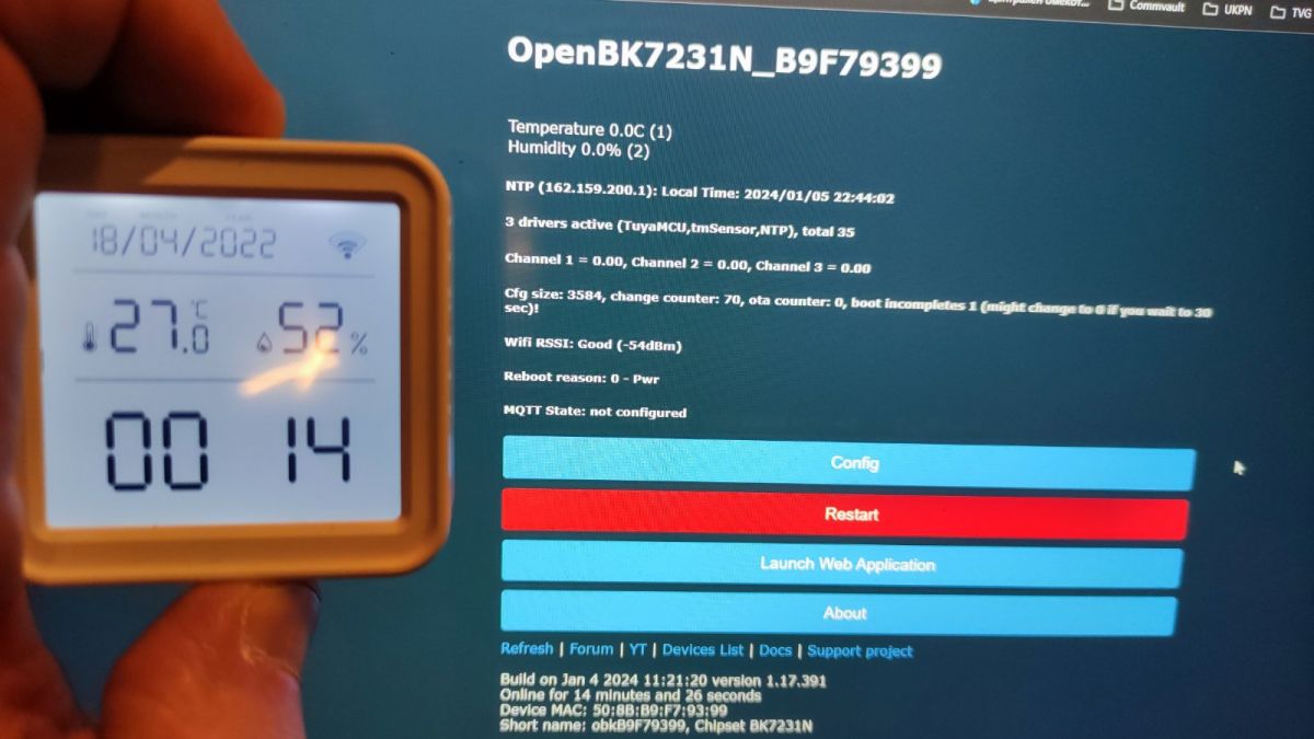

    Hello Guys
    I try TH08 with OpenBK but it did not read sensor, it just show zeroes.
    Screenshot of the OpenBK7231N interface showing no sensor readings.
    Also i try to flash it on PCB directly but it did not work, i have to desolder it and then the flash is successful.
    Can you help with the sensor?
  • #119 20892770
    auntlydia
    Posts: 70
    Rate: 14
    are you sure it is the same device? also, you may wanna try the current firmware 1.17.391 - I have multiple of those devices and they all work perfectly fine. The problem that a sensor shows zero values happened to me when I forced the device in keeping wifi connection by keeping the button pressed. maybe they have changed the design of the pcbs? it might be worth taking a look at the pcb pictures and compare.
  • #120 20892912

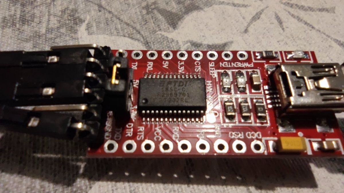

    vikicha
    i think it is the same device or i'm wrong.
    LCD display in a white frame on a gray floral pattern background. Internal view of an electronic device with a visible main board and CBU module.

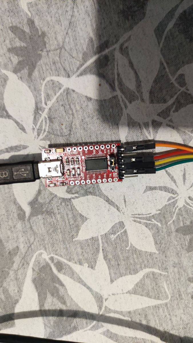

    and this is the UART i used for flash.
    USB to UART converter module with connected wires. Red circuit board with FTDI chip and connectors.
    i try the latest OBK 1.17.391 firmware but it is the same, no sensor readings only zeroes.
    Config in autoexec.bat is.
    startDriver NTP
    // starts the NTP driver (network time)
    startDriver TuyaMCU
    // starts the TuyaMCU driver
    startDriver tmSensor
    //starts the tmSensor driver
    ntp_setServer 192.168.86.1
    // sets the preferred NTP time server IP adress
    ntp_timeZoneOfs 1
    // corrects time zone by hour value +/- (time zone offset)
    setChannelType 1 temperature_div10
    //sets the type of channel 1 (selected freely) to temperature times 10 (i.e. 23.5C written as 235 integer, as this notation is used by Tuya), thanks to which OpenBeken knows how to display its value on the panel
    linkTuyaMCUOutputToChannel 1 val 1
    // maps dpID from TuyaMCU (variable identifier) 1 to channel 1, value type. In this particular device, dpID 1 is temperature. dpID roles vary by device
    setChannelType 2 Humidity
    // sets channel 2 type to humidity
    linkTuyaMCUOutputToChannel 2 val 2
    // as before, here dpID 2 is humidity
    linkTuyaMCUOutputToChannel 3 val 3
    setChannelType 3 ReadOnlyLowMidHigh
    setChannelLabel 3 "Battery Level"
    mqtt_broadcastItemsPerSec 20
    [Edit]
    Also date and time seems synced from NTP but not pushed to LCD
