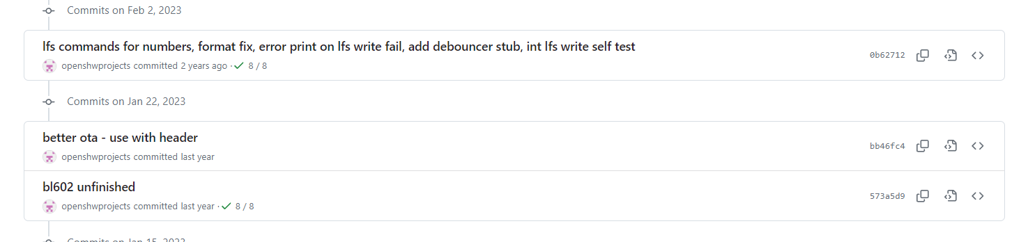

  • Suggest testing January 2023 build and disabling BL0937
    #33 20925372
    Posts: 14755
    Rate: 12880
    If you are willing to investigate the issue futher, I would suggest getting version from the January 2023 and checking if it also works in unreliable manner:
    Screenshot of commit history in a repository, showing changes made on February 2 and January 22, 2023.
    I introduced BL602 in January 2023 and as far as I remember it worked well. So, I would suggest you to flash the Feb 2023 build and try to narrow down when it began to break.... but take care, keep your UART ready, if you are not sure, then don't do it, I don't want you to brick your device or something.
    EDIT:wait, that BL0937 driver does a lot of interrupts, have you tried to OTA without BL0937??

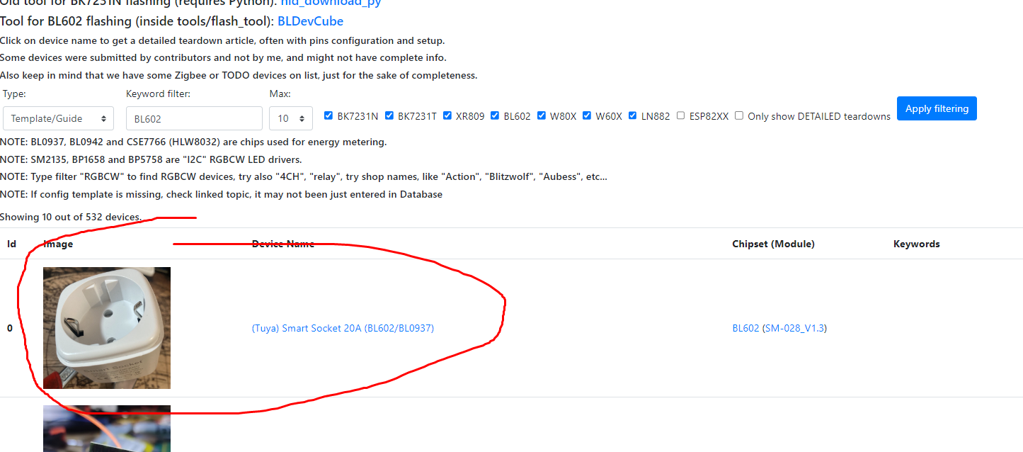

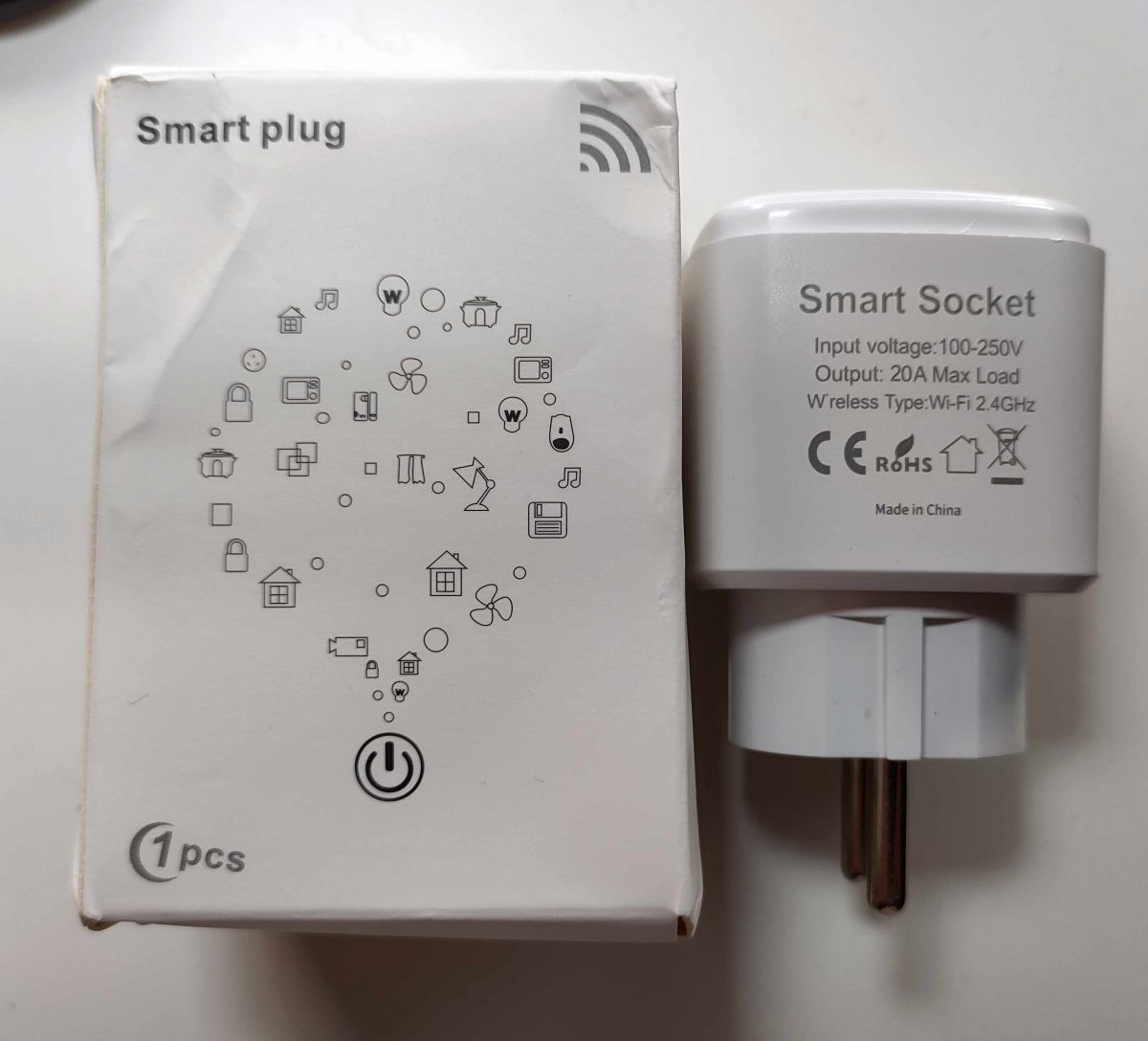

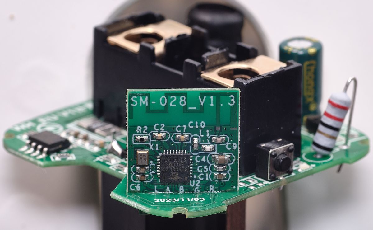

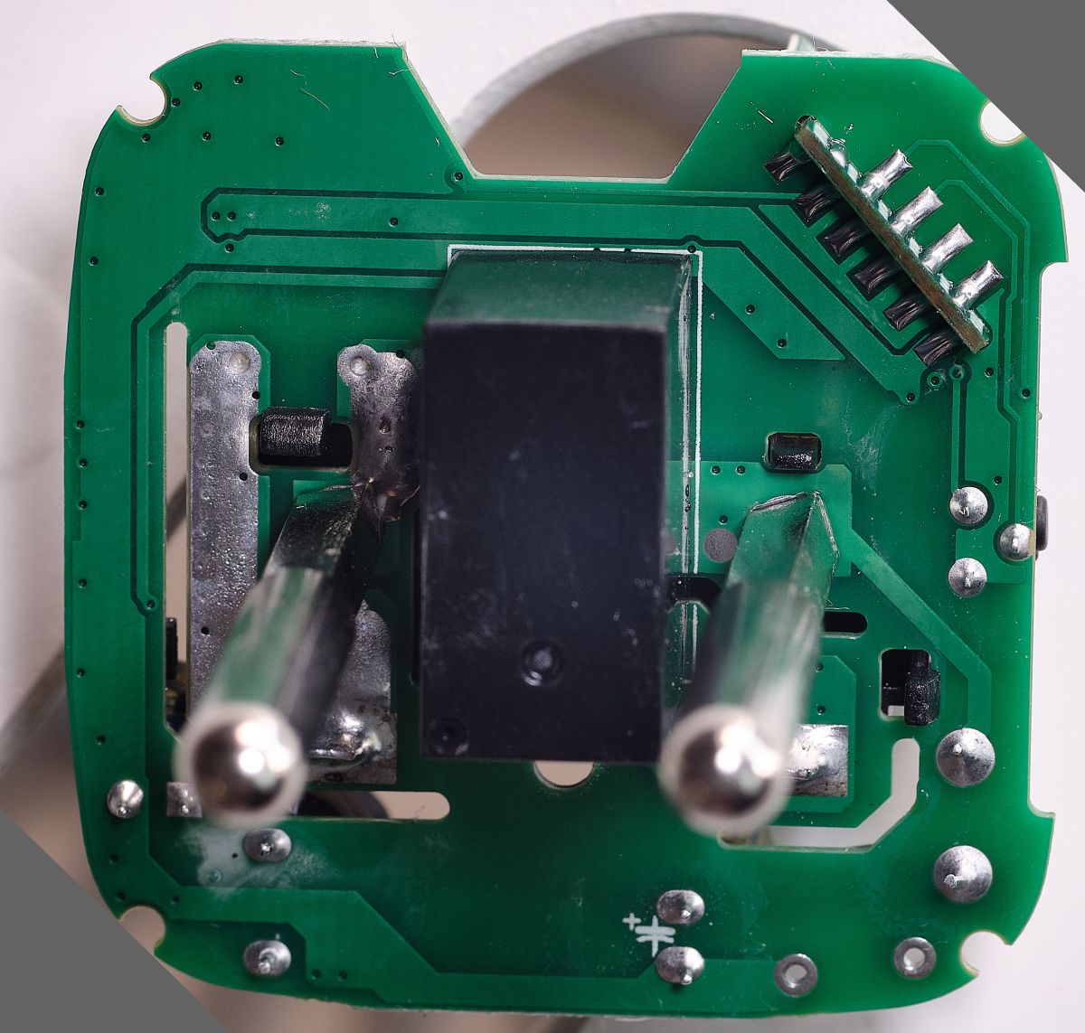

  • Pinout works, but device is missing from BL602 list
    #50 21004198
    Raufaser
    Posts: 47
    Rate: 16

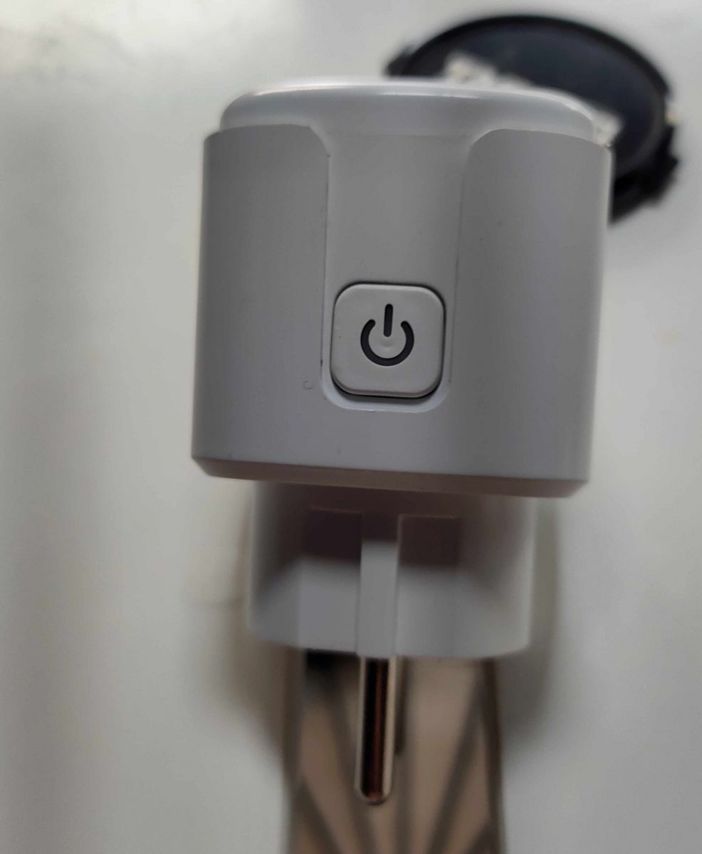

    I think i got the same socket:
    White smart plug with power button on a white wall. Image of a smart plug packaging and device with a voltage range of 100-250V.

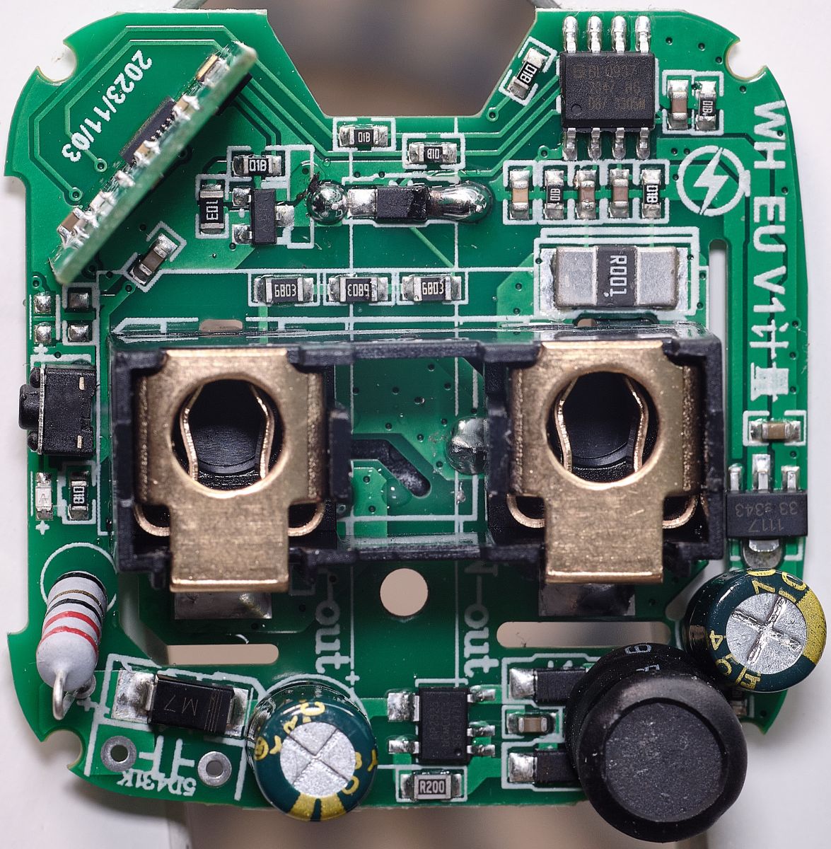

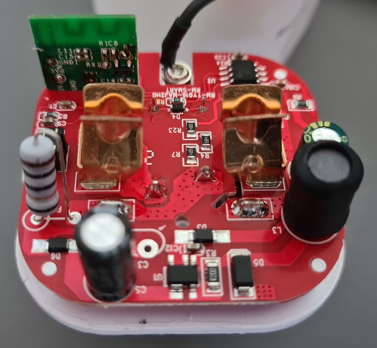

    I have some high res pics of the internals:
    Close-up of a circuit board with electronic components. Close-up of a circuit board labeled SM-028_V1.3, showing electronic components. Close-up of a printed circuit board of an electronic device.
    I took the pin configuration as described in the first post. It works until now.
    This device is not in the device list when filtering for BL602. Maybe something is missing?
  • #51 21014474
    Posts: 14755
    Rate: 12880
    Why do you think it's missing? How to replicate the problem?

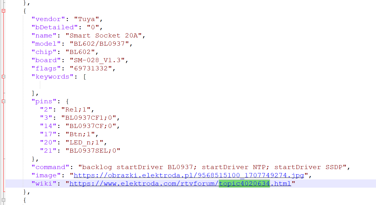

    This thread is listed in devices.json:
    A JSON code snippet with information about the Smart Socket 20A device.
    Or are you referring to other model?
    Screenshot of an IoT device list featuring a highlighted Tuya smart socket.
    See: https://openbekeniot.github.io/webapp/devicesList.html

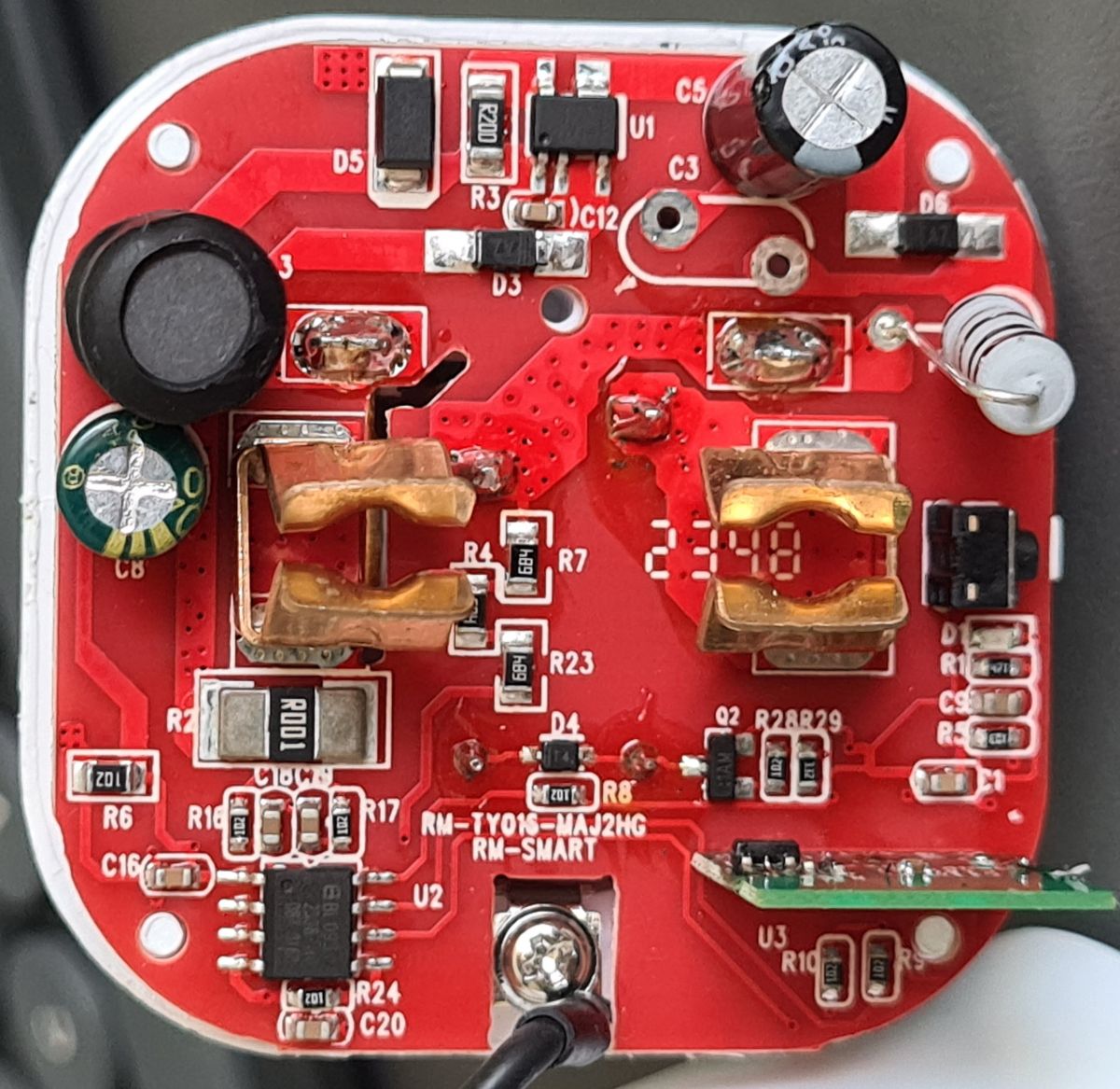

  • Freezing BL602 socket with BL0937 driver enabled
    #52 21025349
    zdzihu123
    Posts: 11
    I have similar BL602/BL0937 (module: SM-028_V1.3) RMC021 20A smart socket and also am facing freezing issue. It stops responding after some time (sometimes 15 min, sometimes 2-3h). When it's frozen I cannot access web gui, no ping, button not working.
    Build on Mar 28 2024 15:26:36 version 1.17.523
    Short name: RMC021, Chipset BL602
    I am going to test it with BL0937 driver disabled. Please point me to next troubleshooting steps.

    Drivers: startDriver BL0937; startDriver NTP; startDriver SSDP
      "vendor": "eWeLink",
      "bDetailed": "0",
      "name": "eWeLink Smart WiFi Socket 20A",
      "model": "RMC021",
      "chip": "BL602",
      "board": "SM-028_V1.3",
      "flags": "1024",
      "keywords": [
        "BL602",
        "socket",
        "BL0937"
      "pins": {
        "2": "Rel;1",
        "3": "BL0937CF1;0",
        "14": "BL0937CF;0",
        "20": "LED_n;1",
        "21": "BL0937SEL;0",
        "22": "Btn;1"
      "image": "https://obrazki.elektroda.pl/8095216400_1711786208.jpg",
      "wiki": "https://www.elektroda.com/rtvforum/topic4020634.html"

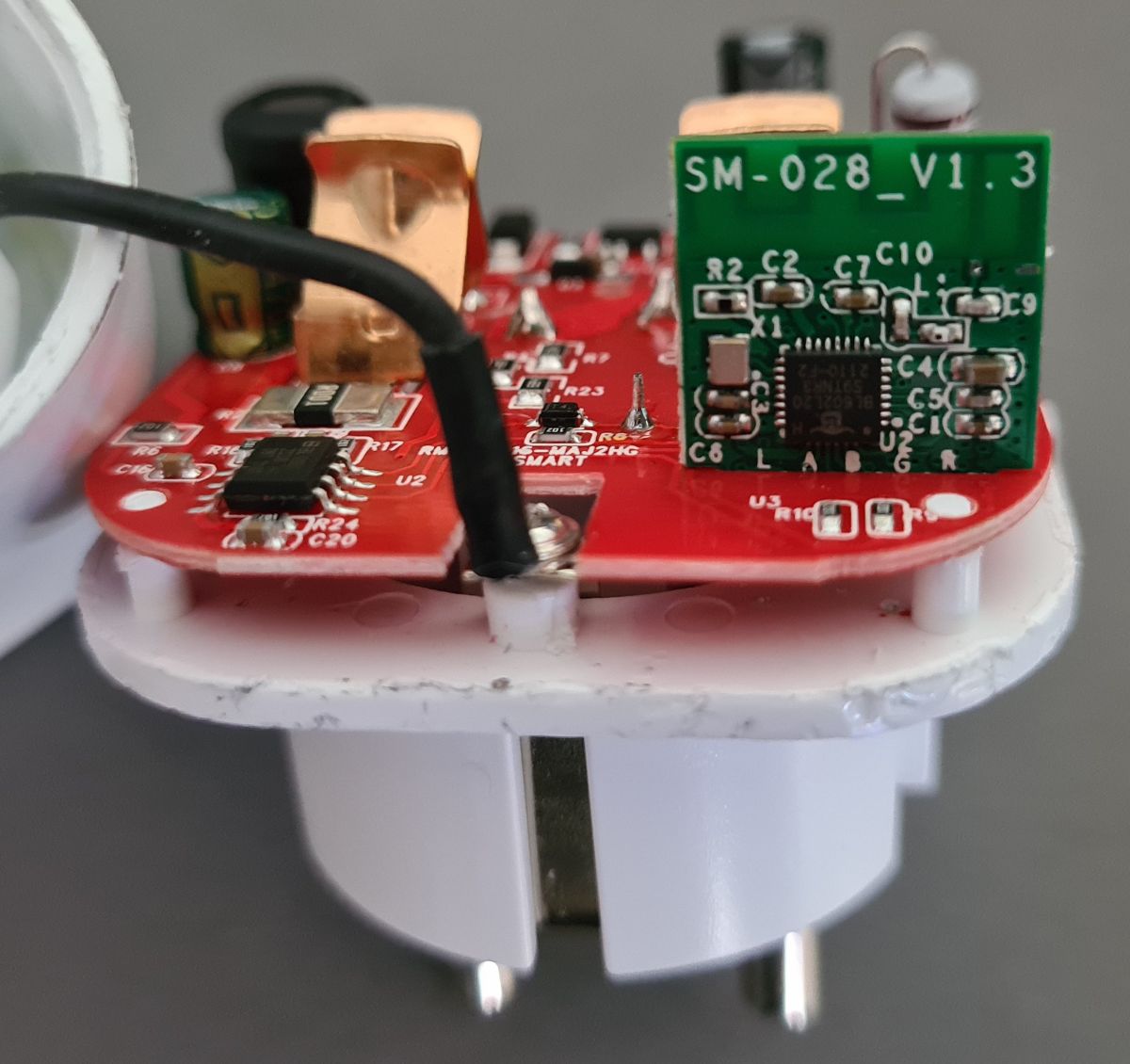

    It's not connected to HA, no mqqt traffic in network (for now I have only 1 or 2 standalone smart plugs connected to wifi, no HA connected to this wifi network).
    Electronic module of a smart WiFi socket with discrete components on a red circuit board. Close-up of the internal electronic components of an eWeLink smart plug on a red PCB with the designation SM-028_V1.3. Close-up of a red circuit board interior with various electronic components.

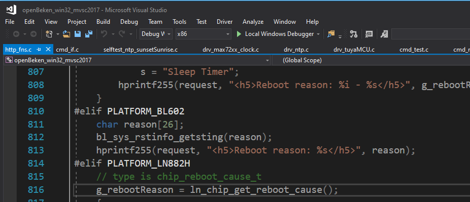

    I think the first thing we need is Watchdog. It will solve all consequences of the potential freeze.
    https://github.com/search?q=repo%3Aopenshwprojects%2FOpenBL602%20watchdog&type=code
    We already have reboot reason on BL602:
    Screenshot from Visual Studio showing source code for the BL602 platform.
    It seems the most promising WDT code is here:
    https://github.com/openshwprojects/OpenBL602/...a28/components/hal_drv/bl602_hal/bl_wdt.c#L35
    Code: C / C++
    Max timer is (65535/16) - about 4095
    So basically, first call:
    bl_wdt_init(1000);
    In the:
    and then, in driver quick tick (I guess?) call:
    bl_wdt_feed();
  • #57 21025413
