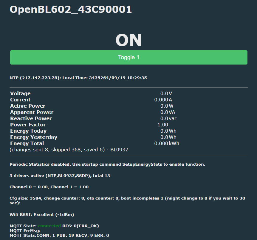

    #111 21274357
    andrewbeyou
    >>21027185 Hi, i'm new here. I managed to flash the bl602 chip but i'm stuck, because all my values are 0. I see yours is quite working. can you give a hint please?
    Screenshot of the OpenBL602 interface displaying ON and detailed energy data.
    Update: After OTA "OpenBL602_1.17.756_OTA.bin.xz.ota" the values are ok, but the physical button is not working. ( "17": "Btn;1", )
    Update: physical button on my plug tuya plug is "22": "Btn;1" not "17": "Btn;1".

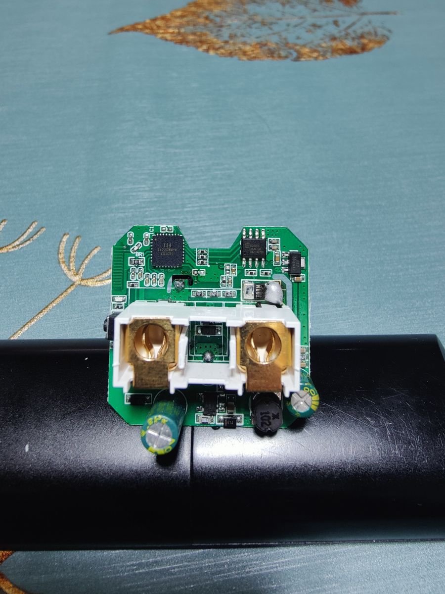

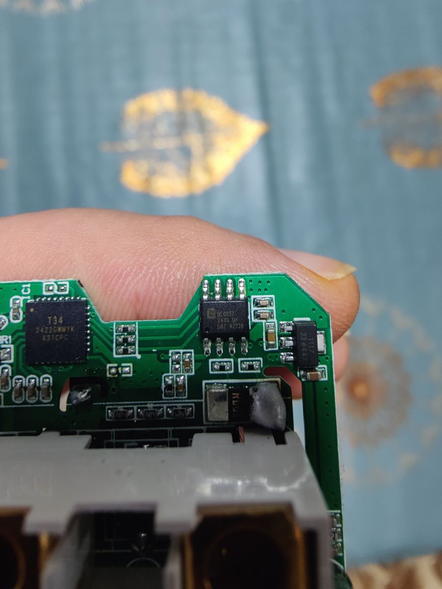

  • Need cloud-cutting method for BL602 socket firmware 1.3.18
    #114 21423243
    bezzubov
    I have firmware 1.3.18 on wifi socket 16A and can't change firmware on it by wifi, no profiles for this firmware. No software updates in SmartLife.
    It BL0937 and T34. Can you help me to cut it from cloud?
    Close-up of a circuit board with visible integrated circuits like BL0937 and T34. Image of an open electronic module with a PCB and electronic components. Smart plug box standing on a table. Packaging of a smart plug compatible with Amazon Alexa and Google Assistant.
  • #117 21423817
    Posts: 14755
    Rate: 12881
    Your T34 has clearly visible pads with solder, so accesing them should be relatively easy...

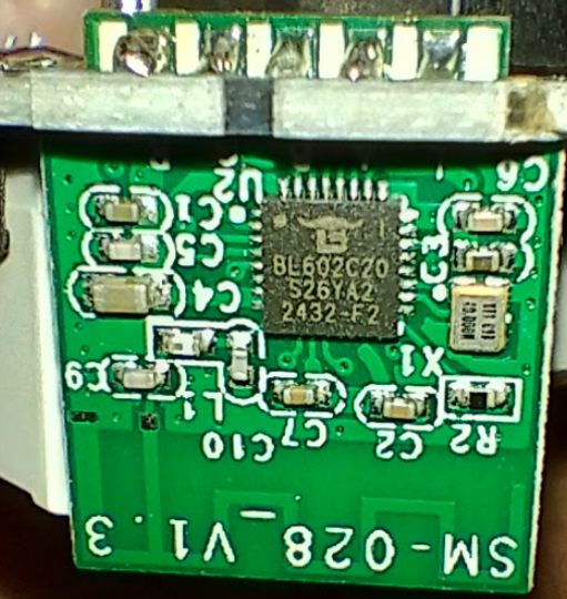

  • Web interface freezes only in normal operating mode
    #118 21734265
    mrdart
    Hello! Today I successfully UART flashed Elivco BSD33 (with BL602C20 onboard) to version 1.18.206
    Close-up of PCB with BL602CG20 chip and SM-028-V1.3 marking
    And it works fine when i connect to it using internal acceesspoint or safeboot.
    But if run socket in real life - its web interface completely freezes after a several seconds (no web, no ping etc.) - at the same time phisycal button keeps working (switching rele) together with led.
    I left only rele, button and led at configuration, no bl0937, no mqtt, no drivers, no flags, no startup items, even watchdog is off - it freezes.
    Any thoughts on this? I'm almost gave up(
