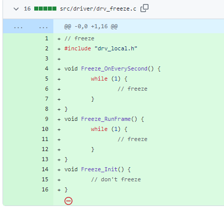

    I think I can add a "Freeze" driver that will put infinite loops in both "every second timer" and "quick tick". Usage will be:
    startDriver Freeze

    Here is PR to download binaries from:
    https://github.com/openshwprojects/OpenBK7231T_App/pull/1158
    It enables watchdog so it should just work. In order to test the watchdog, you need to start the freeze driver that just does:
    Example of source code in the drv_freeze.c file.
    So, once you confirm it just runs, you can do:
    startDriver freeze
    and it should just reboot with watchdog reason (unless I missed something, @miegapele can double check)

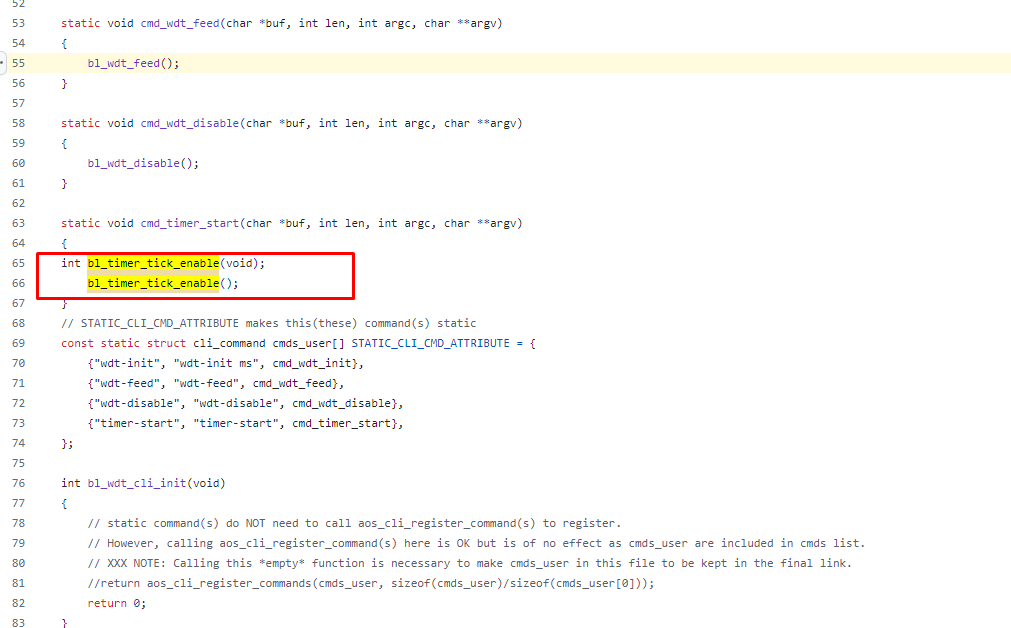

    Does not seem to work, unfortunately. It boots, acts all normally, and even OTA works, but the freeze driver freezes everything and no reboot.
    Might be you need to init timer too after all, will test
  • Missing watchdog CLI command implementation

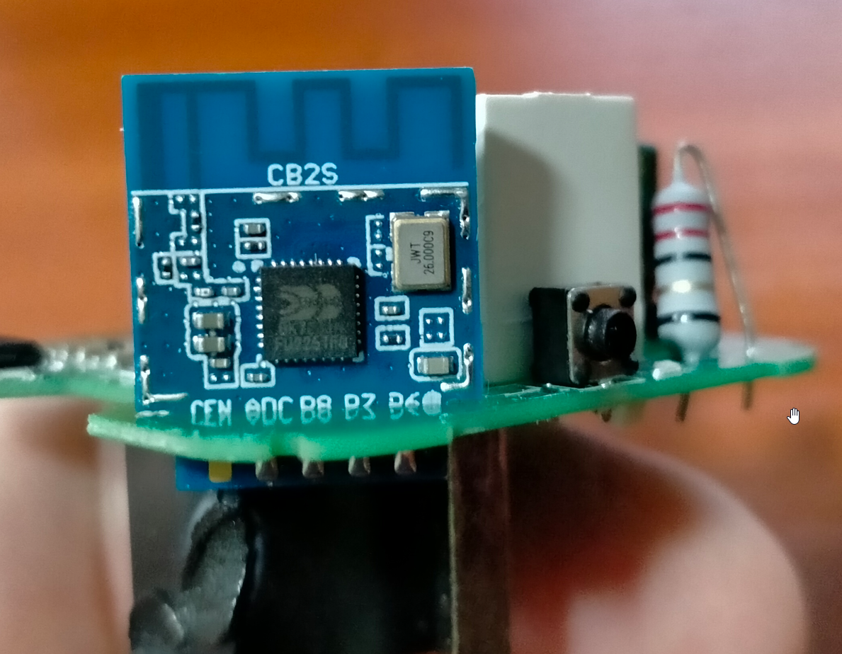

  • Suspected power-supply chip failure on socket board
    #69 21025997
    epolet
    Posts: 12

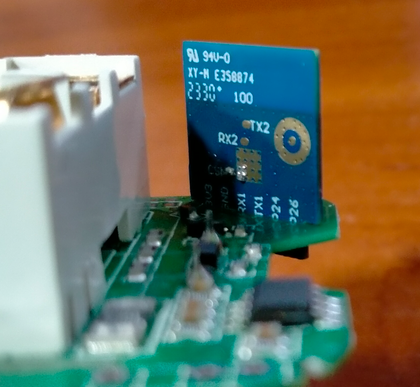

    Hello guys,
    I have such smart socket and successfully uploaded OpenBeken software. I was able to connect to it via web over wifi
    But when I soldered out wires through which it was reprogrammed, assembled it back and put to the socket, I found it doesn't work. Led seemed to sigh and go out. Neither short nor long pressing of button did not help. Soldering up two wires just to CB2S board and connecting to PC brings it to life and to wifi again. So obviously, there some trouble with power on the socket board happened. Strange - it is totally new socket. But ok, as is now.
    I suspect chip between two big capacitors (marked by red question mark on a picture (I took it from previous page, thanks)). But it is impossible to recognize it because of totally unreadable its marking.
    So, maybe anyone could advise me something to bring socket to life? Or, at least, help to recognize that chip.
    Thanks.

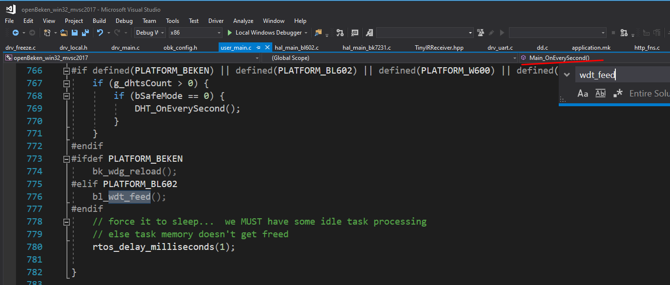

    I made same change on my branch, seems the same. everything looks frozen, but something still works. I tried forcing disconnection from the wifi, UART log then shows it trying to connect but failing.
    I will try to remove wdt_feed call, seems like something is not correct.
  • #72 21026020
    Posts: 14755
    Rate: 12880
    This is suprising @miegapele because wdt_feet is at the end of OnEverySecond call:
    Screenshot of code in Microsoft Visual Studio highlighting the function wdt_feed in the editor.
    So, with infinite loop in driver EverySecond, it should not be reached.
  • #73 21026021
    Raufaser
    Posts: 47
    Rate: 16
    Hi.
    BP2525
    There shouldn't be an CB2S in this socket. It should be SM-028_V1.3
  • #74 21026036

    Removing wdt_feet makes it properly boot loop, after it boots in safe mode fine, so maybe worth keeping, it might help with some crashes.
    ALSO that timer init code speeds up time counting by 2 so that part should not be merged.
    there is slightly different time initialization in new sdk, might try that later
  • CB2S module found in unexpected socket version
    #75 21026208
    epolet
    Posts: 12

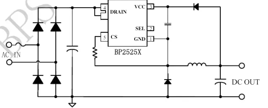

    Raufaser wrote:
    BP2525
    Yep! Thank you.
    I checked it and found it works well - 365V on input and 5.2V on output.
    So the next stop is LM1117. It has 1.8V on input and 0.8V on output.
    Strange. Between BP2525 and LM1117 there is almost nothing.
    According to typical application schematic of BP2525 (let me put it here just in case) the only diode is under suspection
    Application circuit diagram of the BP2525X for power rectification and regulation.
    Ok. Will check it.
    Maybe it is a little bit different version of the socket. It has CB2S :
    CB2S module on a circuit board with visible components. Close-up of a circuit board with a mounted CB2S module marked with RX2, TX2, and a serial number.
  • #76 21026358
    Raufaser
    Posts: 47
    Rate: 16
    OK. But then you are either in the wrong thread, or you flashed the wrong firmware.
    CB2S has a BK7231N. This thread is about the BL602. That is a different chip.

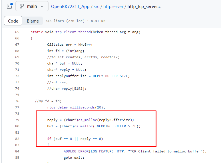

  • HTTP server malloc failure causing unreachable device
    #79 21026582
    Posts: 14755
    Rate: 12880
    @miegapele can you check is it ok to merge?
    I disabled extra timer
    @zdzihu123 well, if button is still working then I don't think that watchdog can help much... buttons are handled in the quick tick update. Hmm.
    @miegapele what do you think?
    I've seen similiar issue once or twice. It was caused by a strange TCP socket lock causing memory leak. The free memory amount was going down and memory was not freed. Finally the HTTP server code was not able to alloc new buffers for TCP connections, here:
    https://github.com/openshwprojects/OpenBK7231T_App/blob/main/src/httpserver/http_tcp_server.c
    If HTTP GET malloc is failing ,then device will not be reachable via HTTP but will still work when you press physical button.
    See this fragment:
    HTTP server code snippet highlighting memory allocation.
    Maybe we could change the server behaviour to be more bulletproof? Maybe we could prealloc, let's say, 4 buffers and keep shuffling them? But that means we will be able to only handle 4 TCP connections at all... removing the "malloc" call per HTTP packet would make HTTP server immune to "malloc returns 0" problem.
    There are of course some problems with that. For example, this code is shared between all platforms (well, except windows simulator), so any change there would require extensive testing. Unless we #ifdef that just for BL602...
    Thoughts?
  • Freeze driver was blocking watchdog reboot

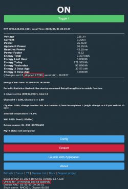

  • #82 21027185
    zdzihu123
    Posts: 11
    Thank you guys, I installed .528 and will give it a shot tomorrow.

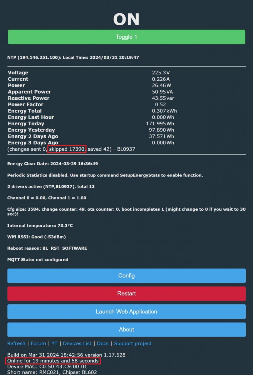

    EDIT: Just out of curiosity, is that amount or events registered by BL0937 (17390 changes in 20 min) normal? Or may it be the source of my problem?
    User interface monitoring energy data with information on skipped changes.
  • #83 21027408
    miegapele
    Posts: 173
    Help: 15
    Rate: 29
    That counter is fine, it records big numbers
