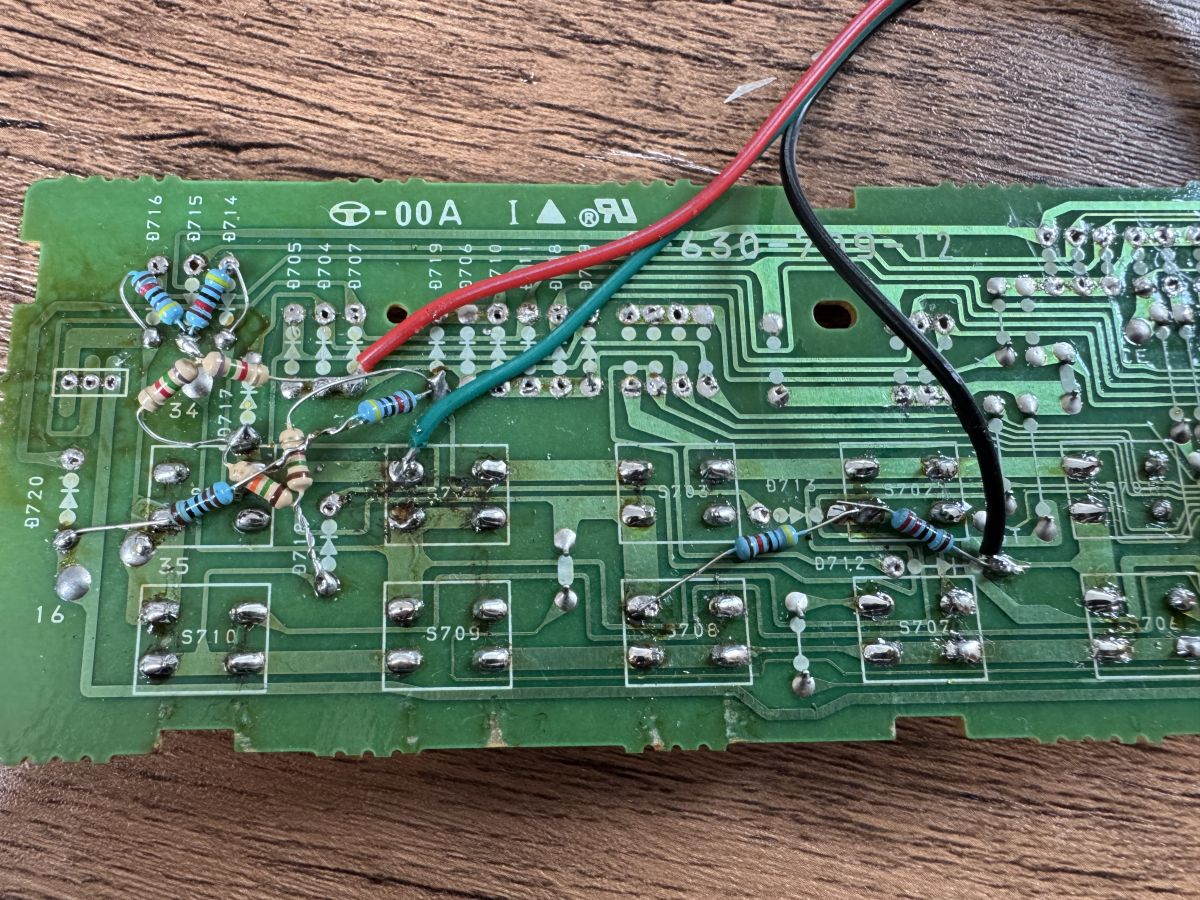

    I soldered everything off the board from Sony, added new switches, resistors. In adc read mode I have the values (two coincide) but after writing them the keyboard does not work properly. Most of the buttons don't trigger at all, some don't trigger what they should.
    Close-up of a circuit board with removed components, added new switches and resistors, and wires. .

    @gabar5 you must have something badly soldered, because it works very well with me. The ladder was chosen so that just none of the values in the matrix overlap.

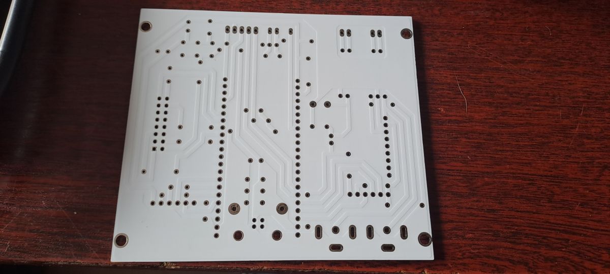

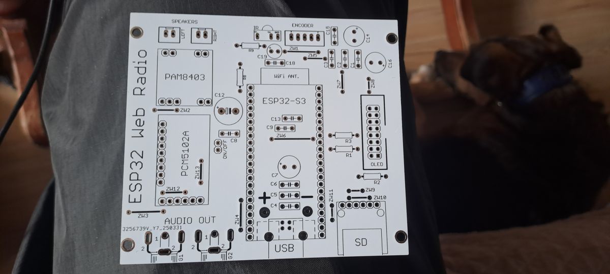

    Based on @DJCheester's graber I made tiles in china, they came out pretty cool.
    White PCB with the label ESP32 Web Radio and markings for electronic components. .
    White printed circuit board with multiple holes and traces on a dark wooden background. .

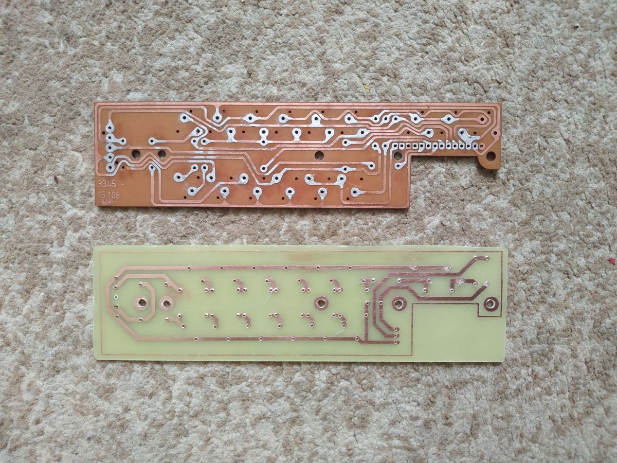

    And in the meantime I made a PCB for my keyboard
    The darker one is the unsoldered original one and the lighter one is my creation.
    Two printed circuit boards, one darker and one lighter. .
    When there's a moment again I'll solder the keyboard as needed 😀.
    I also confirm the ADC on the OLED works.

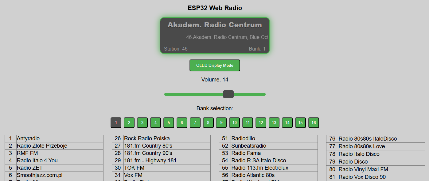

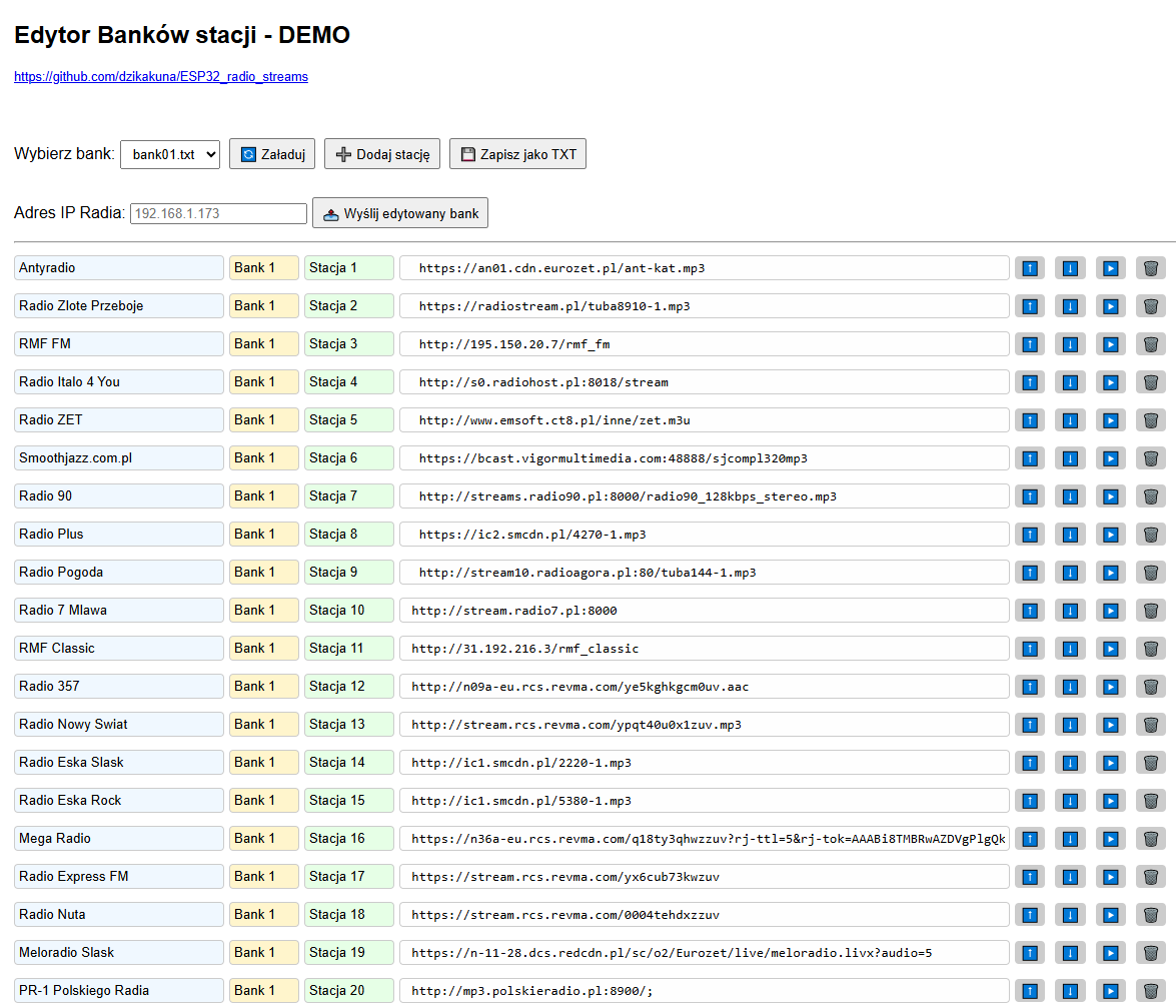

    I have made a simple bank editor. The editor allows you to download a given bank directly from GitHub, change what you need, change the order of stations and if you give it an IP number it will even automatically send us the content of our changes to the SD card of the radio :) There is also an option to play a given link before you load it. Pressing Play will play it on the radio using the radio's integrated playback function from the link provided by the web server.
    The editor is nothing more than a clever html file with a few scripts. It needs to be downloaded to disk because GitHub will not open the HTML like a browser only displays the source.
    NOTE:
    This is a demo version, it has completely no security mechanisms. If you type "Ala has a cat" in the name of the stream this will also be loaded on the SD card. The editor overwrites the current files of the Bank in question on the radio. Once the new content has been uploaded, simply reload the respective Memory Bank on the radio.
    Screenshot of an online radio station bank editor, showing a list of stations with names, links, and management options. .

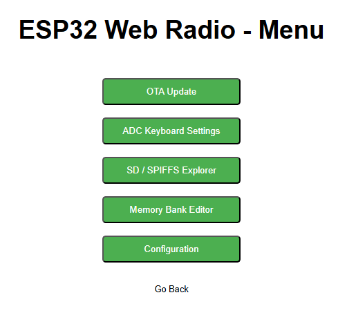

    As part of the Christmas 'bunny', I have uploaded this week's update 3.17.65 to your GitHub.
    - I added one menu where all options are now present
    - there is a new (v1.05) banks editor, it pulls banks from a txt file, github or from the radio and detects the IP or hostname of the radio itself (you have to upload the editor.html file to the SD card via web or external reader)
    - I added mDNS, the radio now reports itself on the network as hostname: esp32radio i.e. http://esp32radio.local This works minimally slower than by IP, but if someone has DHCP, there is no need to check the IP at startup.
    Main menu of the ESP32 Web Radio interface with five green option buttons and a Go Back link at the bottom. .
    Screenshot of the ESP Web Radio bank editor showing a list of radio station names, stream URLs, and management buttons.

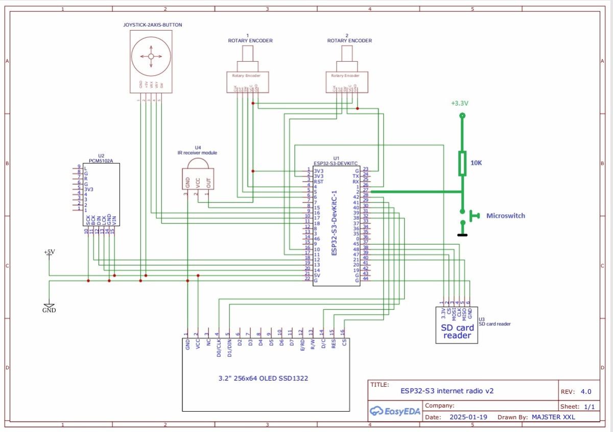

    @DJCheester I just tried to do something like this today, I added an extra microswitch pullup to the 2nd GPIO pin, a few lines of code and with this switch I turn the radio on and off. Testing for now. If that's something you wanted I'll add the code....
  • #1159 21525584
    DJCheester
    Posts: 2049
    Help: 75
    Rate: 949
    Board Language: polish
    Hi the code can you please provide or write the changes as I will be distosing to my project anyway and the switch will not quite work like that. Regards...
  • #1160 21525642
    Lechuuu
    Posts: 102
    Rate: 25

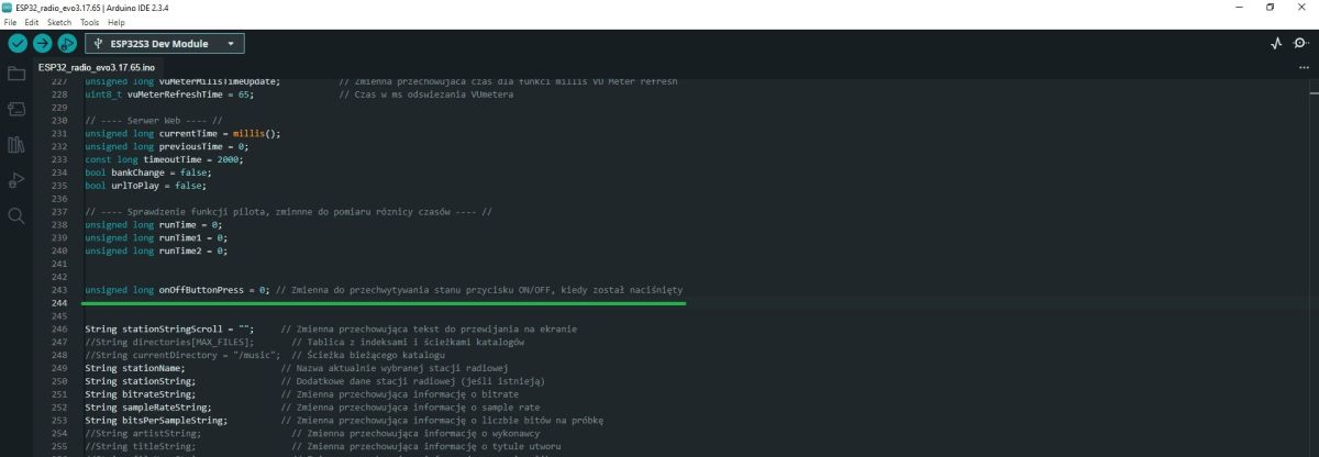

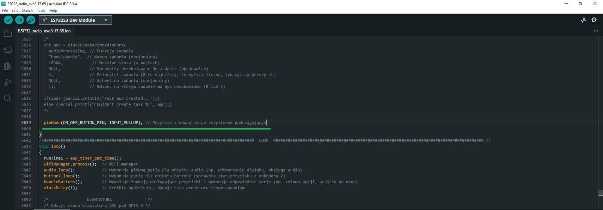

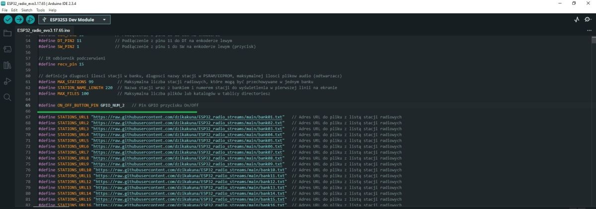

    I don't know if anyone will find it useful to switch on and off using the microswitch, but I missed it and I've put a few lines together in the dirt.
    Where to paste what - in the pictures below
    Screenshot of Arduino IDE showing a source code fragment for ESP32 with the On/Off button pin definition highlighted. .
    Screenshot from Arduino IDE showing a highlighted code line initializing a variable for the ON/OFF button state on ESP32. .
    Screenshot showing a code segment in the Arduino IDE with a highlighted line initializing a button pin with a pull-up resistor. .
    Screenshot of the Arduino IDE editor showing a highlighted code section handling an ON/OFF button for an ESP32 module. .
    Electronic schematic of the ESP32-S3 internet radio project, highlighting a microswitch connected via a 10K resistor to the ESP32 pin. .
    #define ON_OFF_BUTTON_PIN GPIO_NUM_2   // Pin GPIO przycisku On/Off
    unsigned long onOffButtonPress = 0; // Zmienna do przechwytywania stanu przycisku ON/OFF, kiedy został naciśnięty
    At the end of setup()
    pinMode(ON_OFF_BUTTON_PIN, INPUT_PULLUP); // Przycisk z wewnętrznym rezystorem podciągającym
    At the end of loop()
      // Sprawdź, czy przycisk ON/OFF jest wciśnięty
      if (digitalRead(ON_OFF_BUTTON_PIN) == LOW) {
        if (onOffButtonPress == 0) {
          onOffButtonPress = millis(); // zmienna czasu naciśnięcia przycisku
        if (millis() - onOffButtonPress >= 3000) {
          Serial.println("Wykryto długie naciśnięcie, ESP32 pozostaje w stanie czuwania.");
          onOffButtonPress = 0; // Reset timera
      } else if (onOffButtonPress > 0 && millis() - onOffButtonPress < 3000) {
        // Jeśli przycisk zostanie zwolniony przed upływem 3 sekund
        Serial.println("Wykryto krótkie naciśnięcie, przechodzę w głęboki sen.");
        esp_sleep_enable_ext0_wakeup(ON_OFF_BUTTON_PIN, LOW); // Ustawianie pinu budzenia
        u8g2.setPowerSave(1); // wyłącza wyświetlacz
        esp_deep_sleep_start(); // wlącza esp w tryb deep sleep
      } else {
        onOffButtonPress = 0; // Zresetuj timer, jeśli przycisk nie jest naciśnięty
    Ps. I am not a programmer - code to be improved by more experienced people. But it works :) .

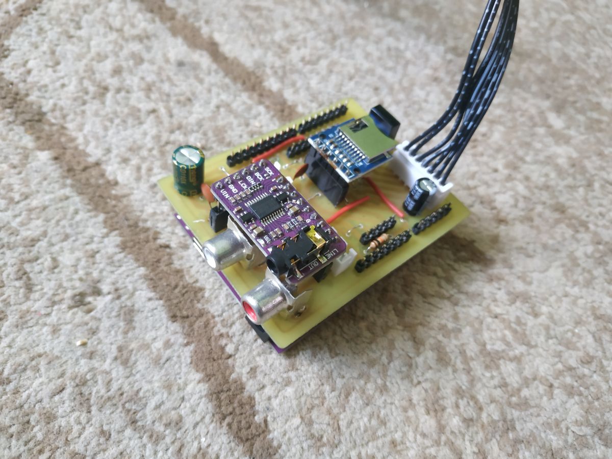

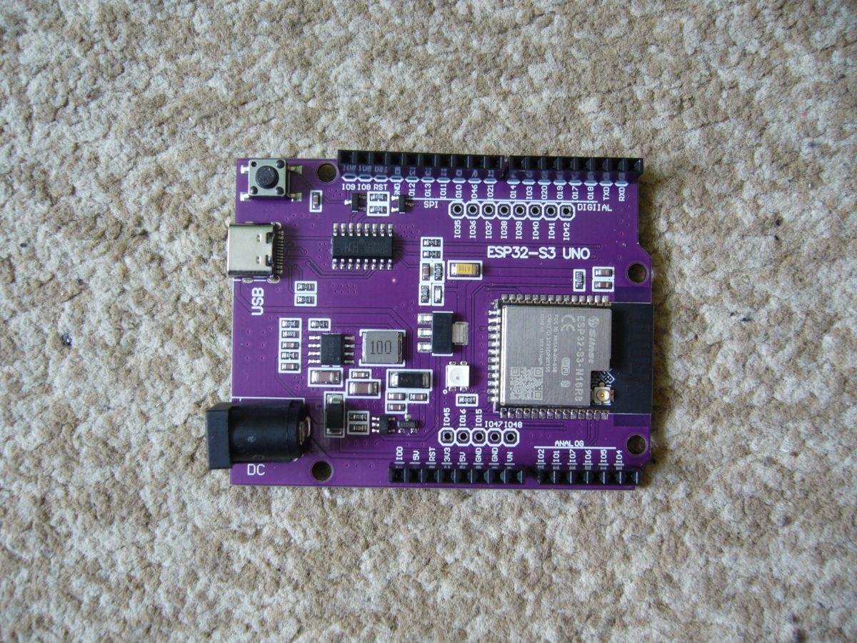

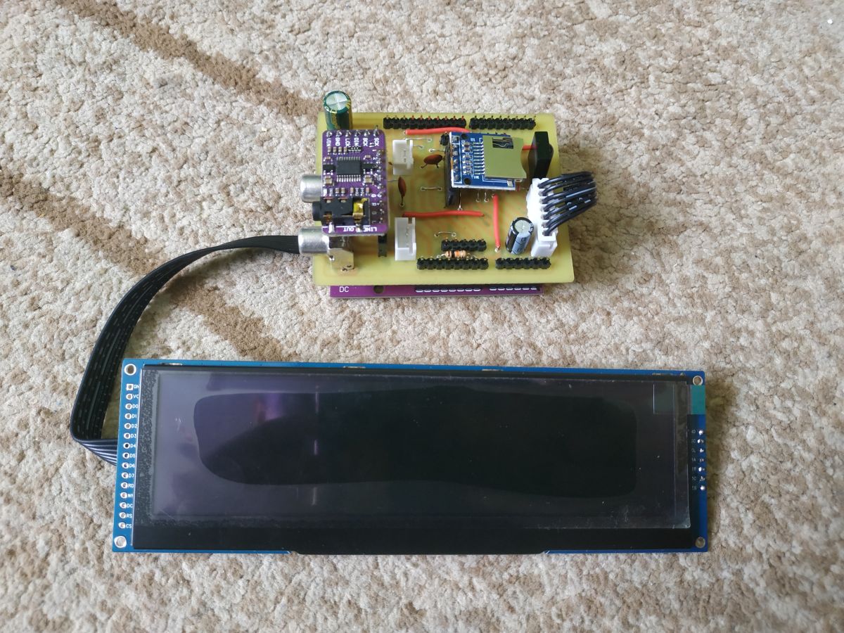

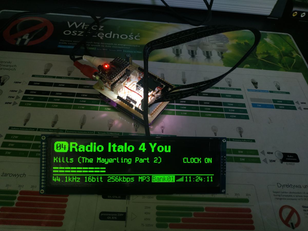

    Today, out of an excess of free time after Christmas, I got the new radio up and running ;)
    You can give it the name UNO (although the first one is not)
    I used the following ESP32 module for it
    A purple ESP32-S3 UNO electronic board with connectors and components, lying on a beige carpet. .

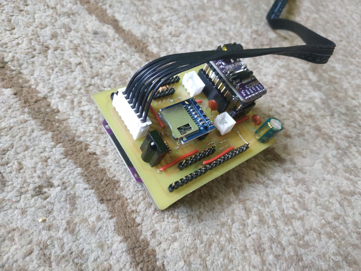

    Adding to this is my second PCB project based on the sandwich.
    ESP32-based radio module assembled on a PCB with electronic components and connected wires. .
    Electronic module on a PCB with connected cables and components, including an ESP32 and an SD card reader. .
    A custom radio module with ESP32 and an LCD display lying on a carpet, connected by a cable. .
    ESP32 module connected to a custom PCB, displaying radio information on a large green screen. .
    I "slimmed down" the radio - missing the connector for the encoder, the connector for the keyboard, and the PAM8403 power amplifier (2x3W).
    I hooked it up to my tube radio and it plays nicely.
    Note at the beginning my SD card didn't work - it turned out that on the Chinese module the GPIO47 and 48 pins are swapped, physically they are reversed, I suggested the description when designing the board and now I have to swap in the code to make it work ;) But this is not a problem.
    I would add that this larger display doesn't chop as much on the audio lines ;) .

    For this project you must have an esp32s3.
    Welcome,
    I have uploaded on GitHub the update to 3.17.77 , ->: Link .
    What's new in 3.17.77 ?
    - I have changed a bit the layout of the radio's website
    - We have WebSockets, i.e. station data, volume and the added station string is transmitted in real time (e.g. by turning the encoder on the radio, the volume on the page will also change)
    - In the configuration there is now an option to extend the VOLUME range from 21 to 42. This is useful if someone wants to build the radio module together with the amplifier module.
    - I have added auto creation of the config file. If the radio does not find the config.txt file, it will create it automatically on first start-up
    - The code is written so that by replacing the SD entry. (SD dot) to SPIFFS. (SPIFFS dot) it is possible to use the SPIFFS memory instead of the SD card. Then you have to use the website to load the files from the SD card content directory (especially editor.html)
    - is MDNS, the radio reports itself on the network as host: http://esp32radio.local/ regardless of IP.
    Have fun testing.

    @robgold thanks for the new version
    Observations from the new version (maybe only for me)
    - in Configuration on the page is Max Volume Extended [0] range 1-21 or [1] range 1-42, in the selection On/Off (for consistency should be Max Volume Extended [OFF] range 1-21 or [ON] range 1-42)
    - volume range change (works after radio restart), is this the way it should be?
    - if a station broadcasts a title with Polish characters, then after switching to this station there is no title in the window on the page, when switching to another station, the window does not refresh, you have to refresh the page. You have removed the processText for decoding Polish characters, if it is disabled, it displays Polish characters on the website, but does not display them on the radio.
