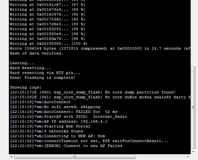

    bolszoy
    Posts: 64
    khoam:
    I have two of the same ESP boards both have the same thing on them, uploaded multiple times so not likely. I'm betting they are some kind of insecure, or the Chinese have changed something about the others.
    I have the impression that when it says Internet radio, the ESP crashes. But when I try to change wifi, I get a return that it sees 4 networks and tries to connect. Nevertheless, nothing happens on the OLED.
    I will still look for the old router tomorrow and try again.
    • Internet radio and audio file player on ESP32-S3 Wifi.JPG (100.71 KB) You must be logged in to download this attachment.

  • Modules appear faulty despite multiple flashing methods
    #158 21195923
    bolszoy
    Posts: 64

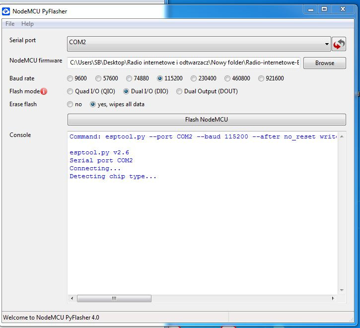

    I always enter the SSID and Password manually. NodeMCU-PyFlasher stands on recognizing the chip, ESP-Flasher does the deletion automatically....
    Like nothing, these modules of mine suck. I've ordered ones like the ones below, hope they'll be good.
    I don't know how to erase the flash without uploading anything.
    I'll just add that I've uploaded via COM /UART/, FTDI and CP210x, no matter - they behave the same. I don't think they uploaded badly - I hope no one buys them....

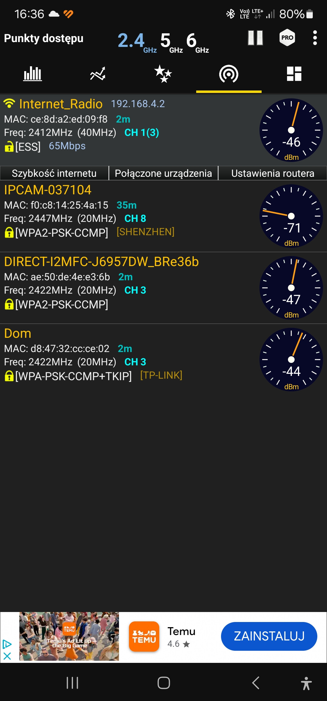

    This is what it looks like
    • Internet radio and audio file player on ESP32-S3 Screenshot_20240819_163625_WiFi Analyzer.jpg (285.14 KB) You must be logged in to download this attachment.

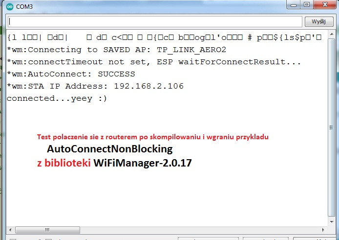

    Hi mate bolszoy . From this screenshot I can see that you have a very richly secured WIFI access to the router DOM .
    I would suggest you install ARDUINO IDE on your PC, the latest version 1.8.19 works on WIDOWS 7 and higher.
    Install the library - which is attached WiFiManager-2.0.17.zip .
    It is already patched.
    This patch is described by the project author .
    https://www.elektroda.pl/rtvforum/topic4041603-120.html#21183571
    Then start the ARDUINO IDE and in the examples search for WIFIManager and choose one of the examples and compile it on a board you have, let it even be an ESP8266 and do the test and see if it connects to your router DOM.
    If the ESP8266 connects you, you will see on the port preview, then a similar test should be performed with the ESP32S3 or ESP32 board.
    I chose this one AutoConnectNonBlocking .
    The author of the project uses this library.
    And you will be more sure where the problem lies.
    It will take you little time.
    I assume that you are not a novice, that you know how to use the ARDUINO IDE.
    I am curious to see what the test results will be...
    The connection attempt fails, then the problem is in the router.
    How it worked for me is the picture attached.
    I also did a readout of what type of modulation the ESP32 uses, this is b - photo attached
    And maybe it is enough to change the settings in the router so that it also accepts a b connection, i.e. it would be B/G/N.
    Futek2

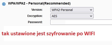

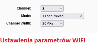

    Please find attached pictures at which router settings my ESP32S3 connects and everything works correctly.
    I think maybe it is enough to set the WIFI port parameters in the router and everything will be fine.
    Enter your own password.
    Maybe select a different channel, as ESP has WIFI on startup channel 1.
    If this works, then experiment with the other settings on your router.
    Good luck.
    Futek2

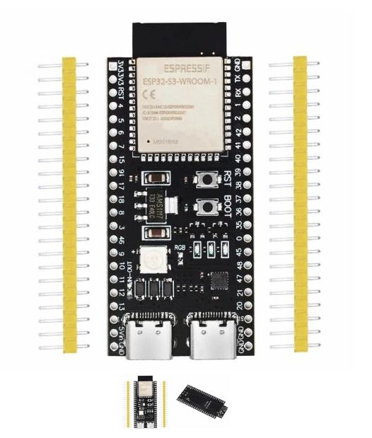

    I once came across an article describing the ESP8266 and ESP32 that the memories used are not of good quality.
    What I can confirm that I unpacked a new ESP32 and when uploading the software it was ok but resets just appeared.
    So without delay I replaced the memory and the problem disappeared.
    But these were 4MB memories.

    For now I have replaced the whole ESP32 S3 module with another one from stock and on it now works without problems, for the next couple of hours it remains to be seen.
