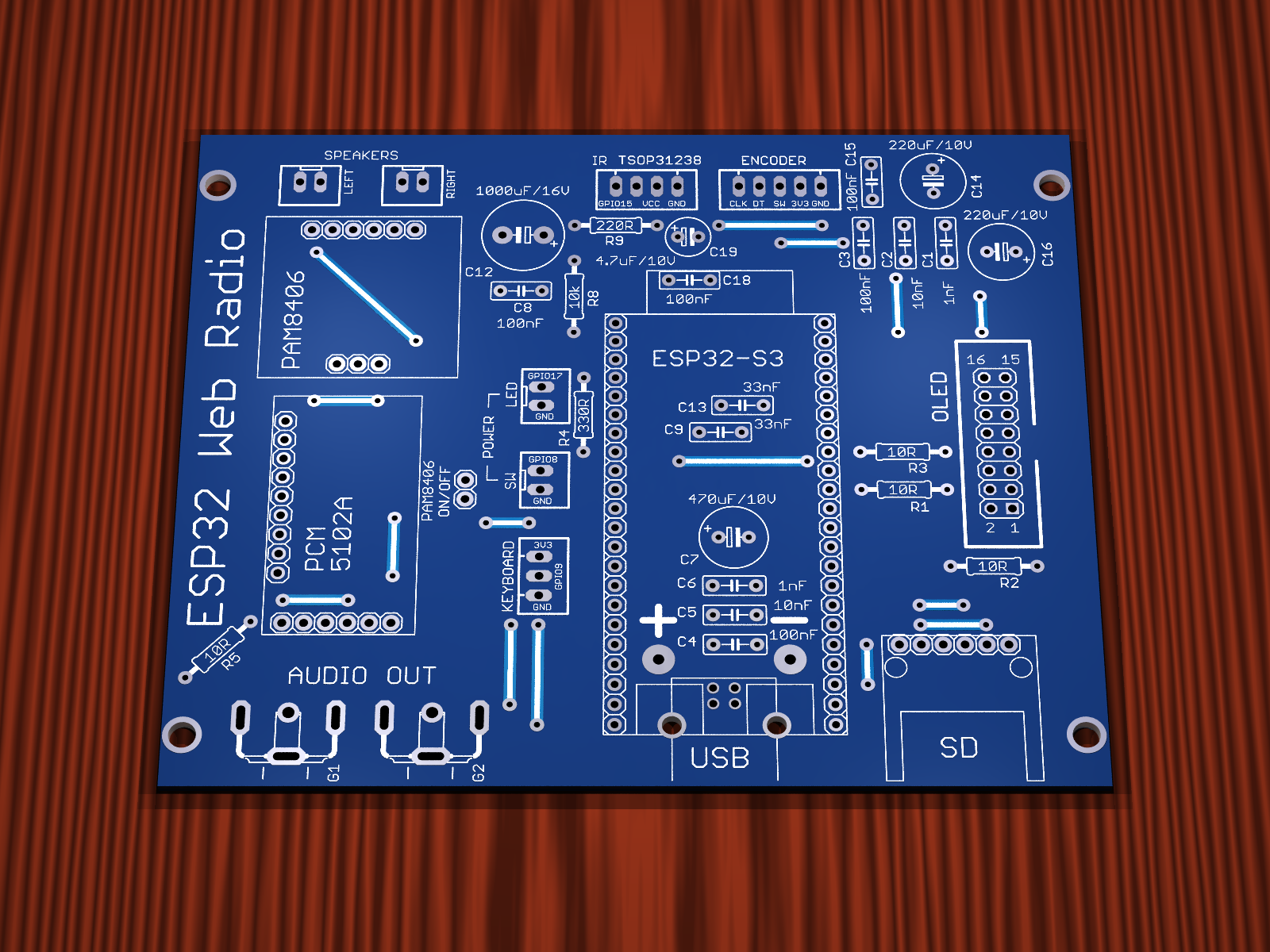

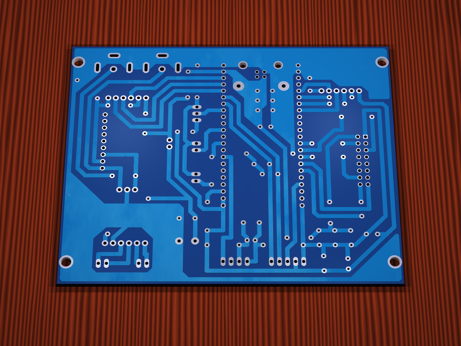

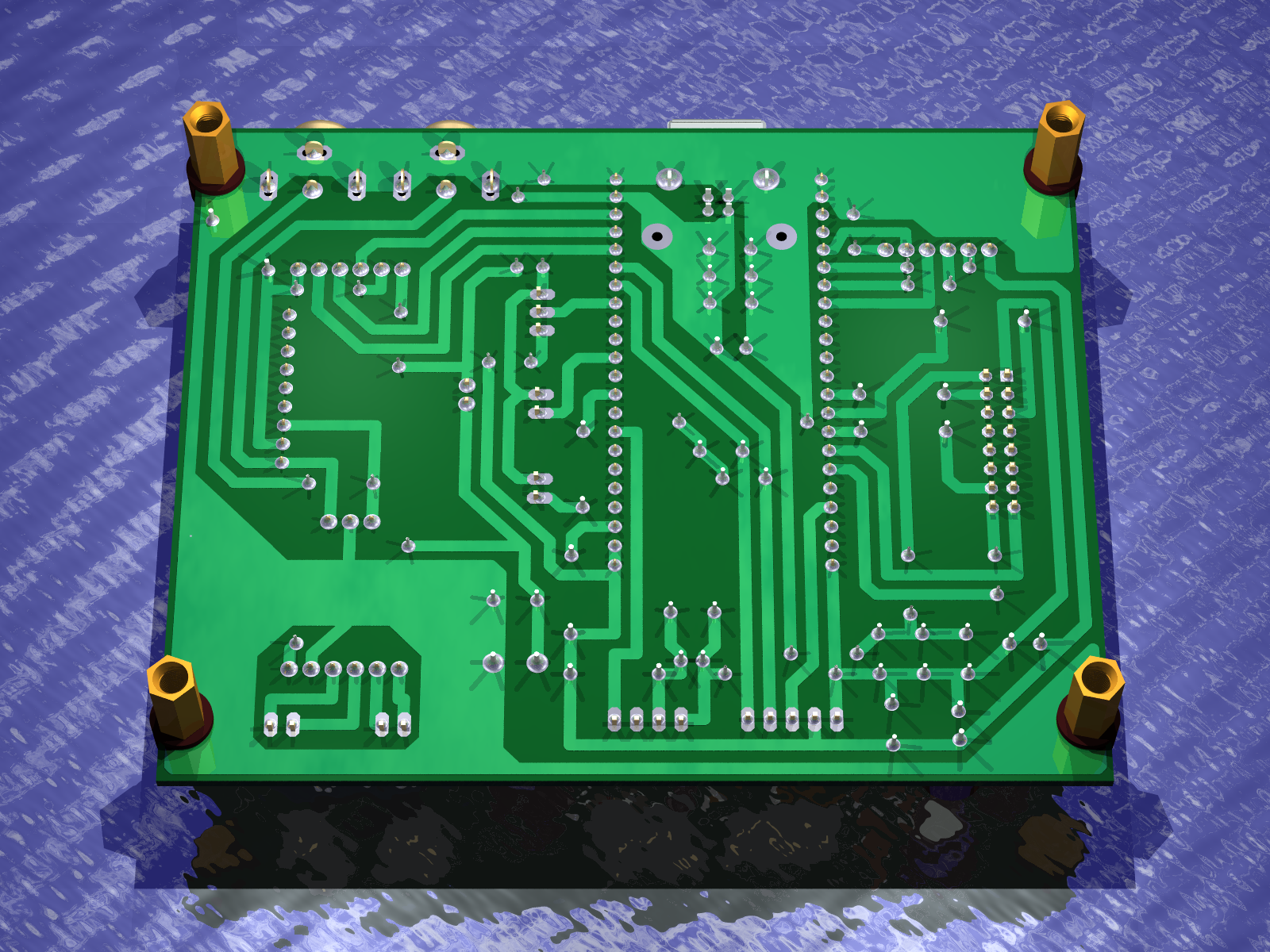

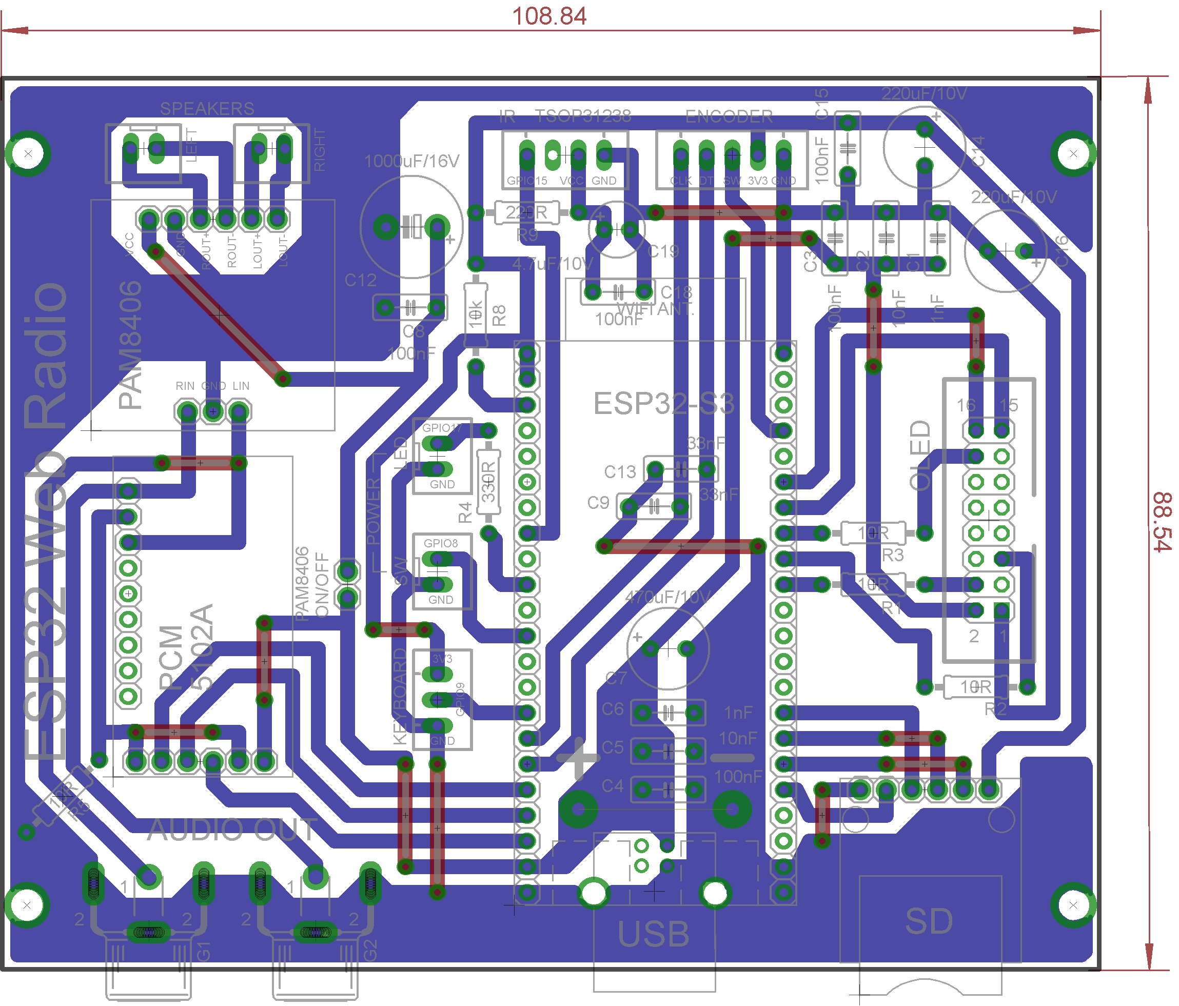

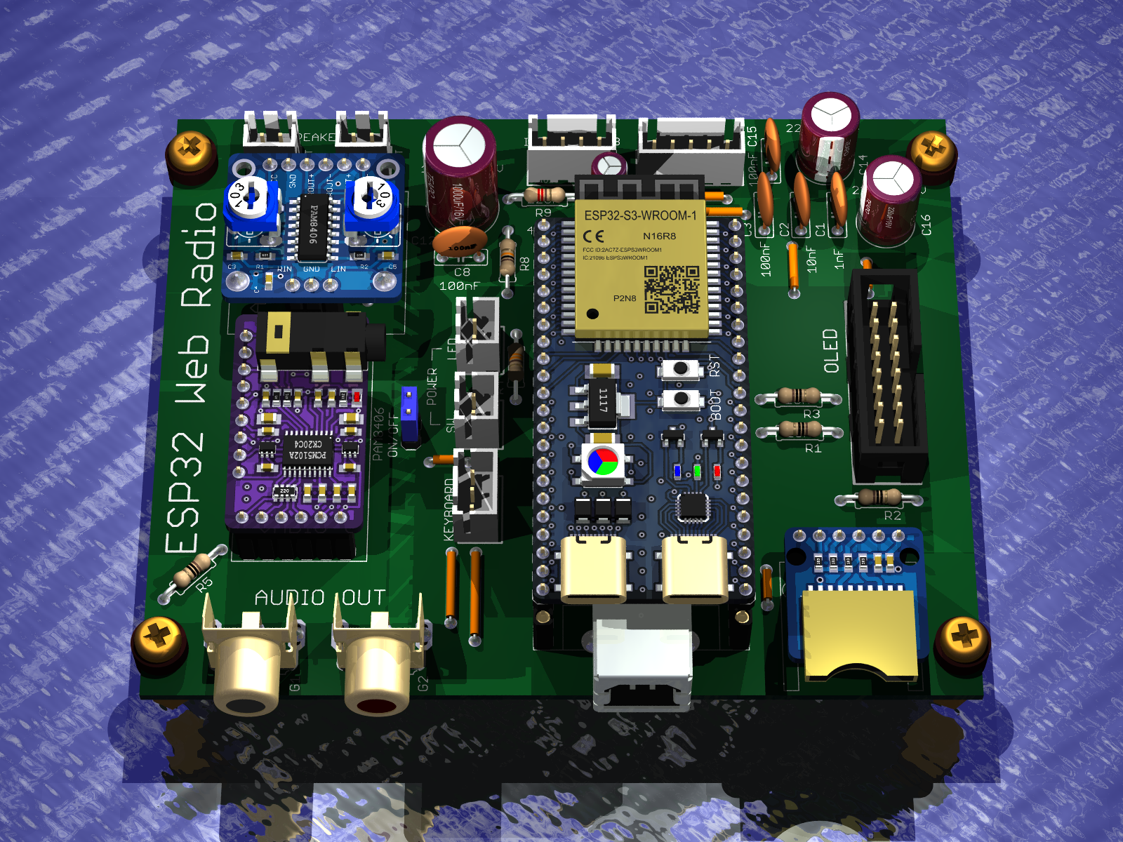

    Robgold you have these amplifiers, the radio works on them, the next version of the PCB for the kitchen radio in my vision is to use just two of these amplifiers without the PCM5102A and are you planning STANDBY because from what I gather in these amplifiers one pin handles everything i.e. probably connected to VCC is the left channel through a 470k resistor is the right channel and pulled both to ground gives muting. Do you, and how do you think, use the mute on two boards at the same time with different voltage levels on this SD pin bodajrze pin is called. Are two MOSFETs controlled by one GPIO ?
    I have made another amendment to the version of my next PCB on the PAM8406
    And so added component values
    Added 10R resistor on PCM5102A ground
    Changed IR receiver to JST 4pin connector with one pin omitted
    I haven't added the PCB version yet because I need to number all the previous ones somehow.
    Tomorrow maybe if time permits I'll fiddle with the chokes to see if I can work something out and get less interference.
    This is how it is now in 2D
    2D PCB layout showing ESP32‑S3, PAM8406 and PCM5102A with traces, connectors and labels
    And this is how the PCB will look
    3D render of a blue “ESP32 Web Radio” PCB with labeled connectors and module footprints
    Bottom view of a blue PCB with copper traces and many vias on a wood-like textured background
    Well assembled ;)
    3D render of “ESP32 Web Radio” PCB with ESP32‑S3‑WROOM‑1, audio outputs, OLED header, PAM8406 amp Bottom view of a green PCB with many traces and through-holes, plus four gold mounting standoffs
    Any more suggestions ')
    Regards ...

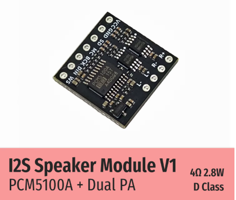

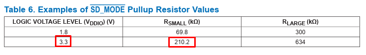

    >>21864035 Yes, I have, that's my photo. Such typical amplifiers for integration. No quality craze. Suitable as a sound system for kitchen, bathroom, workshop, office. It is not an amplifier for room speakers. I mean it's loud but I hear that it's not that quality. Not this dynamic range.
    You can control from one GPIO. With a 5V supply you have to keep one amp above 1.4V on the other amp above ~ 0.85V. You can't exceed Vdd but with a 5V supply and controlling from 3.3V you can hardwire one to GPIO and the other through a resistor. At 3.3V this will be RSMALL (kΩ) = 94.0 x VDDIO - 100 i.e. ~210K as the documentation confirms:
    Screenshot of a table listing SD_MODE pullup resistor values for 1.8 V and 3.3 V logic levels
    Something would have to be introduced but still working on a new "pinology".
    I still have such an "invention" with PCM5100A it should play much better quality. I will be testing it out.
    I2S Speaker Module V1 board with PCM5100A and Dual PA on white background, labeled “4Ω 2.8W D class”.

    >>21864080 This module seems to be two in one, the converter is and the amplifiers only that the input of the amplifiers analogue. I wonder how the interference will be here. Maybe factory it's less. Well, and this GPIO would be useful. In fact, if you want to save GPIO, you could connect it to the LED standby using a negator on a transistor on the PCB and then when the LED standby is on, a low state would be on the amplifiers and vice versa.
    Regards...
    Added after 1 [minute]:
    >>21864101 o and it still has jumper fields for gain. Could be an interesting solution.
    Regards...

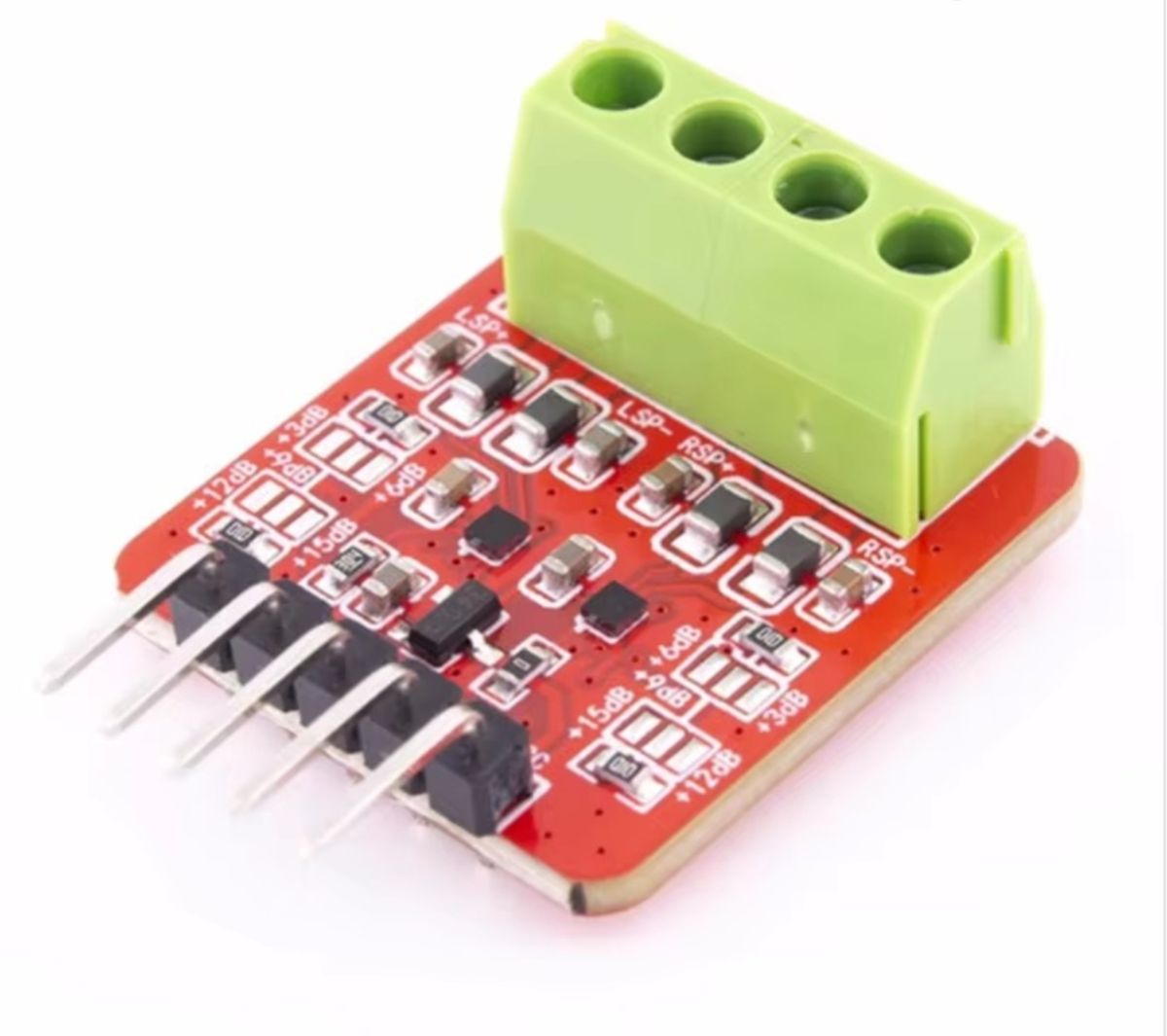

    >>21864101 Interesting module only that as I wrote it is not the quality that PCM gives. Additionally, in the comments on Ali someone wrote that it heats up and I suspect why. There I think "my friend" put a 3.3V stabiliser in a SOT-23 housing to power it ...question why ? It would need to be "tuned" right away and get rid of that :)
    the @DJCheester LED Standby also has an info function, i.e. flashes during startup, flashes when there's an error, can't be used for control. For this, in case of mute it would be good to switch off the amplifier as well.
    You set the gain in MAX once with a resistor and forget it, these jumpers are cool but you set it once on individual boards and that's it.

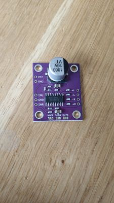

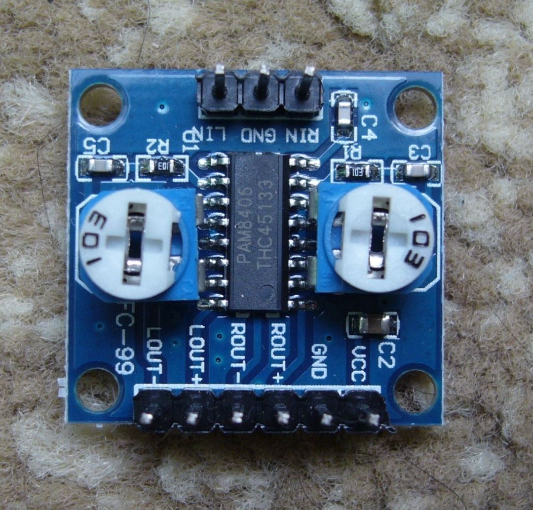

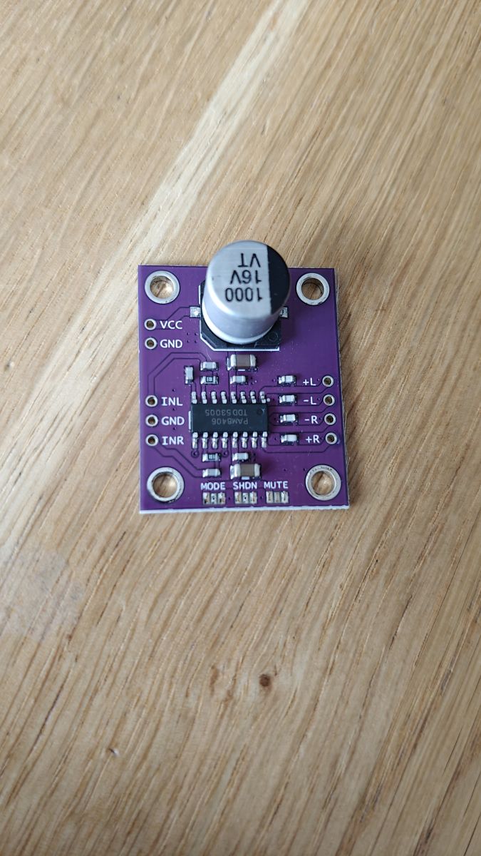

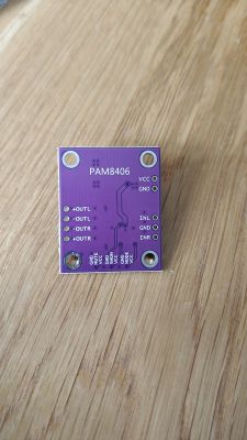

    For your information, I ordered a PAM8406 and it turns out that the version that arrived has a selectable amplifier class and shutdown and mute options.
    But no potentiometers, well something for something 😅
    Purple PAM8406 amplifier module with large capacitor on a wooden surface
    Purple PAM8406 amplifier PCB with labeled pins on a wooden surface

    The module is not very useful with jumpers for mute or shutdown, but it is a pity that it is not on goldpins. As long as the class AB /D is set once and it is ok.
    And no potentiometers.
    The one with potentiometers remains for now.
    Greetings....
    Question did you use a red diode (1.8v) as a power LED what resistor did you put in series ?
    And did you give the switch power to ground only or did you still put a 100nf capacitor in parallel as protection against switch contact vibration.
    Regards ...
    If we change the amplifier then to this
    https://pl.aliexpress.com/item/1005009507952634.html
    It has a gain pattern which will adjust the signal level.
    And the pcb5102A will remain as a line-out.
    Regards...

    As for these jumpers, I think it's already a cool solution. Of course goldpins would be better, but I guess soldering one wire to a jumper is something everyone can handle :D

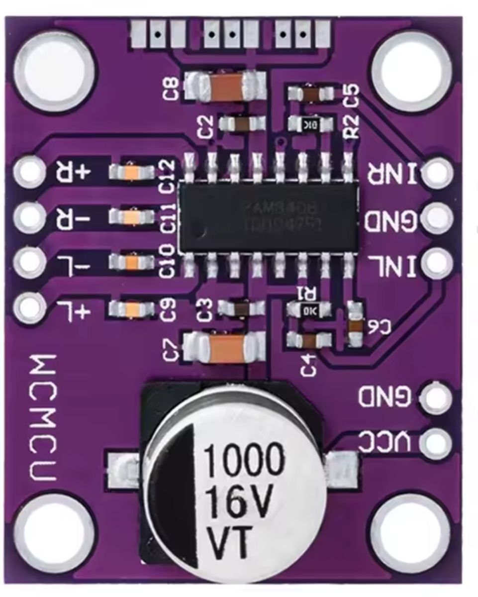

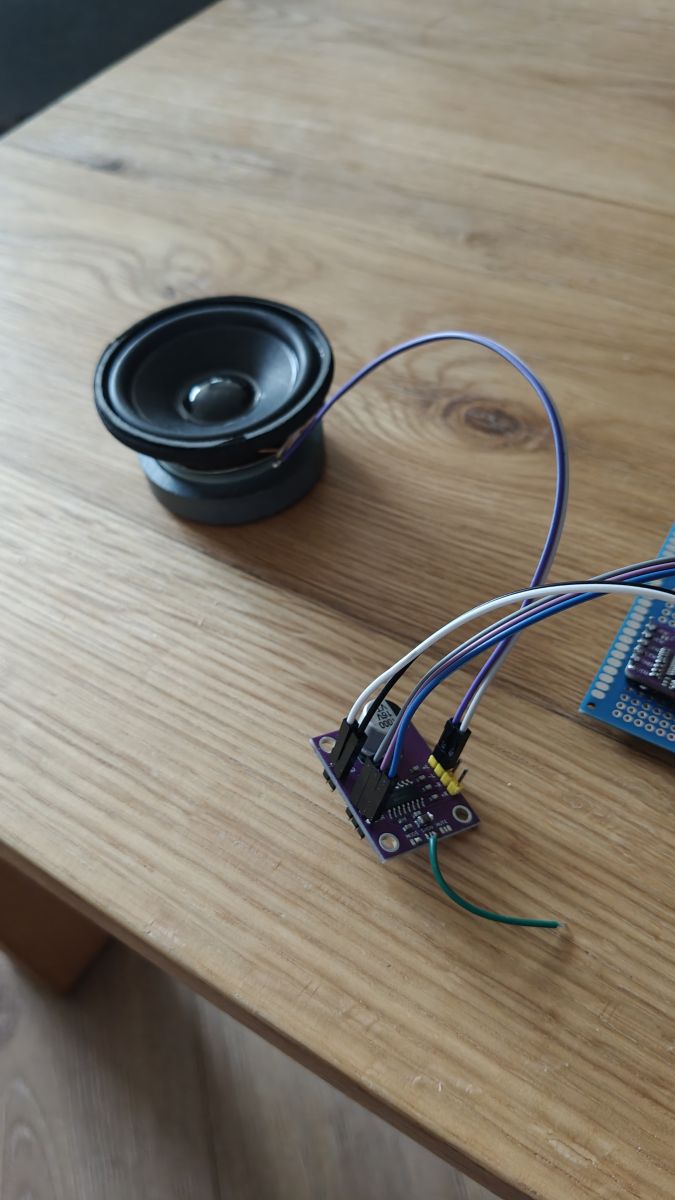

    I have assembled a circuit based on the PAM8406 in AB calsa and am very satisfied. The noise is almost inaudible at vol 1.
    I have only tested with a 2.08 inch screen. Unfortunately I do not currently have a larger one.
    I also soldered a wire to the SHDN input and it works great when it gets a LOW signal. Now I'm just waiting with a big request to @robgold to put such a possibility in the new software version and I'm already mega happy :D
    Small speaker and amplifier board with connected wires on a wooden tabletop Small OLED display reads “webradio 1 Vol 4”, connected by a ribbon cable to a board on a table.
    I think this is the best solution so far for using the project as a small "kitchen" radio ;)
  • Class AB mode selected by grounding pin 9

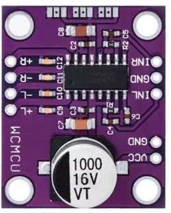

    OK and you can see if you have ground or power on leg 9 because this is the mode of operation according to the pdf LOW is class AB high is D.
    Because on these modules what I recently ordered
    Blue audio amplifier module with PAM8406 IC and labeled input, output, and power pins
    There seems to be a 9th leg with mass.
    So it would appear that it is working here as an AB ?
    I will physically check this tomorrow.
    Greetings ...

    I, via a jumper, have ground on pin 9 now. That is, the AB mode.
    It looks like your circuit is also working on AB. You would have to check with a meter because you can't quite see it on the picture.
    I chose this circuit because it seemed more decent. I think it has more filters, that big capacitor encouraged me the most 🤣even the speaker output has some filter elements.
    Purple audio amplifier PCB with IC, 1000µF 16V capacitor, IN pads, and L/R speaker output terminals

    Every Chinese is probably different, as with these dimensions from the PAM8403 modules. Well nothing, I'll measure on mine tomorrow if not then you'll have to lift it up on your own and hook it up with the ground according to the documentation.
    https://docs.rs-online.com/7c06/0900766b81268cf8.pdf
    I'll get around to checking it tomorrow as time permits.
    Regards...
  • Wrong resistor and capacitor values blocked audio output
    #2550 21865827
    pipikupi1979
    Posts: 15
    >>21863127 hello. Yes I agree this pcm is not complicated only as it turned out the boards are messed up on the ground these small for example resistors should be 100om and they are 10k capacitors mixed up with the values as they fall. I fought with this topic for a few days letting the input signal 3khz and nothing on the output then I corrected the code and nothing and then it turned out that when I started checking the components on the board and replacing them with the right ones it worked from the start, only the filter on the input cut out everything at about 700hz upwards so there was no chance of anything going through. I have now ordered a large board which supposedly doesn't have this problem but whether it does or not I am considering an ws8782 on the input but that remains to be seen for now I have a 10 band dsp equalizer skeleton on a peaking IIR I am waiting for the pcm1808 and ws8782 to arrive and we will see what happens next. Nevertheless, thanks for your interest
