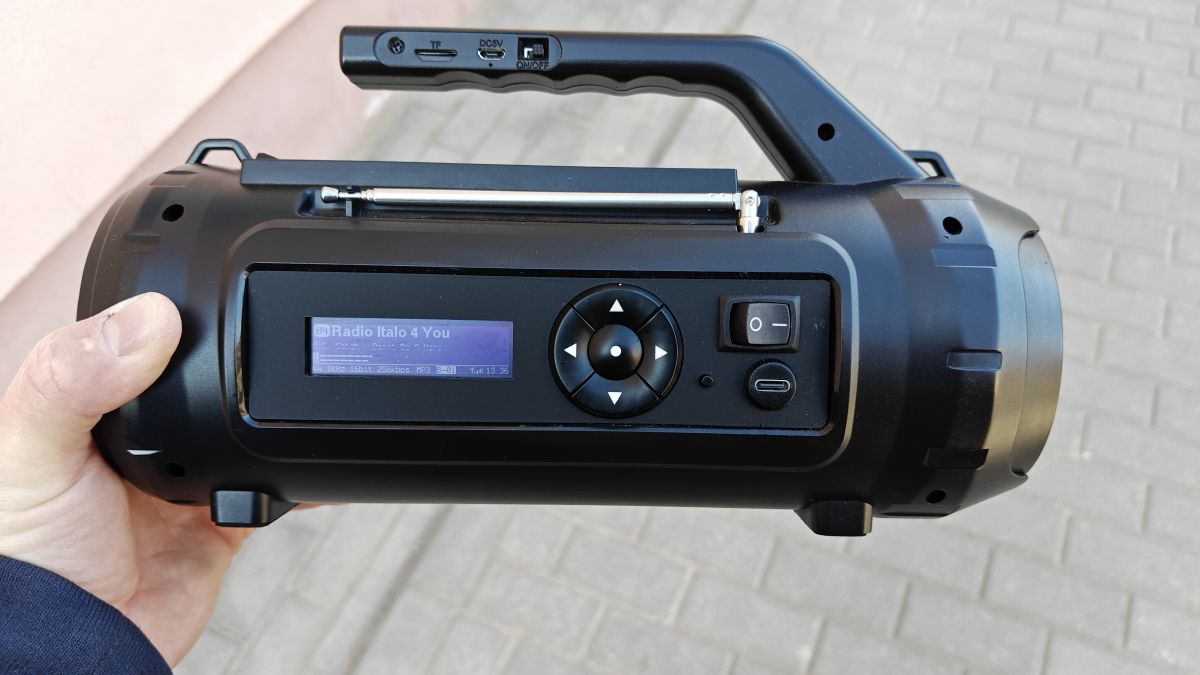

    dawidkosciesza
    Posts: 54
    Rate: 14
    Another redesign :)
    Black portable speaker with handle, antenna, and radio display, held in a hand outdoors
  • #2565 21868004
    robgold
    Posts: 698
    Help: 10
    Rate: 284
    >>21867939 Super. Did you sub-map the arrows to the ADC ? Does everything work ? Fellow Rafal on the FB group yoRadio seems to have designed such a pcb board for these switches. Is it from him or did you design something yourself ?
  • #2566 21868045
    dawidkosciesza
    Posts: 54
    Rate: 14
    I used the up and down arrows as they are in the ADC, but changed the right and left to volume :)
    I made the board myself, but it's good to know that someone has already designed something because it's a bit of fun :D
  • #2568 21868164
    dawidkosciesza
    Posts: 54
    Rate: 14
    Your suggestion would be good if using the next station and previous station buttons. And I use up down as a selection from the station list and it is more intuitive than sideways ;)
  • #2569 21868194
    robgold
    Posts: 698
    Help: 10
    Rate: 284
    >>21868164 In this case, yes. Especially since there is now order and the list always displays from the currently playing station.

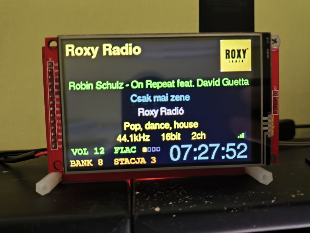

    hevet
    Posts: 346
    Rate: 47

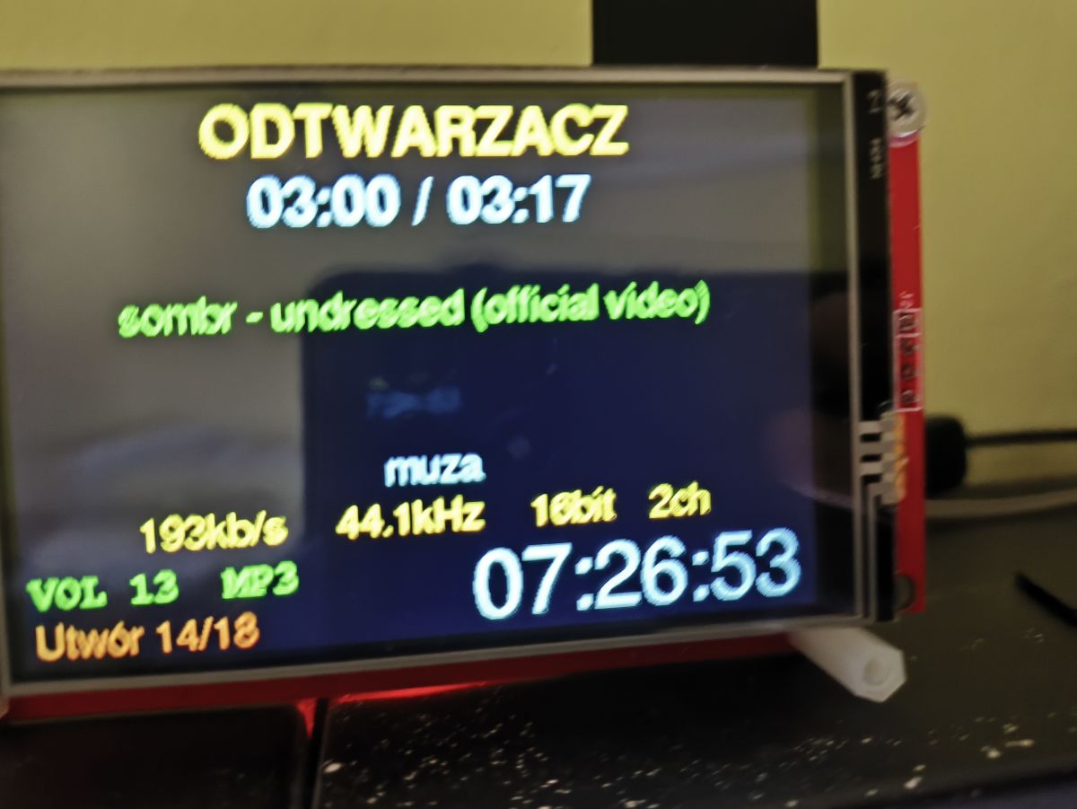

    At my place the adventure with the player has started, for now without web support, but maybe one day. The radio now displays a small logo on the right hand side permanently.
    Player display shows Roxy Radio, track title, time 07:27:52, and a station logo on the right Small player screen showing “ODTWARZACZ”, 03:00/03:17, and a large clock reading 07:26:53

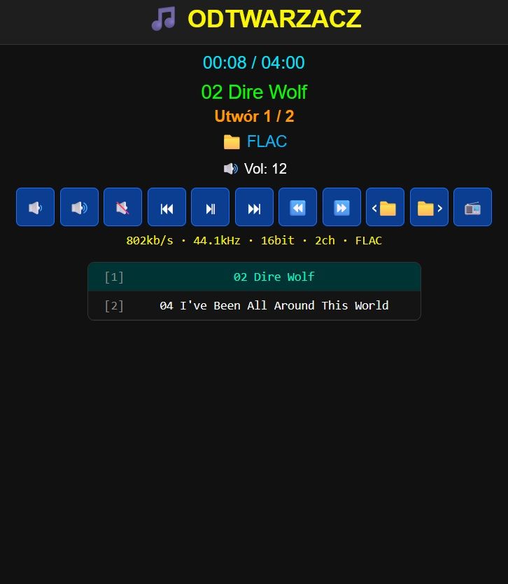

    hevet
    Posts: 346
    Rate: 47
    Somehow, it occurred to me.
  • #2575 21869451
    ejcon
    Posts: 253
    Rate: 54
    Screenshot of an audio player showing “02 Dire Wolf” playing and a two-item FLAC playlist.
    Are you going to make it available or are you just going to brag about it?
    It seems to me that if you publish something it is with the thought that others will also benefit.
  • #2576 21869513
    hevet
    Posts: 346
    Rate: 47
    I promise, I won't again. You think wrongly, there is no obligation to do so,
