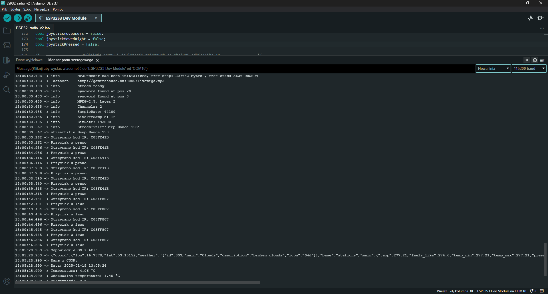

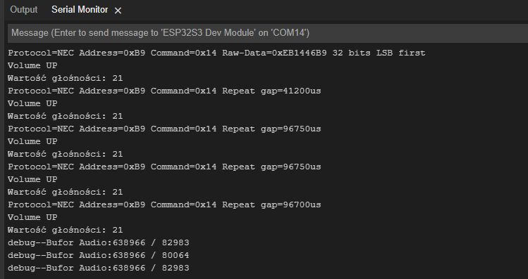

    I managed to do the IR remote control operation without any additional libraries based on the pulse test, the strings returned are repeated enough that I can treat them as correct, although probably when I connect the logic analyser later on, errors will come out, but that's for later to work out.
    I have inserted a new function into the main loop:
    analyzePulseFromIR(); // Analyses the data from the IR receiver and recognises commands from the remote.
    and the preparation for the analysis looks like this:
    Code: C / C++
    and the most important thing is that nothing gets dumped even when holding the button for a long time, below is a screen shot of how it works, I'll upload an update to github later:
    Screenshot of the Arduino IDE console showing code operation with an IR remote. .
    edit. it already works nicely to switch radio stations right and left on the remote, there is progress.

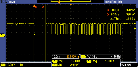

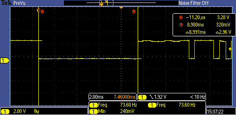

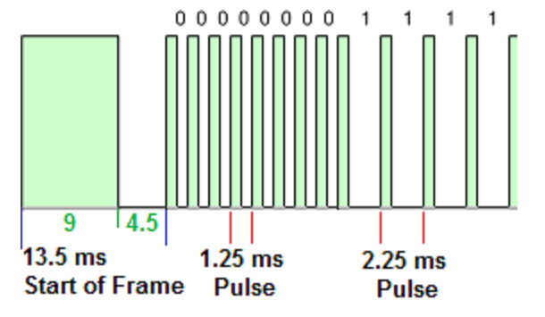

    Just taking a quick look, it would be good to validate in these 32bit. In the NEC 2-bytes go directly 2 are negation.
    Screenshot of a serial monitor displaying data from a remote decoder connected to an ESP32 microcontroller. .
    @MAJSTER XXL .

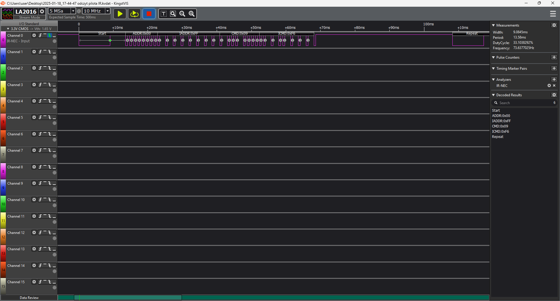

    As far as I can see, the function in the interrupt (this one is probably tacked on to the ATTR) counts the pulse time difference and then you just have a simple comparison of > from 500us or > 1600us followed by a 32bit variable. No problem catching those initial 9ms in the NEC protocol ? I hooked up the receiver because I was already starting to wonder myself what it was sending to the ESP.
    Digital oscilloscope waveform showing a square signal with measurement data. .
    Oscilloscope signal graph showing electrical pulses in the NEC protocol. .
    I hooked up the trigger on GPIO15 to CHANGE, ISR functions to Interrupt
    Question where do you call the analysis of what is in the interrupt ? This data changes every ~560us.

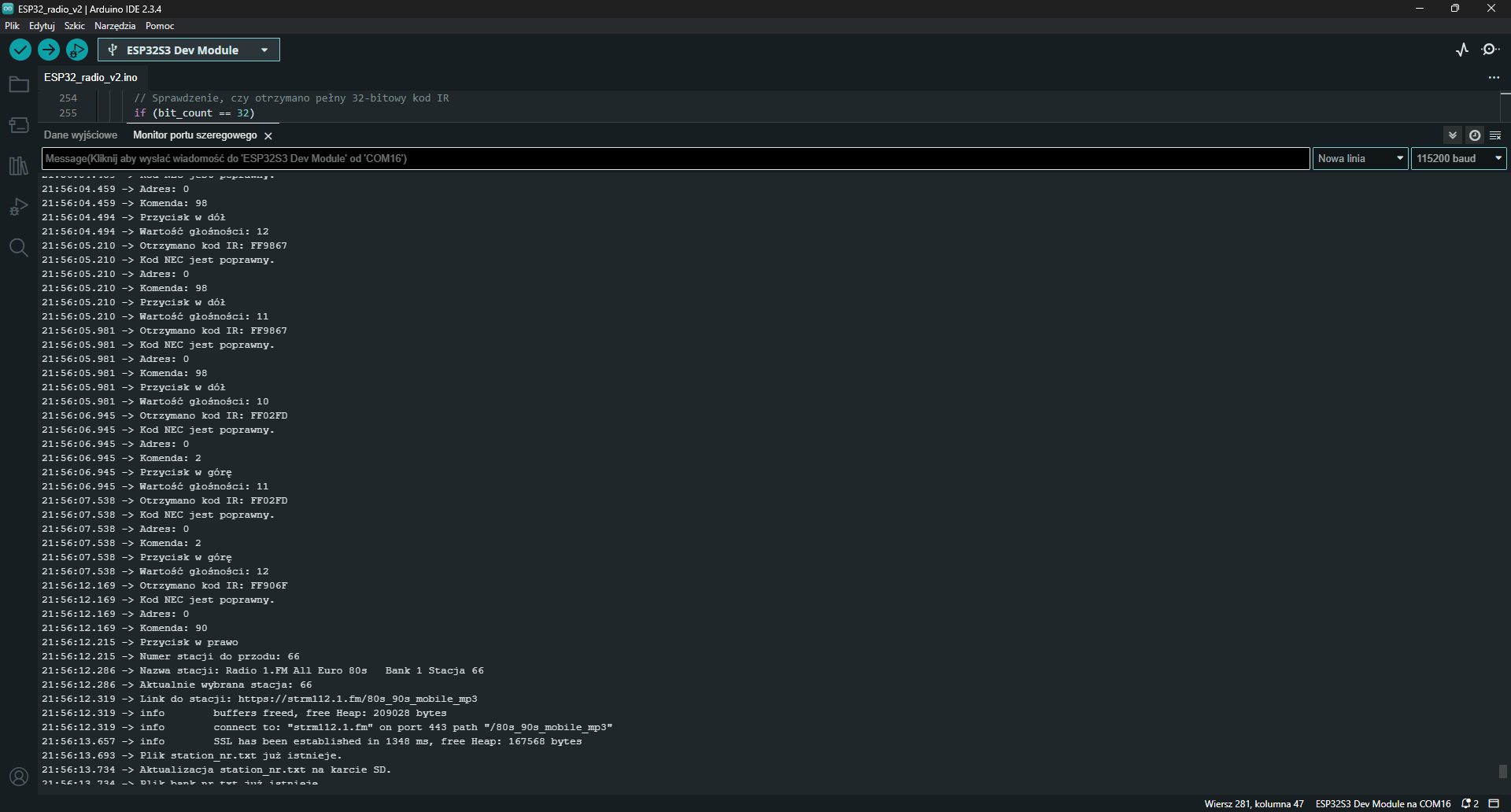

    @robgold is corrected, as far as it will turn out in practice, I motivated myself and found my analyser and checked the timings and raw data carefully and included it in the code, I added a validation with the NEC protocol and so far it looks promising, by the way I learned from it without involving additional libraries, so we will have better control of the whole thing.
    Of course how will everything turn out after user testing, let's hope....
    Below is a snapshot of the serial and screen a of the analysis:
    Screenshot of a logic analyzer display showing decoding results of the NEC protocol. .
    Screenshot of Arduino IDE showing the serial port monitor. .

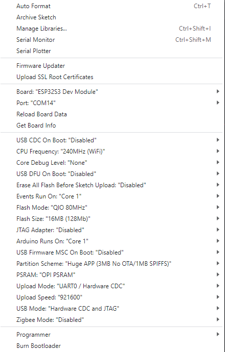

  • psram_malloc type mismatch in ESP32-S3 build
    #409 21400405
    hevet
    Posts: 347
    Rate: 47
    Hi after the break. I see the project is progressing at a great pace.

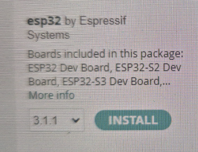

    Question for @robgold, I'm trying to compile your version 3.11 where there is a change from EEPROM to PSRAM, but I'm getting this error:
    2754 | psramData = (unsigned int8_t *)ps_malloc(PSRAM_length * sizeof(unsigned int8_t));
    | unsigned char*
  • #410 21400431

    @hevet I have the same on all versions from colleague @robgold from github.
  • #411 21400437
    hevet
    Posts: 347
    Rate: 47
    Maybe @robgold can tell the secret on how to fix it. Although on github he has a compiled bin file for version 3.11. Is it possible to somehow upload the file via flasher or otherwise?

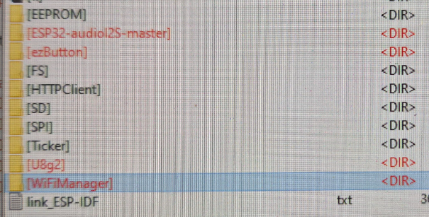

    Now some information for those who have problems with compiling "from scratch". Today I did an exercise on a foreign computer where there has never been an Arduino.
    - We install Arduino 2.3.4 - installation for all users (Arduino in Program Files, libraries in C:USER NAME -AppData - LocalArduino15 -libraries).
    - We download in tile libraries the package - ESP32 by Espressif (see image) .
    - We download the whole project from GitHub and into the aforementioned directory (C:YOUR USER NAMEAppDataLocalArduino15libraries) we copy the libraries
    - ESP32-audioI2S
    - ezButton
    - U8g2
    - WiFiManager
    Everything, the program compiles correctly. Sorry for the pictures but I had no way to take a screenshot.

    List of ESP32 boards to install in Arduino IDE. .

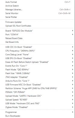

    And how are you set:
    Flash size and Partition Scheme?
  • #416 21400738
    robgold
    Posts: 726
    Help: 10
    Rate: 290
    All the ESP32s I have are the 16N8 version which is 16MB Flash and 8 MB RAM.
    Huge APP 3MB, NO OTA, 1 MB SPIFSS
    Tool menu with ESP32 module settings. .
  • #417 21400742
    hevet
    Posts: 347
    Rate: 47
    Thanks, managed to compile, works even :) .

    robgold wrote:
    Now info for those who have problems compiling "from scratch"

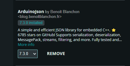

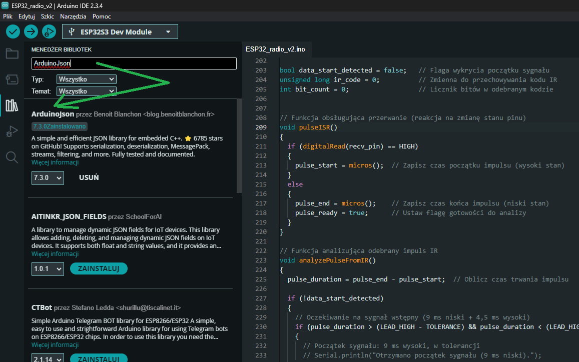

    And the json from where?
    #include <ArduinoJson.h>
    The one as in the picture fits, but it is not installed by default.
    Screenshot showing the ArduinoJson library version 7.3.0 in a development platform. .
  • Fixing NEC IR decoding for negative pulses and LSB-first bytes
    #419 21401801
    robgold
    Posts: 726
    Help: 10
    Rate: 290
    @MAJSTER XXL .
    I have incorporated your corrections into my sketch. Unfortunately I still found something average about the remote working.
    I started looking at that pulse analysis function and it seems to me that it was missing checking the start of the frame correctly.
    The IR receiver reads the code and outputs it negated (the output is an OC type with a 10k pull-up). The frame starts at 9ms but this pulse is NEGATIVE (have a look at the oscilloscope snapshot I took yesterday) In the interrupt handler you measure the pulse currently you start when it has a HIGH state and end when it has a LOW state. This way the 9ms pulse is never analysed because it cannot be measured.
    In the NEC protocol the "1" pulse lasts 1600us and the "0" pulse lasts 560us. Since we have the reverse logic this:
    Our pulse "1" lasts 2.25ms -> 2250us-560us = 1690us, the pulse "0" on the other hand lasts 1.25ms -> 1250us - 560us = 690us and such values must be analysed in the functions.
    I made in the void IRAM_ATTR pulseISR() detection of a negative pulse and entered it into the analysis. Now the function void IRAM_ATTR analyzePulseFromIR() must first detect a pulse of 9ms, then 4.5ms and then starts to analyse the individual bits and "insert" them into the IR_CODE variable.
    Since in the NEC protocol the bits come in an LSB-MSB configuration I did a rotation of the full 4 bytes i.e. "endian" swaps:
    We read LSB - MSB
    Address --- /Address --- Cmd --- /Cmd
    9D --- 62 --- 28 --- D7
    9D --- 62 --- A8 --- 57
    Rotation to MSB - LSB
    /Cmd --- Cmd --- /Address --- Address
    EB --- 14 --- 46 --- B9
    EA --- 15 --- 46 --- B9
    //9D6228D7 vol+ EB1446B9
    //9D62A857 vol- EA1546B9
    Now we have the remote control codes read correctly. I finally fold the address and code variable into one string and 0xADRCMD is formed. In my case B914 for the Kenwood standard in which I have the remote control. That is, remote control address B9 and command 14 -> VOL+
    The operation of the function void IRAM_ATTR analyzePulseFromIR() occurs in a Ticko Timer2 interrupt set to 50us (these are the timer times used by IR libraries) This gives us pretty good oversampling.
    I've thrown in additional variables that are assigned actual times of 9ms, 4.5ms and the last pulse of 1690us and 690us in the interrupt handler. This allows you to view how well the remote control "holds the timings" and what tolerance should be set for the TOLERANCE variable.
    On the terminal we get:
    NEC code OK:9D6228D7 MSB-LSB: EB1446B9 ADR:B9 CMD:14
    debug -- Analysis - pulse 9ms:8975 4.5ms:4601 1690us:1691 690us:621
    For those who wish to test with their remote control, a map of the remote control codes can be found in the DEFINE section at the beginning of the ino file.

    The remote now seems to work stably and reproducibly but still not perfectly.
    Will try to do compilations with the IR library and compare performance.

    Oscilloscope screenshot showing IR remote signals. .
    Infrared signal diagram of the NEC protocol with annotated pulse durations.
  • IR analyzer shows 9 ms low and 4.5 ms high pulses
    #420 21401913
    MAJSTER XXL
    Posts: 2064
    Help: 164
    Rate: 429
    @robgold great that you've embraced this analysis function, because you see.... on my analyser I had a normal high state, the probe connected directly to OUT without plugging into ESP32 and when I commanded the remote, first for 9ms a low state came in and then for 4,5ms a high state, so it confused me. Only I'll tell you that I had the 9ms pulses and the 4.5 ones enabled on the serial and they appeared normally after every even the shortest peak from the IR remote, so I don't get it anymore, my analyser is lying, I don't think so. I'll save the topic for the weekend as I won't have time to do it during the week. I'll just be peeking in for a while to read what's new, so keeping my fingers crossed.
    @simw Json the usual first off the shelf from Arduino, just need to get yourself an account on weatherman and supply a link with your own location as mine is Saw, plus an API key, good luck.
    Arduino IDE window with open ESP32 code and library manager showing ArduinoJson library selected. .
