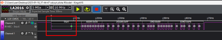

    Master , from what I can see from your analyser you have a falling edge trigger set up and you also go low for 9ms.
    I inserted Serial.print where theoretically it should be those 9ms and it was giving me 0us pulse length or some very large values which puzzled me.
    Screenshot from a signal analyzer showing an IR-NEC protocol readout from an input channel with falling edge triggering in KingstVIS. .

    Only this showed up in the terminal
    NEC code OK:FF18E7 MSB-LSB: E718FF00 ADR:0 CMD:18
    debug -- Analysis - pulse 9ms:9063 4.5ms:4491 1690us:1634 690us:589
    Other button
    Stack:5152

    So it reads your remote control correctly.
    NEC code OK
    FF18E7 MSB-LSB: E718FF00 ADR:0 CMD:18 .
    9ms:9063
    4.5ms:4491
    1690us:1634
    690us:589
    As I wrote, the worst these remotes hold is this short pulse but here it is not a tragedy.
    Now for each button read yourself these two values ADR:0 CMD:18 and in the definition section of the remote control
    e.g. for the voice command you have:
    #define rcCmdVolumeUp 0xB914 you change to #define rcCmdVolumeUp 0x0018 i.e. you give the address and right after it the command.
    So for all buttons.

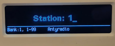

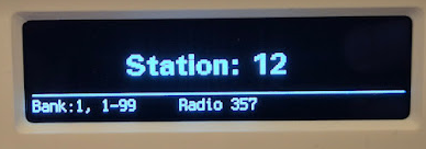

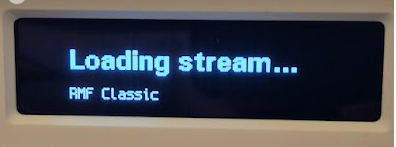

    Update for version 3.14 - Link
    - I have improved the remote control reception functions. This version should respond correctly to the remote control. On my test radio it works very responsively, it does not "lose" commands
    - the numeric buttons on the remote control work, you can enter any station number, on the screen you will get information which station is under a given number, switching is done by pressing the button defined as "Enter/OK". If you do not press anything, the radio will return to the main screen after 6 seconds (without changing stations).
    - switching of banks from the remote control works
    - it is possible to switch off the VU-meter "beautification" from the remote control
    - an information screen has been added during the stream loading (helpful if a station is "dead" then we know what is happening)
    - when a station is opened, the station list moves to the position of the newly opened station
    - one of the remote control buttons (rcCmdMute 0xB916) test-added to the function activating the preview in the terminal on filling the audio buffer

    Radio screen displaying station number 12 with bank 1 and label Radio 357. .
    Radio display showing station selection. .
    Display showing Loading stream... message and station name RMF Classic. .
