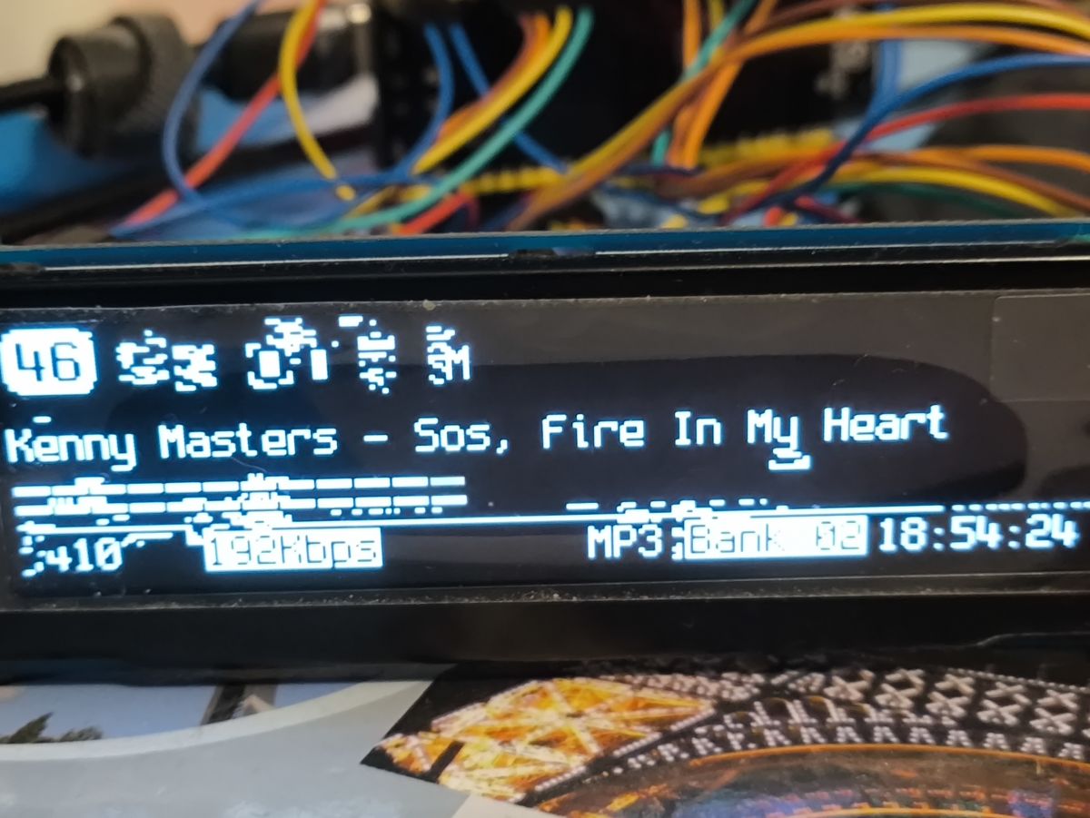

    This radio-player switching add-on is a matter of 5 minutes with one encoder. I guess there is a hidden function in every Evo3 that can switch something when you hold down encoder 2 for 4 seconds. Currently it switches the VUmeter mode from dashes to bars for testing.

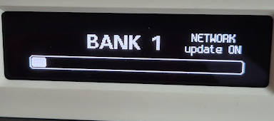

  • Remote selection loses stream metadata display
    #453 21406280
    hevet
    Posts: 347
    Rate: 47
    @robgold I used a different remote a bit and now with the operation is much better. Codes assigned, works decently.
    Instead I noticed another bug, at least with me. When changing the bank with the encoder and selecting any station from the bank, the title information (as long as the station is broadcasting it), the VU meter and the stream format appear, but this information is missing when I change the bank and select the station via the remote. The station plays, but there is no VU meter, stream format or title. After restarting the radio the information returns.
    The second thing is that after start-up, the first station from the bank is always switched on, i.e. it remembers the bank, but no longer the station.

    @hevet,
    thanks for catching the bug. I've started wrapping some repetitive stuff in functions and overwrote the station_nr variable.
    I'll fix it tonight and upload the new file to GitHub. The bug is in the "fetchStationfromServer()" function, which is now also responsible for displaying station fetch information.
    I've caught a few more bugs. All the power of independent testing in you my dears.
    @DJCheester
    The remote you suggested will be ok and should work. I have it and it too works standard on address 00 and NEC protocol.
    I would however strongly urge you to go for the RC-406 that I have shown. I know that it is no longer 6zł but 20zł from Ali or Allegro but the quality of work, the number of buttons speaks in favour of the latter.

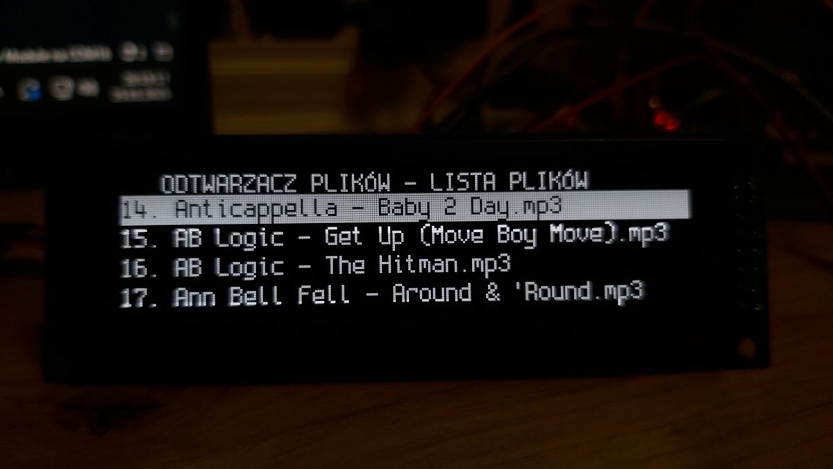

  • ESP32-S3 remote control flags and MP3 recording question
    #455 21406909
    MAJSTER XXL
    Posts: 2064
    Help: 164
    Rate: 429

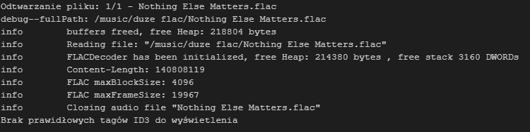

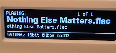

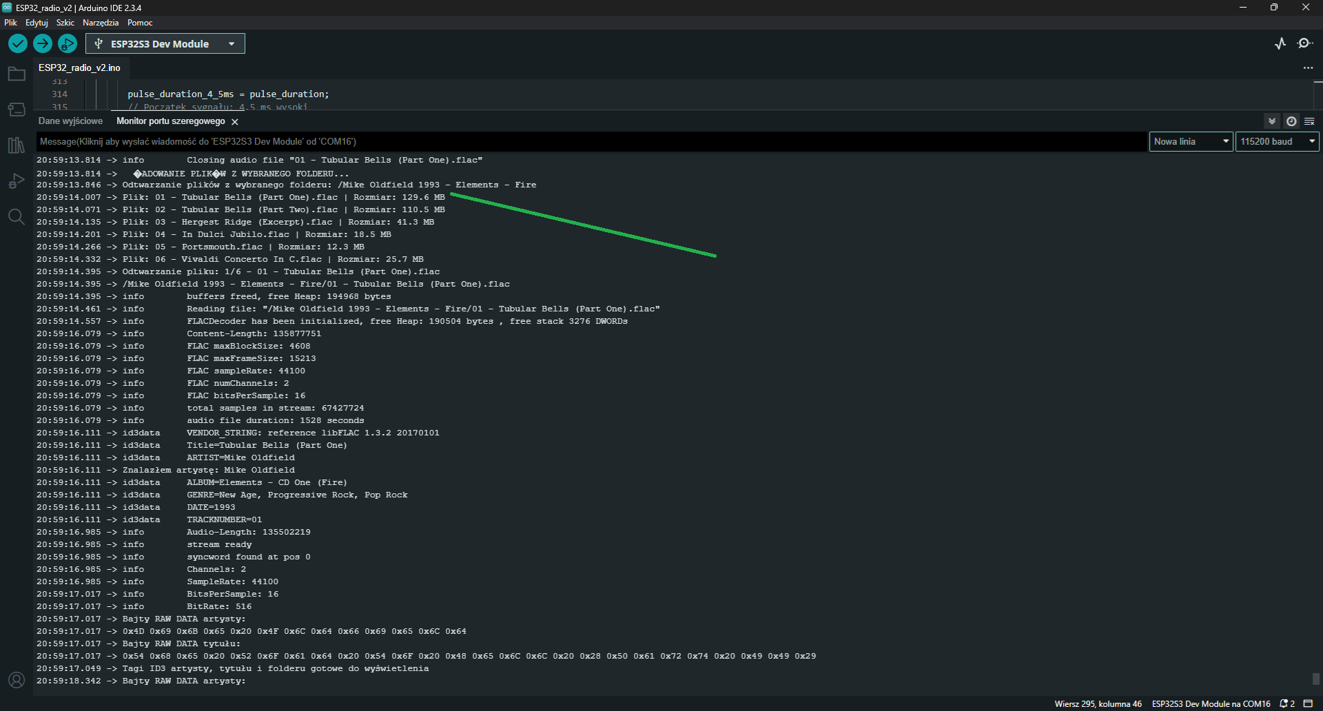

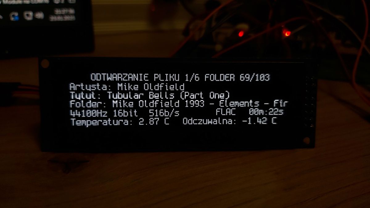

    @robgold I copied the necessary parts to myself and I have to admit that the operation from the remote control has now become a pure pleasure, I did a little bit more in my own way, i.e. I created more flags to set the use of the corresponding buttons of the remote control and inserted this in a separate function with a view to use in the file player. I don't know if this is the best way to go, as I have this player to rework anyway, I need to do subfolder playback and take a slightly different approach to selecting files to play. You asked the other day about playing large size flac files from a card, with me it runs normally such an almost 130MB one, but I can see on the serial that the bitrate is somehow undersized at only 516b/s - the Audio library author has something wrong with it.
    I'm still boxing myself in with this idea, as I've been trying to do an on-the-fly recording of the internet radio I'm listening to straight onto an SD card, but only the ones that stream mp3s, so far I've only managed to create a Recorded folder on the card and a file that has the name of the station I'm listening to in the name plus a note of the start time of the recording and I'm stuck. The question is whether this ESP32 module can still handle such on-the-fly recording to a high-speed SD card of the broadcast/song being listened to?
    Below is a screen shot of Mike Oldfield's flac being played:
    Screenshot showing serial port monitor output in Arduino IDE, displaying playback of a FLAC file. .
    Display showing information about the song Tubular Bells (Part One) by Mike Oldfield.

    @MAJSTER XXL
    I am very pleased. So we have one additional function - remote control - out of the way. As for the operation, it is precisely because of the planned addition of a pushbutton keyboard to the conversion of already existing FM tuners that I "dressed up" individual things in functions like volumeUp() or bankMenuDisplay(). I think that whether you do it with flags or functions, it's all the same. Ultimately, the event has to be handled somewhere anyway.
    Regarding the FLAC files, when I tested your software while still testing the remote, I tried to play a FLAC I have on my card and it doesn't even start. I write its name and it just sort of flies out of the handling function. The file is 140MB. The display will stay as it is in the picture and to paraphrase... "it doesn't care about anything else".
    I think that ESP itself is a huge potential, the question is whether the way it is handled by Arduino doesn't "castrate" it too much. Theoretically if you peek into the audio library it can work on the second core. I would be tempted to make an MSC (MassStorageClass) and access the contents of the card via USB.
    Debug console with information about FLAC file Nothing Else Matters.flac. .
    FLAC player display showing track information for Nothing Else Matters. .

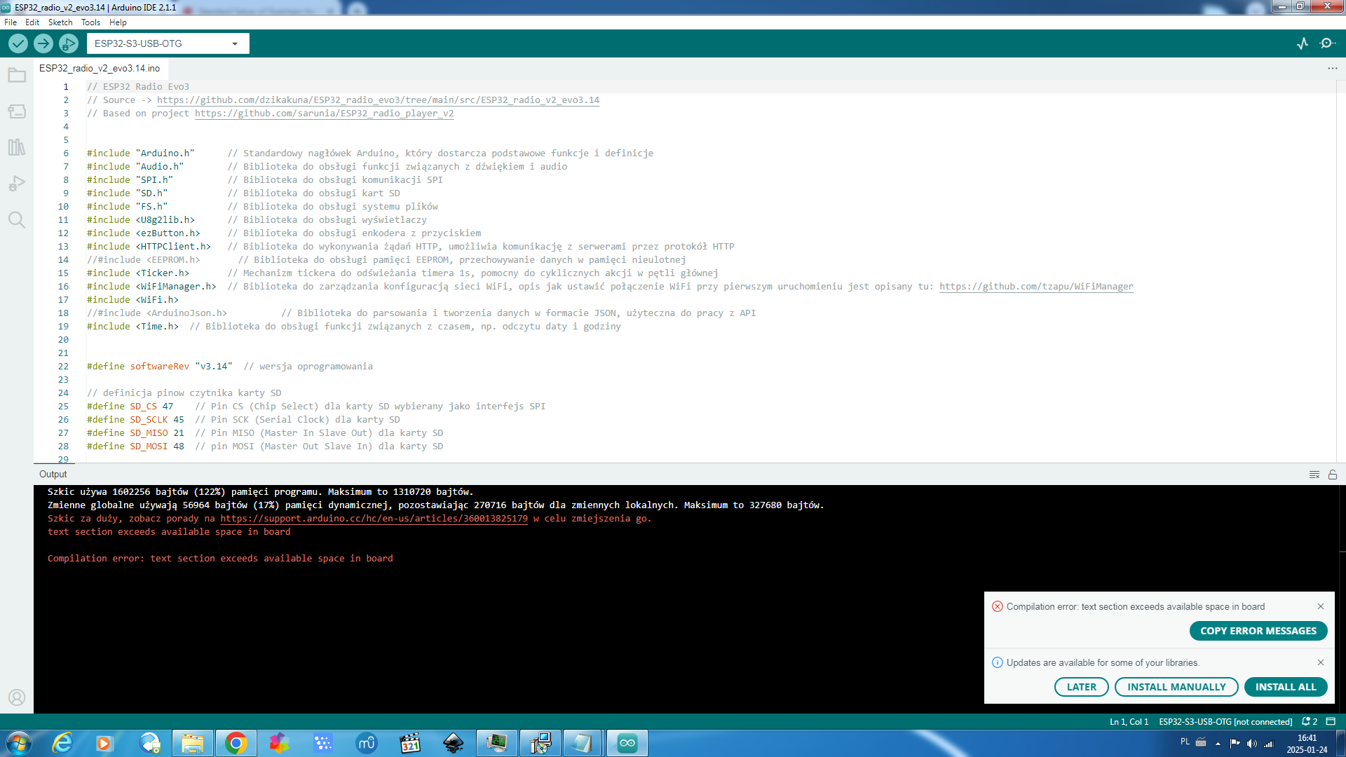

    Gentlemen I have been wggling in turn
    Arduono 2.11 - the last one that works with Win7 64b - so I read
    For this I installed ESP-IDF
    And the ESP-S3 3.11 board in the Arduino board manager
    After trying to compile the latest version 3.14 I get this log
    C:UsersHDDocumentsArduinolibrariesSDsrc_diskio.cpp: In function 'bool sdcard_mount(uint8_t, const char*, uint8_t, bool)':
    416 | #define FM_ANY 0x07
    | int
    C:C:C:C:C:C:C:C:C:C:793:31: note: in expansion of macro 'FM_ANY'
    793 | res = f_mkfs(drv, FM_ANY, 0, work, sizeof(work));
    C:³³³³³³³³.cpp:793:42: error: invalid conversion from 'BYTE*' {aka 'unsigned char*'} to 'UINT' {aka 'unsigned int'} [-fpermissive].
    | BYTE* {aka unsigned char*}
    C:| C:C:C:C:C:793:25: error: too many arguments to function 'FRESULT f_mkfs(const TCHAR*, const MKFS_PARM*, void*, UINT)'.
    C:³³³³AppDataLocalArduino15-arduino-libs-release_v5.3-cfea4f7c-v1-libs-release_v5.3-cfea4f7c-v1-libs-release_v5.3/include/fatfs/src/ff.h:339:9: note: declared here
    339 | FRESULT f_mkfs (const TCHAR* path, const MKFS_PARM* opt, void* work, UINT len); /* Create a FAT volume */.
    Found multiple libraries in "HTTPClient.h"
    Used: C:³³³³³³³³{Arduino}HTTPClient
    Unused: C:UsersHDAppDataLocalArduino15packages3.1.1librariesHTTPClient
    Multiple libraries found in "FS.h"
    Used:
    Unused: C:UsersHDAppDataLocalArduino15packages3.1.1librariesFS.
    Multiple libraries found in "Ticker.h"
    Used:
    Unused: C:UsersHDAppDataLocalArduino15packages3.1.1librariesTicker
    Multiple libraries found in "SD.h"
    Used:
    Unused: C:UsersHDAppDataLocalArduino15packages3.1.1librariesSD.
    Multiple libraries found in "SPI.h"
    Used:
    Unused: C:UsersHDAppDataLocalArduino15packages3.1.1librariesSPI
    exit status 1
    Compilation error: exit status 1
    Something I probably have uninstalled - I uploaded the libraries to the Aruino Libraries document catacog
    Please help me to compile.
    I do not have a computer with a newer system
    Greetings ...

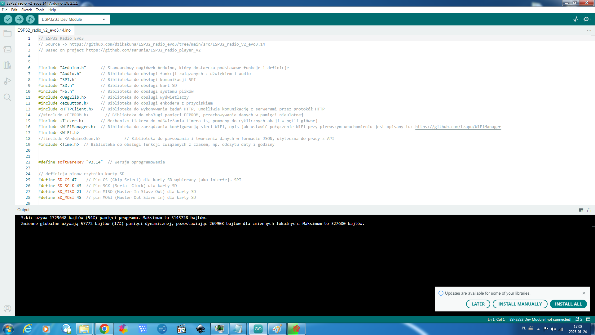

  • #459 21407867
    hevet
    Posts: 347
    Rate: 47
    Remove the SD and SPI library from the Arduino/libraries.
  • #460 21407887
    DJCheester
    Level 28  
    Posts: 2089
    Help: 75
    Rate: 958
    Ok, now it's done, take a look at the screenshot to see if I'm doing it right or what to do, because the sketch doesn't seem to fit
    Screenshot of Arduino IDE showing code and compilation error.
    Thanks
  • Need Espressif USB driver for ESP32-S3 flashing
    #462 21407929
    DJCheester
    Level 28  
    Posts: 2089
    Help: 75
    Rate: 958
    Actually wrong settings ;) .
    Compiled without errors
    I will now upload
    Screenshot of Arduino IDE showing code for ESP32. .
    Thanks to
    Added after 7 [minutes]:
    Ok compiled
    However, the settings
    Screenshot of Arduino IDE with code for ESP32.
    How do I now install the ESP in the computer I plugged in the USBC it on the right and flashes the RGB LED in successive colours ???
    This is the new ESP windows calls driver in the folder Espressif not found ??
    Greetings ...
    Added after 36 [seconds]: .
    Ok compiled
    Greetings ...

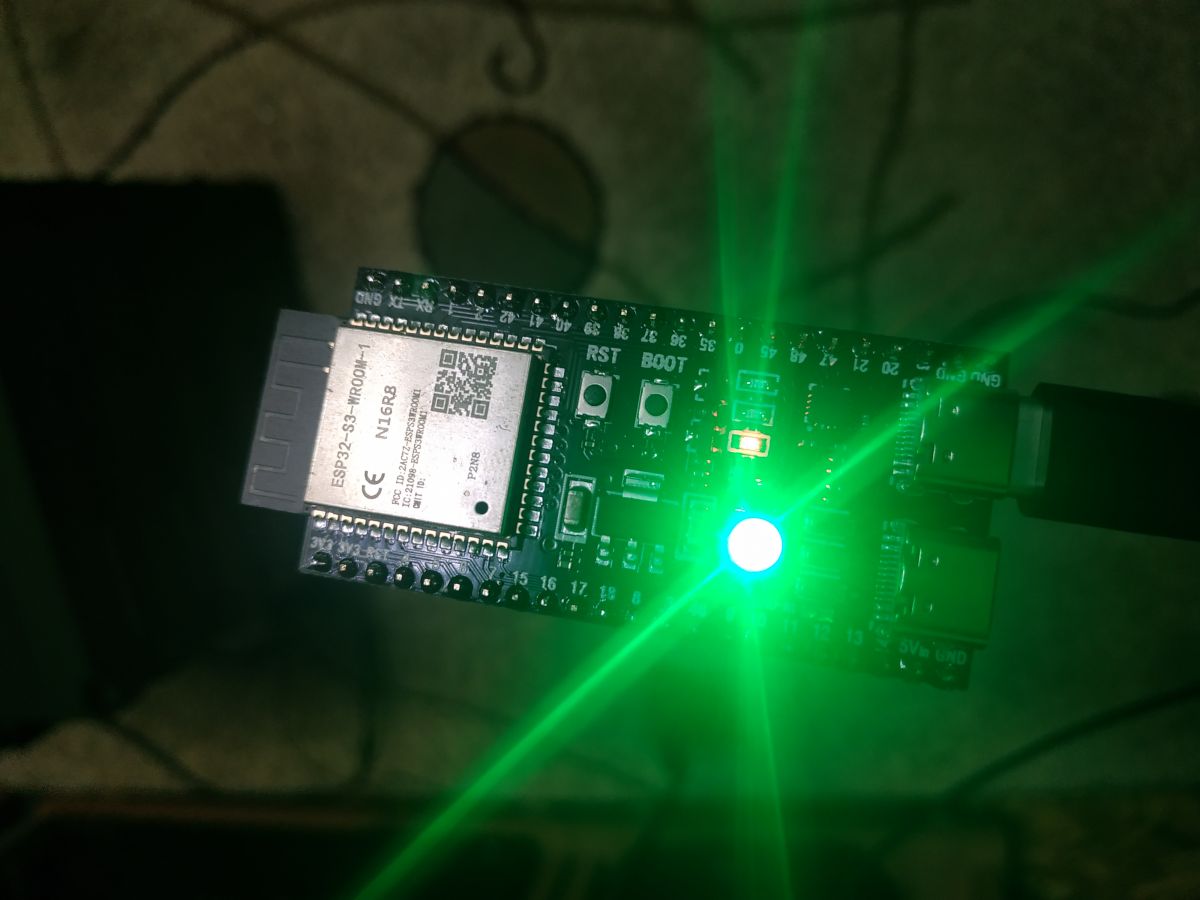

  • #463 21407945
    hevet
    Posts: 347
    Rate: 47
    And what is the ESP specifically? The drivers should install themselves.

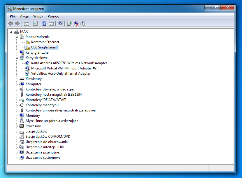

  • USB single serial port detected on Windows 7
    #464 21407954
    DJCheester
    Level 28  
    Posts: 2089
    Help: 75
    Rate: 958
    This is win7 64bit may not have ESP such
    ESP32 module with a glowing green LED. .
    N16R8
    Greetings...
    Added after 1 [minute]:
    Unless it's not the USB I've plugged in but I've seen on the net that it's the one on the right
    Greetings ...
    This is what my computer found
    Screenshot of Windows 7 device manager with USB Single Serial device highlighted.
    USB single serial
  • CH341 driver enabled successful ESP32-S3 upload
    #466 21408020
    DJCheester
    Level 28  
    Posts: 2089
    Help: 75
    Rate: 958
    Thanks, it worked, I uploaded Ch341

    Writing at 0x00180f20... (88 %)
    Writing at 0x0018647f... (90 %)
    Writing at 0x001900c9... (91 %)
    Writing at 0x001975c9 ... (92 %)
    Writing at 0x0019cfe7 ... (94 %)
    Writing at 0x001a204a... (95 %)
    Writing at 0x001a7bc0... (97 %)
    Writing at 0x001ad8b3... (98 %)
    Writing at 0x001b388a... (100 %)
    Wrote 1729760 bytes (1137672 compressed) at 0x00010000 in 15.8 seconds (effective 875.2 kbit/s)...
    Hash of data verified.
    Leaving...
    Hard resetting via RTS pin...
    Does anything else need to be done on this ESP now - reset or can it be unplugged from the computer ??
    Greetings ...

    It can be unplugged, the reset did itself. And does it show anything on the display?

    I don't know but this rgb glows greenish-yellow no longer flashes
    Today I wanted to go through the compilation process I don't have the display plugged in yet - I programmed the ESP myself
    Tomorrow I will try to do a test on the contactor, i.e. OLED ESP and card, because this is probably the minimum ??
    Do I need to load anything onto the card or is it just an empty FAT32?
    Thanks for today because I have to go to work for the night (I did not sleep during the day it can be a drama around 3 hours ;) .
    Greetings ...

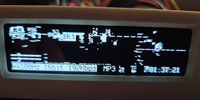

    Sometimes when switching stations, bushes appear on the display. When I switch to another station and back to the one that was the problem, the bushes disappear. This happens on any station, randomly. The bushes also disappear by themselves when the information broadcast by the station changes, e.g. the artist.
    Car radio display showing strange symbols and the song title Kenny Masters - SOS, Fire In My Heart. .

    @hevet I have this sometimes too, I don't know what causes it, you may need to enable some sort of subsequent refresh of the displayed data after some short time.
    I did quite a bit of work on the SD card file player today, I managed to make the screen scroll in a loop using the directional up - down buttons on the remote control for both radio stations / folders / files with the selection being confirmed by the middle button on the remote control. It needs a bit of fine-tuning so that when alternating between encoders / remote control it always selects exactly what is selected from the list. Sometimes there will be a -1 shift in the selected file index - I need to track this down. If I use only the remote control to select files / folders it is rather always OK, if I insert something from the encoder then somewhere the index is shifted just by 1. @robgold can you help to trace this? I also need to make the highlight set to the last selection each time.
    I'm thinking of moving the handling of the whole file player to a separate file so it's easier to control visually.
    I uploaded the current file to myself on github: https://github.com/sarunia/ESP32_radio_player_v2
    Below is a description of the remote control buttons:
    Code: C / C++
    and a screen shot of the selection of audio files from the current folder being played:
    Display showing a list of audio files with the file Anticappella - Baby 2 Day.mp3 highlighted. .
    @robgold I think it's ok now with this file index numbering at my place, I've changed the file search approach anew, which has made it quicker to start playing any file in the scrolling list or selecting the previous one, now all selections are pulled from the files[] array.

    @hevet, @MAJSTER XXL
    Regarding the display and the subject of so called "ghosting", I've spent quite a bit of time to severely limit this but they still appear from time to time. Interestingly most often on stations without streamtitle and with AAC codec i.e. e.g.: all Polish Radio programmes, 1,2,3,4. Looks like it's related to the setColor() function. See that always then something from the bottom line will do in the negative. Today I made an extra refresh of the screen after 200ms. I think this solves the problem because the "ghosts disappear". A bit of a prosthesis but oh well.

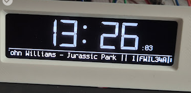

    I made an additional display mode for my needs this week. It's probably of little use to anyone, so I didn't even post it on GitHub.
    The idea is that you can use the remote control to turn on the clock mode and then the station name and scroller go to the bottom line. We turn off the info about frequency, stream type and only display the minimum with the minimum (I assume we know what we are listening to). In addition, on the SSD1322 it is possible to dim the display by reducing the pixel current from 160uA to 80uA so that it does not flare up at night.
    Other changes:
    - in the bank menu by pressing the numeric keys you can quickly select a bank from 1-10 ( under 0 is the number 10)
    - under the RED button (red handset in my case) in the bank menu, it is possible to enable a flag for downloading a given bank from the network (GitHub server)
    - under the ATT button, a mute function is added, in place of the VU indicators the information "MUTED !" appears.
    Distorted electronic display with graphic errors and music playback information.
    LED display showing the time 13:26 and information about the playing music. .
    OLED display showing information for bank 1 and network update enabled.

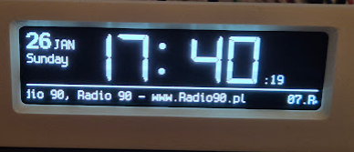

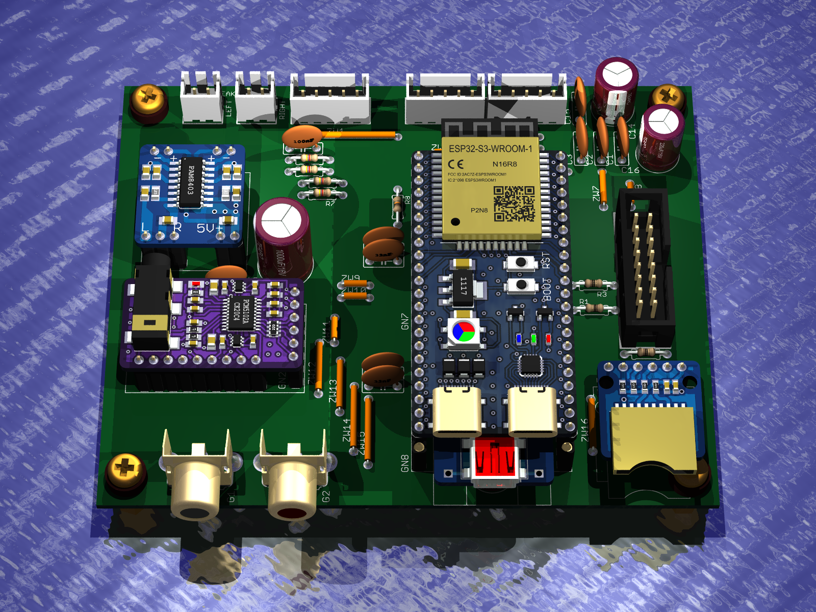

    A cool byline, something like this is what I wanted, it could be.
    I have a question for MAJSTRA XXL how do you switch on this radio? I.e. does it switch on by itself when power is applied or do you have to press/hold the encoder or simply use the remote control?
    I think that ESP does not consume much power, so if the option would introduce standby even from the remote control or possibly add a switch and the system would turn off the OLED radio and the whole ESP would work 24 hours a day, it could also be.
    If you want to be more economical, you could add a button to disconnect power from the whole system.
    What do you think?
    The question of the clock itself, when the radio is on, as you have shown, it would be good, optionally, when it is off, not 24 hours a day but, for example, after pressing the remote control or encoder, to show the time and date, the day of the week.
    And if there was an option with esp32 switched on all the time, it would also be possible to implement an alarm clock in the code, i.e. at the set time the station would switch on or, if the radio was for some reason offline, an MP3 player with preloaded sound on the card or just MP3 tracks.
    These are my suggestions. What do you think?
    I am currently working on the board, but when there is more time, I will certainly etch it and start the radio.
    I have already programmed the ESP thanks to my colleague hevet, I hope we will see it on startup.
    Tell me, if I wanted to hardwire a PCB for the switch, would it be standard in this ESP to use a pushbutton to ground like in Arduino, with a 5V supply pulled up through a resistor e.g. 4.7k?
    And the LED from the pin directly through only a resistor to ground as I did on the Arduino.
    Maybe I'm asking stupid questions but this is the first time I'm using ESP ?
    What voltage level is on the ESP pin 3.3V I think ?
    Regards and thanks for your help so far.
    For the time being the PCB will look like this.
    PCB with ESP32 module and electronic components. .
    Greetings...

    Have to admit that today's PCB visualisations look nice. Have you checked yourself this SD reader ? Because I got nicked on it it doesn't have a card "ejector". It's a kind of "connector".
    I'd suggest you, throw away the connectors in front of the ESP antenna and move the module/antenna out of the PCB area completely.
    What are you drawing in ?
  • Eagle3D render workflow and PCB layout notes
    #476 21411102
    DJCheester
    Level 28  
    Posts: 2089
    Help: 75
    Rate: 958
    Heyka the PCB is not yet final I am thinking about your suggestions what you wrote me i.e. SMD capacitors directly under the sockets etc.
    I as I wrote am retired from electronics, I am using the first visualization software that came out.
    The design is in Eagle and the render is using Eagle3D script and Povray
    As I've been designing this way for 11 years now, I learned how to write model macros in povray from scratch.
    Greetings...

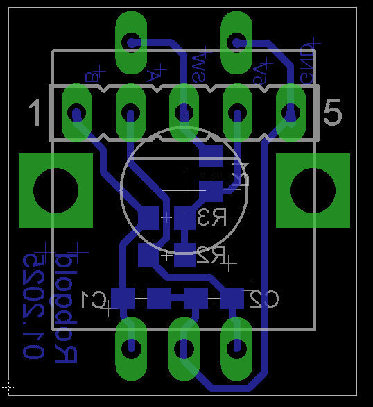

    @DJCheester, you can give those capacitors from the encoders at the encoders themselves. That would be best. Any pins should be "whisked away" at the source to avoid stretching them across the circuit with wires.

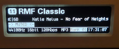

    I added a calendar to the clock screen.
    The mute information is displayed in the negative
    Digital display of time and date with additional radio information. .
    Display screen showing the currently playing song on the radio. .
    Printed circuit board design with capacitor and encoder elements. .

    Elements such as resistors capacitors are to be changed on the PCB this version is only an overview now I will improve it to make it the best it can be.
