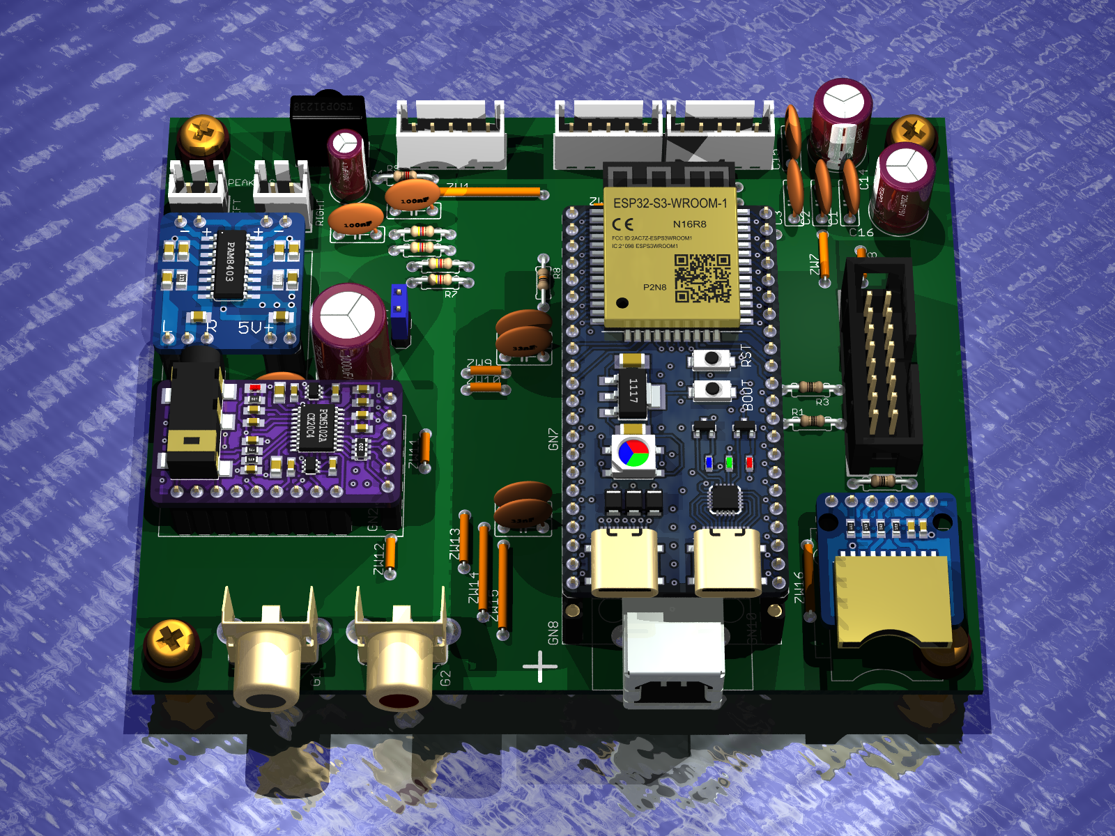

    Hello I haven't checked the card reader, I will see, but it's not likely to be replaced very often, i.e. the card.
    Once loaded files will be for a long time, at most I will correct the position of the reader relative to the edge of the board.
    Gentlemen, software updates are springing up like mushrooms after the rain 😀 .
    I'm already looking forward to running my version of the radio, only dilemma is which soft will end up in the radio, I think I'll buy a second ESP and load both - changing the module is a snap.
    Keep it up, regards....

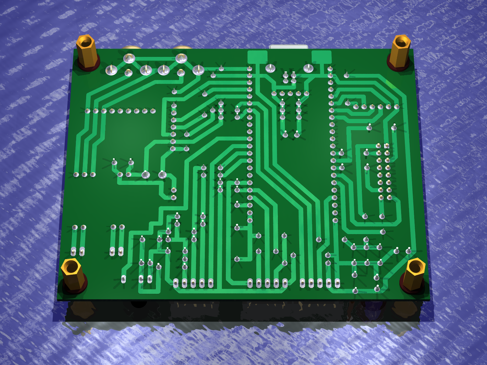

    DJCheester wrote:
    PCB this version just an overview now I will improve it to make it the best it can be.
    I would suggest including more secure mounts for the SD card adapter module. If you only mount it on solder pins (located so unhappily), without more secure supports, this will not have sufficient mechanical rigidity, so that after a while the solders can let go and problems arise.
    By the way. How are you going to power this board of yours? Is any of the visible on the board, a power connector, or are you going to power it via the USB connector on the ESP module ? (I ask out of curiosity, because the latter option is suggested by the location of the ESP module on your board).

    Under the ESP I'll most likely add a USB printer square socket and that's what I'll power, as for the card module, for the time being the prototype is most likely to fix the card on the front and here goes the duct tape.

    And you think this board must/should be powered by a USB connector?
    In my opinion, if the SD adapter ultimately, will be somewhere else, and why reserve space for it on this board, the connector itself will suffice.

    The board is universal, so there is room for an adapter just in this place so that it can be mounted immediately, you can also mount the JST 6pin socket raster 2.54 and with a cable to connect where you want, it is done for uniqueness, at startup probably will be useful direct connection later you can change, although probably will remain in this place adapter has mounting holes for distances 2mm and you can additionally fix it. Besides, the card will not be changed often.
    The same is true for the ESP, a module with a mini/microUSB socket is planned and a USB printer socket will already be coded directly into the board.
    Of course, you choose what you want and only mount one.

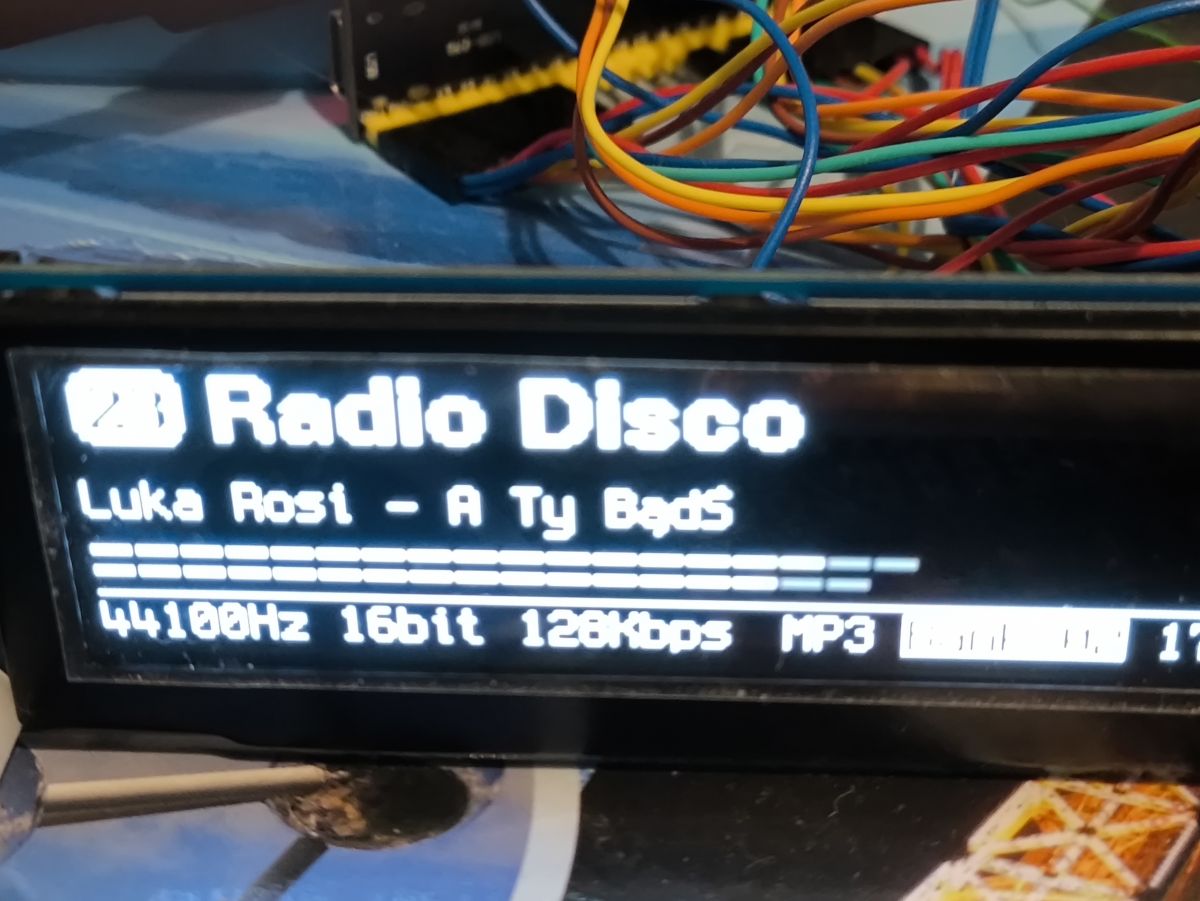

    @robgold I have uploaded your latest version, two cosmetic things:
    Instead of a small ź it displays ¶
    Screen display showing a music player with radio, artist, and track information, with colorful wires in the background.
    The second thing, the clock overlaps the bank number information. You need to change the value from 201 to 208.

    @hevet,
    Corrected already after the release on GitHub.
    Thanks, I've already caught that too. The value x=203 for the second hand, the full clock has x=208.
    This missing "ź" is unfortunately most likely related to the Disco station. I also caught this error once, I will have to check it further in my free time, but it seems to me that it is a wrong character encoding on the station side. If I succeed, I will check it before uploading the first version of 3.15. If not, it will be in some iteration of 3.15.

    @robgold possible, but ź converted to ¶ seen still at another station.
  • #490 21412775
    robgold
    Posts: 724
    Help: 10
    Rate: 290

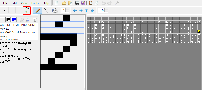

    >>21412756 .

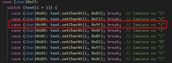

    I return the honour, indeed something is wrongly assigned:
    code C5 -> case (char)0x9B: text.setCharAt(i, 0x9C); break; // Converted to "¶" and should be ź
    You need to replace code 9C with 9F at the letter ś. Type from your finger for now for tests for case (char)0xC5:
    Screenshot showing hexadecimal data with the code C5 9B highlighted in red. .
    Code snippet showing character replacement instructions with comments. .
    Screenshot showing a character editor and bitmap for the letter ś in a character table. .

    Ok, I've done it, I'll watch to see if it helped.
    Added after 2 [hours] 59 [minutes]: .
    @robgold now showed ź instead of ¶.

    This is exactly what I wrote. The charms of Unicode.
    The word "louder" is 67 C5 82 6F C5 9B 6E 69 65 6A
    The question is what to replace the C5 9B characters with when, according to the table, both letters have the same code in UTF-8.
    I would go back to "ś" however "ź" is relatively less frequent.

    Too much in front of the computer today. At work, after work.... thanks. Corrected. Letter: "ź" is C5 BA
    In that case, in the tables we have, this character was not there. It needs to be added:
    case (char)0xBA: text.setCharAt(i, 0x9F); break;  // Zamiana na "ź"

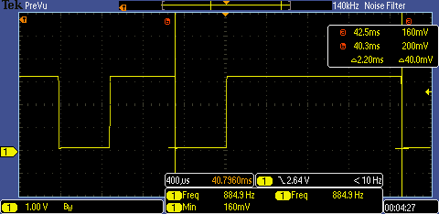

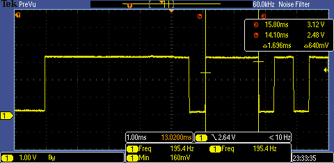

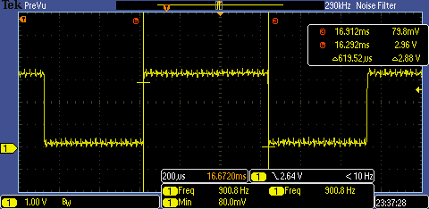

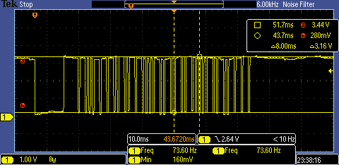

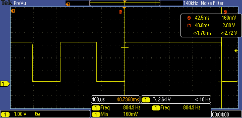

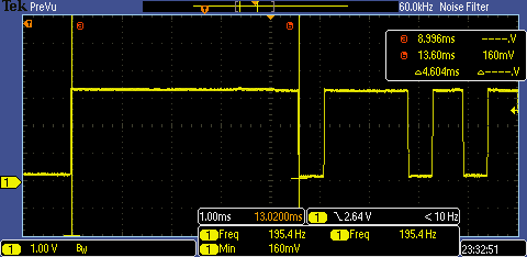

    @MAJSTER XXL
    I saw that you changed the pulse definition in the description from 690 to 560us in your ino file. I have started to explore this topic of the NEC protocol. Some sources give the duration of the shorter pulse as 1.25ms others 1.12ms. I finally measured it because it was bothering me, maybe it will be useful to someone else. It turns out that the short pulse (0) actually lasts 1.12ms.
    My analyser unfortunately proved too slow I had to reach for an oscilloscope ;) .
    Results from measurements:
    pulse 9ms came out almost 9ms -> 8.996ms
    pulse 4.5ms -> 4.604ms
    pulse 1.690 -> 1.696ms
    pulse 560us -> 619.52us
    signal "0" -> 1.13ms - exits symmetrically at 560us
    signal "1"-> 2.2ms
    I am uploading the oscillograms. This is to close the topic of the IR remote control.
    Oscillogram of IR signal showing pulse waveform. .
    Oscilloscope signal of IR remote with time and voltage values. .
    Oscilloscope signal display showing various time parameters. .
    Oscillogram of NEC protocol signal .
    Oscillogram showing signals with durations of 16.9ms, 16.3ms, and 619.52us. .
    Oscillogram showing signals in the NEC protocol. .
    Oscillogram of NEC protocol signals on an oscilloscope screen. .

    Yes, we leave the block "C5" as it was and add at the end the definition for "ź"
    case (char)0xC5:
            switch (text[i + 1]) {
              case (char)0x82: text.setCharAt(i, 0xB3); break;  // Zamiana na "ł" Unicode UTF-8
              case (char)0x84: text.setCharAt(i, 0xF1); break;  // Zamiana na "ń" Unicode UTF-8
              case (char)0x9B: text.setCharAt(i, 0x9C); break;  // Zamiana na "ź" Unicode UTF-8
              case (char)0xBB: text.setCharAt(i, 0xAF); break;  // Zamiana na "Ż" Unicode UTF-8
              case (char)0xBC: text.setCharAt(i, 0xBF); break;  // Zamiana na "ż" Unicode UTF-8
              case (char)0x83: text.setCharAt(i, 0xD1); break;  // Zamiana na "Ń" Unicode UTF-8
              case (char)0x9A: text.setCharAt(i, 0x97); break;  // Zamiana na "Ś" Unicode UTF-8
              case (char)0x81: text.setCharAt(i, 0xA3); break;  // Zamiana na "Ł" Unicode UTF-8
              case (char)0xB9: text.setCharAt(i, 0xAC); break;  // Zamiana na "Ź" Unicode UTF-8
              case (char)0xBA: text.setCharAt(i, 0x9F); break;  // Zamiana na "ź" Unicode UTF-8

    robgold wrote:
    You are not measuring with a pulse of 4.5ms. Change the value to 4500 and leave the Tolerance at 120. It should work.
    I've set it and it looks like it's working, thanks :) .

    >>21413353 if you want a fantastic web interface, free, self-contained recording of remote control keys (NEC - 38kHz) then yoRadio is the answer. It's a well-developed and well-thought-out radio - with superb control also from the web level. Including editing of station lists, import and export. Everything except the alarm clock ;-) I tried to compile the projects of my colleague Majster and robgold, but I couldn't manage with the libraries. There is a large group on FB at yoradio. I have already run 3 radios including the SSD1322 I bought for this project.
    Digital radio display showing 21:20 and connecting to Polish Radio Drivers, with a computer screen in the background. .

  • #510 21415982
    DJCheester
    Level 28  
    Posts: 2081
    Help: 75
    Rate: 954
    As far as I know this is how I am designing the PCB so far I have added ir and a USB printer socket to power the whole, pcb not yet worked out all modules will be on goldpins as below
    Visualization of a designed PCB with an ESP32-S3-WROOM-1 module and various components.
    Close-up view of a green PCB with circuit traces and solder points. .
    Unless I am unaware of something.
    We will wait to hear from the authors of the two versions i.e. MAJSTRA and robgold.
    Greetings ...
