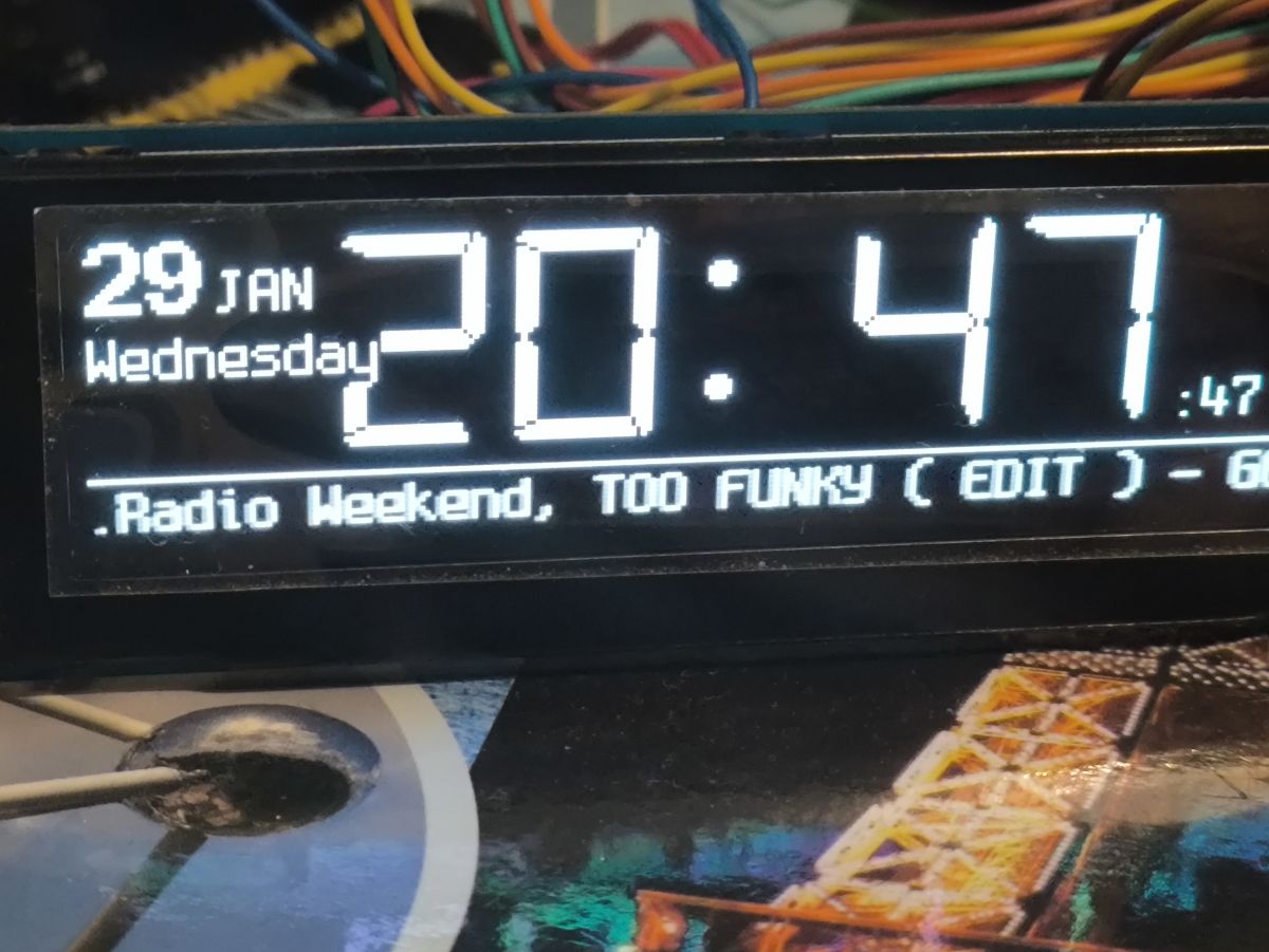

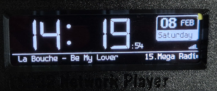

    @robgold, small cosmetic error, day of the week overlaps the hour.
    Electronic display showing time, date, and radio information .

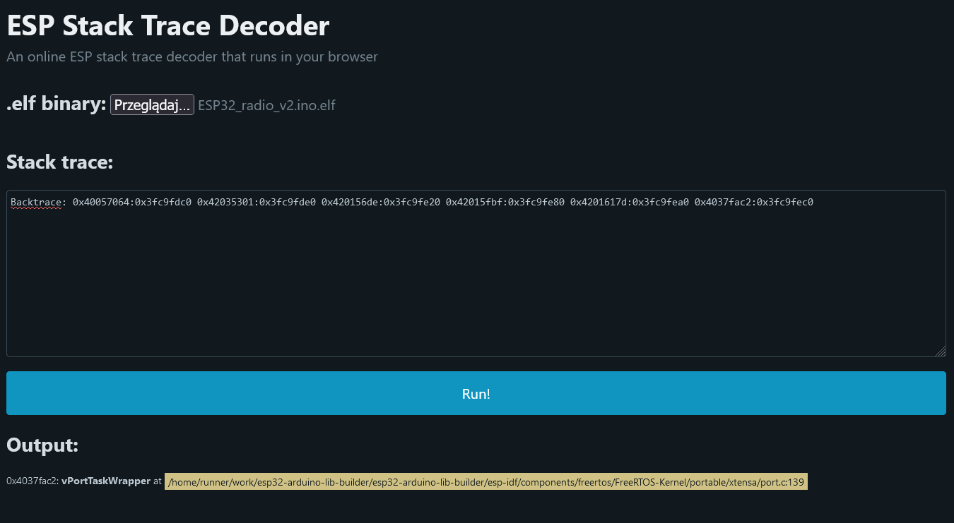

    @khoam thanks for the lead on the decoder, but it doesn't tell me much except that it points to:
    ESP stack trace decoder interface with loaded binary file and output trace code. .
    and this is related to the FreeRTOS task, the fragment pointing to port.c:139:
    Code: C / C++

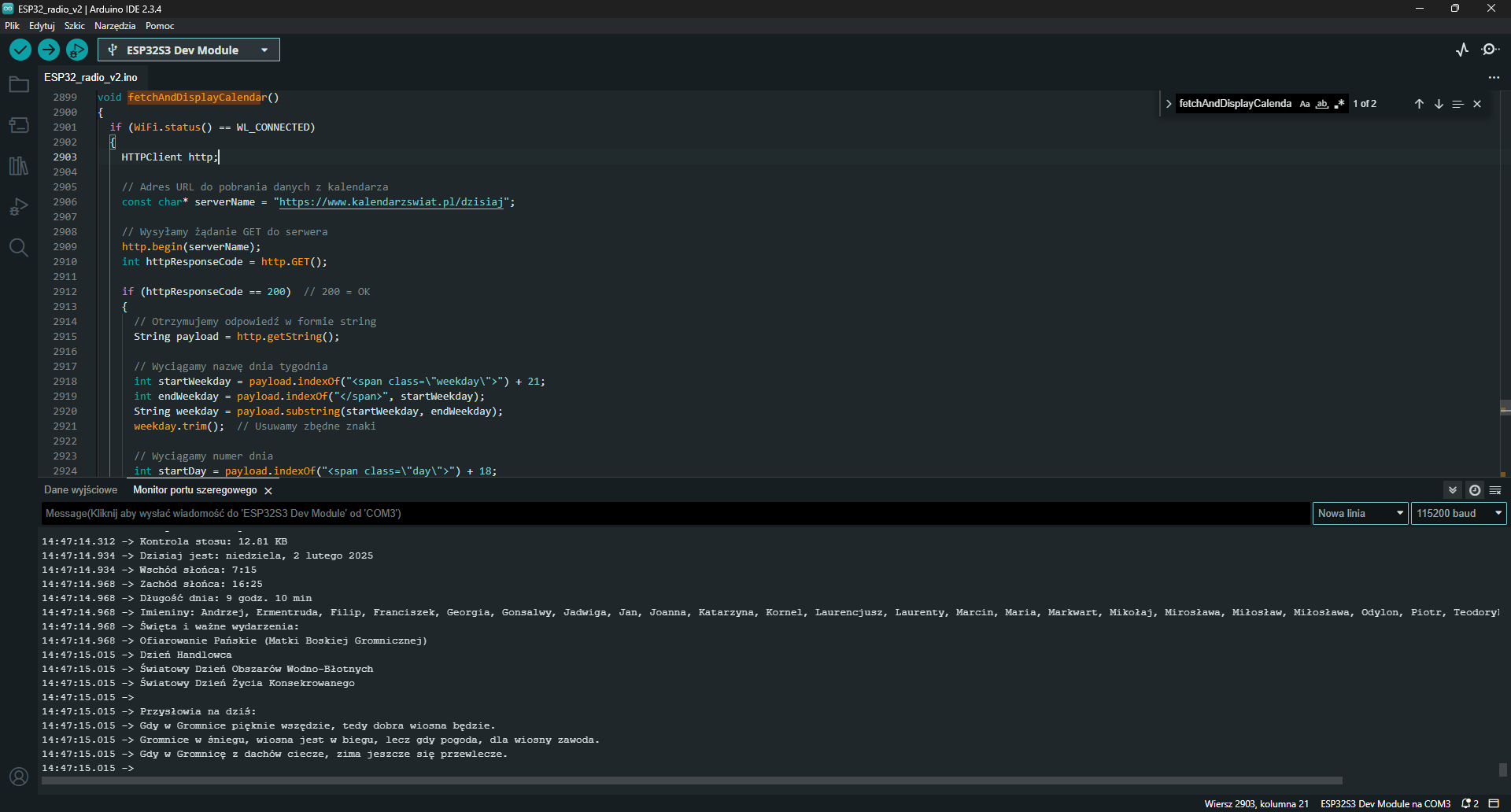

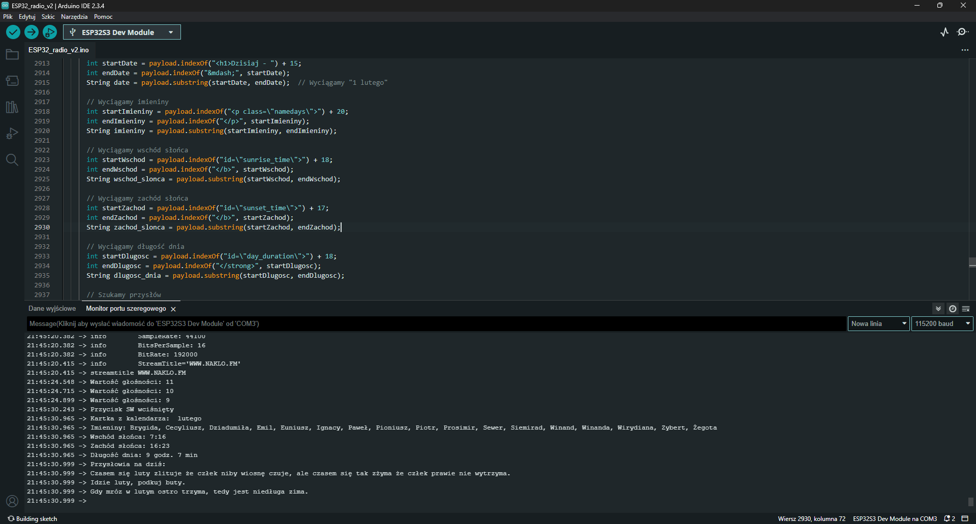

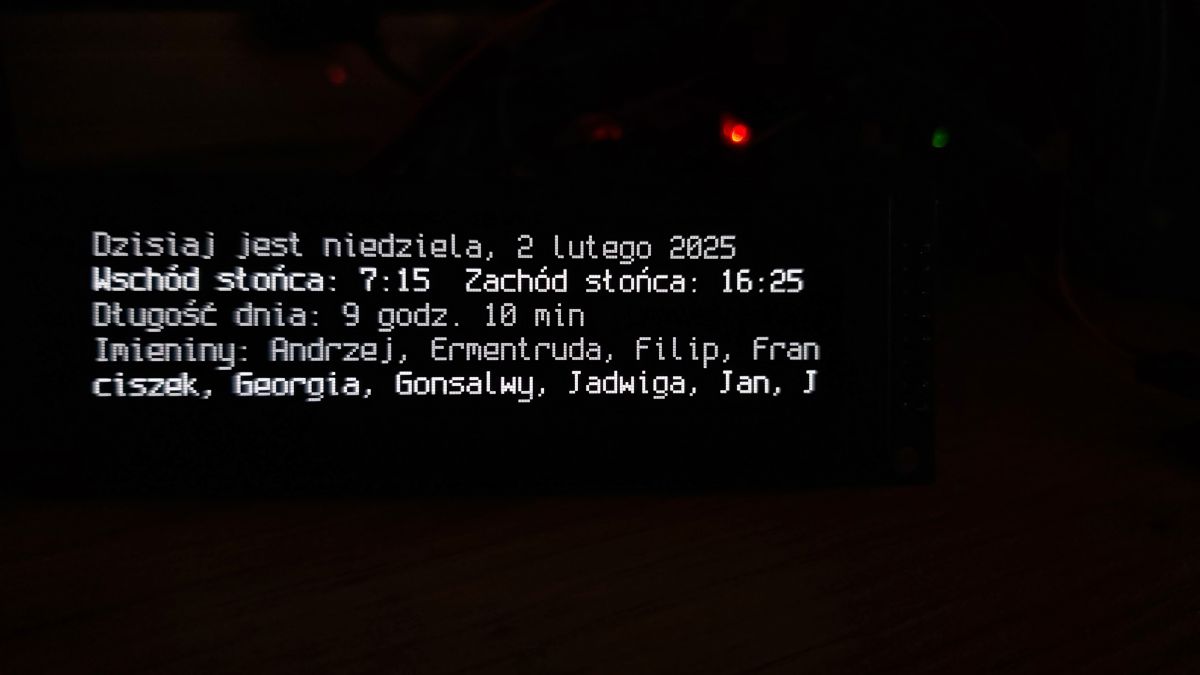

    At the end of the day I'm uploading a screen shot of the calendar card on the series, it will be displayed on the last line sequentially with the weatherman:
    Screenshot of Arduino IDE showing C++ code and output data related to messages sent to the ESP32S3 module. .
  • HTML calendar scraping with ESP32-S3 button trigger
    #523 21421481
    MAJSTER XXL
    Posts: 2064
    Help: 164
    Rate: 429
    I have added some useful info from the site that serves the calendar. The data is extracted by looking for relevant phrases in the payload with html content. As long as these phrases in classes are fixed on the page, it will work. Maybe someone will find it useful- you can frequent. As a test, I assigned a joystick button and a button on the remote control to call this function.
    Code: C / C++
    Code: C / C++
    Screenshot of Arduino IDE showing code and output on the serial monitor. .
    Screen displaying date, sunrise and sunset times, and namedays. .

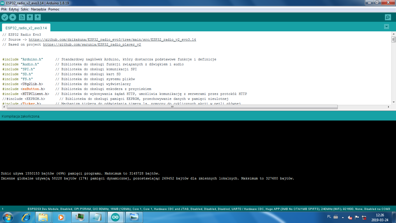

    Hello managed to compile the sketch under Win7 32bit + SP1
    Running on a clean system
    installation - Arduino 1.8.19
    in Arduino - board manager we install esp32 by espressive Systems v.2.0.17 kit (the latest from version 2)
    After attempting to compile, a version error pops up esptool.exe
    The file is for the 64 bit version of Windows I get this error
    Arduino:1.8.19 (Windows 7), Board: "ESP32S3 Dev Module, Disabled, OPI PSRAM, QIO 80MHz, 16MB (128Mb), Core 1, Core 1, Hardware CDC and JTAG, Disabled, Disabled, Disabled, UART0 / Hardware CDC, Huge APP (3MB No OTA/1MB SPIFFS), 240MHz (WiFi), 921600, None, Disabled".
    The version of the C:■******AppDataLocalArduino15.5.1.exe is not compatible with the version of Windows running. Check in the operating system information on this computer which version of the program is needed (x86 - 32-bit or x64 - 64-bit) and then contact the software publisher.
    exit status 1
    Compilation error for ESP32S3 Dev Module board.
    This report should contain more information if in
    File -> Preferences the option "Show
    detailed information during compilation"
    I have replaced the esptool.exe file for the 32bit version is here
    https://github.com/espressif/arduino-esp32/issues/6012#issuecomment-1589090694
    After that, the sketch compiles (of course, the libraries placed in the arduino/libraries folder should be included in the project)
    Compilation of a sketch in Arduino 1.8.19 on Windows 7. .

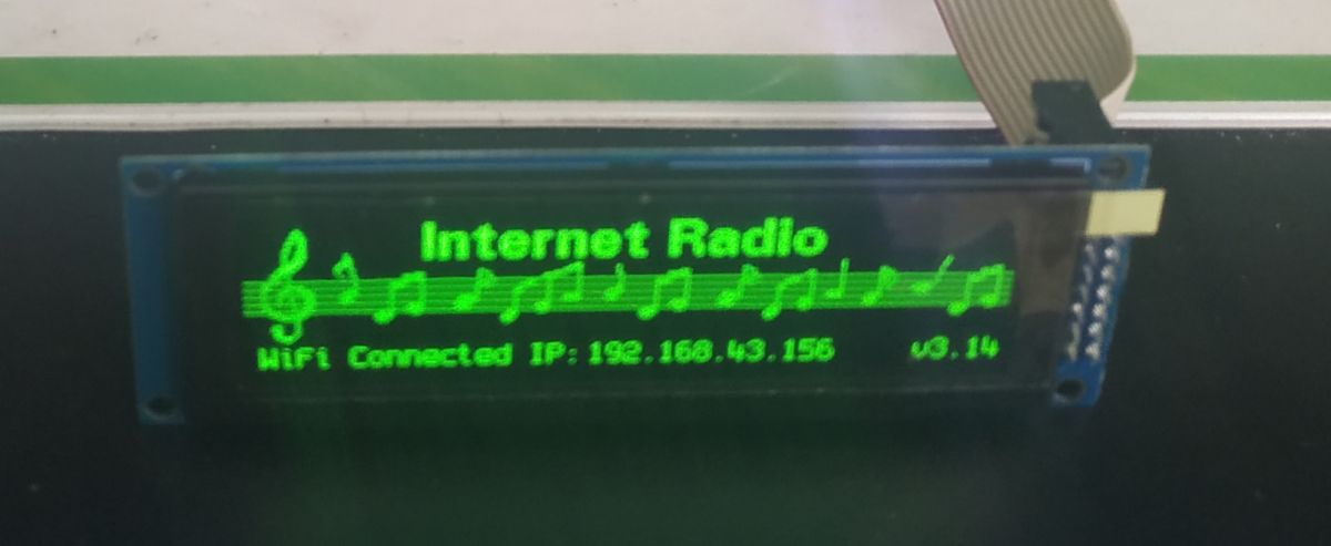

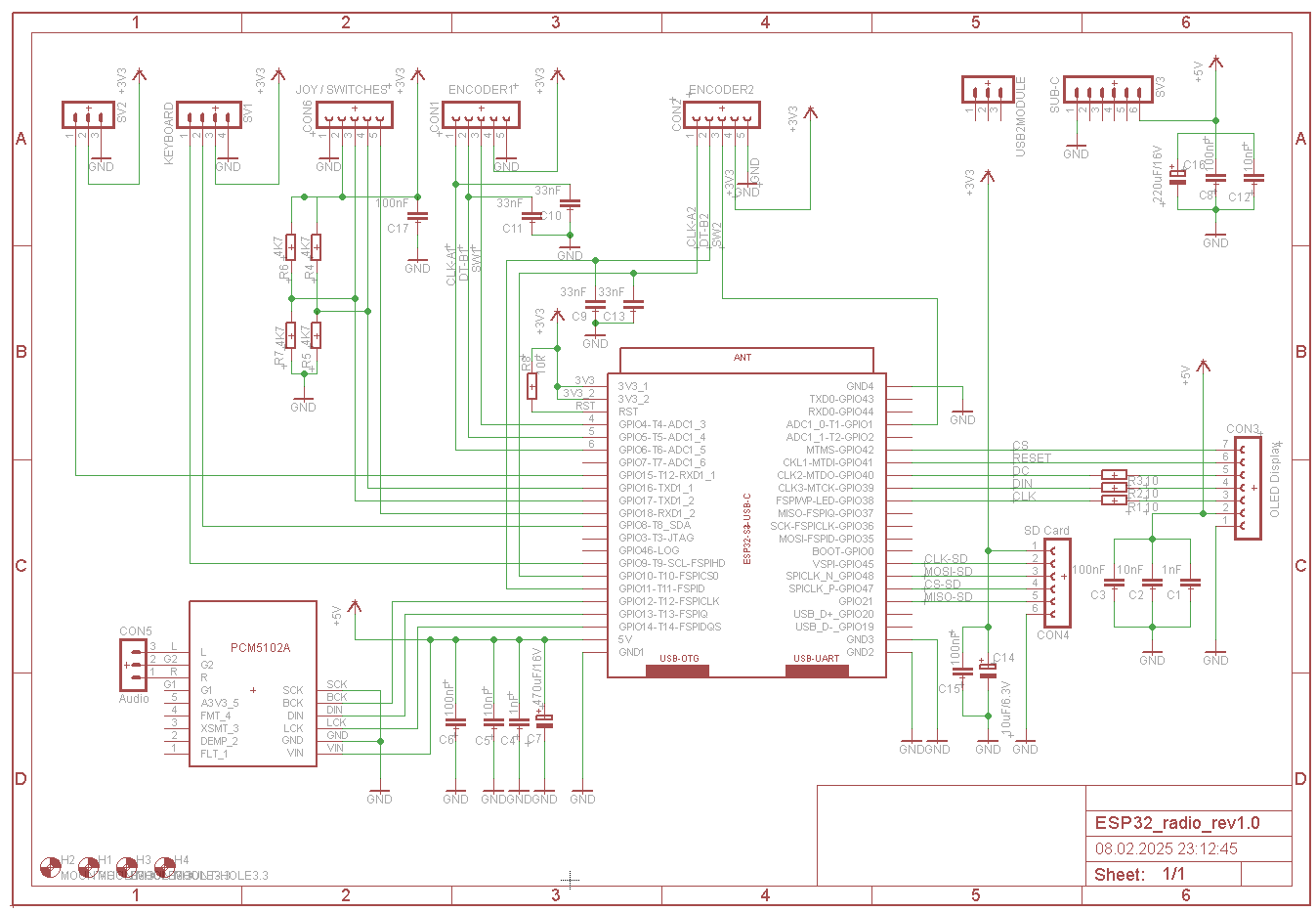

    The schematics will slowly differ for the moment but I am trying to maintain compatibility with Majster. E.g. in my version there is no joystick as well as the player is without the updates and changes that Majster has made. I just don't use it. Every now and then I download the Majster file and upload my test FLAC files. Until they start playing I skip the topic of the player.
    The IR receiver was clipped to GPIO15 on a test basis and has stayed that way and will stay that way at least in my version. The foreman seems to have left it on GPIO15 the same way too.

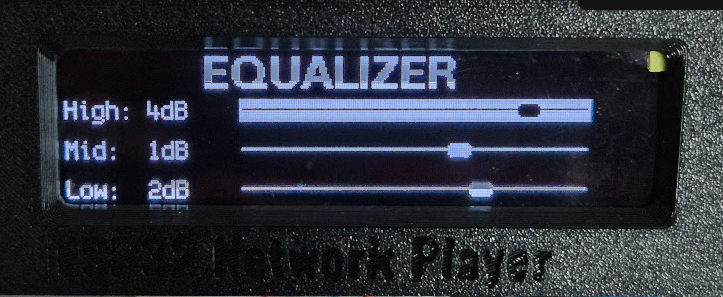

    - added a 3-point equalizer, for now a test version, without notation and "presets"

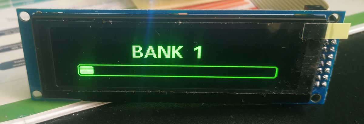

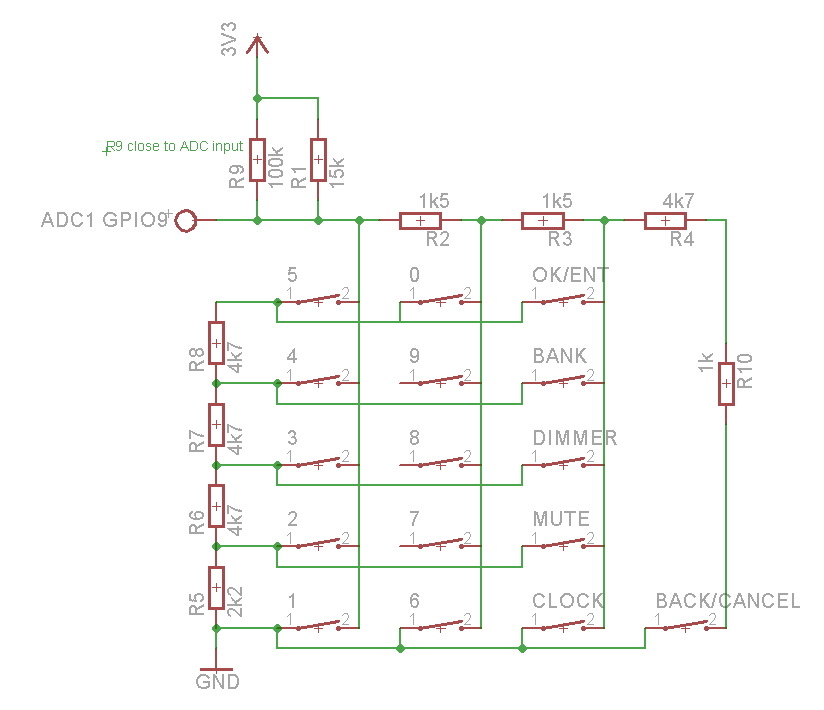

    - added numeric keypad functions for changing stations, banks ( resistive keypad on ADC1 GPIO9),

    - new calendar view in the full-screen clock option,

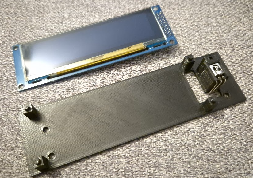

    - updated STL file for Hammond case
    - updated STL file for printed housing

    Equalizer: .
    At the moment I have implemented what the Audio library allows, which is a 3-point equalizer.
    Since the settings are in the range of -40 to +6dB, in order to display it quite correctly the sliders below 0 move slower, above 0 they jump much faster. It's called up with the remote control command assigned to "rcCmdAud" We move with the arrows - up, down filter selection (Hi, Mid, Low), right, left boost-dampening change. Test.

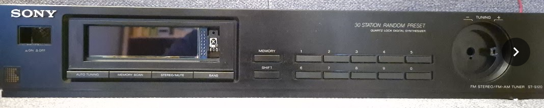

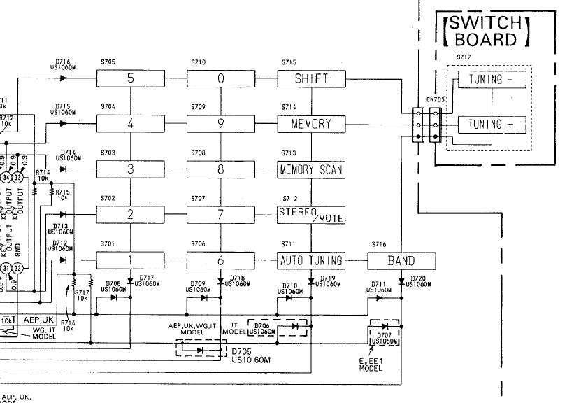

    ADC keyboard: .

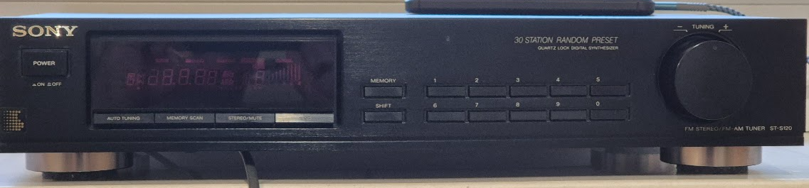

    I managed to obtain an old Sony ST-120 tuner as a "donor" for conversion. Consequently, the need arose to add keyboard support. As a test I built a matrix resistive keyboard based on reading from ADC and I can tell you that it works very stable. If there are problems, I will switch to PCF8575. On the schematic there is a place to connect the i2c keyboard. In the INO file the keyboard is disabled. You have to disable the comment in lines 3893-3897. The schematic of the keyboard and the resistor values can be seen in the pictures.
    Code: C / C++
    The keypad has a specific connection matrix resulting directly from the solution that is in this Sony. In general, old Sony tuners are very cool because they have a minimum of buttons and a large knob under which either Sony already mounted a knob/button +/- for tuning or an encoder. So the conversion is simple. If anyone wants to, I can provide ready-made files for conversion for the OLED 3 display..12 and an IR receiver. The prices of these tuners as I looked are in the range of 80-100PLN and you gain a housing and a ready-made 12V, 24V power supply. So a simple 3.3V inverter solves the problem.

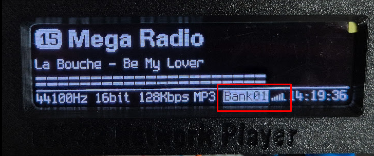

    Wifi indicator: .
    The addition of the indicator has forced some changes to the display. The file format has been reduced to 3 letters i.e. we have: MP3, AAC, FLC, VBR. In addition, the Bank info is written without spaces as Bank01, Bank02 etc.... The indicator shows the network coverage in the form of 6 bars. You can move it anywhere on the display. The function that draws it is: drawSignalPower(194,63,0); The syntax is (X-coordinate, Y-coordinate, option whether to print signal level on serial 1 -yes, 0-no).

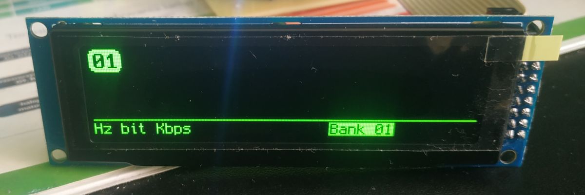

    Corrected additional screen refresh: .
    As some of you have already pointed out sometimes artefacts/ghosts appear on the display after changing stations. The streamtitle refresh function from the Audio library is to blame for this. It starts substituting the streamtitle variable when changing stations and sometimes spills the display buffer. In the VU meter's refresh loop I added an extra counter counting 4x65 and refreshing the screen once more. So far after this "prosthesis" I have not been able to catch the "artefacts" again.
    Schematics, images, pictures below. The schematics themselves in Eagle 6 format are on GitHub.
    Circuit diagram of an ESP32-based radio .
    Sony ST-120 tuner keypad connection schematic .

    OLED display showing radio station and audio parameters. .
    Display showing equalizer with three sliders. .

    Front panel of Sony ST-S120 tuner with visible buttons and display. .
    Front panel of a Sony tuner with display and buttons .
    OLED display module with casing. .

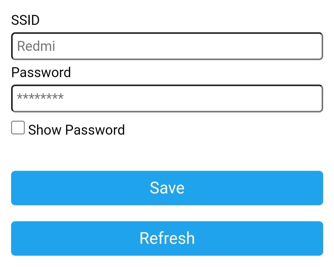

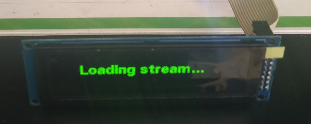

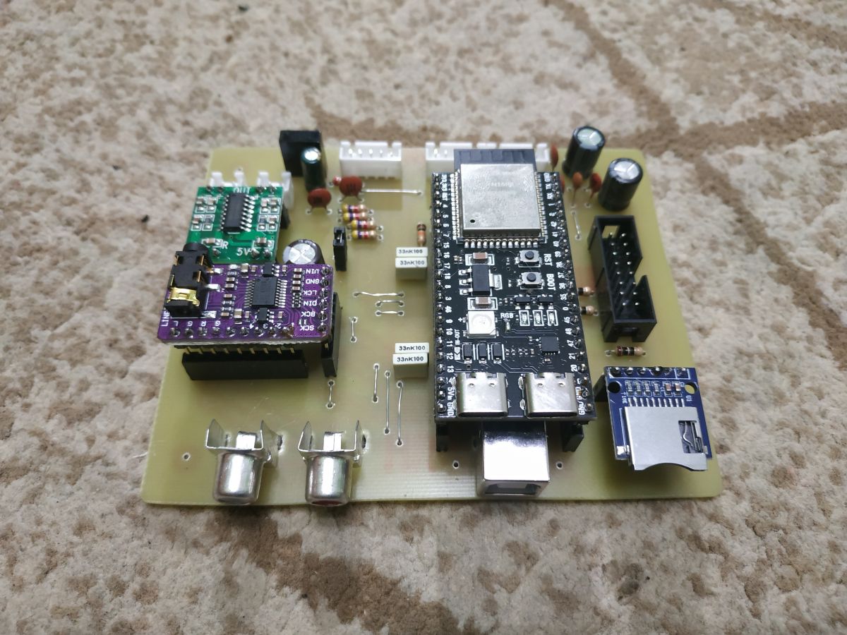

  • First-time WiFi hotspot setup and hardware disable questions
    #531 21431542
    DJCheester
    Level 28  
    Posts: 2089
    Help: 75
    Rate: 958
    Welcome

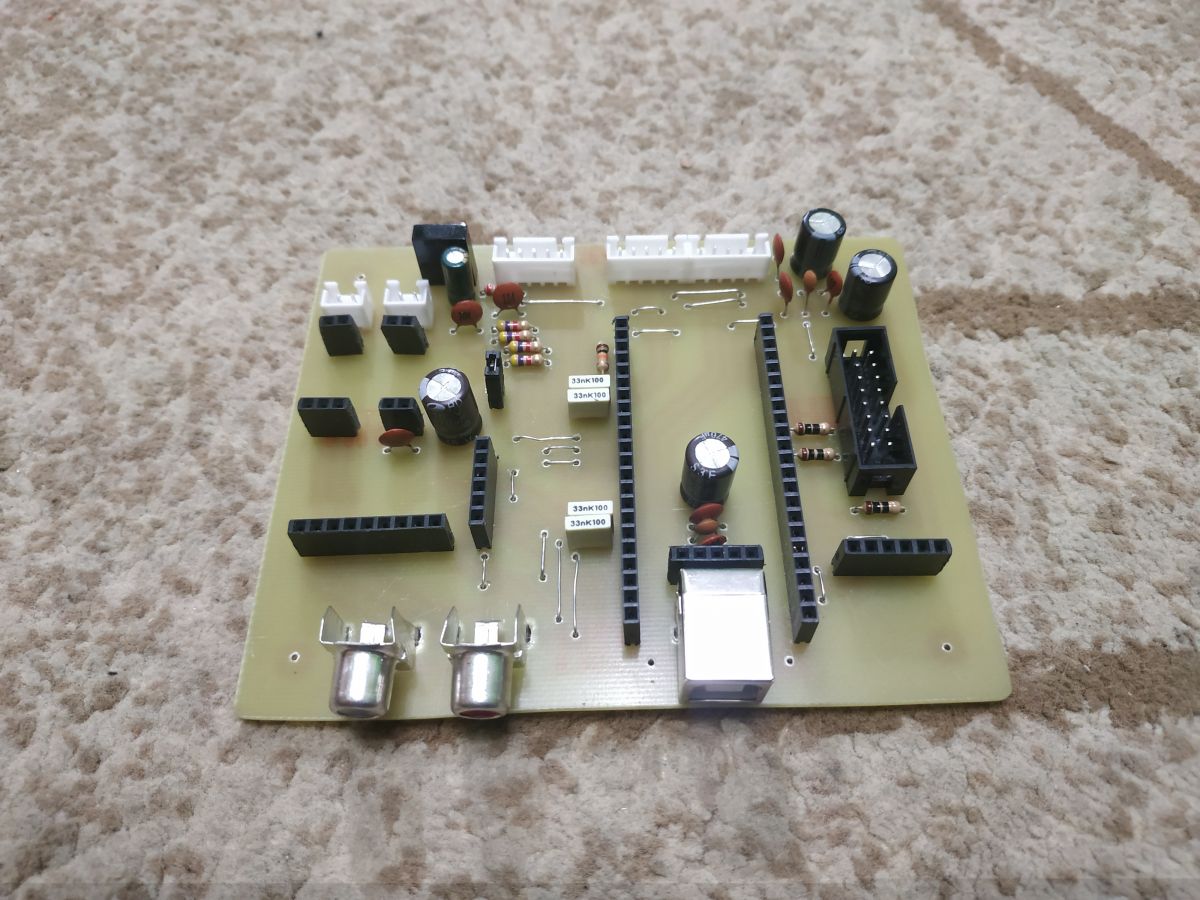

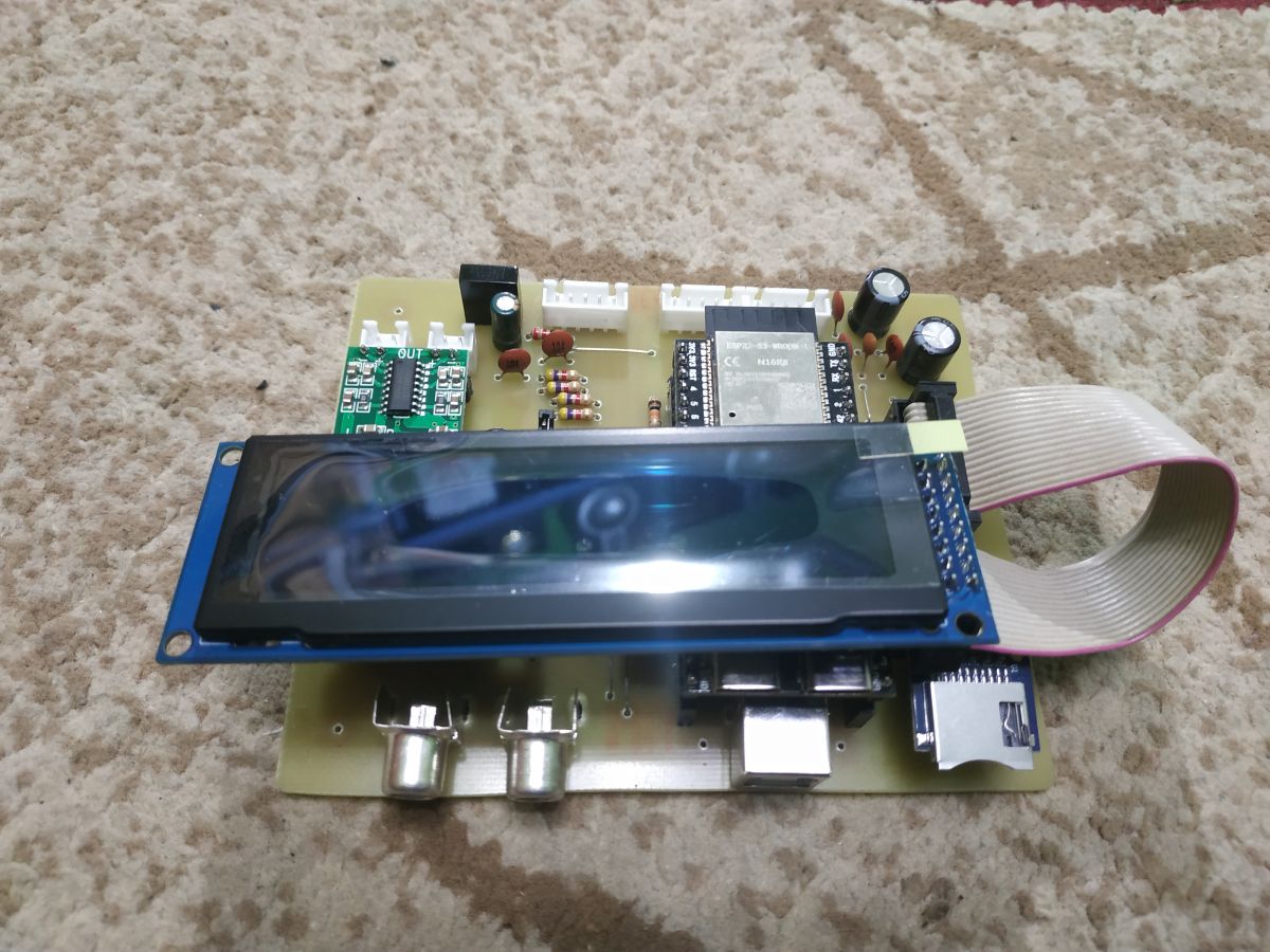

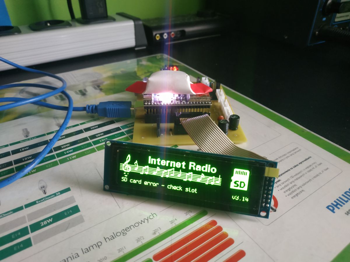

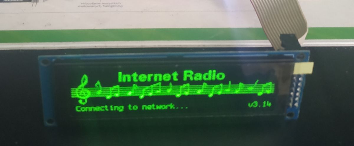

    A pensioner has built a radio from my PCB.
    PCB board with mounted electronic components. .
    View of a custom-built radio on a PCB. .
    DIY radio on a PCB with a display and connectors. .
    And it even started up 😀
    Radio built from PCB with Internet Radio display.
    DIY internet radio with a display connected to a PCB.

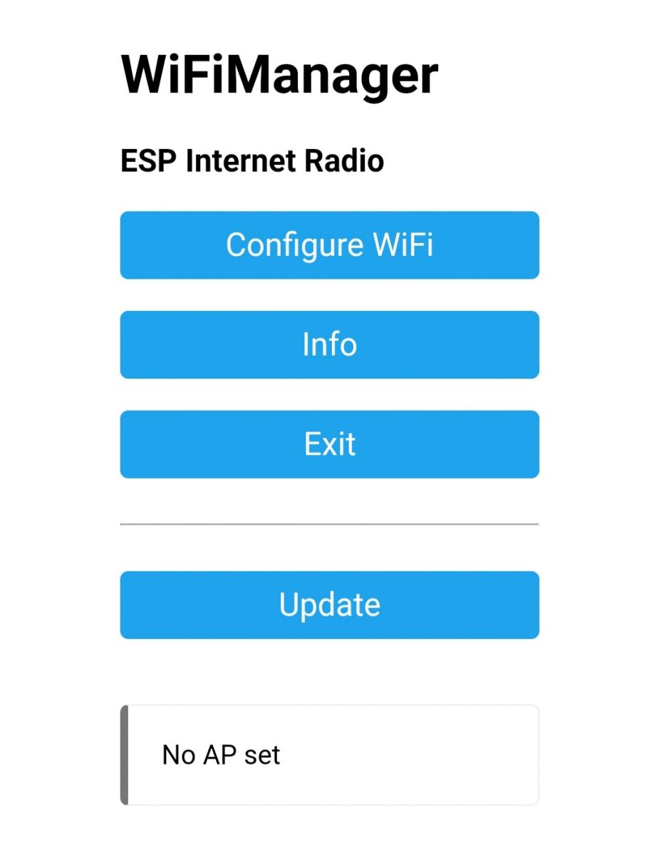

    And now how to run it further.
    I have no experience with WiFi networks
    So please help (just like a cow on a ditch please)
    I don't have WiFi at home ie a router running 24 hours a day but I can share from my phone for radio listening and my computer.
    When I'm using my laptop and I'm on the net this is how I share the net.
    Now, how do I set up this radio for the first time, i.e. connect to my phone with a hotspot, i.e. network name and password and so I can play with it.
    Maybe the questions are layman's but I have no knowledge of WiFi
    Greetings and would appreciate your help.
    PS. The display is glowing beautifully.
    And also a question how to disable this big diode, is there such a jumper RGB it is enough to unsolder. Or desolder the diode ?
    Or is it possible to disable it by software ? Do you also have this ?
    So far I have been running without encoder the robgold soft and tsop31238 receiver installed on the PCB.
    Fellow robgold it looks beautiful in the case 😀.
    Question what is/will the SV2 3pin connector be for ?
    The keyboard at my place will not be useful remote control operation but for your version it will be like a factory.
    Greetings ...

  • WiFi setup via phone hotspot and encoder pin fix
    #537 21433441
    DJCheester
    Level 28  
    Posts: 2089
    Help: 75
    Rate: 958
    robgold wrote:
    @DJCheester
    You set up a WiFi router on your phone. This you already know from what you write how to do. You then search for a WiFi network called ESP32 Radio and connect to it. This is where the phone will 'rebel' that this network doesn't have internet and ask you to connect - yes, connect. You then open a browser and go to 192.168.4.1, as shown in the display. There is already a page there where you have to select your WiFi network (that is, in your case, the router created by your phone) and enter the password. You give "save" and manually have to reboot the module. Unplug its power supply or press the reset button.
    It worked out very nicely. You must have worked a bit hard to get it to work. Upload the Eagel files somewhere.
    SV2 is the IR receiver connector - GPIO15.
    Hi I will attach the eagle files in the topic because I don't have Github.
    For the time being I want to get this radio working first.
    And I already caught one mistake i.e. swapped pins CLK and DT i.e. GPIO / for now I swapped them in the sketch and the encoder works eventually I will change the PCB
    And now the effects I managed to connect to the ESP32 Radio network and there I typed in the Redmi SSID (that's the name of my network - it's not in the list because the phone can either work as a router or a hotspot together no) and Password I typed in the access password and clicked SAVE
    - it appeared on the next page saved
    and already satisfied I switch to the hotspot and nothing I reset the radio and will attach pictures and screenshots of what is happening from the phone shortly.
    meanwhile on the serial monitor with the ESP connected to the computer I get the log
    And on the display I see first a graphic then connected and loading stream and it hangs like this
    As for the PCB was a bit of fun drilling and soldering, but the important thing is that something is working so far, I hope that today with your help I will be able to start the radio.
    Please help and best regards ...
    What I am doing wrong
    Added after 8 [minutes]:
    First, at the address given on the OLED was
    WiFiManager interface for ESP Internet Radio with configuration options.
    I clicked the wifi jam
    WiFi configuration form with SSID and password fields.
    After which my network was not there because I was in wifi mode with my phone and not hotspot mode so I typed in the network name and password.
    I clicked Dave and on the newly opened page it showed saved
    After a reset it was
    OLED screen displaying Internet Radio with green text Connecting to network and musical notes. .
    OLED display showing Internet Radio message and IP address 192.168.43.156. .
    Display showing Loading stream... .
    Please let me know what I am doing wrong or what I have done wrong.
    Greetings ...
  • Load Bank 01 from network on fresh SD card
    #538 21433468
    robgold
    Posts: 726
    Help: 10
    Rate: 290
    Since you don't have the files on the card then do this "trick" press the encoder to go to bank selection, or on the remote select the bank menu and load Bank 01 from the network.
    I suspect you are stuck in a loop where the radio has connected but there is nowhere to download the stream from. I need to check this recently I tested the WiFi manager itself hard on a trip to make sure it always works correctly but the situation, with a fresh SD card I can see still needs further checking.
    Additionally, check that your phone is not blocking the connection in some way or requiring approval. I don't know how the Redmi does hotspot.
    I tested it on a Samsung and it goes through without a problem.
    What I always say is that the prototype called "sample A" and the software needs testing :) .
  • Requesting SD card file loading via computer
    #539 21433480
    DJCheester
    Level 28  
    Posts: 2089
    Help: 75
    Rate: 958
    Hello I don't have the remote configured yet this will be the next stage.
    Normally I have only connected to my hotspot once now when it is on it hangs on connecting and thats it and when I turn it off it goes to IP
    Then by holding the encoder longer I enter the bank
    Display showing the text BANK 1 with a progress bar on a green background.
    But it doesn't pull anything then it's just this
    Electronic display with the text 01, Hz bit Kbps, and Bank 01.
    Is there no way to download these files to the card via the computer so that they are already there?
    Greetings ...
  • No internet connection prevents NTP clock sync
    #540 21433485
    robgold
    Posts: 726
    Help: 10
    Rate: 290
    Of course it is. Here you have the bank files: https://github.com/dzikakuna/ESP32_radio_streams
    For this you need to create two txt files. One called station_nr.txt the other called bank_nr.txt in bank type in 1 and only that and in station_nr type in 4.
    One specifies the station the radio should start on and the other the bank. The station is Italo4You. It is the only station with a very reliable stream and allows the client to buffer as much as 230kB.
    bank_n..txt (3 bytes)You must be logged in to download this attachment. .
    station...txt (4 bytes)You must be logged in to download this attachment. .
    bank01.txt (8.43 kB)You must be logged in to download this attachment.
    To me it looks like you have no connection to the net. Yes, the router on your phone has assigned you an IP because the router mechanism works, but you have no internet. If you had internet, you would see the clock, which is taken from the NTP server.
    const char *ntpServer1 = "pool.ntp.org";
    const char *ntpServer2 = "time.nist.gov";
