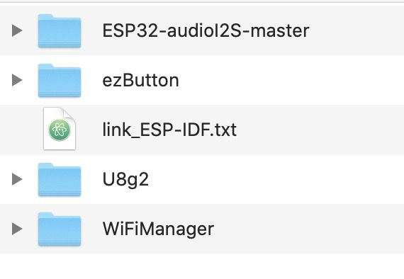

  • Need to copy three files to the SD card root

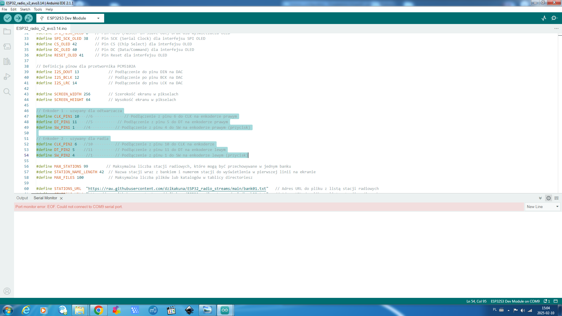

    Hello, mobile data is on, so the net should be there, so I understand that I have to put these three files on the main directory of the card?
    Tell me because on arduino 1.8.19 I have serial monitor from this board and here on 64bit on 2.1.1 IDE I have this
    Screenshot of Arduino IDE software with program code for ESP32 module. .
    I am now uploading the 3.15 version.
    After uploading via arduino soft, do I have to assign the access point again from the beginning or not ?
    Greetings ...

    The Arduino sometimes has its "freaks" when it comes to the serial monitor. You have to shut it down completely and fire it up again. Unfortunately. Such is the "super" environment.
    When it comes to WiFi settings and programming, it all depends if you have the option set: "Erase all Flash....."
    If Enable then unfortunately yes. Disable this option then all WiFi settings will remain.
    Screenshot of Arduino settings with Erase All Flash Before Sketch Upload set to Disabled. .

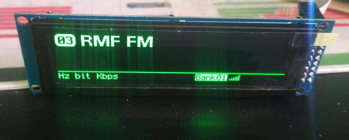

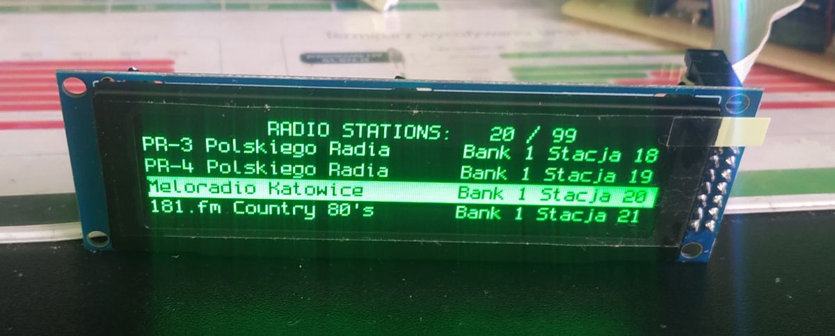

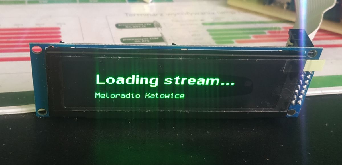

    I have uploaded V3.15
    LCD display showing RMF FM on channel 03 .
    LCD screen displaying a list of radio stations. .
    LCD display showing Loading stream... Meloradio Katowice. .
    Banks reads from sd connects but seems to not download data.
    This is strange because the hotspot connected to the computer normally shares the net.
    I'll try clearing and uploading again later with the access point setting.
    For now, thanks and best regards....

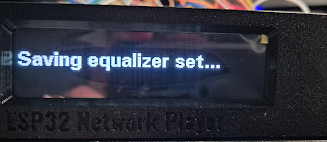

    As part of today's "fun moment", I added a function that saves the Equalizer settings to an "equalizer.txt" file.
    The file is read at startup. If it is not on the SD card then the filter values will be set to 0.
    Updated v3.15 file on GitHub.
    To save the filter settings, while in the Equalizer menu after setting the filters, confirm them with the OK/ENT button on the remote control. We will then get a message on the display. Otherwise, we will change the settings, but after restarting the radio we will read the previously saved ones or, in the absence of a file, the values 0,0,0.
    Screen displaying Saving equalizer set... message on an ESP32 Network Player device. .

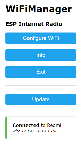

  • Antenna touch reveals ESP32-S3 Wi-Fi issue
    #548 21433838
    DJCheester
    Level 28  
    Posts: 2089
    Help: 75
    Rate: 958
    Well that's the problem, after touching the antenna it shows up on the phone and on the computer, I did that from the phone I permanently let the hotspot go and on the computer I connected to the ESP and set up the access point (holding the antenna of course) and immediately it showed up.
    WiFiManager interface for ESP Internet Radio with buttons Configure WiFi, Info, Exit, Update and information about connection to Redmi. .
    Radio mastered game thank you all project great - now I have to put the toy away for a week or so (but good thing it's up and running).

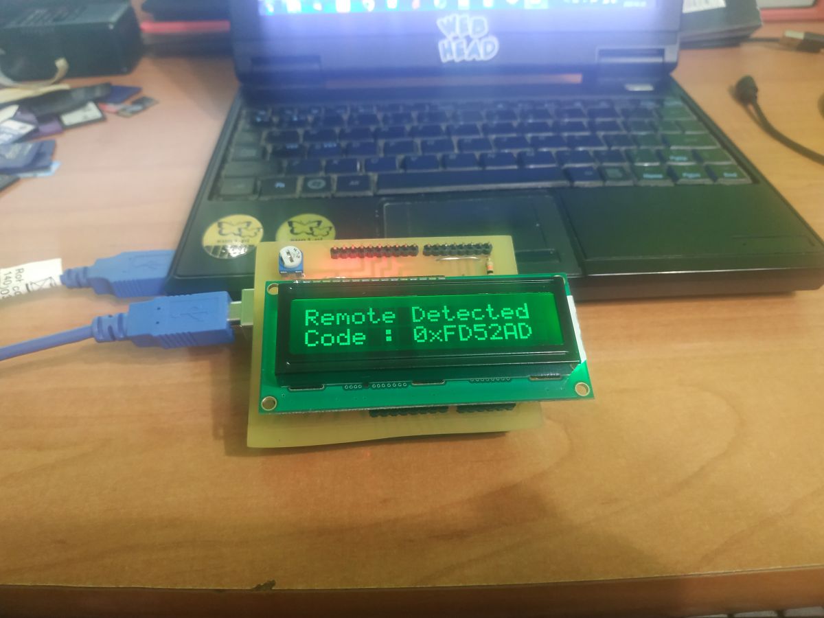

    As I have you on the links I will ask about the remote.
    I once made myself such a remote control tester on an Arduino UNO
    It displays the code like this
    Display showing remote code 0xFD52AD against a laptop background. .
    On the serial monitor I have some more info see in a moment I will add
    How does this relate to your codes written in the script ?

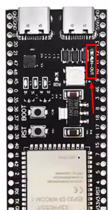

  • Unsoldered jumper disables 5V output on module
    #551 21433904
    robgold
    Posts: 726
    Help: 10
    Rate: 290
    At the top of the module near USB-OTG you have a jumper unsoldered. This is why 5V does not come out of the module with a pin.
    Electronic module with an unconnected USB-OTG jumper highlighted. .
    Code 0xFD52AD is a code let's call it in "RAW" format. You see the reading in LSB-MSB form along with bytes in negation for packet control.
    At the terminal the Radio sends all the information. Here an example: 9D6228D7 is what you see in your tester. Then you have the inverted bytes to MSB-LSB and the address and command cut out.
    NEC code OK:9D6228D7 MSB-LSB: EB1446B9 ADR:B9 CMD:14
    debug-- pulse 9ms:8986 4.5ms:4575 1690us:1691 690us:598

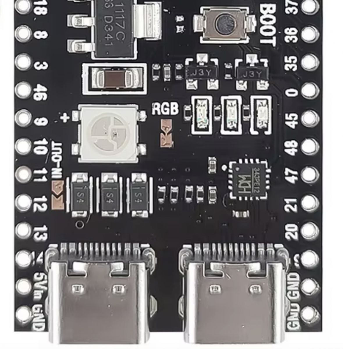

    Well, I didn't know that (anyway, as I wrote, I've seen ESP32 for the first time).
    And tell me if it is possible to read my codes from the remote control so that they match the radio (rewrite them or write them differently)
    And that big RGB diode or RGB jumper, if I unsolder it on the module, it will not burn my eyes ;)
    Thank you ;)

  • Clarifying RGB jumper, reset, and boot buttons
    #554 21433950
    DJCheester
    Level 28  
    Posts: 2089
    Help: 75
    Rate: 958
    O ingenious 😀
    It's on to the next sitting, the important thing is that there is progress, and lots of it.
    It's still as if you could tell if the jumper on the ESP named RGB is from the diode the big one ?
    And the rst button is known reset and what does boot do ?
    Sorry for the layman questions 😀
    No more tests for today because my finger is already stiff - I'm ordering a second ESP
    Regards...

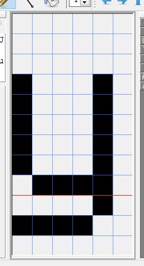

  • #555 21433967
    MAJSTER XXL
    Posts: 2064
    Help: 164
    Rate: 429
    @robgold could you correct the lowercase "y" so that its bottom is raised by one row of pixels, i.e. so that it fits like the lowercase "g" ?
  • Font data dump for ESP32-S3 display output
    #556 21434061
    robgold
    Posts: 726
    Help: 10
    Rate: 290
    Do you have similar observations to mine ? Apparently as many as 256x64 pixels and in reality every line is worth its weight in gold :)
    Code: C / C++
    Example of font at 256x64 pixel resolution .
  • Cut RGB jumper trace to disable onboard diode
    #557 21434067
    wirbud
    Posts: 65
    Rate: 16
    DJCheester wrote:
    Well, that big RGB diode or RGB jumper if I unsolder it on the module it won't burn my eyes
    next to the diode is where the 2 pads are (RGB) but this time there is a thread of print between them. To turn the diode off just cut this thread. You can always put a blob of tin and the dida can burn your eyes out again! (I tried in yoRadio to put it out, four GPIO ardes I used and it still lit up after a few seconds. )
    Circuit board with electronic components, including an RGB LED and two USB-C ports. .
  • #558 21434072
    robgold
    Posts: 726
    Help: 10
    Rate: 290
    The situation with the diode is interesting. It seemed to me that in ESP32 S3 devkit1 this diode is a digital diode that requires whole commands to be sent to it to make it light up (at least that's how it is with me). It should go off after the flash is wiped. And here it comes out as if it were a regular RGB zipped to the GPIO.
  • #560 21434102

    robgold wrote:
    it looks like it would be a regular RGB zipped to GPIO.
    Unplug the power supply, it has to go off because these are WS2812Bs.
    If you don't unplug then the diode is simply "latched".

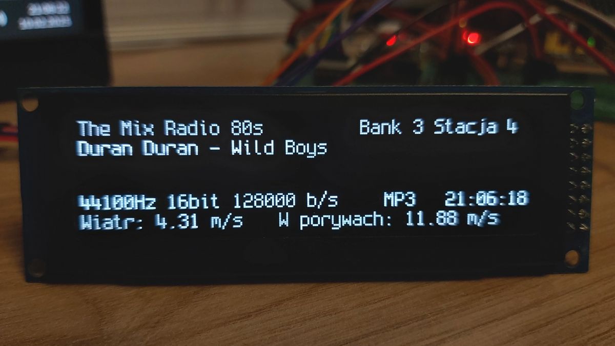

    @robgold beautifully, the question is whether any of the characters still stand up or down too much and ooze onto the adjacent lines? I think it was just the little 'y' that was too lowered.
    LCD display showing information about a radio station and wind conditions. .
  • #563 21434129
    robgold
    Posts: 726
    Help: 10
    Rate: 290
    @MAJSTER XXL, I've looked at the whole font. I think it's just the letters q,p - vertical dashes.

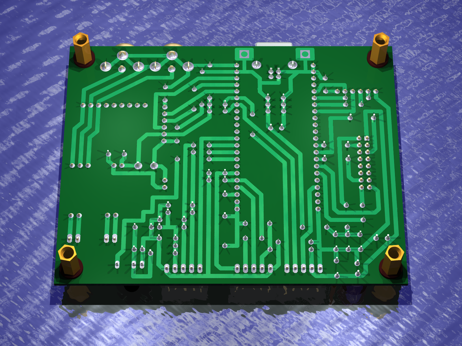

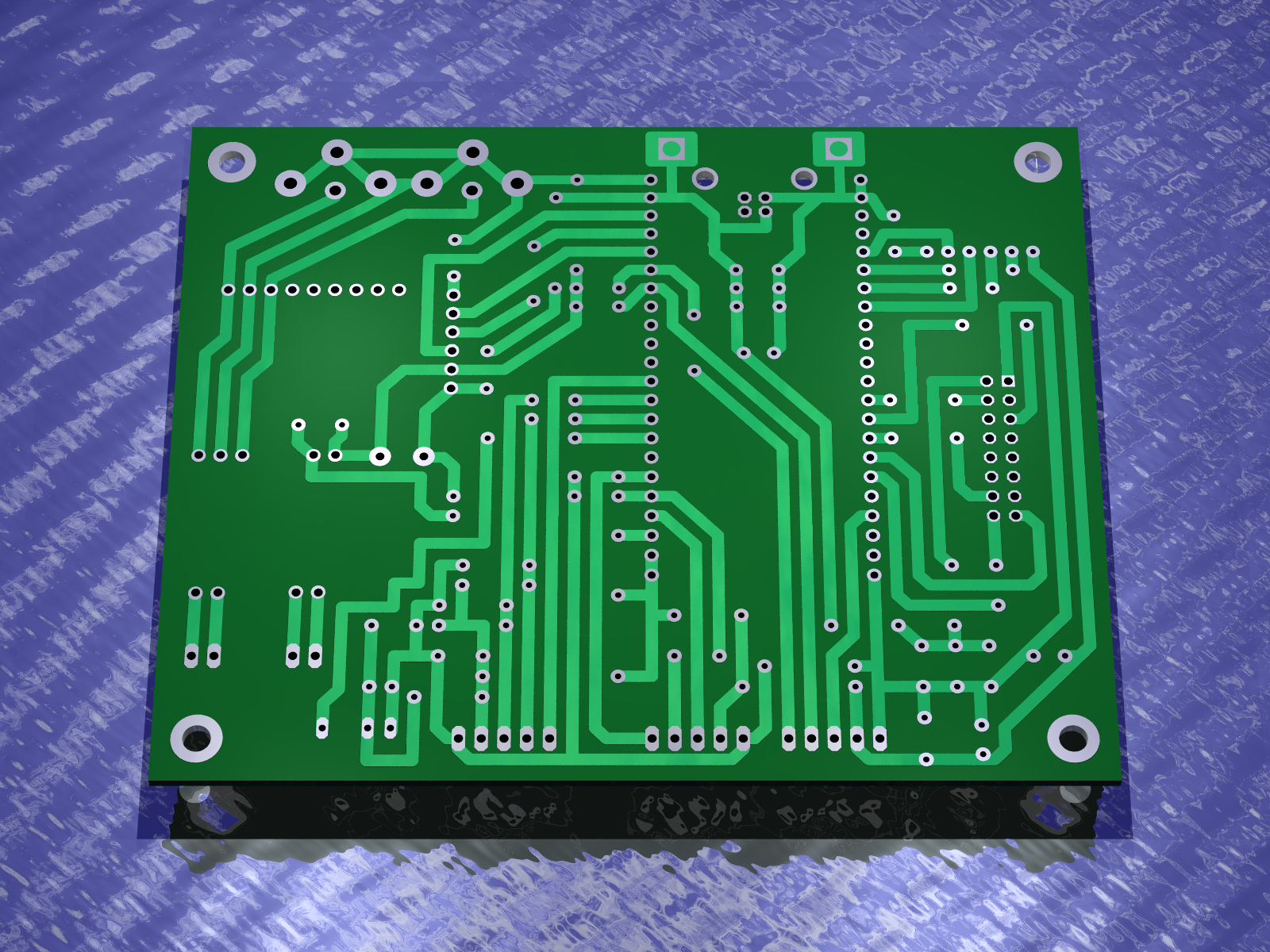

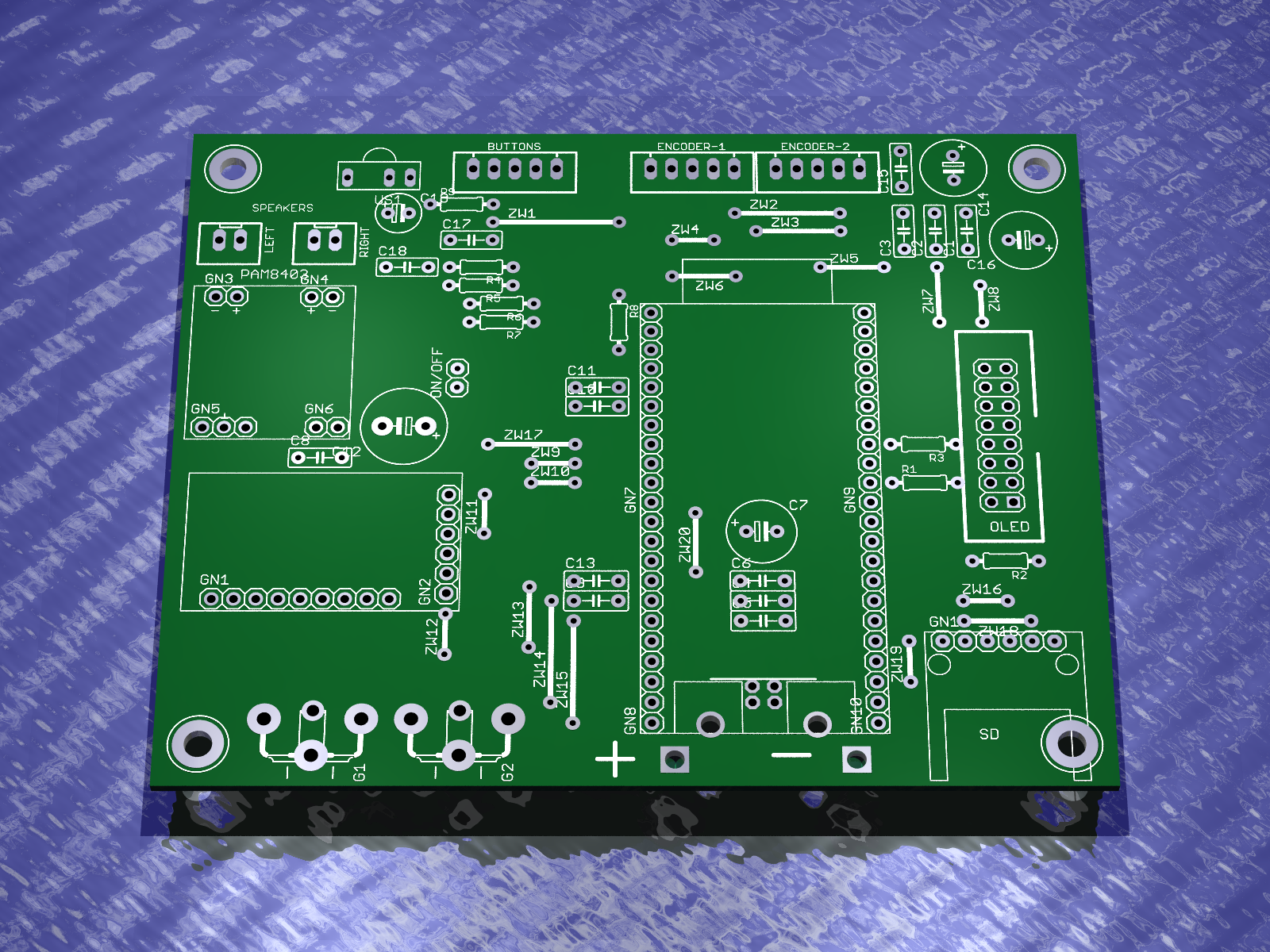

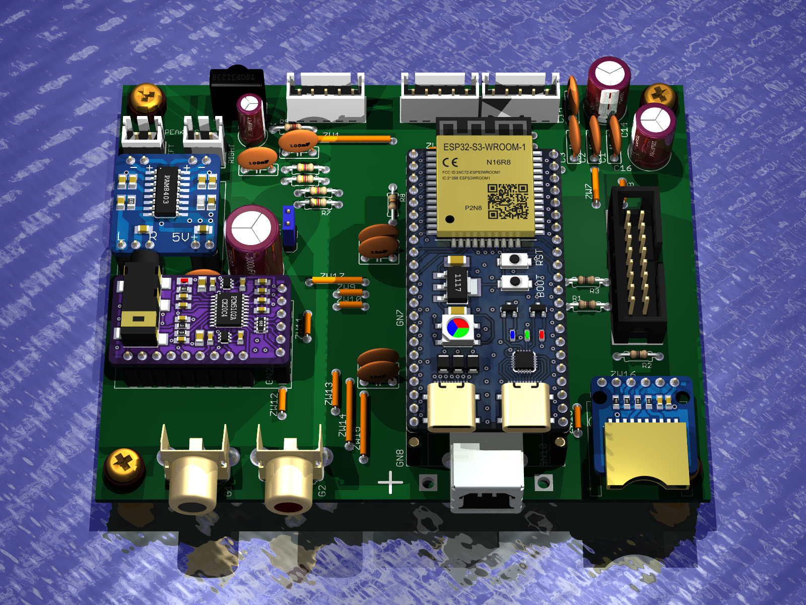

  • PCB files released for ESP32-S3 radio player
    #565 21434558
    DJCheester
    Level 28  
    Posts: 2089
    Help: 75
    Rate: 958
    Welcome ;) .
    As promised I am making my PCB design files available
    PCB design with ESP32-S3-WROOM-1 module and JST connectors.
    Visualization of a single-sided PCB with green laminate and copper traces. .
    PCB design with various connectors and components .
    Printed circuit board design with green laminate and white tracks. .
    The board for software by friend robgold v3.14 (v3.15 will also work, but there is no keypad connector as of v3.15). The board should also work with author's software MAJSTER XXL (I have not tested it) has JST slots for second encoder and keypad used in this software.
    A jumper on the PCB powers the PAM8403 amplifier.
    Robgold soft running with the help of a colleague (thank you for your support)
    On PCB corrected connections (as declared in the software)
    Radio plays and starts after correct ESP programming and configuration.
    NOTE: Not tested remote control for now - lack of time probably will run this further on Saturday.
    If someone would like to order a ready-to-use board from a company, the pads in RCA connectors should be corrected (I will do it as soon as I find a moment after the radio is fully operational) There are round pads and there should be oblong ones (I had such a library)
    In the case of thermo-transfer and making the board by yourself (one-sided), the type of pads does not affect the assembly, because you can re-drill the holes to longitudinal ones (in the case of ready-made boards from China with metallized holes, it would be useful to do it the way you need)
    A pdf file ready for thermal transfer is also included in the package.
    Best regards....

  • Removing duplicate Espressif libraries fixed compilation
    #566 21435162
    wirbud
    Posts: 65
    Rate: 16
    To colleagues with compilation problems..... Yesterday I made the enty attempt to compile. As described by robgold - (ver 3.15) - I placed the libraries from the directory in the Libraries directory in Arduino (not Arduino15). As usual, there was a rash of errors. I came up with the idea that since it was bothered by duplicate libraries I removed from the sketches directory all those that had their versions installed by Espressif 2.0.17 (in the Arduino15 directory). Shot in 10. Compilation without error !
    So much should be left in /Arduino/Libraries
    List of directories in the Libraries folder for Arduino. .

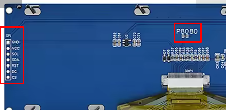

    The question I have is if I want to go crazy and buy such a larger OLED for this radio
    https://pl.aliexpress.com/item/1005006861743547.html
    Here on the back there are no jumpers on how to set the data bus in 3.12 you soldered a resistor on 4SPI
    https://ae01.alicdn.com/kf/Sad9d8069f69e47cd81331791955ccb9c3.jpg_960x960.jpg
    And how to do it here ?
    Do you have any information because it is a shame to risk 200PLN if it turns out that it will not work ?
    Greetings ...
  • #568 21435328
    robgold
    Posts: 726
    Help: 10
    Rate: 290
    On the back as far as I can see you have a jumper called 8080, the SPI connector on the left. Presumably when you unsolder this jumper it goes into SPI mode.
    The driver is the same, it should work without any software changes. Someone here already asked about this display and was about to order it. Look for it in this thread.
    Close-up of the back side of a display circuit board with highlighted SPI connector and P8080 jumper. .
  • #569 21435335
    DJCheester
    Level 28  
    Posts: 2089
    Help: 75
    Rate: 958
    That was me, I asked 😀
    Only at the time I didn't yet know about the configuration on display....
    I preferred to ask.
    Thanks and best regards...
