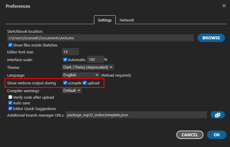

  • #1420 21728718
    robgold
    Posts: 698
    Help: 10
    Rate: 284
    >>21728715 If previous versions of "Evo" compiled correctly then there are no changes in 3.18.21 where you would need to use other libraries.
    Turn on your compile display options and throw in what you are stuck on.
    Arduino settings window with verbose output enabled for compile and upload

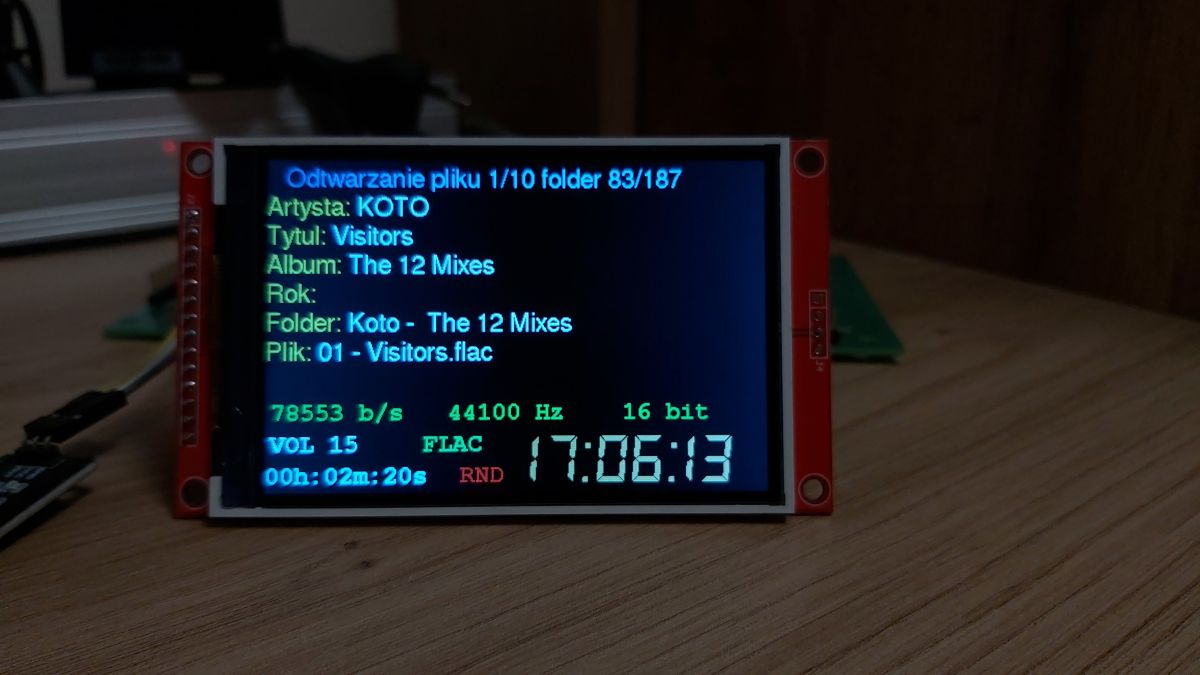

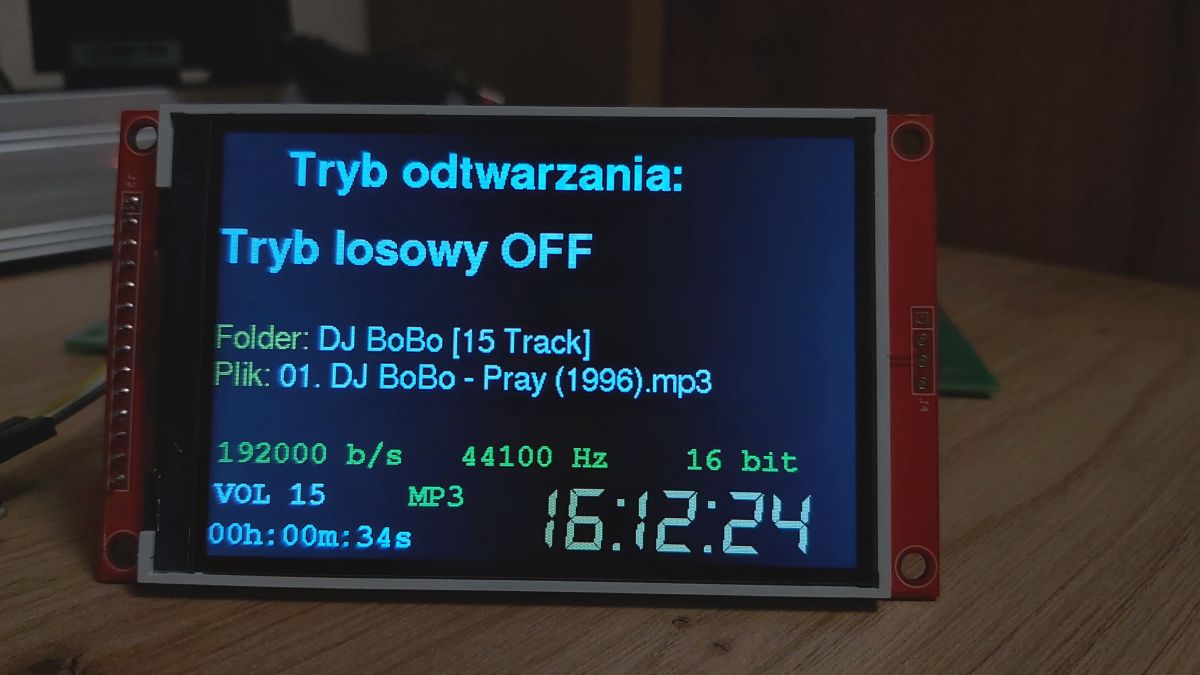

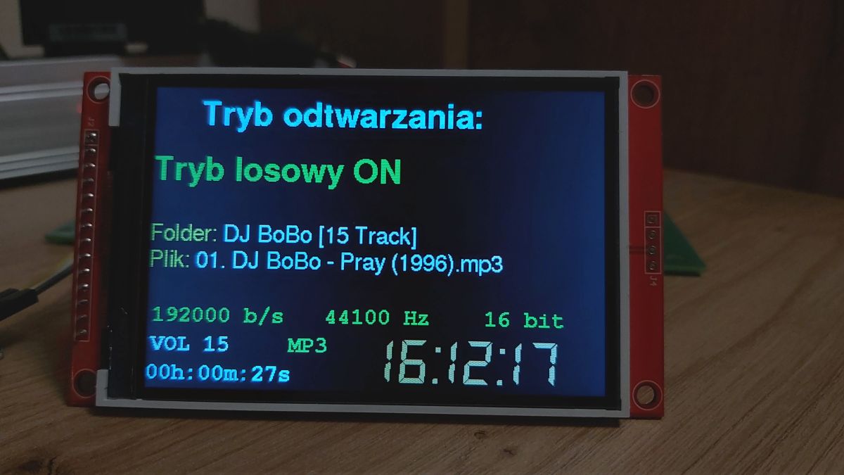

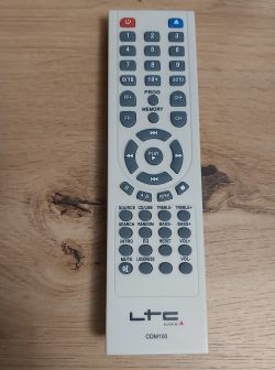

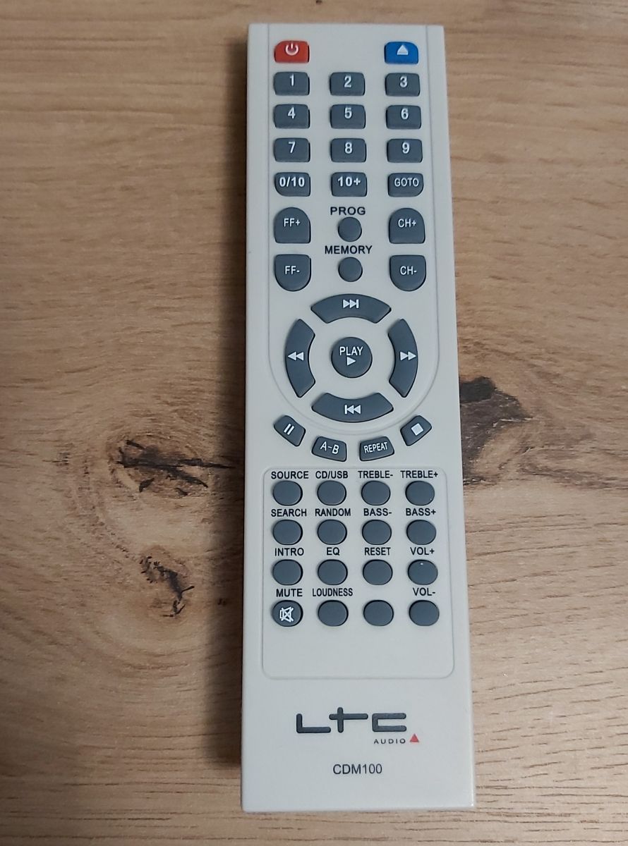

  • #1428 21732297
    MAJSTER XXL
    Posts: 2063
    Help: 164
    Rate: 421
    However, in my v3 version with the colour screen, a function has been added to enable random playback of files from a given folder. Each file is played once from the entire contents of the audio files in that folder until the files run out. The function uses a static usedIndices vector which stores the file numbers already drawn. When all the files in the directory have already been used, it clears the list and starts the draw again. This ensures that no songs are repeated until they have all been played. I just need to think about putting a symbol next to the file player timer to indicate that the shuffle mode is active.
    I used an extra button on the remote control, which even had the name RANDOM, you have to assign a new extra button and give its code in line:
    Code: C / C++
    In general, I have moved the entire file player and its support to FilePlayer.cpp and FilePlayer.h :
    https://github.com/sarunia/ESP32_internet_radio_v3/tree/main/ESP32_radio_v3_ILI9488_canvas
    Color screen of ESP32 showing active MP3 random playback mode
    Color screen on ESP32 showing audio file data and playback mode
    Some time ago I assigned myself this remote control from the photo below, which I had left over from some microwave from my wife's beauty salon. It is even created with these buttons to operate from our project:
    LTC AUDIO CDM100 remote with RANDOM button for shuffle playback function
    edit. I've added a red "RND" to the right of the clock of the audio file being played when random is enabled:
    Color ESP32 screen showing audio file details and active random playback mode
