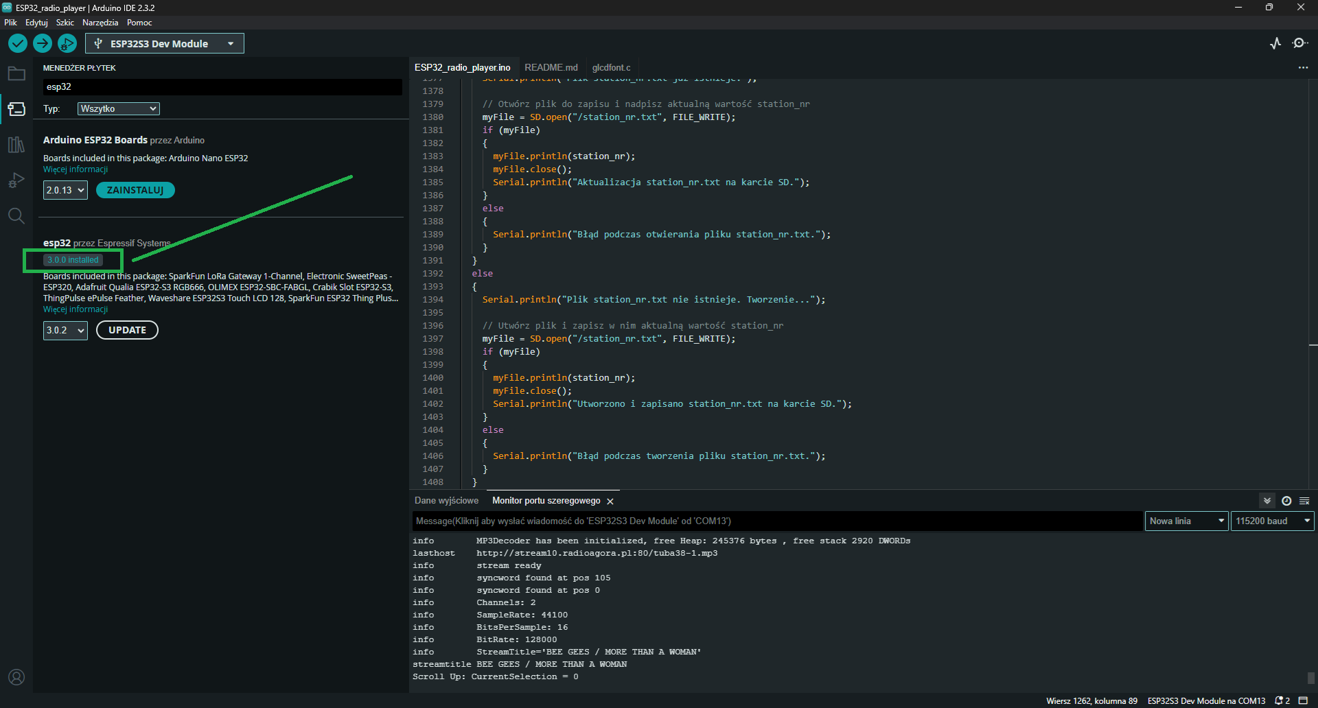

  • Rolling back ESP32 board manager fixed station list downloads
    #126 21152949
    MAJSTER XXL
    Posts: 2064
    Help: 164
    Rate: 429
    I don't know if any users have had problems downloading a complete list of stations from each bank, but I noticed that after updating the ESP32 board manager from Espressif it was only downloading a few dozen links from each bank. I rewrote a lot of things in the code and there was still no stopping point, until finally I decided to roll back the version to the one highlighted in the screen shot below and it finally started downloading the complete data. I have no idea why this is happening- I checked on 2 different ESP32 S3 chips.
    Screenshot of Arduino IDE showing board manager and code for ESP32. .
    Regarding the encoders themselves, the one for station selection from the scrolling list I already had to replace with a new one - it was just going crazy, after replacing it is quite stable, but not perfect either. I also have no idea how to improve it, because e.g. during fast forwarding it can sometimes go back one position when stopping the wheel movement.

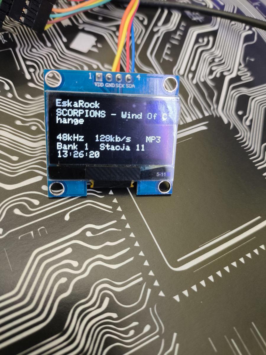

  • #128 21160404
    hevet
    Posts: 347
    Rate: 47
    I tidied up a bit on the display, blew out the bits, changed the values to kHz and kB/s.

  • WiFiManager byte conflict with ESP32 core 3.0.4
    #129 21183432
    SP4SR
    Posts: 127
    Help: 12
    Rate: 11
    Someone changed something and now it won't compile
    In file included from C:\Users\Amigos\Documents\Arduino\ESP32_radio_player1\ESP32_radio_player1.ino:12:
    c:\Users\Amigos\Documents\Arduino\libraries\WiFiManager/WiFiManager.h:536:11: error: reference to 'byte' is ambiguous
      536 |     const byte    DNS_PORT                = 53;
    In file included from c:\users\amigos\appdata\local\arduino15\packages\esp32\tools\esp-xs3\2302\xtensa-esp32s3-elf\include\c++\12.2.0\cmath:42,
                     from c:\users\amigos\appdata\local\arduino15\packages\esp32\tools\esp-xs3\2302\xtensa-esp32s3-elf\include\c++\12.2.0\math.h:36,
                     from C:\Users\Amigos\AppData\Local\Arduino15\packages\esp32\hardware\esp32\3.0.4\cores\esp32/esp32-hal.h:30,
                     from C:\Users\Amigos\AppData\Local\Arduino15\packages\esp32\hardware\esp32\3.0.4\cores\esp32/Arduino.h:36,
                     from C:\Users\Amigos\Documents\Arduino\ESP32_radio_player1\ESP32_radio_player1.ino:2:
    c:\users\amigos\appdata\local\arduino15\packages\esp32\tools\esp-xs3\2302\xtensa-esp32s3-elf\include\c++\12.2.0\bits\cpp_type_traits.h:406:30: note: candidates are: 'enum class std::byte'
      406 |   enum class byte : unsigned char;
    C:\Users\Amigos\AppData\Local\Arduino15\packages\esp32\hardware\esp32\3.0.4\cores\esp32/Arduino.h:149:17: note:                 'typedef uint8_t byte'
      149 | typedef uint8_t byte;
    exit status 1
    Compilation error: exit status 1
    can you help?
  • #130 21183571
    MAJSTER XXL
    Posts: 2064
    Help: 164
    Rate: 429
    @SP4SR Look for the WiFiManager.h file
    and on line 536 replace with:
    const uint8_t DNS_PORT = 53;
  • #131 21183655
    SP4SR
    Posts: 127
    Help: 12
    Rate: 11
    Thanks, it works!
    And how do I flip the screen as I have everything upside down?

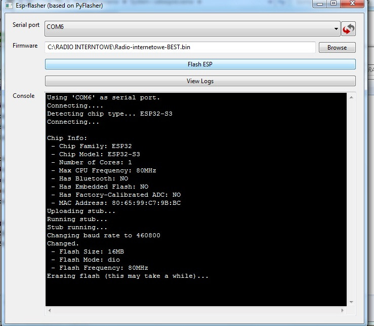

  • Ready-made ESP32-S3 BIN upload package provided
    #132 21188713
    futek2
    Level 19  
    Posts: 524
    Rate: 230
    Hello interested in the subject of building according to the concept and design developed by kol MAJSTER XXL for which a big word of praise.
    https://www.elektroda.pl/rtvforum/topic4041603.html#20998118
    Reading the posts related to this topic I noticed that a lot of problems appear with the compilation of the source code.
    I think, that the author of the project will not mind if I add to this information the ready BIN code to be uploaded to the ESP32S3 module - as used by the author of the project.
    The upload is very simple with the help of one of the attached programs and before that you have to install the drivers that support the USB port for the recognition of the ESP32S3 module.
    The attached file Radio-internet-BEST.zip is a compilation of the project without any interference in the source code.
    I think that this will contribute to greater interest in this project by colleagues. MAJSTER XXL , because only the electronic part will remain to be done by average electronics technician.
    Programs for uploading the software are usually very simple and before each upload delete the entire contents of the memory.
    The drivers are included with indication of CH343SER.ZIP and a picture of how the BIN file is uploaded.
    To give you an idea of the interest in this facility, I have added a minimum possible number of points for the download.
    Greetings and I wish you success and satisfaction with the internet radio, because the project made by colleague MAJSTER XXL is exactly worked out.

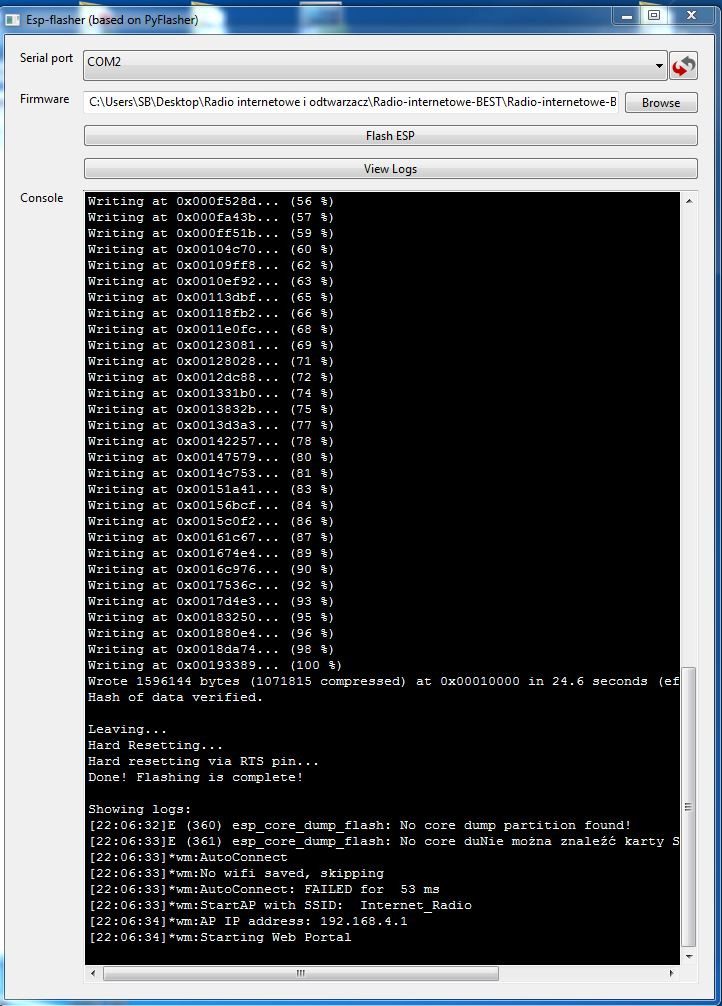

  • #133 21192033
    bolszoy
    Posts: 64
    Hi. I have no experience with ESP ele project I really liked it.
    Unfortunately the screen is completely black, although I can see the SSID Internet_Radio in the laptop.
    I would also like to know what is the IP address of this radio /I saw it but I remember where/.
    Congratulations on the ingenuity of the author. Greetings.
  • Setup steps for ESP32 AP WiFi configuration and reboot

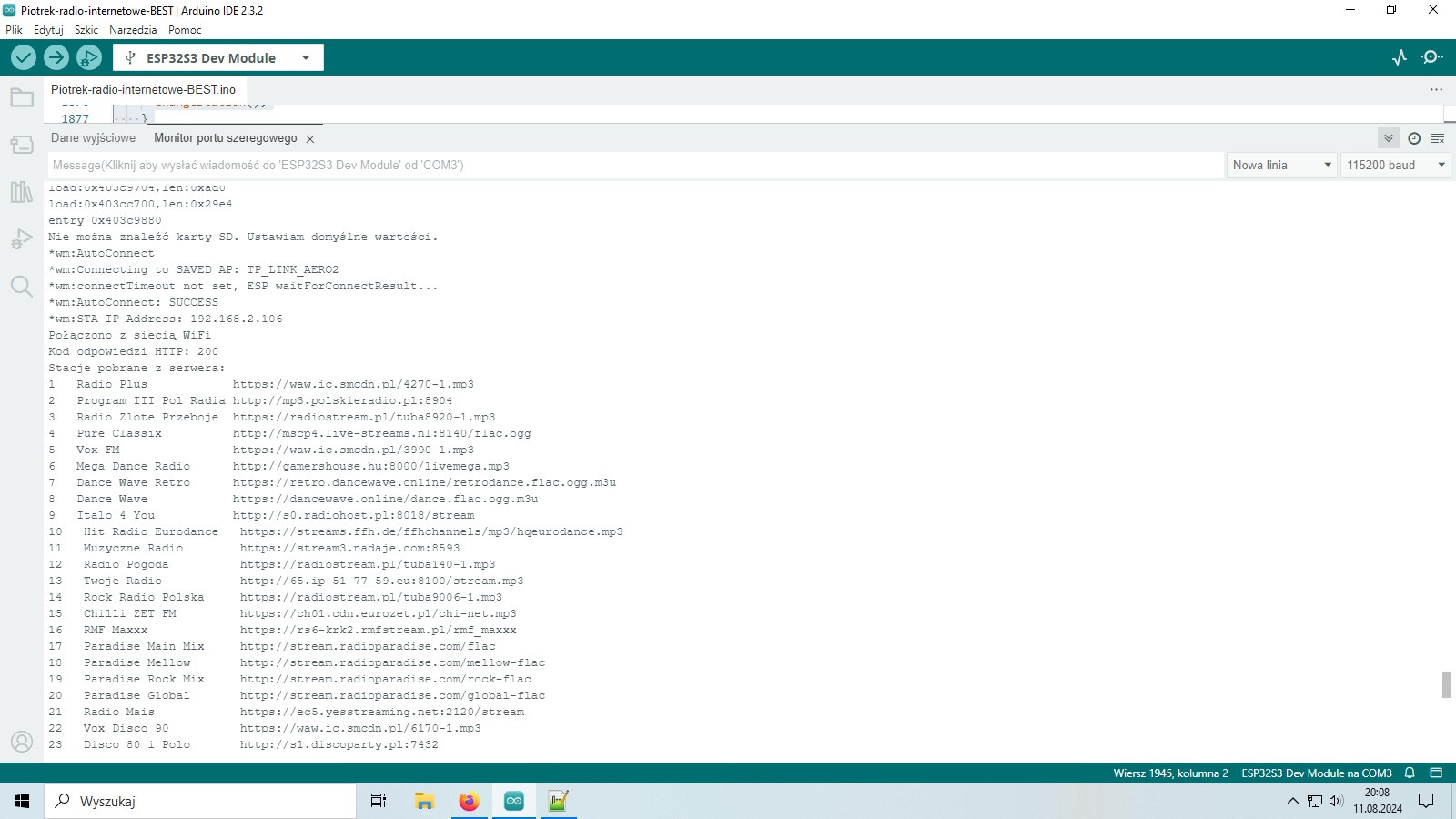

    #134 21192603
    futek2
    Level 19  
    Posts: 524
    Rate: 230
    Hi mate bolszoy .
    The first thing to do after uploading the software is to reboot the ESP32 and if you have WFI on your laptop then look for a new AP the name will be associated with the radio and connect and a browser should open and select log in and a page will be displayed with the setting of the password for your router. And if you have correctly selected the configuration, after the connection the radio stations appear. You will be able to see lite on the terminal preview. For me it worked from the first start. As for the dark display, maybe you have connected something wrong.
    The author of the project made everything ok.
    I think you will manage and enjoy.
    I would ask the author of the project to make a simpler version without the display and to control it via WIFI, because all you need is to add the code of the website with all the options for the selection of stations.
    IP address. 192.168.4.1 if something goes wrong with the configuration, you have to reload the software because then all the data stored in the ESP32 memory is deleted.
    This data is displayed shortly after uploading the software in the terminal window of the program with which you uploaded the software to ESP32.
    Kind regards
    Futek2

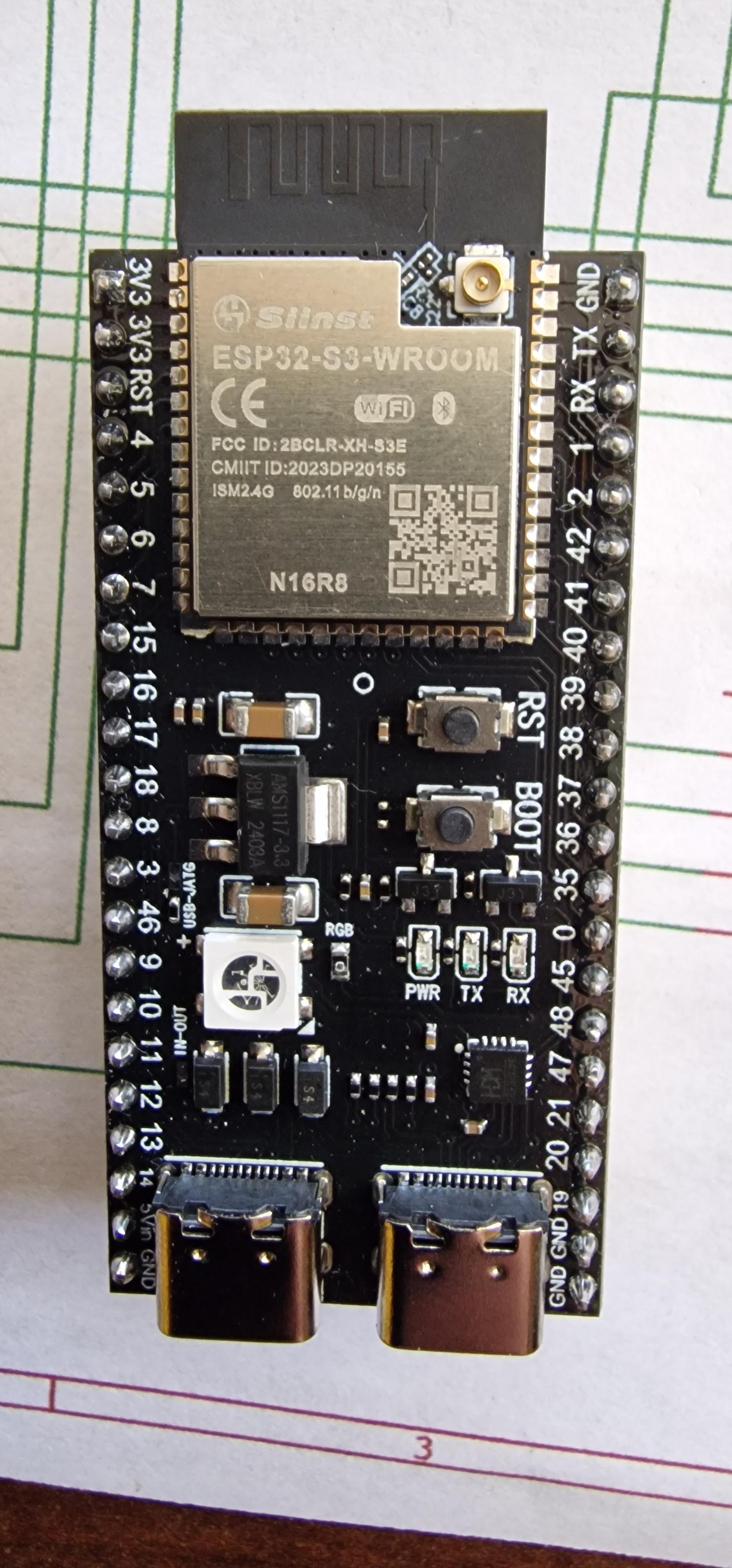

  • Problematic ESP32-S3 board pins RGB to SD MOSI
    #143 21193956
    bolszoy
    Posts: 64
    Hi. I already know for sure that I have a problematic board /actually two/, and a lot of people have problems connecting to WiFi on them.
    The .bin file itself is certainly uploaded well, while in my case, as in the case of my colleague Hevet, the RGB lights up because it is pinned to pin 38 /out 48/. And this pin is used for the SD card - MOSI.
    Therefore I need to buy another board, but I don't really know which one to look for. Could you please take a picture of your ESP32?
    Thank you for your help.

  • Compilation succeeds on Arduino IDE 2.3.2 Windows 10
    #144 21194045
    futek2
    Level 19  
    Posts: 524
    Rate: 230
    Here is a picture of my plate
    https://static.elektroda.pl/attach/560635D2-2A30-4C36-8F6C-9CA3B9A05239_7467576.jpeg
    I made the compilation in ARDUINO IDE 2.3.2 for WINDOWS 10 - 64bit.
    But all the biobibliotheques needed I installed from scratch and there was no problem with the compilation.
    If you think that there is a difference between the boards, it is necessary to make a fix for a different type of display in the source code, but it is good that the author does it, because he knows the project best.
    Futek2

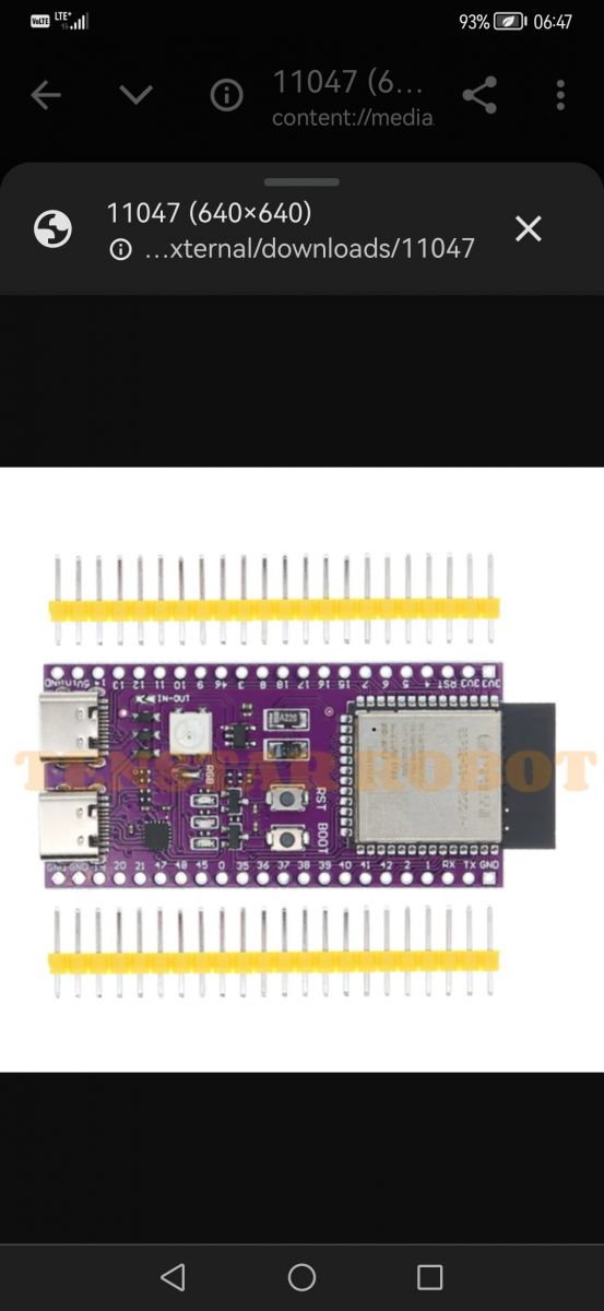

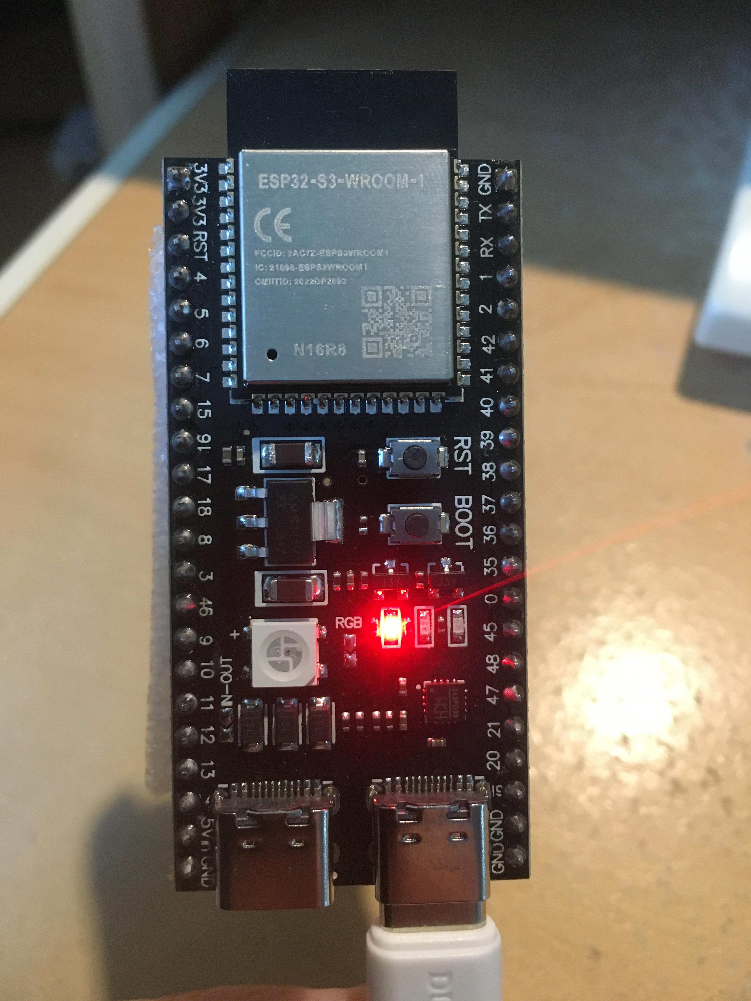

  • ESP32-S3-WROOM board variant may need code fix
    #145 21194071
    bolszoy
    Posts: 64
    "I did the compilation in ARDUINO IDE 2.3.2 for WINDOWS 10 - 64 bits.
    But I installed all the libraries needed from scratch and there was no problem with the compilation.
    If you think there is a difference between the boards, then a fix needs to be made for a different type of display in the source code, but it would be good for the author to do this, as he knows the project best."
    I agree with you. As far as the board is concerned, with me there is a difference only in the addendum "-1"
    ESP32-S3-WROOM. On many forums, users are having problems connecting to the network.
    The display itself is not a problem as I can buy a second one.
    Also, in your case the RGB does not light up after loading the .bin file
    Greetings and thank you for your patience.
    Added after 53 [minutes]:
    Here is my plate.
    qrna I looked at the picture of the packages 30 times and did not zatryby to enlarge the tiles.....

    Hello to the author of the project.
    As I indicated at the beginning ESP is my first contact. But it turned out that my OLED was inadequate. Fortunately I was able to on alli.... To find its schematic. After a little modification and connecting the display reset and ESP I have "internet radio". And that's the end of it. No response is given by the encoders or the buttons. And now I am puzzled by the fact, no Wi-Fi connection, and that nothing else happens.
    I have only the OLED, encoders and buttons connected, no reaction - the RGB lights up. By way of deduction, I have come to the conclusion that I have an ESP32-S2 WROOM-1U. The pinology is apparently the same, but it is somehow very resistant to co-operation.
    I've ordered the WROOM-1 board, and it will probably arrive around Tuesday. I'm curious to see if it will kick off. At most, others will know what to watch out for. But I wouldn't recommend buying an ESP32-S3 with an external antenna output. There are some problems with these boards, according to foreign forums.
    Thank you for your interest and best regards.
    Added after 11 [minutes]: .
    I have 4 meters to the router. also thought about getting another one, but not today.
    Here is my dump:[/tr].
    • Internet radio and audio file player on ESP32-S3 Wgranie pliku.JPG (179.29 KB) You must be logged in to download this attachment.

    To me, it could be that your WIFI channel is clogged. Because everything is uploading fine and the ESP32S3 is booting correctly from what you have shown in the attached
    picture.
    I'm positive you will get the radio working.
    Best regards
