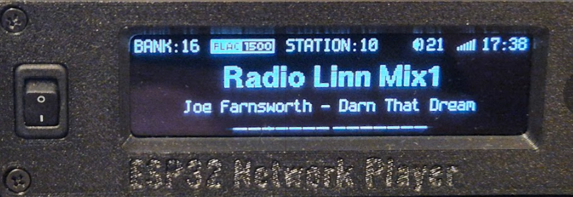

    i have uploaded to GitHub Dzikakuna version Evo 3.19.19
    Link
    What's new ?
    - improved bitrate reading for stations where the bitrate is calculated by the library (so-called estimated bitrate)
    - in displayMode 4 I added such a mini logo with information about the codec and bitrate
    - in the menu for displaying the list of stations, quick navigation has been added.
    Now, pressing the right and left arrows jumps by 5 stations. The up/down arrows switch by +/- one station as before.
    - the function of switching the radio on/off from the remote control, so called POWER OFF/ON, has appeared.
    In this mode, under the rcCmdRed button (eventually there will be a dedicated code rcCmdPwr) Pressing the button once, the radio goes into Standby mode, the ESP32 goes into light sleep mode minimising current consumption (on a mini USB meter it is 0.00mA). To wake up the radio press the rcCmdRed button (red handset on the RC-406) 2x at an interval of less than 0.5sec. The first pulse wakes up the ESP32 and the second pulse is only read correctly in the interrupts and the button code is checked. If the code is correct, the radio displays POWER ON and then performs a reset and starts. If the code is wrong the radio immediately goes to sleep without showing anything on the display. Eventually this will be linked to a standby LED and a transistor to cut off the card, display, PCMa, possibly other peripherals.
    ESP32 display showing Radio Linn Mix1 station and Joe Farnsworth track playing.

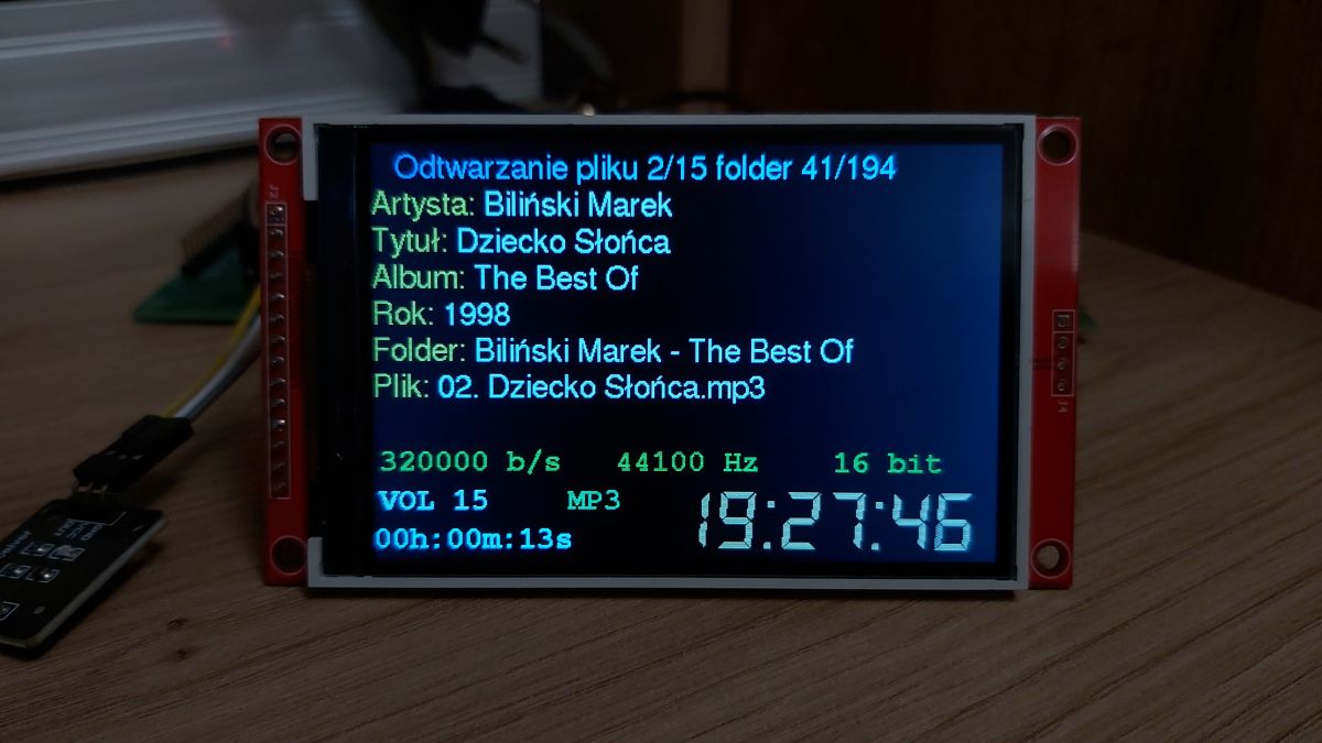

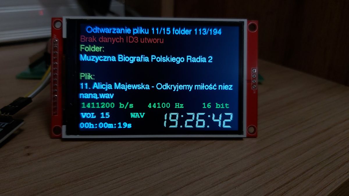

  • Added Polish font support and WAV display
    #1454 21738396
    MAJSTER XXL
    Posts: 2064
    Help: 164
    Rate: 429

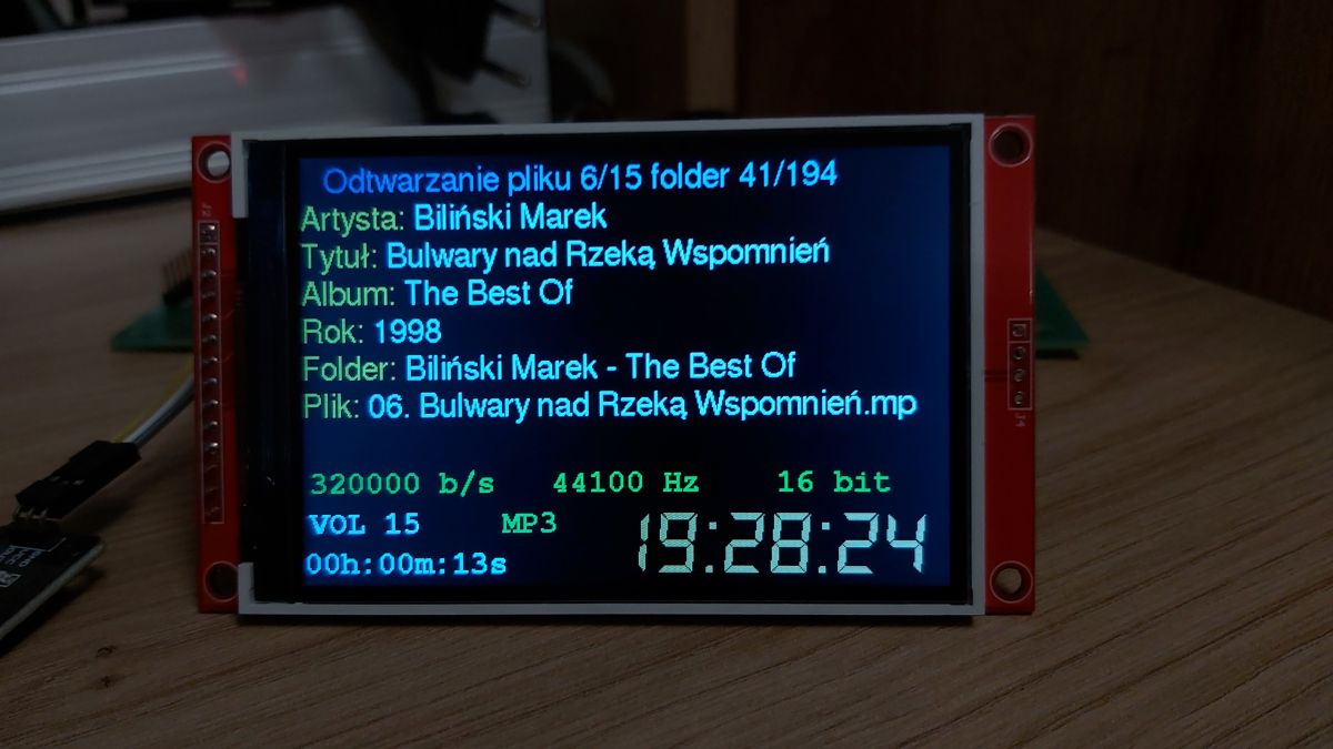

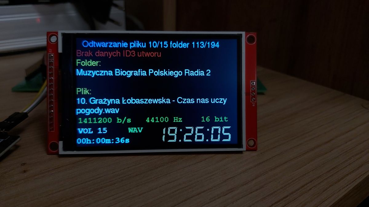

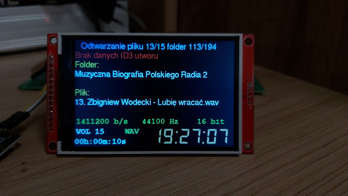

    My colleague @hevet dropped me a prepared library with support for Polish characters in the FreeSans12pt7b font for testing. I've thrown this into my v3 version for now in the file player and the effect is as in the screens below. I also added display of the wav format. (Hardly anyone uses this these days). I took the liberty of uploading this file with Polish characters to my repo on github, thank you Fellow @hevet .
    LCD screen displaying WAV file information with correct Polish character support LCD display with audio player showing WAV file with Polish characters Audio player screen showing WAV file with Polish characters and audio details Color display showing an audio player with Polish characters and track metadata Player screen with MP3 file details and Polish characters in FreeSans12pt7b font Player screen with MP3 file details and Polish characters in FreeSans12pt7b font

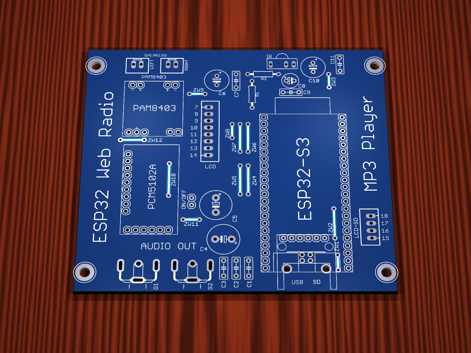

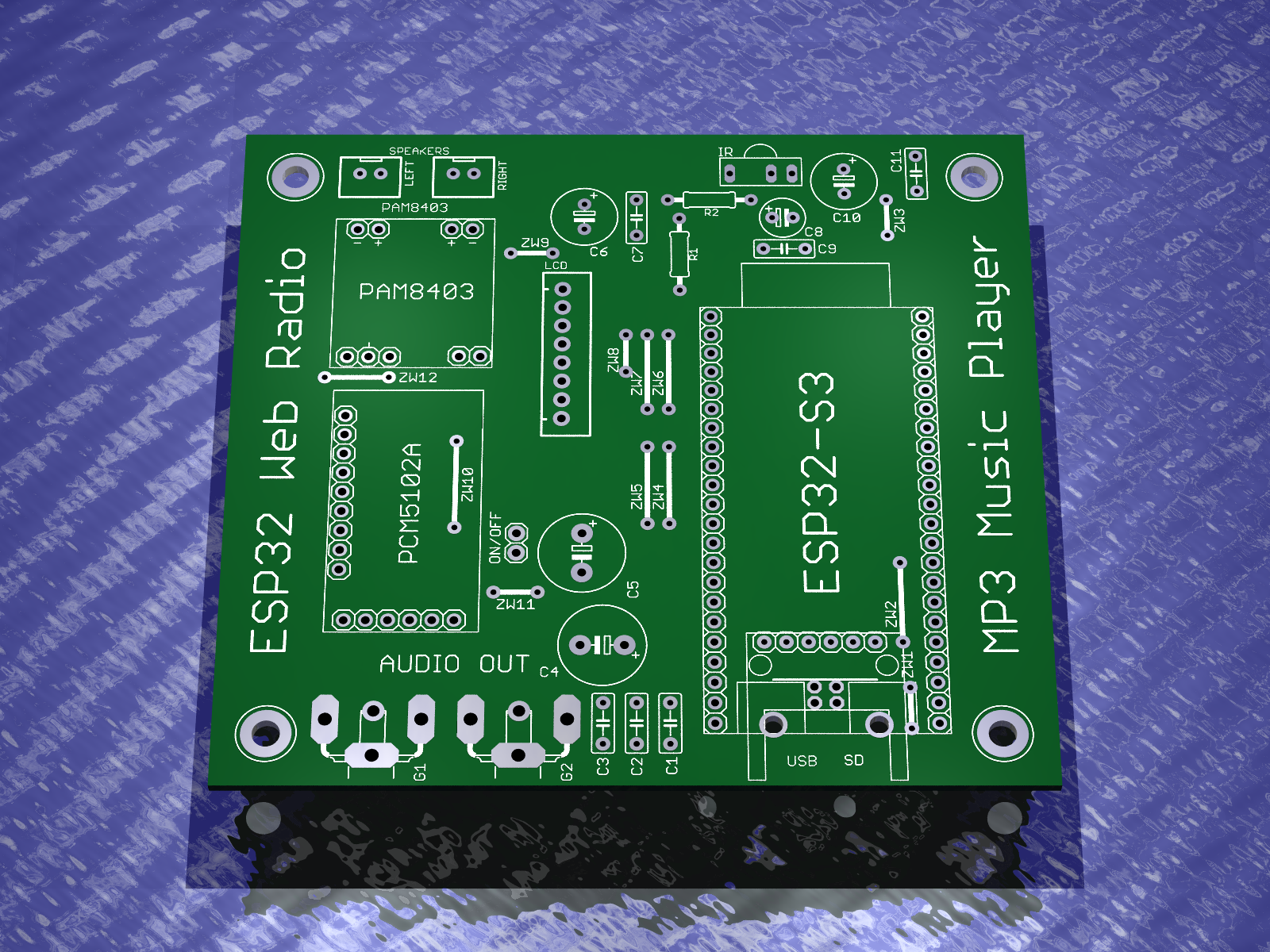

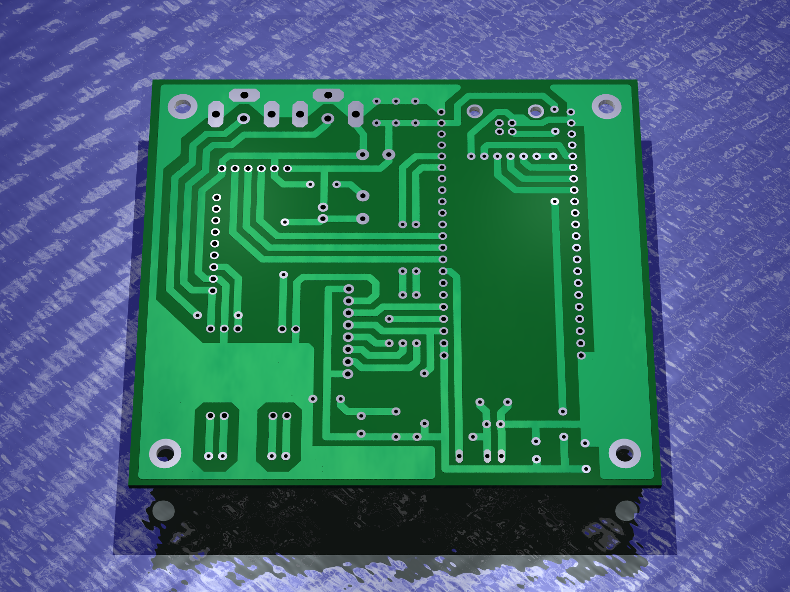

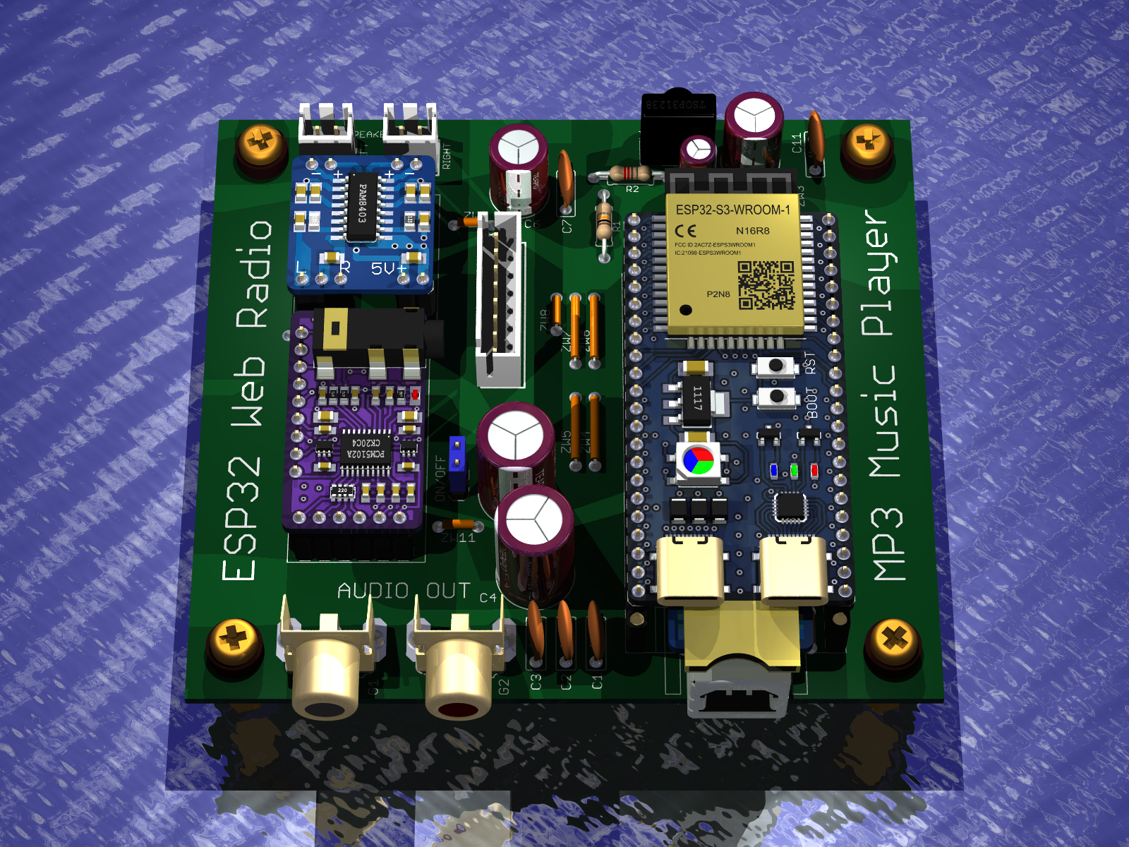

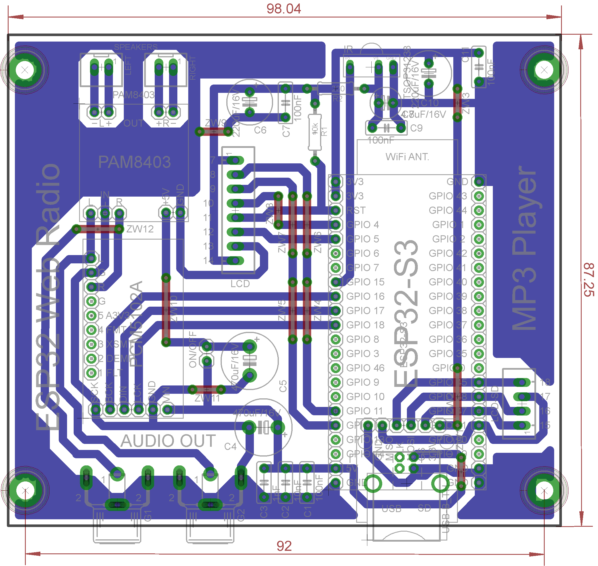

    Hello, the radio is developing beautifully, I mean both projects of kol. Robgold as well as the version in colour of kol. MajstraXXL ;)
    As I have been using the Robgold version of the radio for a long time, I wanted to put together a second receiver, this time in colour ;)
    I designed a PCB for the connections of coll. MajstraXXL according to the schematic he provides on his Github.
    The board is designed in my style i.e. on modules and in a through-hole version.
    PCB looks like this ;)
    3D render of a green PCB labeled for ESP32-S3, PCM5102A, and PAM8403 module installation
    3D render of a green single-sided PCB with through-holes and circuit traces
    And this is how the 3D render looks ;)
    3D render of a PCB with ESP32-S3, PCM5102A and optional PAM8403 modules
    Green PCB with visible traces and mounting holes, 3D rendering
    The PCB design includes the necessary modules i.e. ESP32-S3, PCM5102A, SD module, and optional PAM8403 amplifier module.
    Once the prototype version is up and running I will make the project files and gerber available to others ;)
    Regards ...

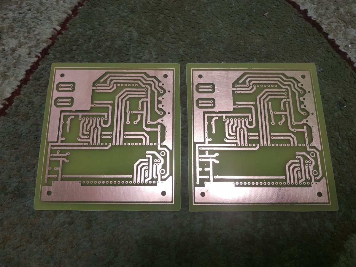

    Added after 6 [minutes]:
    I have already made prototypes
    Two green PCBs with copper traces placed side by side on a patterned carpet I have already made the prototypes
    Greetings....

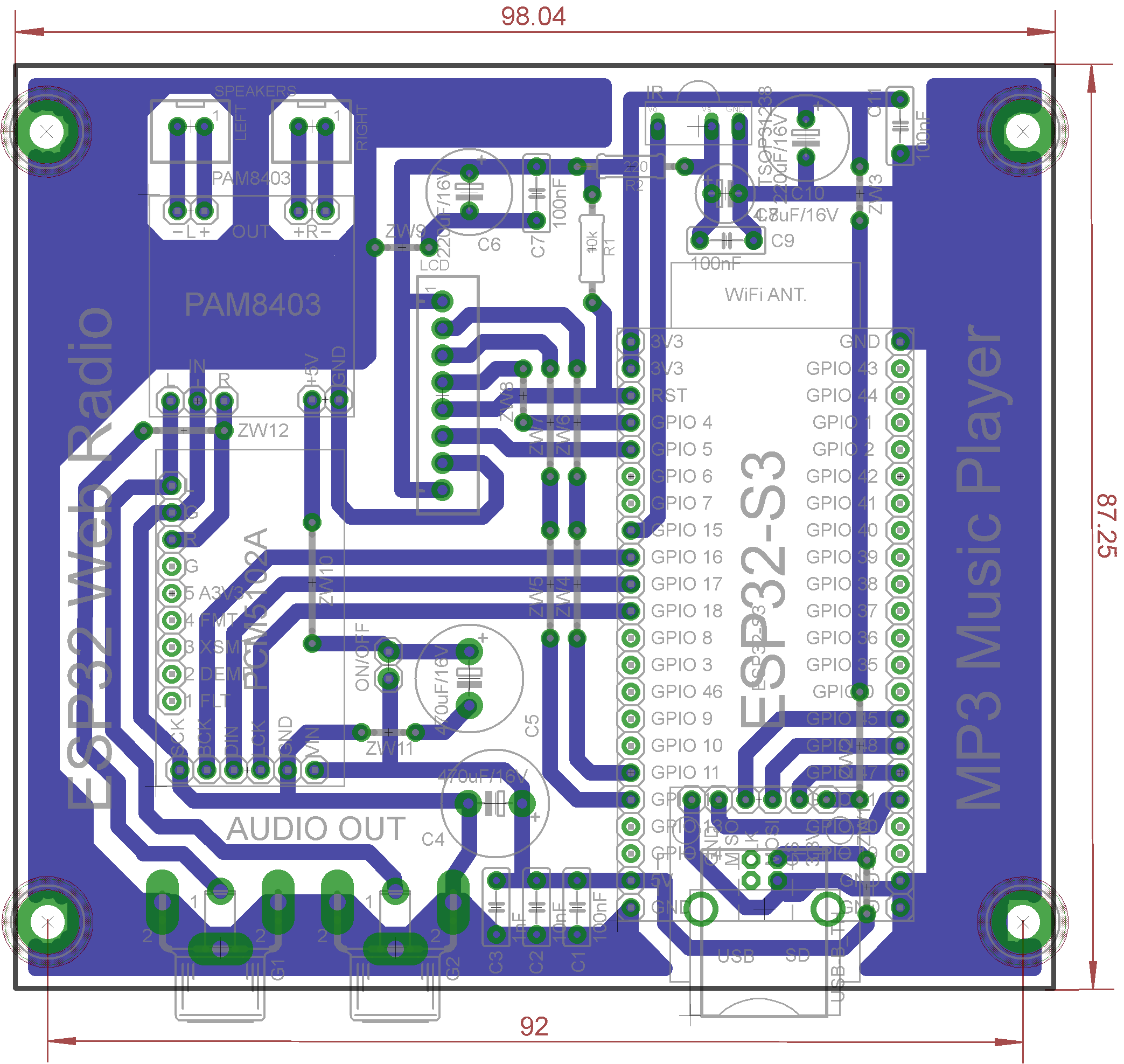

  • Black screen on SSD1322 with ESP32-S3 build
    #1457 21741768
    QALAB
    Posts: 10

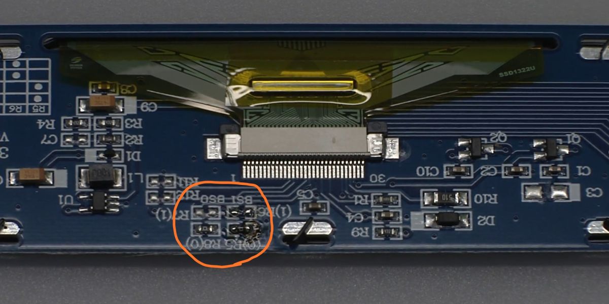

    I would like to ask the author and my friends who understand this subject, to which offset address should I load the ESP32_radio_evo3.19.17.bin file with the Flash loader for internet radio? I tried 0x0, it loads but the screen does not appear. When I compiled it with Arduino IDE 2.3.4 ESP32 Core 3.3.2 without any errors and uploaded it to the ESP32 S3 Module, I can see it as EVO-Radio from WiFi, but the screen remains black. I have an SSD1322 display, and the display works with yoRadio. My display connection pins are SCK-Pin38 SDA-Pin39 RST-Pin41 DC-Pin40 CS-Pin42, I kindly ask for your help in this matter. Best regards. My English is very bad, please excuse me.

    The pins are correct, if it's an OLED display 3.12 whole (that's the one I have) then there are several reasons.
    1. The 5v power supply and gnd are they connected to the display ?
    2. Is there the required voltage on the 5v pin ?
    3. Is the SPI interface set up correctly.
    These two resistors on the display should be soldered like this ?
    Close-up of OLED display back showing ribbon connector and resistors R9 and R10
    If everything is as it should be and it doesn't work then from attaching the photo maybe we can find out what is wrong ?
    Greetings ...

    Gentlemen someone once wrote (or it seemed to me)
    I've been thinking and thinking - I want to order an LCD display.
    Foreman XXL sent me a link to an LCD where he was buying
    https://sklep.msalamon.pl/produkt/wyswietlacz-tft-lcd-35%e2%80%b3-ili9488-320x480/
    There is an SD card reader on this display.
    Has anyone run it with our radio ?
    Because if so and it works I will add an optional JST connector in the PCB design for the SD_CS, SD_MOSI, SD_MISO, SD_SCK pins ?
    Then it will be possible to dispense with the microSD card module.

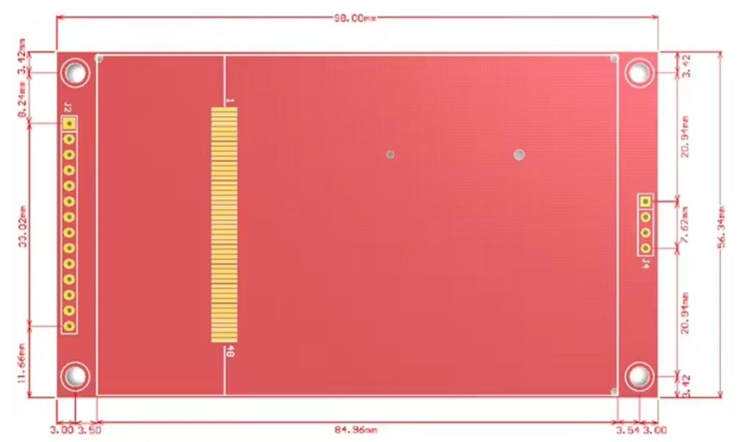

    Oh and a final issue MAJSTER is 3.5 inches in size, to this size in width I will adapt the board.
    There is also a 4 inch LCD
    https://pl.aliexpress.com/item/1005003033844928.html
    Will this larger one also work ?
    Greetings ...
    Added after 1 [hour] 40 [minutes]:
    I changed the PCB so that the size between the holes is 92mm. I found the dimensions of the 3.5 inch module on the internet.
    MajsterXXL just confirm to me how you can the dimension between the holes on the display board ??
    Greetings ...
    Added after 8 [minutes]:
    This is what it looks like now
    PCB layout with ESP32-S3, PAM8403 audio amp, and 98.04 x 87.25 mm dimensions
    And the dimensions of 3.5 inches (gleaned from the net)
    Dimension diagram of a 3.5-inch LCD module with hole and connector positions marked.
    Greetings...

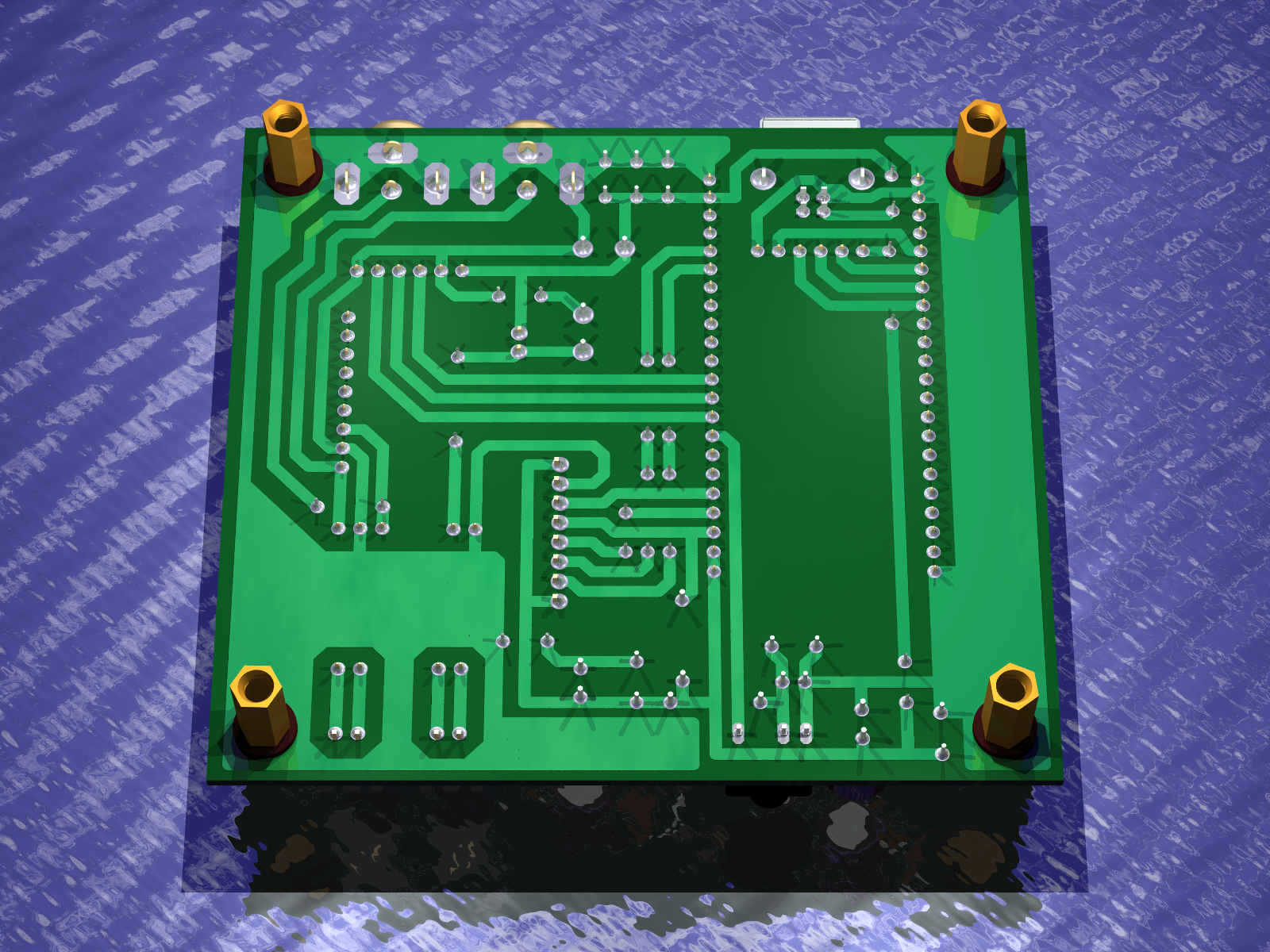

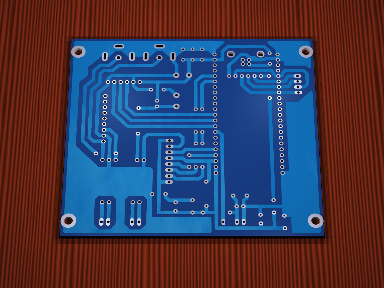

    Well, I have improved the design - adding a connector for an SD card placed on the display.
    PCB design with ESP32-S3, SD card connector, LCD, and audio output components
    Tomorrow I'll check the connections to make sure I didn't screw up when making the PCB and make a gerber.
    Greetings ...
    Added after 2 [hours] 35 [minutes]:
    Well done ;)
    Checked connections ;)
    I added the numbers next to the JST connectors corresponding to the display pins.
    This is how it looks ;)
    Blue ESP32 PCB design labeled with SD slot and LCD outputs on wood surface
    Single-sided blue PCB with light blue tracks and multiple through-holes for component mounting
    I also bought the missing components today - I'm assembling the PCB tomorrow, I have the modules, the display from Salamon is already on its way to me.
    So there will be a launch soon, and if it goes well I will post a gerber for those who are interested.

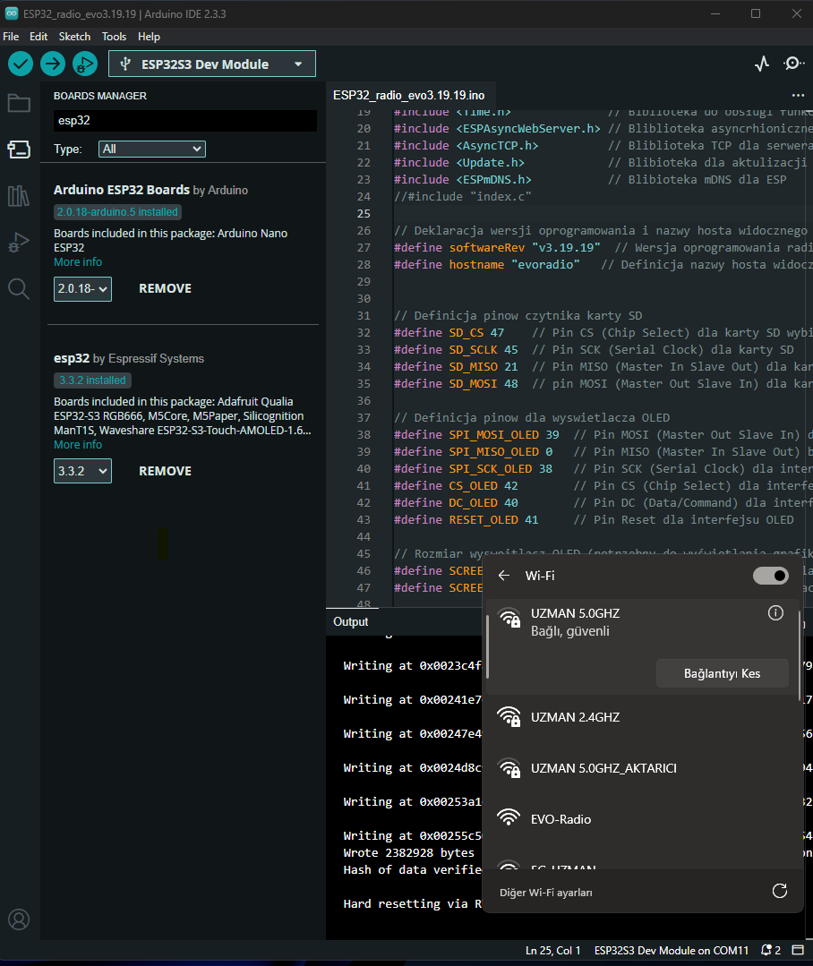

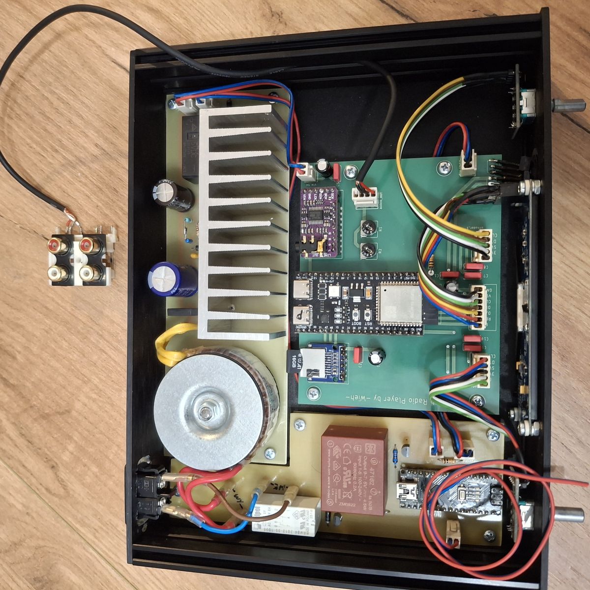

  • Audio_i2s library installation error on GitHub install
    #1462 21743781
    wieh76
    Posts: 57
    Rate: 23

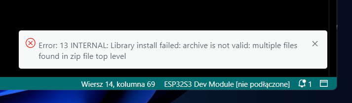

    I have assembled this internet radio, it plays beautifully. I used the software from robgold version 3.18.21.
    Today I wanted to upload the newer version 3.19 so I installed the recommended libraries via robgold. I just can't add the Audio_i2s library from github because the error shown in the picture appears. Is this library added differently?
    Library install error: multiple files found in ZIP file top level directory
  • #1463 21743794
    DJCheester
    Level 28  
    Posts: 2089
    Help: 75
    Rate: 958
    The libraries are in the user name userDocumentsArduinolibraries and there is a directory "ESP32-audioI@S-master" where you need to replace the SRC content. You download the corrected files from kol.Robgold's Github.
    Regards...
  • #1464 21743860
    wieh76
    Posts: 57
    Rate: 23
    DJCheester thanks for the help. Soft uploaded and working.
    By the way a big thanks to Robgold and Majster XXL for their work.
    Below the radio during testing:
    Internet radio player with display showing stream details and open electronics
    Regards

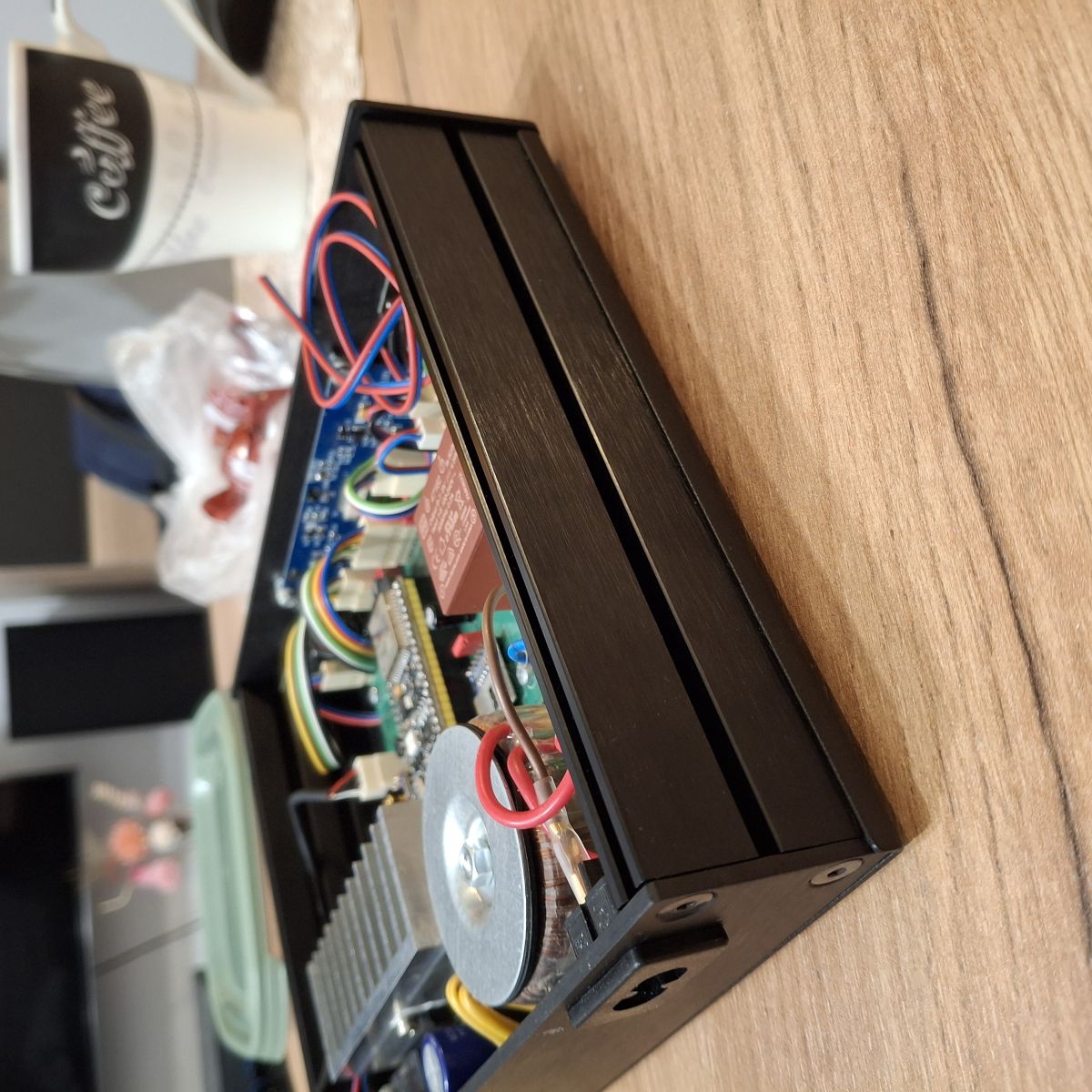

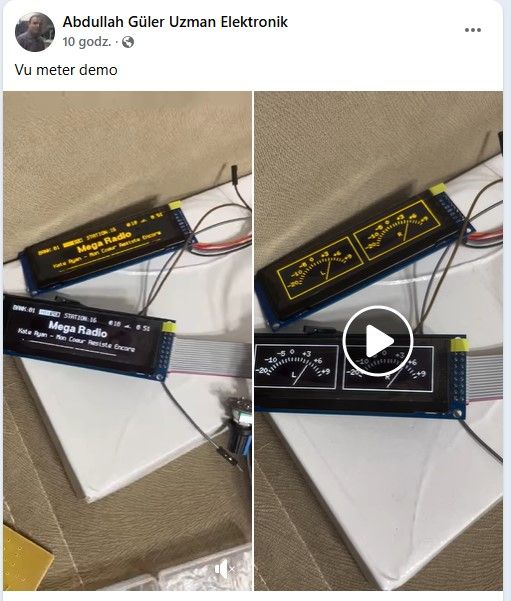

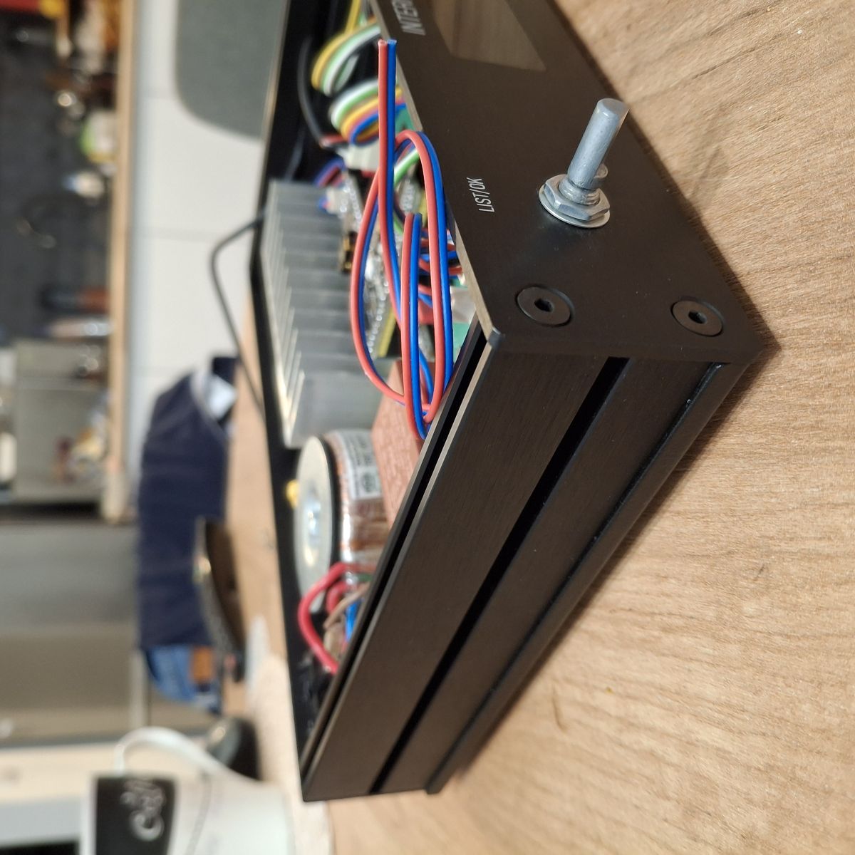

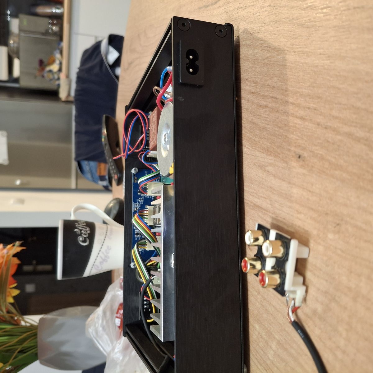

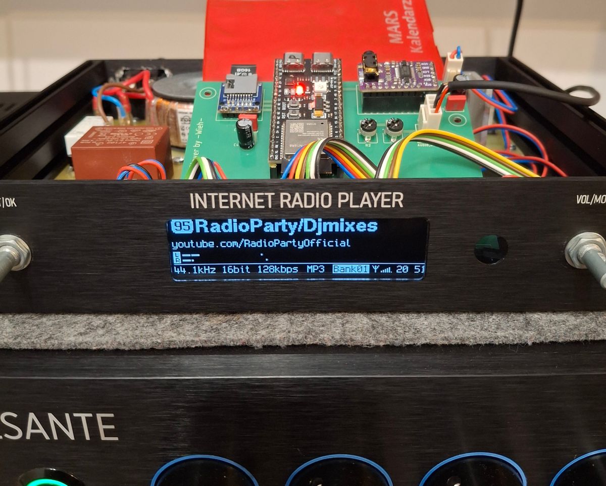

    >>21743925 Super that you managed to get it working. Looking at the wires and display colours isn't that your FB post ?
    It would be nice if you would provide a link to the authors of this radio, to this forum and correct that this is not yoRadio.
    Two electronic displays labeled Mega Radio with VU meter graphics

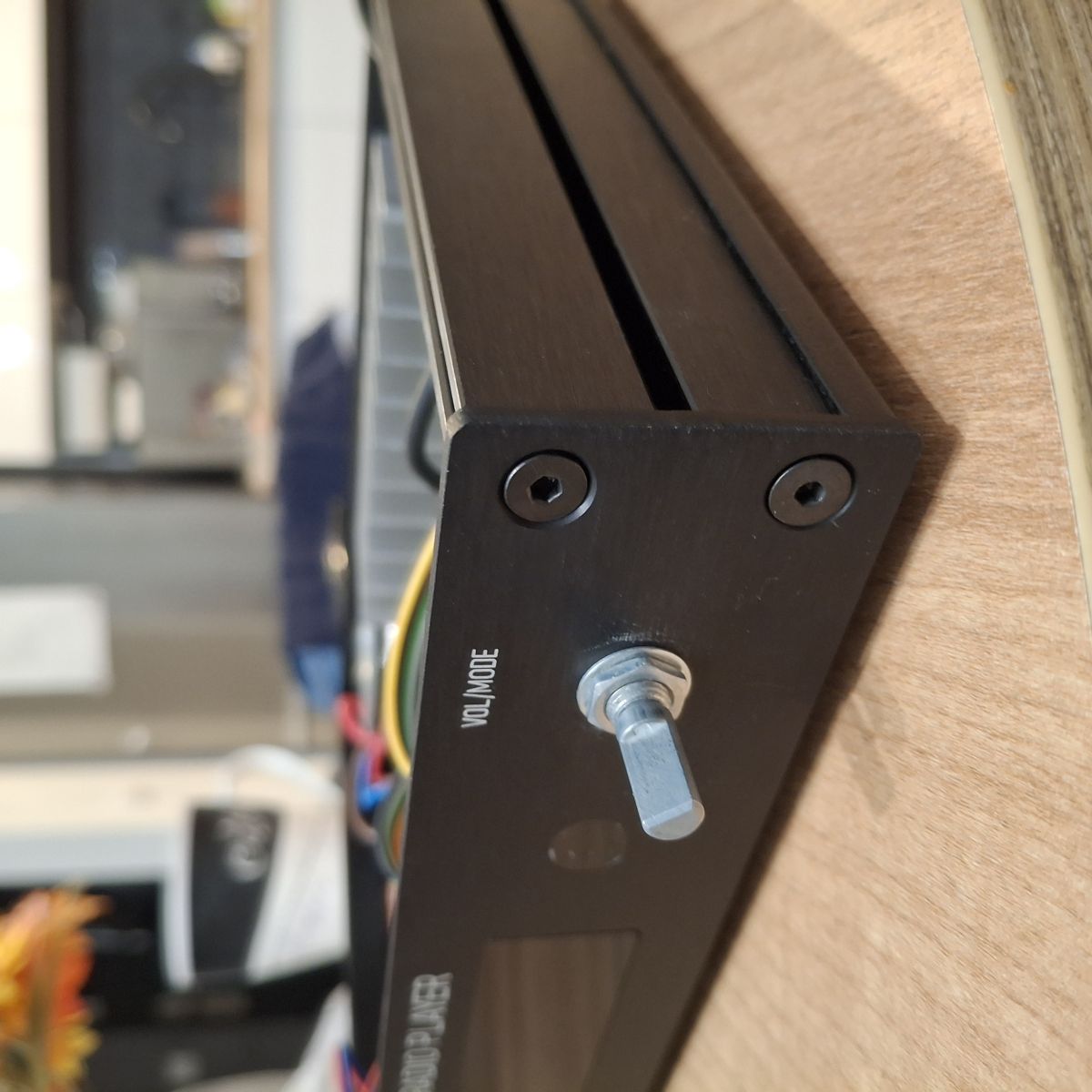

    @wieh76 I am impressed with the case. Beautiful workmanship. Will you upload any details ?

  • Custom Modushop enclosure with CNC front panel

    @robgold I would like to make the case like this😀. Case bought from modushop.co.uk specifically Link . Front panel + plexiglass for the holes for the display and IR receiver made on cnc also in this shop (they also do custom machining). I drew the panel in eagle including the lettering (which they burn out with a laser) and emailed it to them. Cost approx. 365 PLN (enclosure + processing) is a bit painful, but if it is to look good, it is worth paying. As you can see with me there are two encoders because originally there was supposed to be a soft XXL from the master, but he offered me yours and so it stayed. The second one will now be for decoration😀. A couple of pictures of my creations:
    Black electronics enclosure with visible internal circuitry and wiring.
    Interior view of electronic device housing with wires and RCA connectors
    Close-up of black audio device front panel with encoder and VOL/MODE label
    Corner of a black electronic device case with encoder and visible wiring.
    Interior of a hand-built electronic device with PCB, wiring, and components
    Greetings

    >>21743925 Super that it worked. Looking at the wires and display colours isn't that your FB post ?
    I've already done it so there's no doubt who the author is 🤗👍

    Help: 10
    Rate: 290
    @wieh76 It came out very nicely. I for one am a believer that it's better to have something you enjoy than to save up and then be upset that it's not. It came out SUPER. I'd get that second encoder in the software and make it into two: Volume on one, stations and banks on the other. I wonder if I should go back to such an option in the Evo so that someone who wants a version with two decoders could configure it that way.
    Are you planning to share the file for the CNC front end ? Question how is the display mounted/glued ?
    What do you have a small arduino for in this project ?
