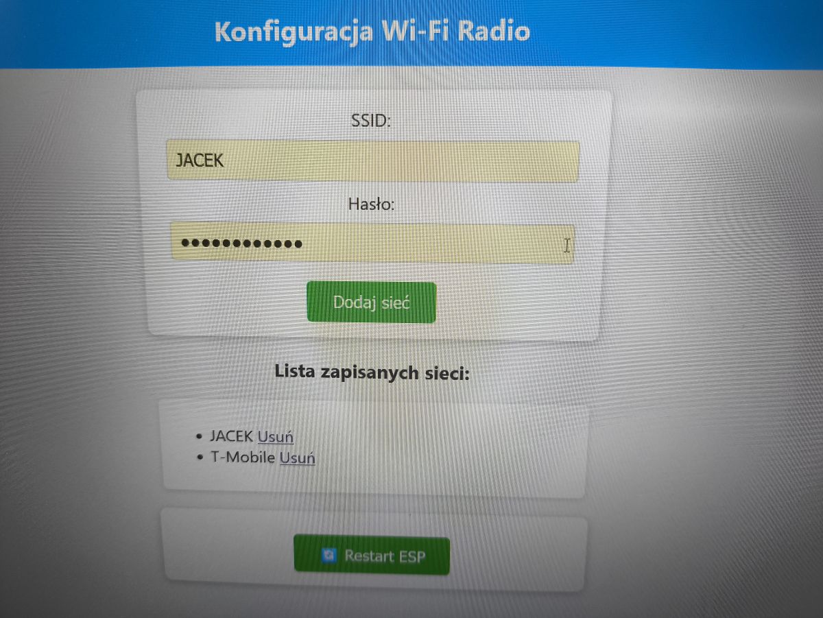

    @hevet
    Write something more regarding this point. -> " instead of wifi manager a simple AP portal, you can add and save an unlimited list of wifi networks"
    I would also be happy to replace this wifi manager.

    @robgold something like this, an extension for the wifimulti library.
    Wi-Fi setup panel with login form and list of saved networks
    In the evening, more I can send you, because now I have no way to send the code.

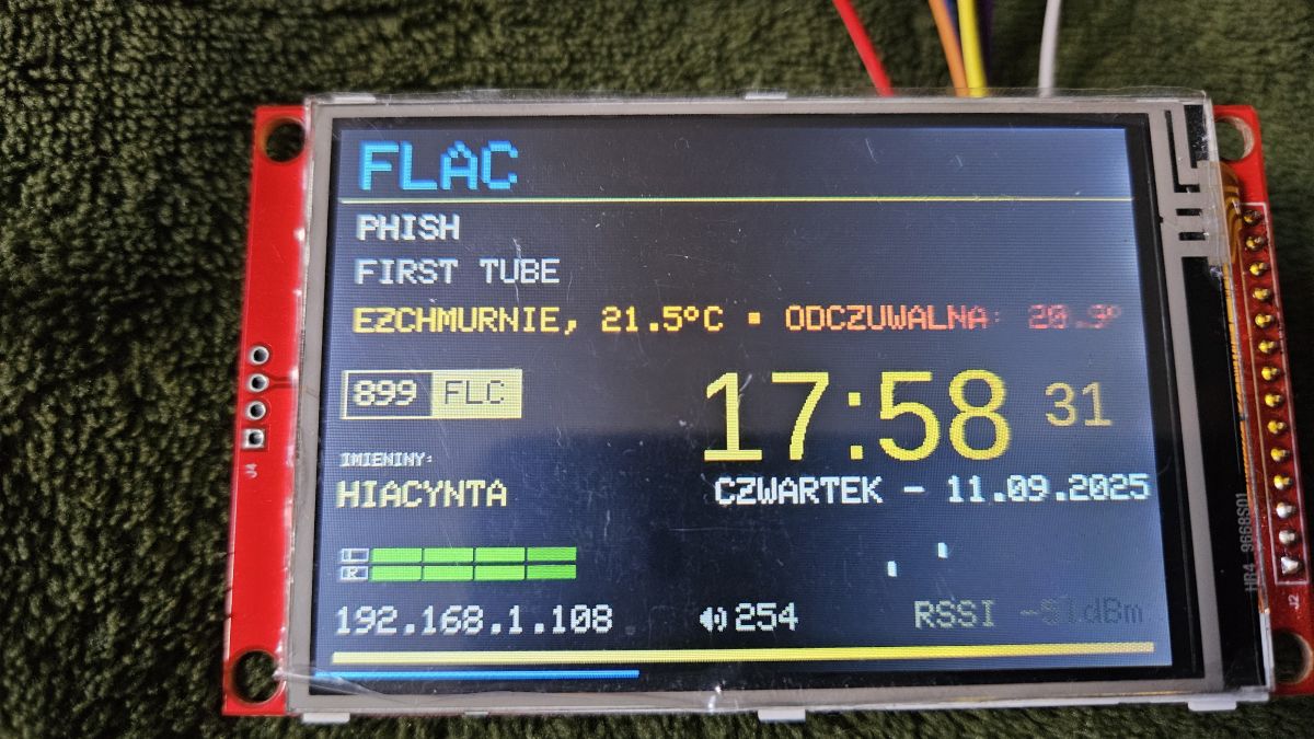

    Mis wrote:
    If anyone would be interested in a yoRadio modification that pushed this project forward a bit, I committed something like this.
    Quite a few changes and fixes, SPDIF, OPUS and VORBIS decoders, station finder, full polish, naming, weather ect.
    The code is on github: https://github.com/romekb/yoRadio_spdif
    And this is what it looks like:
    yoRadio display screen showing station, song, weather, date, and time .
    And a short video:
    https://youtu.be/0B93uhm7WAI
    I have two such radios made based on two versions of Chinese CYD displays on a standard ESP32 (with a PSRAM cube glued on the wires, because without PSRAM it runs poorly). Of course on ESP32S3 there will be no problem as well as on WROVER modules. Now a Chinese panel with ESP32S3 and a 3.5'' 480x320 IPS display + capacitive touch, but with a slightly unusual TFT controller, is coming to me. I should be able to get this working, and of course the code will be on github.

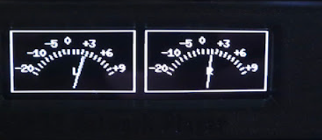

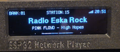

    Welcome,
    I have uploaded on Github GitHub Dzikakuna version Evo 3.18.21
    What's new ?
    - I have improved the radio's response to station listing from the IR remote control. Now the radio displays a list of stations by selecting the currently playing station, only the next press scrolls up and down.
    - I added Mode 3 - this is a simplified mode with station information displayed in a centred way, plus a miniature VU meter at the bottom.
    - I experimentally added Mode 4 - for fans of the slogan "no LED will sell" there is a full-screen VU meter in the form of simulated analogue pointers
    This is the last version working on the old Audio and Core ESP32 libraries.
    From version 3.19 onwards, only the ESP-audioI2S-master 3.4.2 and higher audio libraries will be supported (changes in the way information about the playing station is communicated) and core ESP32 3.2.0 and higher. At the moment, I'm sticking with 3.2.0 because this version has improved wip and netif files, which makes it possible to listen to "streaming" stations in FLAC format.
    Version 3.19 will probably be released on Github later this weekend.

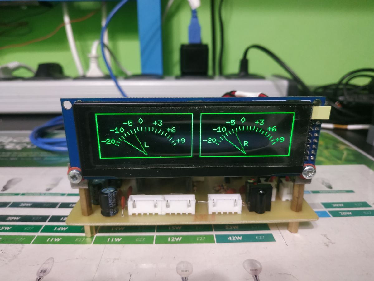

    I'm in love with these uvmeters 😀
    Revelation and respect for such refinement of the software.
    Dual-channel VU meter on an LCD mounted on a prototype board .
    Greetings....
    Added after 3 [minutes]:
    robgold wrote:
    This is the last version working on the old ESP32 Audio and Core libraries.
    From version 3.19 onwards only the ESP-audioI2S-master 3.4.2 and higher audio libraries will be supported (changes in the way information about the playing station is transmitted) and core ESP32 3.2.0 and higher. At the moment, I'm sticking with 3.2.0 because this version has improved wip and netif files, which makes it possible to listen to "streaming" stations in FLAC format.
    Tell me if the higher libraries require a 64bit comp ? Because if so, unfortunately I won't install Arduino 2.x and that's where the fun ends for me. If it is not possible on Win32.
    Greetings ...

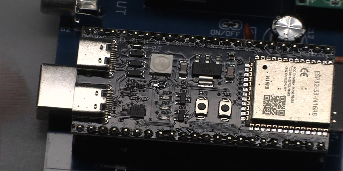

  • 0 ohm resistor removal disables bright LED; LCD2004 needs major rewrite
    #1404 21725403
    DJCheester
    Level 28  
    Posts: 2089
    Help: 75
    Rate: 958
    irysbox wrote:
    I succeeded in loading the soft evo to the board and a white LED came on which hits me in the eyes like I haven't had before
    There is a 0 Ohm resistor on the ESP next to the diode, remove it and the diode will not light up, as I remember correctly under these pins which is the diode in our case hangs the sd card that is why it lights up.

    Added at 4 [minutes]:
    Unsolder this resistor
    ESP32-S3 module with SMD components, buttons, and USB-C connector visible
    Close-up of PCB with circled resistor to desolder
