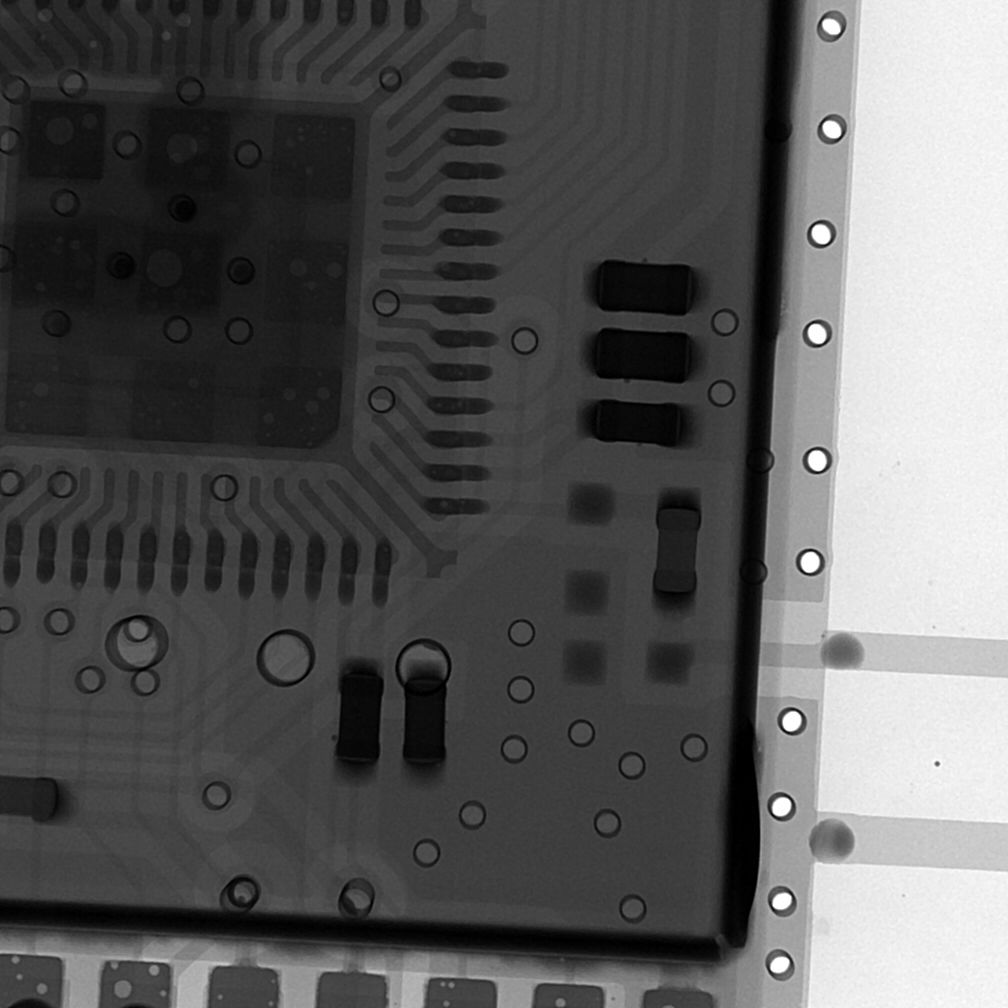

    @TechEkspert I happen to be fortunate that professionally I do. I am attaching a photo of my ESP32-S3 with x-ray.
    X-ray image of an ESP32-S3 board showing internal electronic components. .
    TechEkspert wrote:
    @Lechuuu is there any chance of an article on the practical use of X-Ray?
    What applications, what has it been able to detect, what do you need to watch out for, how much does it cost, what size it is, how much power it draws, does it need to have a properly prepared room, etc.
    I work with one of these: Nikon XT V 160 .
    As for the article on this, there's not much to describe here and my use is very sporadic, on/off/take a picture type

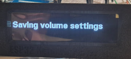

    I have also thrown in a volume record into 3.15. This is a function that is called on demand. The recording only takes place when we confirm a value in the volume control menu with the OK/ENT button on the remote control. A corresponding message on the display informs us of this. It is read out when the radio starts and, for me, as a test under the "rcCmdRed" button. Changing the volume itself does not write it to the volume.txt file. If the file does not exist on the card then the default value after start =10 (range 0-21) is taken. The first time it is saved, the file is created. Link GitHub Evo3.15 .
    Display showing the message Saving volume settings

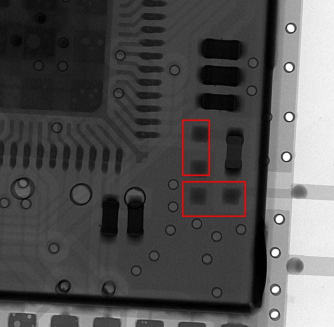

    @Lechuuu
    I'm looking at this X-ray photo and thinking how this is supposed to work as there is not even a complete PI filter at this ESP. There is only a coil and no capacitors to ground. Some kind of joke on the part of the manufacturer. Do you have a pure X-Ray or with a rotating table and head tilt function (aka pseudo CT) ? Nice "voids" came out on the ground pads under the circuit ;) .
    X-ray image of an electronic circuit with highlighted areas of missing components. .

    When it comes to saving configuration values to EEPROM (to minimise wear and tear), it is a good idea to save new data only if it differs from that previously saved.
    I often use this method in my devices. Write is set to a fixed interval. For example, every half minute. Of course, this method is more suitable for infrequently changing data.

    The web server is very primitive and can only handle one connection at a time. It also tends to throttle the main loop if you click a lot. I haven't noticed any major problems with it myself though. I'm assuming you have the Arduino set up correctly (PSRAM turned on appropriately to capacity - not every ESP module has OPI).
    The version that is currently on GitHub doesn't write anything by itself when turning the volume, so I suspect contacts. Changing banks appears when you hold down encoder 2 (the one from changing stations) for 3 seconds. In general, the audio library eats up resources and, in the case of a poor connection or stream, can make the whole radio very "sluggish".

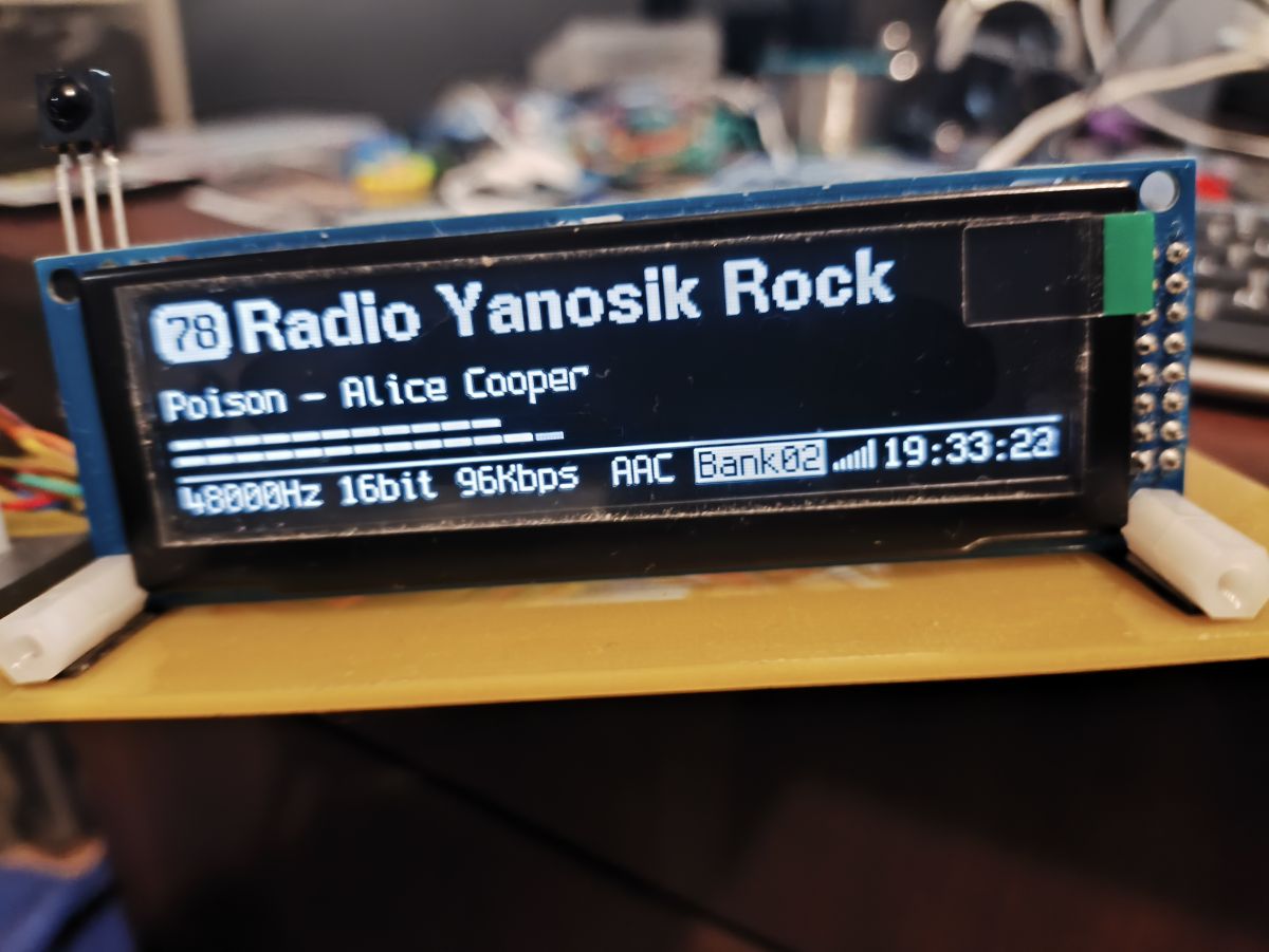

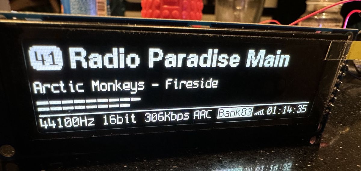

    Cool this radio !!! I soldered most of the connectors and it is better. The screen fades to black or stays on Volume. But I think only when I move the encoders. Via the WEB side it doesn't do the screen fade. When the screen disappears the rest of the radio functions still work normally ! I can change stations with the encoders or from the web site. Volume also, even banks (super with those 2seconds.
    On the quality side - not once did I have an interruption of the audio stream! The yellow board with the TFT screen (CYD) interrupts frequently on e.g. Radio Drivers (AAC).
    Flac I wanted to check - and in front of it is MaXXima Bank 15 Station 40 http://maxxima.mine.nu:8000/maxx.ogg and here the radio restarts and so the evening ended.... loop without exit, How to exit ? Switching off does nothing.... returns to this station and resets over and over again.
    Radio display showing the station Radio Paradise Main and the track Arctic Monkeys - Fireside. .

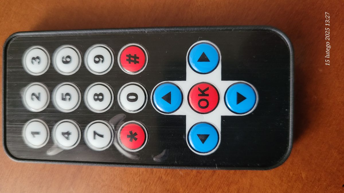

    How do you get the remote to work? (I have this little thing from Ali with a receiver). At Majster's I had 2 buttons working - 0 reduced the memory bank and ^ down, but nothing else worked. At Robgold, neither button worked. You have to plug in the port monitor and enter the received codes of this remote? Yes? Thanks.

    Yes you have to read the codes in the serial monitor, robgold has a completely different remote and on its codes nothing will work on your remote.

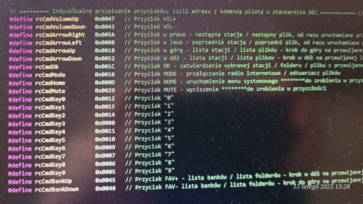

    technics az7
    >>21440462 if you have such a remote control then
    Remote control with numeric and navigation buttons. .
    Computer screen with code assigning remote control buttons to commands. works I checked

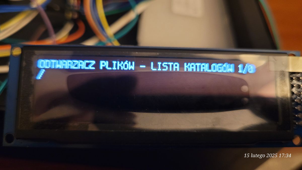

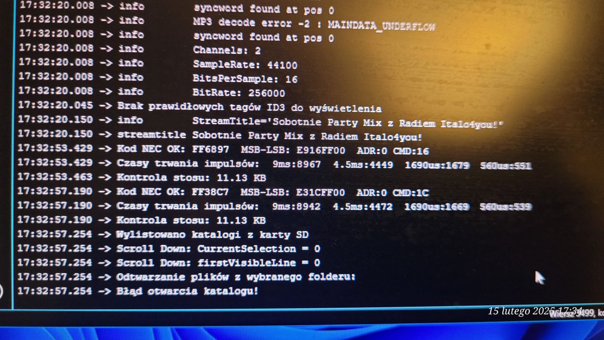

    >>21440492 I have this problem that it doesn't read my mp3 files from the SD card, which works, the station address lists are there and the radio plays and when I go into the file player there is nothing there despite adding some in mp3 format? The program uploaded from Majster.
  • #614 21440607
    MAJSTER XXL
    Posts: 2064
    Help: 164
    Rate: 428
    @technics az7 The files should be in some folder in the root directory of the SD card with no subfolders. Show the contents from the serial terminal, which is returned in the logs. The SD card should be formatted to the FAT32 file system.

  • #617 21440814
    technics az7
    Hello, first of all I wanted to congratulate you on a really good job with this project.
    It returns something like this
    Screenshot of system messages with information about MP3 decoding and error messages. .
    LCD screen displaying the message ODTWARZACZ PLIKÓW - LISTA KATALOGÓW 1/0 with wires in the background. .

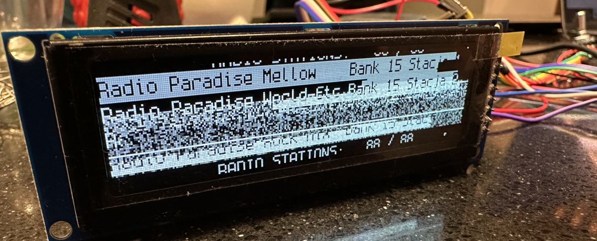

    Remote control introduced - works. However, with the screen I have a CYRK - it lives a short life with the RADIO and then flies off. It either stops with the content or goes black out. Where to look for the problem?
    #define SPI_MISO 0 - when I substituted -1 the screen would pop up quickly and a digital signal would fly in the headphones as if I were uploading a Commodore program ;-) (
    When I commented out this line it didn't compile. Can't the RESET oled be connected to the ESP32 RST ?

  • #623 21440935
    wirbud
    Posts: 65
    Rate: 16
    Update - I switched the voltages to the correct 5V - no change. I switch the bank and the screen goes black.....
    Or after black it woke up with such mosaics.
    Digital display with complex background showing interference in the form of a mosaic. .

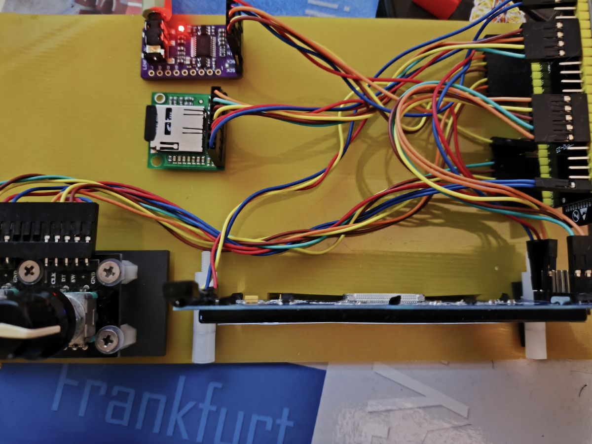

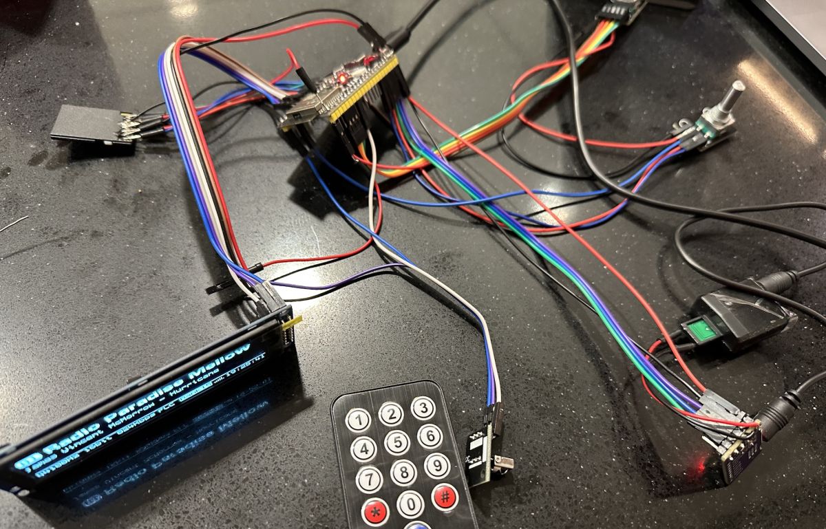

    the situation looks like this on the table - you may notice something ;-) ....
    Electronic set on a table with wires, display, and remote control.

    It's hard to make out anything in this tangle of wires, that's why I didn't do the wires as they can fail to connect, I made PCB files available in the topic. I recommend such a solution, everything works as it should, I recommend to have a good look at the connections and possibly tighten the loose wires or replace them with other ones.
    Best regards...
  • #629 21440976
    hevet
    Posts: 346
    Rate: 47
    I see Chinese cables that are of poor quality. After one insertion the pins expand and then hold poorly. I make the wires myself, bought the pins and have no problems with the connections.
    Display showing Radio Yanosik Rock and the song Poison by Alice Cooper. Electronic board with multiple colorful wires and modules. .
