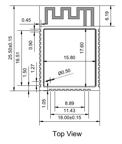

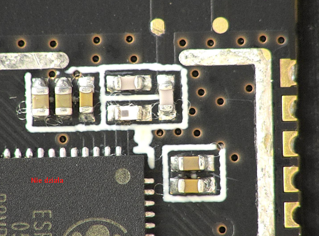

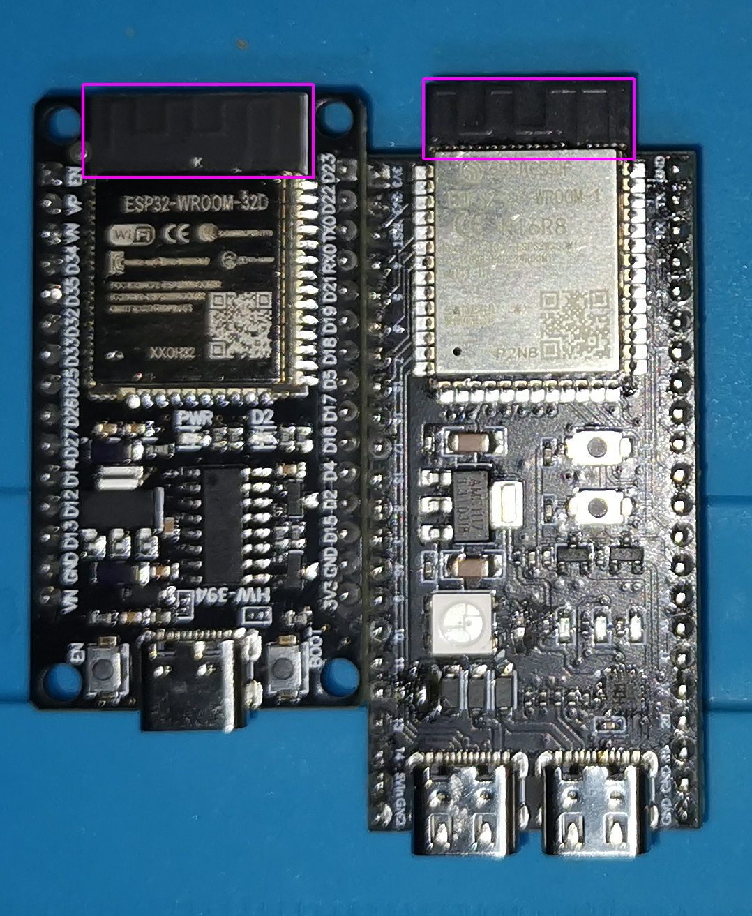

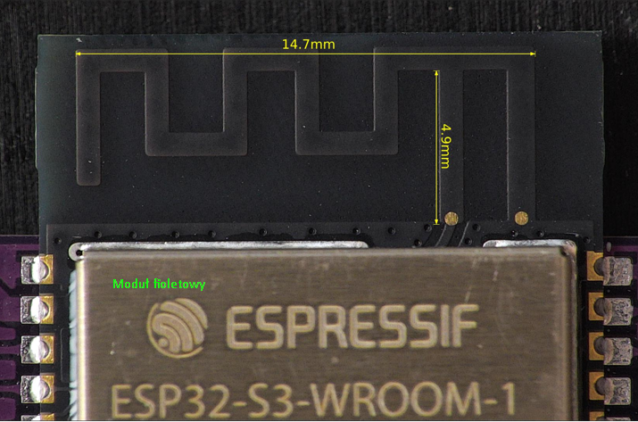

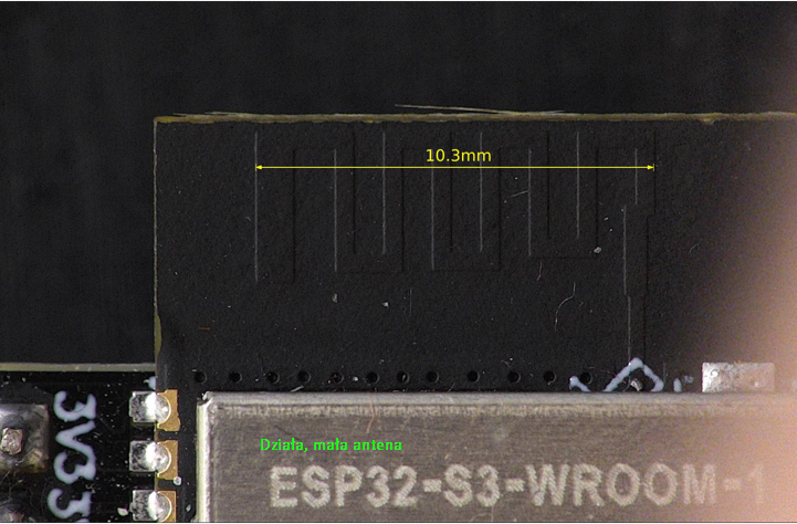

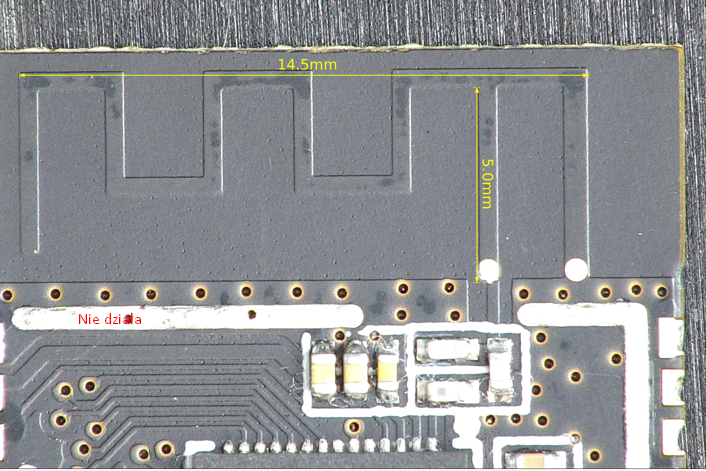

    Out of curiosity "nature", I threw three ESP modules on the digital microscope today.
    One with a black PCB - working, one with a purple PCB and a "poor 3V3 regulator" - working and the one with black PCB not working.
    This black working module has a completely different WiFi antenna. I'm tempted to hook up to this non-working module with a VNA analyser and see where it 'flies out' on the Smith chart. Unfortunately in the datasheet the manufacturer does not give any reference layout or component values to verify this. The web is full of tutorials and it seems as if it is all a copy of the same solution.
    In the last link "ESP32 S3 Hardware Design Guidelines" there is one layout shown and interestingly enough the module that works best (black PCB different atenna) has just such a layout. The rest is some kind of "Chinese creativity".
    Some links:
    Link 1 .
    Link 2 - TI guide
    Link 3 - ESP Hardware Design Guidelines
    In terms of the RGB diode, in the devKit ESP32 S3 it is zipped to GPIO48. We have an SD card on this port so it will not go off by itself even after a reset.
    You have to help it by cutting the jumper :) .
    Close-up of a PCB module with electronic components. .
    Close-up of a black PCB with markings Nie działa and dimensions 14.5 mm and 5 mm. .

    robgold wrote:
    From "nature" trivia, I put three ESP modules on a digital microscope today.
    I didn't have a microscope, but I have a similar case. 2 Wroom-32D modules not working properly, modules not responding, ripping streams etc. Checked on yoRadio.
    Plus 2 modules from ESP32S3 on which everything works as expected.
    Photo not of very good quality, but you can see that the antenna in the non-working one is completely different.

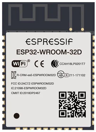

    Yesterday I read on the Commodore group (they build there various wonders for Amiga etc) that there can also be "bugs" in the software and not everything works on everything, not even the antennas but also the processors can work "differently" So not only the antenna is a problem. I have now ordered 2 units from Ali and we will see what arrives. On the other hand, maybe it would be worth writing some proven source of this ESP at least for the time being, because apparently these are not expensive modules, but again, collecting 10 damaged - not fully operational - modules is a bit of a waste of space and $
  • Fake ESP32-WROOM-32D modules and antenna advice
    #588 21437573
  • #589 21437591
    miroskop
    Posts: 481
    Help: 65
    Rate: 65
    It appears that the fakes do not have the 'Espressif' logo and lettering. All in all, this is logical (?)

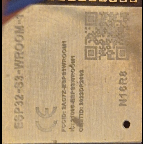

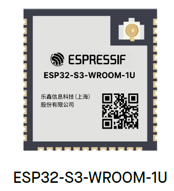

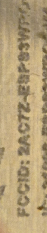

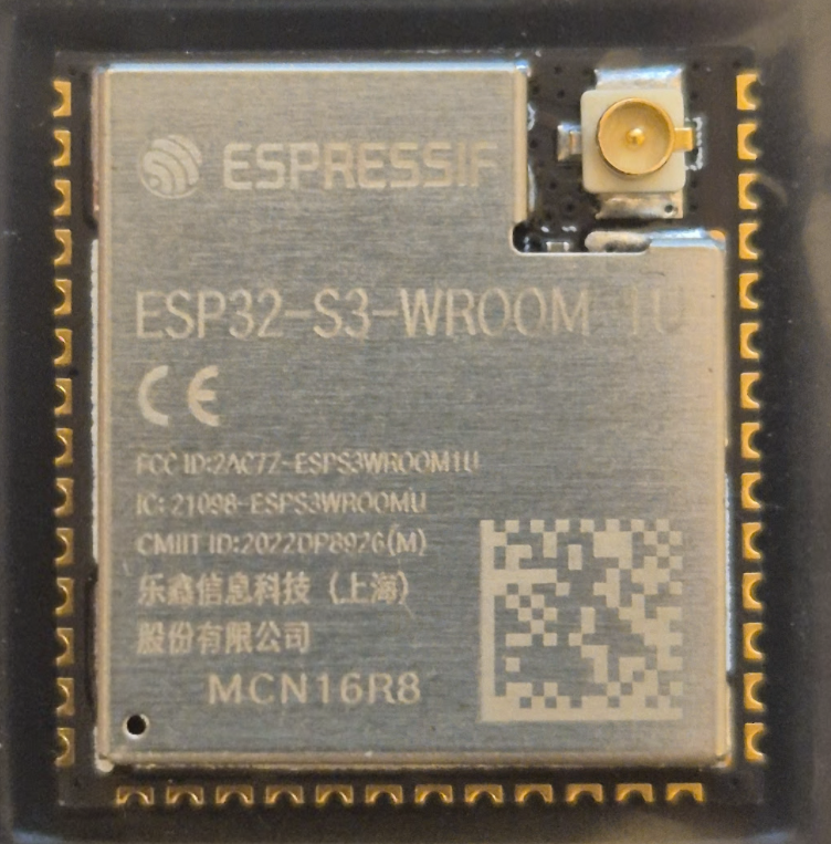

    @koham
    And what would you say to the fact that I have a module from the FCC 2AC7Z but without the Espressif logo ? In addition, those modules that have the logo compared to a module from TME ( theoretically from legal distribution) have a much lower quality engraving. I think that they already counterfeit everything today and even have no qualms about sending fakes with the correct FCC and logo to the EU market.
    I agree that there is a better chance of an original with the logo and correct FCC. As well as the fact that modules with external antenna are more reliable because, as you can see from my microscope measurements, subsequent copies from film copies or scans cause the antennas to diverge and probably no longer have a perfect fit with the components that have been soldered into the filter. Therefore a piece of wire plugged into the antenna socket, even a moderately matched one, may work better than this simple antenna on a laminate, even though it is only 2.4GHz and nowadays you can do 76GHz without Roger-type materials.
    Close-up of FCC printing on module 2AC7Z without Espressif logo. .
    Close-up of an ESP32-WROOM module with engraved text and a QR code.
    I wouldn't suggest the renders in the Espressif instructions either. In the official instructions the antenna connector has the render turned 90st relative to the physical module (TME purchase)
    ESP32-S3-WROOM-1U module from Espressif with visible logo, model name, and QR code. .
    ESP32-S3-WROOM-1U module with Espressif logo and certification details on casing.

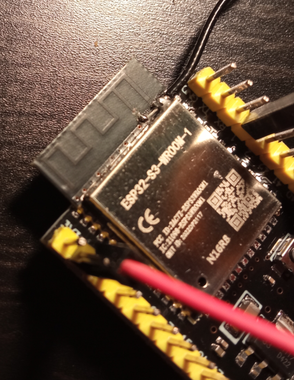

    I was also going through a coverage problem on the ESP32-S3 2 days ago.... It was ripping the stream and disconnecting the network every now and then.... I thought I had come across a faulty unit. I checked on x-ray that all the components were soldered and found nothing - everything OK. I decided to cut the path from the original antenna on the PCB and added an external one. Now the range is great, everything is working fine :) Something has screwed up with this antenna on the PCB - also cut and solder the external antenna.
    Close-up of ESP32-S3 board with an externally soldered antenna.

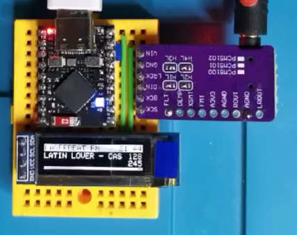

    For this, the ESP32-S3 Supermini module has no communication problems at all.
    Interestingly, the rssi 'sensitivity' value reported by yoRadio is -70dBm for this module, and therefore not working -59.
    ESP32-S3 Supermini module connected to a breadboard with an OLED display showing the text LATIN LOVER - CAS. .

    This super mini has a ready integrated antenna. A completely different story. A much more stable solution but expensive. The parameters of those on the PCB depend on everything from the thickness of the pre-preg used to manufacture the PCB to the thickness of the solder-mask paint, etc. This is suitable for development provided you have an Access Point under your nose.
    @Lechuuu I'm all for it. I think it's the easiest solution even if we don't perfectly shoot with the fit. It's not CB radio that the tip will get hot from reflections, the powers are small.

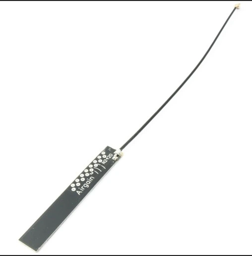

    Hello where to get such an antenna ?

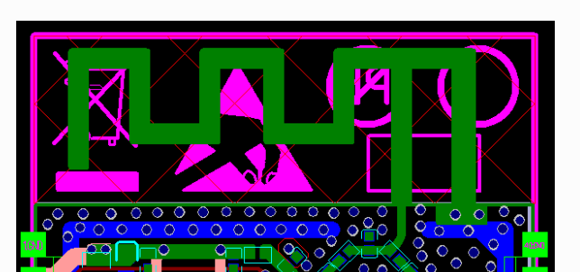

    @Lechuuu I have a question: did you cut only this inner (left) path or both?
    Edit: however, through the magnifying glass I can see that this right path does not go under the screen. There was no question.
  • #598 21438508
    robgold
    Posts: 726
    Help: 10
    Rate: 290
    This right path is the ground. The left one is the fader for the antenna.
    Illustration of PCB trace layout with a green right-hand ground trace and left hand antenna feed trace. .

    @DJCheester I just happen to have one like the one in the picture from allegro (type in: wifi esp antenna)
    Black WiFi antenna for ESP with cable and connector.
    @microscope to cut only the left path, the right path is ground and is connected to the shield. It is important to solder the wire as in my picture, that is, the wire strand is to be to the left path.

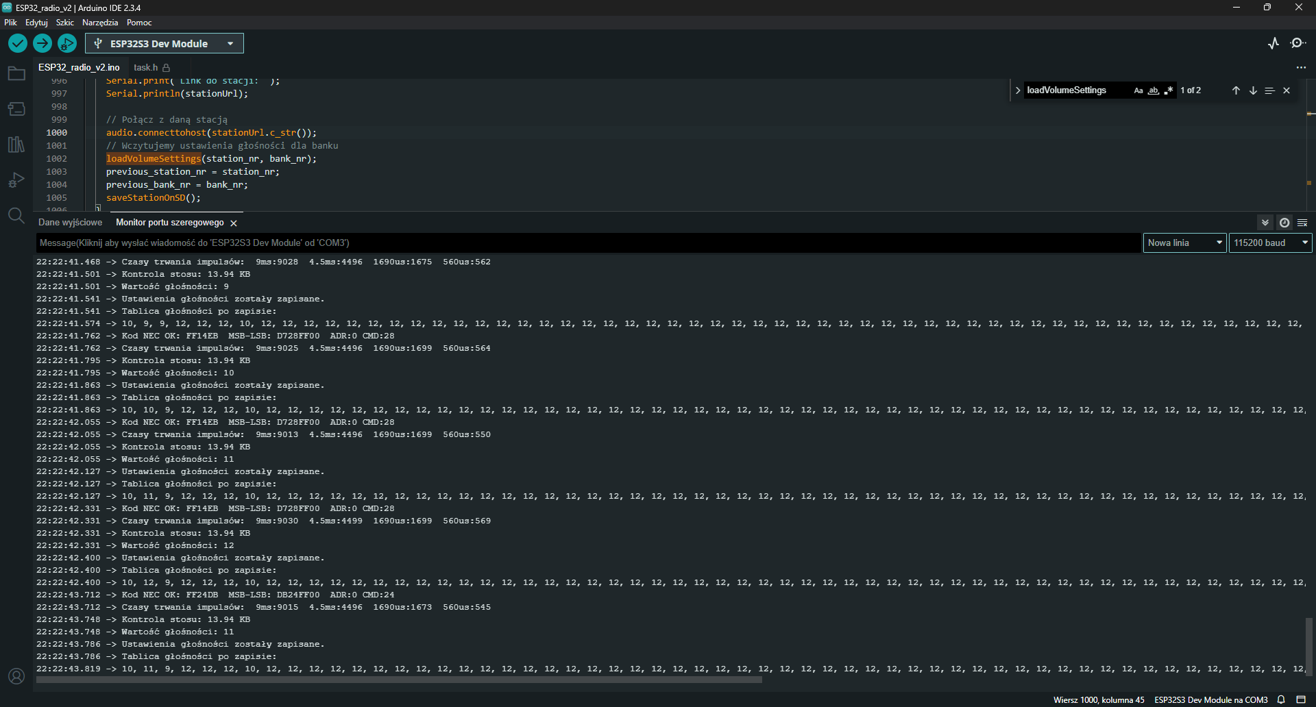

    I see that the antenna theme has developed, and in the meantime I'm throwing in an add-on that saves the volume settings of each station from each bank to an appropriate file where these saved settings are kept. The volume settings are saved to the file on an ongoing basis without change for other stations in the current bank.
    Here is the saving function:
    Code: C / C++
    Here the read function, when there is no required read file then a corresponding file is created with default settings = 12 for each station index in this bank:
    Code: C / C++
    I then call the save function here at the end:
    Code: C / C++
    while the read function in this fragment of the changeStation function:
    Code: C / C++
    You can check and test, in my case it seems to work fine. Operation from remote control and encoder works:
    Screenshot of Arduino IDE with code for ESP32. .
