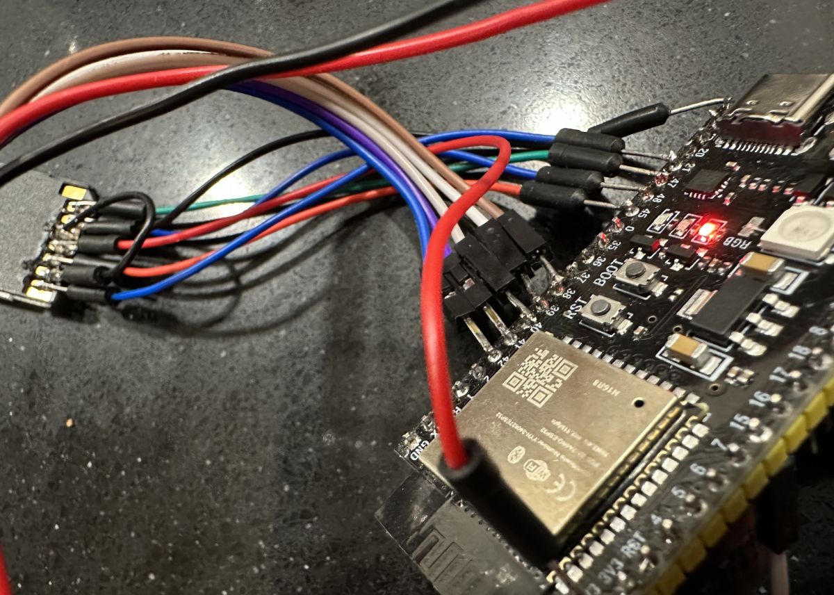

    >>21440976 you are right ! these wires are a massacre ! That's why I soldered most of them from the top to the ESP32 (KArta SD mini sits in the adapter and this one already on the solder.
    ESP32 with connected colorful wires on a black surface. .
    Added after 1 [hour] 7 [minutes]:
    Most of the problems solved - the jumper on the display for the SPI setting was illusory.... soldered and the screen no longer disappears.
    The occasional reset still remained. Maybe the case and short wires will improve that too. Thanks to everyone for their help Thank you Majster, for the super project and robgold for the great

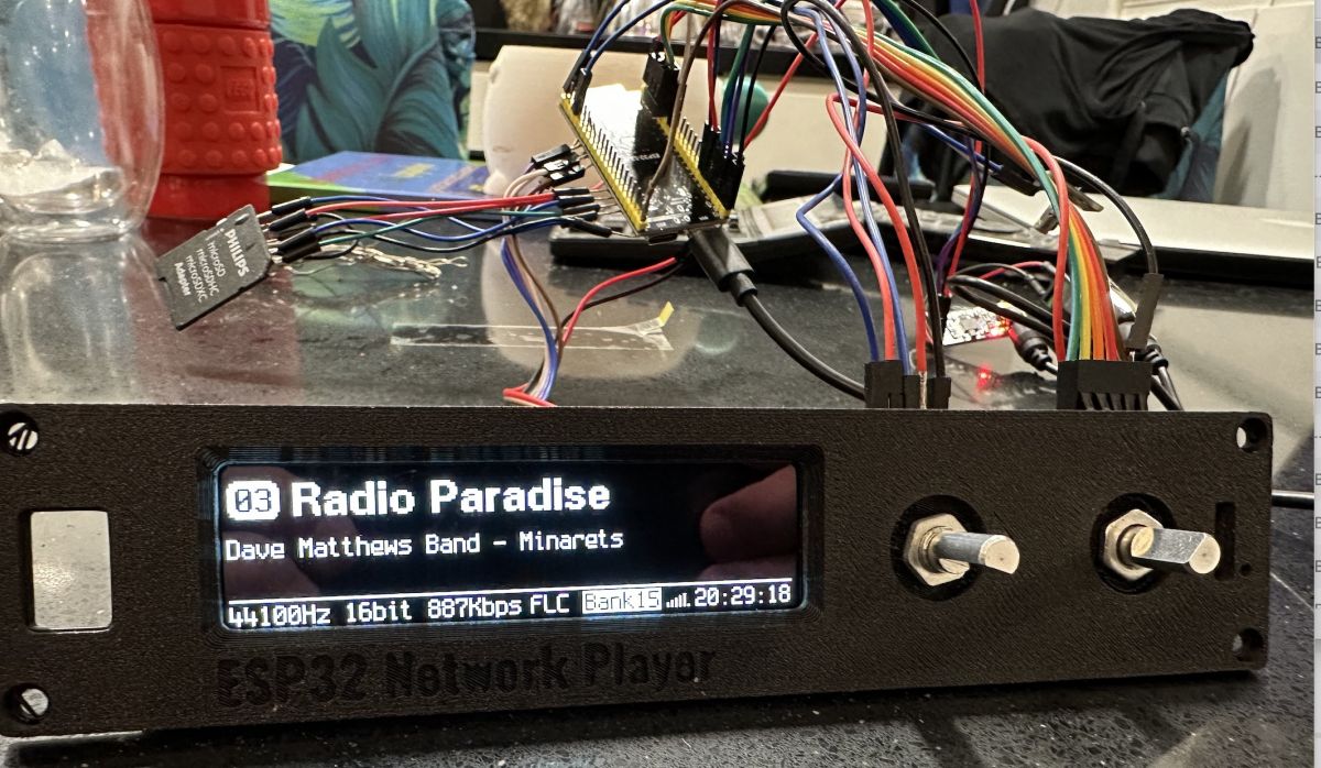

    screen lift and those notes ;-) For the housing also.... still a question about the switch button and SD port .... would you give a link of the pattern.
    ESP32 Network Player with display and wires.

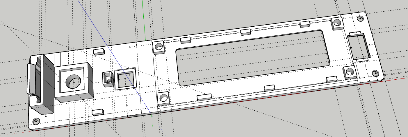

    Welcome,

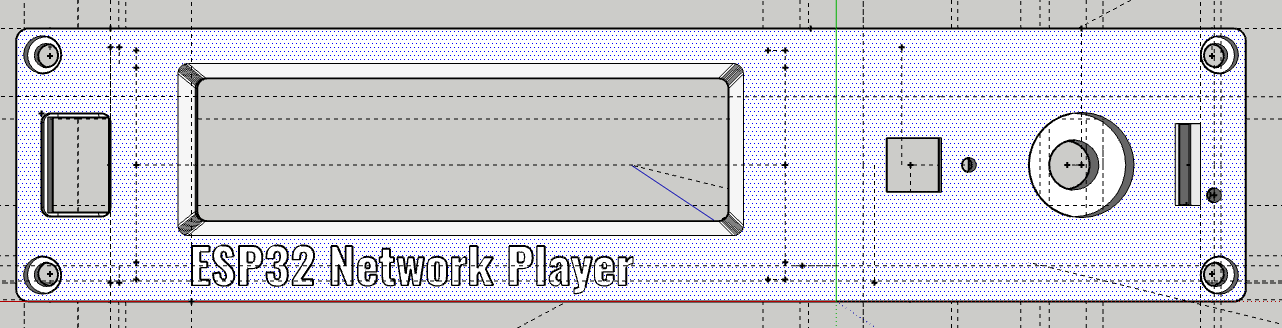

    I'm glad the enclosure has been useful. I have uploaded the latest version to GitHub with one encoder and a window for the IR receiver and IR LED. The whole thing is designed so that the power supply for the IR receiver and receiver LED can be "stolen" from the encoder pins. The window for the IR is printed from transparent PETG.
    I have also updated the front for the Hammond case.
    Front panel design for an enclosure with encoder and display slots .
    Design of ESP32 Network Player case with openings for display and buttons. .
    The switch for the case is: Link or or Link The former I have and there is a 3D design under it. The latter appears to have identical dimensions. I don't have it yet but when an order from TME is collected I will throw one in for testing.
    Card reader from Msalamon this -> Link .
    Display is -> Link
    Knob (fits a lot of different ones) I have one from Ali -> Link
    By the way Msalamon has sold all the OLED displays. I wonder how many people on this forum thread have bought an OLED from him for their radios ;) .

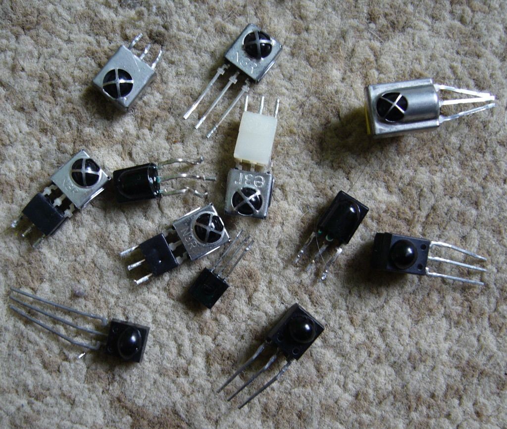

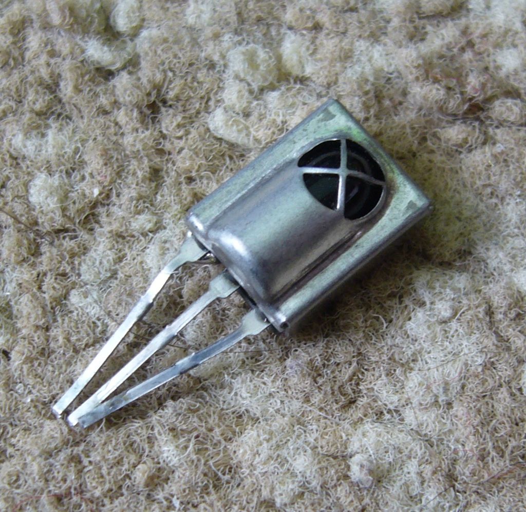

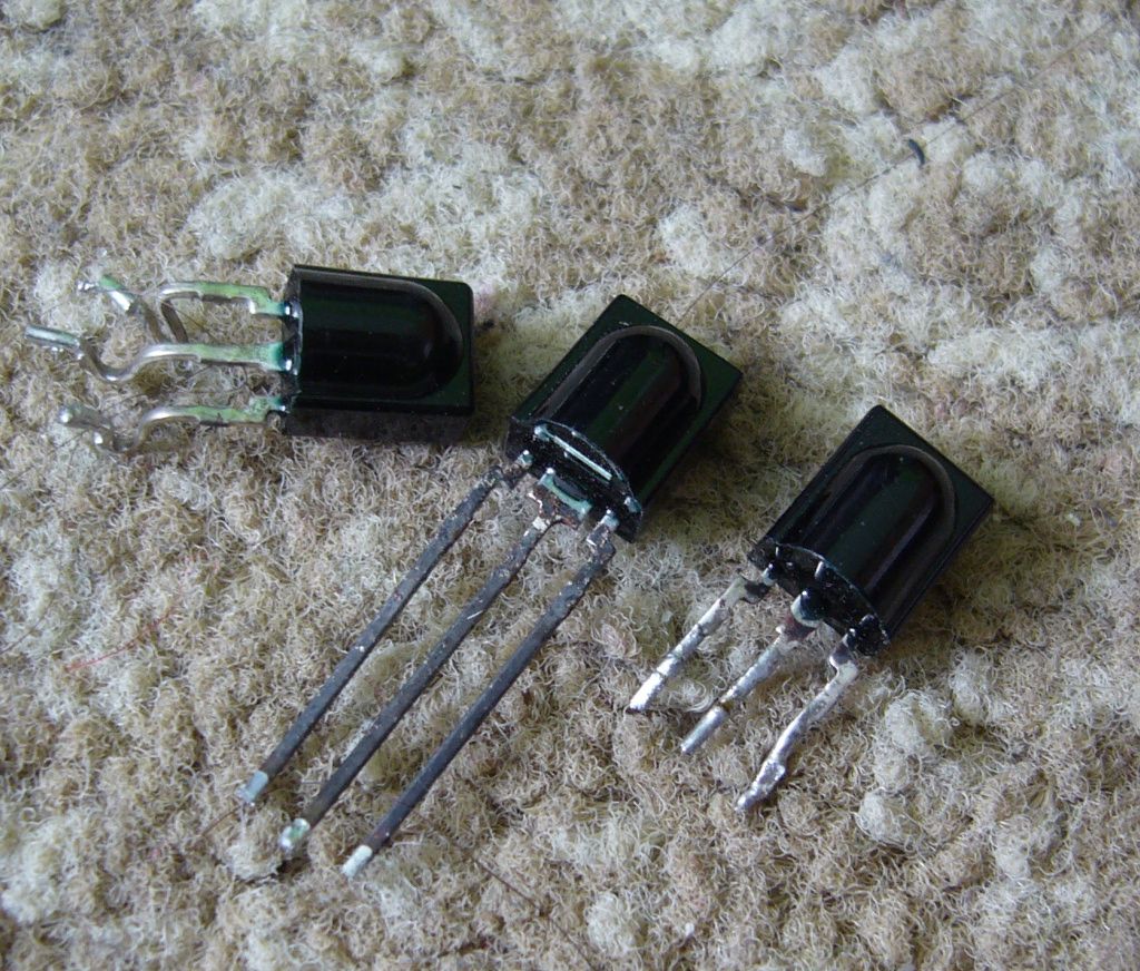

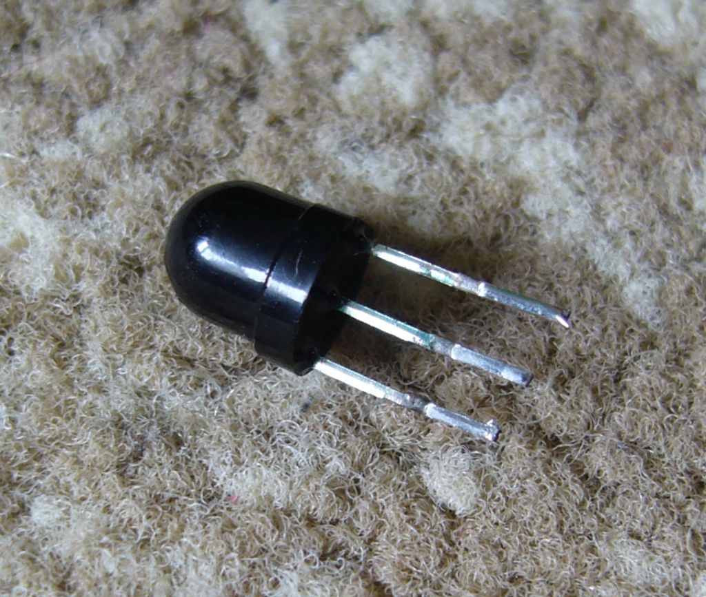

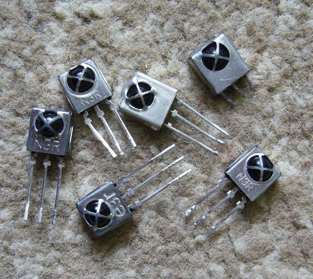

  • Request to identify receiver type and pinout

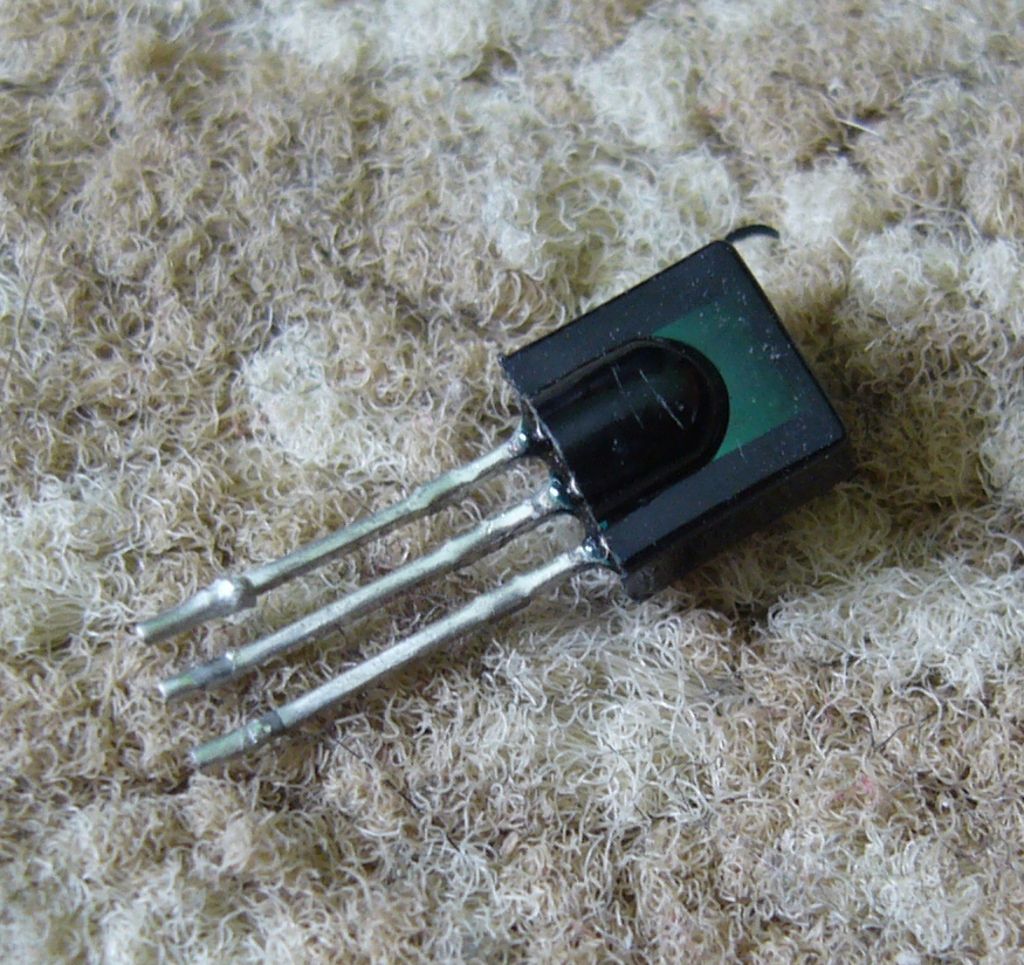

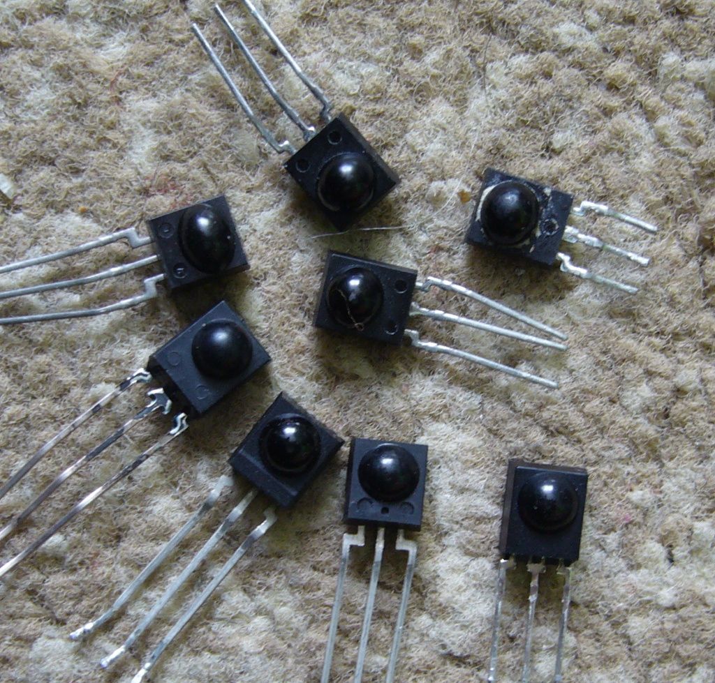

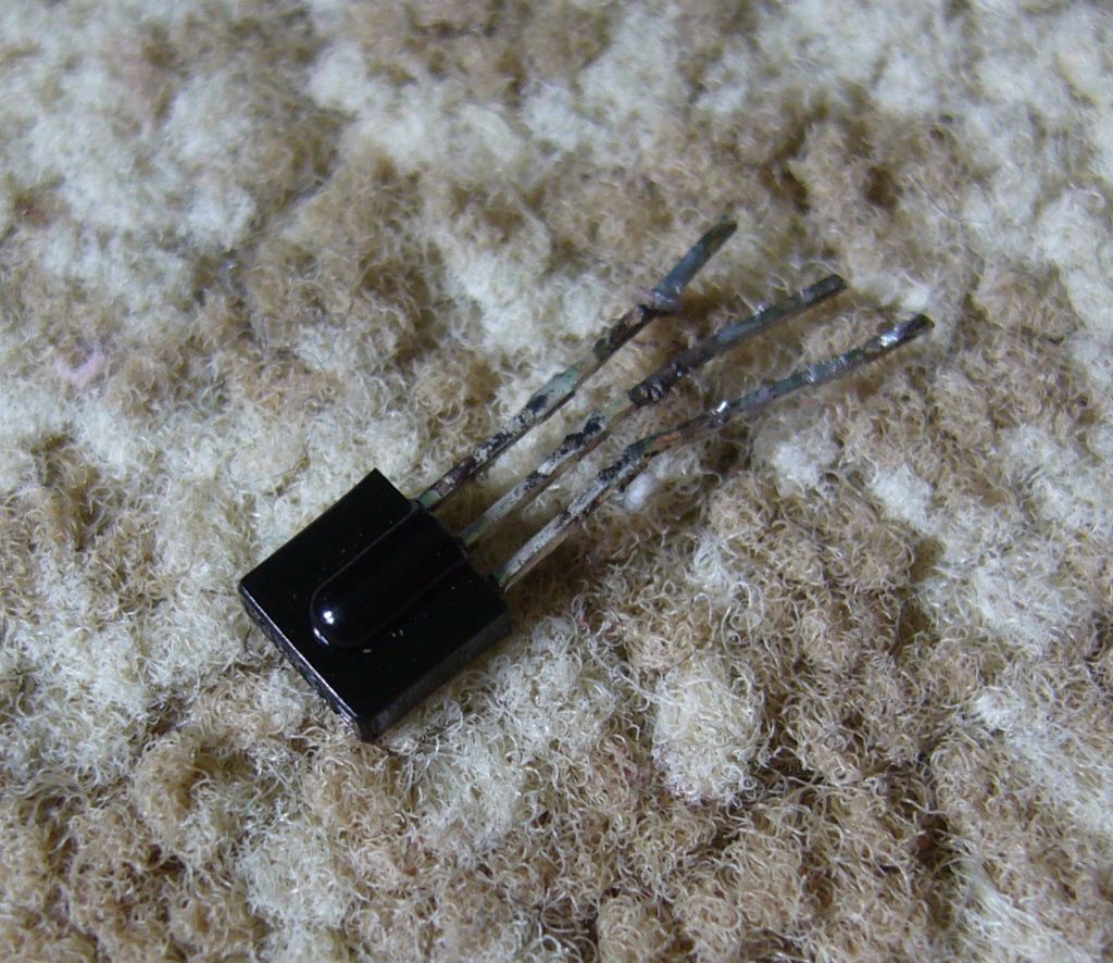

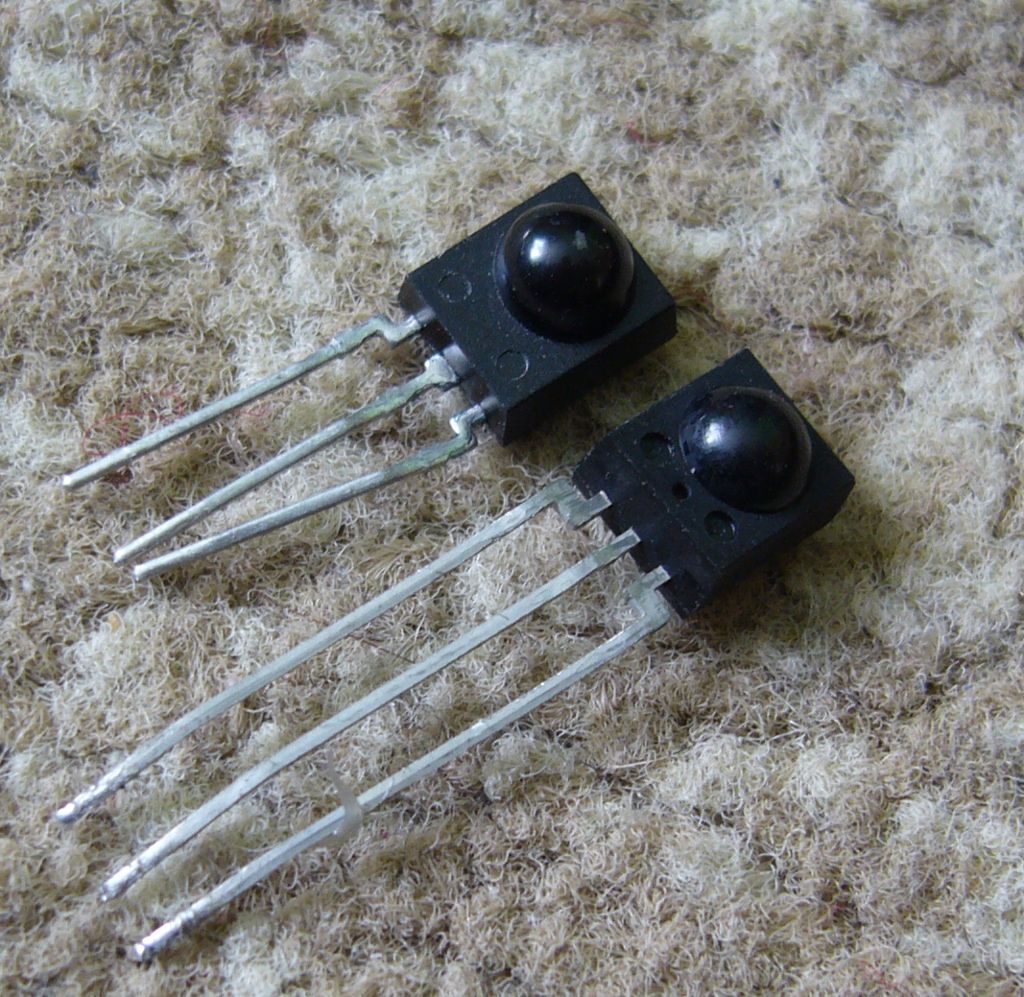

    #638 21441874
    DJCheester
    Level 28  
    Posts: 2089
    Help: 75
    Rate: 958
    Hi well that's what I was thinking - tomorrow I will solder it off the PCB and put it on wires away from the board and ESP.
    Possibly I will use another one I have a lot of from disassembly the problem is the lack of descriptions and therefore interpretation of the pins
    Unless you know how to identify pins from such receivers....
    Several IR receivers with different casings and pin counts lying on a carpet.
    Three-legged metal electronic component lying on a carpet.
    Several metal infrared receivers with three pins lying on a carpet. .
    Three-pin sensor or IR receiver with a black housing, lying on a light surface. .
    Several electronic receivers with three legs on a carpeted surface. .
    Three electronic receivers with three pins each, placed on a carpet. .
    Two black infrared receivers on a fuzzy surface. .
    Three-pin IR receiver on a textured surface. .
    Close-up view of a black three-pin component lying on a carpet-like surface. .
    I would appreciate your help in identifying the type/pinout of the receivers ??

    Hello again - with the receivers it has cleared up, I downloaded quite a few pdfs and connected a few unfortunately the problem is the same, but the problem however turns out to be what a colleague wrote earlier i.e. unconnected encoders.

    Case of receiver I've plugged in 3 types from what I've shown above pictures and the best in the sense of signal catching and distance have the big ones what I've designed in PCB that is TSOP31238.

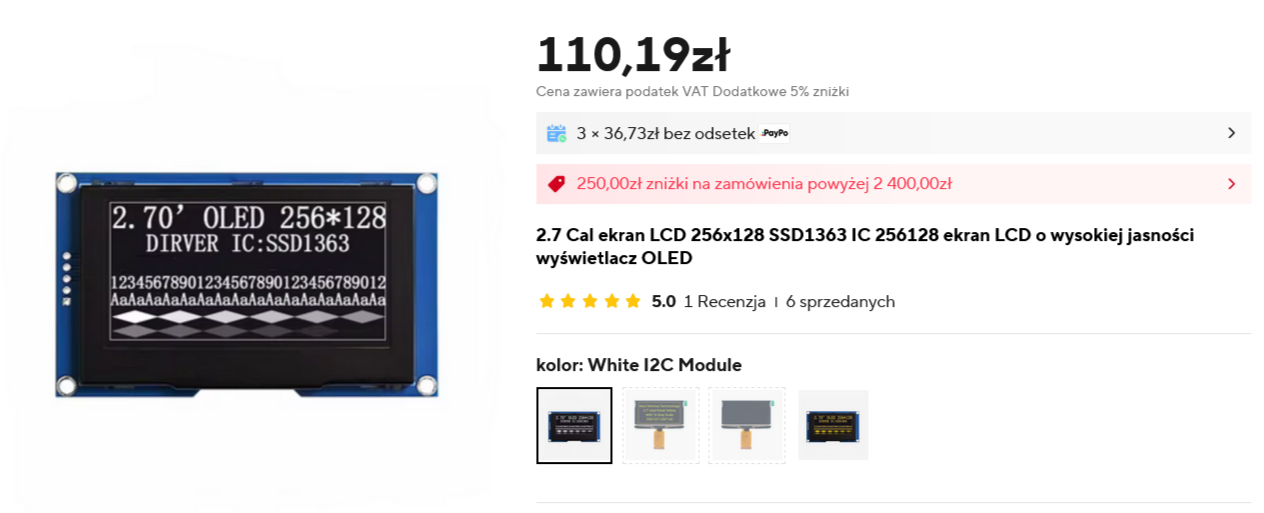

    And I already know I'll be making my v3 version based on a 256x128 OLED display, I've been looking for some larger size but there's not much to choose from. I got a bit caught up because I didn't notice and ordered a 4 PIN, so it will probably be via I2C. There will be an opportunity to tie mine and @robgold's screen inserts together more and expand the number of lines and useful info.
    2.7-inch OLED display 256x128 with price and description. .

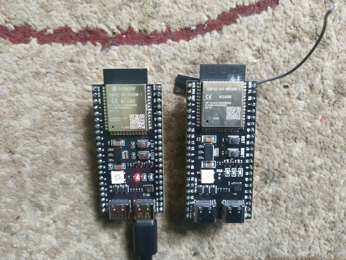

    Gentlemen I bought another ESP from Ali and I have to say that it is like the original, there is the espressif logo to the different shape of the ESP module this metal heatsink and antenna and the range is super without combining.
    I attach a photo of both for comparison.
    Two ESP32 modules on a carpet, one with Espressif logo. .
    So the bubble bought in Poland and the one with the logo from china super.
    Greetings ...
