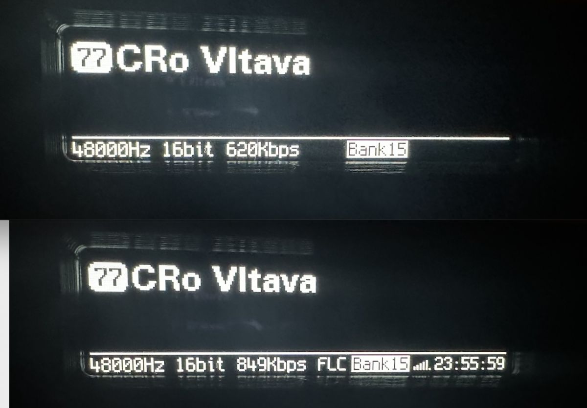

    Hot - I'm listening to CRo - flac - cuts heavily - could this be improved - hardware too weak? Internet too weak connection - because WIFI I have to rule out. I have close by and fibre optic....
    When cutting, the watch and FLC text goes off. Is this any indication?
    Two screens of a player showing playback of the CRo Vltava radio station with different data bitrates. .

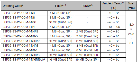

    >>21451814 Do you have PSRAM enabled in your Arduino compilation settings ?
    What module do you have ? 18R8 ? how much RAM do you have ? Depending on the amount of RAM you have, you have either QSPI or OPI memory.
    Table of ESP32-S3-WROOM module parameters, including columns for Flash memory, PSRAM, operating temperature, and size. .
    Added after 5 [minutes]:
    With FLAC stations I have the same thing, that's why I dumped those stations to bank 16. I also tested it on yoRadio. It is the same. It is sometimes worthwhile to preview what is on the serial port output when "audio buffor print" is enabled. I have a case where, for example, the ubiquiti 6 router has a problem with 2.4Ghz and IoT devices. After switching to Mikrotik suddenly the radio is buffering 250kb of stream.

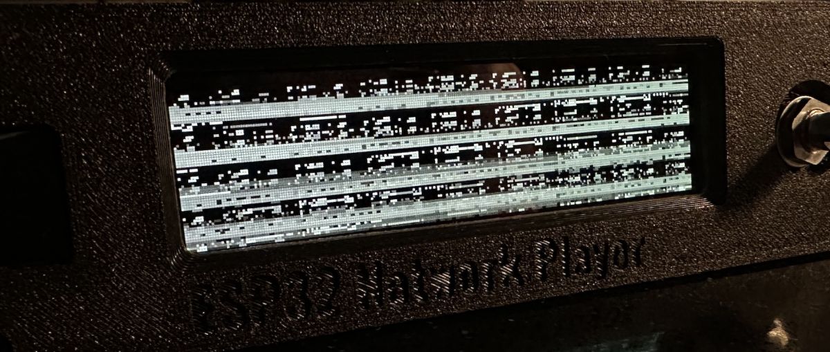

    Well, maybe not a firecracker - because that's what yoRadio is all about. In it, the I2S library held back in time is very old - from before ESP32S3.
    Thanks to your advice - I was able to replace the library with a fresh one and fire up TOSLINK (after adding the MCLK line). And shock - finally, Polish Radio Drivers has been playing for a few good minutes and not once was there a break in the stream. (Maybe it's due to the fact that I didn't define the screen, because I can't run SSD 1322 on yoradio with S3 board (regular ESP32 goes.).
    ESP32 screen displaying a distorted image with interference. .
