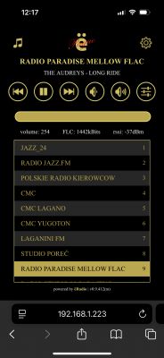

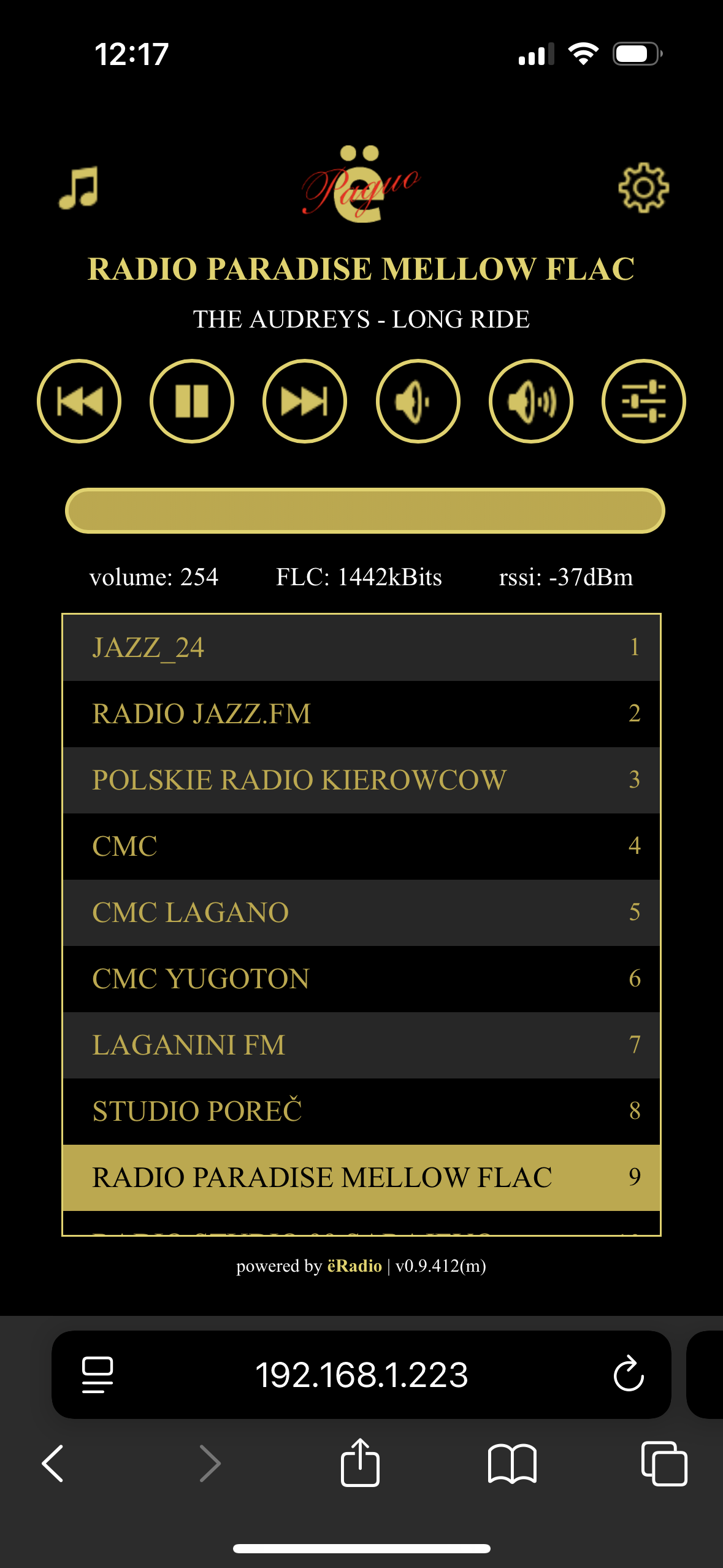

  • FLAC 1445 kbps works after removing display code
    #693 21453832
    wirbud
    Posts: 65
    Rate: 16
    robgold wrote:
    Mp3, Aac with no problem even up to 320kbps are running, but already FLAC 1000kbps can not cope. With me this radio plays every day to this some corrections in the code I make and I do not have any problems, resets or ripping of the stream.
    I've had Radio Paradise Melow FLAC - (1445 kbps) flying at me for an hour now, not once did it cut.
    I don't know for sure .... but my intuition tells me that this is due to the lack of screen support (only IR and WEB control). (I have commented out all lines with screen)
    Screenshot of Radio Paradise Mellow FLAC online player. .

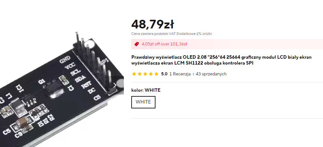

    Ok, I am starting to play with the radio, in the sense of assembling the blocks and so I look but I bought probably the wrong display ? because my display has only 7 pins, and I see in some pictures that there are displays for 16 pins and now the question is which is good :)
    mine is like this
    OLED display module with pins and product details
  • Use SH1122 display declaration for OLED compatibility

    @CodeBoy
    You have a very good display. Find the display declaration in the code and set the one for the SH1122. I have this display and the radio works normally on it.
    Code: C / C++

    @robgold and what connections only uses 7 with ESP ? instead of 16 ?
    sorry for the stupid question but it's also new to me :)

    @CodeBoy
    Both displays use the SPI bus. The fact that the other one has 16 pins does not mean they are all pinned.
    Code: C / C++
