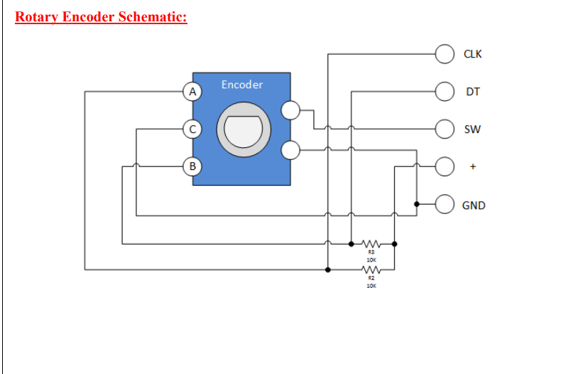

  • #724 21455132
    ArturAVS
    Moderator
    Posts: 25977
    Help: 2292
    Rate: 7705
    Board Language: polish

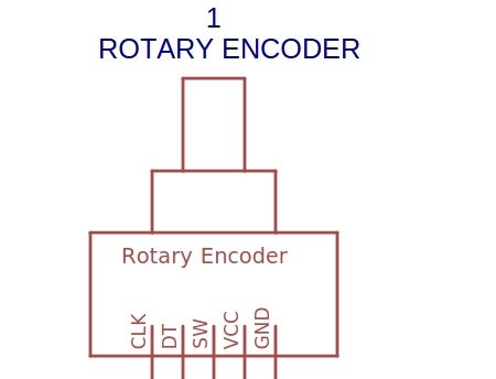

    I have a question for the Author, what kind of strange encoders did you use? Normal ones have outputs A, B, and ground and possibly SW (button). The ones in the original schematic (from the title post) are quite different;
    Diagram of a rotary encoder with labels: CLK, DT, SW, VCC, GND.
  • #725 21455234
    Slawek K.
    Level 35  
    Posts: 3015
    Help: 259
    Rate: 1297
    They are not strange just normal, commonly available and used.
    There are pull-up resistors added on the encoder board.
    Below is a diagram :
    Rotary encoder schematic with pull-up resistors. .
    Greetings
  • #726 21455237
    ArturAVS
    Moderator
    Posts: 25977
    Help: 2292
    Rate: 7705
    @Slawek K. I know how typical encoders work. Here is a confusing description of the connections.

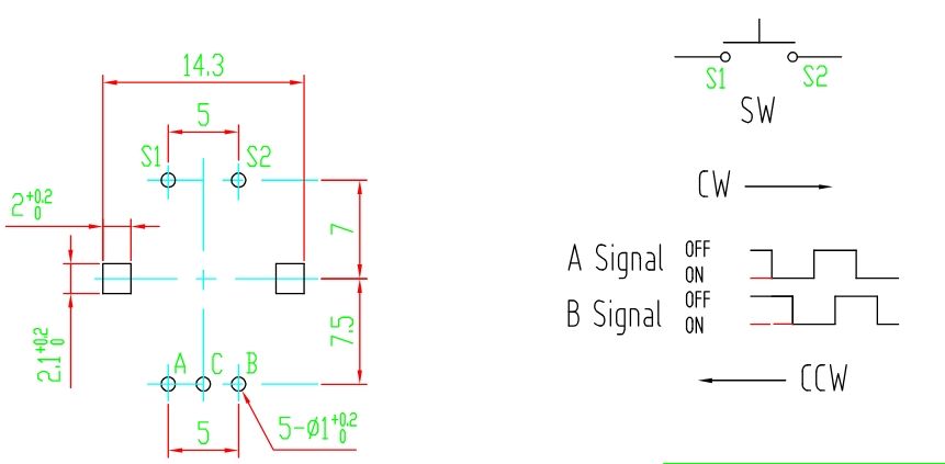

  • #728 21455256
    ArturAVS
    Moderator
    Posts: 25977
    Help: 2292
    Rate: 7705
    Clk, Dt, Sw and VCC and GND. This suggests that the encoder is fitted with some electronics, which is not the case. A typical encoder has markings;
    Encoder connection diagram with designations A, B, C, and buttons S1 and S2.
    A, B, C, A and B channels and C common. S1 and S2 are the button.
  • #729 21455263
    miroskop
    Posts: 461
    Help: 65
    Rate: 60
    I used ordinary (bare) encoders due to the fact that the ones with the board don't have a screw fixing (at least I couldn't find one with a thread), making it difficult to mount on the faceplate. I put the 10k pull-up resistors on the PCB. An additional plus is that you don't need to pull VCC to the encoders, four wires are enough.
    PS. However, I have now found encoders with board and thread :( .

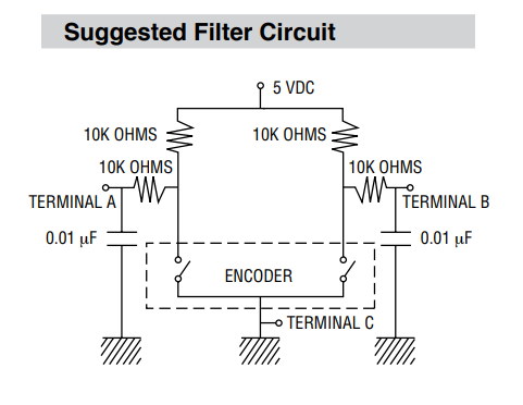

  • #731 21455323
    robgold
    Posts: 698
    Help: 10
    Rate: 284
    @ArturAVS
    These are (unfortunately) the effects of the "Arduino generation". Someone didn't "grasp" that an encoder has outputs A,B and works in Gray code. So they contrived to call one output Data and the other Clock. This was followed by the creation of such blow-ups, ready-made libraries. The world of ready-made modules is full of such "flowers".
    @miroscope
    Be careful with these off-the-shelf PCBs. I have several such encoders and they are of such poor quality that they fall apart in my hands. And when you add a big knob they just mechanically have a lot of play. It's better to buy a good branded encoder from TME.
    Just as a curiosity, I will add the recommended filtration system by Bourns:
    Suggested filter circuit for a rotary encoder. .

  • #733 21455402
    miroskop
    Posts: 461
    Help: 65
    Rate: 60
    I have already written about the use of these capacitors in the order of 10nF - 33nF several pages earlier. They have worked well for me.
  • #734 21455459
    robgold
    Posts: 698
    Help: 10
    Rate: 284
    Yes I remember, the capacitors seem obvious. I'm referring to that complete 10 Ohm, 10nF filter.
  • #735 21455502
    miroskop
    Posts: 461
    Help: 65
    Rate: 60
    In the schematic it is 4x10kOhm. I didn't put these resistors in series, only the pull-up ones, but increased the capacitance to 33nF. You would have to check how the "full option" would work

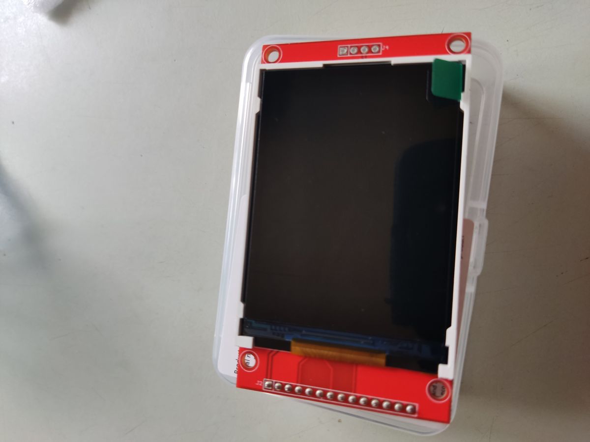

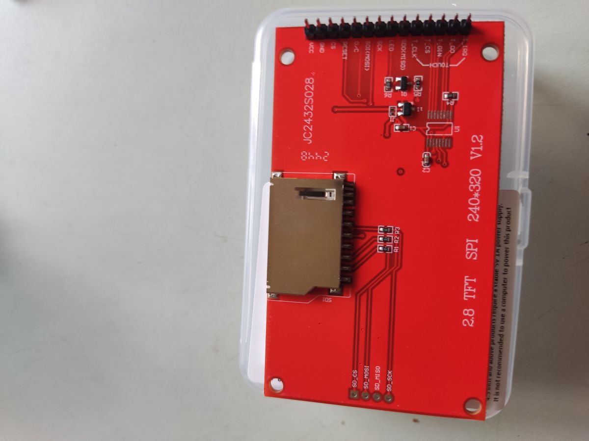

    Szaryczlowiek83
    Posts: 69
    The missing components have just arrived and I'm getting on with the assembly this evening.
    Has anyone dealt with the JC2432s028N LCD display? It's a 2.8" display on a lil9341v library which has a miniSd card reader (I think because I can't find the specs for the devil) firstly I'm wondering if it will work, and secondly can anyone tell me how much the files on the card alone take up without the music.
    Electronic board with LCD display JC2432s028N and miniSD card slot.
    LCD display JC2432s028N lying on a white background.
    I'll post it if anyone is curious

    MAJSTER XXL
    Posts: 2063
    Help: 164
    Rate: 421
    The encoders are printed on their small PCBs exactly as they appear in the wiring diagram, and why bother with combinations here. This is to give those interested in building a radio a simple and clear way to make connections between components.
    This is also how the ports are defined in the software.

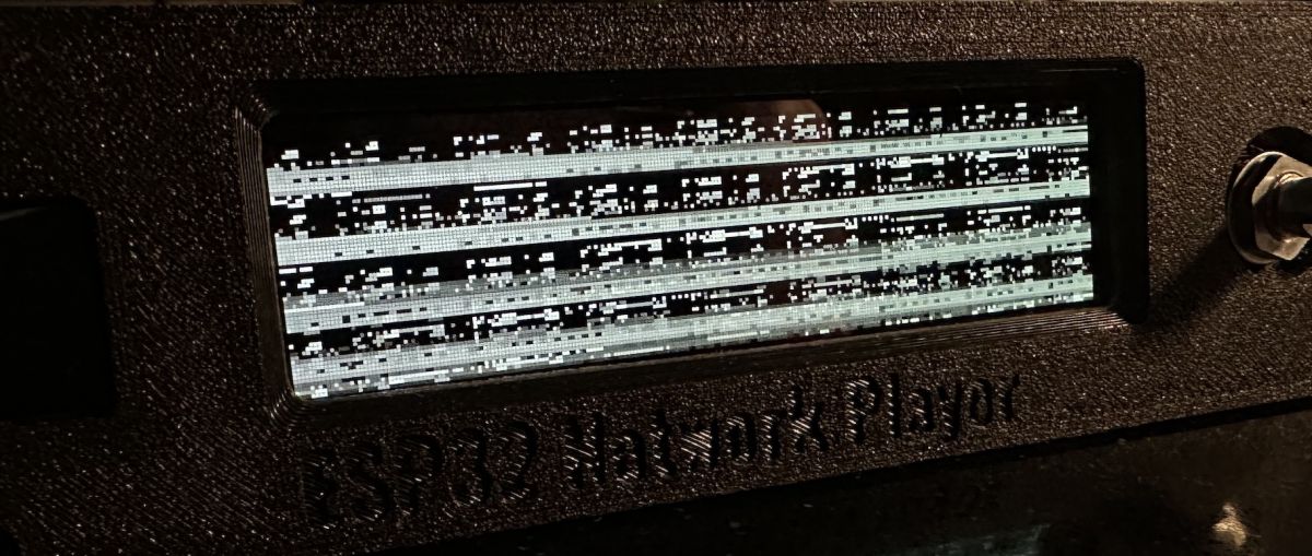

  • #748 21456390
    wirbud
    Posts: 64
    Rate: 15
    >>21456381 I tried but this generator does not allow to select and define other SPI pins than the standard ones. And the whole plan goes to hell. I won't upload the version from the thread later. So now I'm thinking if maybe it's the clock frequency.... maybe I'll look here some more....
    Display of an electronic device with interference in the form of black and white stripes and pixels.
  • #749 21456395
    robgold
    Posts: 698
    Help: 10
    Rate: 284
    @wirbud
    Just as a quick note, see if it works SSD1322 to yoRadio in the myoptions.h file. I wrote this from "my finger" so no guarantees:
    Code: C / C++
    Instead of #define TFT_SCK 45 it could be #define TFT_SCLK 45 but rather SCK.
    In the second attempt, still change HSPI to true.
    In this file at your place you have SPI definitions, swap to "our" leads and it should work.
    Link .
