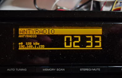

    I did a test on my yoRadio and ESP32S3 module. It doesn't start on pin settings compatible with our design. SCK and MOSI must be on pins 11 and 12 for yoRadio.
    Internet radio display showing the station Antyradio. .

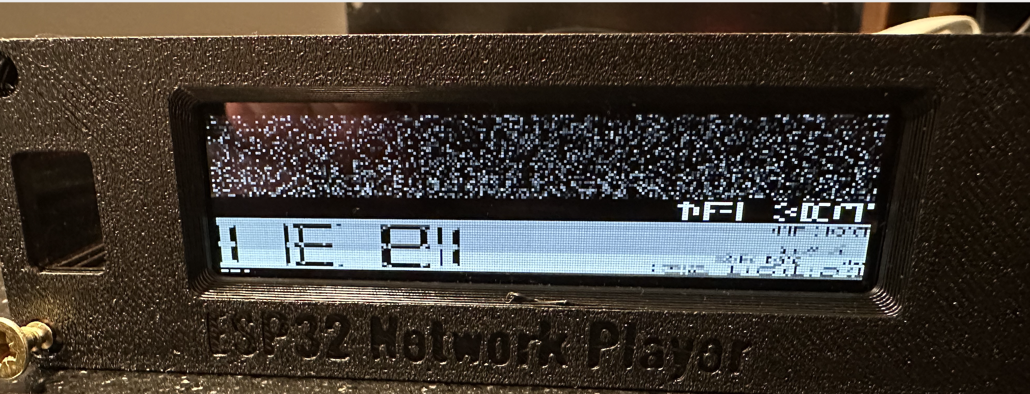

    Added after 1 [hour] 32 [minutes]: .
    Situation with my yoradio screen - after disconnecting the CS pin (leg 16 of the SSD1322 screen) something more sensible appeared. I can also disconnect the RST leg (leg 15). is the same. Half a mirrored image. After it walks a little and goes off.
    Changing the station with the encoder boosts the screen and it lights up again for several seconds. Maybe someone can help? (On the ESP32 it runs normally. On the radio from our thread it also goes on.
    Only when I switch to yoradio it is bad. (SPI on 11-13).

    @wirbud, connect the reset pin to the ESP reset pin, on the boards it's called EN (Enable) and press the reset button on the module. Connect the CS signal back, of course.

    >>21457553
    THANK YOU ROBGOLD for your support !!!
    Unfortunately this is the first thing I did - It took much longer for the screen to shine on the EN with the RST bunched up. In the sketch I did not change the 41 leg. Then I changed it to -1 (as it is connected from EN plate. There was no revolution. A hard case.... So I'm thinking that if this is how the FLACs go I'll go back with this SSD1322 on the ESP32. Only the I2S library for AAC needs to be changed to go with this scarier ESP32. I've already got a version of yoradio-ALL(Maleksm)-v0.9.434m(15.02.25) - a lot more audio formats than in the library from December 2024. Interesting fact - Maleksm split the tasks into 2 cores - in one only audio handling goes in the other all the rest !

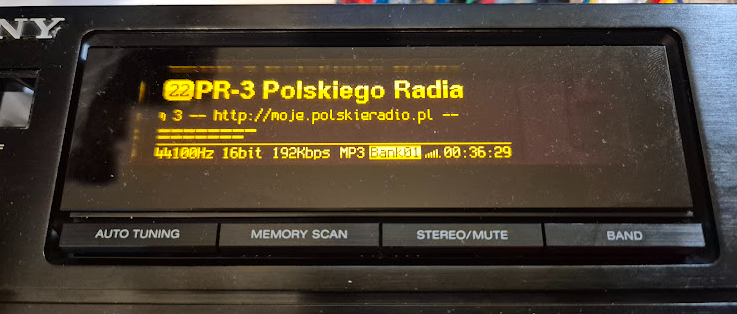

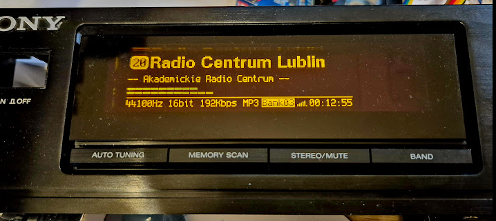

    By the way you can share the rework of the Sony Tuner, front panel and printed adapters slowly on completion :) .
    Sony tuner screen displaying radio station PR-3 Polskiego Radia.
    Sony radio with display showing Radio Centrum Lublin station. .

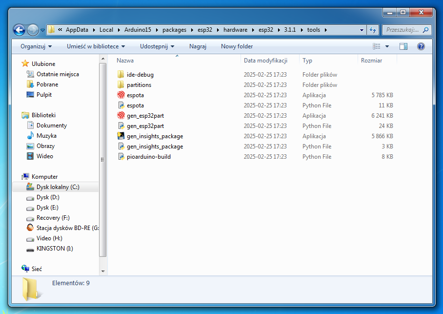

    wirbud wrote:
    BLWIP-FIX.ZIP 2. Unzip and copy liblwip.a to the directory (you have a username, hardware version may be different): C:UsersAppDataLocalArduino15packages32hardwareespesp322.0.17tools.liblwip.a - for ESP32 or C:UsersAppDataLocalArduino15packages32hardwareesp322.0.
    Hello so I only need the archive liblwip-fix.zip ?
    This second file is unnecessary ? liblwip_20241019_3.0.5 ?
    With me I have the 2.0.17 version of ESP libraries and in both the first ESP32 link and the second ESP32S3 link I already have the liblwip.a file but they are not the same in S3 takes more ?
    Then what should I replace with this Fix file in the two cases ?
    And one more question, because on the second computer I have a version of the library 3.1.1 (on 64bit), should I also replace there the same liblwip.a file with this fix ?
    Greetings ...
    Added after 16 [minutes]: .
    Hello again on my second computer I have Win7 64Bit and Arduino 2.1.1 and ESP 3.1.1 libraries
    And there is no such folder there anymore
    C:UsersAppDataLocalArduino15packages32hardware2.0.17tools32.1.
    C:\Users\user\AppData\Local\Arduino15\packages\esp32\hardware\esp32\2.0.17\tools\sdk\esp32s3\lib\
    After version 3.1.1 there are tools and then there is just this
    Screenshot of a Windows folder with files and directories related to Arduino and ESP32. .
    Greetings ...
