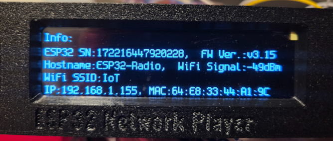

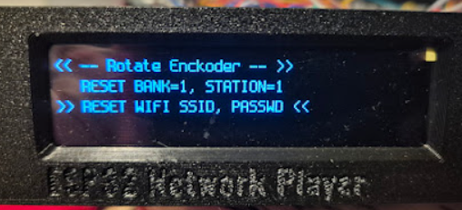

    Quick update for Evo 3.15 Link
    - I made the mentioned screen dimming after 10 sec. Dimming does not work if you manually turn on the dimmer with the button on the remote control because then you have the lowest brightness level. What do we "turn" - >variable:
    Code: C / C++
    - from now on there is a "RECOVERY" mode, what does this mean ? If, for some reason, the radio hits a station which resets it and you do not want to take out the card and manually edit the file with the station number and the bank number, hold down the encoder 2 during the restart. You enter the Recovery mode. In this mode you can:
    reset the settings to Bank=1, Station=1
    reset WiFi settings, the next time the radio will ask to connect to the wifi network "ESP Radio" and set a new SSID and Password to wifi.
    In addition, under the rcCmdRed button you will also see the so-called BasicInfo about the radio. Providing basic parameters of the radio like serial number, firmware, network you are connected to, wifi signal strength, IP address, MAC number.
    ESP32 Network Player display with reset options. .
    Display of an ESP32 Network Player showing WiFi connection information. .

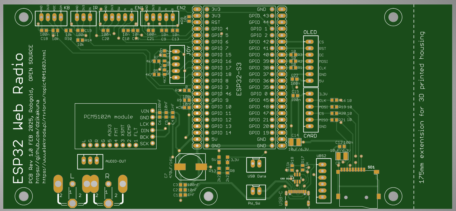

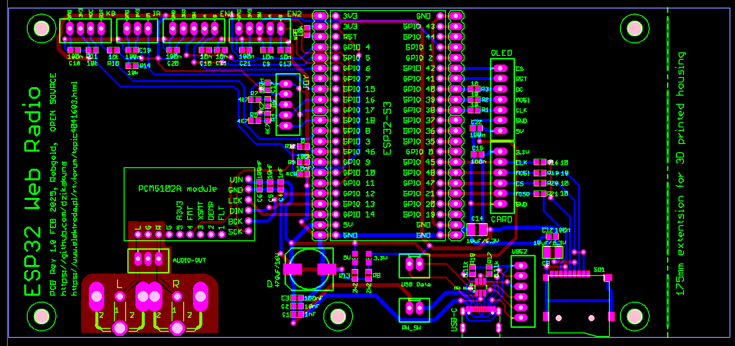

    On GitHub I uploaded preliminary gerbers for the basic PCB version of this radio -> HERE Link .
    The board is made as a kind of "breakout board" so that the radio can be put together using ready-made modules. I distributed the power supply, there is an option for 2x encoder, IR receiver, ADC or i2c keyboard, joystick, which is in the Majster version. I've also thrown in an SD card slot (here I still need to check the connections are correct). There is also a USB-C connector configured with CC pins to give 5V, plus ESD protection on it.

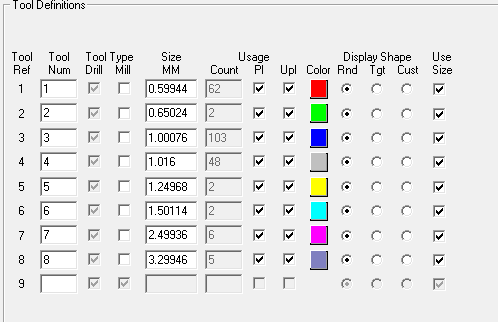

    I've had a preliminary look at the CAMs and ViewMate, everything seems OK, but you know I might have missed something, and since boards in China are cheap but not free, please take a look if there are any obvious errors before I send it to production. I know that the tools (drills) are not yet sorted out in these Gerbers but I will put this together before sending it off to production. Excellon in 1:4 format
    Gerbers can be viewed with many different programs like GerberLogix, ViewMate, CAM350 on the PCBWay website Link there is also a free viewer.

    Hi if I may interject and what I am missing in my previously etched PCB could a solder jumper be made preferably for the Vcc of the SD card to pull up 3.3V and 5V for the use of these largerSD card modules with a stabiliser on board.
    The card voltage selection would be done like the jumpers on the PCM module by soldering the pads side by side with a drop of tin.

    To make it a cheaper PCB in Chinese, you need to close below 100mm, there is so much free space here that you could easily fit this on the aforementioned format :) .
