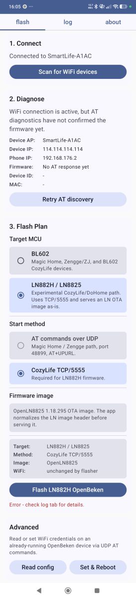

    Phone screenshot of an app log showing connection to CozyLife_4302 and an LN882H OTA upload.

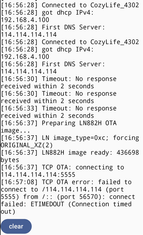

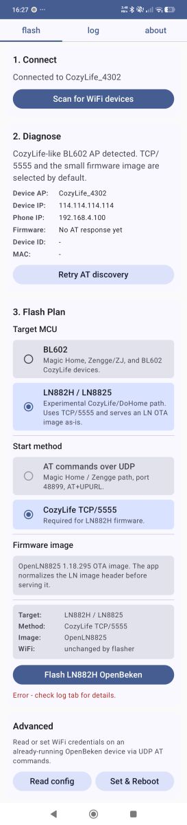

    Okay, now I know what's going on. In the Openbeken assets, ln882h and ln8825 are in different places. I didn't realize they were different builds. Version 0.4.2 is trying to flash LN882H.

    no sign of 0.4.2 so made my own

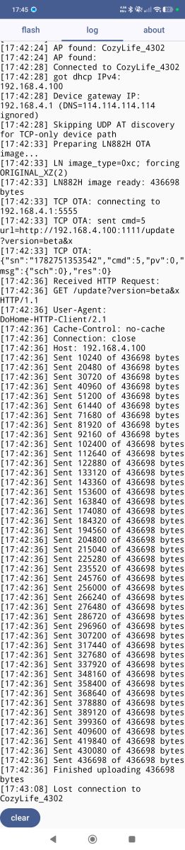

  • Added connection diagnostics for interrupted HTTP transfer
    #104 21930375

    Sorry, I didn't upload the 0.4.2 assts earlier. They're there now, but it probably won't change the result. Thanks for the serial logs, they're not very extensive, unfortunately, but I'll take a closer look.
    Added after 1 [hours] 27 [minutes]:
    [ota_download_precheck:74] same version, do not upgrade!
    This is just a warning. The problem persists later, as if the HTTP connection was interrupted after 8kb of transfer, but I can't see why.
    In version 0.4.3, I added more connection diagnostics.

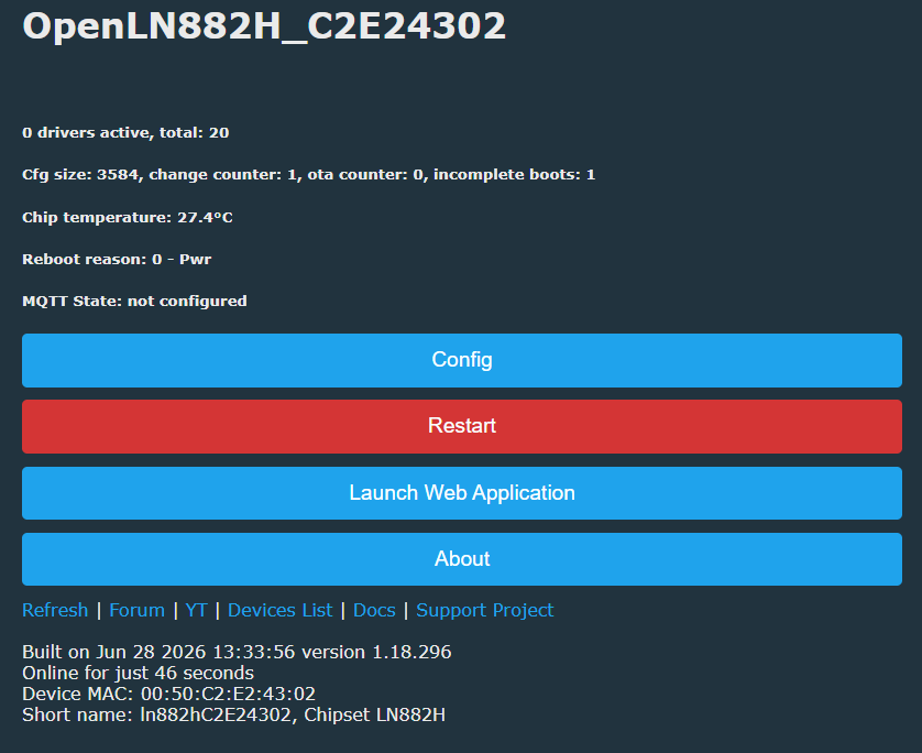

  • OTA flash over WiFi completed successfully
    #105 21930419
    Posts: 5236
    Help: 450
    Rate: 920
    your 0.4.3 completed ota
